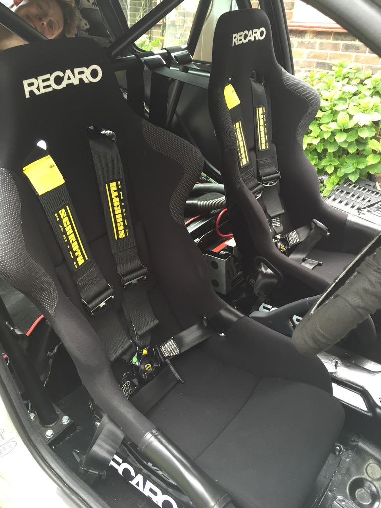

On another note, I finally fitted some proper harnesses that I picked up for a bargain.

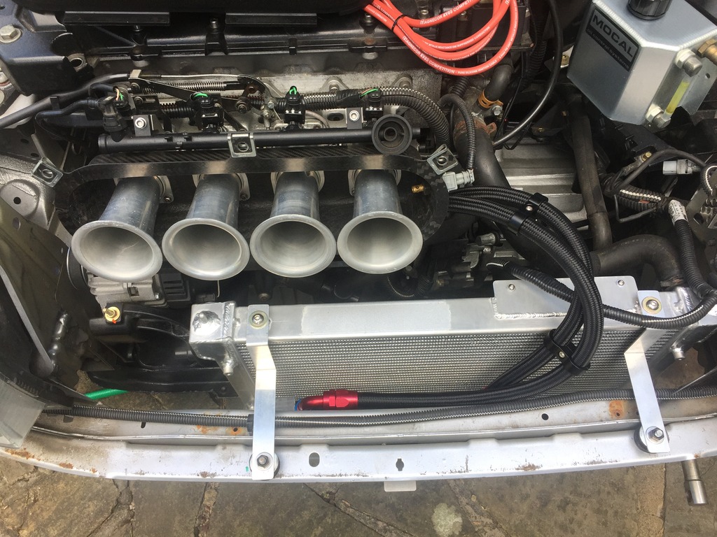

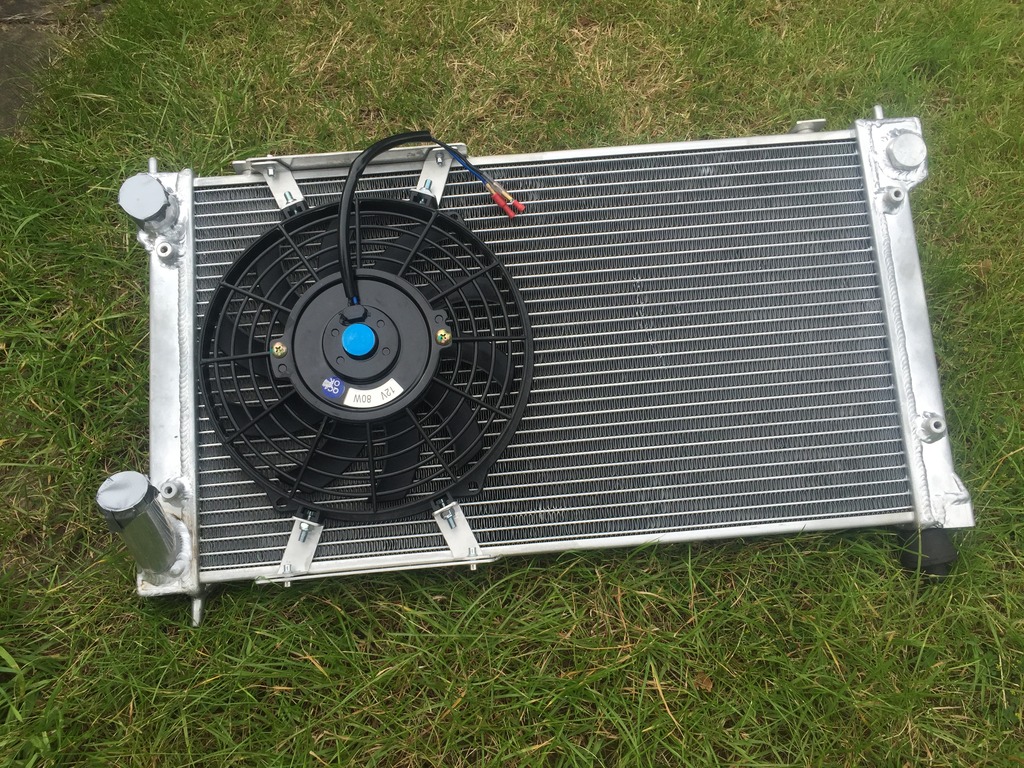

With a massive helping hand from @GrahamS I removed the shitty/tatty Polo rad to replace it with a nice new ally Direnza one. Thanks to @NorthloopCup for some adjustments to the pipes and @Kelv for sorting out the fan mounts, fan and rad support brackets.
G also showed me how to do a lovely wiring install with the fan so it looks proper OEM.
The rad hasn't been put in permanently yet as I need to fit some rubber foot mounts then mock up my oil cooler and lines first.

Looks smart, love the photo bomb, lol. Could you share the links to the rad and fan, after the same myself, looks a very neat job btw. Cheers
This is the one:
http://www.ebay.co.uk/itm/ALUMINIUM...ROCCO-CADDY-/150980635337?hash=item232725aac9
My mate paid £100 for one recently, so it looks like the price changes every now and again.
This one looks like it could be the same too but I'm not certain: (same Ebayer I got mine from - 2fast2cool2)
http://www.ebay.co.uk/itm/VW-GOLF-M...ADIATOR-RAD-/232005775967?hash=item36049f325f
The fan is just a universal £18 one from eBay.

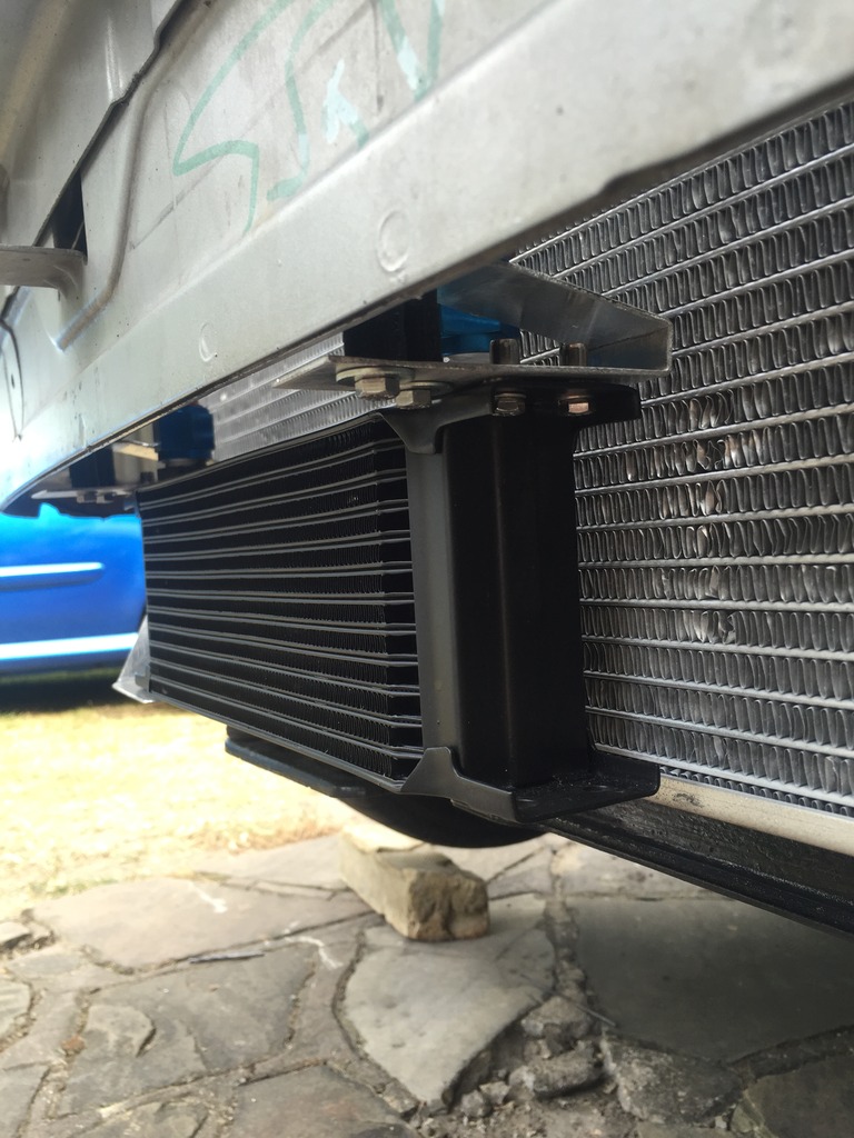

@GrahamS came down again this weekend for another car day. Our aim was to finish off the oil cooler install, and get the car running so some track days can be booked before the Summer is over.
After a slow chilled out start, the afternoon approached and we'd not got much done. It was looking like we'd run out of time at one point, so we battled on.

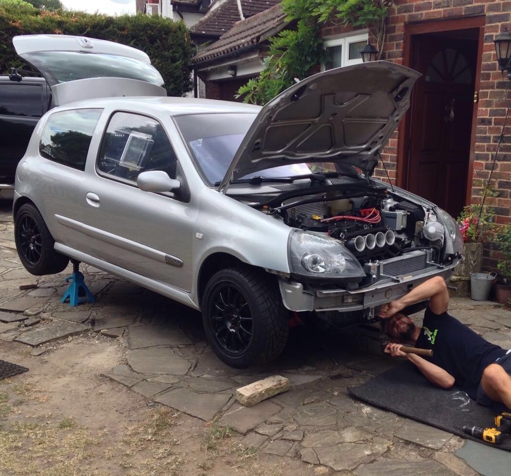

Somehow G managed to get a photo of me actually doing something...
"Don't disturb me when I'm cleaning my room"

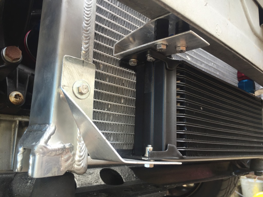

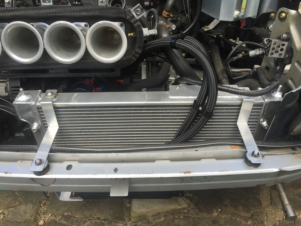

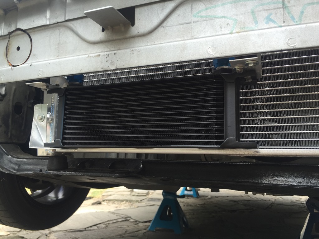

A few shots of the rad and oil cooler in place. I'll get some more at some point, we were rushing to get it finished so I forgot to take some more.
We then went for a little road test, frequently stopping to check for leaks. Excuse the VERY squeaky brakes, they sound rather odd on the footage.

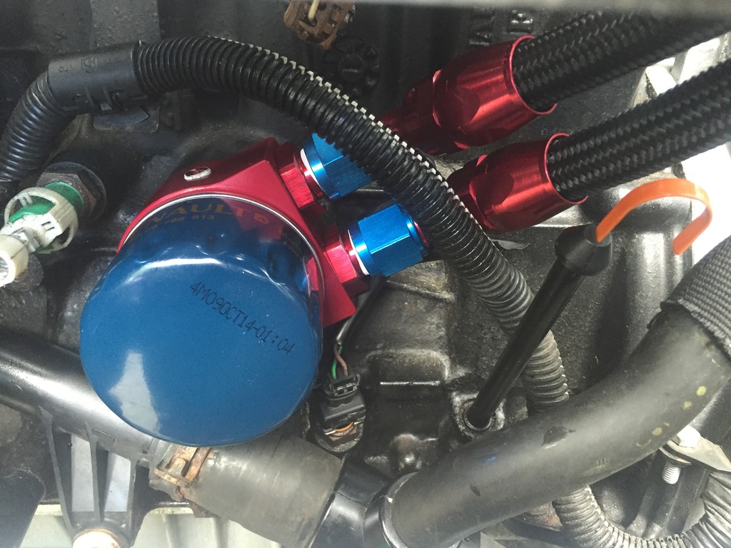

Thanks to Pro Line Motorsport for supplying the cooler and lines. They do some top quality race car builds as well as specializing in automotive plumbing.

Nice work @Martin. like the brackets :up:

The brackets are Graham's excellent design.

Ps thanks for your help with ordering stuff :smile: The plate and lines fit ok at the moment, but when the temp sensor and remote pipes for the pressure sensor get fitted it could get a bit tighter for space haha.
So pleased that is came out so well in the end. Couple of hose separators an it's a pretty perfect install.
For a little bit more detail on the fittings. We used m5 rubnuts on the cross member to absorb vibration from the engine, seal the hole and for ease of removal if ever needed. http://www.masterfix.com/en/products/blind-rivet-nuts-bolts/rubnut/ These should also stop any metal fatigue on the brackets.
It's got 35mm bolts from the bottom of the bracket, through the 20mm nylon spacers and then into x-member.
The bottom bracket is not designed to hold any weight but to prevent back wards and forwarded movement. There were many cardboard templates like project binky!
The brackets are made out of 1.5mm ali plate with the rest of fittings consisting of m5 rivnuts, shorter bolts and loctite.

Looks good. I like how you've mounted the rad and oil cooler.
Did you make them yourself?
