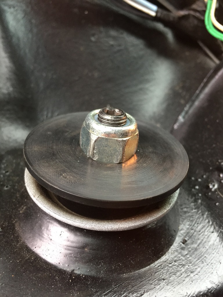

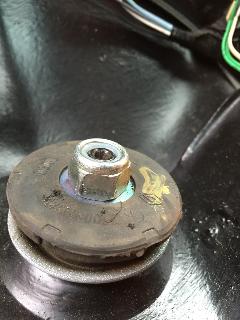

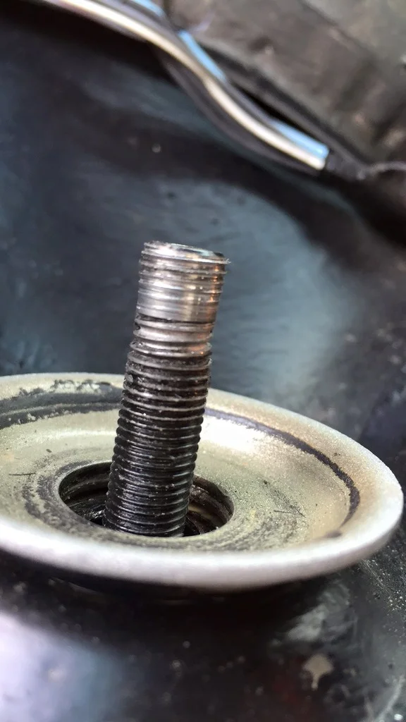

As some of you might know, I've always had an issue with the fitting of my rear top mounts since buying the ASTs. I'm not sure why but for some reason the nut has never been able to get on enough to be locked.
I've got the Powerflex black top mount kit fitted, as shown below. This is nipped up to about 25-30nm.
For a long time I had assumed this was because the Powerflex washers were so thick.
However after speaking to @Tony Hunter @Jay Payne at Silverstone I've wanted to compare the Powerflex kit to the standard Renault kit. The total size is exactly the same and I've still got the same issue. (The Powerflex bush itself is smaller to allow space for the added washer)

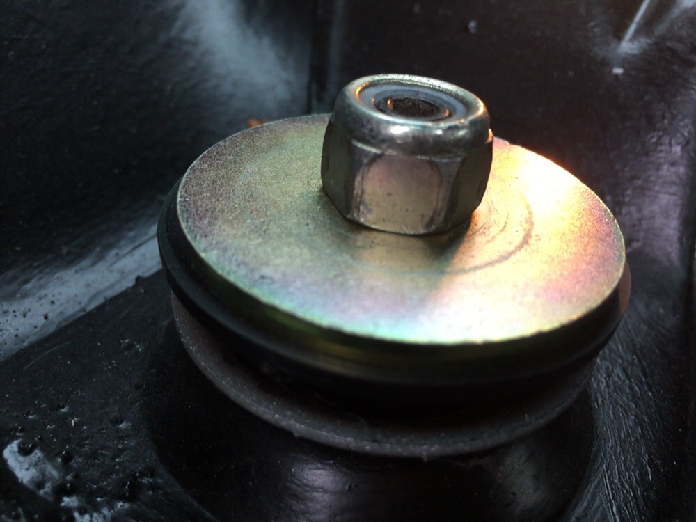

Here's a picture of the Powerflex kit, without the washer. This obviously allows the nut to be done up properly, but the bush itself is being crushed to some extent, so it's not ideal..
So anyway, this weekend, I decided to take the entire rear suspension off and have a proper look into it.
This is what I've been left with.... A f*cked thread!
So now I obviously need to send the rear coilovers back to AST to get them repaired/sorted out. Which is a right pain, considering how bad the AST customer service is and how long they are known to take with things. Especially just as prime track day season is starting.
I've been advised to go back to Cooksport first and do it via them, as they sold me the ASTs.
Does anyone have any experience with sending parts back to AST? Any advice or suggestions would be great.

I'd deal with Cooksport first, might find they have a better professional relationship with AST to organise the repair.
Is there no way they can be re- threaded locally?
I've spoken to Cooksport and AST today. Waiting to hear back from Cooksport now.
They could possible be repaired locally. But that would almost be a make do bodge, which could also affect the value if I ever need to sell them on. I just want them back to how they were really.

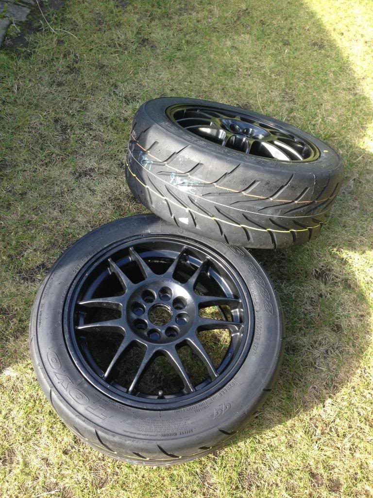

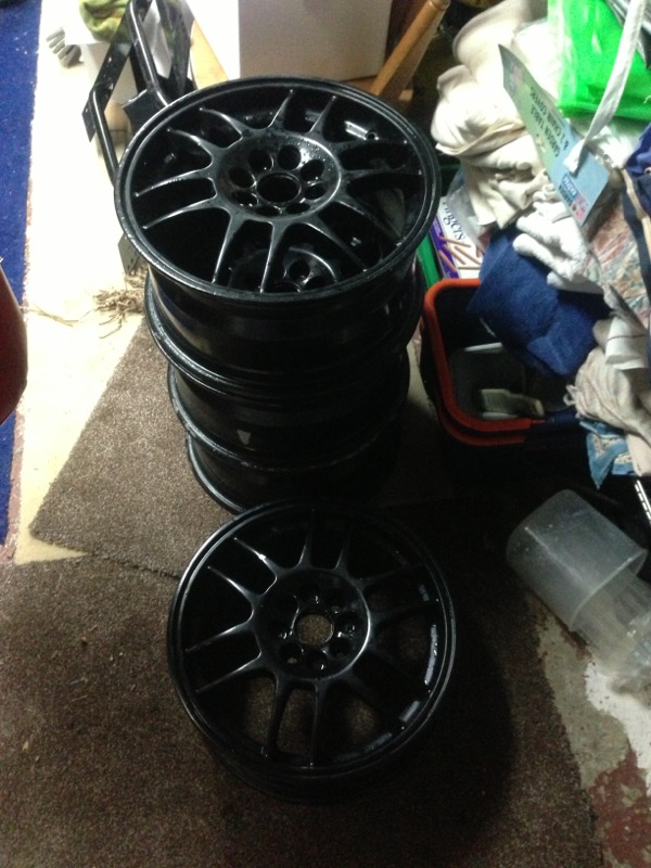

A second set of wheels was purchased along with some sticky tyres. These became my track only wheels.
I have one of those wheels which came as a spare when i got the car. Anyone know where i can get another 3.. any condition but in black. They are o.z ones right?

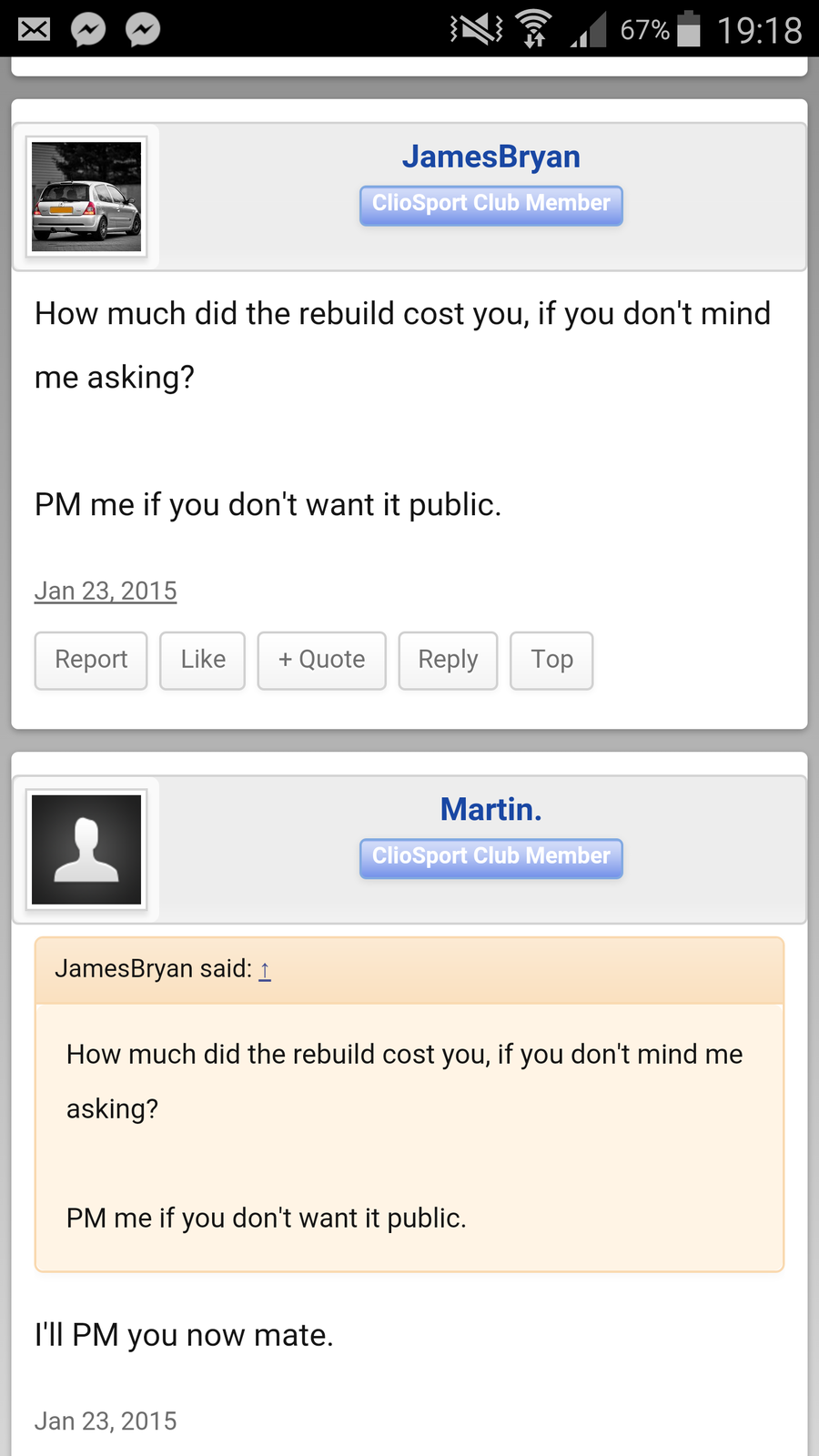

Just out of curiosity mate, how much was the engine rebuild?
Did I not message you? I seem to remeber sending something... Maybe it was to someone else, sorry.
They are indeed mate. They pop up for sale all the time on the Clio forums, just keep your eye out. You may have to buy a full set of 4 though, but they are very cheap wheels. Often go for £30-£40 a wheel.

The nut isn't the wrong thread pitch is it mate?
Looks like it might be to me the way it's chewed that thread up.
The AST looks to be a fine thread bud.
That's what I mean, can't understand why your nuts don't fit.
That's exactly what I've been trying to figure out 😧 As even with the standard Renault rubbers the nut still wont fit.
It's almost as if there's a design fault and the threaded section wasn't made long enough.
Nah buddy, it goes on easy and smoothly. It was also supplied with the ASTs.
The thread is a M9x1.0mm for reference. I haven't actually checked the nut though, but as it goes on nicely and it was supplied with them I always assumed there was no need...

Sent both my rear ASTs to Cooksport on the 16th (delivered on the 18th) as instructed. Cost me £35 to send them insured unfortunately :cry:
I was told last Tue (29th) that they were in the pipeline to be taken to AST for a repair, not sure if that's been done yet and feel a bit out of the loop. Need to chase them again today to find out what's going on, now the BTCC week and races have passed.
Any joy yet mate?
Spoke to a very friendly guy at AST Holland at the beginning of the week. After a discussion we agreed the coilovers don't need a service and he was just going to repair the damaged one.
He's had to send the bill to Cooksport though, so I'm just waiting for this to be sent on to me now.
The whole thing has just taken sooooooooooooooooooooooooooooooooooooooo long!

Oh yeah, next time I'll go straight to these guys at the AST factory.
It's a little annoying really, as I was going to send it to them the first place, but I thought I'd give Cooksport a call first. I was told on the phone that they should be able to get me better customer service with their good AST relationship. So I sent my coilovers there instead, at a courier cost of £35, but they just sent them to Holland in the end anyway.
Cooksport have been helpful, just a bit slow, which I guess is understandable with Josh's touring car commitments. In the end though I'd have saved a good 3-4 week if I had just sent them to Holland myself.
But the repair is done now. I've just received and paid the invoice, so they'll be sent out to me as soon as possible.
