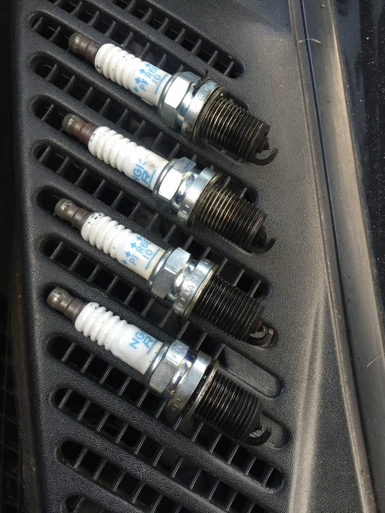

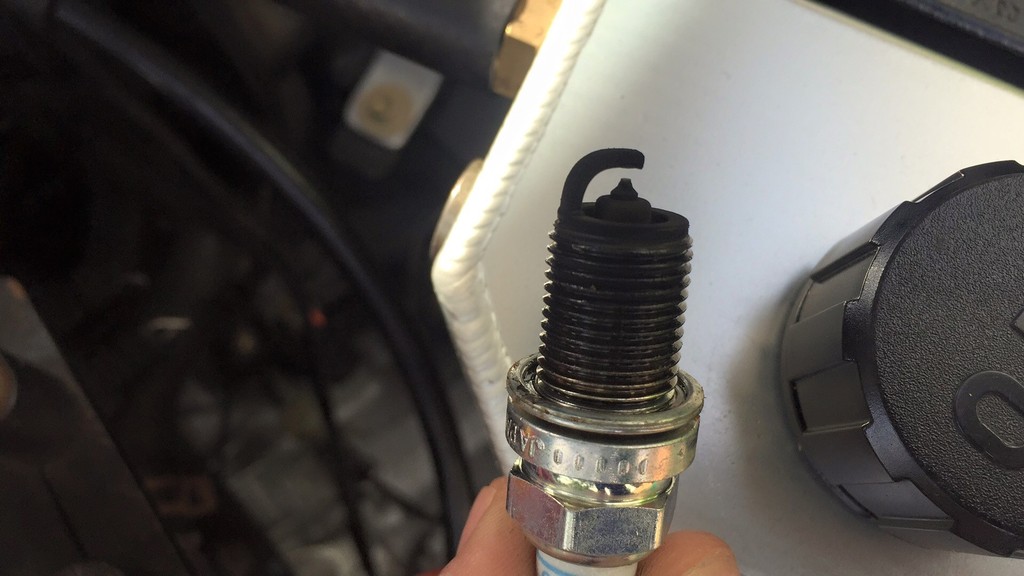

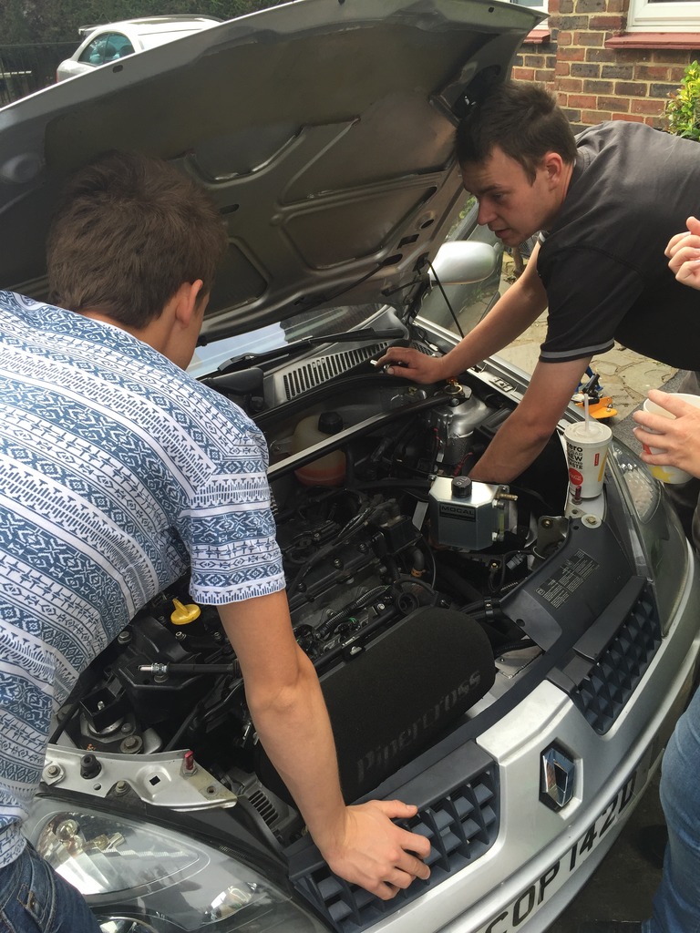

I've had a lot of help this weekend from generous friends. @GrahamS came down on Saturday and we spent the entire day in the sun doing jobs on our cars. Graham and @AlexW also came down Sunday morning to try and get to the bottom of my issues.

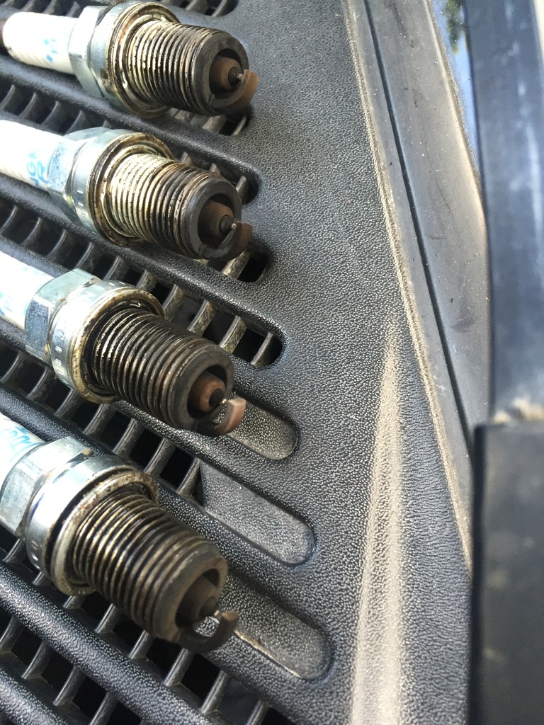

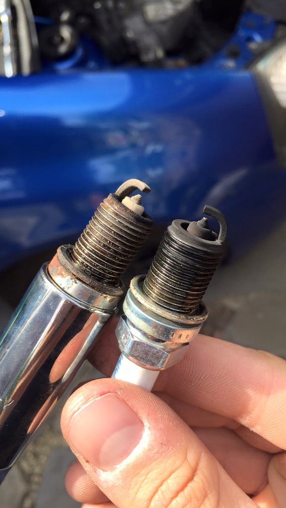

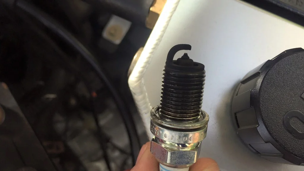

Long story short and after lots of checks and tests. The car seems to have a really weak spark. Which means some of the fuel isn't burning, going through the exhaust and popping, which fails the noise test. Extremely sooty plugs show this. Why it has a weak spark we don't know.
Graham and Alex were looking at the OMEX live data and the AFR on a wideband. Everything looks ok but for some reason the car runs really rich on idle and when holding the throttle stable. Sometimes even as low as 9 I think. When progressing through the revs, or going flat out it is perfectly fine.

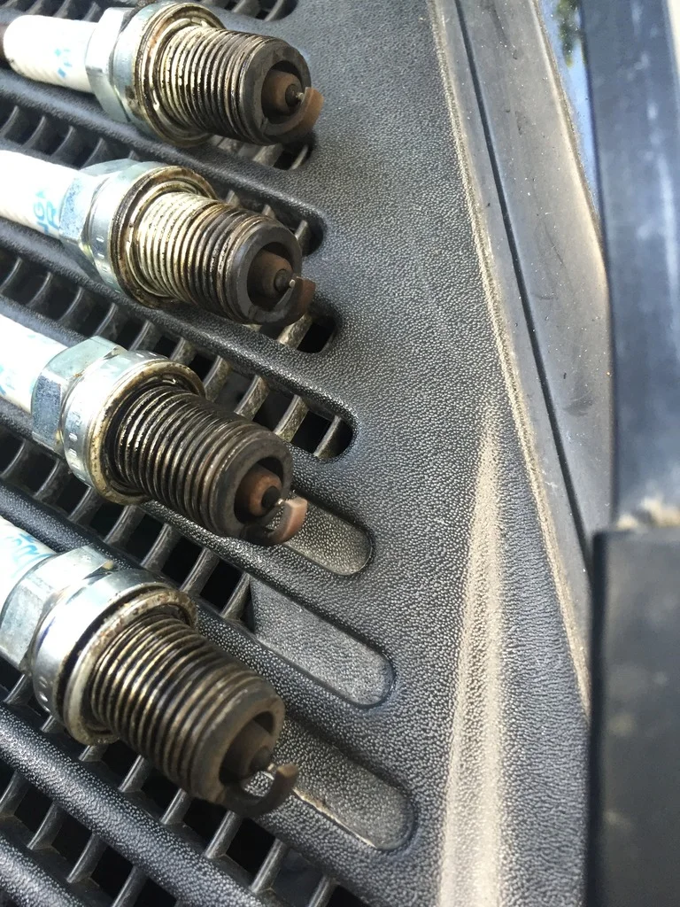

We've stuck my new plugs in for now. It seems to run a lot lot better now. Hopefully enough to get it through the Bedford noise test on Saturday. These plugs will end up getting very sooty though in the end. So the actual problem is still under investigation.
Thanks very much for your help lads!
My plugs:
My plug next to Graham's plug as a comparison. Lean vs rich 😂

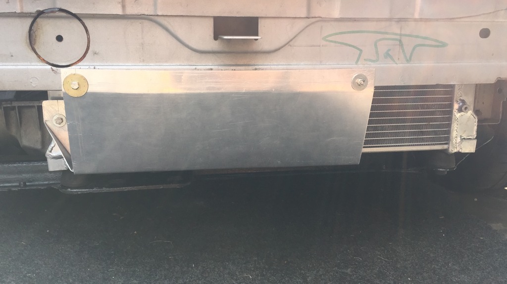

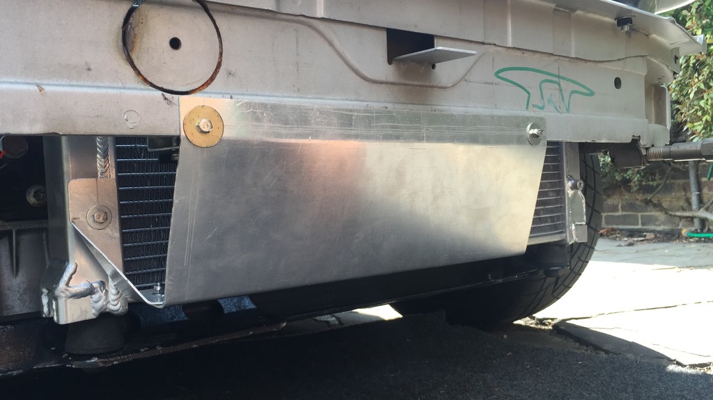

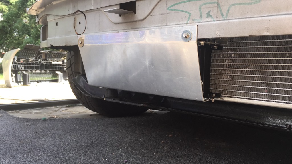

Whilst the car sits unusable until I work out a plan for it around work, I thought I'd spend some time tidying up the oil cooler cover plate I had made. Once I have my oil temp gauge wired in I can use this plate if the oil is getting too cool, potentially on winter track days.
I will also be looking at getting some kind of thin wire mesh to go behind the bumper grills, to help protect the cooler from stones or debris.
I keep meaning to put mesh behind the grill, like the plate but that will be stopping a lot of air flow to the radiator as well.
Yeah it will. Thankfully there's a lot of rad on show above the crash bar too though. It's quite a nice sized rad.
It will probably only be used on very cold winter track days, and also only when I've got the oil temp gauge wired in so I can monitor the operating temperature.

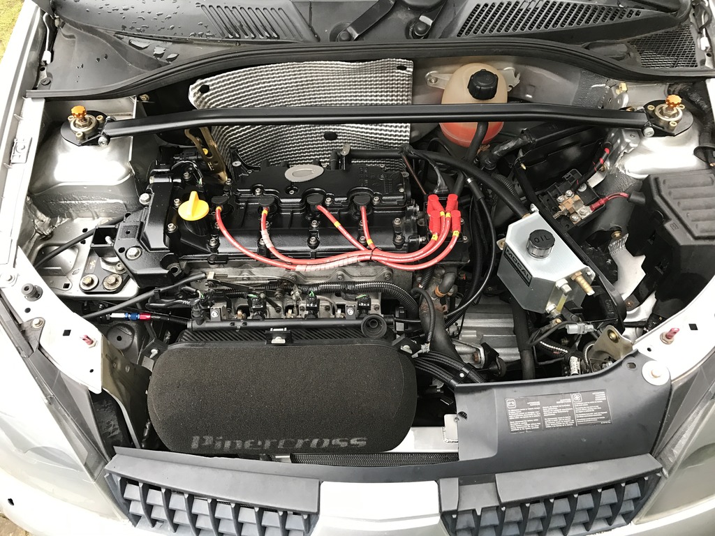

I took Coptood to Brands Hatch yesterday. I was a little bit nervous about passing the noise test as it was the first time trying since the previous issues, but all was good, 85db static.
It was a great day, the weather stayed cool and dry. There was a lot of lovely Porsches (originally a Porsche only track day) and a couple of impressive race cars.
The Clio performed very well though and I had some great bumper to bumper battles with a couple of Porsches. They were probably shitting themselves at the thought of a Renault banger being 1m from their rear bumper..
The car still has some kind of limiter issue though. It won't rev past 6500 at all. Initially thought it could be a standard ECU cold limiter, but it continued to be there all day. So I'll have to look into this and speak to Engine Dynamics again. Short shifting didn't put too much of a downer on the day though.

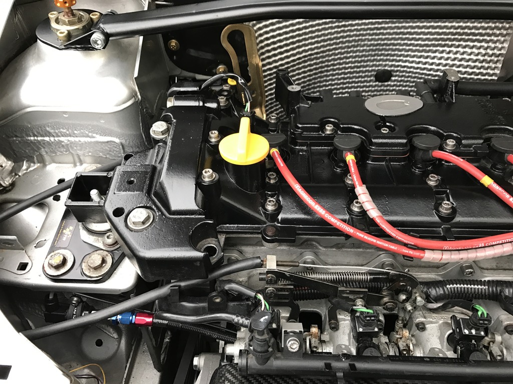

On the last session of the day I heard a weird noise from the engine bay and then under the car. It sounded like something had fallen off, so I carried on around the lap very slowly and saw my oil filler cap sitting there on the track 😂😂 I came back in to be greeted with this mess! Some prick (me) had somehow forgotten to put it back on after topping up the oil, but thankfully I heard it and didn't start a hard 20 minute session. That could have been a disaster!

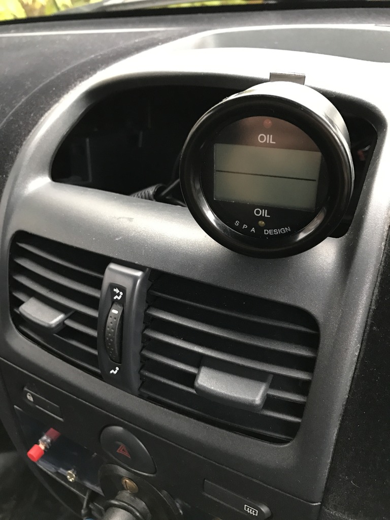

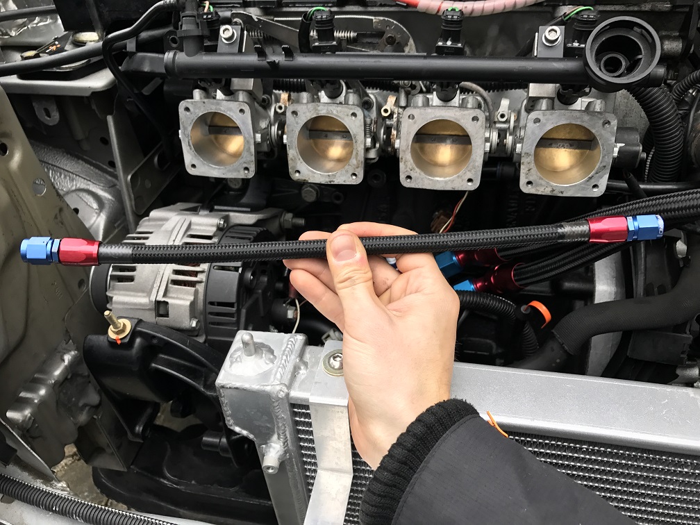

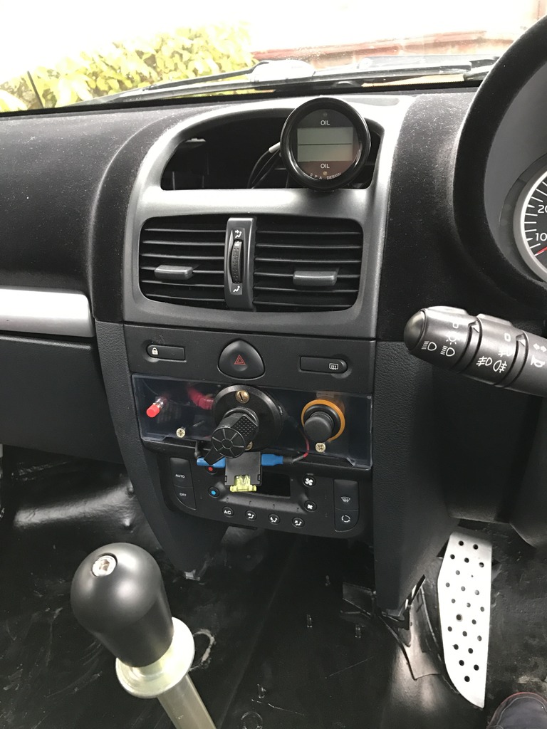

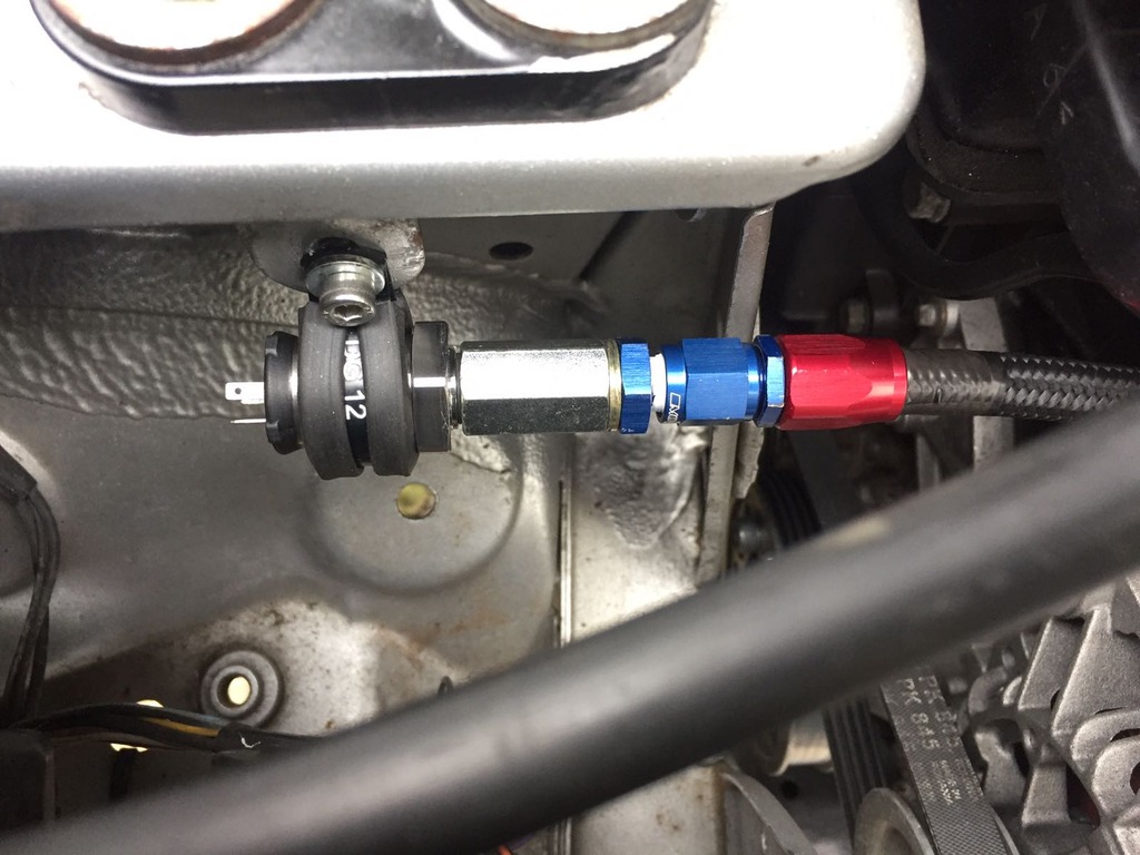

I've had very little motivation to go outside to the car with the cold wet weather recently. Although the other weekend Graham and I did manage to finally get my oil gauge in. We did a lovely job of it if I do say so myself. It looks properly OEM with conduit protecting the wires from under the dash right to the oil filter. Big thanks to G as always @GrahamS
So of course I had to test it. And interestingly the oil temp will not go above 80 degrees in this weather. Even when it gets there it drops off pretty quick when you drive normally! I then put my cooler cover on to test the oil temp again and it reached 100 pretty easily. So it looks like I'll be keeping the cooler cover on throughout winter just in case I drive the car, and I'll only take it off on a track day once I've done my warm up laps.
The oil line we made to remote mount the pressure sensor. Thanks for the advice and help with it all @NorthloopCup and @M.C..
The oil pressure sensor itself

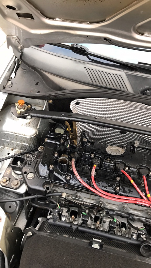

I also gave the bay a quick clean up from the oil explosion at Brands and fitted the new oil filler cap.

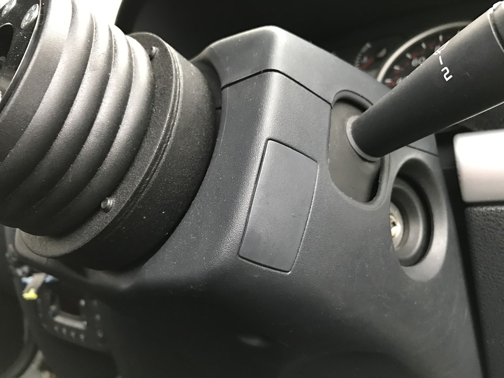

I also fitted a stalk blank, which makes it a lot tidier. Every little helps as they say.

You forgot the staple trick!
We de-pinned the SPA plug using staples so we didn't have to cut a huge hole in the bulkhead. That is all.
