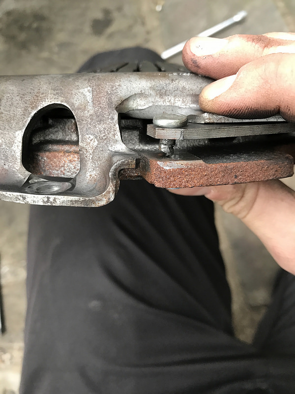

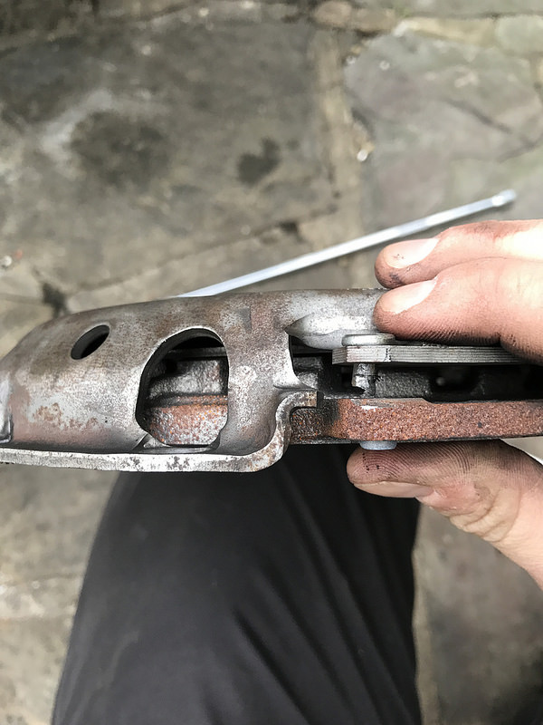

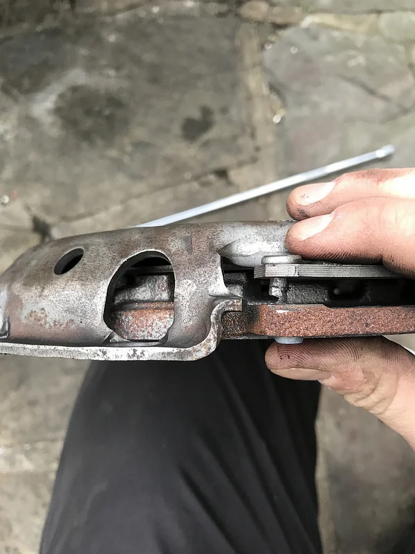

The other weekend the broken clutch was swapped out for a Helix Organic kit.
The old Valeo clutch cover had sheared a rivet!

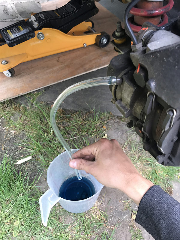

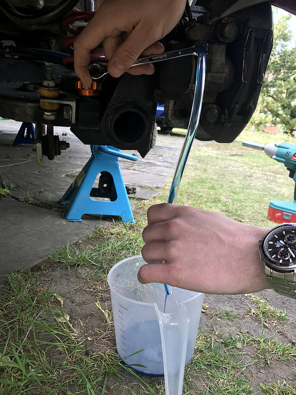

The car was also given a brake fluid change. It hadn't been done in a few years.
Thanks to Alex and Graham for their help.

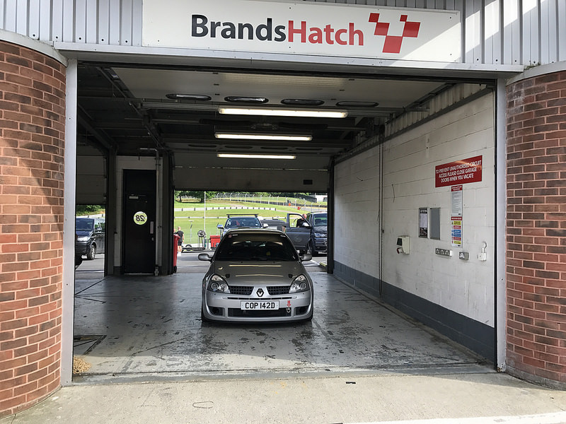

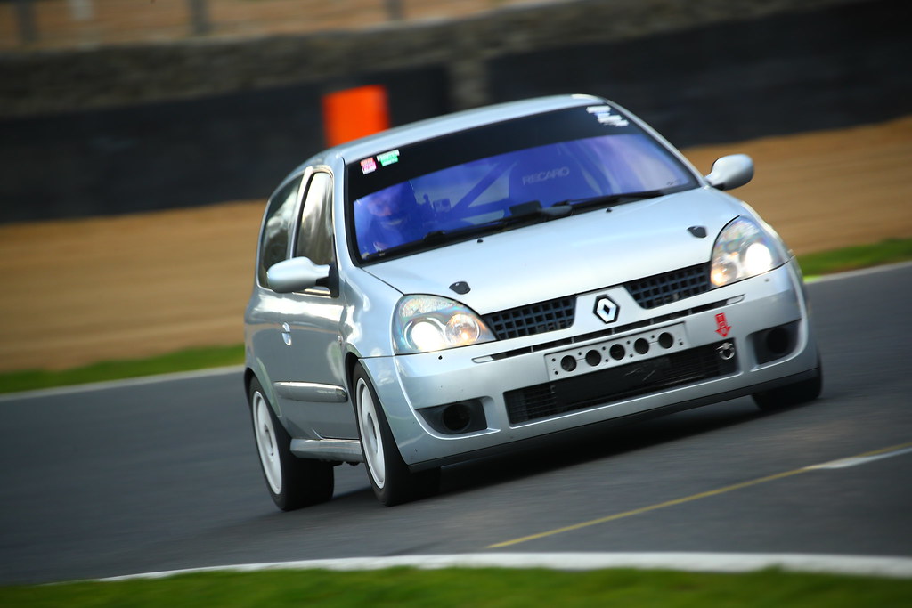

I then took the car to Brands Hatch last night and it performed faultlessly. A few things to note though:
1) I need to fit my roof scoop or a cup fan setup desperately. It felt 100 degrees inside the car on track. No sliders in the windows now means NO air gets into the car. The climate control just blows out hot air and nothing else. Not ideal. We were dripping wet after 5-10 minutes.
2) The helix clutch is VERY noisy when not on the throttle. Sounds broken but obviously isn't.
3) the Gripper also sounds a lot more noisy now at slow speeds around the pit lane. Almost like a load of little animals are making noises inside the box!
4) The oil cooler is VERY good. Oil temps were around 70-80 degrees on the drive there and the sighting laps. Warm up laps saw this rise to a firm 85 ish. On a session I saw 105 degrees when I was really on it, around 95-100 when at 9/10ths. Then after just one cool down lap this quickly drops back down to around 90 degrees and then mid 80s after the 2nd cool down lap. Considering it was a very hot day I was pleasantly surprised by this.
I've also bought some X plates to stick on the car when the old man goes out for his laps. 😂

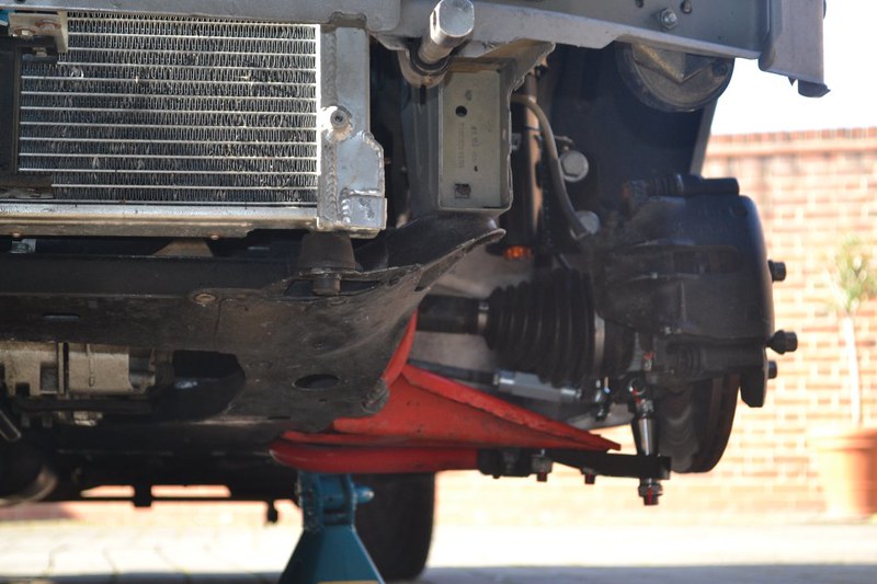

2018 Update.
I've not updated this in a very long time. The car has been great over the last 6 months. I've had a couple of the best track days ever at Brands Hatch, including a recent full day of sunshine on January 18th, which was only £100!! What a bargain that was.

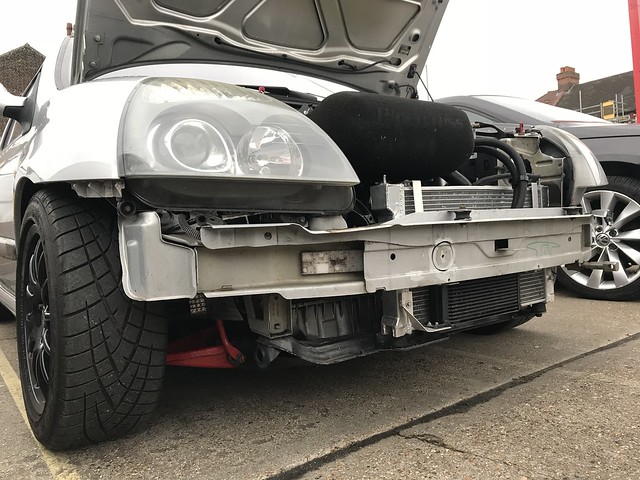

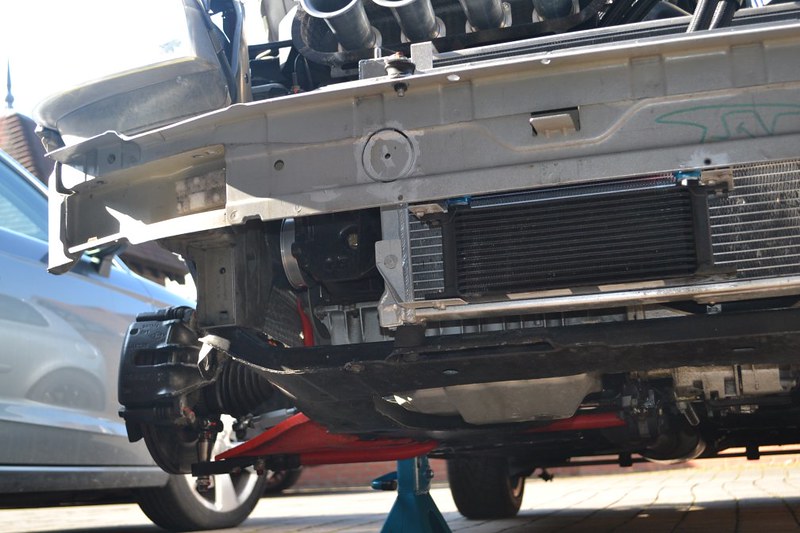

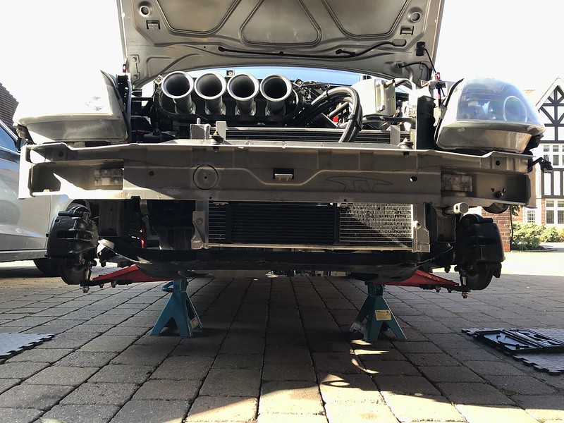

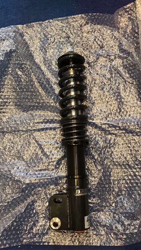

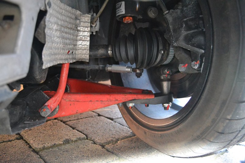

I bought myself some new shiny ASTs. The 5100 kit.
My northern brother Ant from @ACS_Motorsport came down to stay one weekend and kindly fitted these for me, along with his Roll Centre & Bump Steer kit. I had been eying up the RC kits on here for a few years, but never had enough spare cash to justify it.
This kit looks like a work of art, it was a shame to see it fitted under the car but it has made a HUGE improvement on the handling. So much so, that I can pretty much turn in for the apex without ever worrying about understeer. (It's just oversteer which is a slight issue at the moment, but the car hasn’t been setup since the new ASTs, so Ant is coming down again soon to give the car a full GEO and corner weight setup. Last time he did this for me at Silverstone I could not believe the difference it made, so I’m looking forward to getting it on the scales again and having the setup tweaked.
@GrahamS has produced an excellent video of these recent upgrades. With a very helpful explanation of what the RC kit does.

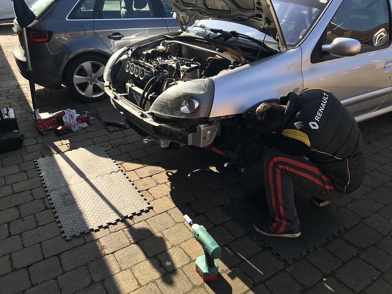

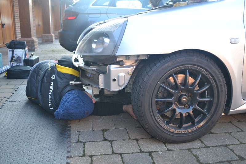

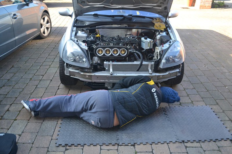

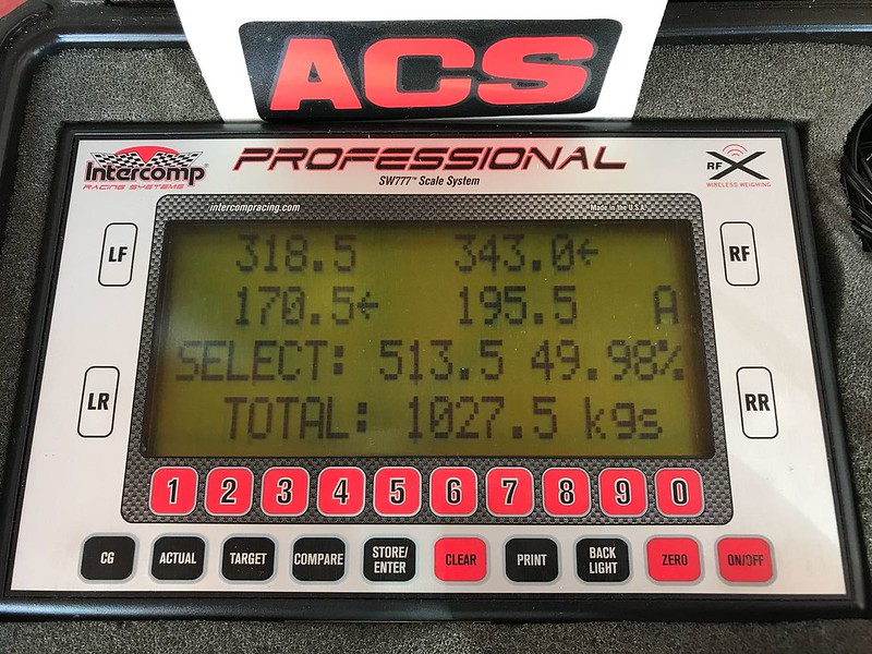

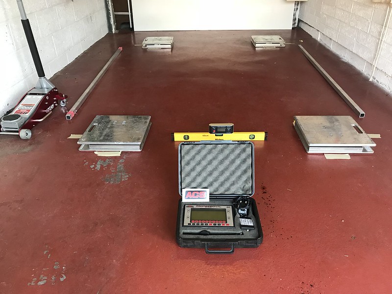

Anthony from @ACS_Motorsport came down to do a corner weight setup on my car last weekend. His motorsport background gives him huge knowledge in car setup and everything was done extremely clinically.
As I’m sure is the case for a lot of us on here. Getting a focused track car to and from places isn’t ideal. Even though mine is road legal I always try and avoid taking it on the road, 1 because of the risk of idiots and 2 because it’s horrendous to drive on the road.
So the mobile service offered from ACS was extremely convenient and i wouldn’t take my car anywhere else now.
He got started on the car nice and early and he literally didn’t stop until he was happy it was perfect.
The car weighed in at 1028kg with me in the drivers seat. With just over 1/4 tank of fuel and a 50% diagonal cross.
For those of you who have never had a car corner weighted before you should look into it. It will totally transform how the car handles on track. When I first had mine done I couldn't believe the difference. I'm really looking forward to seeing how it handles at Snetterton now that I have new ASTs, the RC kit and a proper setup.
