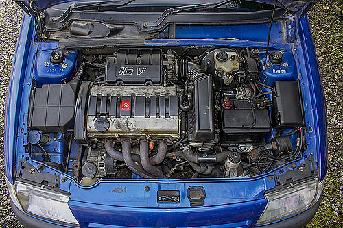

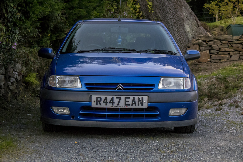

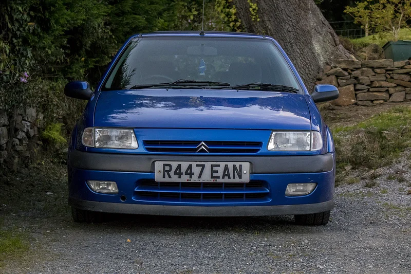

So I decided to stray away from boosting the 182, a lot of thought went into it and various comments/advice from other members, I looked at it from other points of view. My main thought was that it's my daily (other than a works van) so if it turned into a problem/money pit, I'm stuck. After thinking about it long and hard 😂 ... I decided I could have just as much fun with a track car, so I went out to look for one.
That's when I stumbled across this little gem.
1997 Mk1 VTS.
84k genuine miles
Very good condition for the age (bar the odd scratch, it's 18 years old!)
£1100 worth of receipts in the last few months for the following;
head gasket, bolts, cambelt, aux belt, waterpump, coolant pump, thermostat+housing and gasket, starter motor, coolant itself, brand new axle -40mm, new discs/pads all around, spark plugs, pollen filter, oil filter and oil, top mounts, Bilstein B8's, tie rods, 50mm springs (s**t, s**t springs), drop links etc etc.
Overall plans for this are fast road/track use. The standard exhaust is killing me, I'm 100% asbo and need noise, which is good because I've just bought a Saxsport 10 minutes ago so next week shall be some progress already!

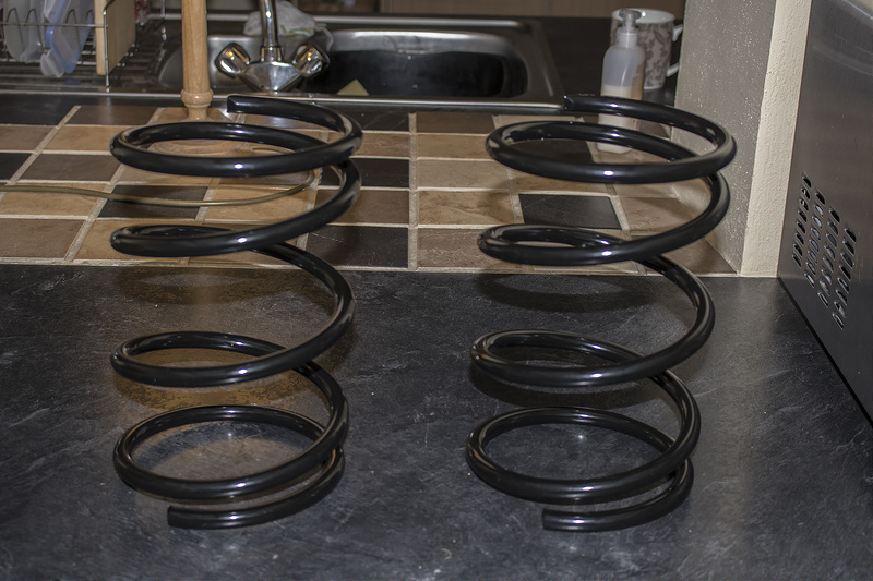

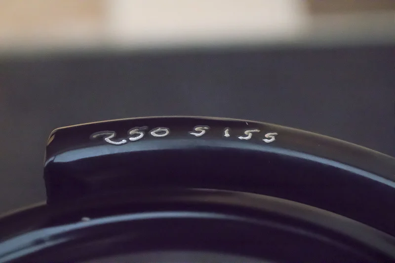

Currently had the car just over two weeks, and I've already spent about £350 on her!
I've stranded away from GAZ coilovers atm, as I'm currently sat on Bilstein B8's at the front, which go very well with a set of Faulkner 155lb springs. Currently because it's on 50mm shitty springs, I think the shocks/springs are bottoming out over bumps, as the shocks are firm, but springs have plenty of freedom. Hopefully the Faulkners should stiffen up the front more.

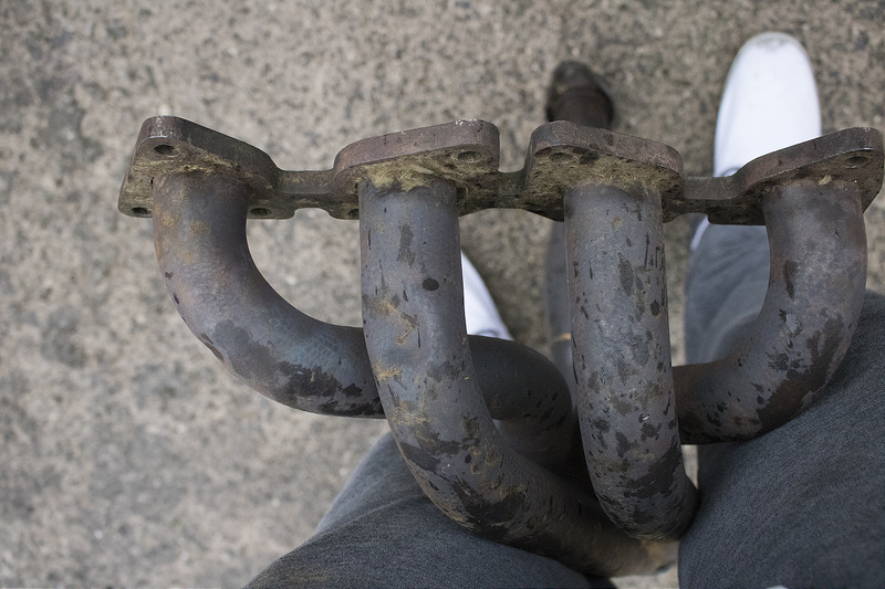

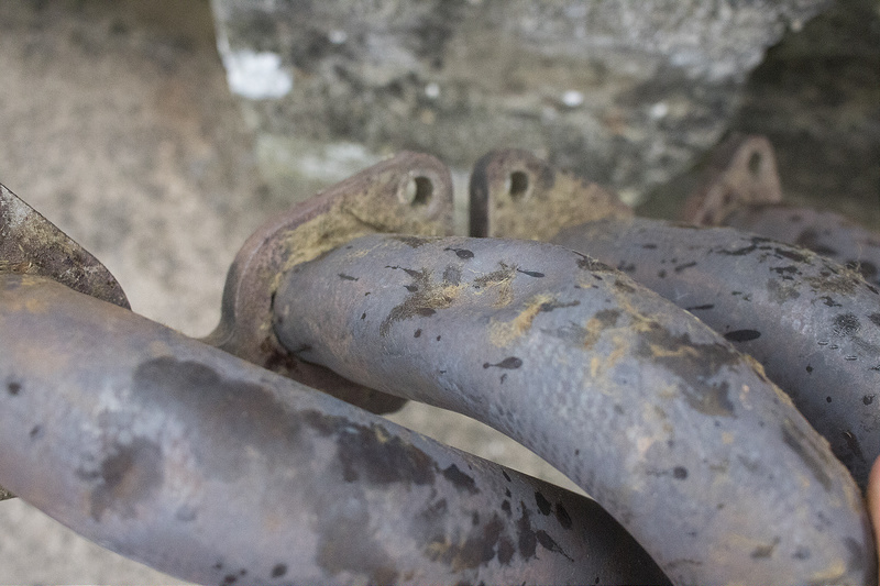

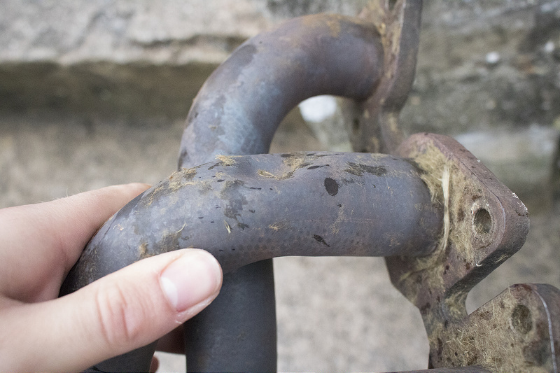

So my SuperSprint 4-2-1 manifold arrived yesterday, and I noticed it appeared to have a dent in it. So today I whipped of the appalling heatwrap that the seller claimed to have cost £60 for...and looky here, what do I see!
The seller said nothing about this, I questioned him about any dents/blows/welding done to it etc and failed to mention this. It shouldn't effect the car in anyway, but it would've been nice to know before hand.

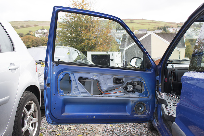

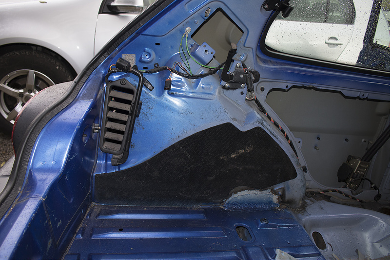

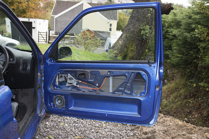

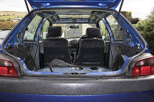

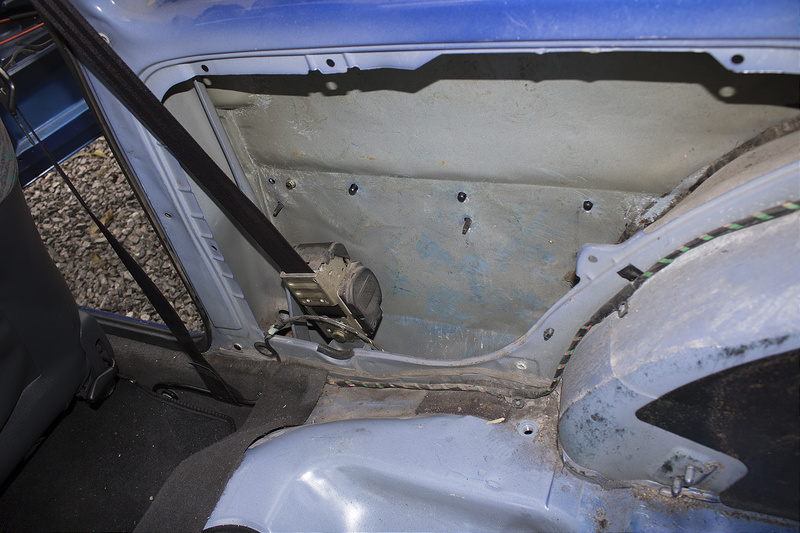

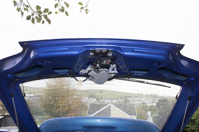

Cracked on with more stripping/weight saving to pass the time, a fair bit has been removed now and I'm getting to the tricky bits.
She's still here! Works van has taken it's place as a daily currently, but if the weather holds off later she'll be given a few heavy feeted moments.
Next is to tackle the exhaust issue again and chase up some wiring. Parcel shelf light, door tweeters, interior light all to be chased back and removed at some point, for the time being they're just taped up together.
  Skoda Fabia VRS
I bet two burley lads could lift it up. Must be light as a feather now! They aren't exactly heavy to start with!
You're probably right! Kerb weight they're 930kg iirc with the spare wheel. With that taken into account, mines got to be around 890kg with all things removed and lighter items (exhaust, manifold is considerably lighter!).

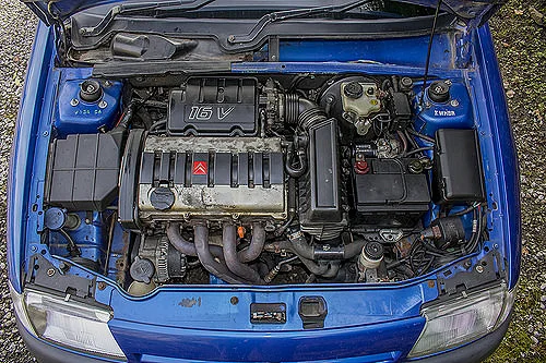

Got the SuperSprint manifold fitted last night with the help of a good mate, no problems what so ever! I couldn't believe it! All that's left now is to sort out the backbox issue, which according to a mate who works in longlife can be sorted by flaring the exhaust? I presume that's like flaring the arches as such, just opening connection a bit more? Correct me if I'm wrong haha. Once the exhaust is all working spot on I'll get some exhaust videos, for now it just blows a lot, like most girls in Bridgend.

Why not have that dent removed from the mani..?
Would be simple enough to get taken out there tbh.
  Skoda Fabia VRS
I don't trust myself with cable ties, let alone other tools! I just wanted to get it fitted for a trial run tbh, it'll more than likely be coming back off in a few months to be wrapped properly/use a DA to bring it back to originalISH condition.

So after looking into it, I may have found out why my exhaust doesn't quite fit together. The id of the Centre section is 50mm, the id of the backbox is 40mm. Every single Supersprint (that model) has an id of 50mm, so this one can't be a SuperSprint, or is one made for the vtr/furio oem exhaust. Bit of a ballache, but a friend is selling a Kam racing backbox, that WILL connect to my SuperSprint centre section. It's a 2+1/4" rolled tip, and actually looks quite nice in the recess of the bumper.
  Skoda Fabia VRS

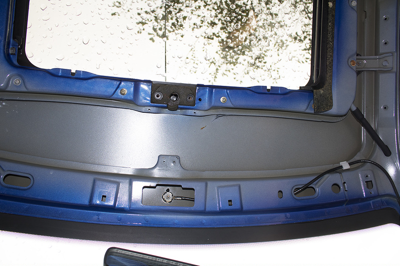

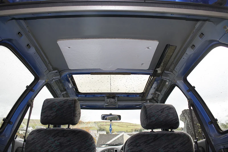

Exhaust sorted (bodged...ahem, for now. Wrapped the backbox with heatwrap to build the diameter up enough for the clamp to grasp it, seems alright for now. Sunroof has also been sealed up (presuming it's the correct place) courtesy of the Father. Will be taking this to a 'cruise' in Cwmbran tonight, because it's loud, obnoxious, and so am I.
