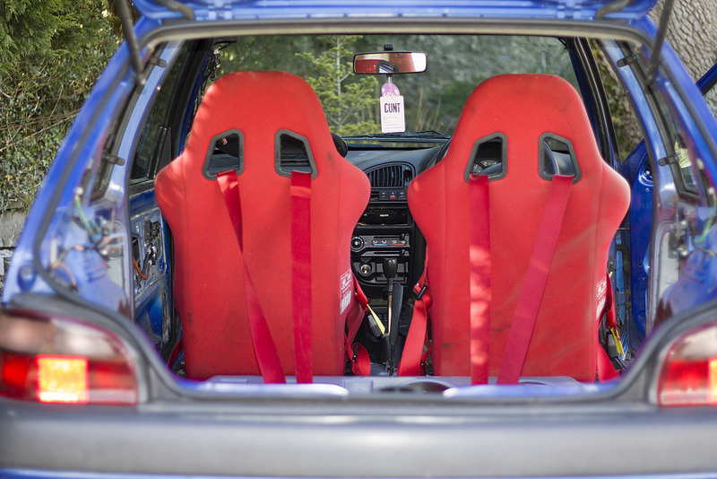

It looked cool and old skool until you fitted the gashy Morettes. Other than that it's mint. I'd have not bought red seats either.
I've already gone off the Morettes if I'm honest...
Seats were ridiculously cheap and came with subframes and side mounts, considering it's a budget track build they fit the purpose spot on.

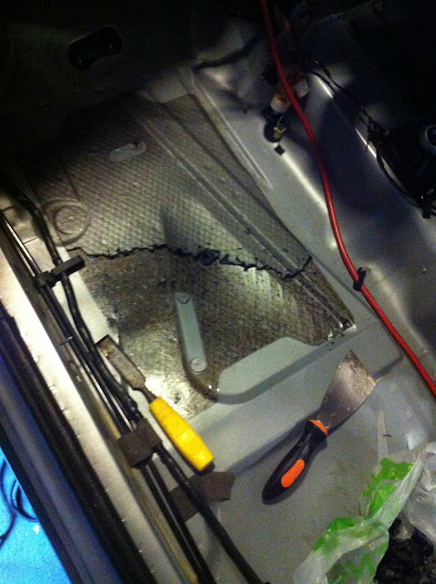

Have you removed the fire mat behind the pedals? goes all the way along the back of the dash - weighs a good 20kg and an easy weight loss/power solution.

I haven't actually, but I didn't realise it possessed that sort of weight? That's mad gains to be made with that loss, I'll look into it on the weekend mate.

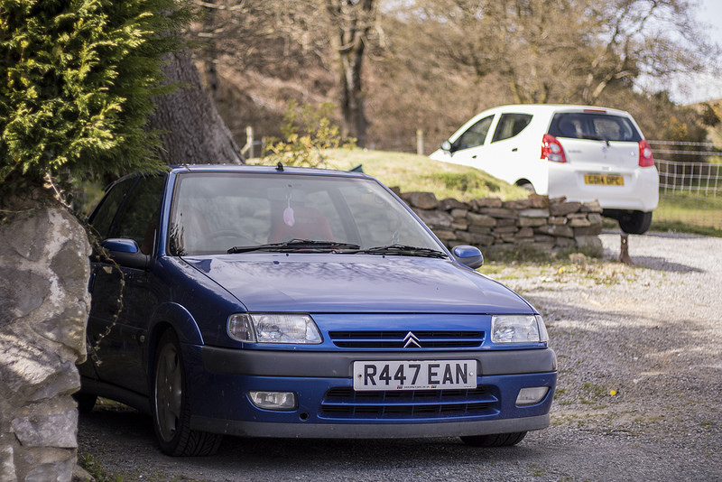

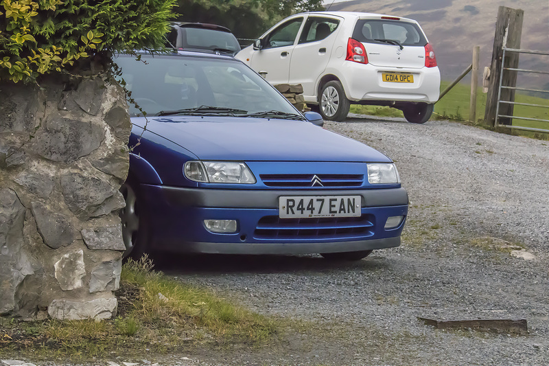

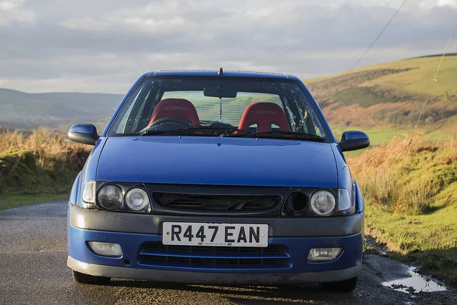

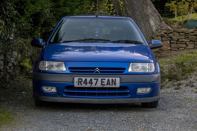

Now looks like every other ruined saxo lol
Fair enough your car but oem for me they look their best
I'm going to be changing back to standard with the lights, flickering through the two pictures I have to agree, original looks much better. I still love how aggressive the front end looks with the Morettes, but it just doesn't feel right.

Yes it is crazy heavy that matting, if you don' t dare remove the dash, just start chopping as much out with a stanley blade. Weigh it on the kitchen scales.
Get a heat gun on the tar in the footwells (1.5kg a side if i recall)

Cheers buddy, I don't fancy taking the dash out so I'll just do as you said, try and pick away at most of it with a blade. I'll have a crack at more weight saving on the weekend then, plenty of bits to tackle. Really need to crack on with removing/trimming excess wires back, so far I've just chased them up and bundled them together lol.

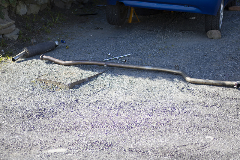

So my balljoints, and front Wishbone bushes have arrived and they'll be fitted shortly. In the meantime, I had a little mishap with my exhaust.
Basically since I've had the sytem, I had bodged the centre section and backbox together due to a slight difference in diameters. The centre Id was 60mm, the backbox ID was 50mm (they're both Supersprint, and know one quite knows why they aren't alike, unless the backbox is sooooper old). I wrapped the join with manifold wrap, which worked for a while... Last night I hit a bump and it just came loose, resulting in many loud tractor noises from the centre section 😂
Aaaaanyway...
Drove her home and got the old system off this afternoon ready for the Saxsport to be fitted tomorrow, literally cannot wait.
Just need to pickup a new downpipe-decat gasket tomorrow morning at the local motor factors and she'll be sorted, then hopefully have a mate press the new balljoints in and fit the polybushes in the afternoon!

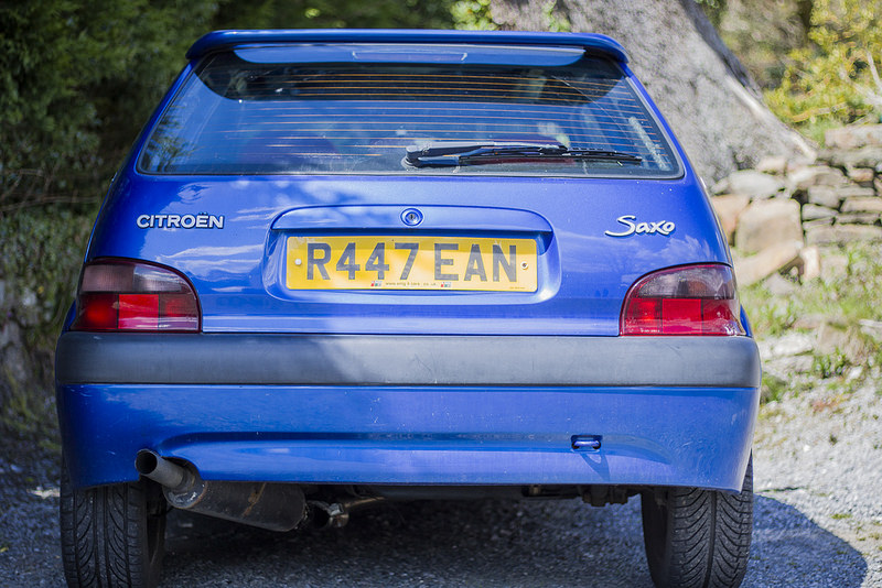

I ripped the old system off as seen above to make way for the Saxsport on Wednesday and got fitting straight away. Overall, I'm dead happy with the change. The Supersprint was f**king loud, obnoxious, and caused my ears to bleed after a 5 minute drive. The Saxsport has a middle silencer, and larger backbox so it's a lot quieter inside the car. This will also be beneficial for future track days, as the Saxsport is plenty below the decibel limit for most tracks, where as the Supersprint was close to the limit.
The polybushes and balljoints will be fitted next week via a mates garage, I've learned my lesson previously, get balljoints properly pressed in, lol.

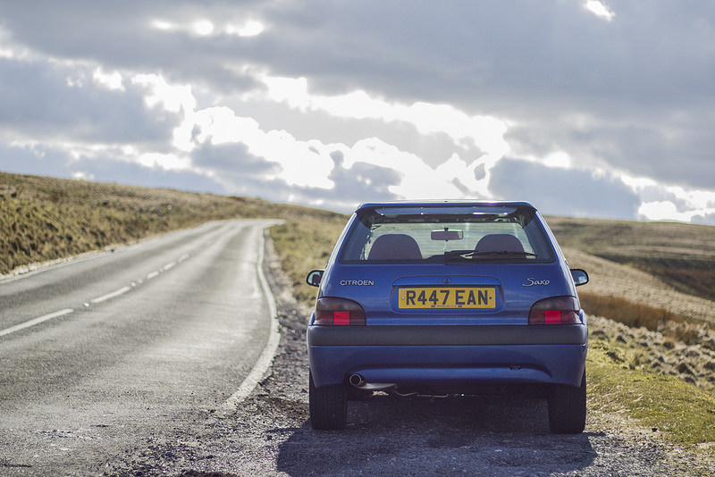

Went for a drive up some phenomenal roads which are about 20 minutes from my house and grabbed some pictures, along with a quick Exhaust video to sort of give a feel of what she sounds like now. Watch the video until the end, LOL.
