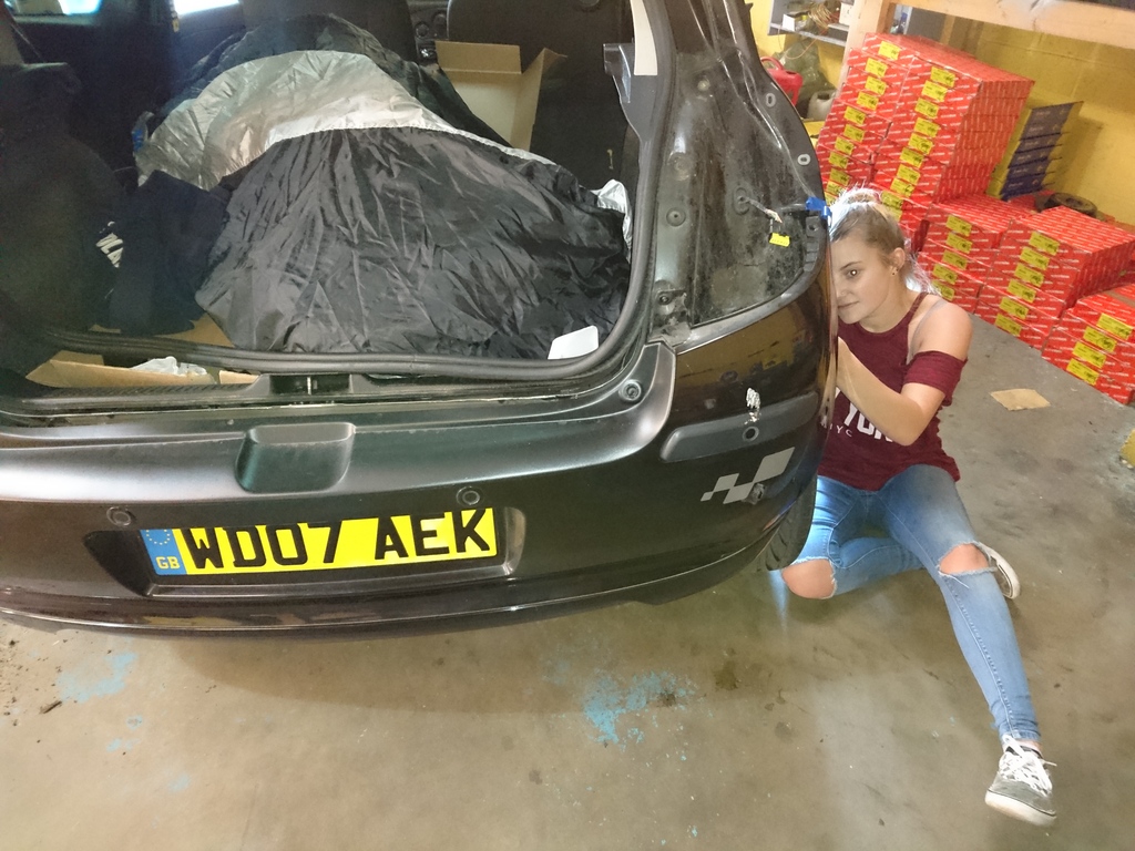

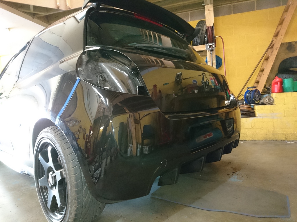

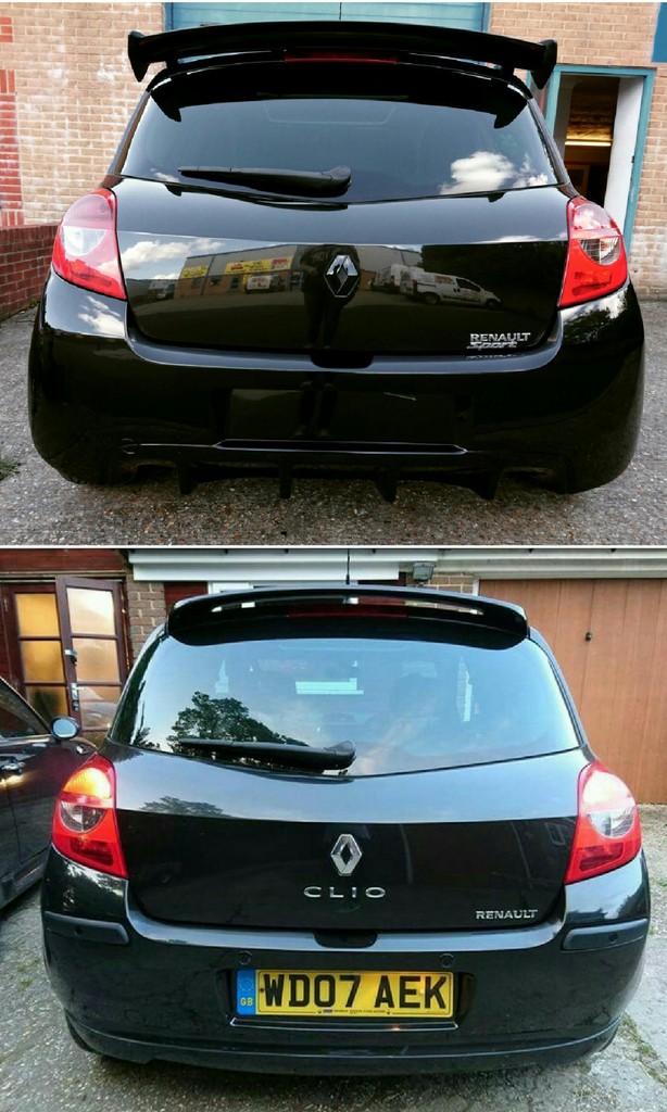

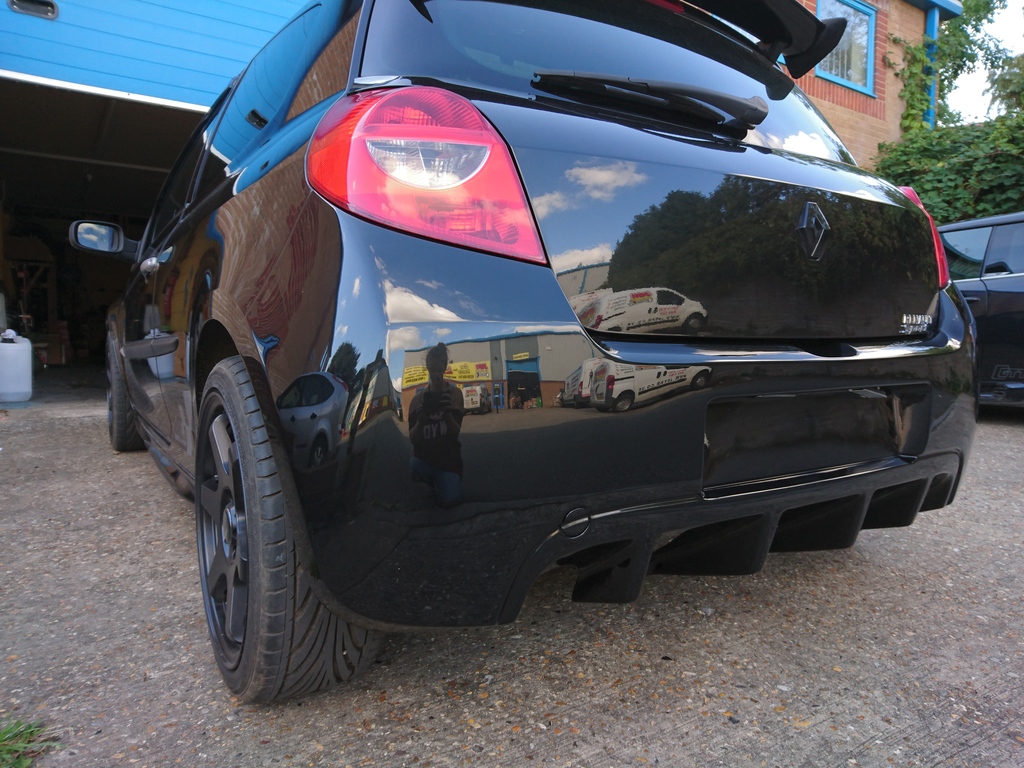

So....this happened today...

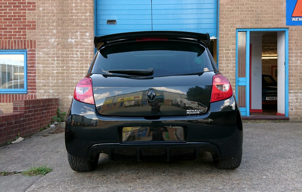

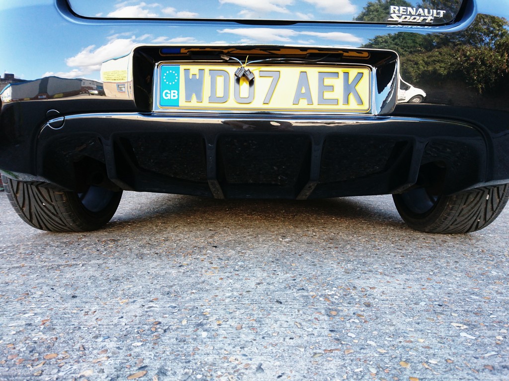

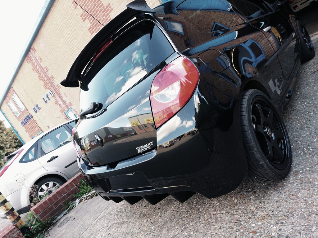

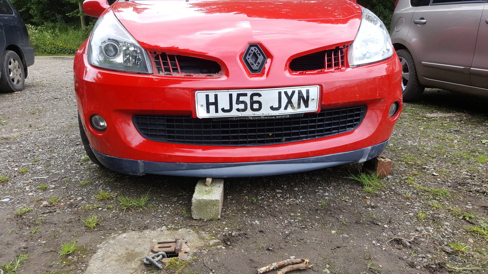

Started by taking the old bumper off...Few modifications needed to be done to the car and the new bumper. But fitted well. Very happy with the end result and colour match :smiley:
When you say a few modifications are needed what do you mean, I will get one as long as it's kinda easy haha
Does it just Clip on or does it need screws here's there and everywhere
  Clio Mk3 tce
I had to cut a plastic part from my car to allow it to fit underneath. Nothing that was useful. You have to drill your own holes for screws etc. And cut out the holes for number plate lights. Been driving around today like I normally do and it's on fine. No movement.
Also you will need to jack up the rear of your car. Makes it much easier getting into the wheel arches as there are a couple of screes to undo in there.
Recommend getting a Haynes manual. Info can be found in there. Or just searching around online.
I am very pleased with mine :)

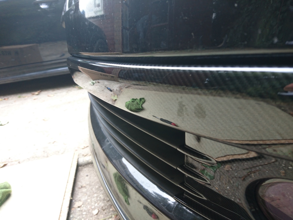

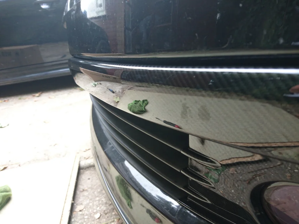

Thank you. Out of curiosity, I'm wandering if the Jasse splitter fits your car? Thought the 197 was wider at the front compared to my dynamique?
And the stuke winglets that I have were easy to fit. Just a couple of screws drilled into my car. Simple :)

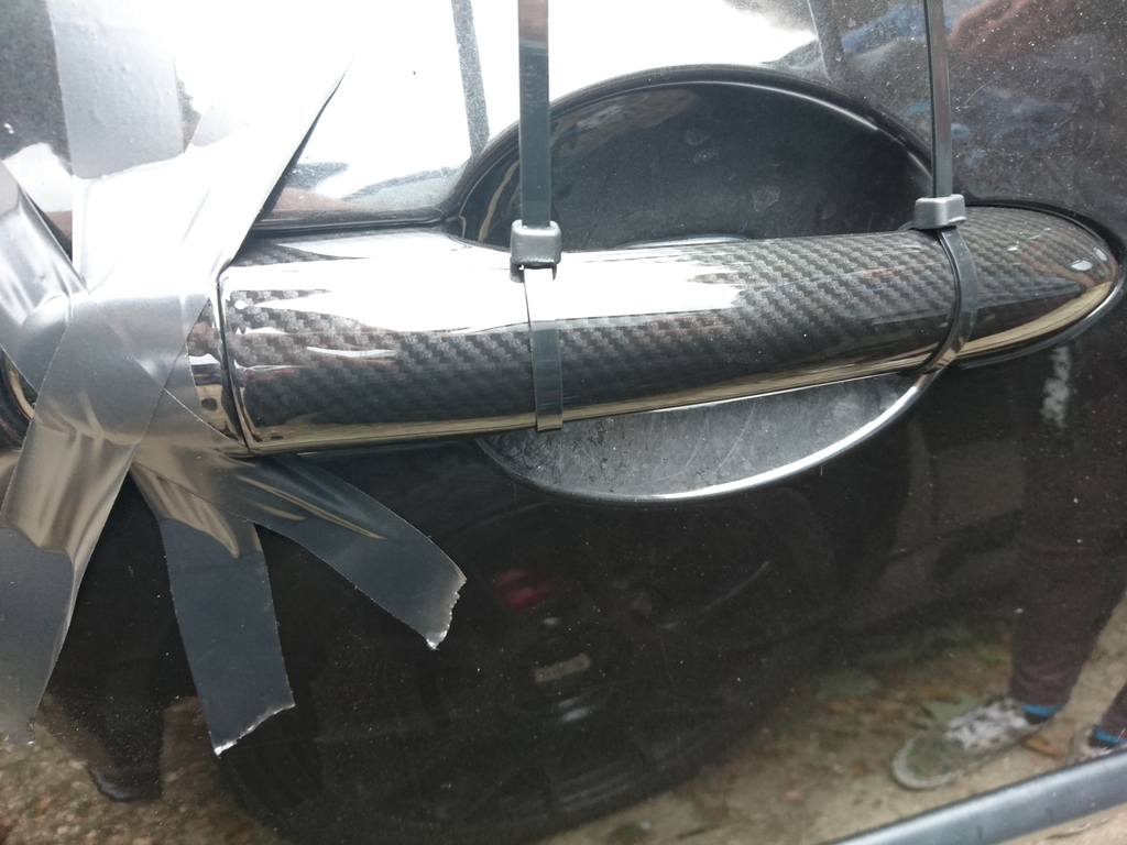

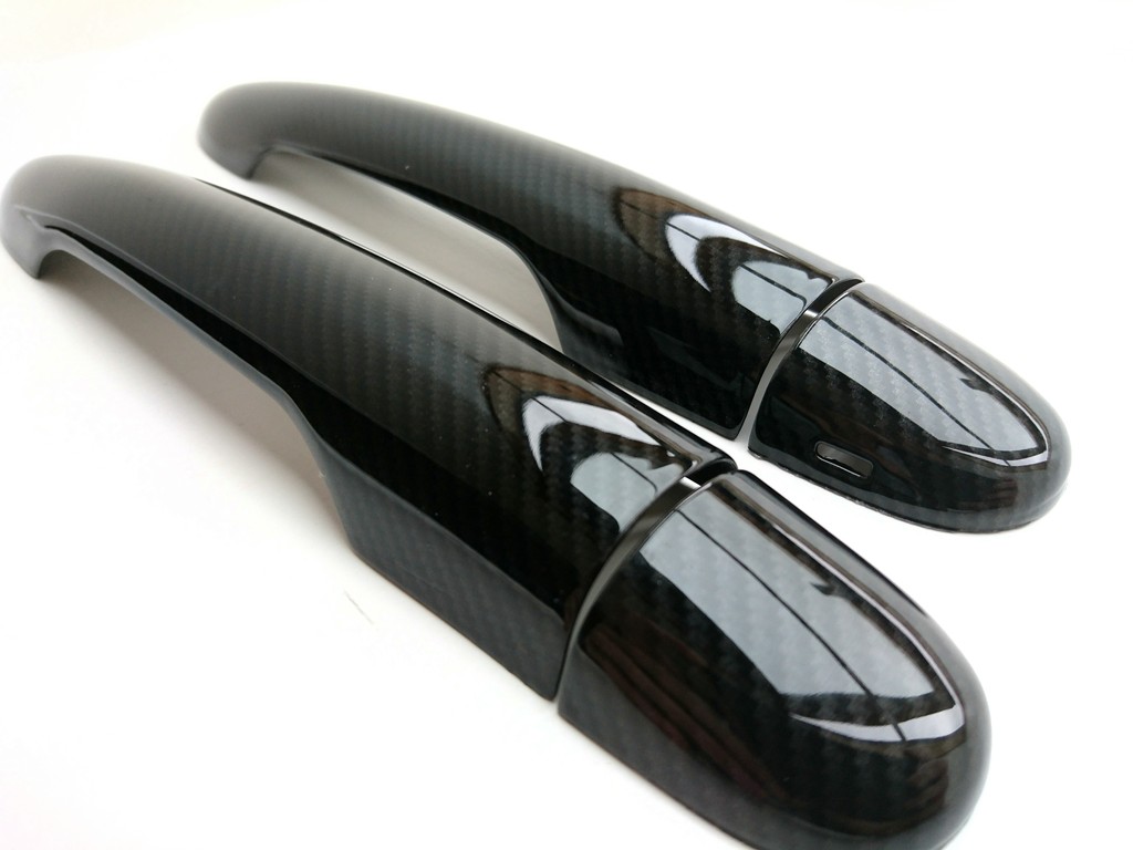

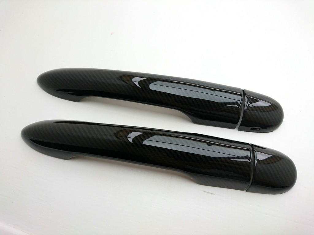

I brought the door handles on online, they were silvers. I got them hydrodippped.

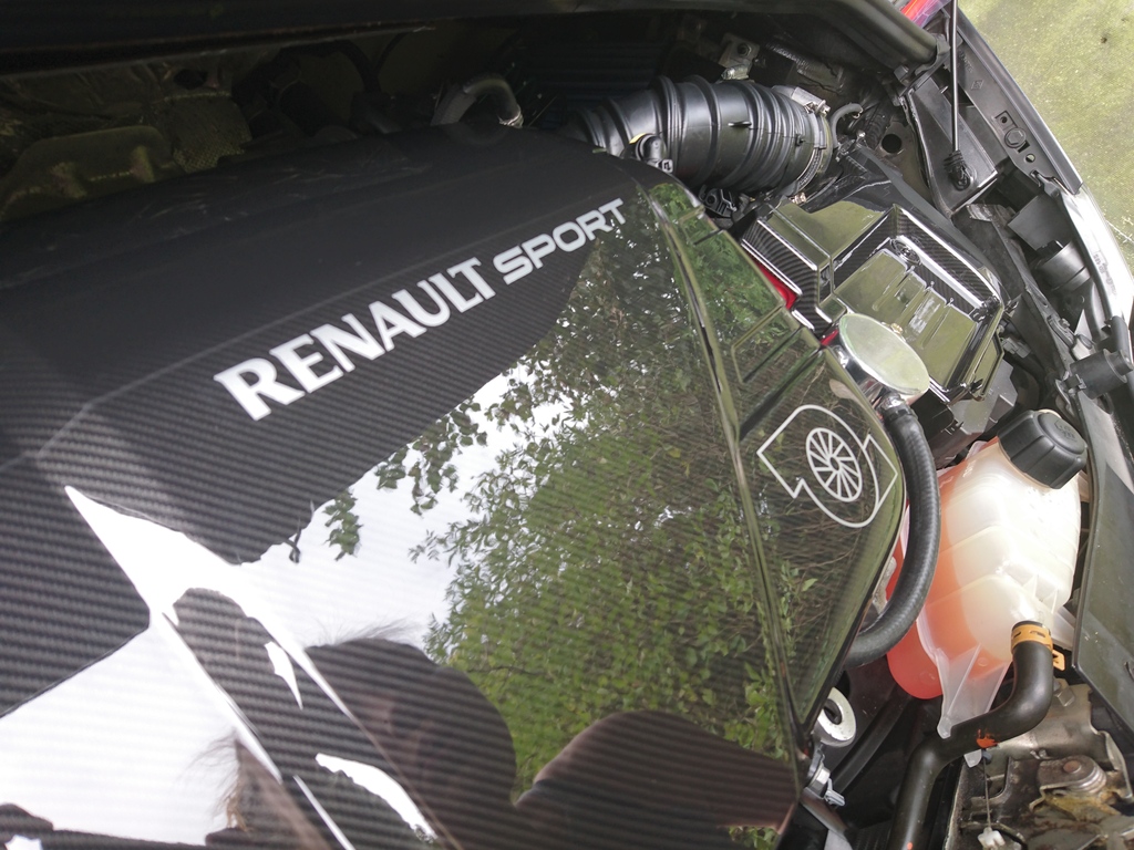

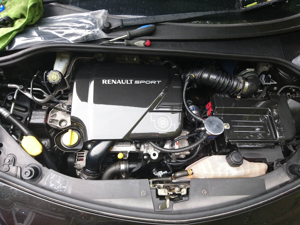

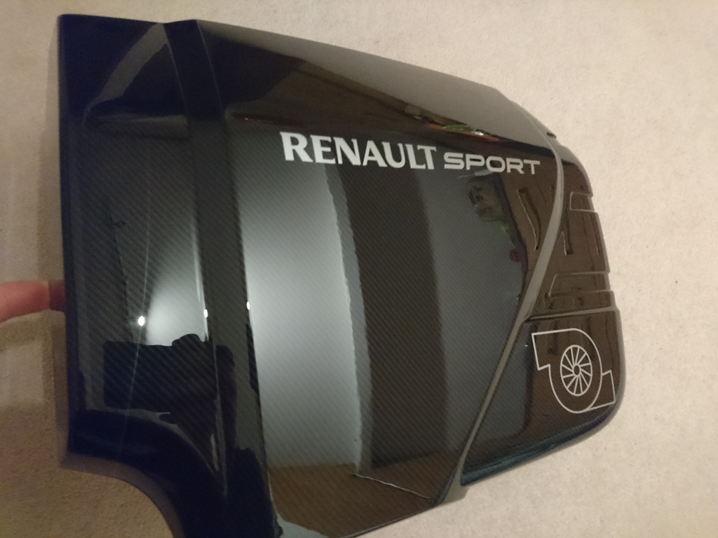

Added some stickers to the engine cover... :)

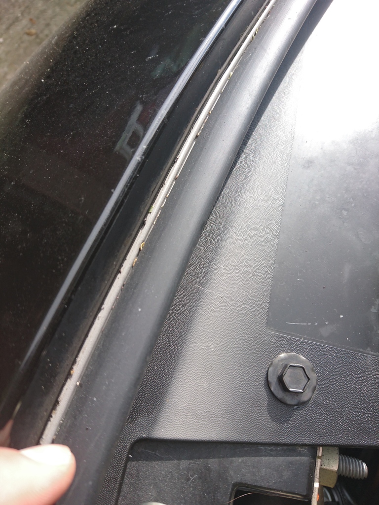

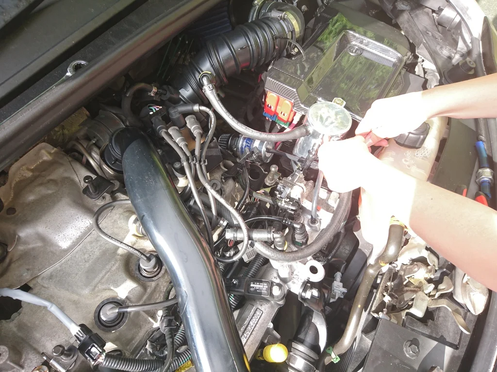

Before I did anything else I put a seal across the bonnet to help stop anymore grime and dirt getting in...

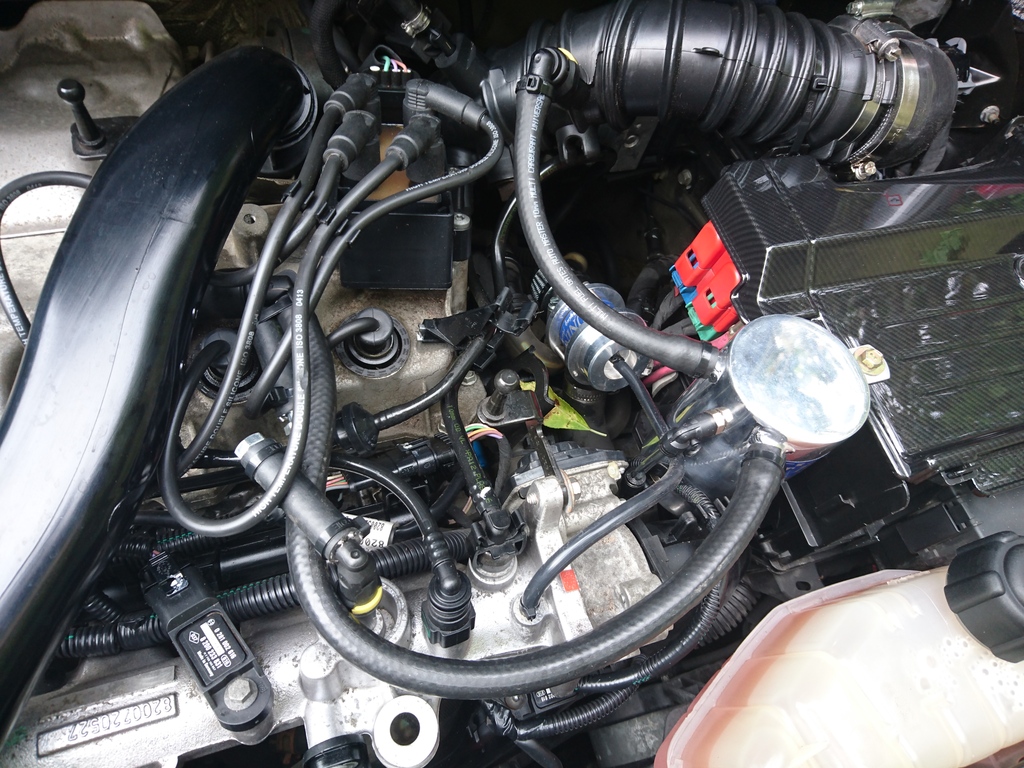

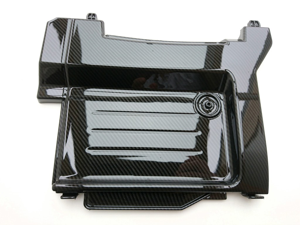

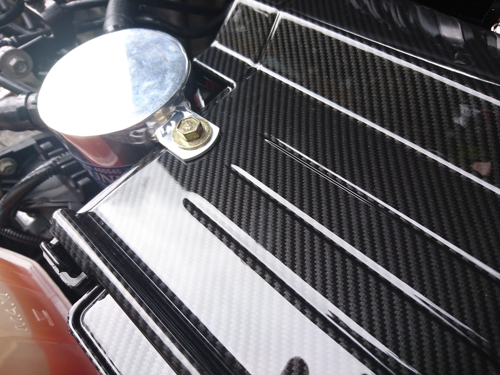

Put my battery cover back on and began to install my oil catch can...

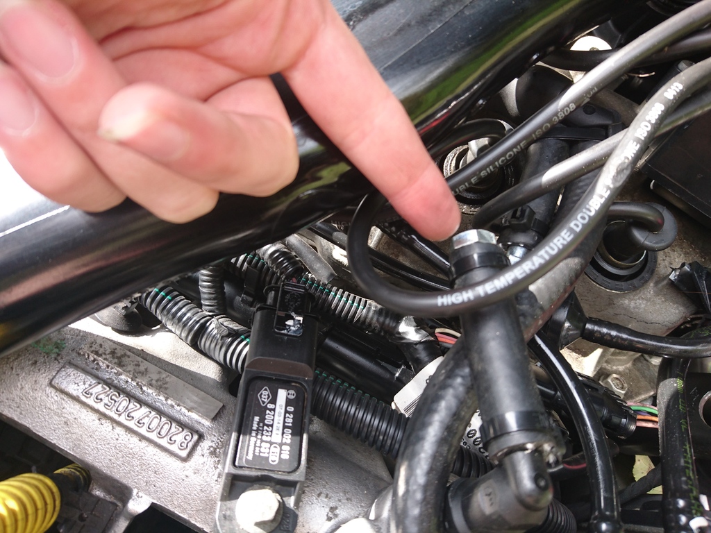

On my engine there is two pcv returns.
One goes to the intake hose. Second goes to the inlet manifold that only operates on vacuum because of a one way valve. But I have removed the valve and blanked off so the oil catch can is collecting from the main return. (intake hose circuit) and it doesn't cause any idling problems.
Bit of a struggle getting the hoses to fit on the hose tails.
Oil catch can is securely attached to my battery cover...
And the final outcome.

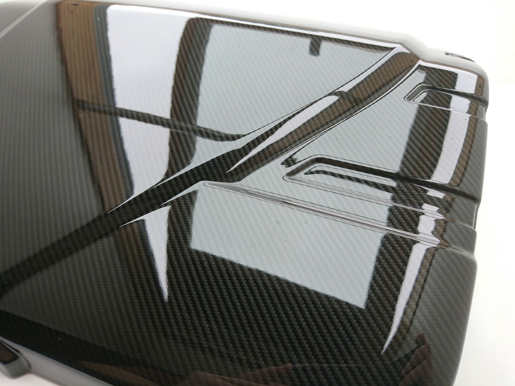

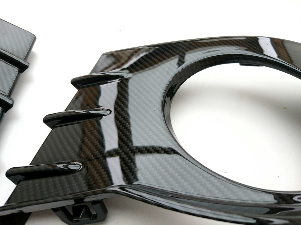

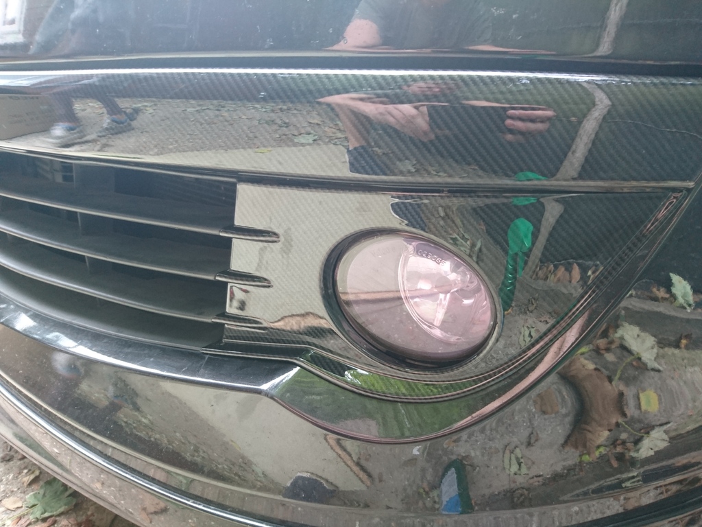

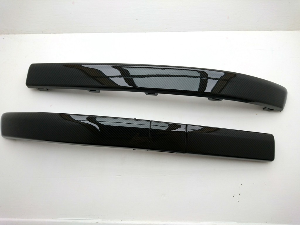

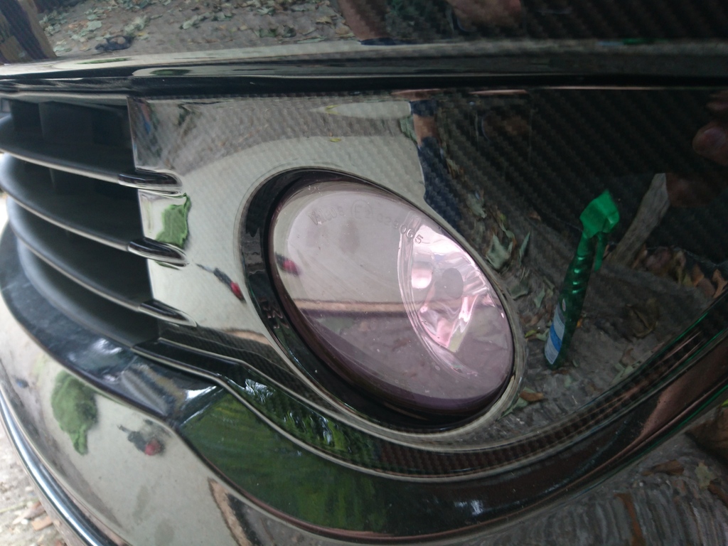

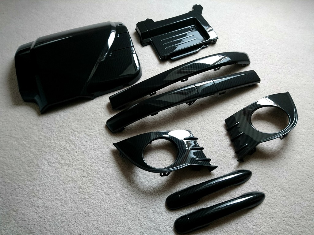

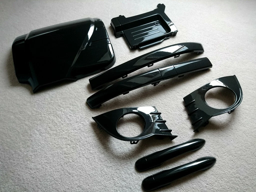

Next was my front mouldings and foglight surrounds. Swapped the old for the new. After a bit of cleaning...
Also fitted my door handle covers using body kit adhesive...they are still setting.
Will post more pics when weathers good. And my car is clean!

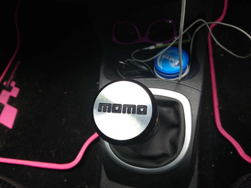

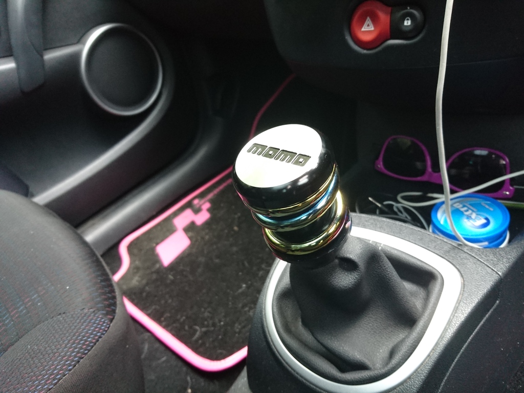

Next came the gear knob...which took the longest to fit.
Momo..as they match my seat belt covers and it's one of my nicknames. Haha :)

how did you find taking off the gear nob, any tools used or used brute force ?
  Clio Mk3 tce
I couldn't do it myself. For this one i got my boyfriend to help. Used brute force and tools. Started twisting with hands and then used tools to pull the little plastic bit from the middle. I've cut mine down as well.
That's the exact answer I didn't wanna hear, just revived me new gear knob haha thanks for your ever supporting help :)
