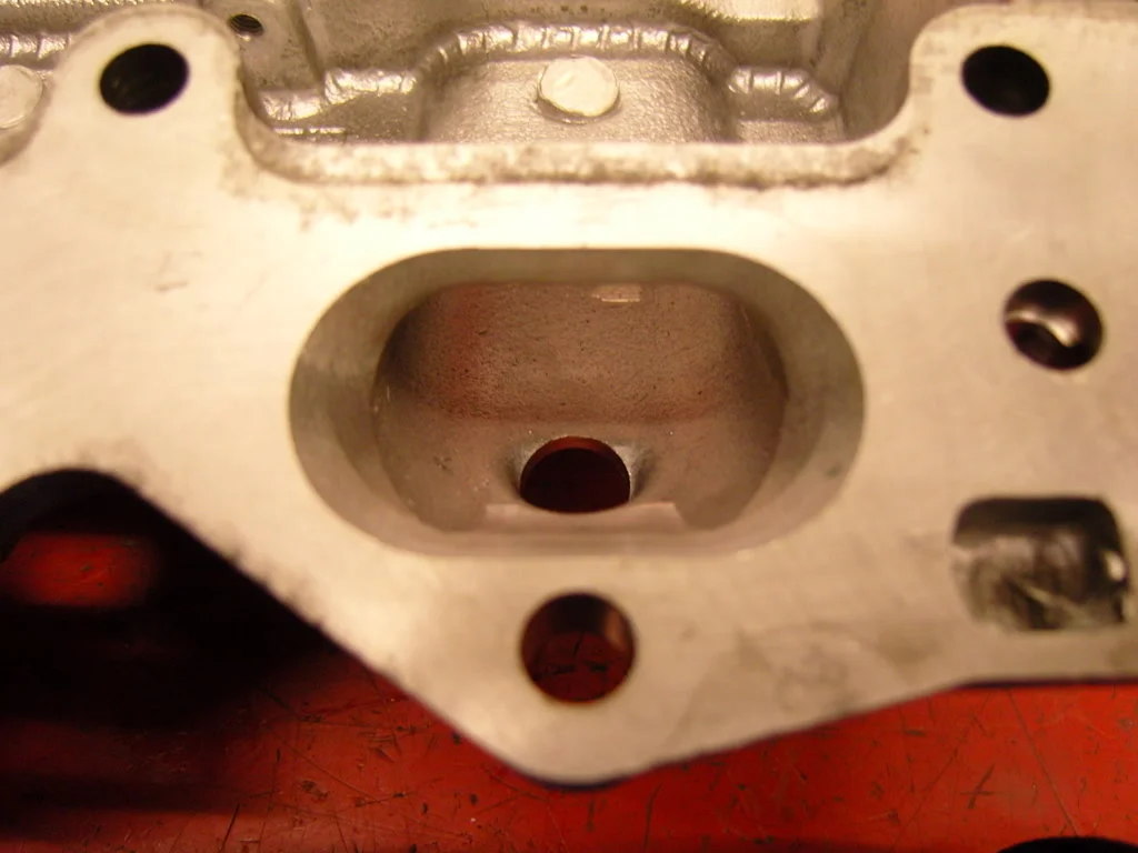

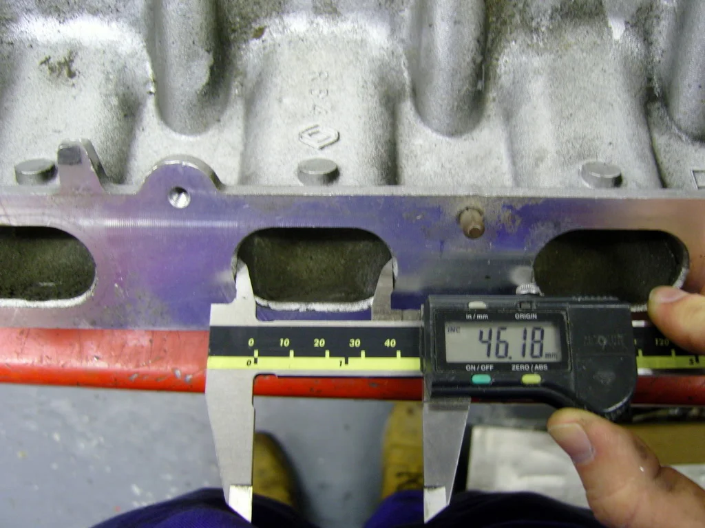

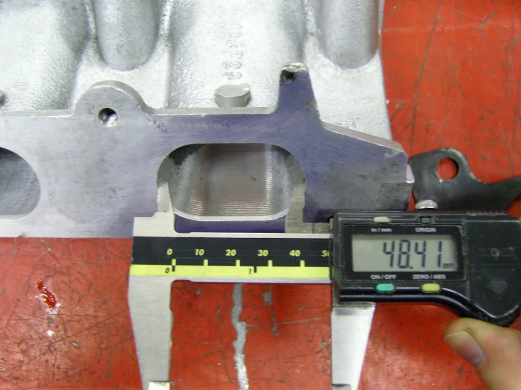

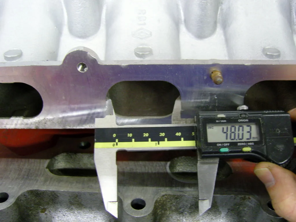

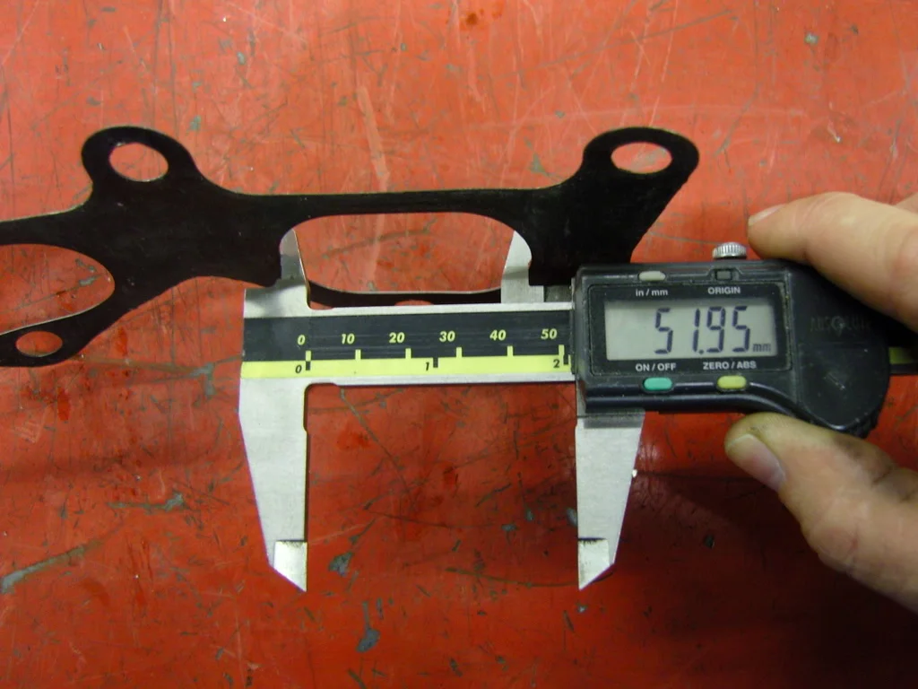

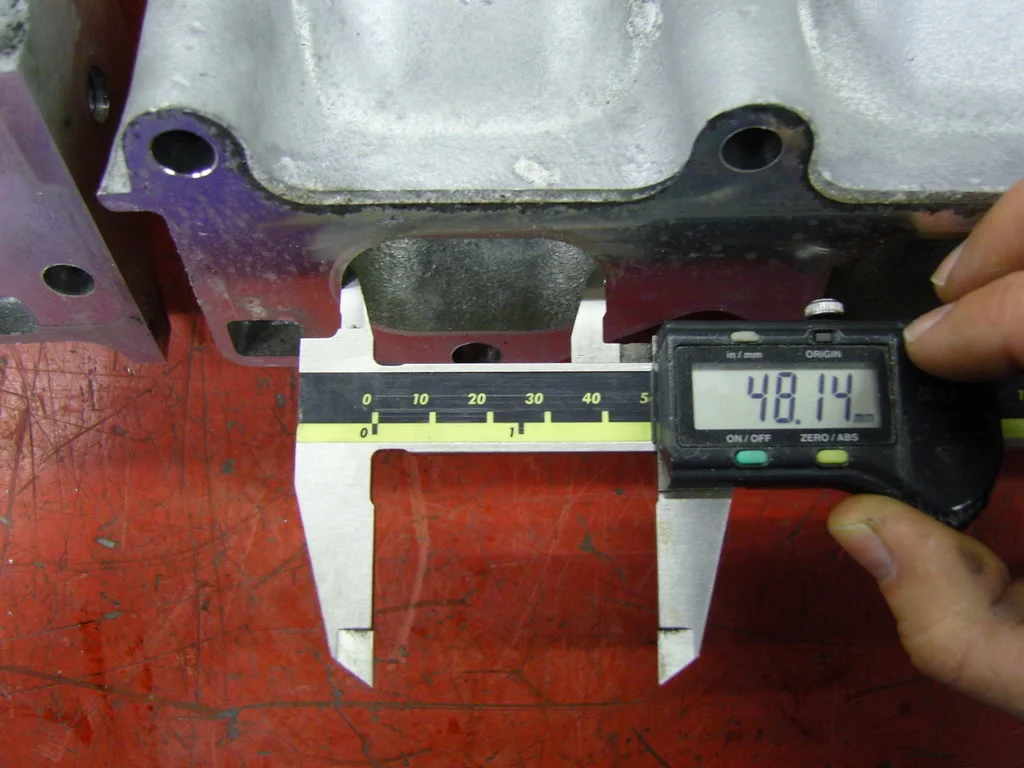

Stock Head face mating flange:
Stock 172 early phs 2
F4R 'RS' component

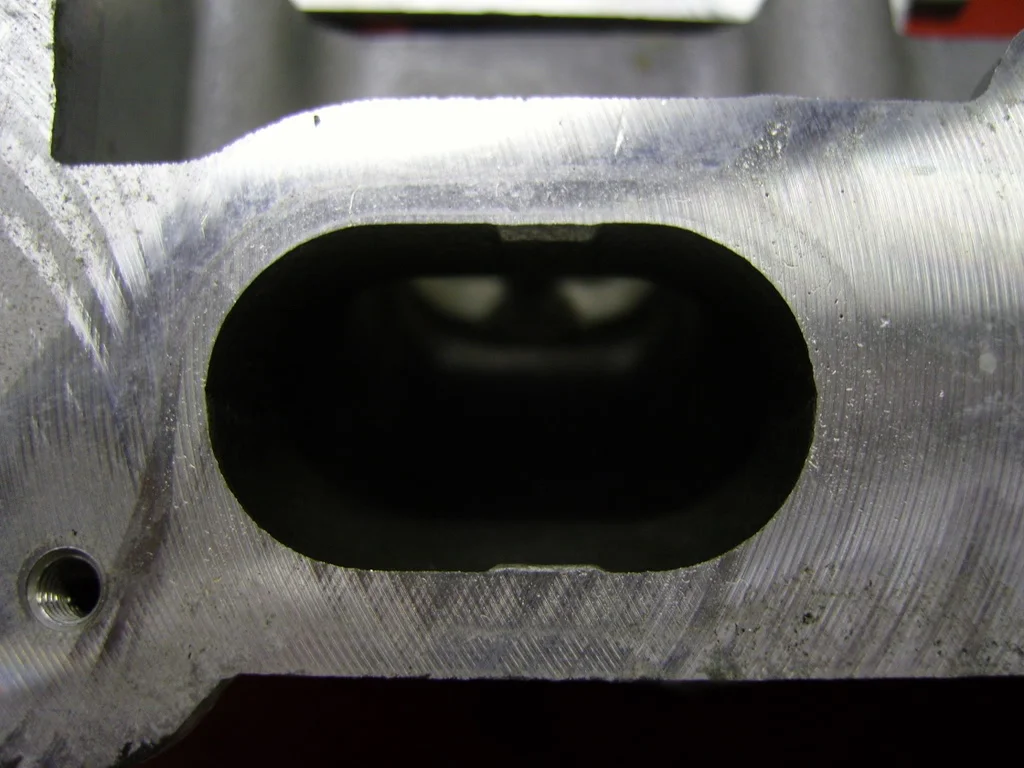

AWT CNC manifold

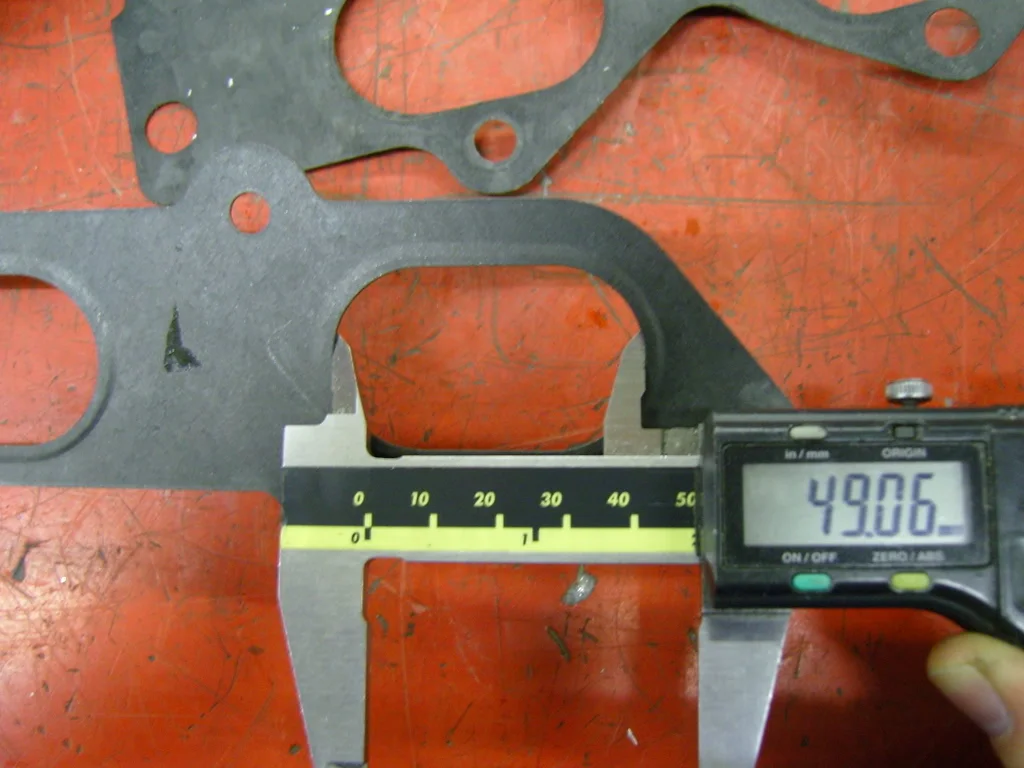

Stock 'crushed' gasket (dimentions as installed)
Actual head
As you can see the dimentions of the finished product match exactly, and still retain a 20 thou (0.5mm) step down as i have always advocated.

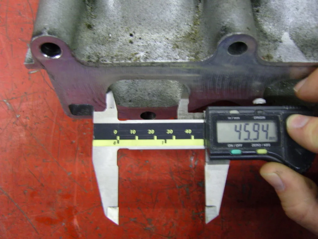

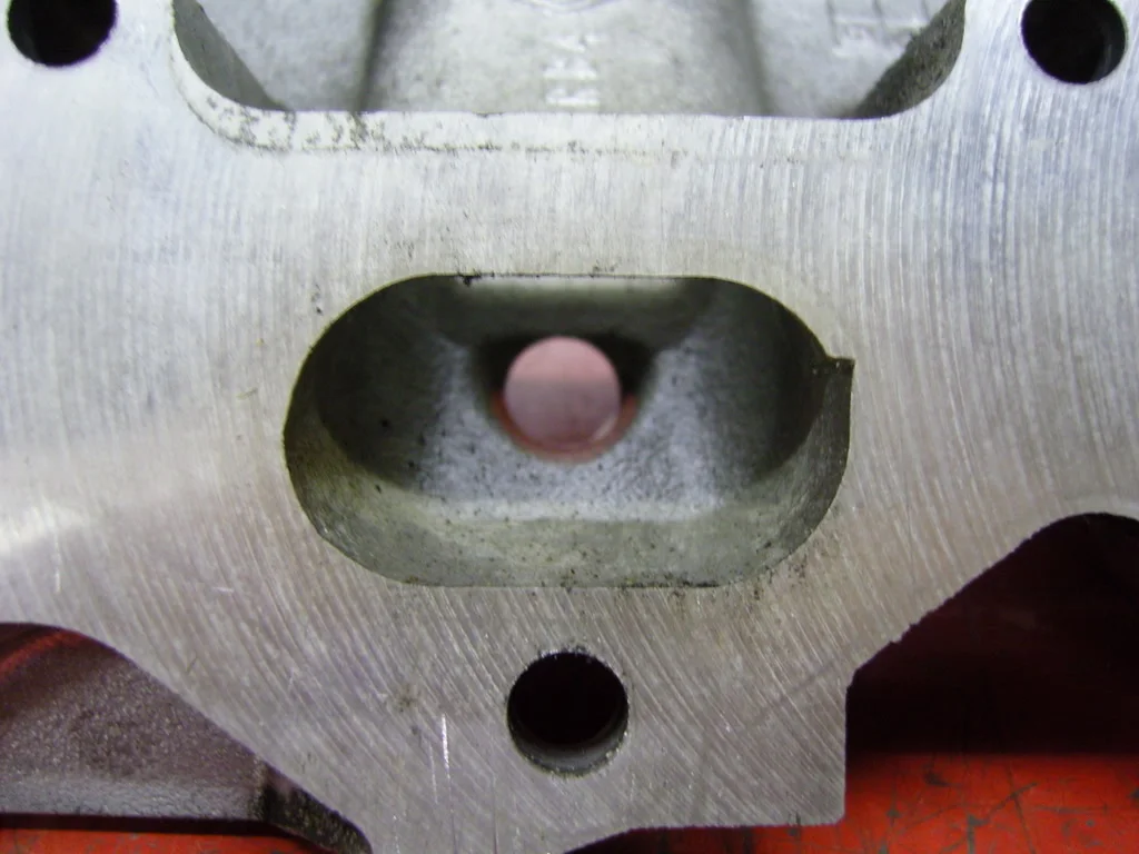

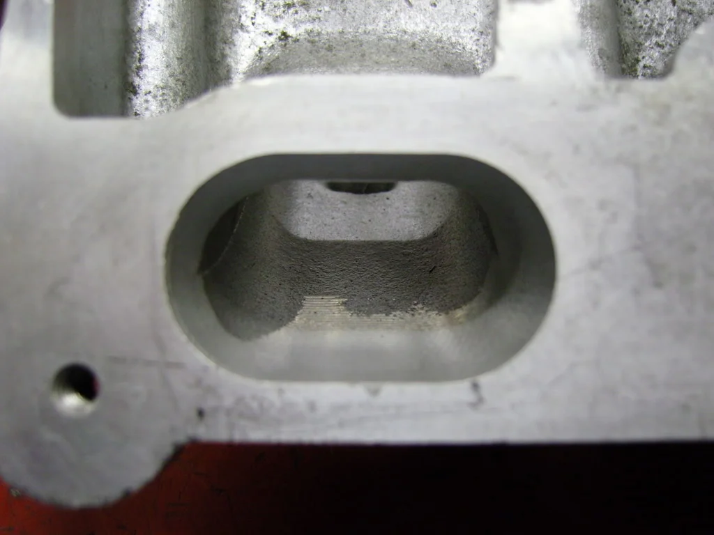

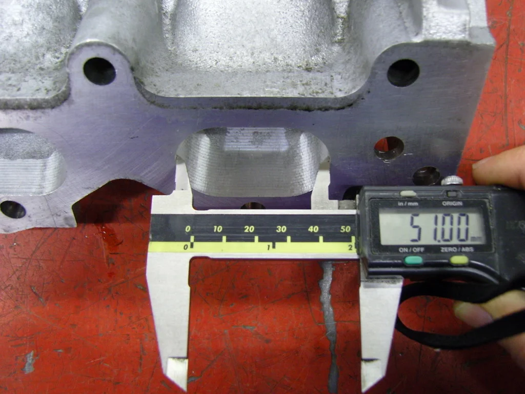

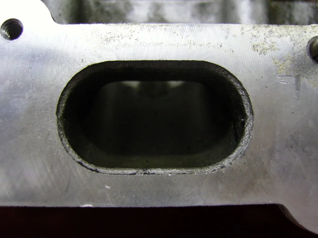

Plenum to manifold flange:
F4R 'RS' component
Notice the bumps, these are present on runners 1 & 4 and are also present on latter 172's and on 182's.

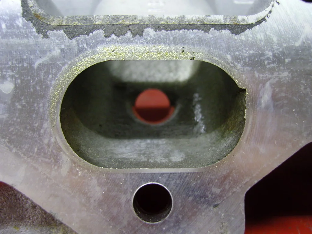

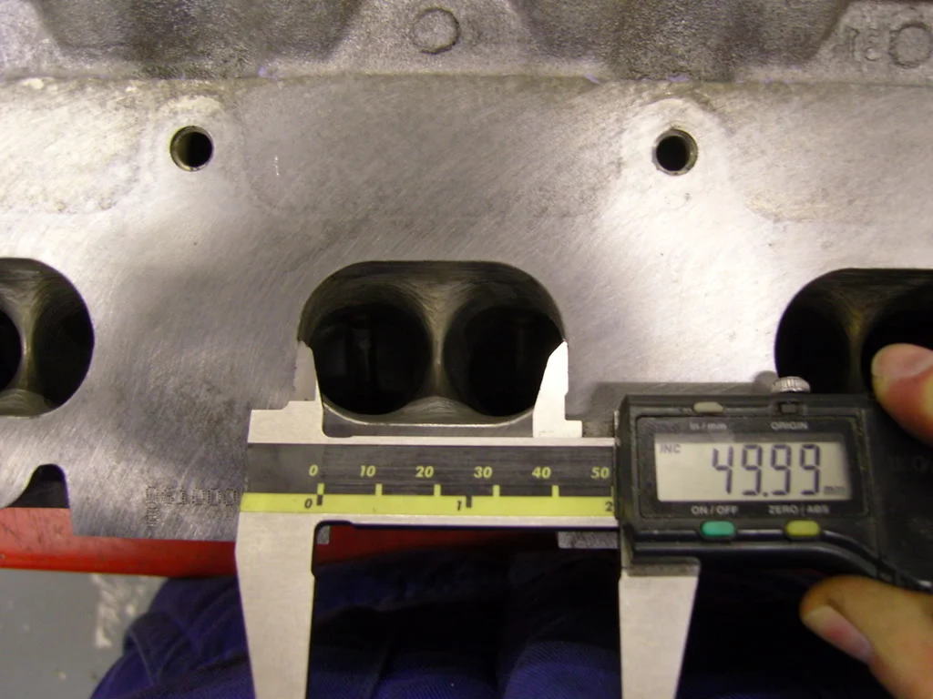

AWT CNC manifold
Stock plenum - manifold gasket
This one is uncrused, but it reduces in cross section by 0.5mm. Plenum/manifold match is perfect as the step down is generated in the plenum.
