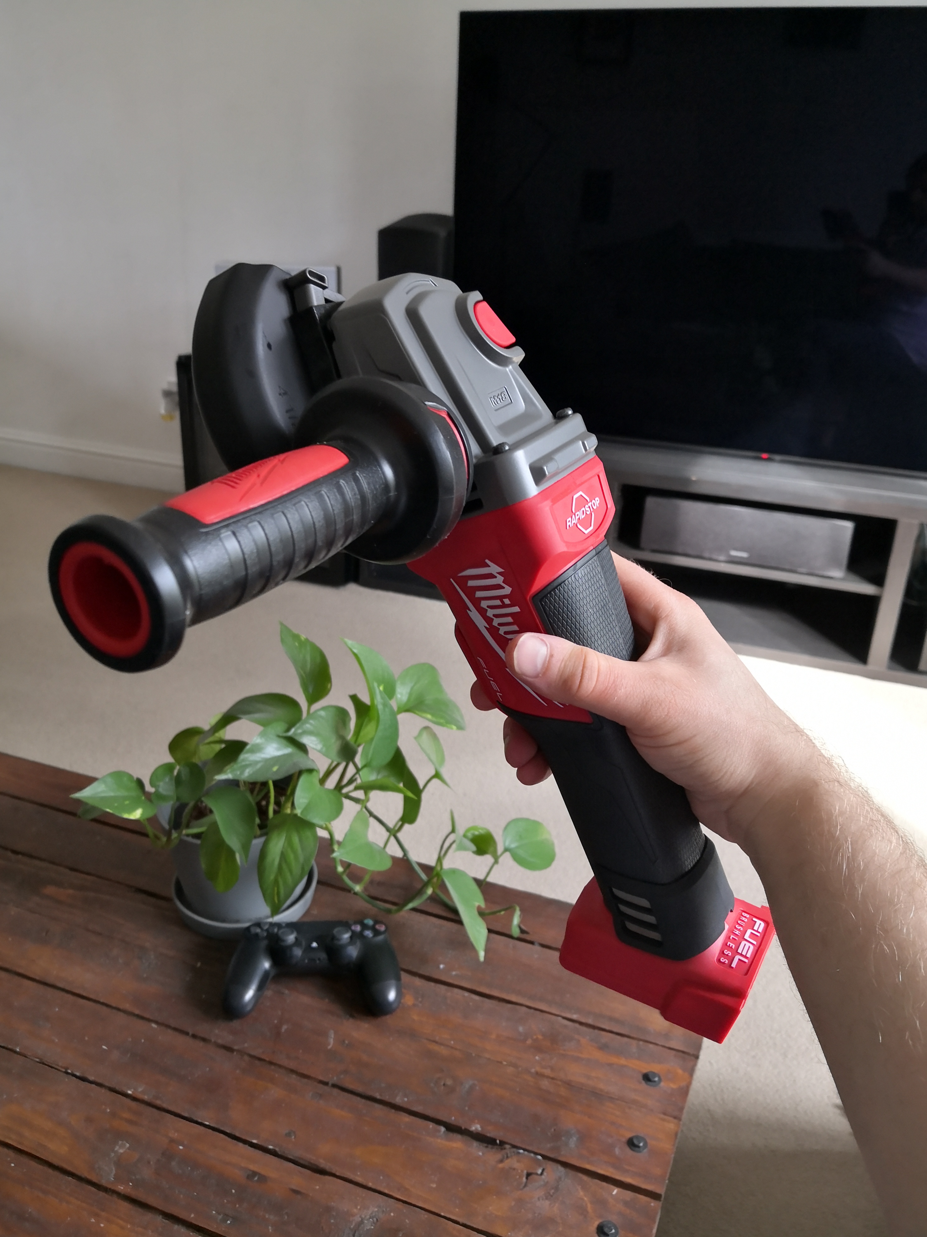

Baby has just turned up. Really decent size and nice and light.

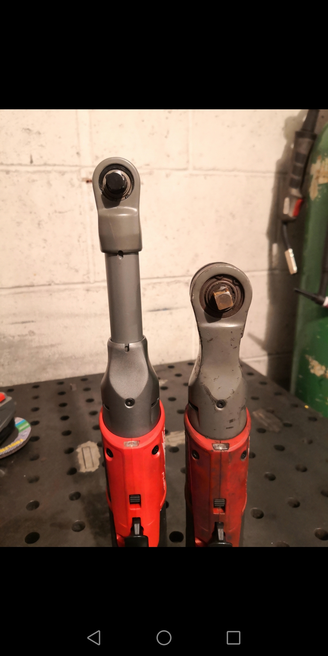

@JamesBryan have you seen the modification you can do the 1/4 extended length ratchet?
Just been having a look and you can swap out the anvil to one from the 3/8 non fuel ratchet so you have the smaller head/thinner profile of the 1/4 but with the attachments for a 3/8
I don't have the extended ratchet so would be nice to have the best of both worlds.
I've seen something like that yeah.
Mine is the 3/8.

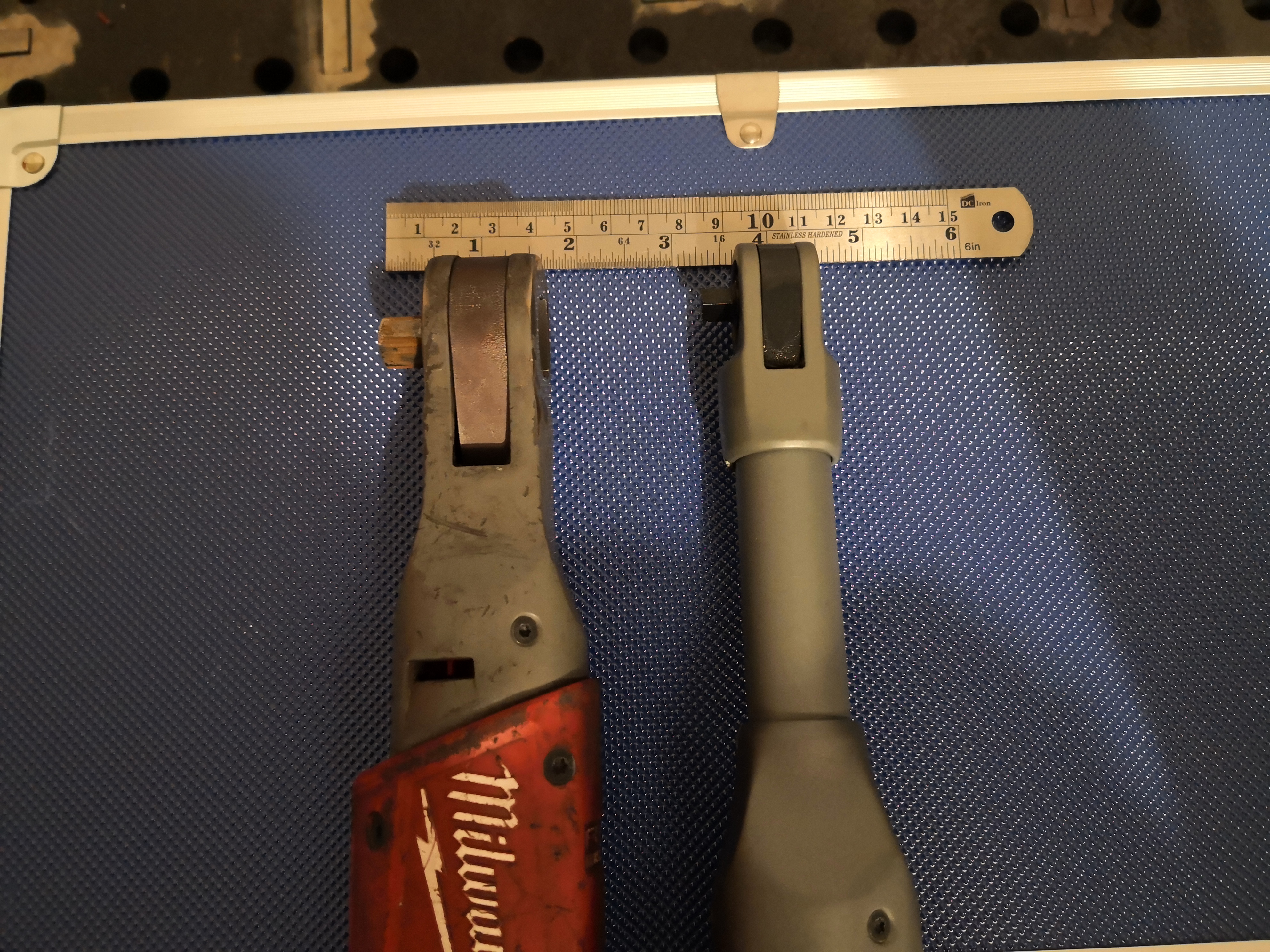

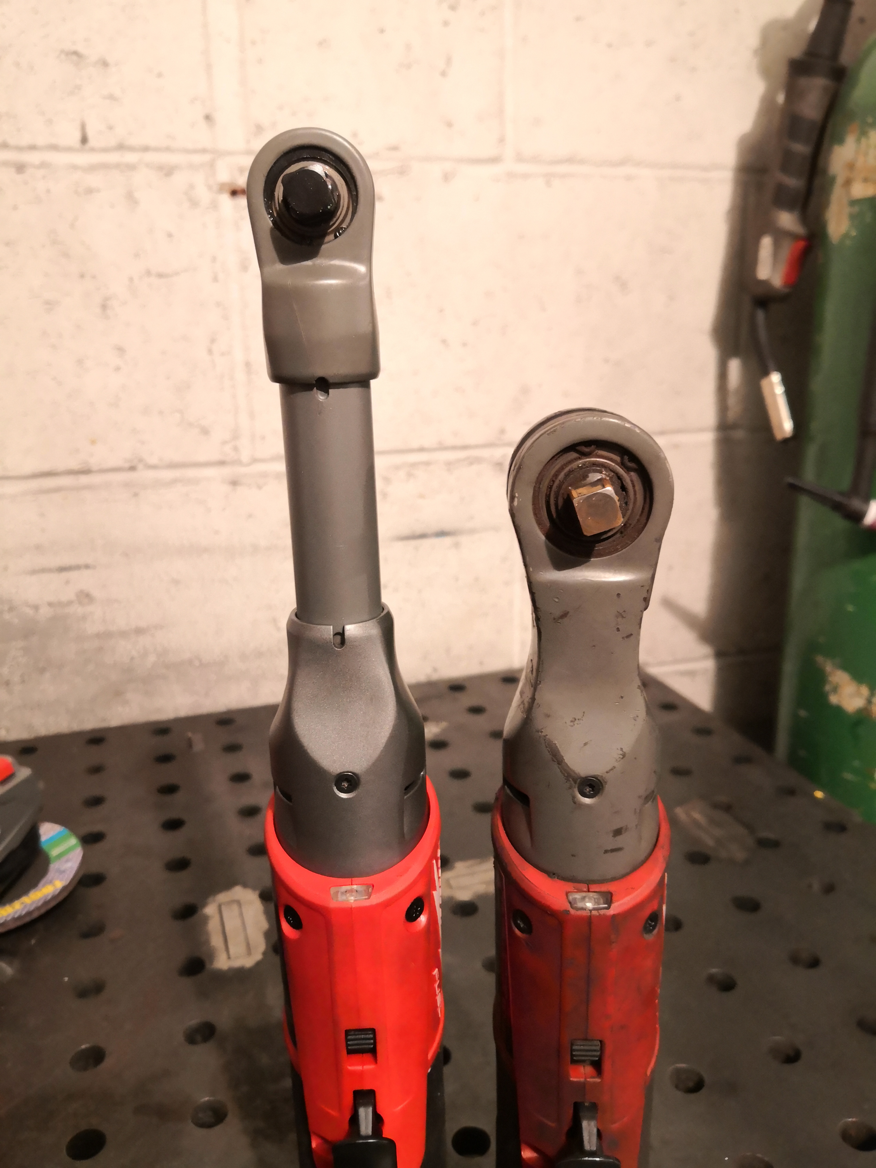

All converted. Used an angle grinder on the anvil to reduce it in length in my haste to sort it but in hind sight I should have just skimmed it in the lathe at work. Doesn't make a difference at all really, as long as it slots in the housing.
Works really well, will definitely come in handy.

Note the 3/8 is more powerful than the 1/4
Make your choice on if you prefer power over access too, as you can do what I did recently and get the lesser power 1/4 unit (54nm) but has a significantly smaller head on it and fit the 3/8 anvil.
Also I recommend going for the extended reach unit as it has exactly the same power as the nonextended reach model in the same anvil size.
Havent used that in anger yet
