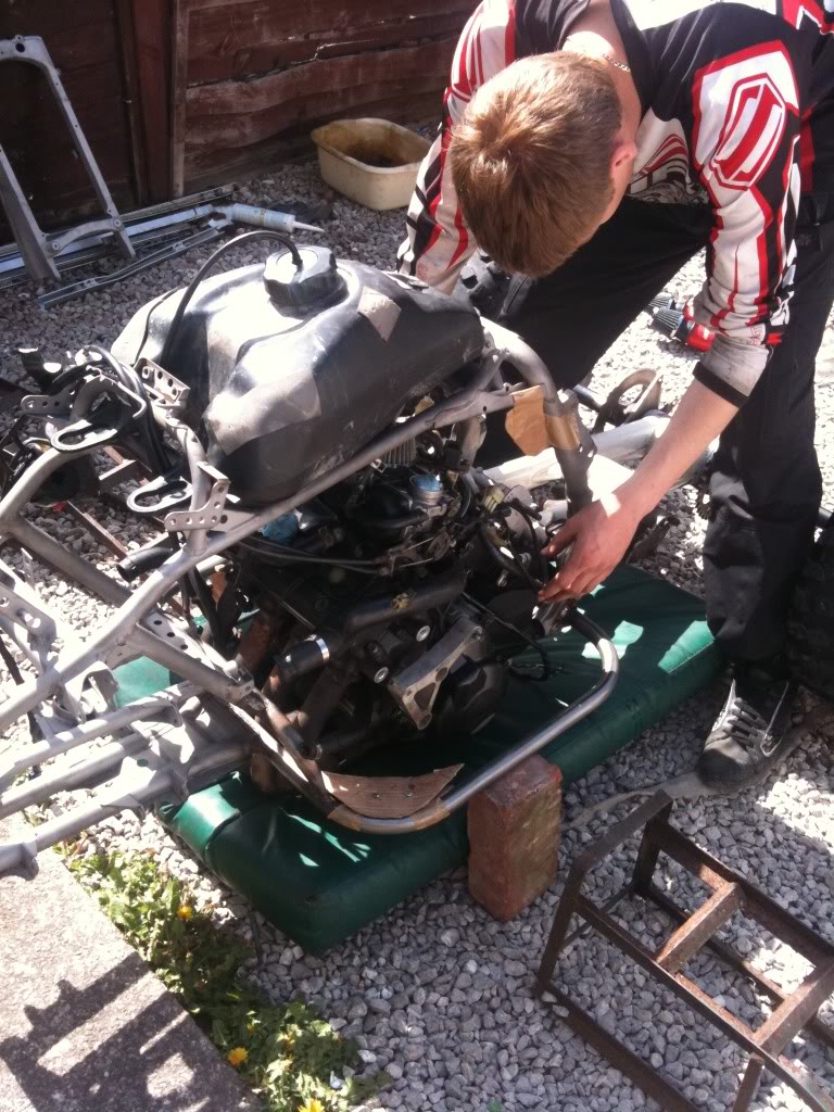

engine out:

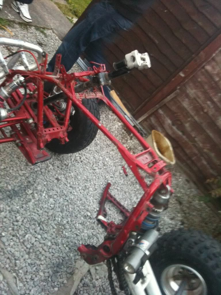

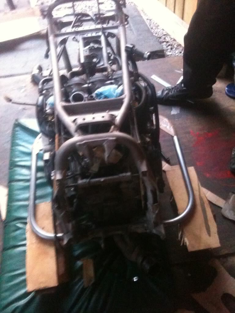

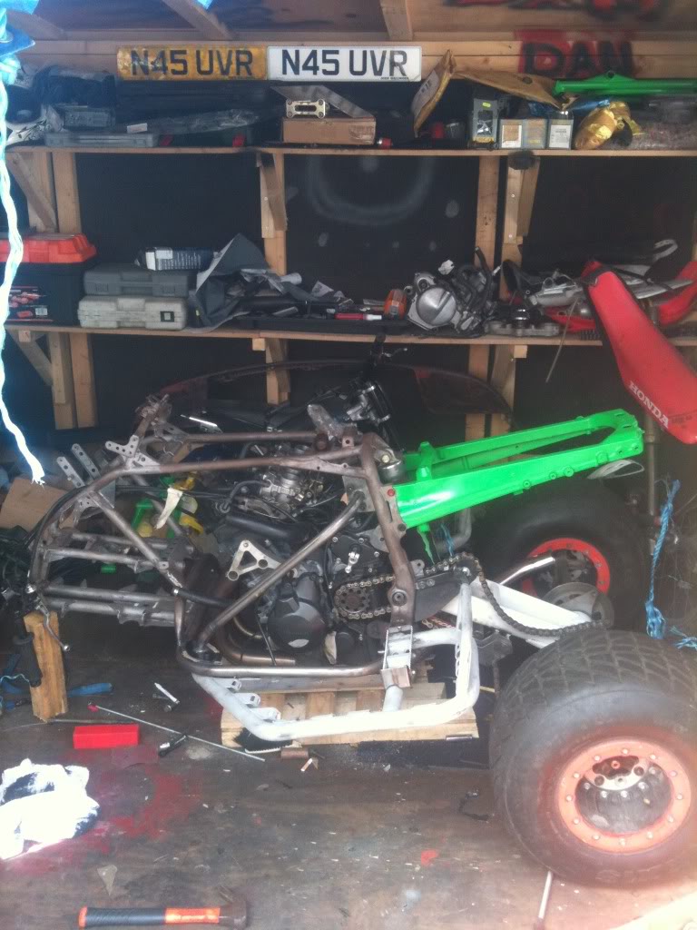

cutting the expensive frame:
the hole:

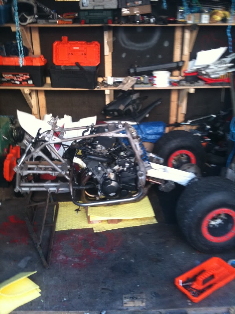

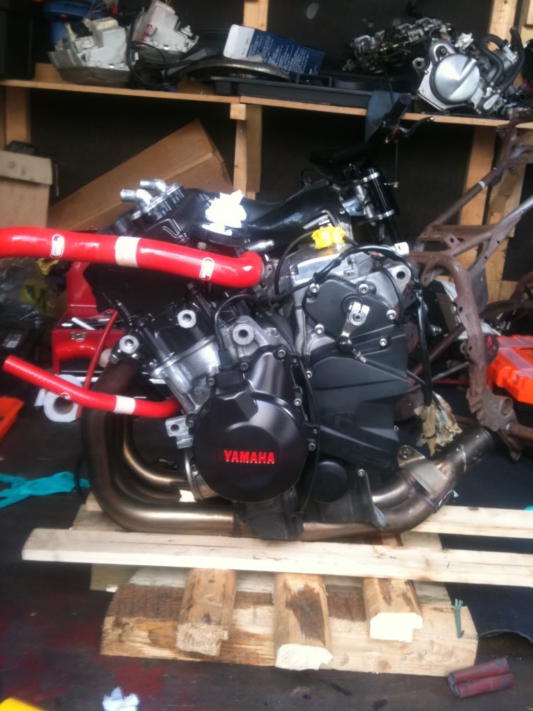

she fits!!:

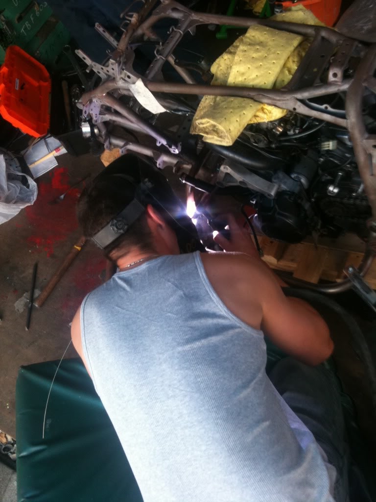

new bits of the frame welded, the welding was shoddy, we got another guy (phill) to weld it again later on:

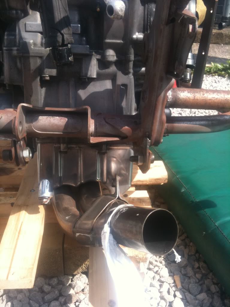

brand new manifold off ebay.........20 squid winner!!:

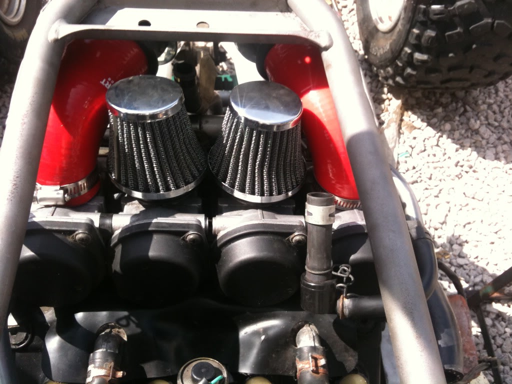

testing the airfilter clearence, we scrapped tghese off as they were too big:

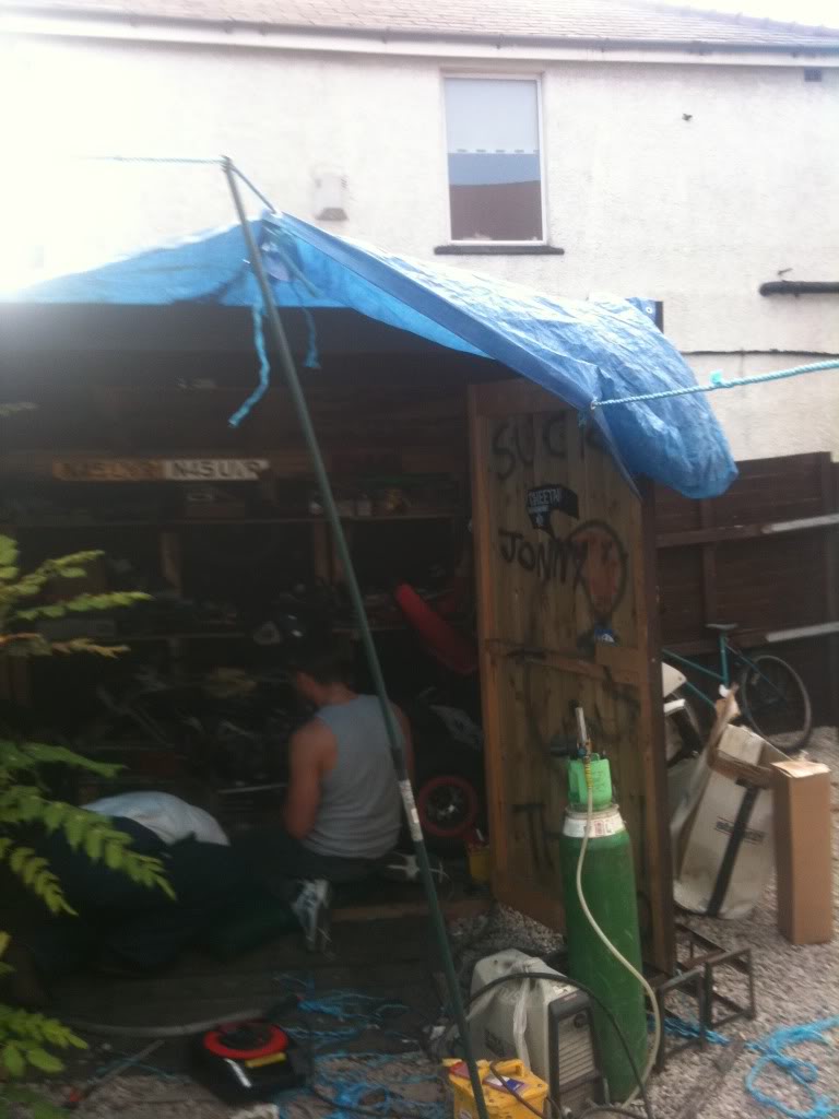

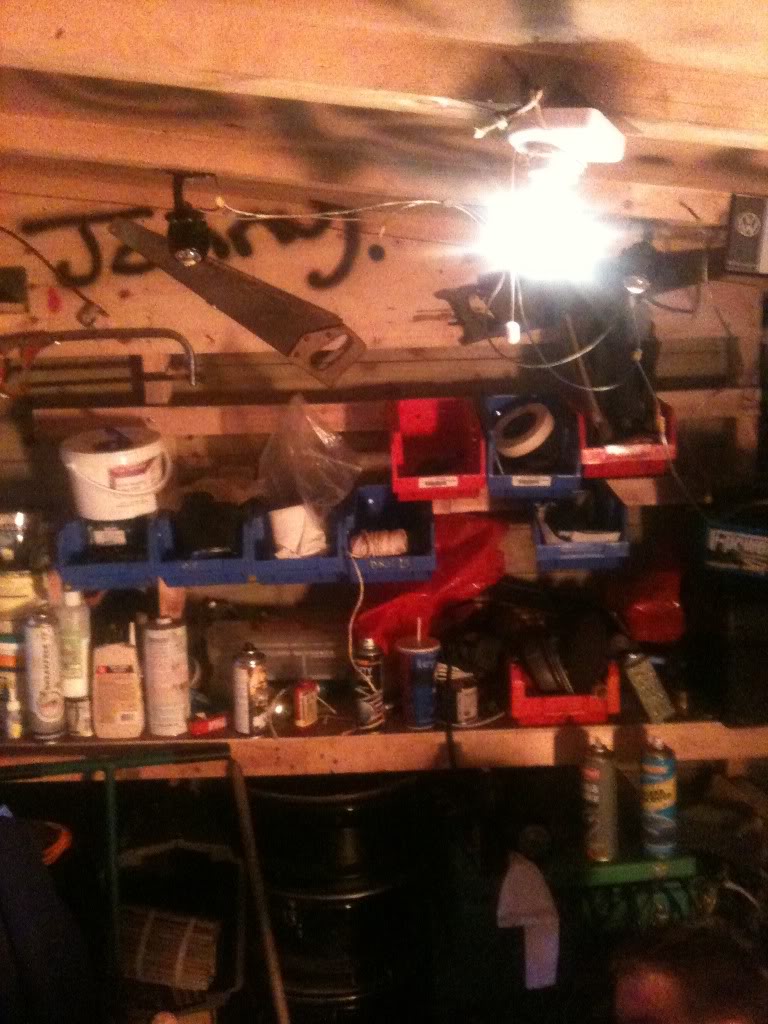

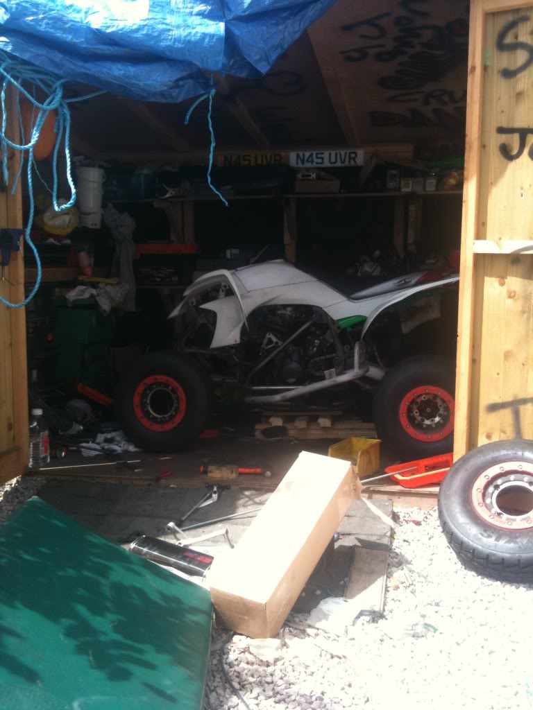

pikey shed were building it in:
phil sorting the welding out, top bloke:

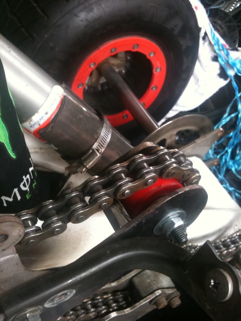

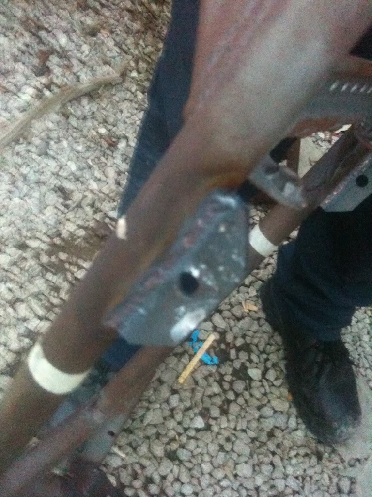

chain roller we made and welded on:
chain roller frame again:

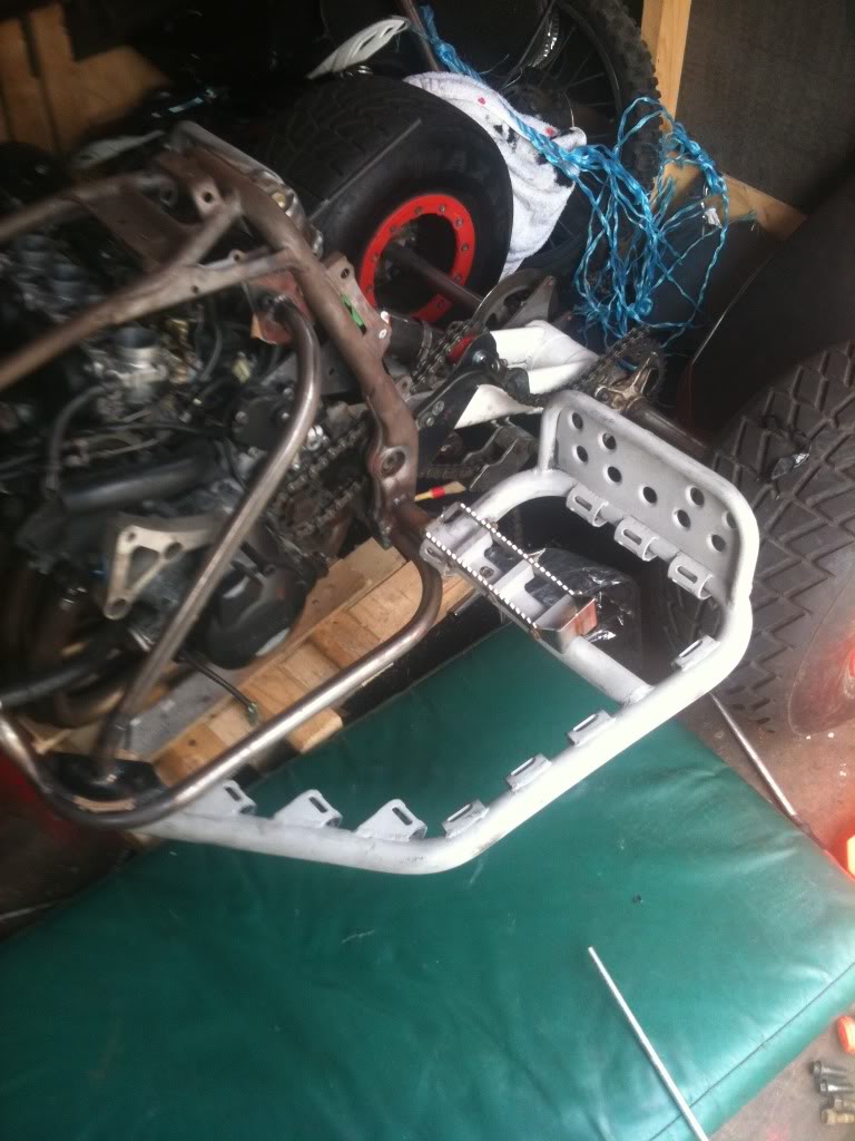

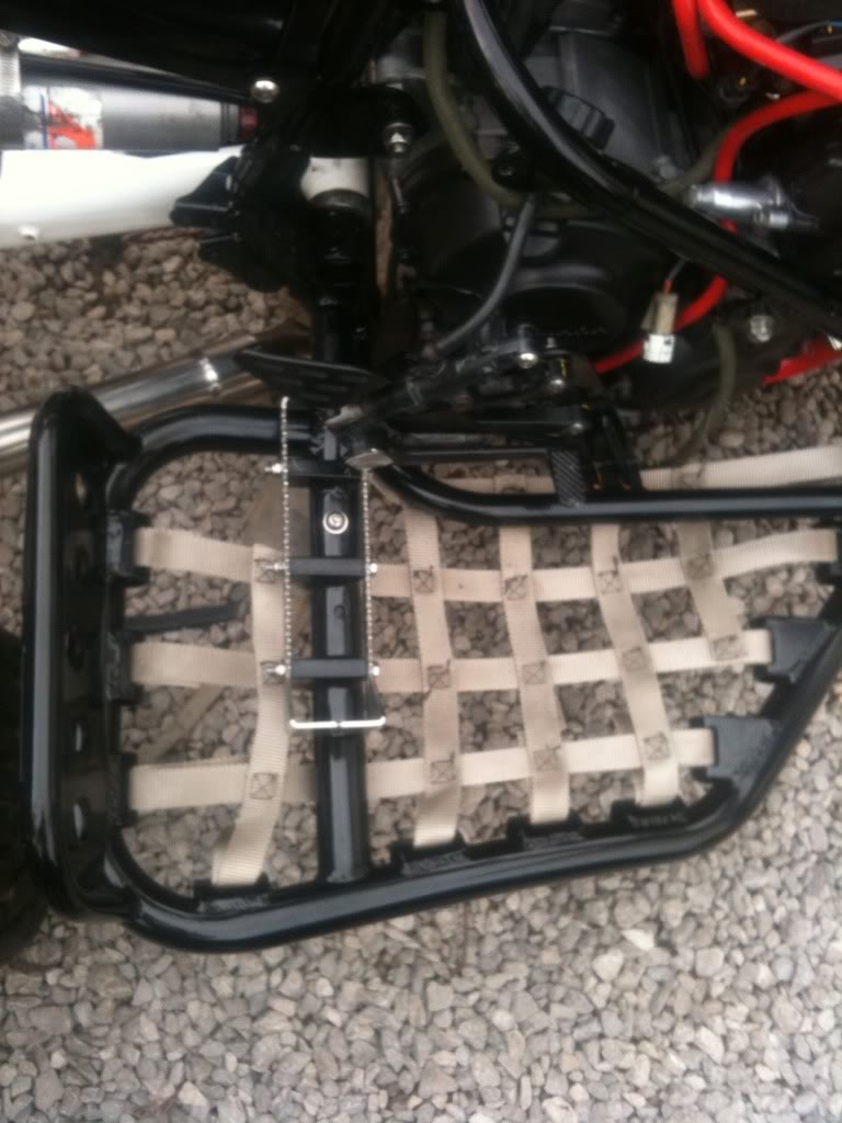

the nerve bars gettin mocked up:

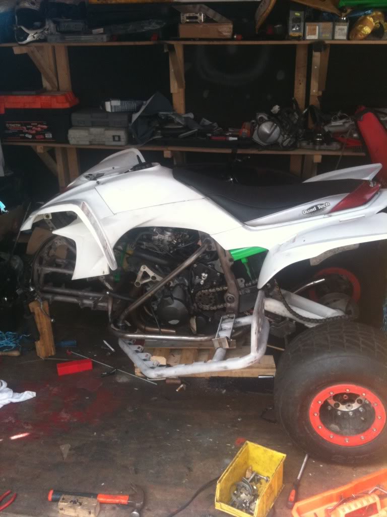

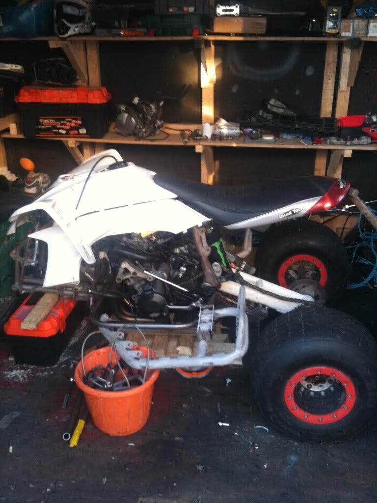

seat frame bolted on:
more plastics goin on:

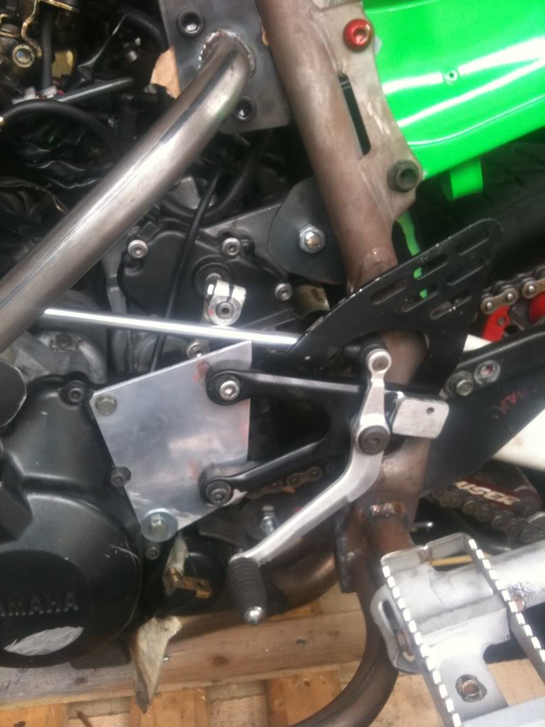

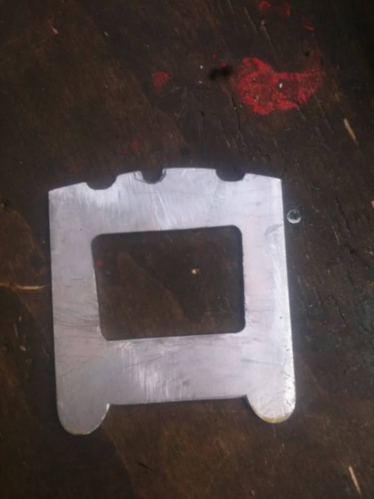

plate to hold the gear linkage on:
box to hold ecu and other bits:

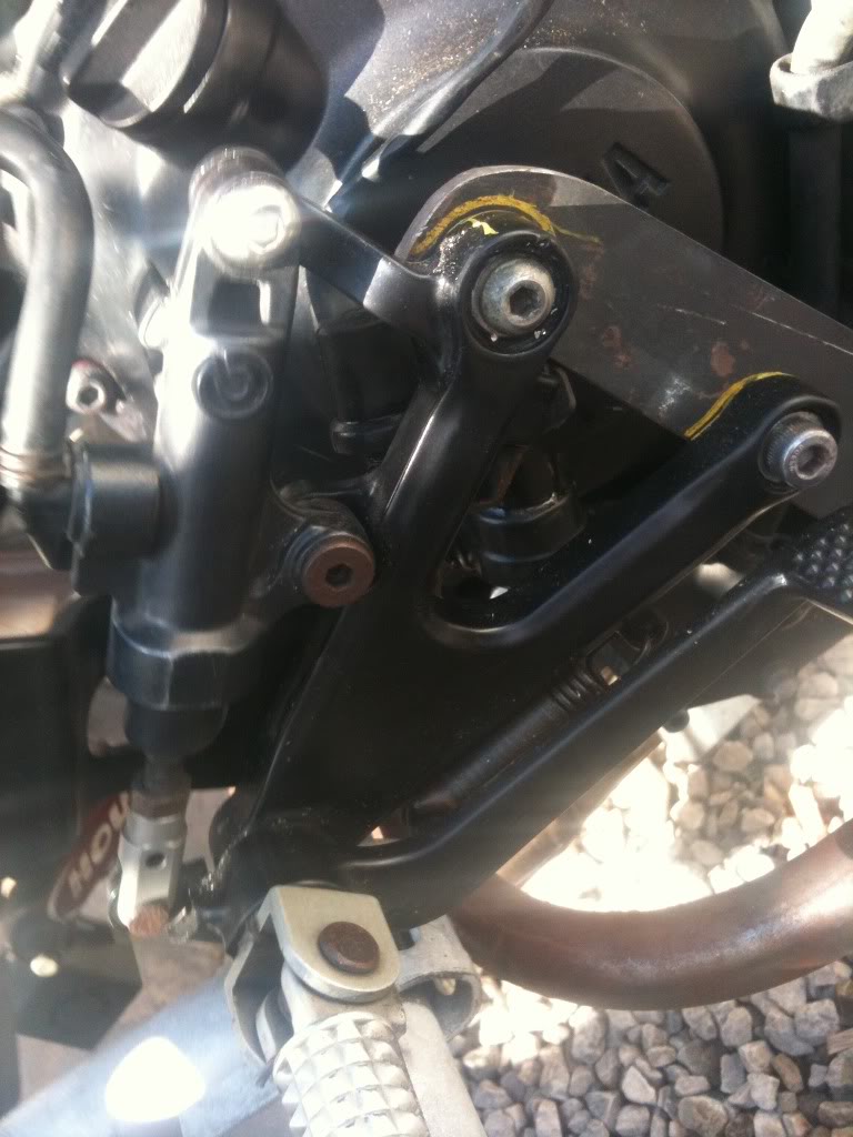

plate to hold foot brake on:

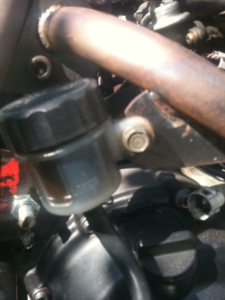

plate to hold brake fluid bottle

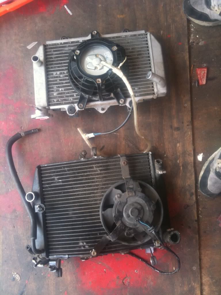

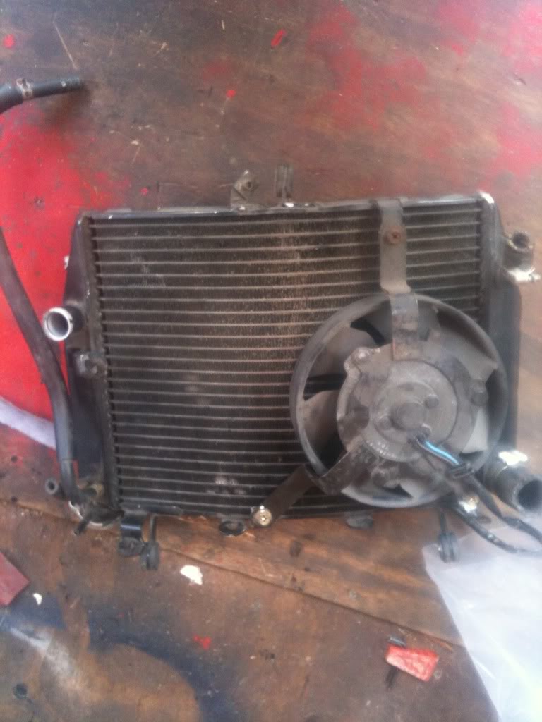

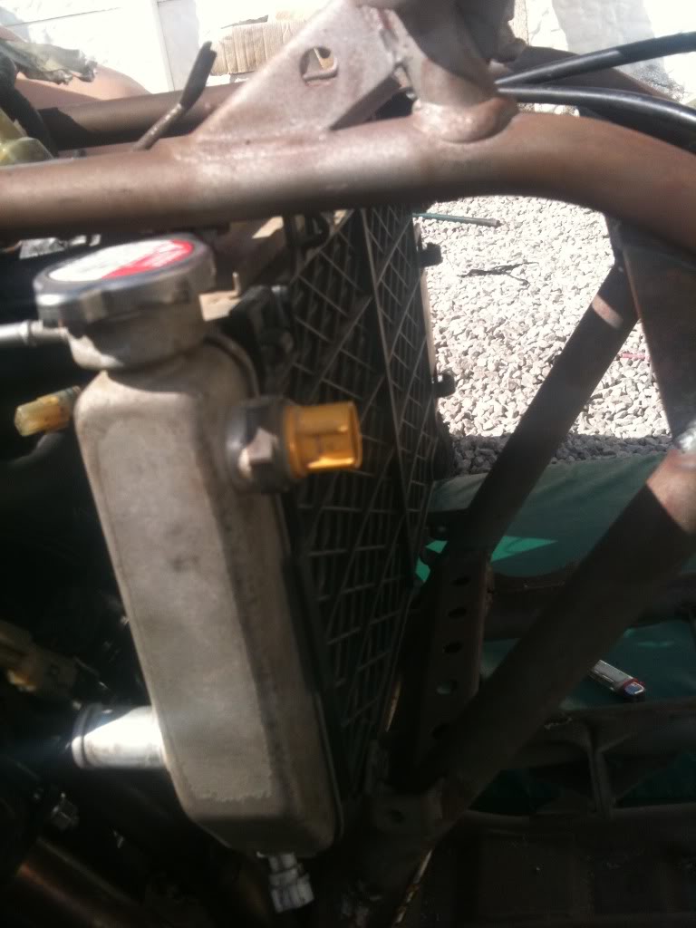

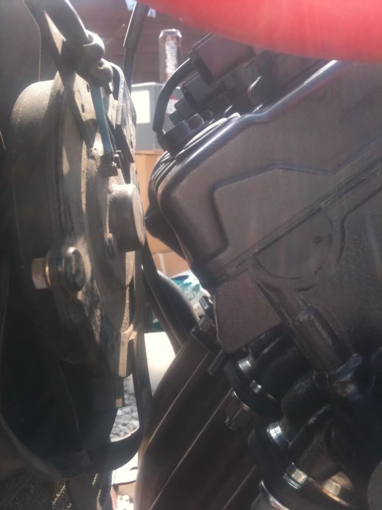

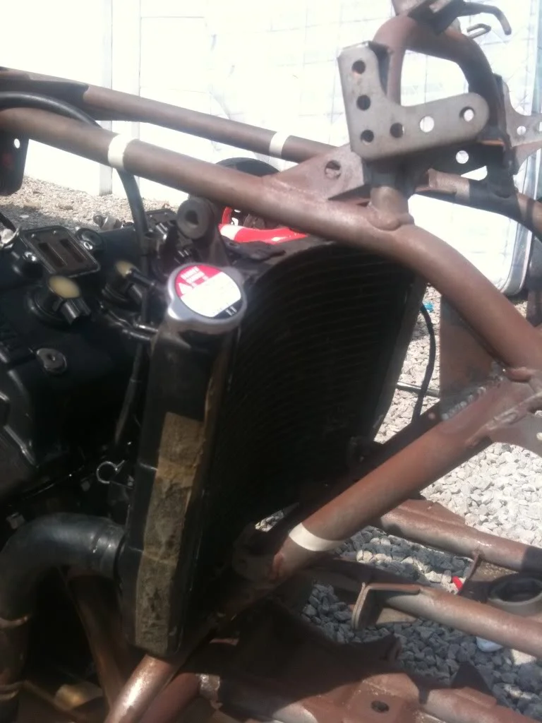

the radiator tight sqeeze we used the 450 one but this is insufficent at coolin the r6 so we need the r6 rad and more chopping is in order:

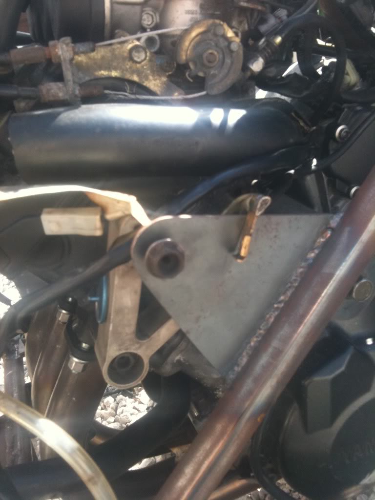

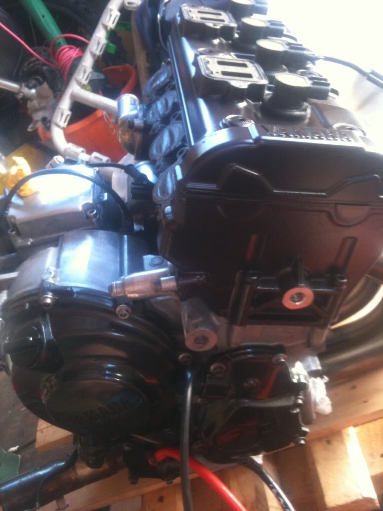

one of the engine mounts:

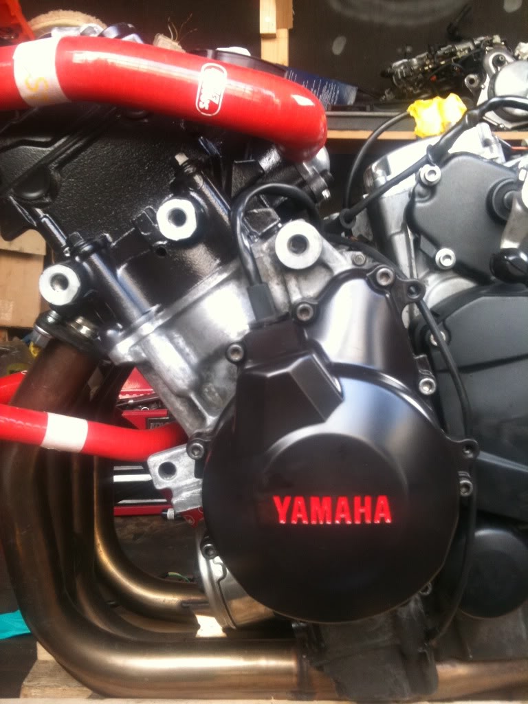

some polishing of the engine bits (not fully done):

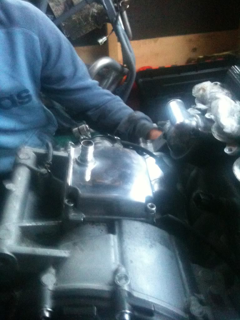

cleaning:
more polishing:

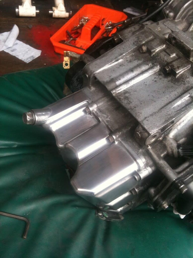

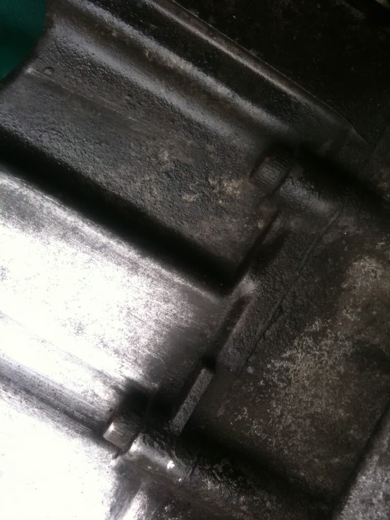

the grime on the sump befor:
the sump once i finished sdandin it:

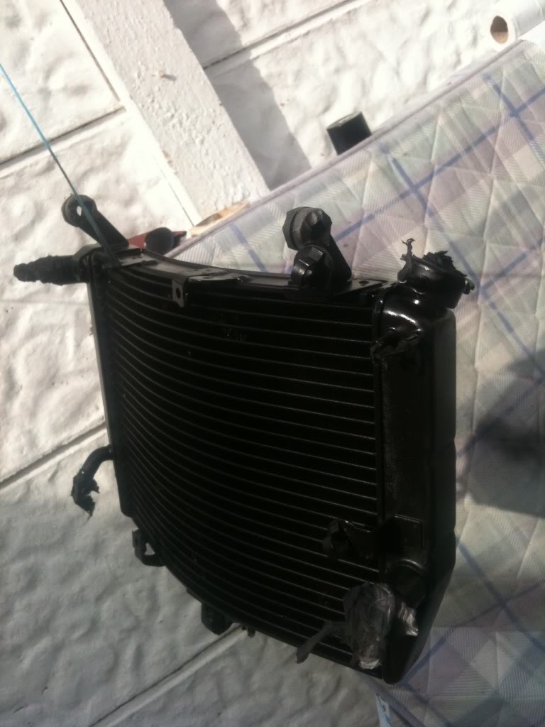

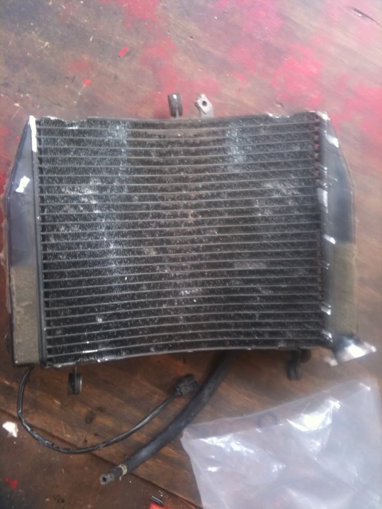

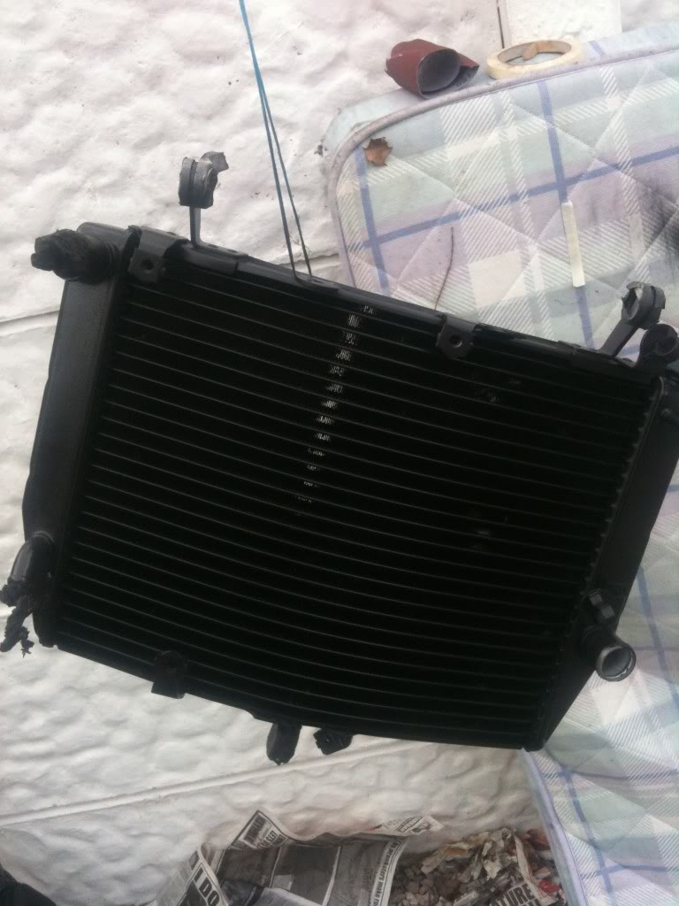

Right the radiatior finnally came, bit dirty so we gave its a clean and scrub and sprayed it black:
before:
after:
comparing to the old rad we were gonna use:

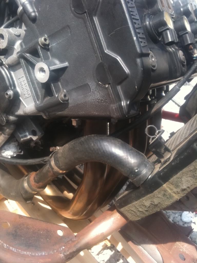

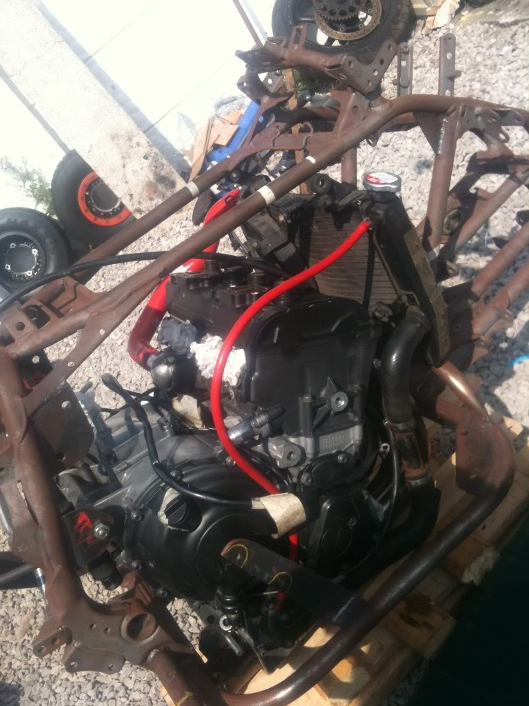

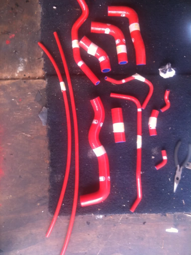

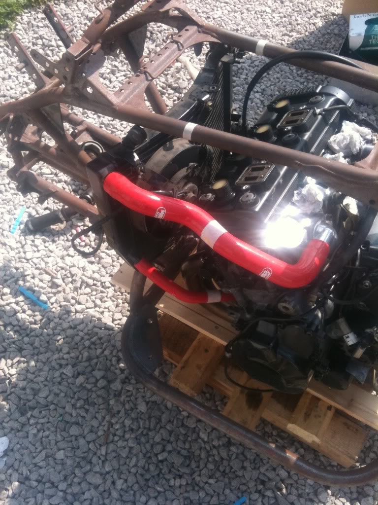

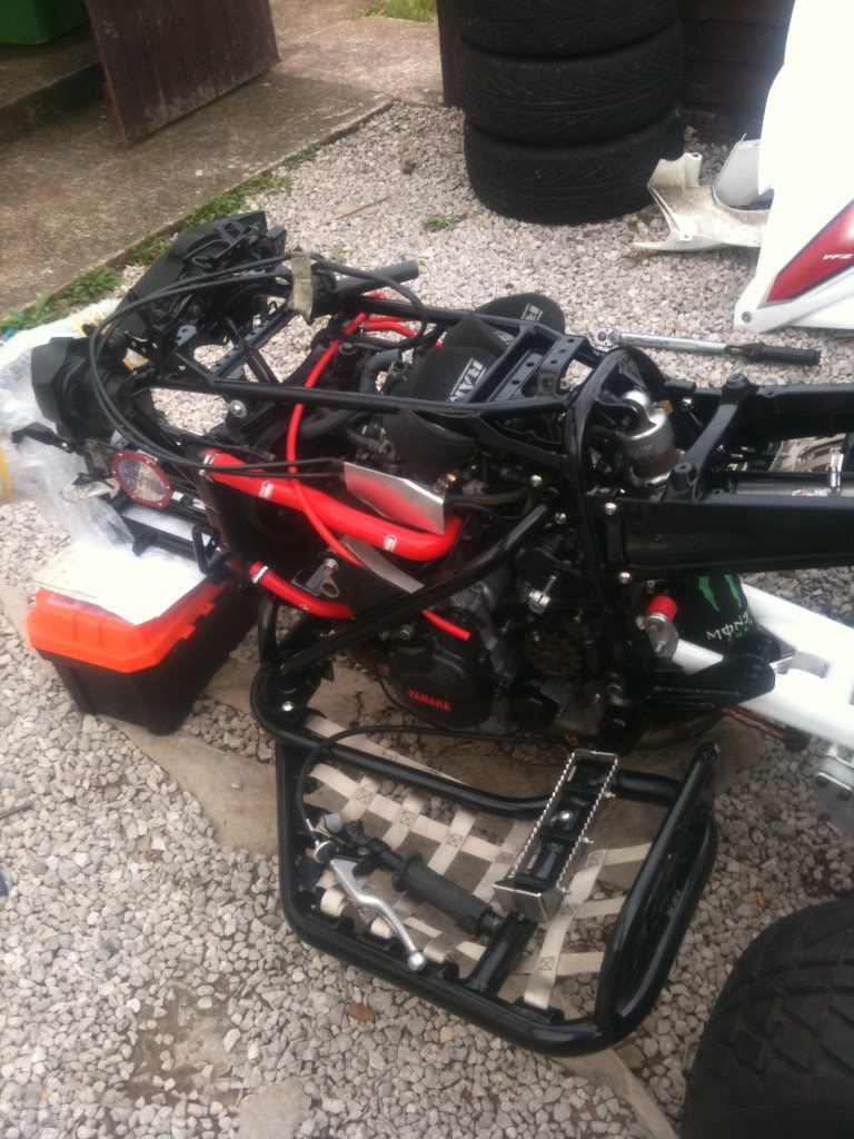

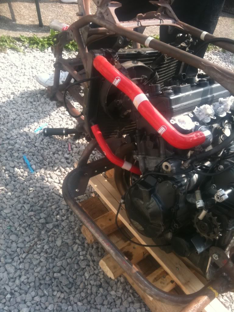

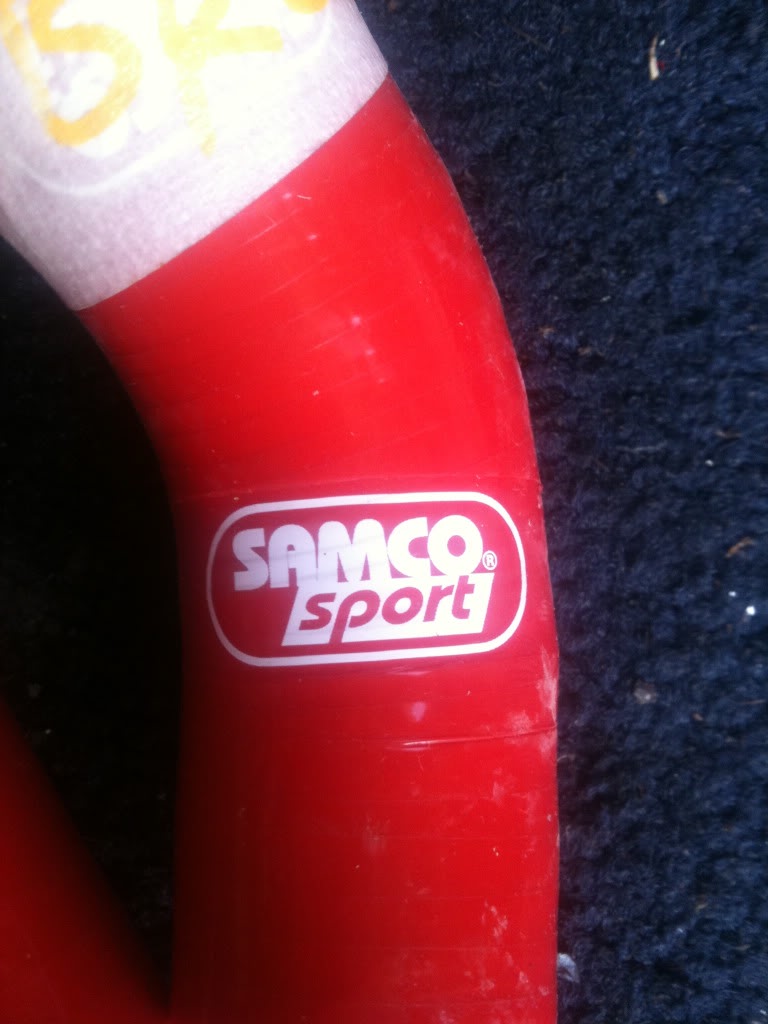

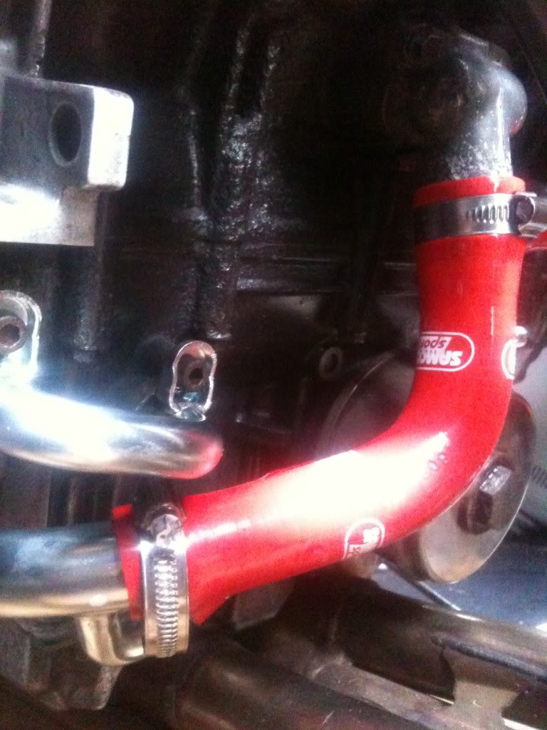

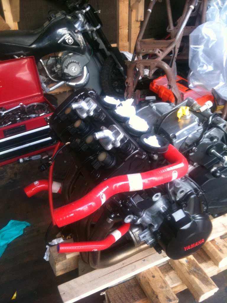

samco hoses arrived:

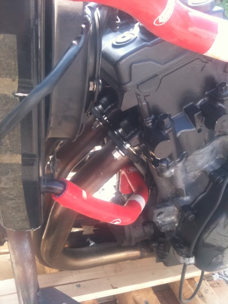

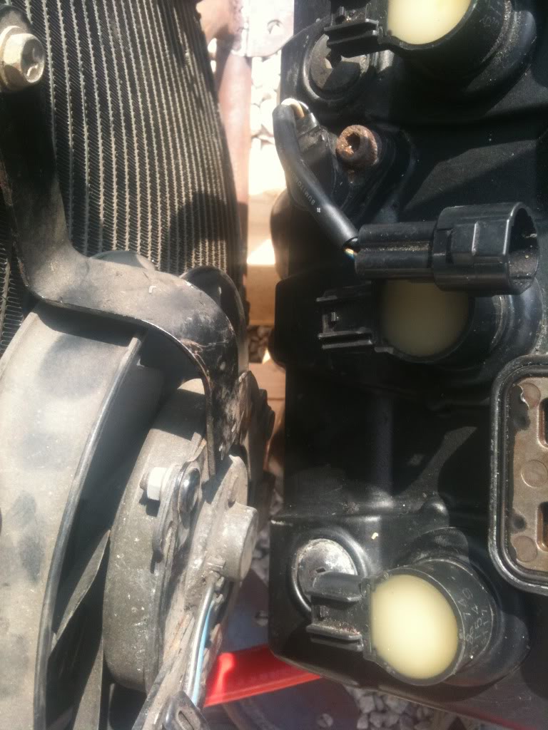

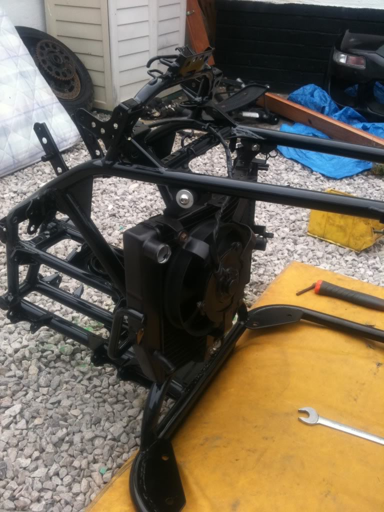

the rad just held in place:
not much room:

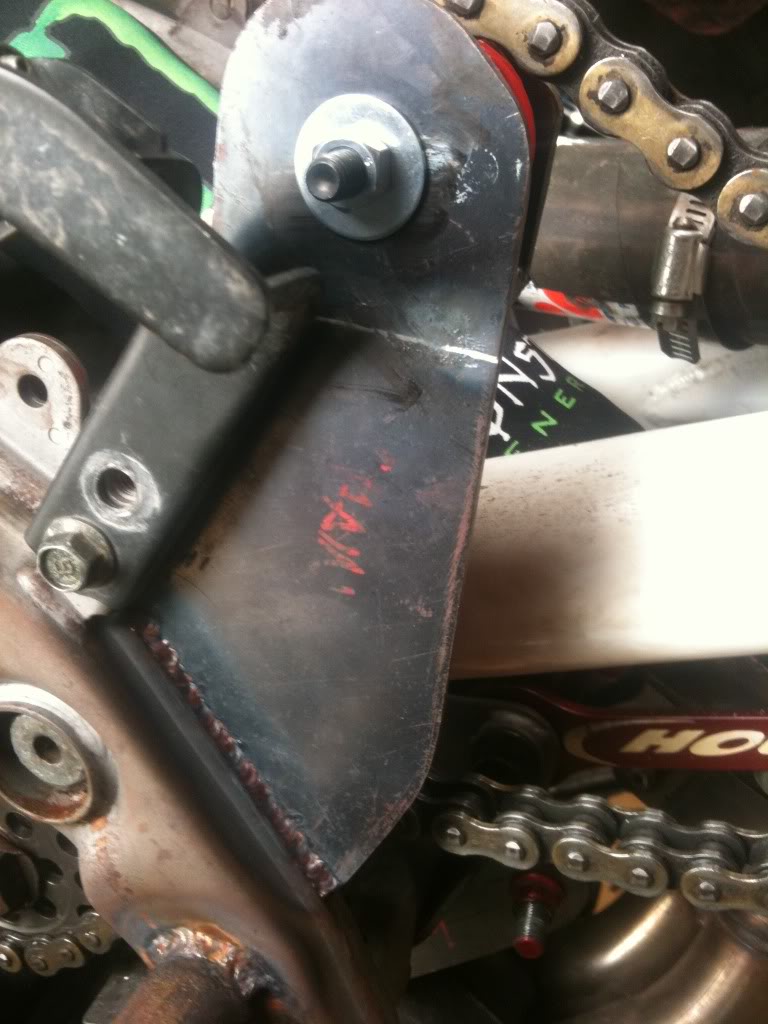

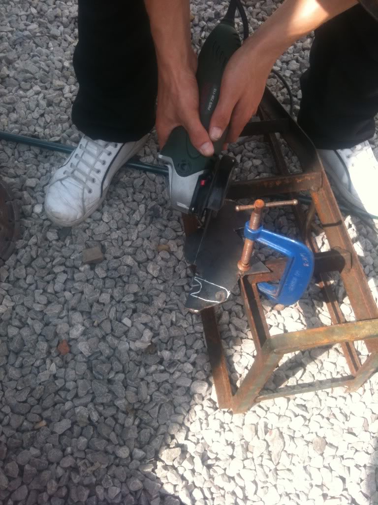

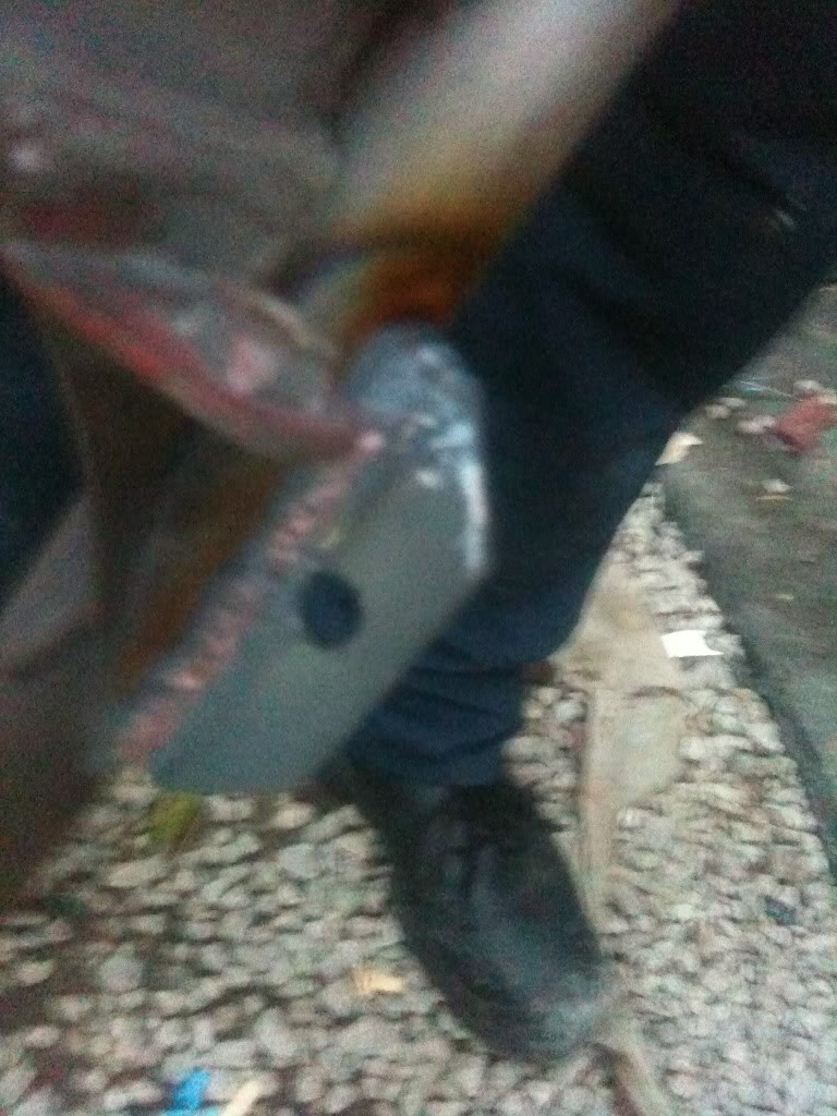

cutting rad brackets out ready for welding:
brackets welded on last night by phill:

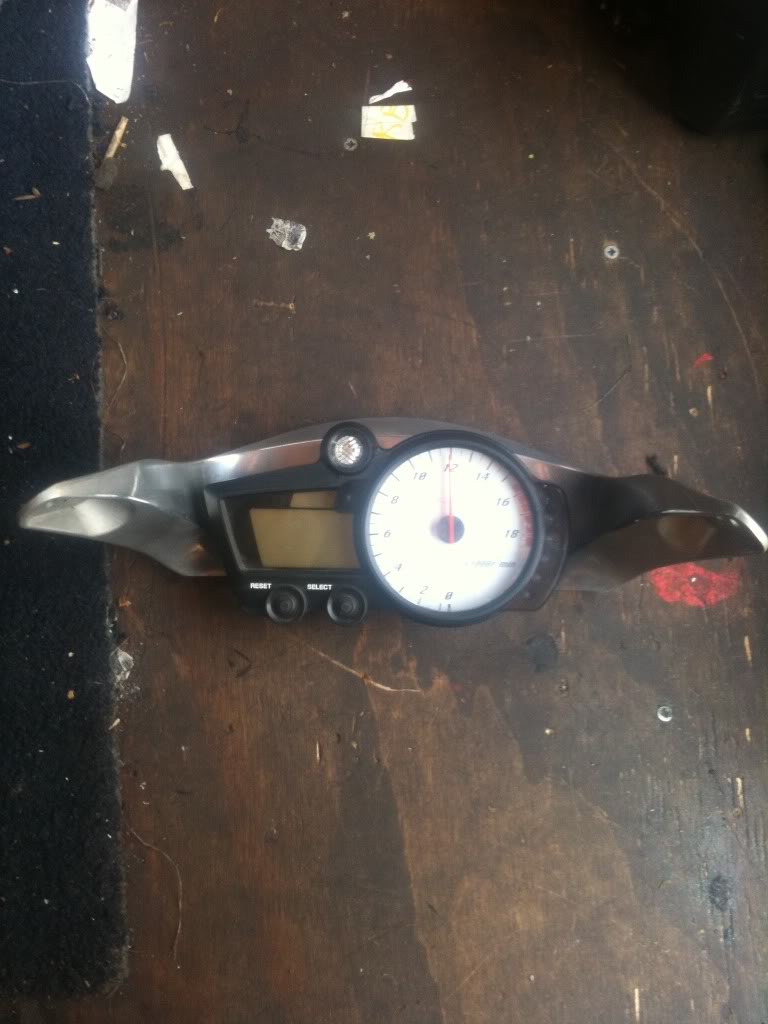

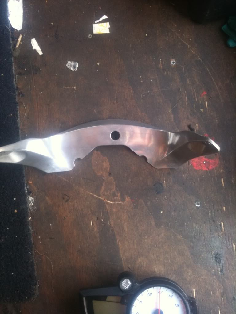

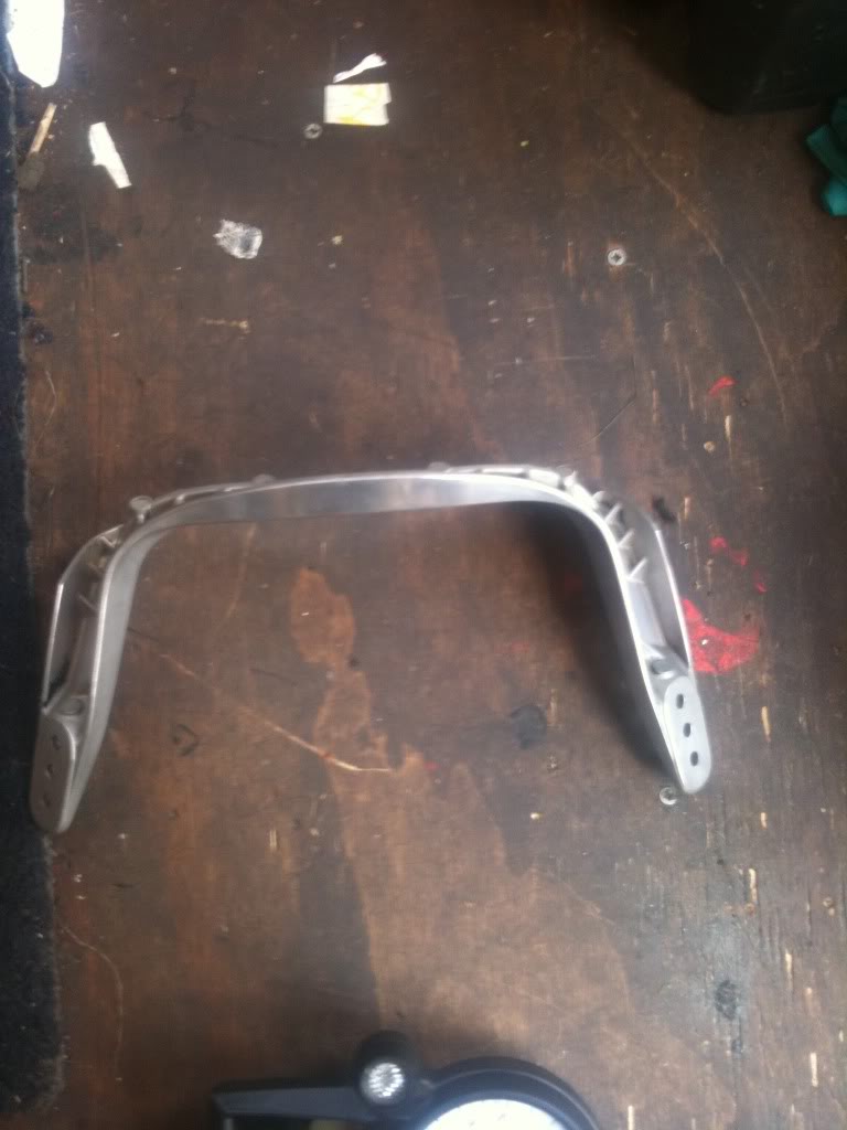

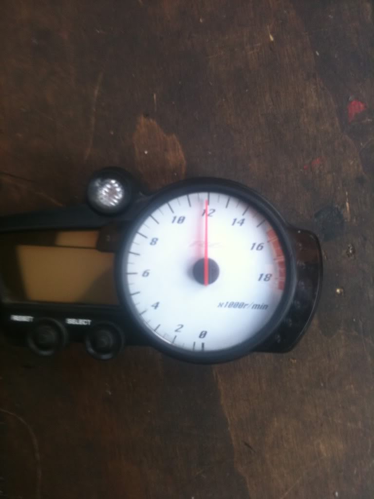

r6 clock:

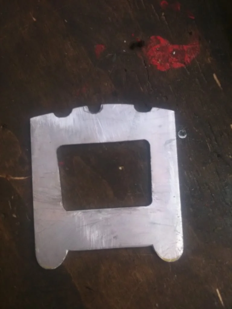

shiny bracket to hold the clock:
and a bracket to hold the clock onto the steering arm trees,:

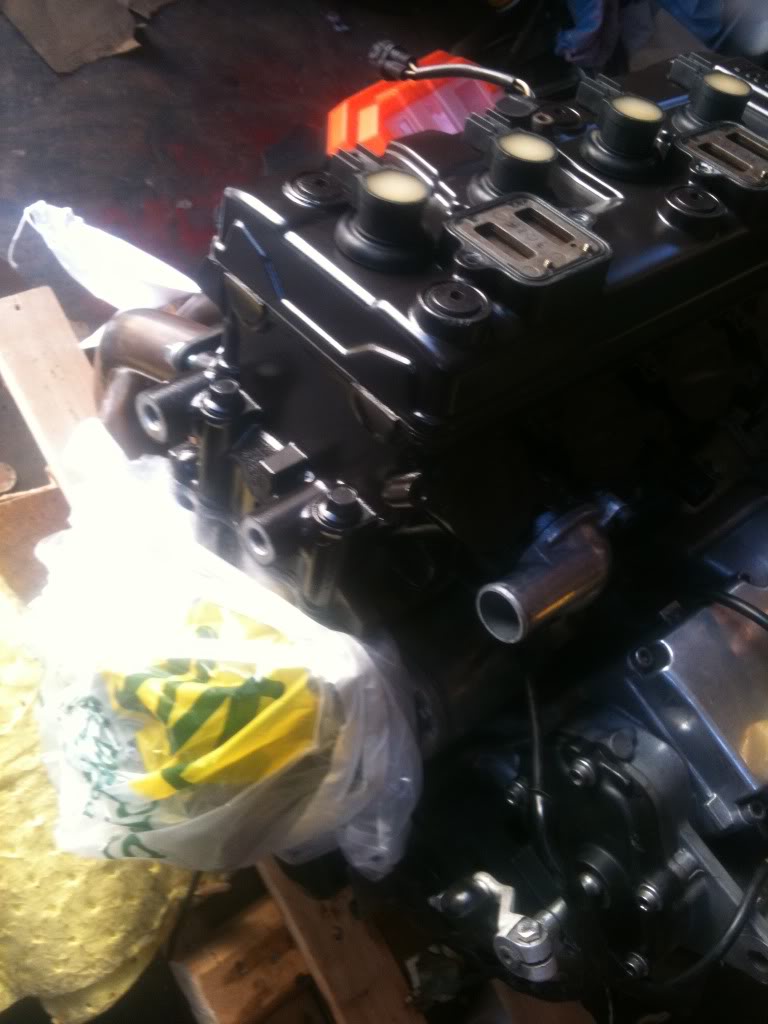

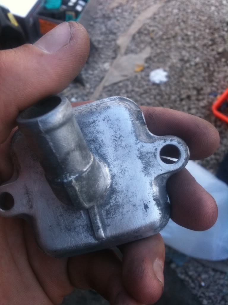

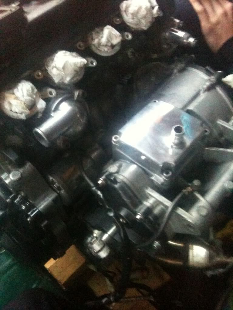

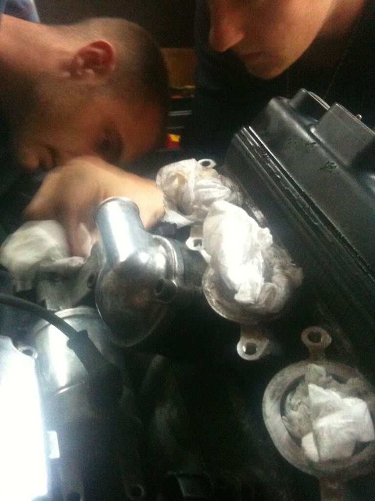

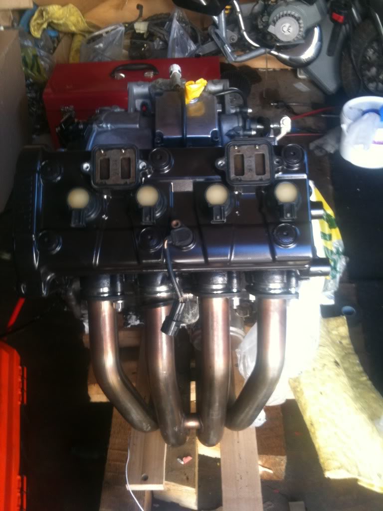

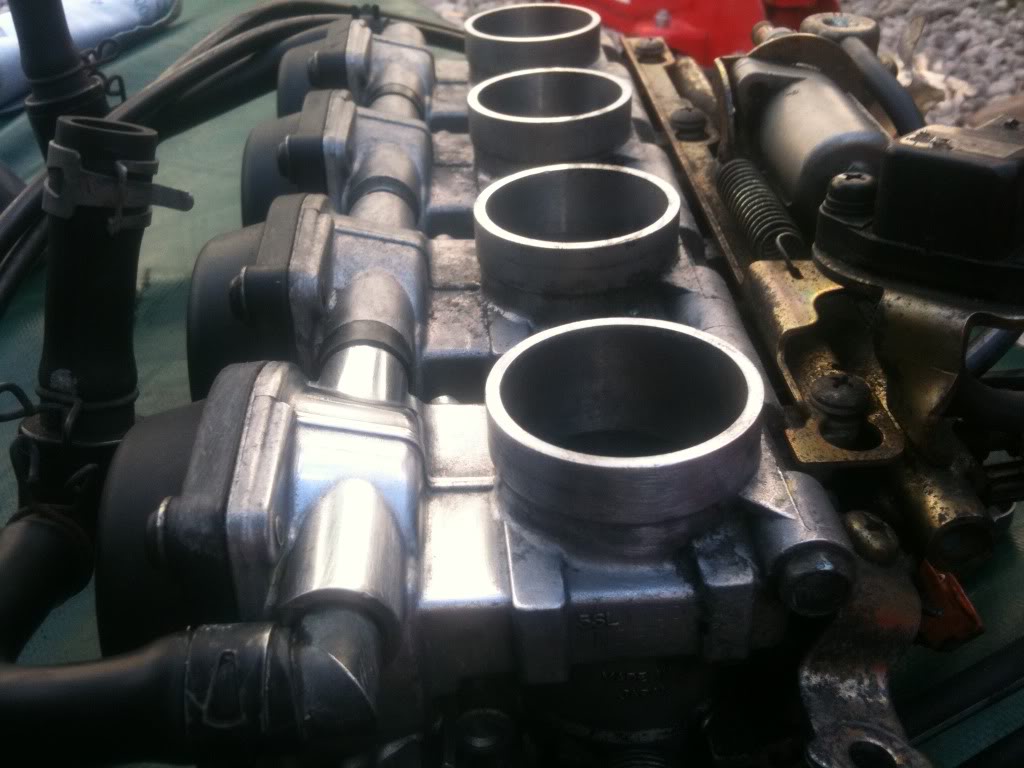

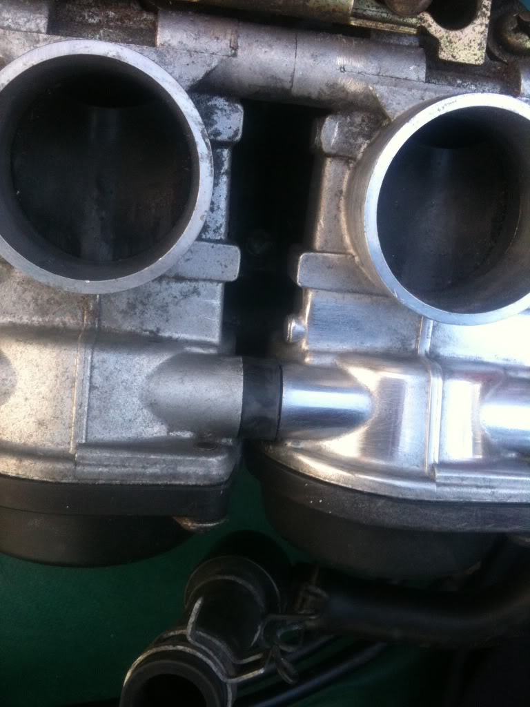

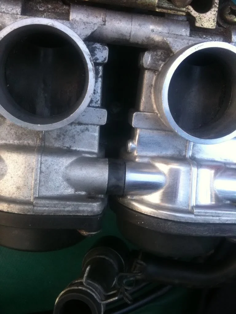

started to clean one of the throttle bodies:
look at this - mingin!!
SHINY!
after a hour!

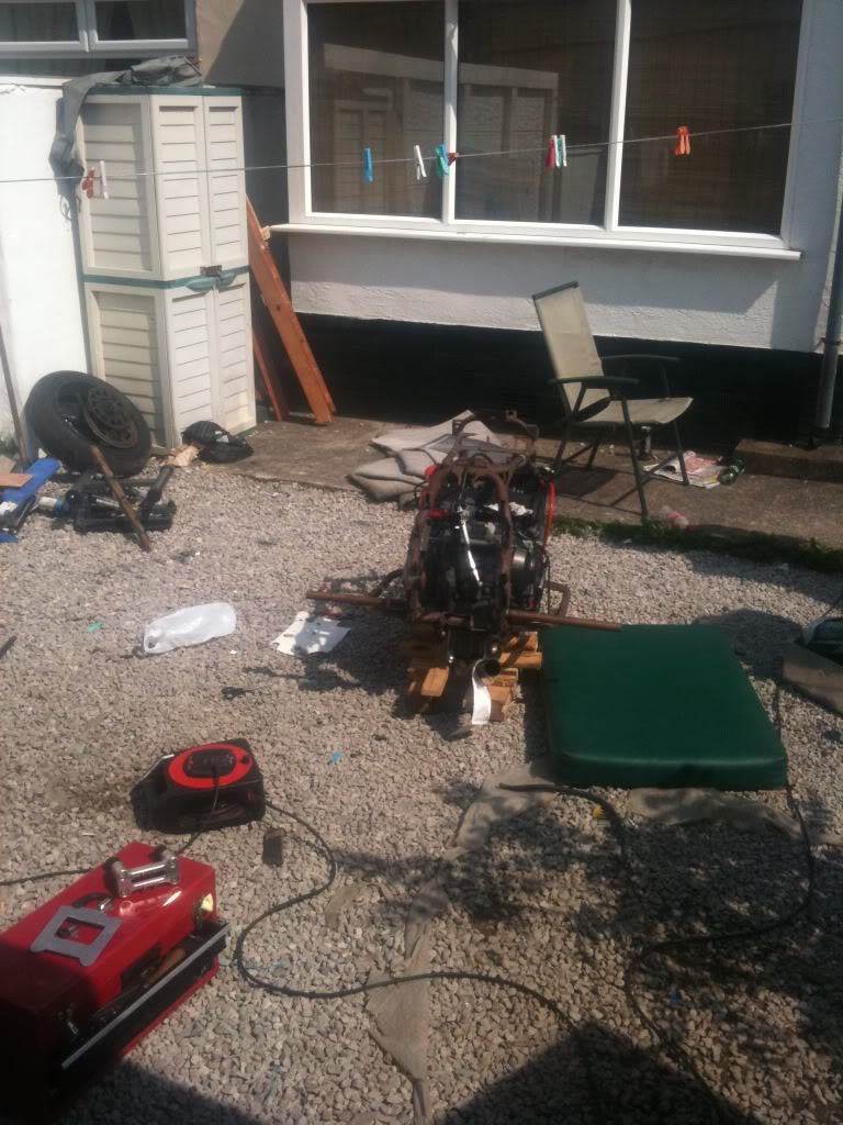

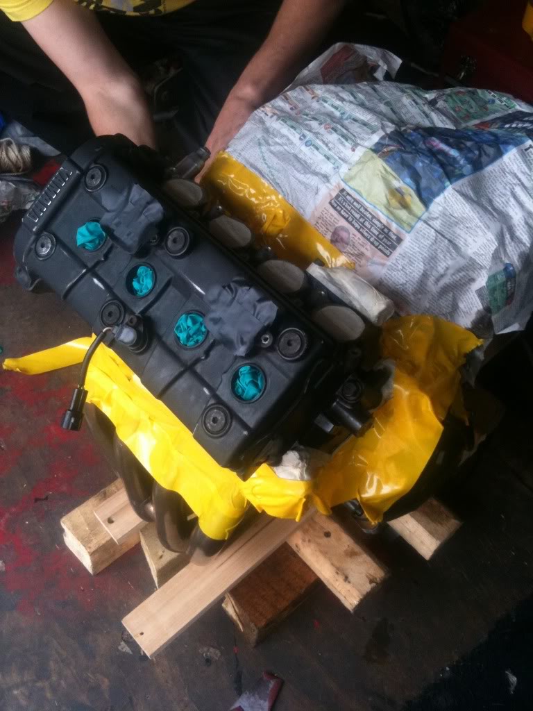

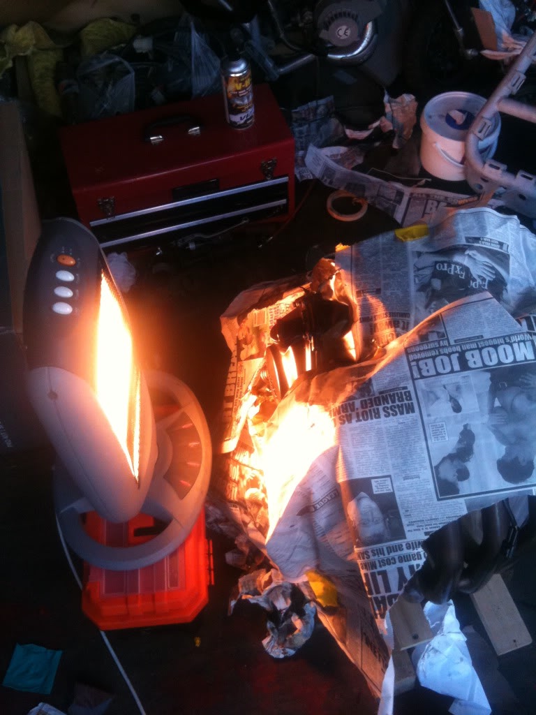

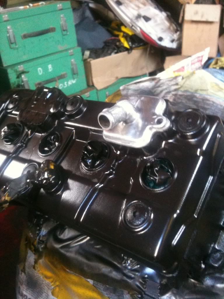

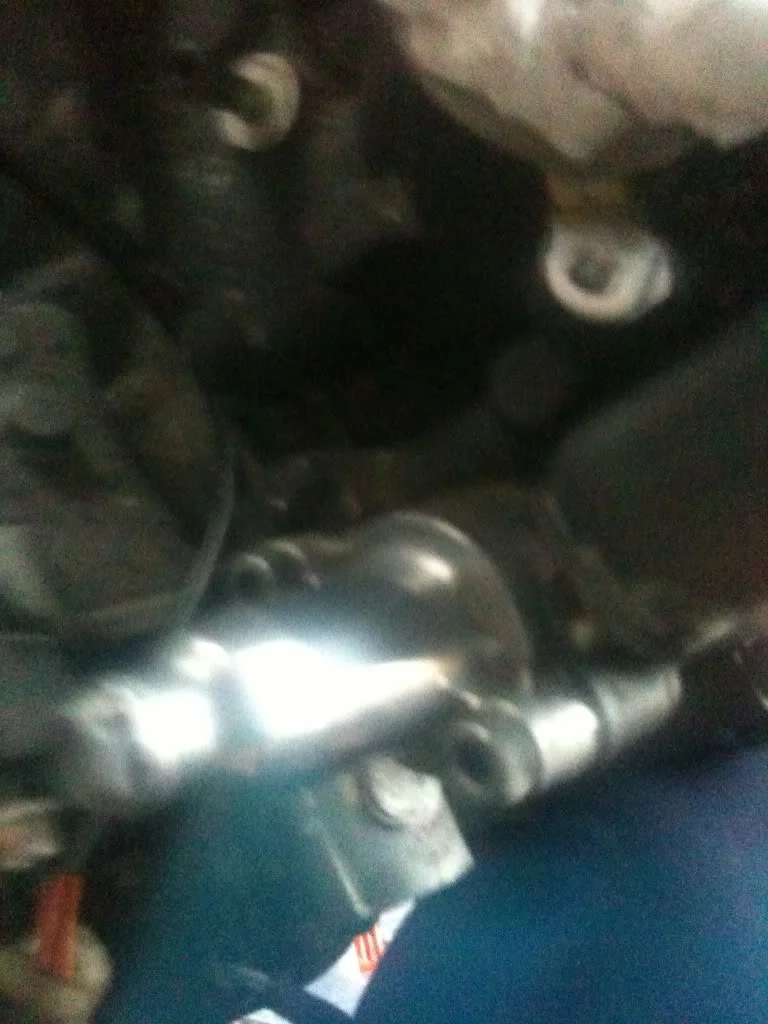

dryin engine -

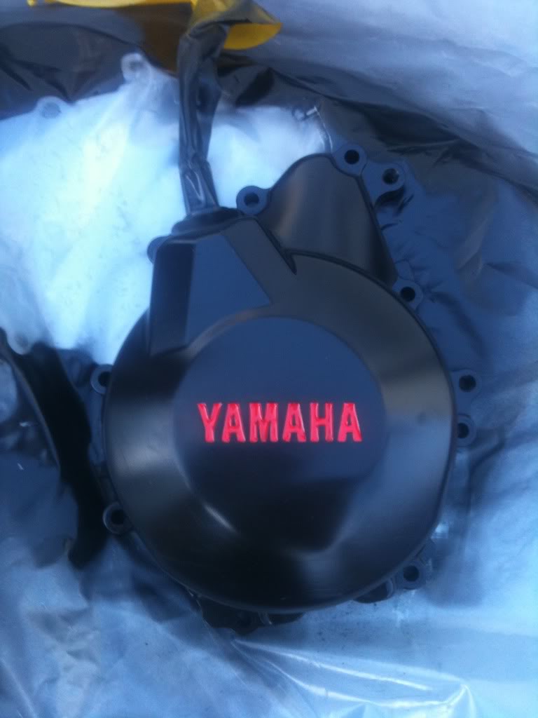

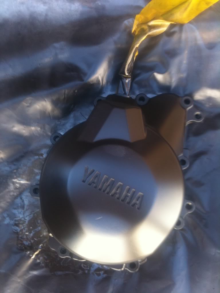

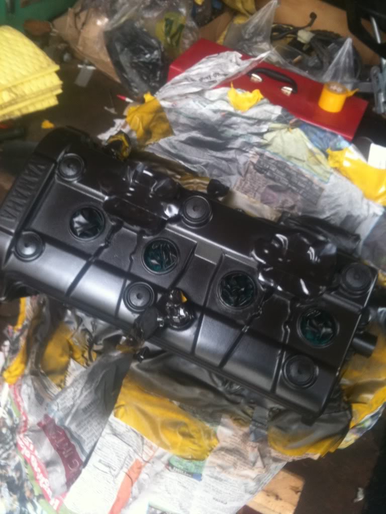

this had big gashes in it, spent half hour sanding it and my mate went sick with the paint! ahaha
nice little touch he did:
pikey paint dryin

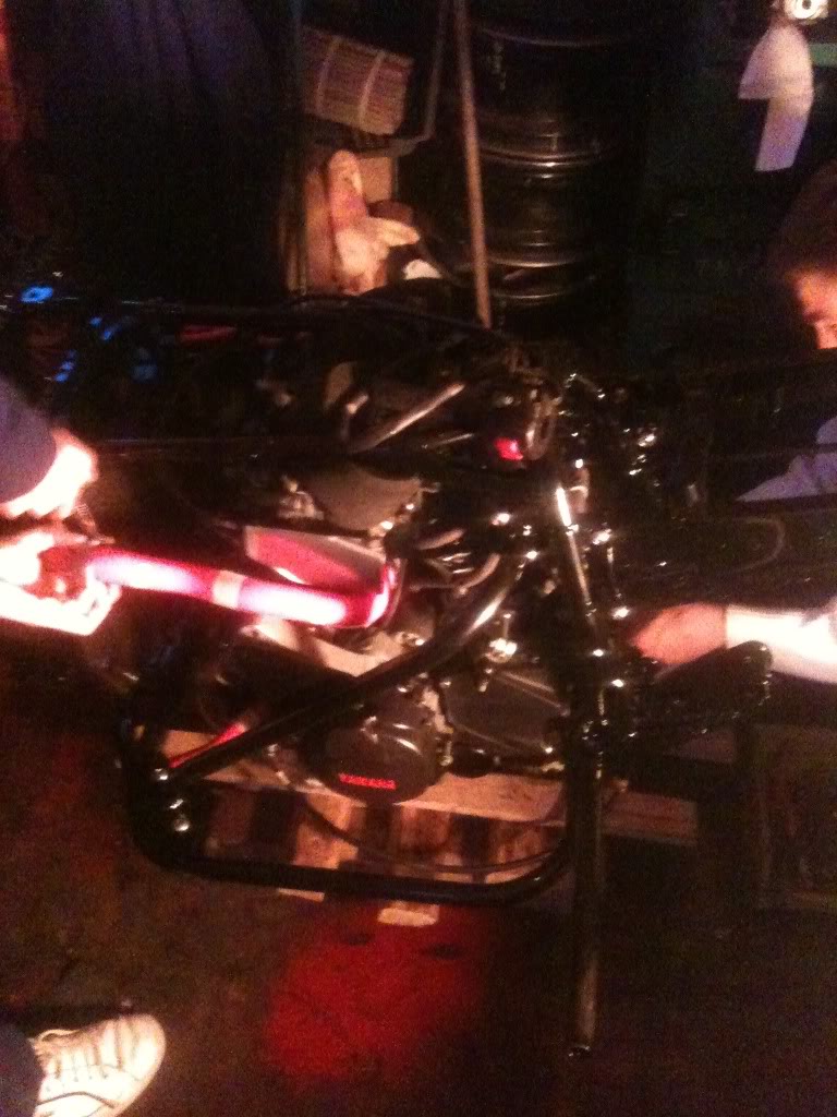

assembiling bits:

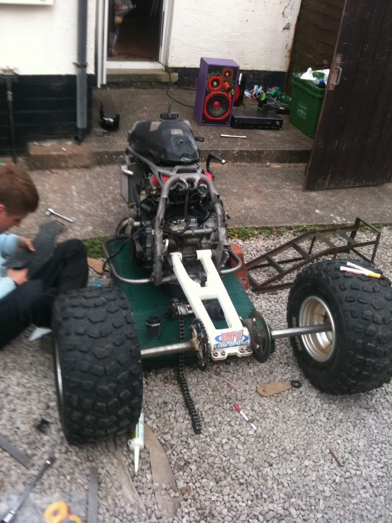

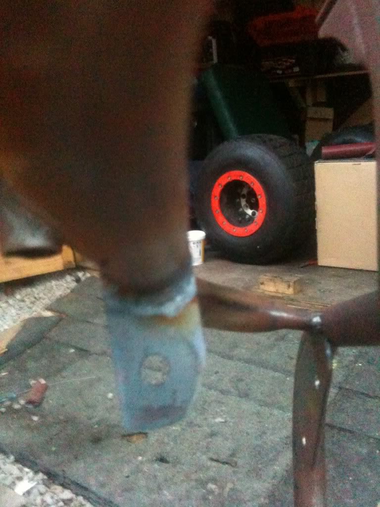

on thing though you need to change that chain system. That chain roller wont last 5 seconds, there designed to go on the non tension side (underneith)
Can you not mod the frame to get a more direct route or lower the rear (i take it you will lower the whole bike) ?
if not, worse case use a front sprocket with a propper bearing.
gonna be quick though... just make sure you've got a propper helmet... just in case ;)
yeah pal, i sed earlier in the thread that the chain is goin to chew f**k out that chain roller were having a sprocet milled up now with some bigg ass bearings through it, that will be ok for it,, just think were using the uprated shocks that came with it, god knows of the make we had to refurb them when he first got the quad some make disappeared! and as for wheels....were not sure ahaha

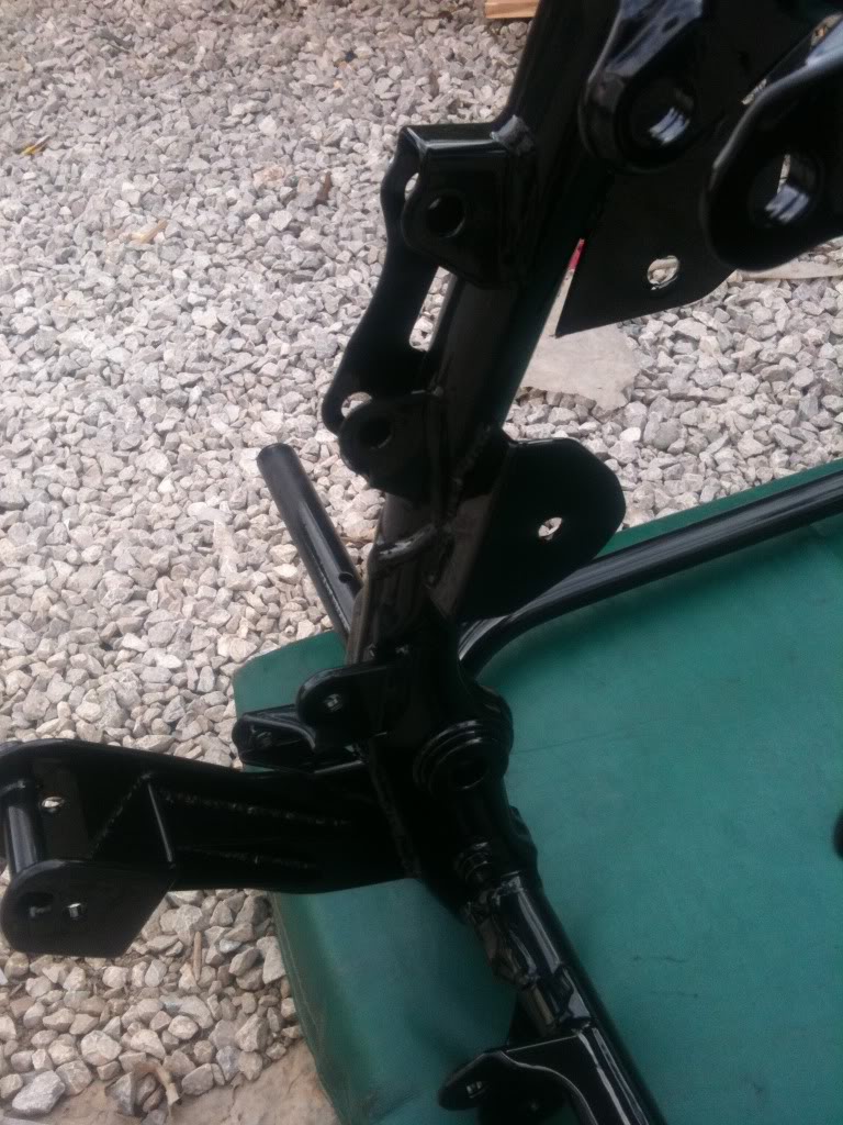

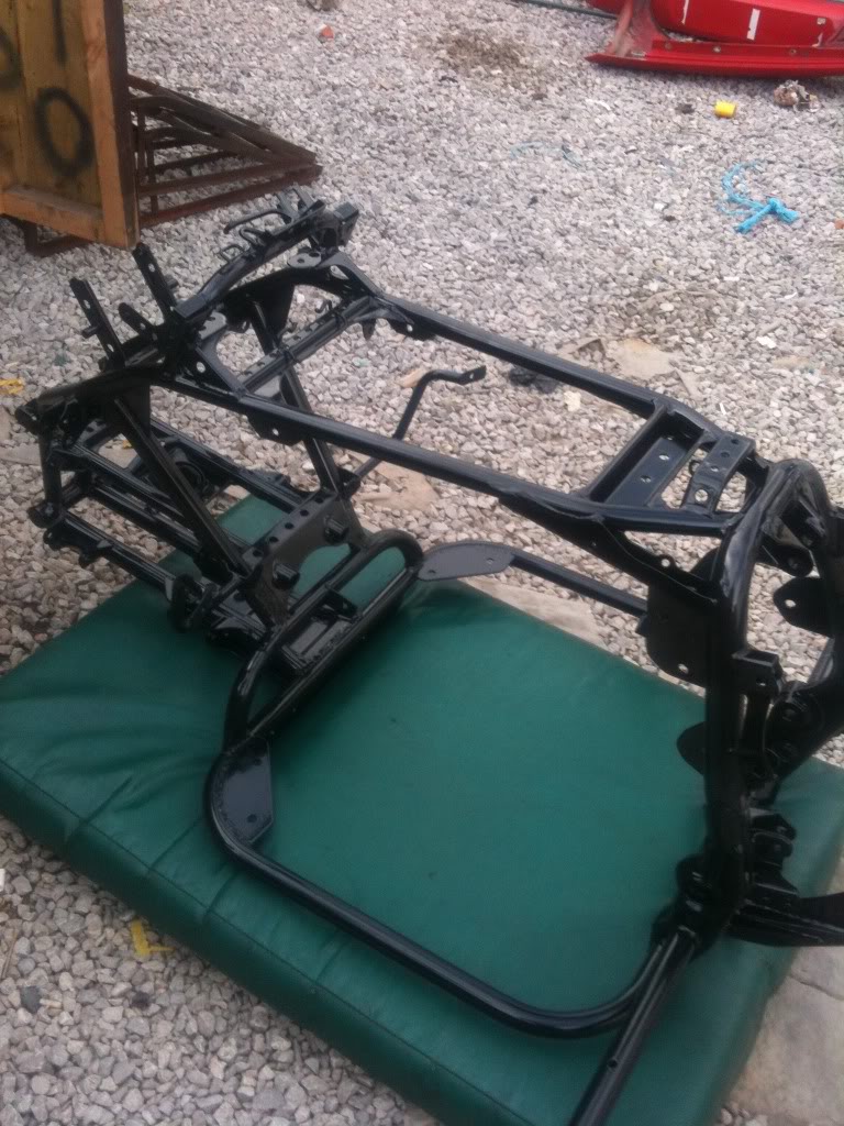

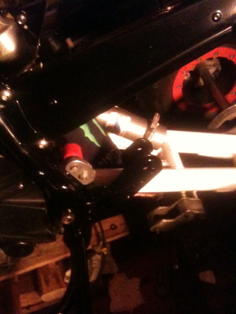

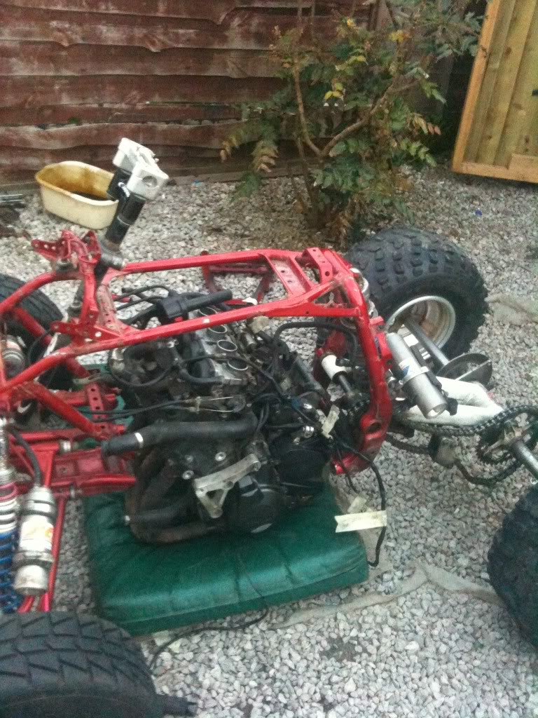

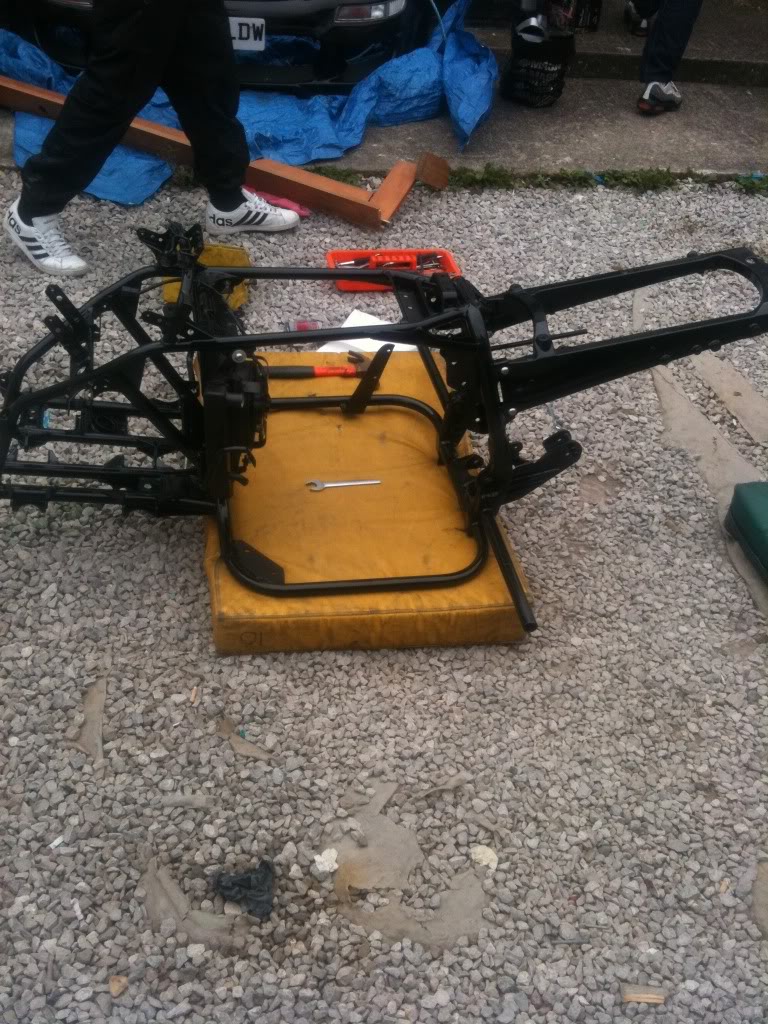

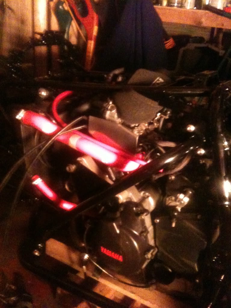

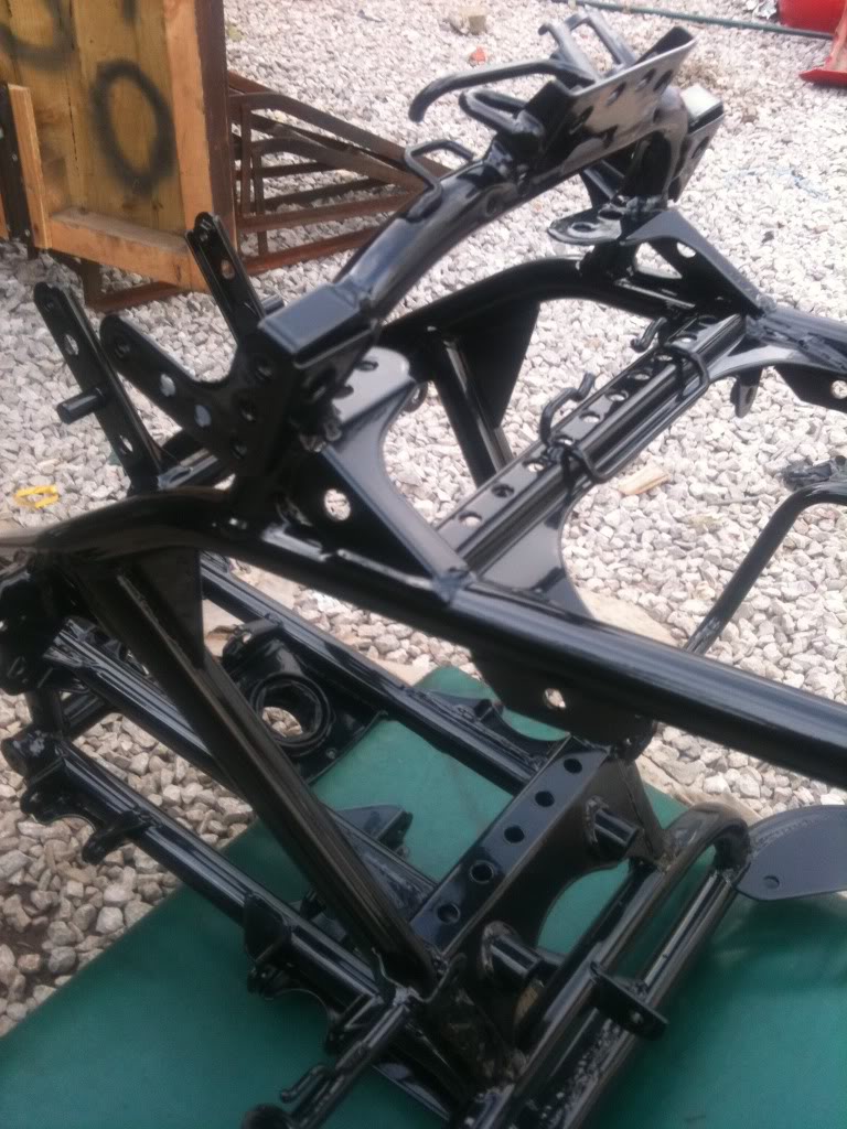

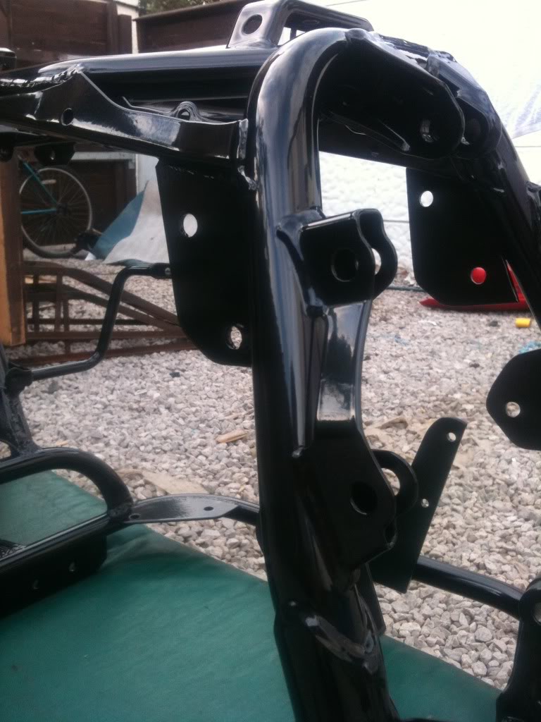

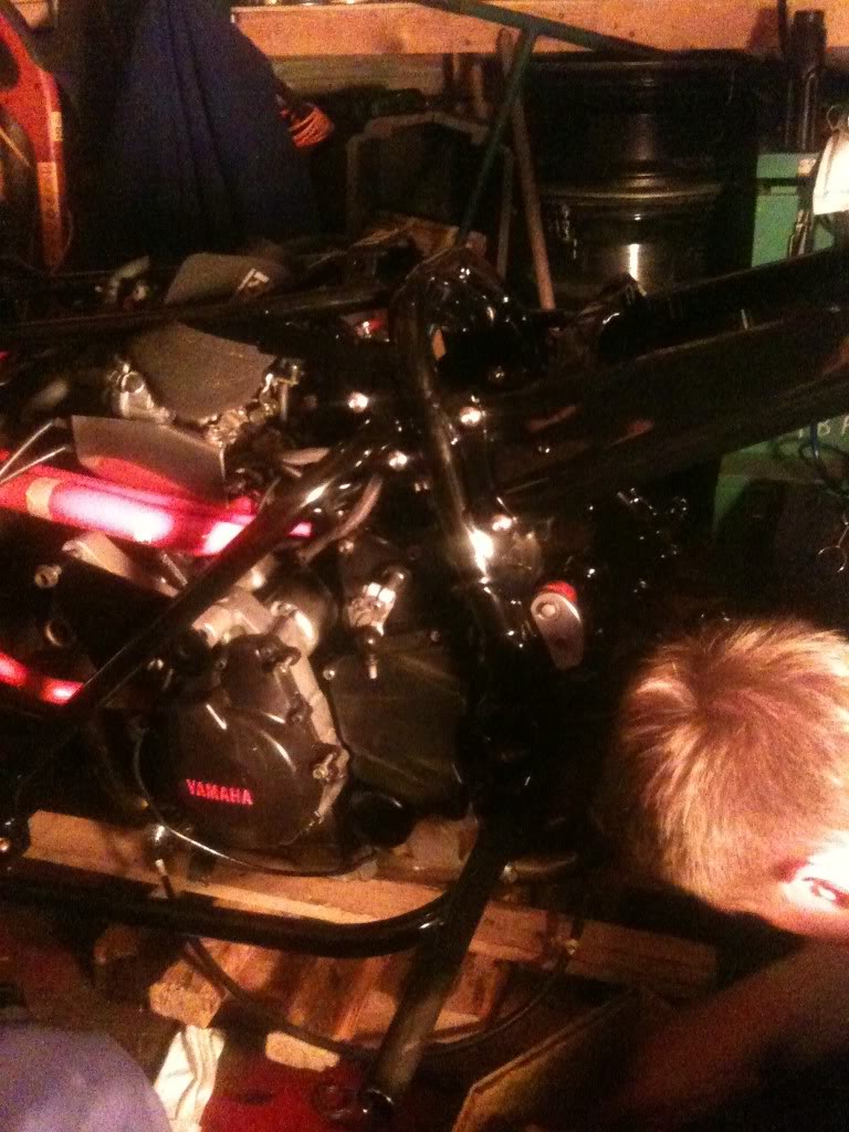

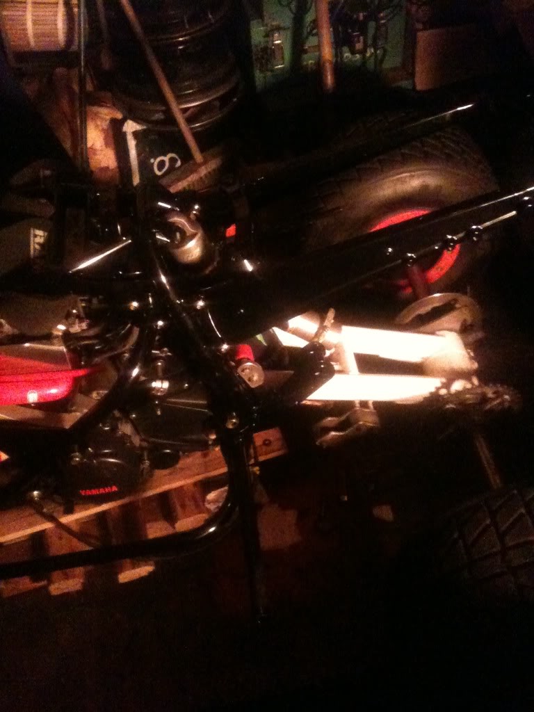

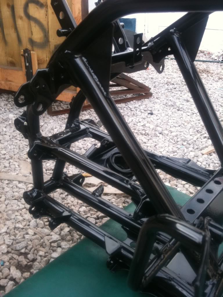

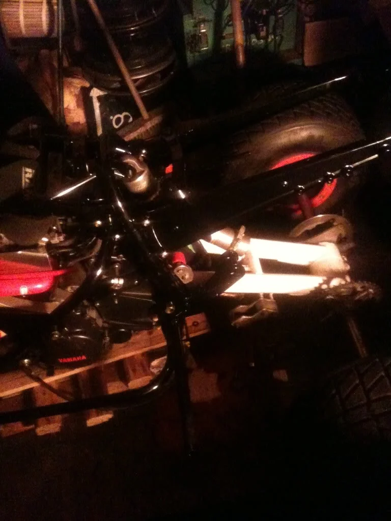

well we got the frame back friday afternoon, and.. wow, its looks like it was ment to be instead of the chopped and welded on steel, it really does look mint , £120 for the frame so its not bad price, it was horrible tryin tp wiggle the engine in with the frame so fresh!!

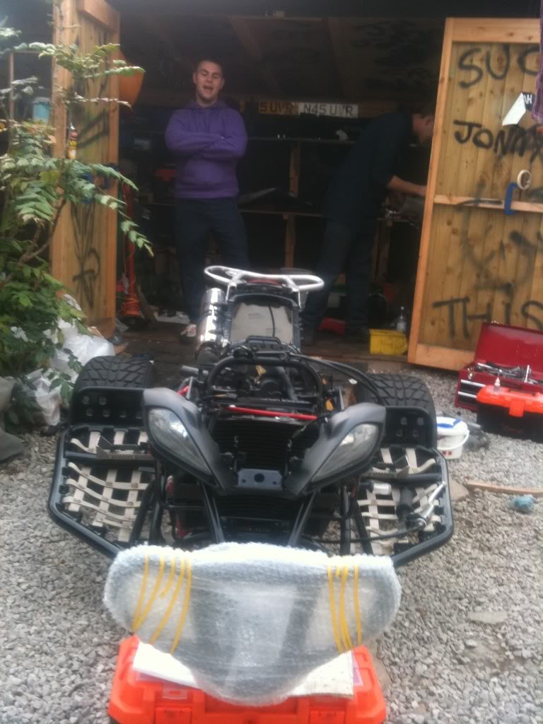

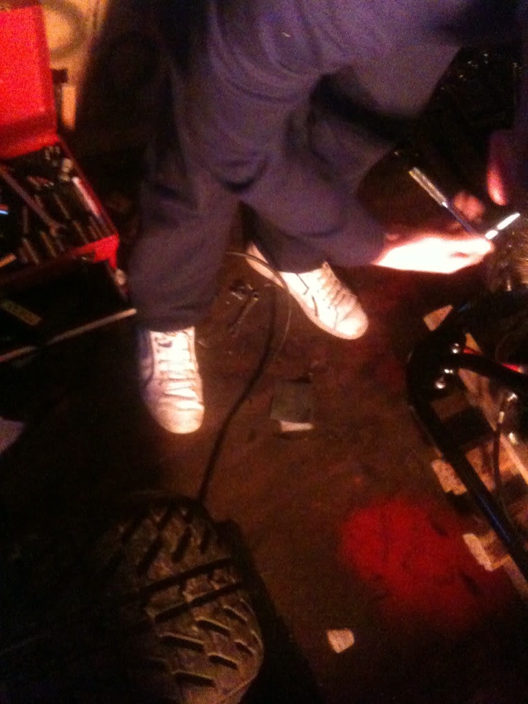

we had started to work in to the dark last night so pikey lights were set up in the shed!

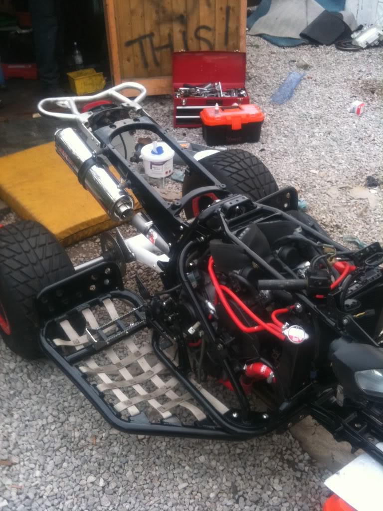

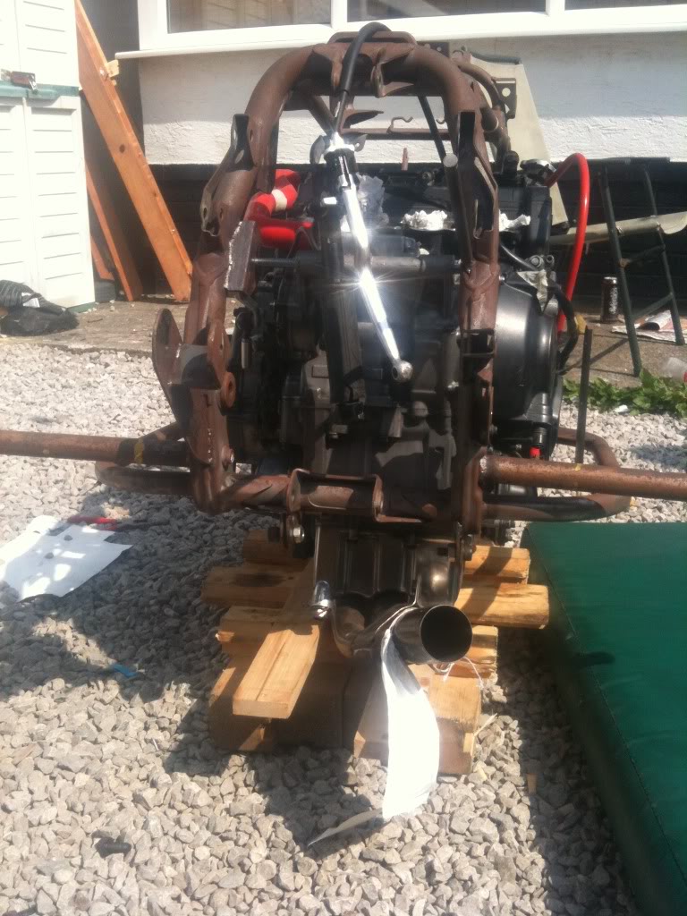

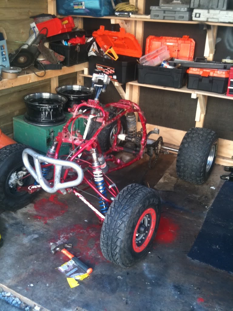

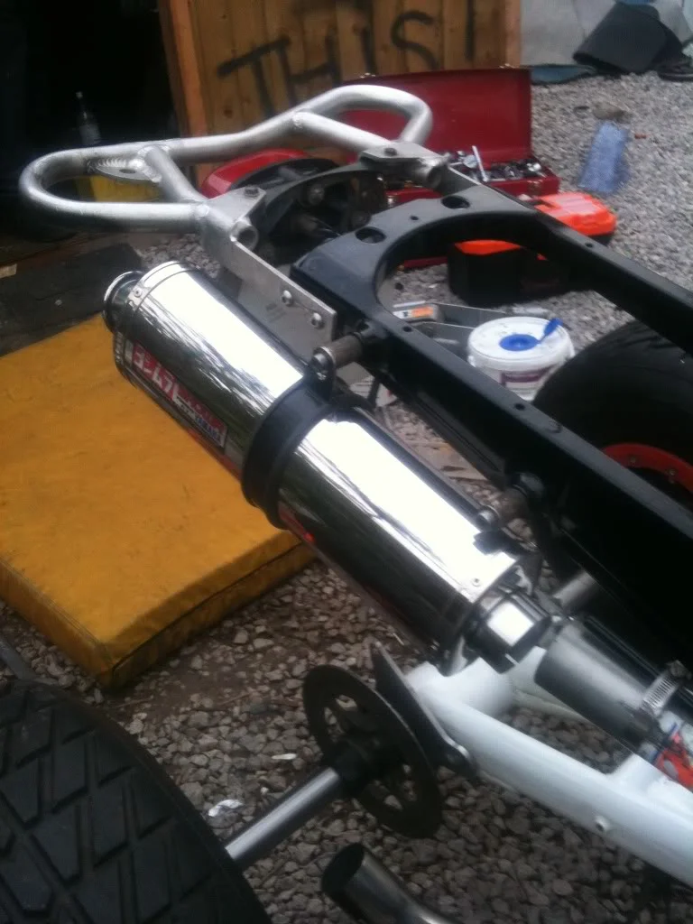

rear axle on
she will be finished off being built next weekend....hopefully :)

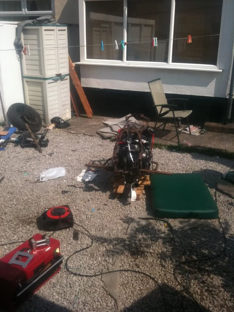

right well this weekend was fun, the clock is wired up ( what a ball ache, the plugs was smashed so we had to wire each one up one by one :( ), well we tried to get it started but the fuel pump isnt good enough its shootin out 23 psi and we need at least 42 psi from the pump, but it DID turn over with a bit of choke cleaner sprayed down the throttle body reved for 20 seconds to about 7000rpm and kicked out lots of flames :)
