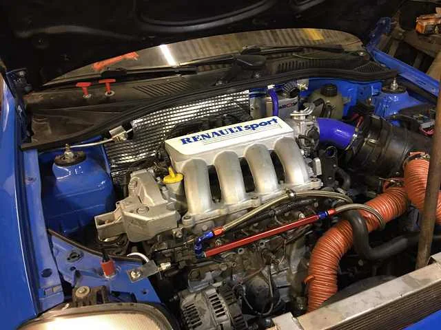

Airbox and ducting is all back on now and we managed to sort the steering out after removing the column.. such an annoying job.
The tracking is miles out now though due to the spline obviously not going back in the same place, so that needs doing again now.

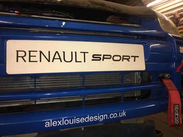

Also Alex put some stickers of her new re-branded website on the car. Free advertising...

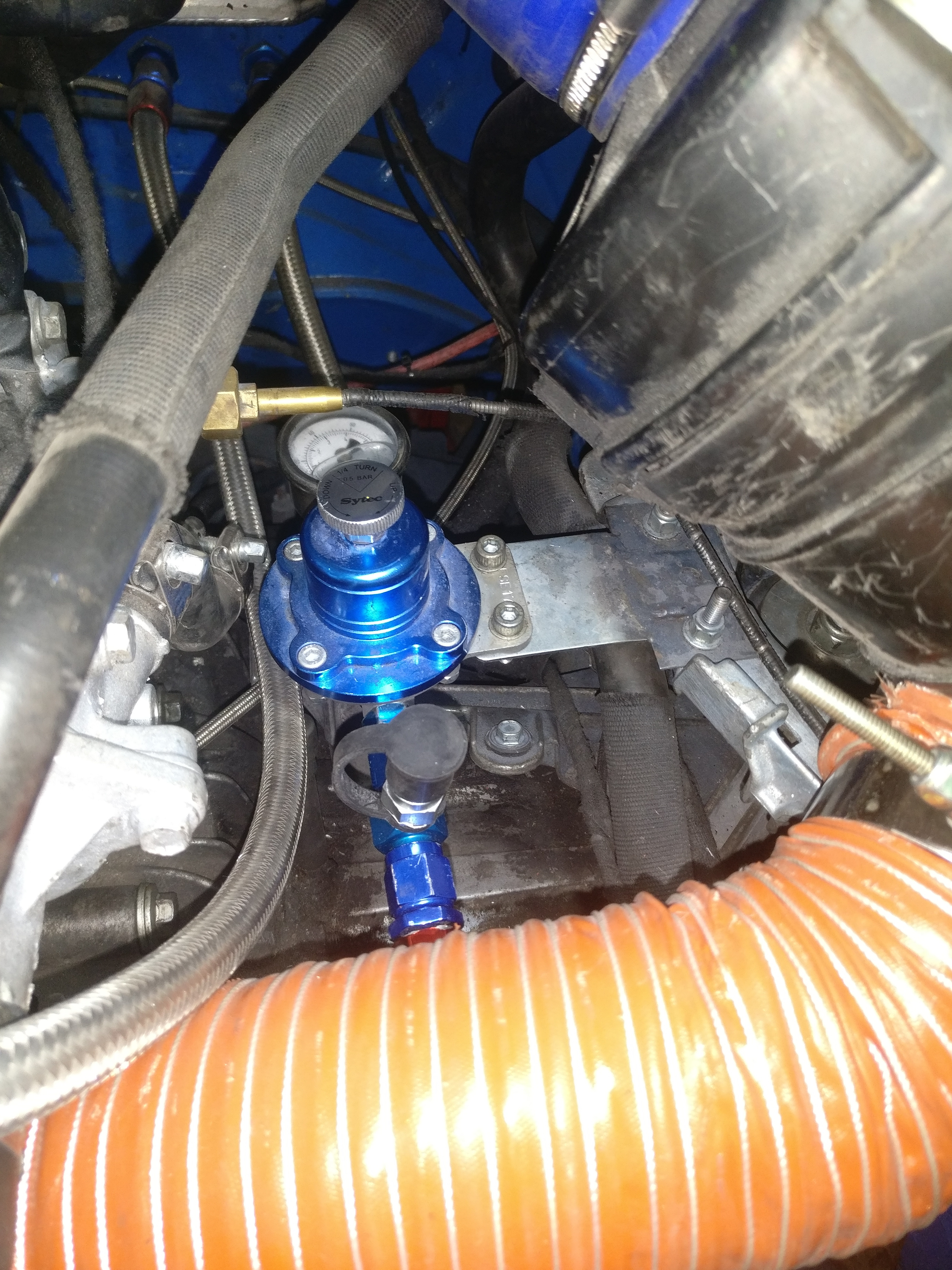

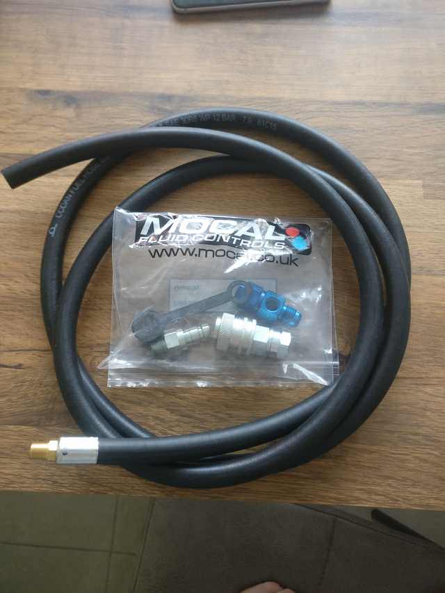

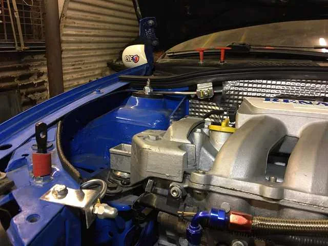

Now the car's back to where it was before, I decided to buy a Fuel Sample kit to meet blue book regs. I opted for a Mocal one from DemonTweeks and bought it through Mark Jones. Placed the order at 4:30 yesterday and it arrived this morning at 11am. Cracking service as always.
Think I'll fit it next to the regulator as it should fit nicely there rather than on the end of the fuel rail either side.
Could of saved yourself some money. Fuel sample is not mandatory ? handy to have mind but I know they’re not the cheapest things in the world

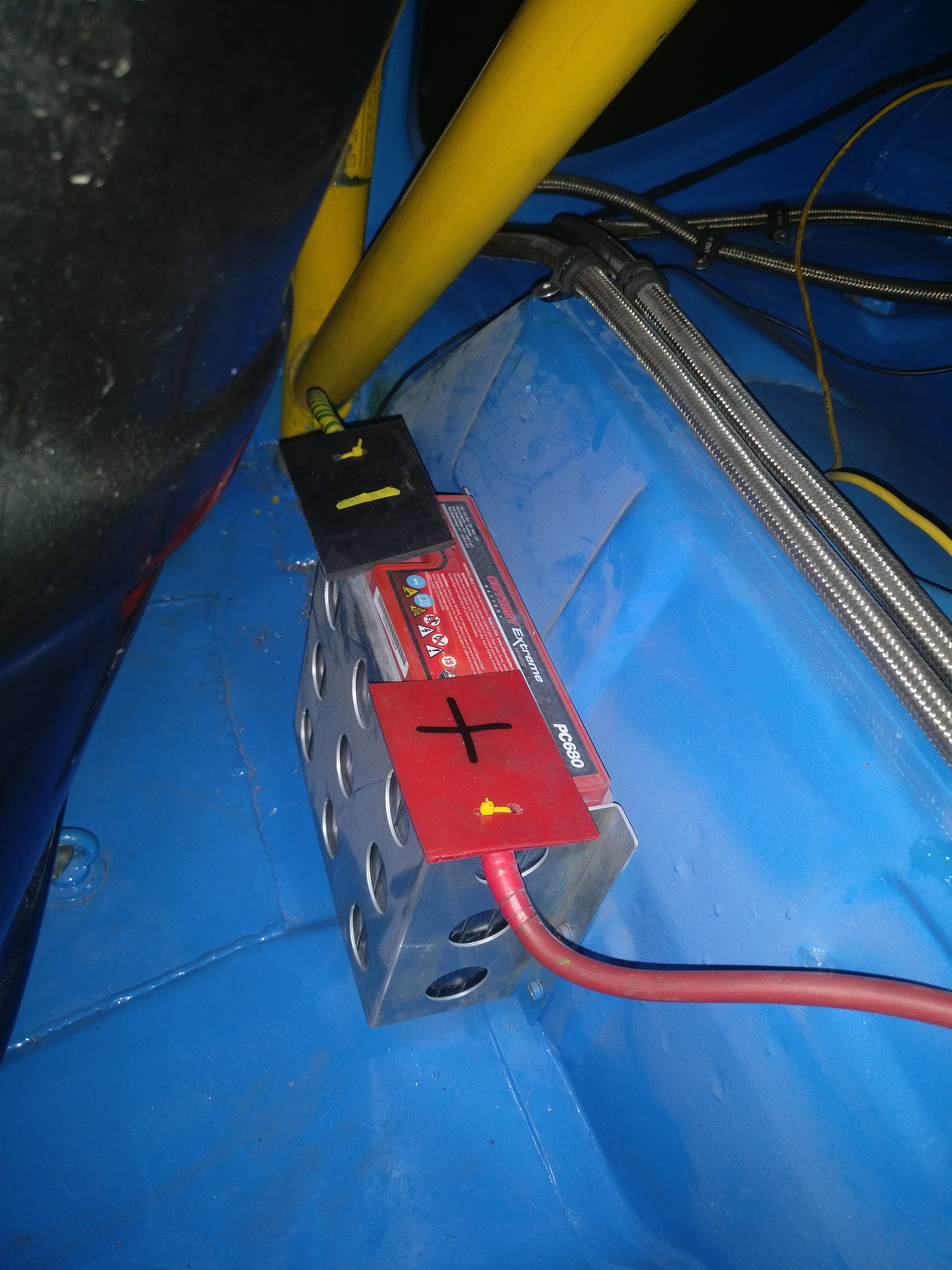

Terminal covers for the battery (required in blue book rules for positive terminal)

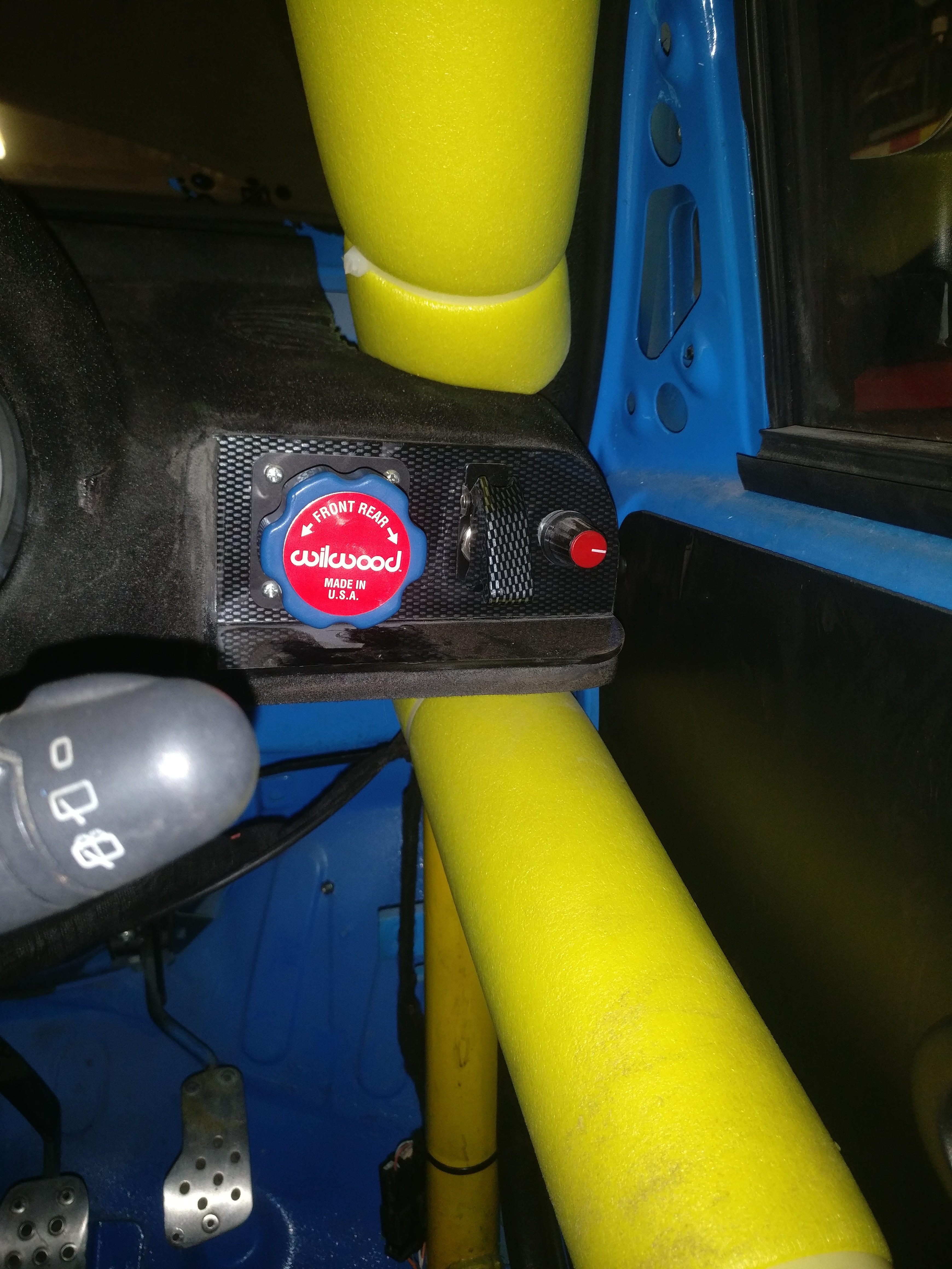

Adjusted the bias towards the front more today as the rears kept locking up at Curborough when we were out last. And stuck my pretty sticker on finally...
Mocal Fuel sample kit... Have also assembled the sample hose and will put it in my race suit bag so I never forget it at an event.

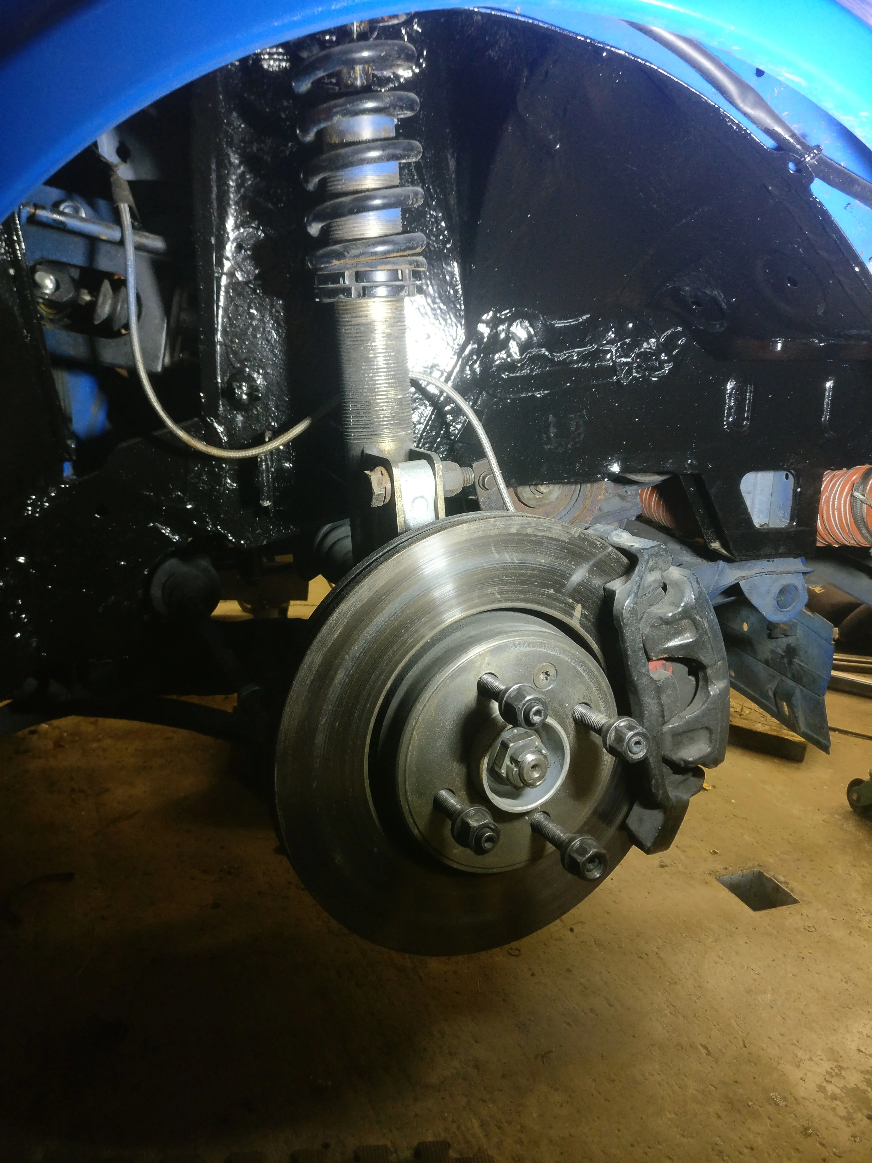

Also de-rusted and painted both front arches in black hammerite to make them look a bit smarter...

You're supposed to have terminal covers? I didn't know that. Scrutineer never mentioned it when he looked at my car.
Yeah I think so. Mine got logbooked with out them and 1 rally with nothing on them until the last event. My co driver has built plenty of cars and he said for me to cover them. Transit van covers fitted mine ?
Yeah it says somewhere it should be protected from things shorting out on it. I suppose it just depends on what scrutineer you get as usual ?
I just ordered some cheapy covers off eBay. If I find anything else that's wrong with mine, I'm just going to scrap it lol
Been the rule as long as I have been rallying. Even in road rallying you have to have them covered as we always had to use insulating tape!
You've obviously studied the blur book more closely than I have lol. Saying that, I know plenty of cars running without them.
Blur book is just so confusing. Just been told off at scrutenering a few times lol. Them ebay covers are a neat little idea though!

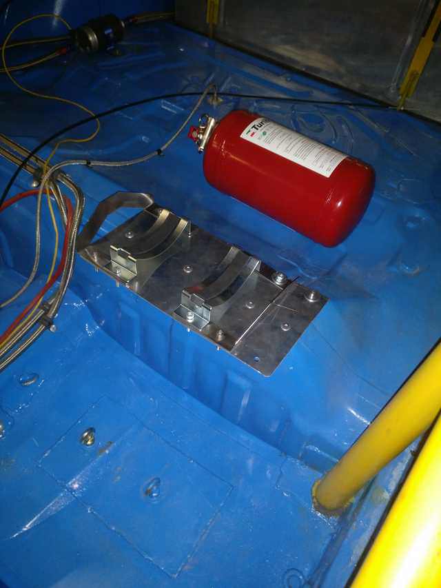

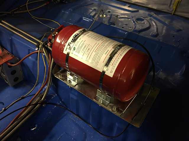

Car wise the old plumbed in extinguisher has been removed and we bought a new FIA Approved OMP Sport System with the 6 nozzles. I made a mounting bracket for it over the last couple of evenings which turned out looking quite good and sturdy.

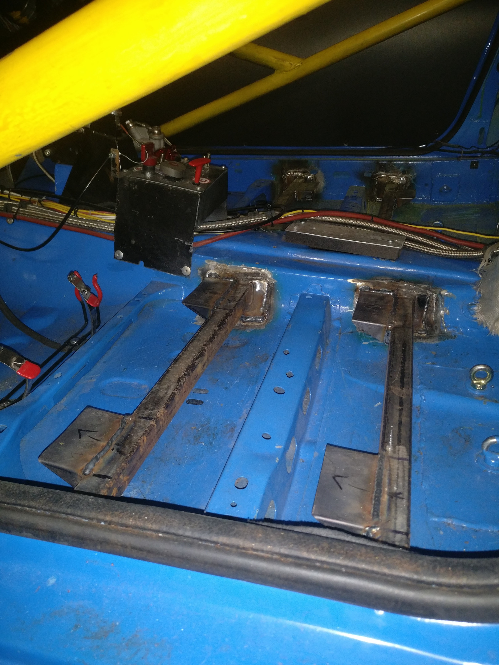

Also ground all the seat rails out to be replaced so that they can be welded properly this time... What a ballache that job was.

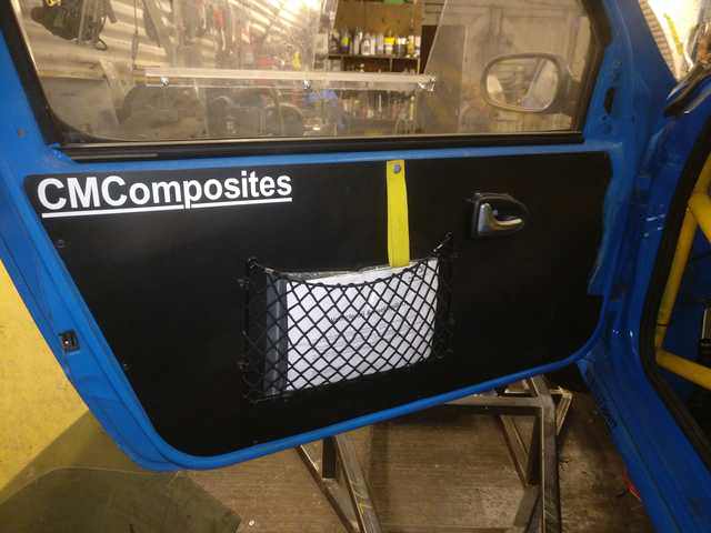

Also got a map pocket which has got our spill kit in for now until I figure out where it'll live for ever.
I think todays jobs will be figuring out where to have the extinguisher nozzles mounted and pipe it all up.

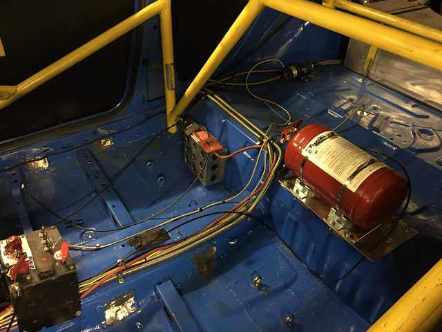

Made a start on plumbing it in earlier, had to modify our extisting brackets to start with then bend and cut the pipe to suit. Also made another bracket that points a nozzle at the fuel rail area/front of the engine.
Can just see the three nozzles, two where they were before and one on the drivers side front.

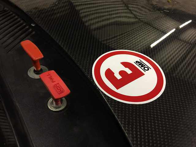

New sticker for the Carbon bonnet and new posh OMP pull cord...
Just got to mount the inside nozzles somewhere and pipe the inside up, and run a pipe to connect what we made in the engine bay today ?

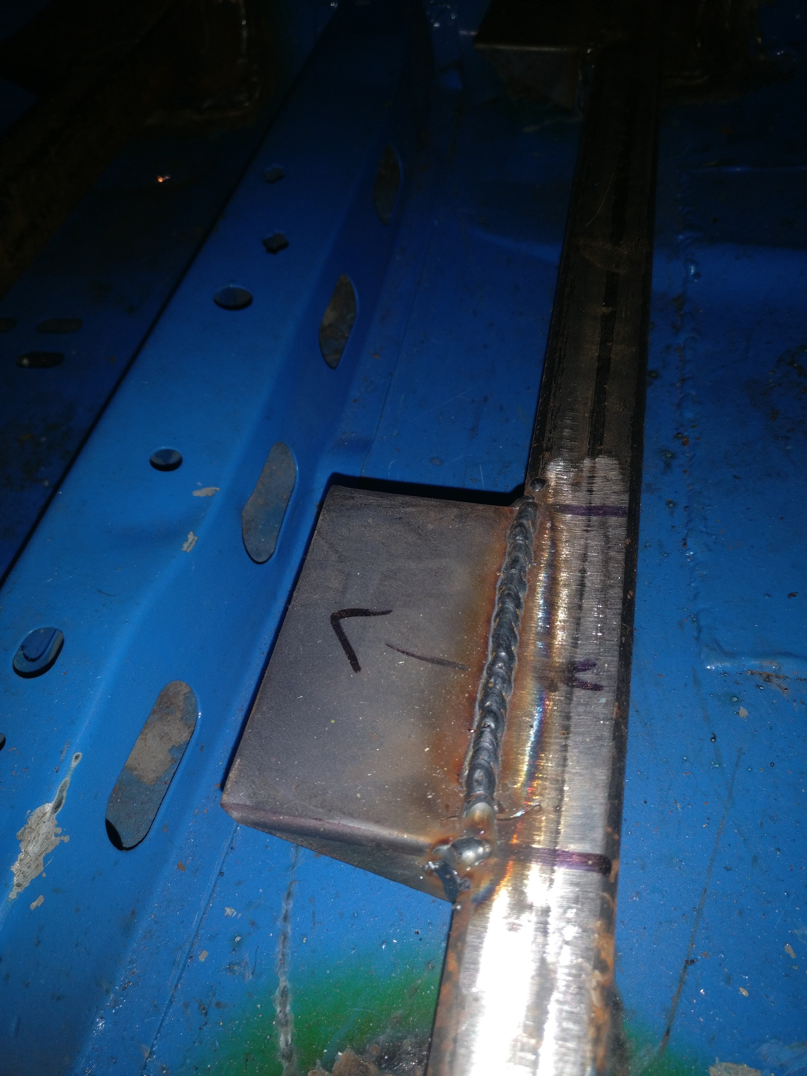

New seat rails are welded in place now... underneath this time also! Excuse the broken camera quality...

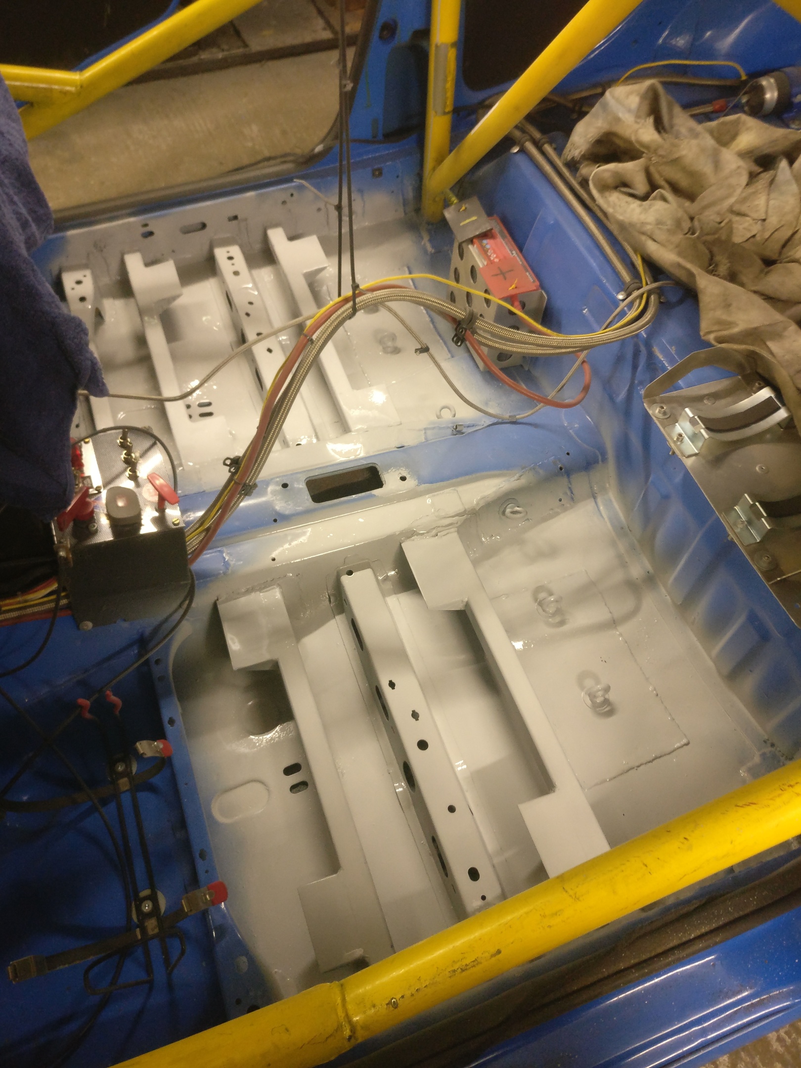

They've also been primed up ready for re-painting most of the floor now too to tidy it up again.

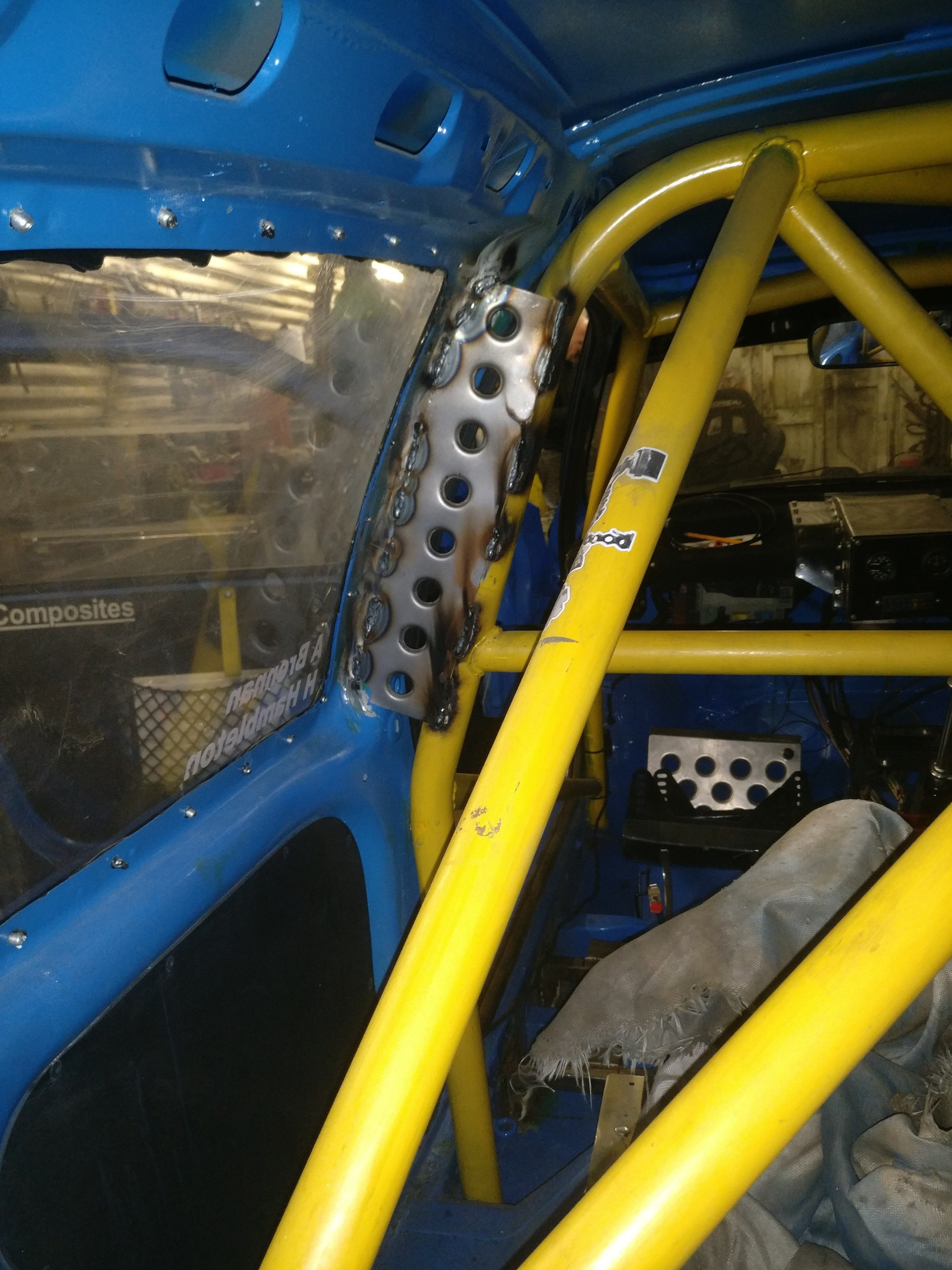

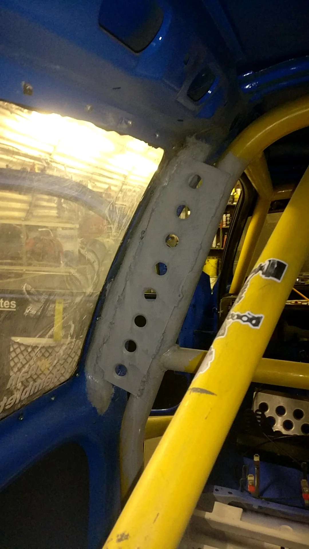

Added some B-Pillar gussets to the cage too!
And primered them up ready for paint. Cage needs tidying up in a few areas as the paint isn't the best on it tbh so will do that when we get some paint for the gussets too.

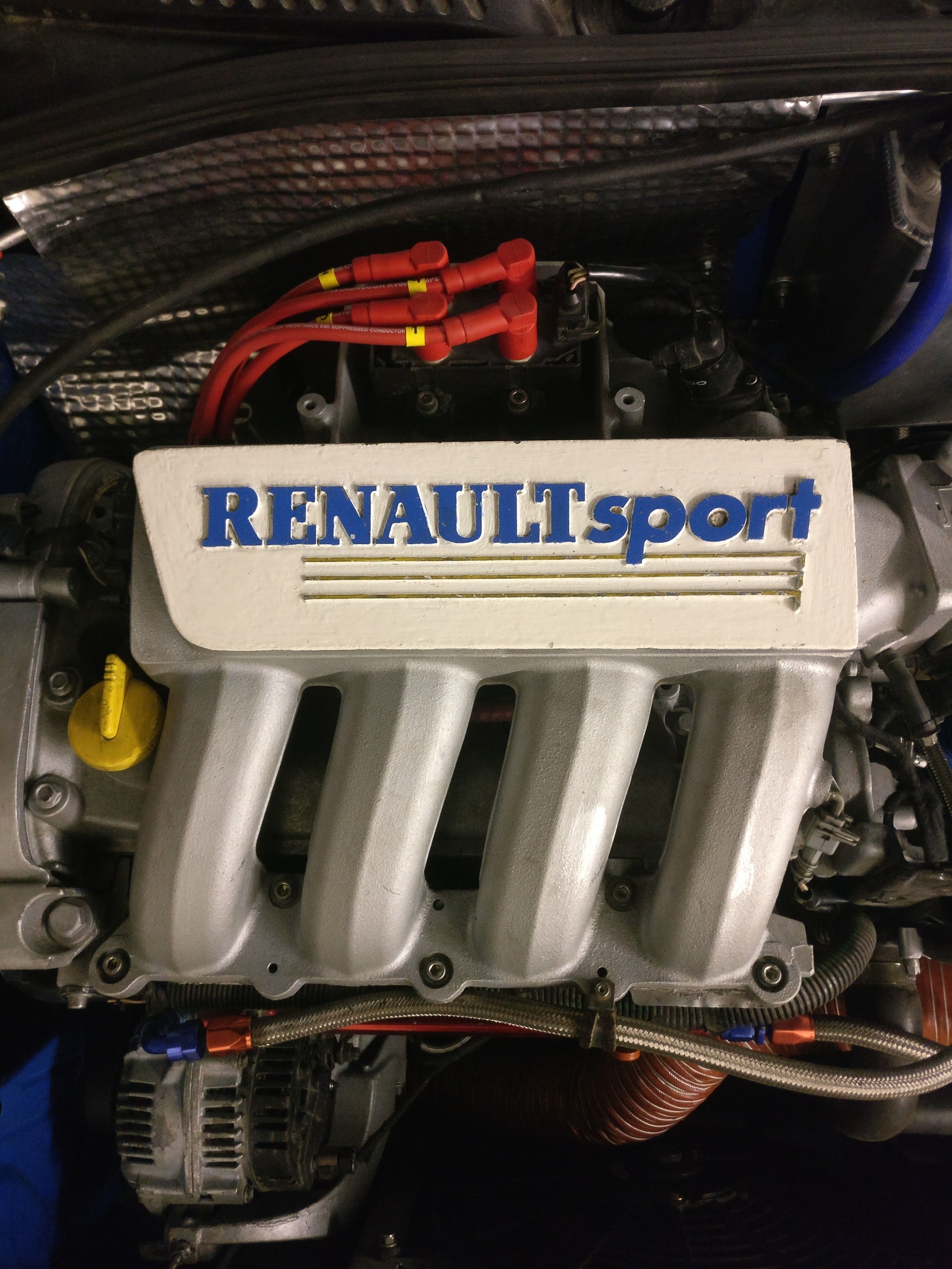

New 8.5mm Magnecor leads which were a Christmas present from Alex...

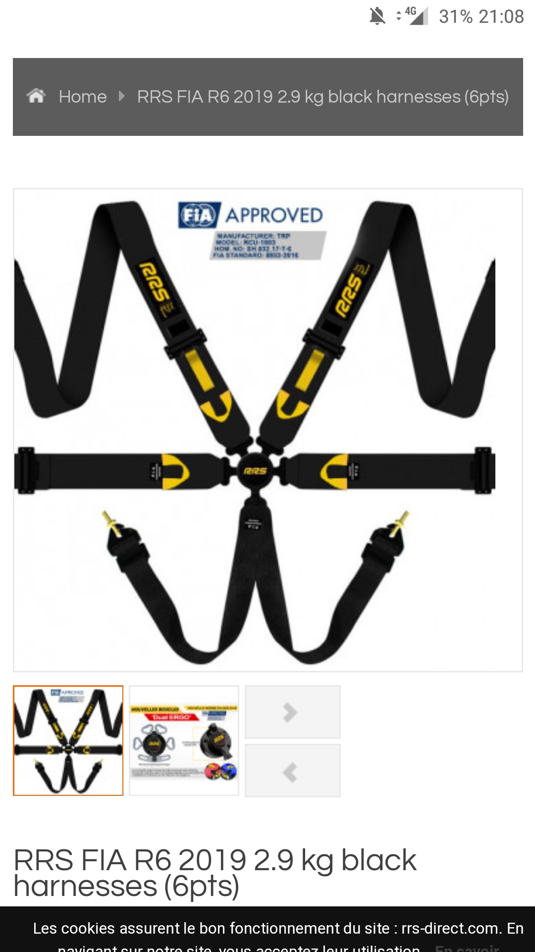

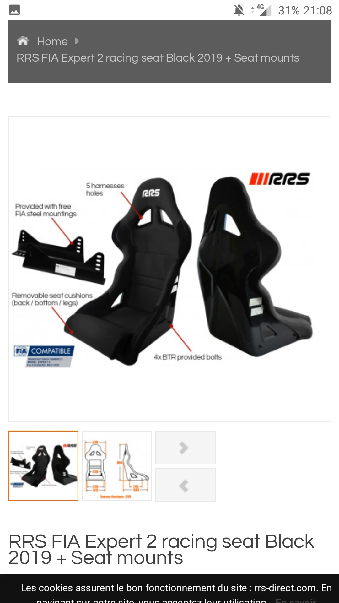

Also we've ordered our new seats and belts to replace the out of date ones. Brand new 2019 dated from RRS-France with some discount too which is a plus.
Screenshots below and they are being dispatched on Wednesday!
