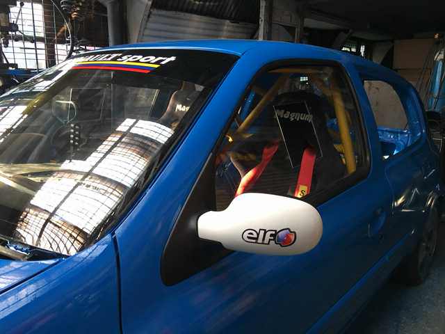

Alex painted our wing mirrors in a subaru white that was laying around in a spray can yesterday along with spraying the mirror surrounds black. Really happy with how these look now!
Also fitted a set of new plugs. Hoping these will make the car run sweeter once we eventually get it started again...

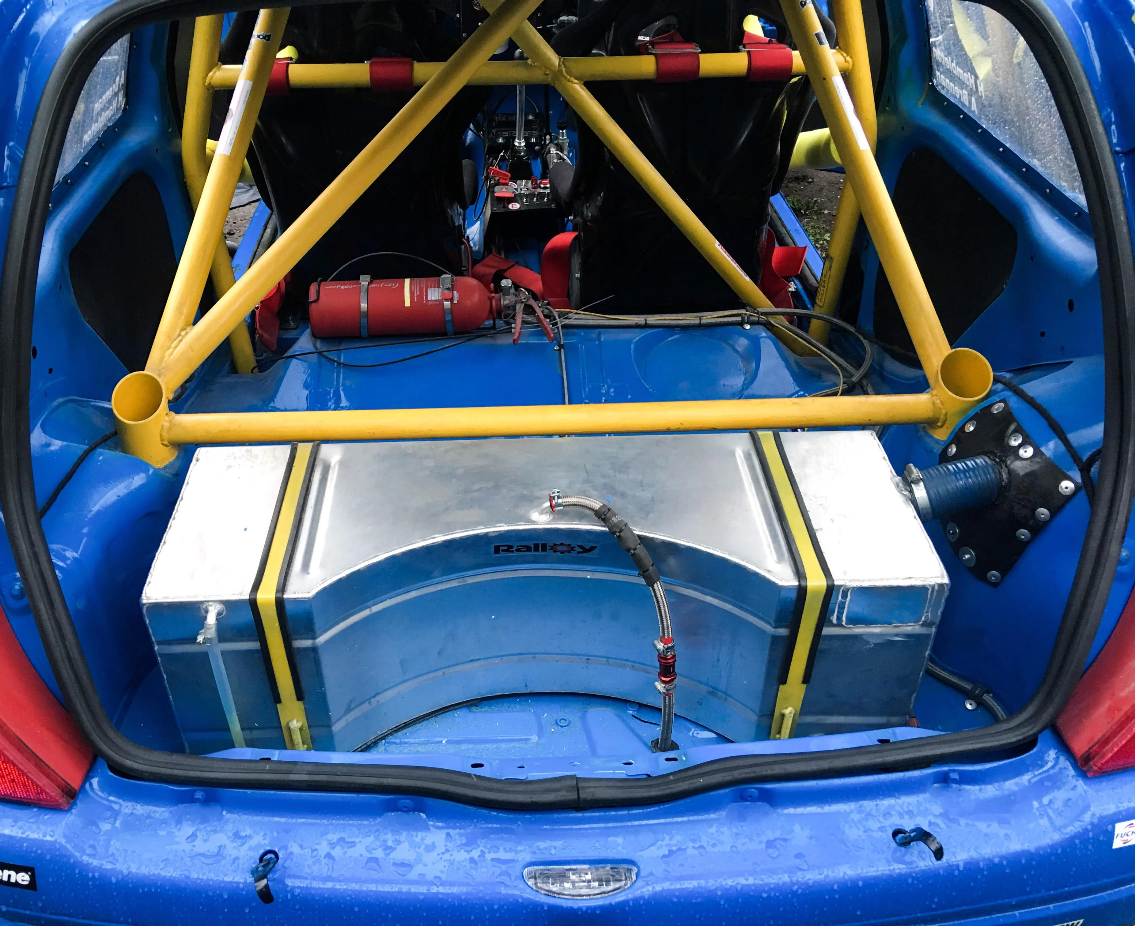

  • Extinguisher is now plumbed in with both nozzles mounted in the engine bay & pull cord connected.

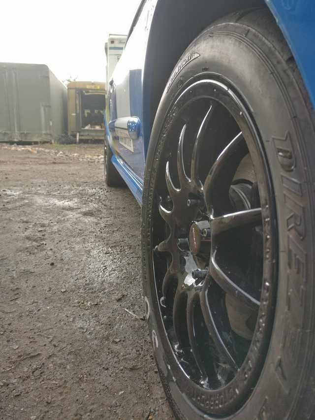

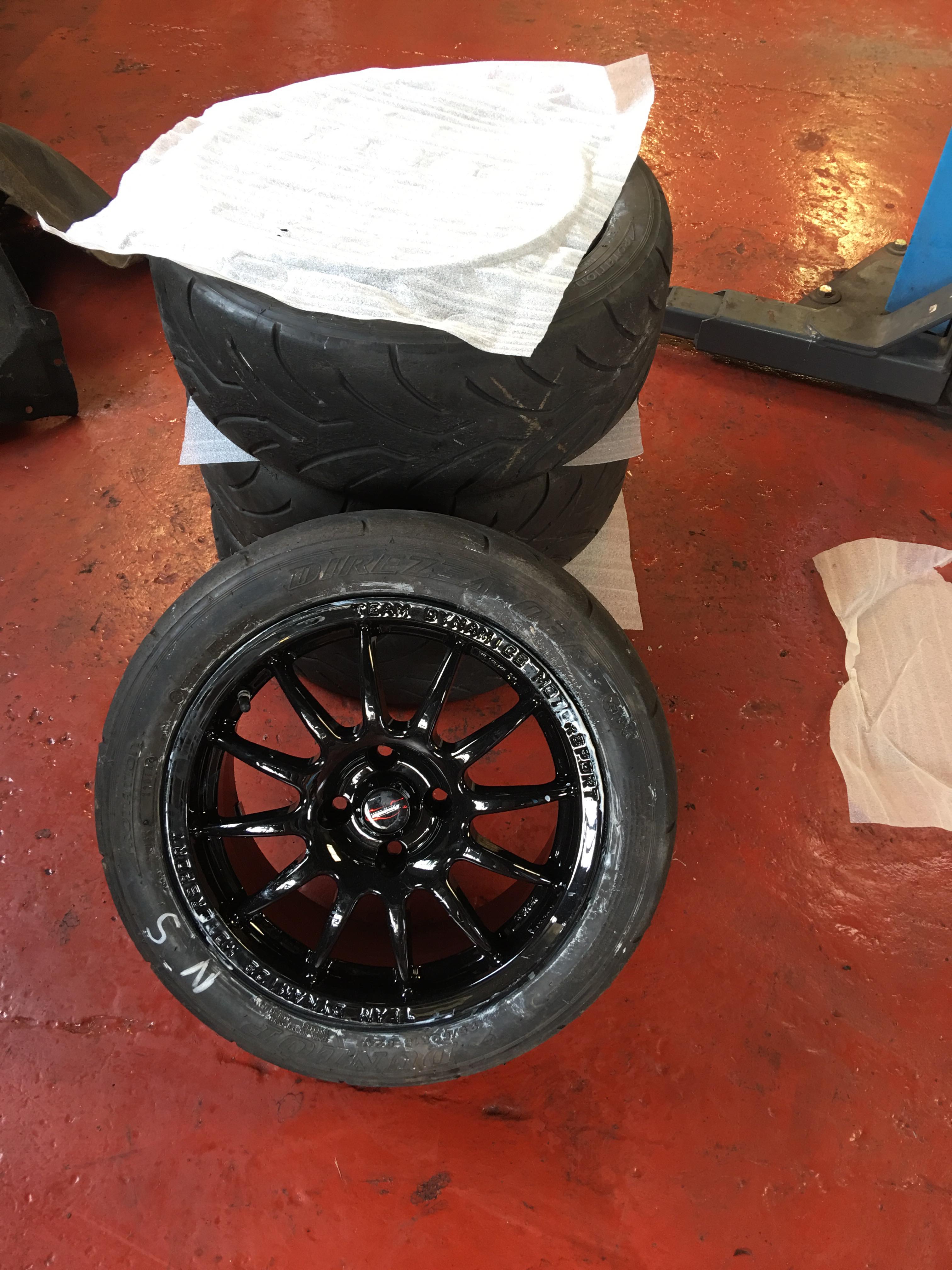

Last week we also made a purchase after getting bored of waiting for Rimstock for 14 weeks after being quoted 6! And the wheels still not having been even machined :ROFLMAO: So we cancelled that and paid a bit extra from Tweeks who delivered them next day free of charge... Can't beat that.
The only snag was we had to have black as we refused to pay an extra £150 odd for a different colour - glad we didn't though as they're stunning!
Last night I also spotted a bargain for 6 Direzzas in R1 compound local to us so off we went straight away to buy those:ROFLMAO:

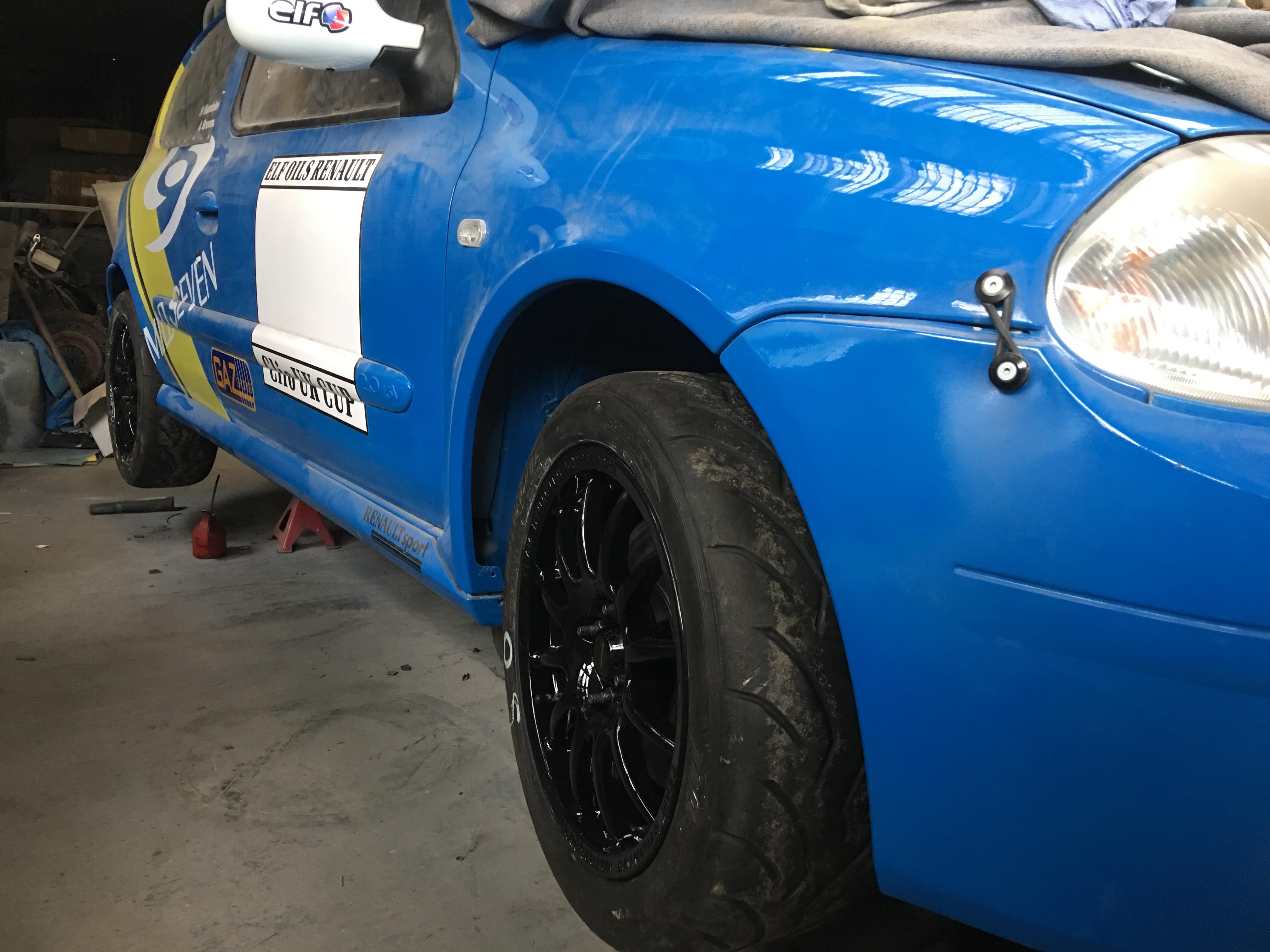

Final thing we did today apart from filler and flat down was put some quick release bumper catches on the front (to drill the holes before paint)
Need to finish rubbing the filler down next to the right shapes and then spray the car so we can build it and get it out ASAP!

Thankyou, we thought exactly the same haha. They are the gloss black yeah, the pictures on their website make them look dull but as you can see they're quite the opposite!

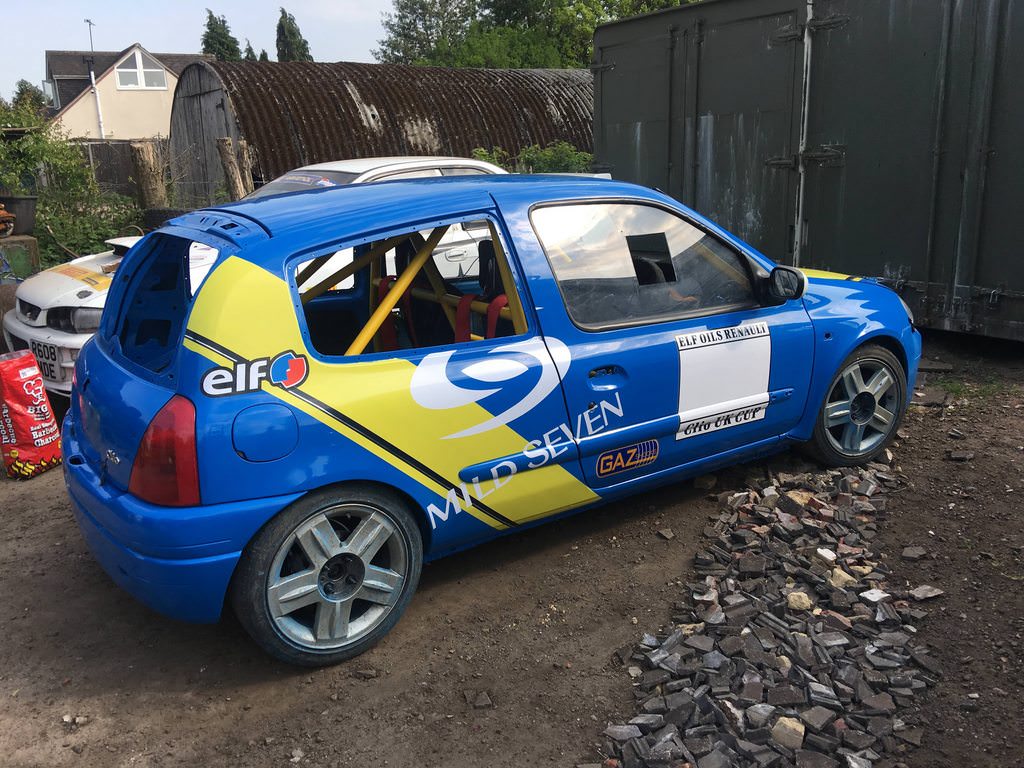

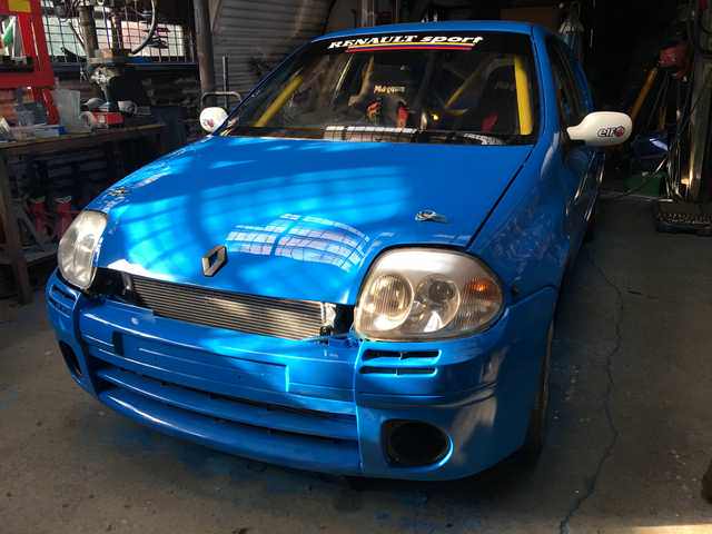

Exactly a year ago today we took the car home in the state it was in shown below...
Since then a LOT of hours grafting by a lot of people have all come together today to get it to look like this...
Looking back I can't even believe it's the same car it's actually unreal? So glad we can begin building the car again now fully to completion now. Still a lot of work needed but it's a hell of a step forward!

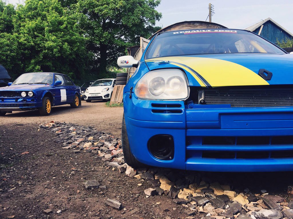

While it was being sprayed for us I refurbed the headlights as they were yellowed and would ruin the look of the new paint. Pic below shows a before and after.
Funny enough got my car almost exactly a year ago myself!! Good progress is very satisfying! Good work mate! Love the colour!
Brake cooling ducts are now on as well as front and rear lights.

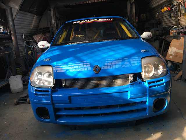

Next big job is wetsanding the entire car down to remove orange peel and then polishing it up to perfection! I've treated myself to a DAS-6 PRO DA polisher and some Menzerna compounds - which sound like they'll be up to the job!

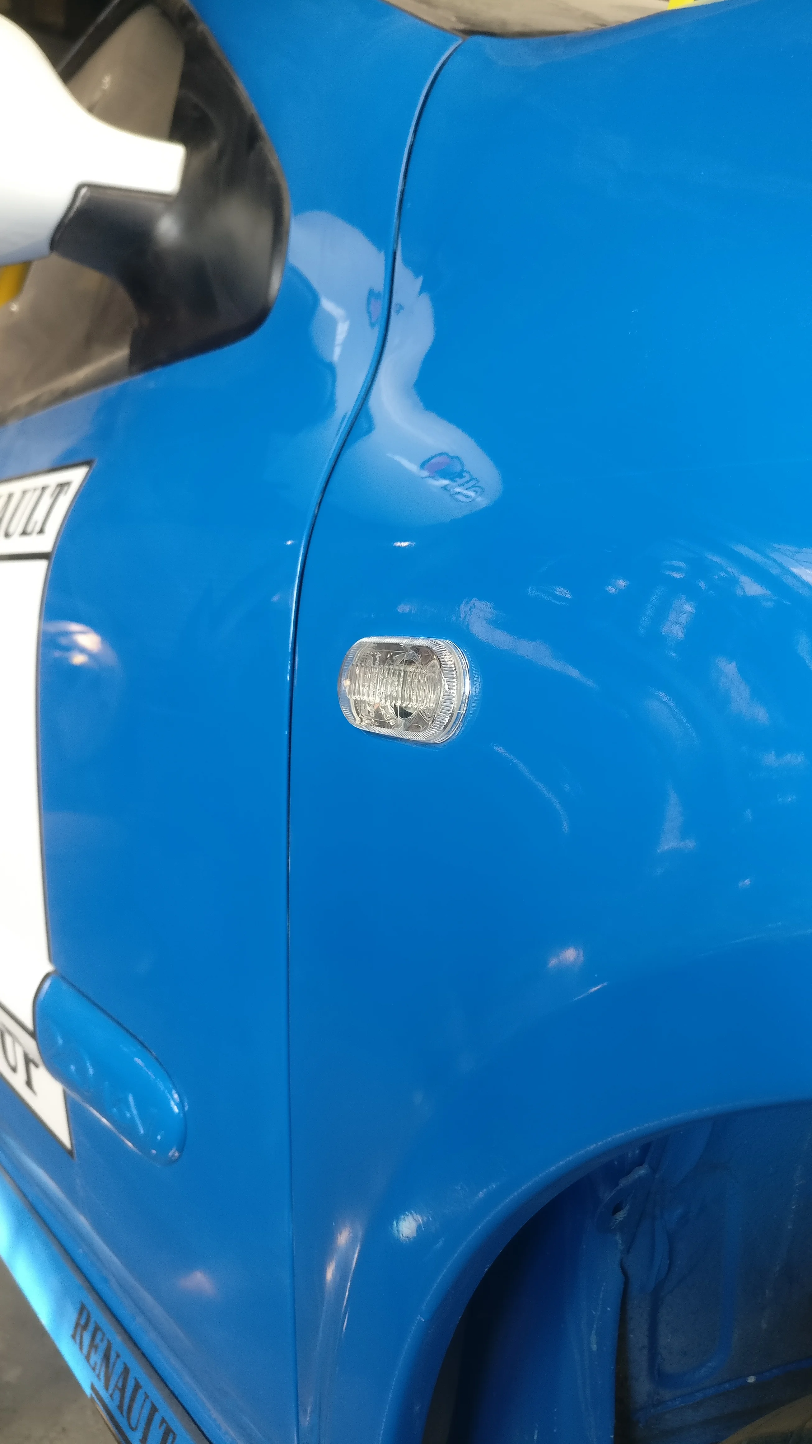

The entire car has been wetsanded and polished now so there is no more orange peel anywhere and it's even glossier now. Need to go over it again with finer compound but leaving it until we can work outside in the sunlight as we're bored of polishing for now?

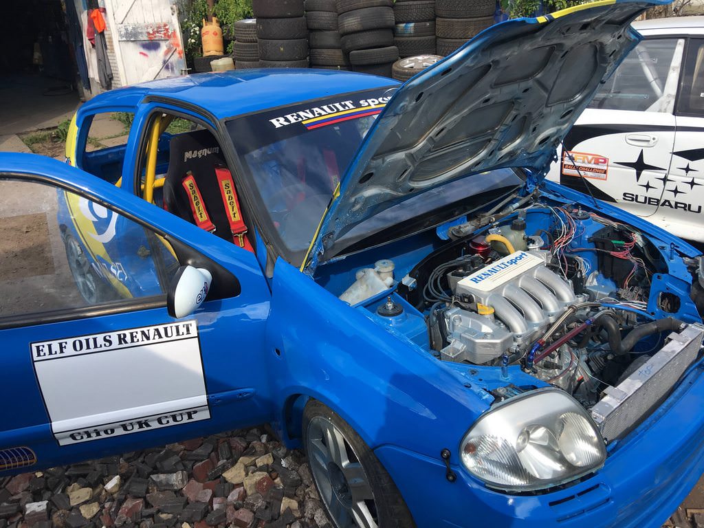

Today we put the door seals and window rubbers back in along with bolting in our homemade front polycarbonate windows with self fabricated brackets.
The wing mirrors are back on, the sunstrip is on and the bonnet pins are back in. It finally looks like a car again ?

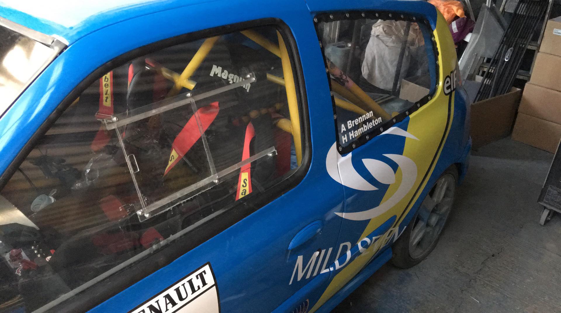

Ordered some more rivets today for the rear windows so we can fit them when they arrive along with the rear windscreen. Also ordered some slightly longer bolts for the window sliders as the supplied ones we're way too small.

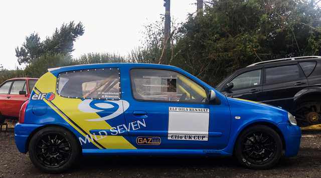

Begun putting the stickers on the car yesterday, managed to get the main parts of the drivers side done and the bonnet. Also drove the car outside today in the sunlight and let it run for a bit for the first time ever really ? Only problems are a small water leak where it just needs a new jubilee clip and the fuel pump being so noisy it gives you a headache ?
Also did some more little things like refit the boot springs and Pete painted the rest of the parts off the car for us like the door handles, bullets and sideskirts. Next thing I'll be doing is putting the door handles back on and then the door cards ?
More stickers applied... to the inside this time
I've also fitted the slider kits we bought to both sides now so the front windows are complete!
The tailgate window is in now too after yesterday. It was a pain but we got there in the end. Doesn't look the prettiest but it does the job and was free - rather this than pay loads for a thermoformed one!
Drivers side rear window is also in now too! Can't do the passenger side yet as we need to finish off the livery that side before putting it in.
Both door cards are in along with the handles and homemade door pulls by Alex. Car's looking good ?

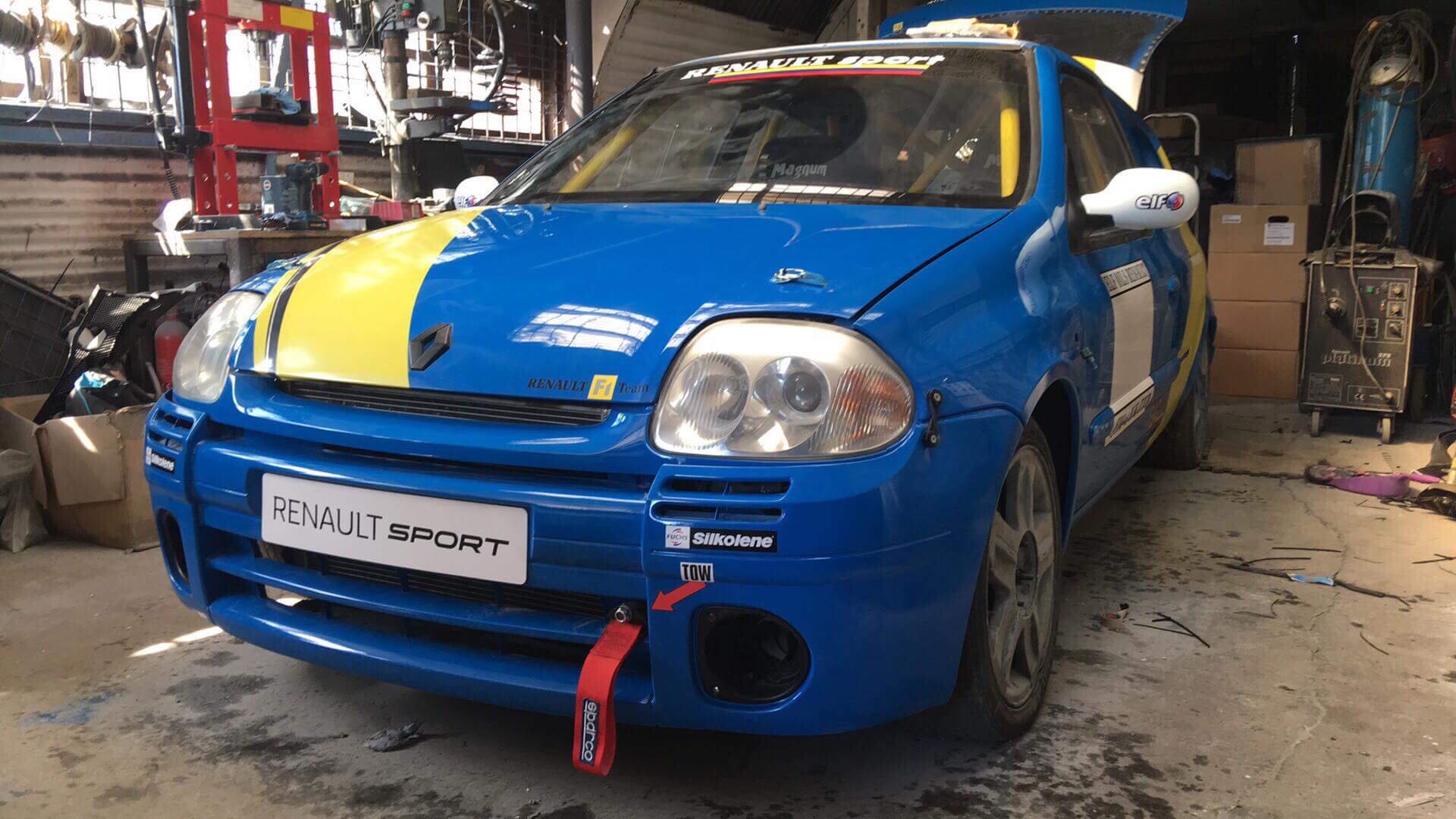

Also fitted the Sparco tow strap yesterday after Pete welded us a post through the bumper to bolt it onto. This was due to the thread in the chassis for the towing eye being rusted away and also so if we ever need to be towed our bumper wouldn't rip off as the strap would pull it around. Unlikely but it's safer this way.

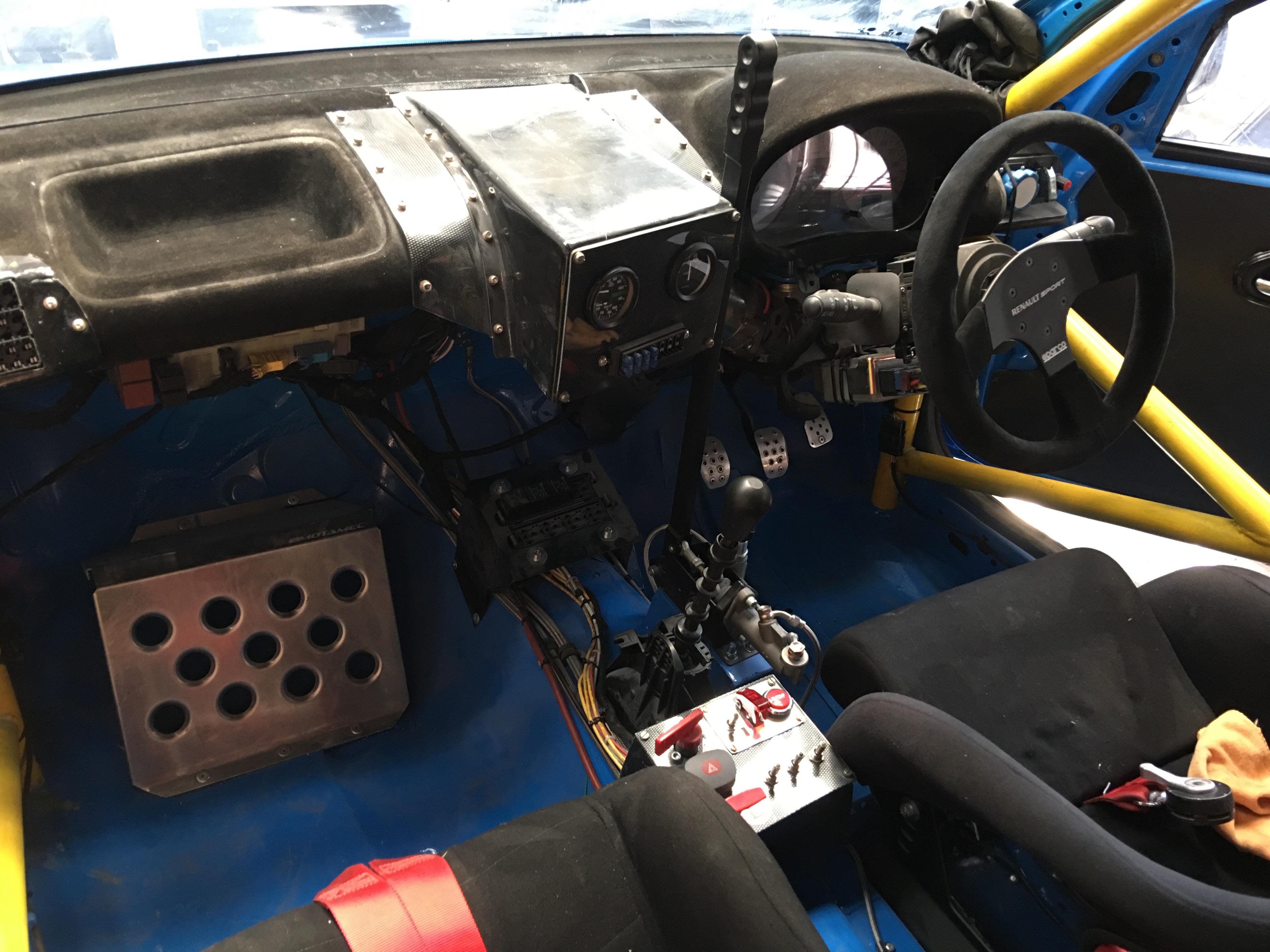

Current state of wires for the interior! Still a load to go and although there looks to be loads here there was probably double this again when we started. Once I've cut them all the redundant fuses and relays will be removed also and t hen the entire loom will be taped up like the engine bay.

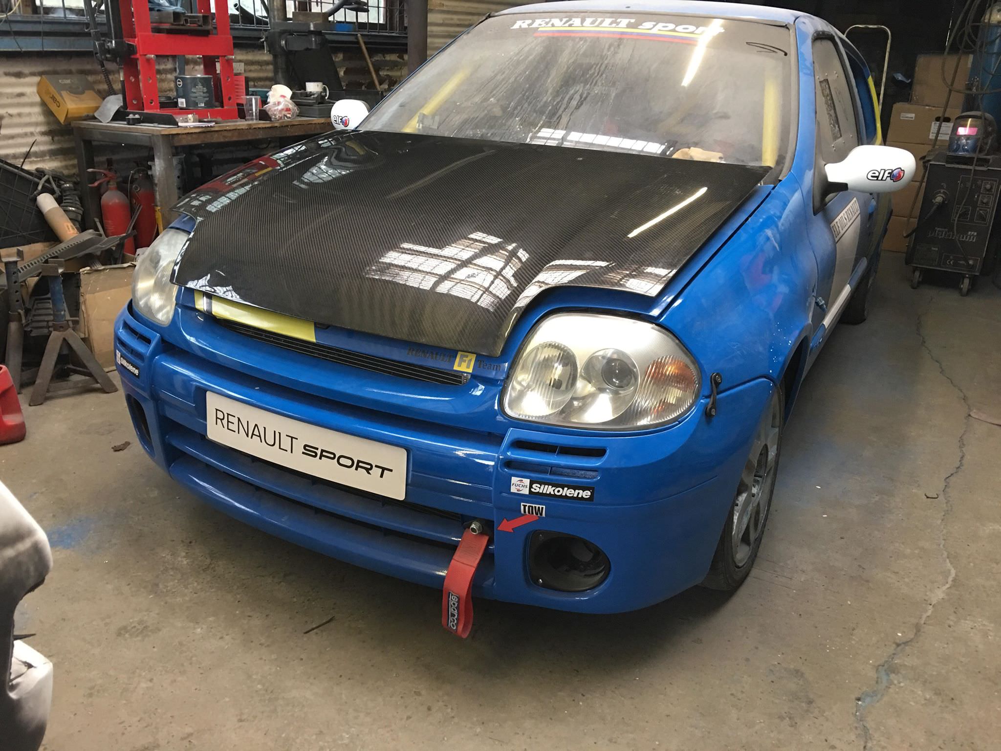

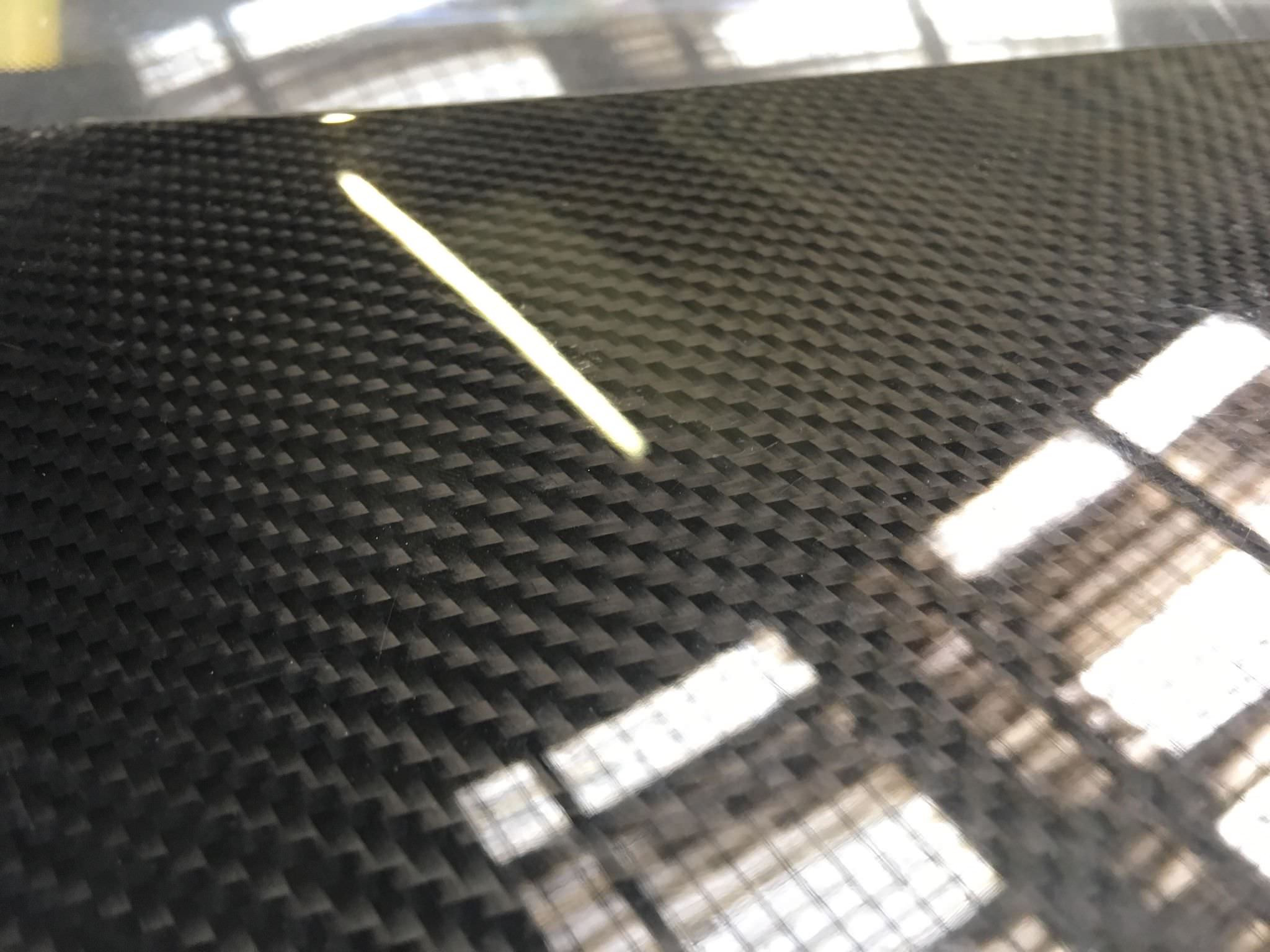

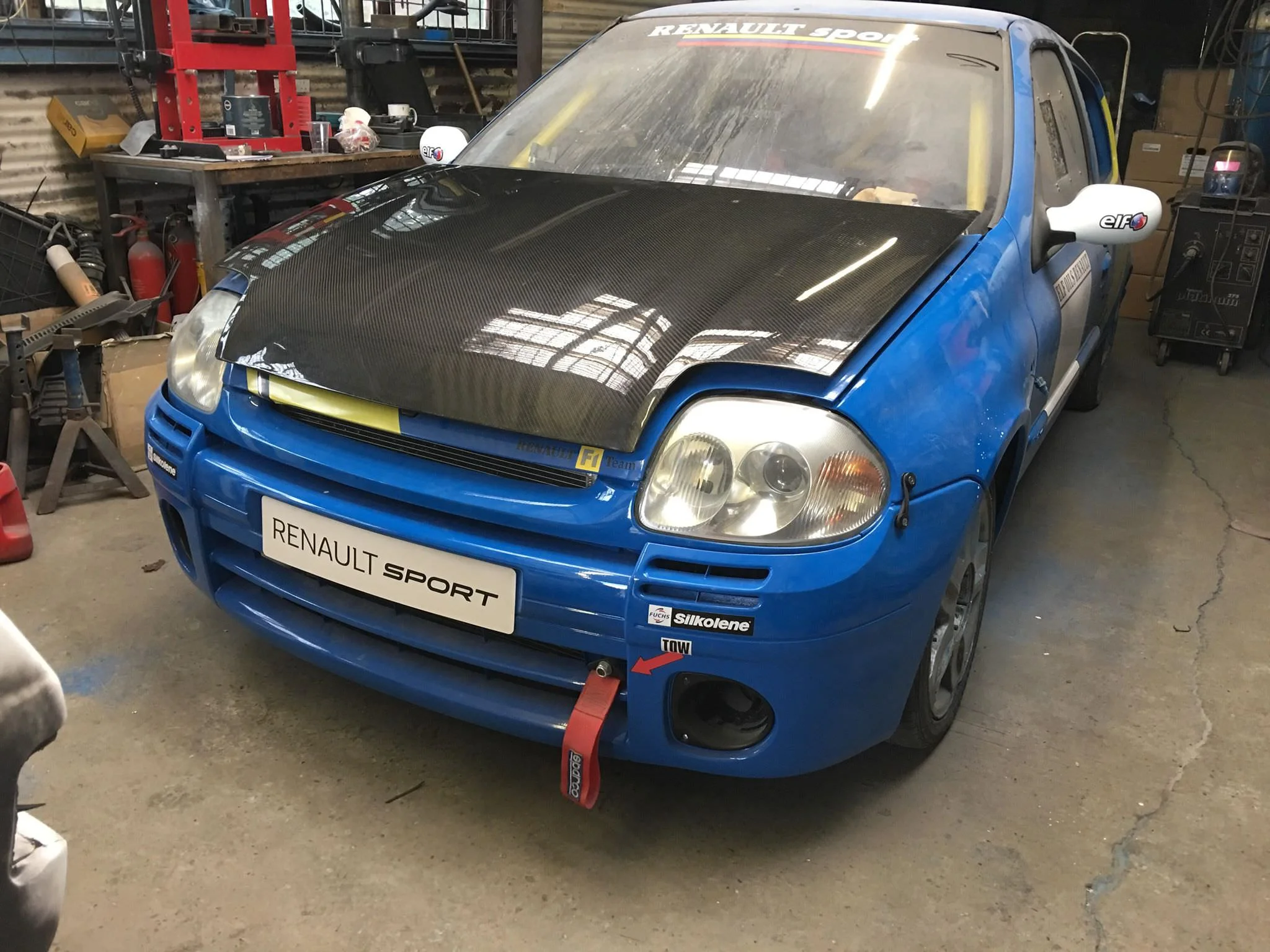

Picked up the carbon bonnet yesterday and placed it on the car to see what it looks like. We think it'll look awesome once it's got some stickers matching our livery on it - bargain!

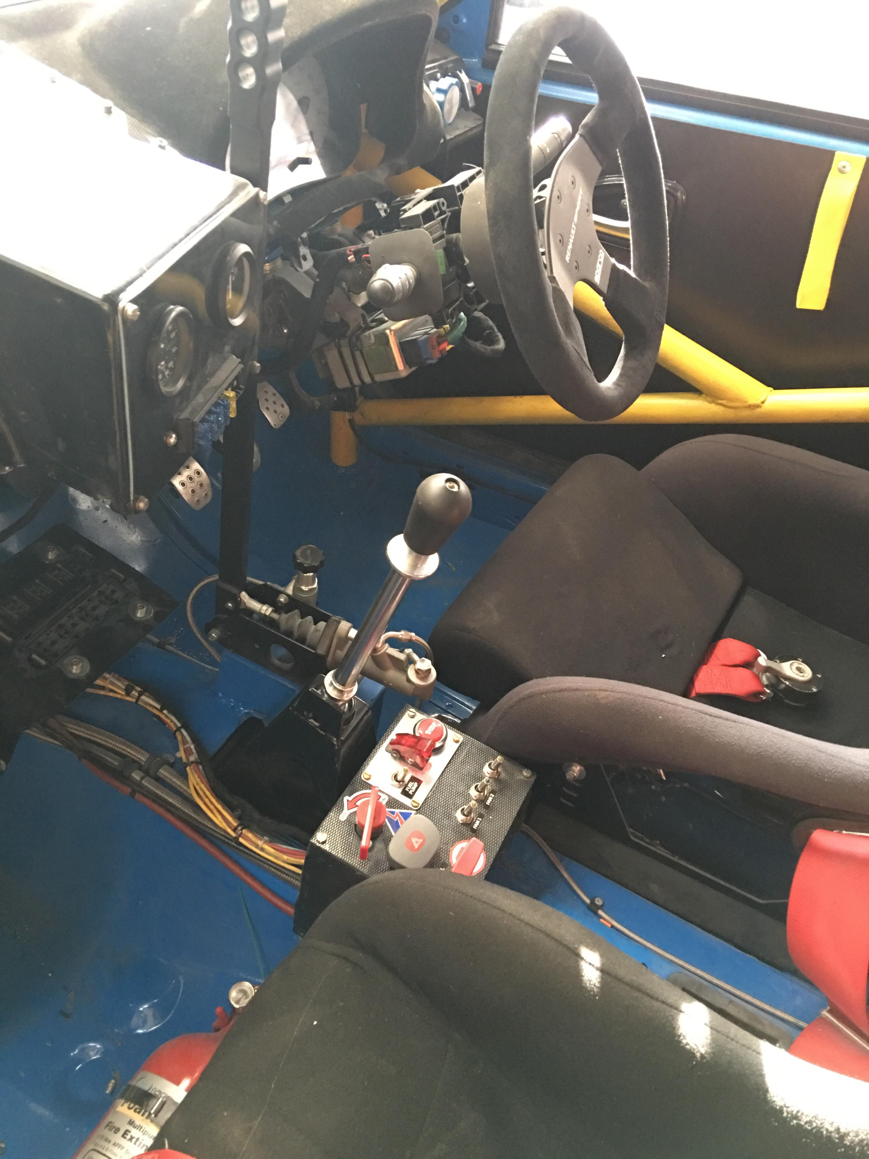

Also finished cutting plugs off the interior loom yesterday and managed to depin all the wires we'd cut so far. My job tomorrow is to pull any unused fuses we've missed using a diagram and cut those wires too! There's hardly any now ?
The entire loom is cut down fully and has been re-wrapped in loom tape and tidied away now so the inside looks like a car again. Alex did most of this yesterday while I was at work. While I was gone she also gave the car a good clean, fitted the last window to go in on the NSR and then finished putting all the stickers on along with the NS side skirt.

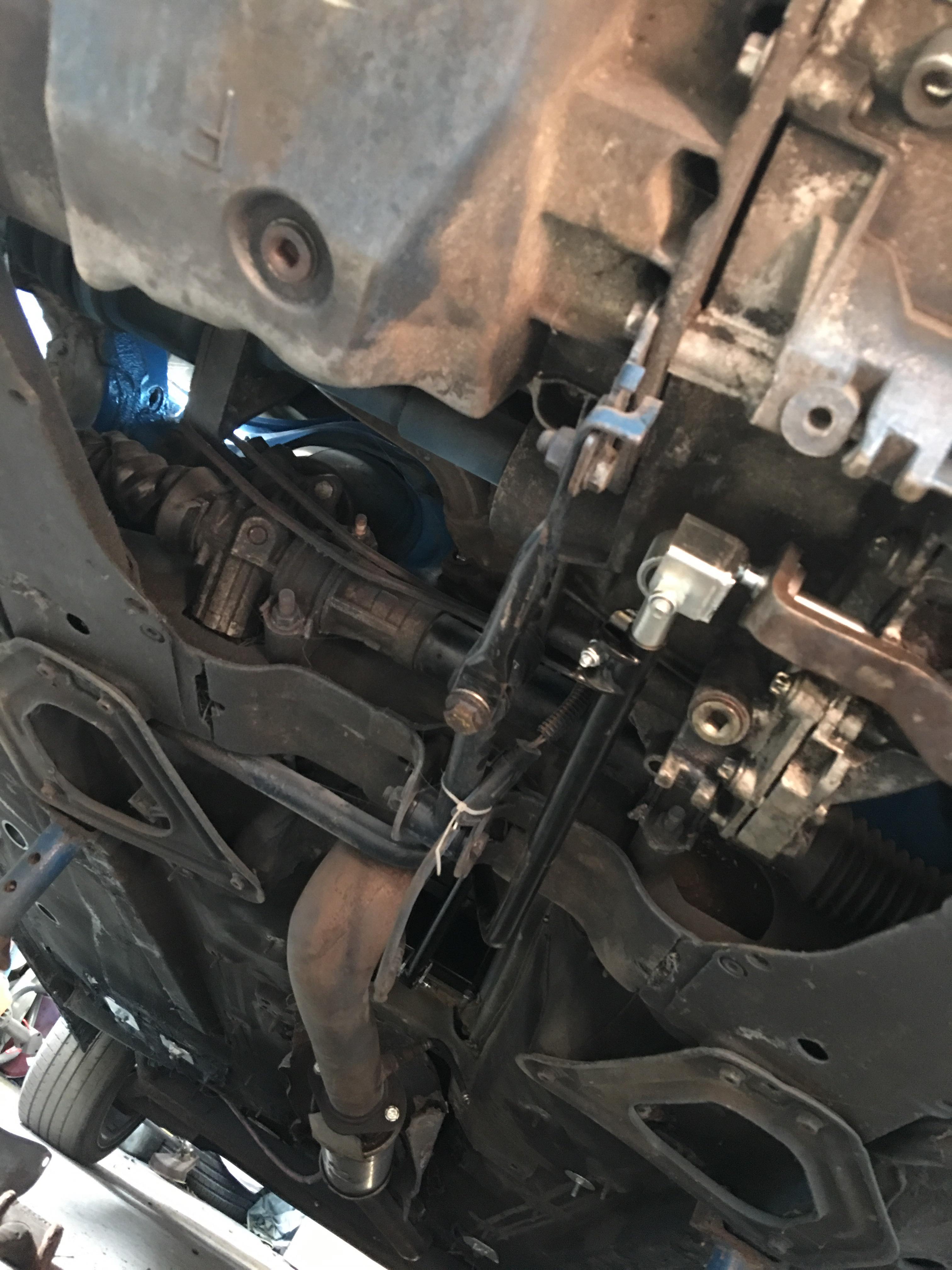

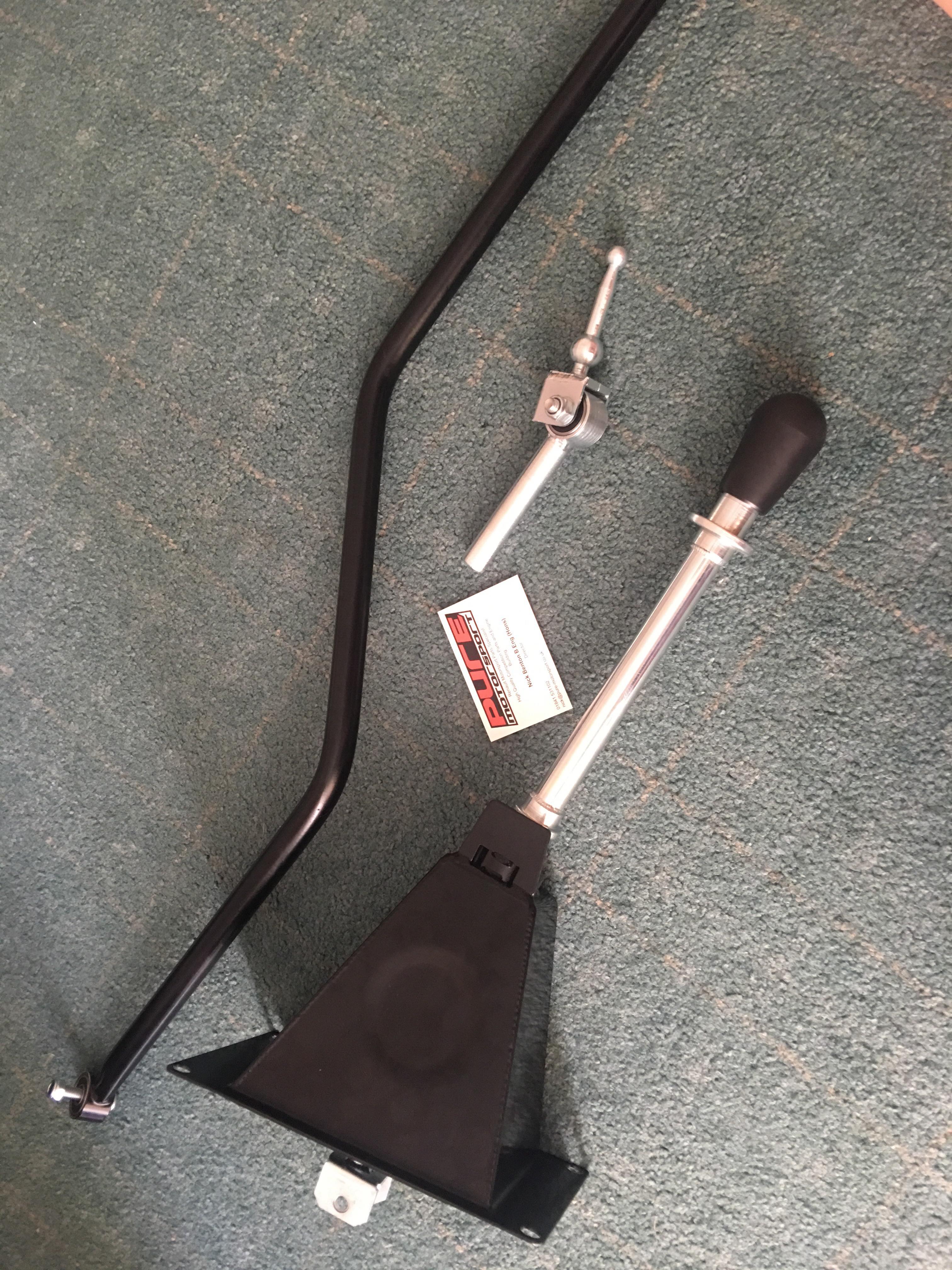

We're also awaiting delivery of a PMS Shifter kit which will hopefully be with us at the end of this week as one of Alex's birthday presents from last week ?

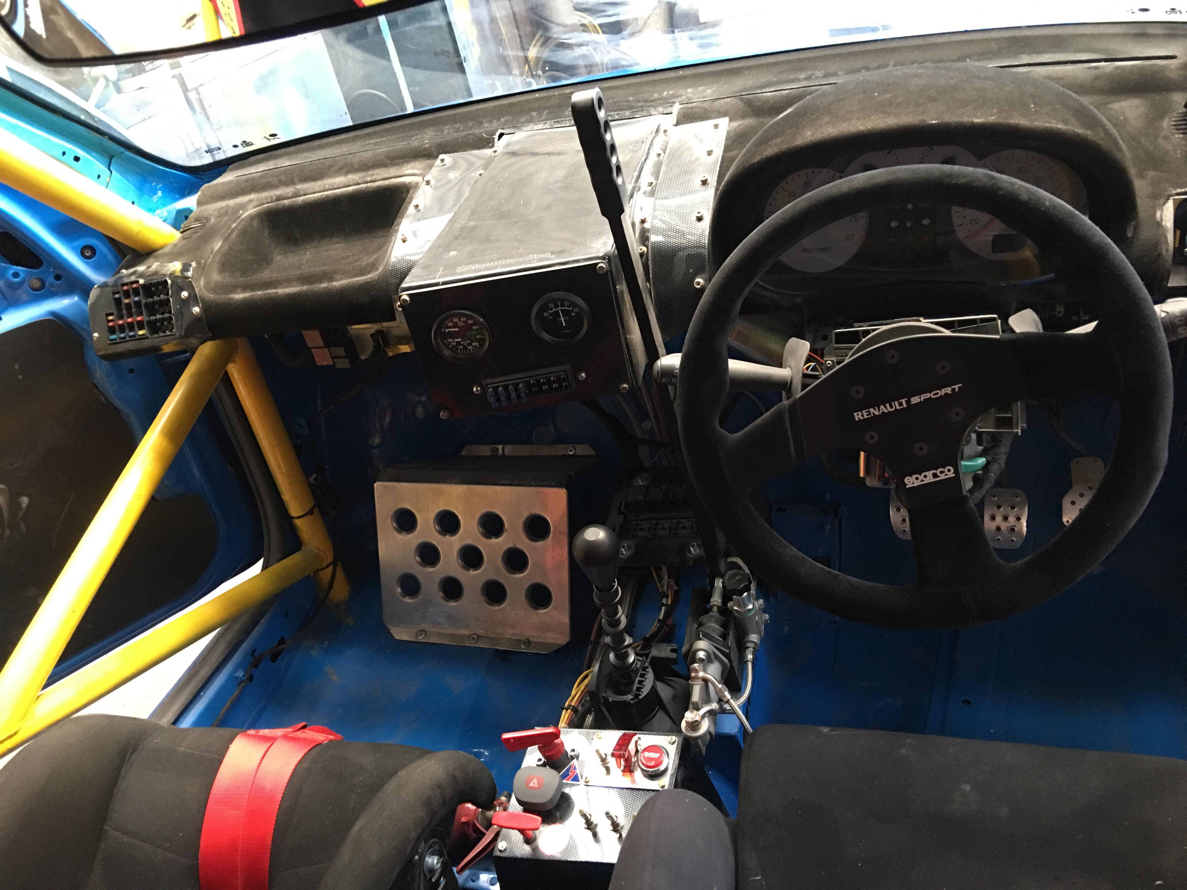

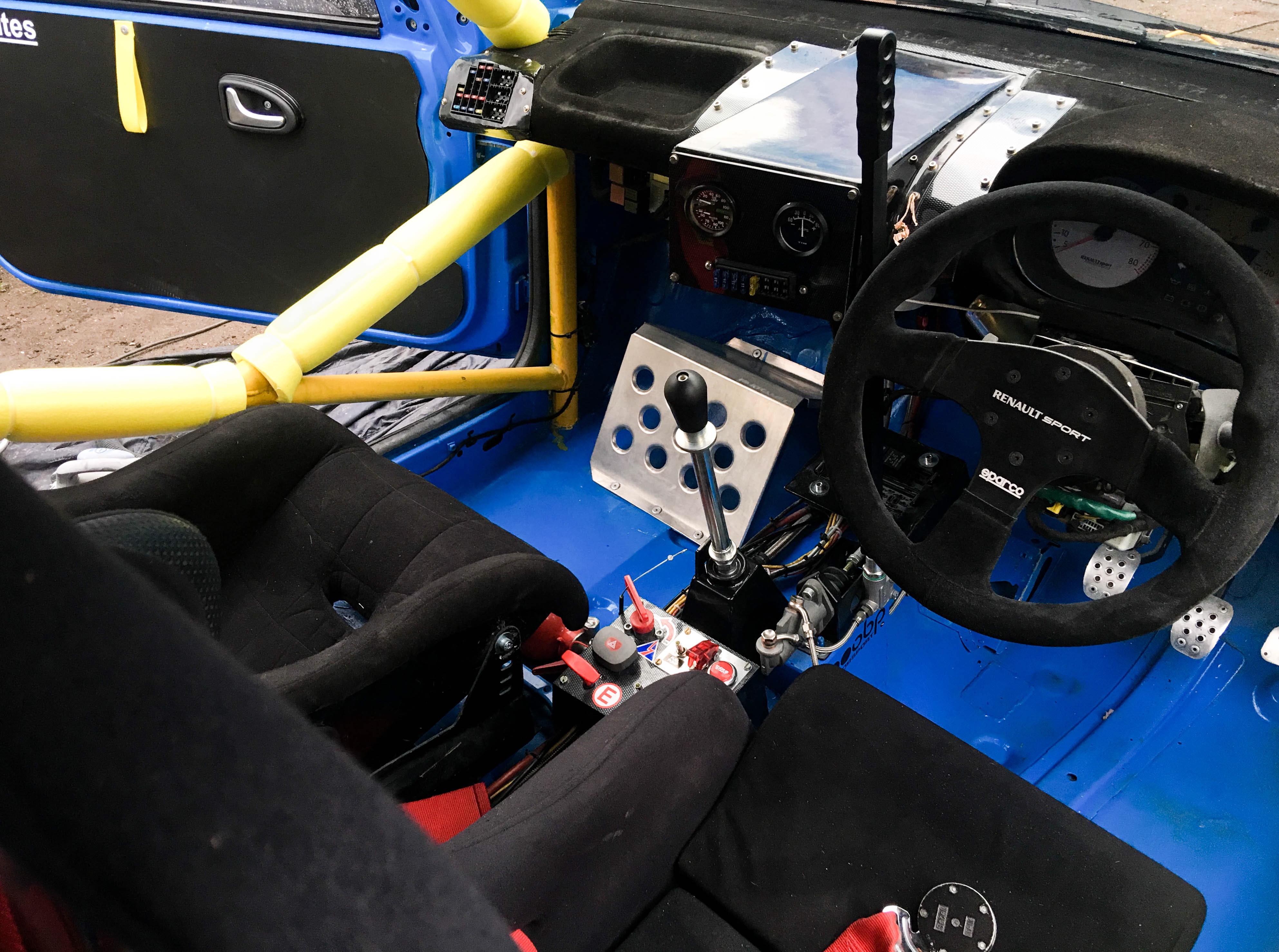

Did a few bits yesterday... the PMS shifter is now set up properly - feels really good. Also replaced our hazard switch with a new one as it was playing up, fitted new side repeater lenses and a new boot light.

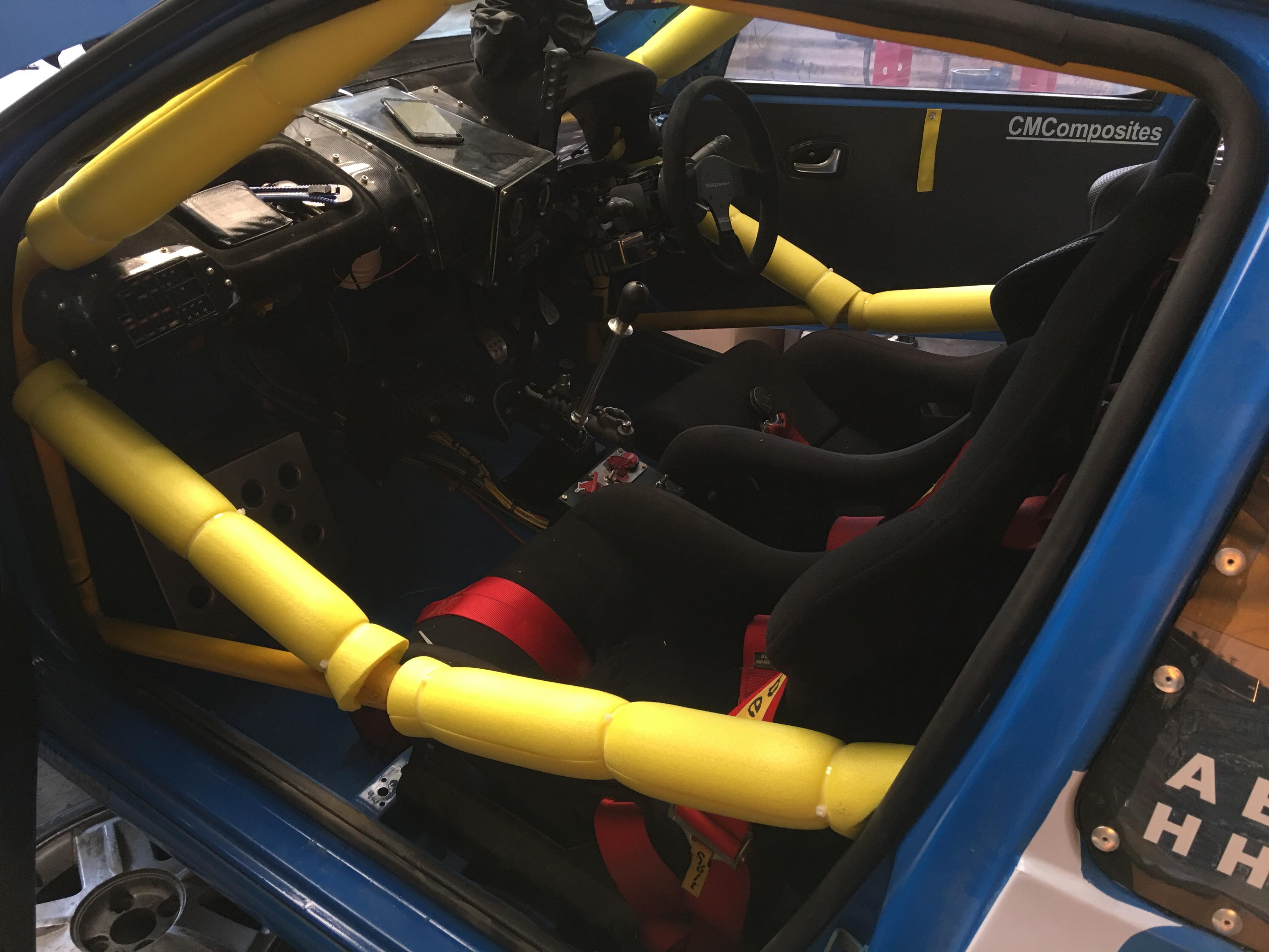

Also put some cage padding on which completes the look of the interior really ?

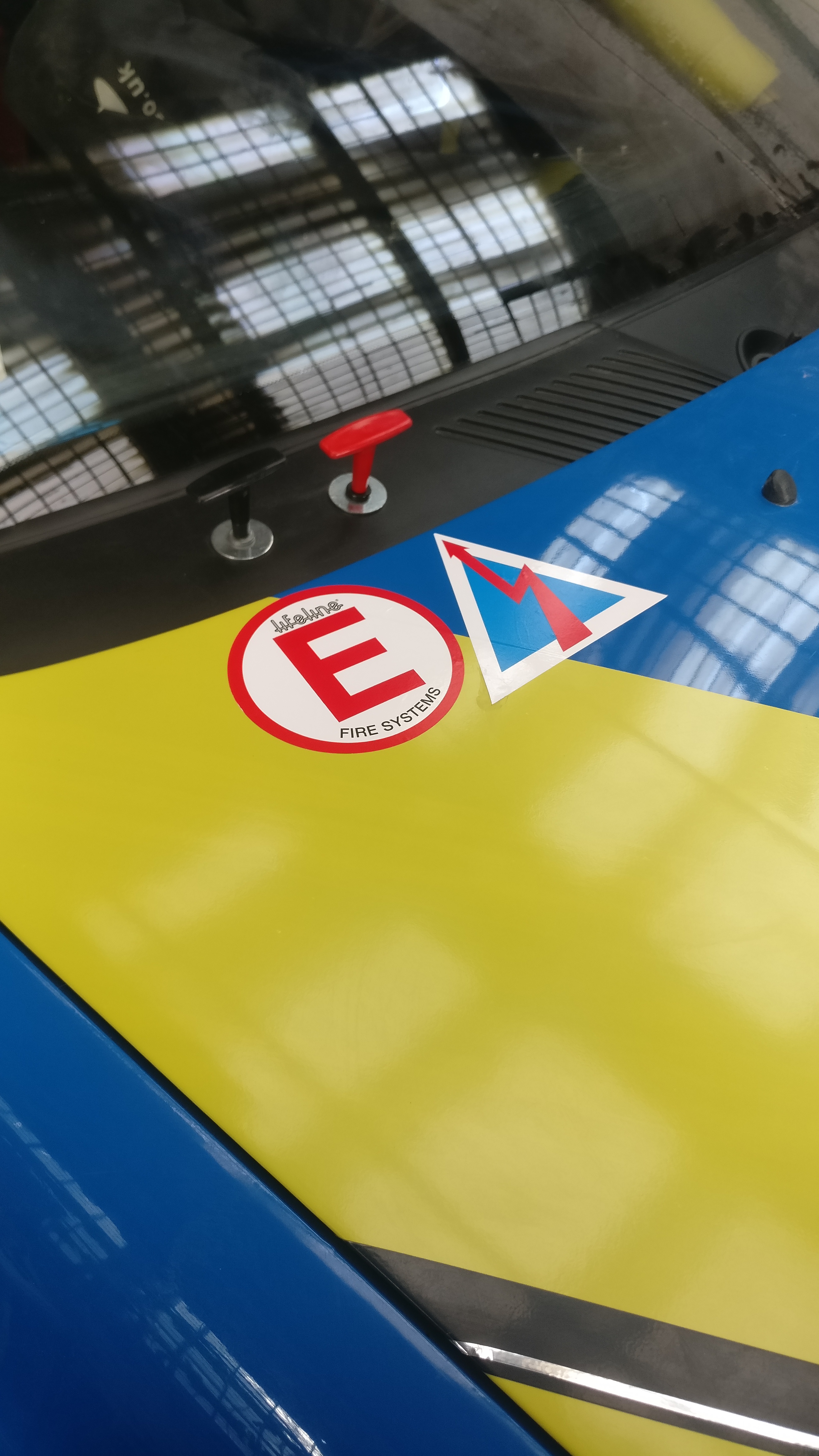

Finally, fitted the pull cords to the scuttle panel along with applying the stickers to the bonnet. Just need to drill a hole in the bulkhead for them somewhere and connect them at the other end now.

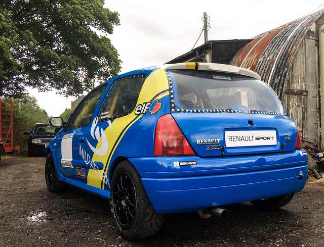

Keep forgetting to update the blog but we've been extremely busy putting the finishing touches to get the car ready.

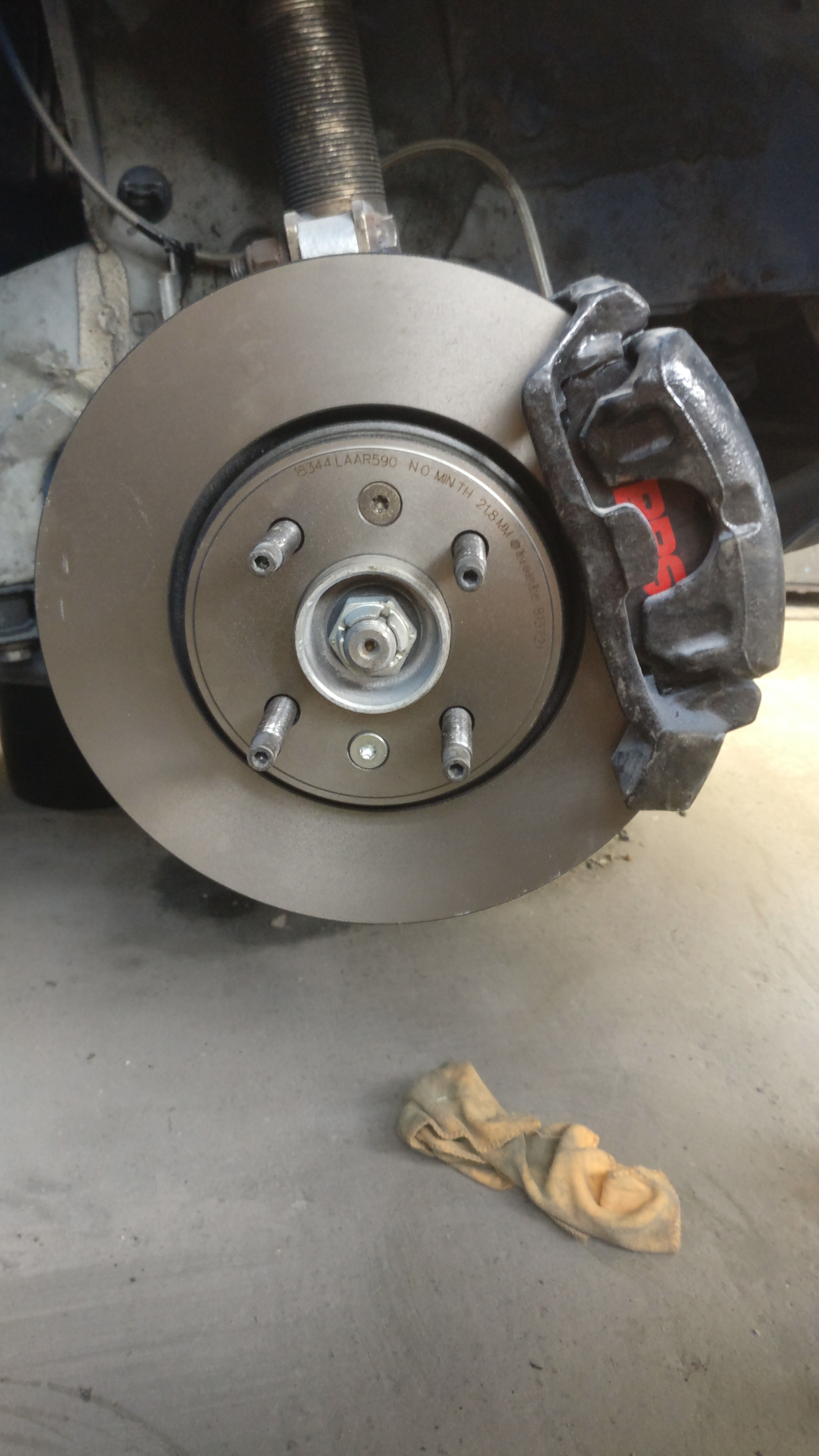

Jobs completed since last update:
  • The extinguisher and autolec cords are now both secured at the other end with the solderless nipples.
  • New Brembo HC discs on the front.
  • Brake lines fastened out of the way.
  • Scuttle panel secured down.
  • Wipers back on and jets piped up.
  • Tyres have been put on the new wheels + fitted to the car.
  • Manifold Back Oreca Group A exhaust fitted (See video below - Not sure why the camera quality is that of a potato)
  • Ride height + damping set with 20L of fuel in the car. (No pictures yet as I think I might tinker with this again)
  • Set the front camber bolts to maximum camber - will check when doing alignment to see what values and amend as appropriate.
  • Replaced our cheap fuel pump for a Sytec Inline one which is much quieter thankfully and probably will be more reliable in the long run.
  • Piped up the ducting to the airbox from the air intakes in the fog light recesses - Originally was going to use them as brake cooling ducts but I couldn't really see anywhere else to put the ducting so used these.
  • Fixed a small water leak by replacing a faulty clamp with a new one.
  • Made a plate out of 5mm rubber to cover a hole in the rear arch where our filler neck sits through and sealed to prevent water ingress.
  • Cut 5mm rubber to shape of mudflaps - to MSA dimensions.
All that's left to do on the car now is:
  • Wire up our Ammeter gauge.
  • Pipe up the demister blower.
  • Tracking/Alignment.
  • Fit mudflaps.
None of these however are stopping us from actually using the car as it is and so therefore we're booking Curborough with our friends and using it as a test day to check for any faults with the car! A date has been set for 4th September and so this will definitely be our first outing!
I did the tracking Thursday night and set the fronts to neutral toe and straightened the steering wheel back up too. I checked the rears too to see which shims I'd need to order in the future to amend them to our preferences and surprisingly it also had neutral toe! A good starting setup I think.

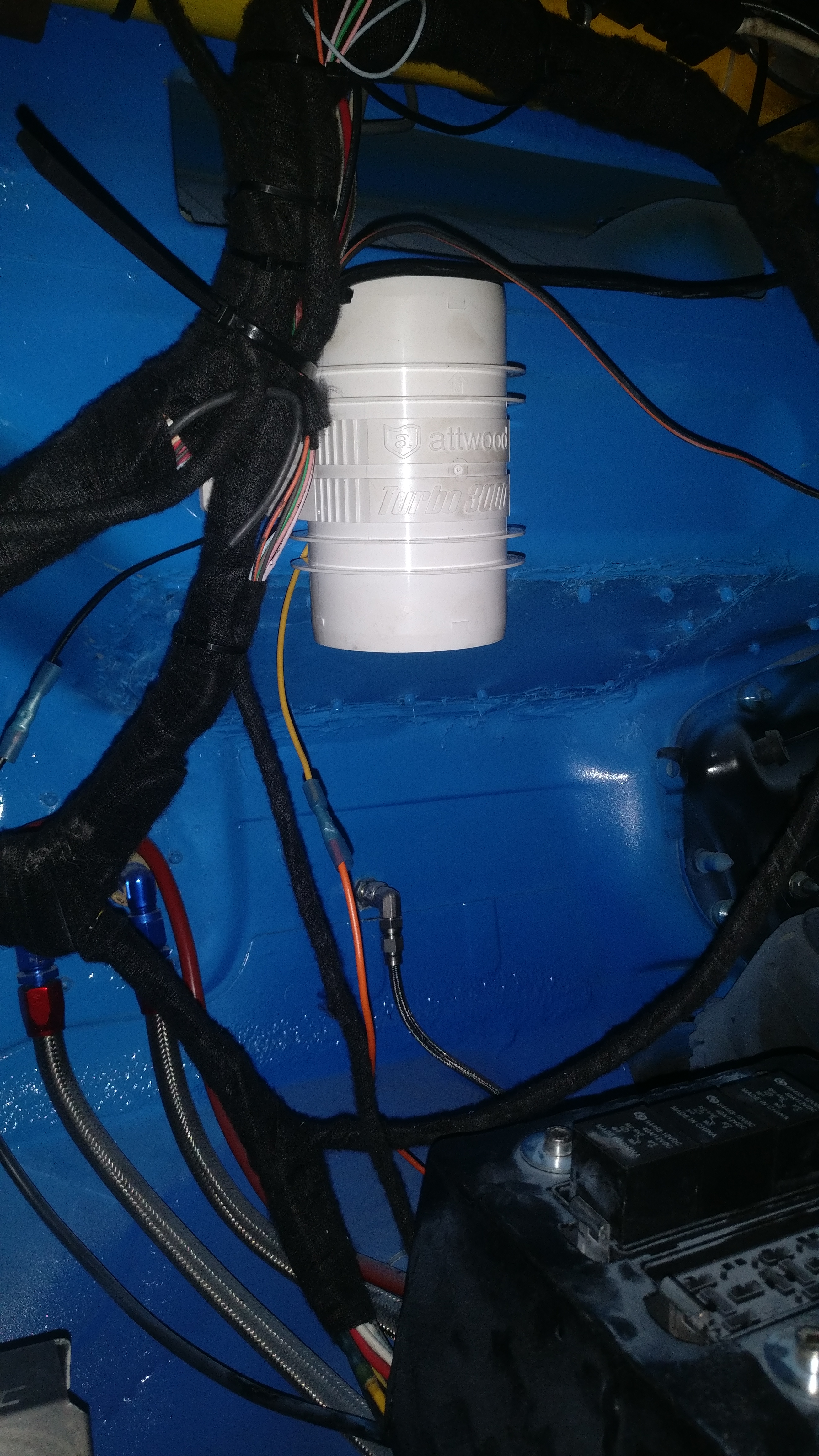

I also begun making a box for our blower to divert it's airflow into the orignal recess in the bulkhead. Couldn't fit ducting into the small slot that was large enough to go on the blower or fit an adapter onto the blower as the cage is in the way.
Latest job which I did yesterday was put a breather pipe on the fuel tank along with a 1 way valve to allow air in but not fuel out this is put through the floor with a grommet to vent.
After that we built some less steep ramps out of the garage.. (We ripped the old exhaust off last time due to the car being too low) drove the Clio outside and performed some very sensible "tests" to check everything was ok with the car. The only problem we found was another small water leak which will be another easy fix - better to find them now than at a track day.

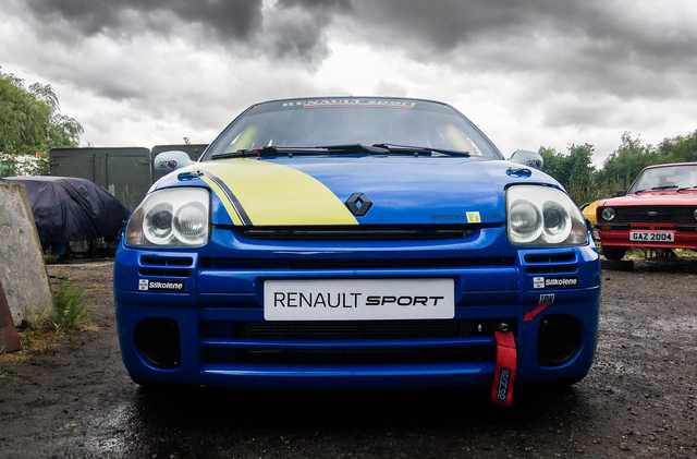

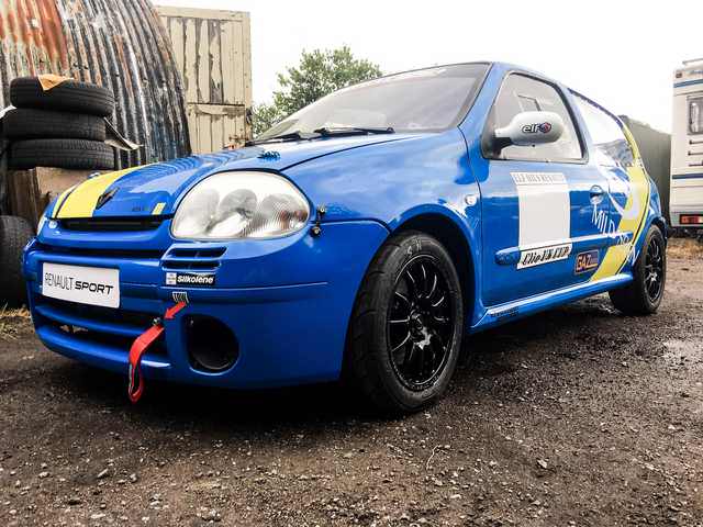

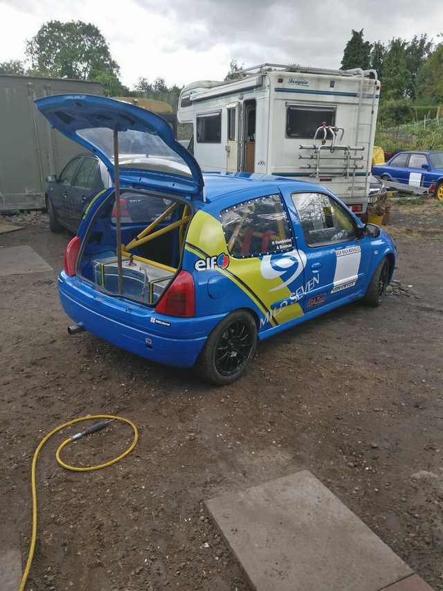

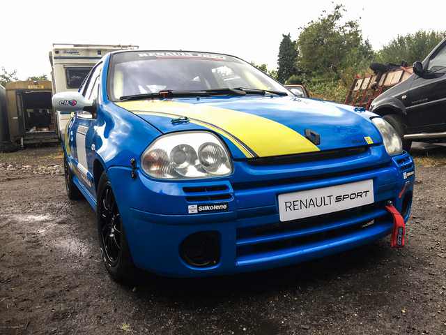

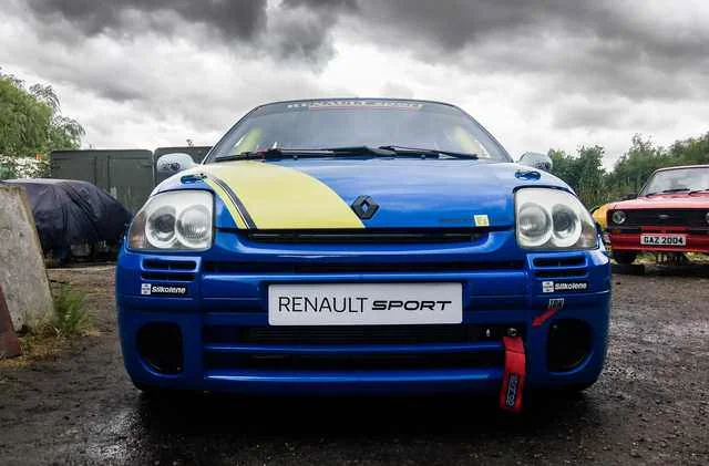

Here are the first proper pictures of the car we've taken of it almost finished, after giving it a quick wash. And a video of one of our "tests"?

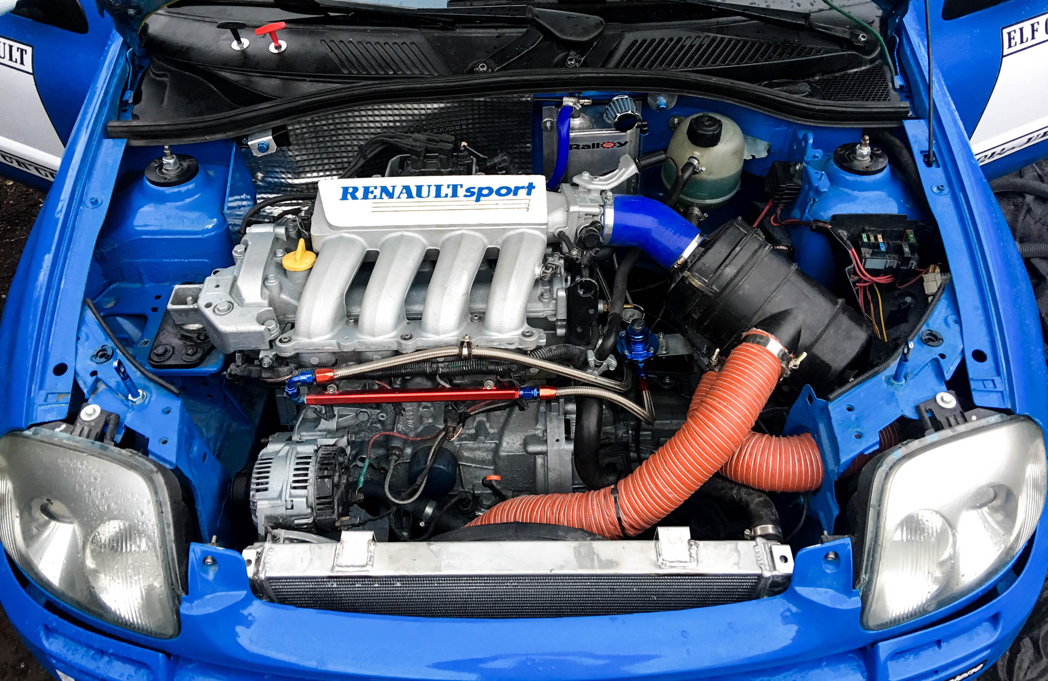

  • I finished making the box for our demister blower out of some spare polycarb we had laying around.
  • Swapped the 1 way breather valve on the fuel tank for a proper Mocal "Rollover valve" after soon realising a true one way valve will pressurise the tank.
  • Swapped out the Front master cylinder to a .500 (from .625) because the pedal was way too hard - we ended up bending the link rod from pushing so hard on the pedal and it not travelling + re-bled the brakes in addition to replacing the NSF caliper which had somehow seized up, even after it's rebuild.

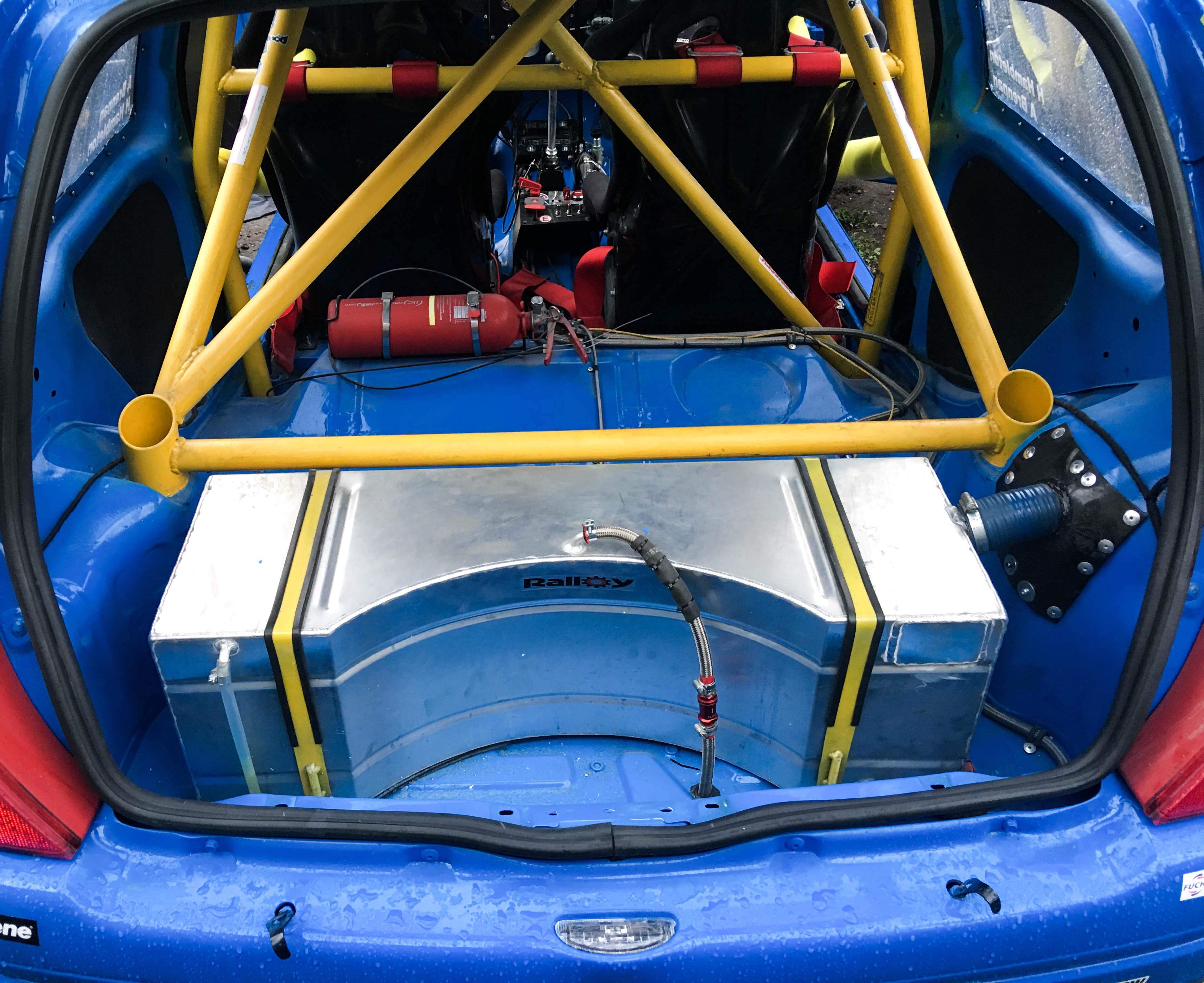

The first easy thing to be ticked off the to-do list was replacing our 0.5l catch tank with a 2l one as per MSA bluebook regs. So I ordered a Ralloy 2l Catch tank and we replaced that! Due to it being quite big we had to nudge our expansion tank over a space and also move the NS extinguisher bracket over a notch as it was pointing at the bottle lid after we moved it ?
While we were in the engine bay I finally ordered some Nimbus Lite heat shield which I've been meaning to buy for months and fitted that in a way that it shields the brake lines on the bulkhead and the bias box. Quite happy with how the engine bay looks now ? Just needs a set of ITB's
Picture of the new rollover valve and showing the harnesses tied up neatly.
Shot of the interior after cleaning (a rare sight it being clean)
