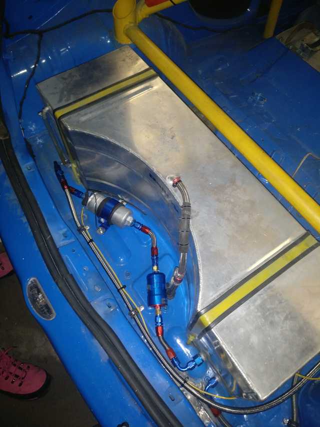

Instead of making a box for the fuel pump we decided to relocate it into the facinity of the tank which is having a cover over it anyway. So we ordered the fittings we needed and some more hose and got on with making it.
Also extended the wiring and cleaned the filter out again which had some more metal filings in surprisingly, must of been loads in the tank! :(
Anyway thats how it looks now, nicely tucked away in the recess.

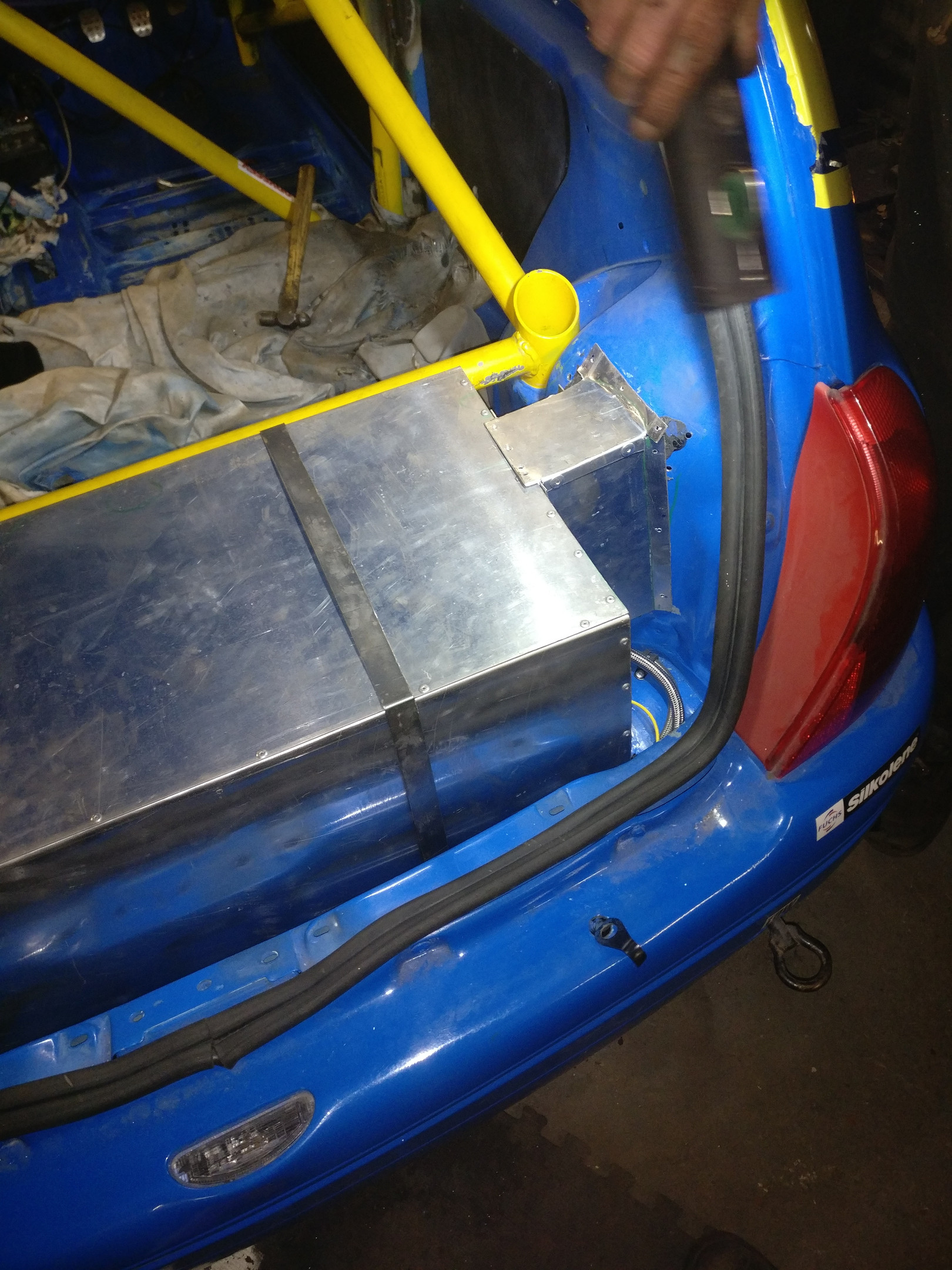

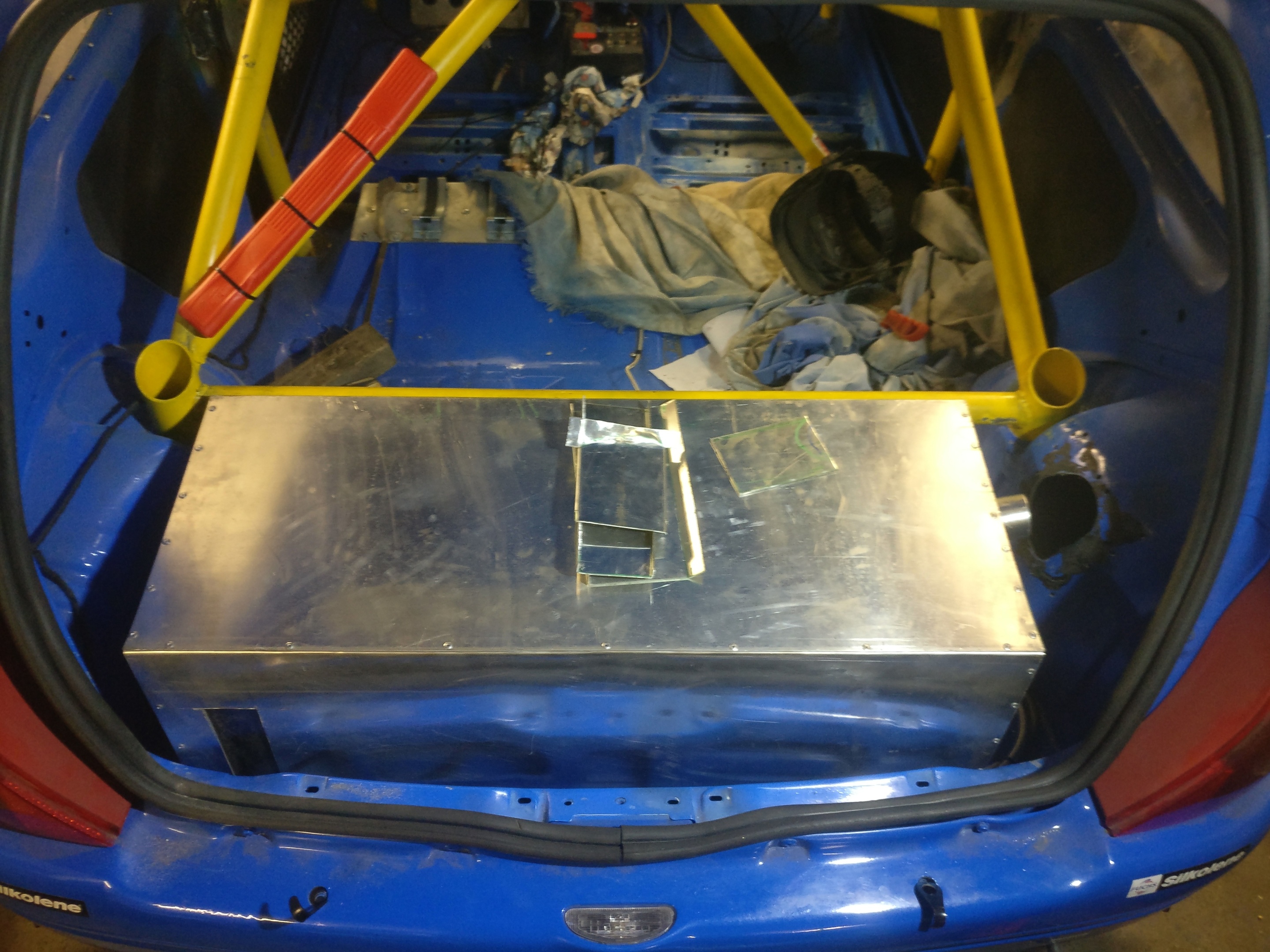

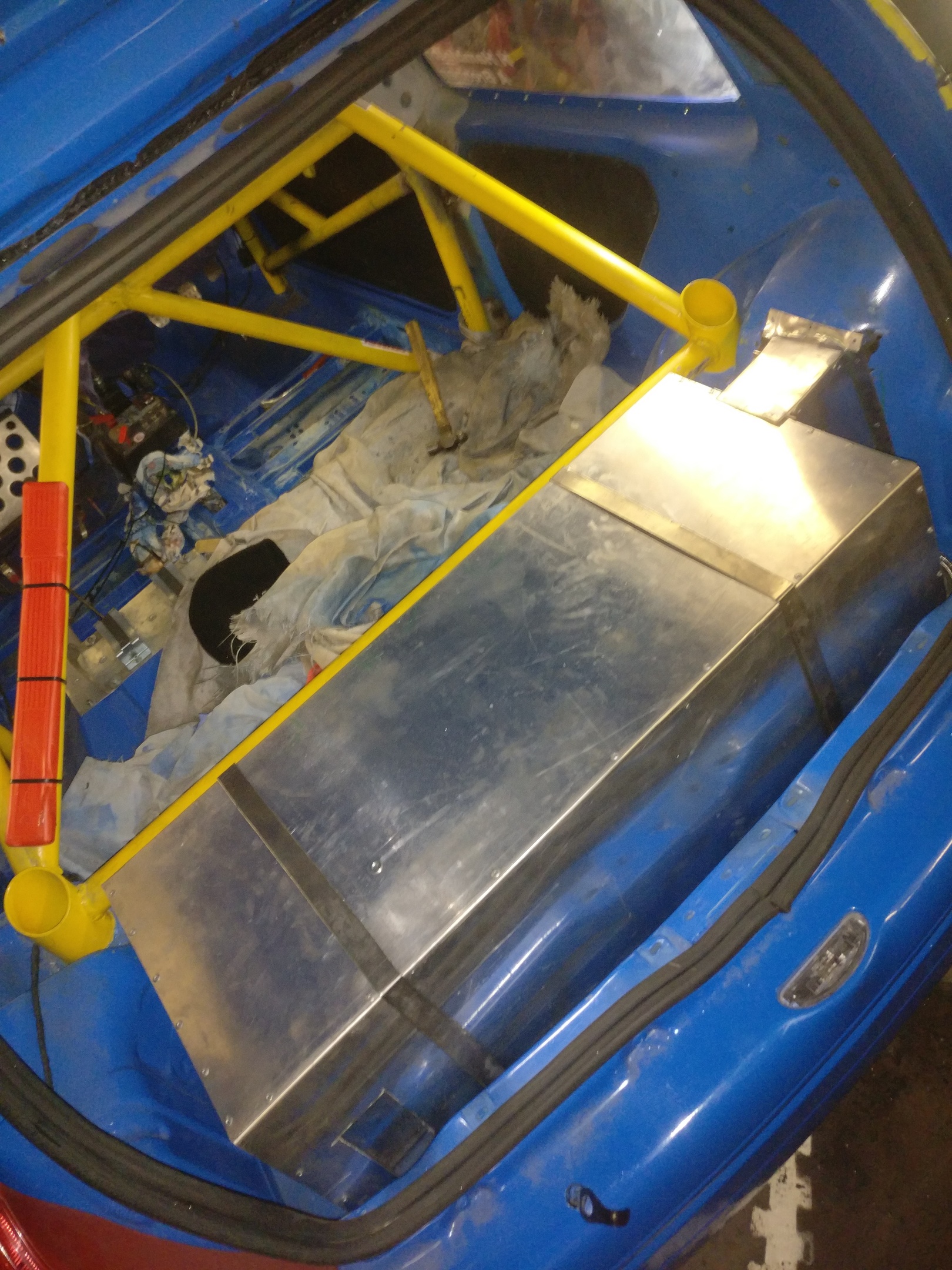

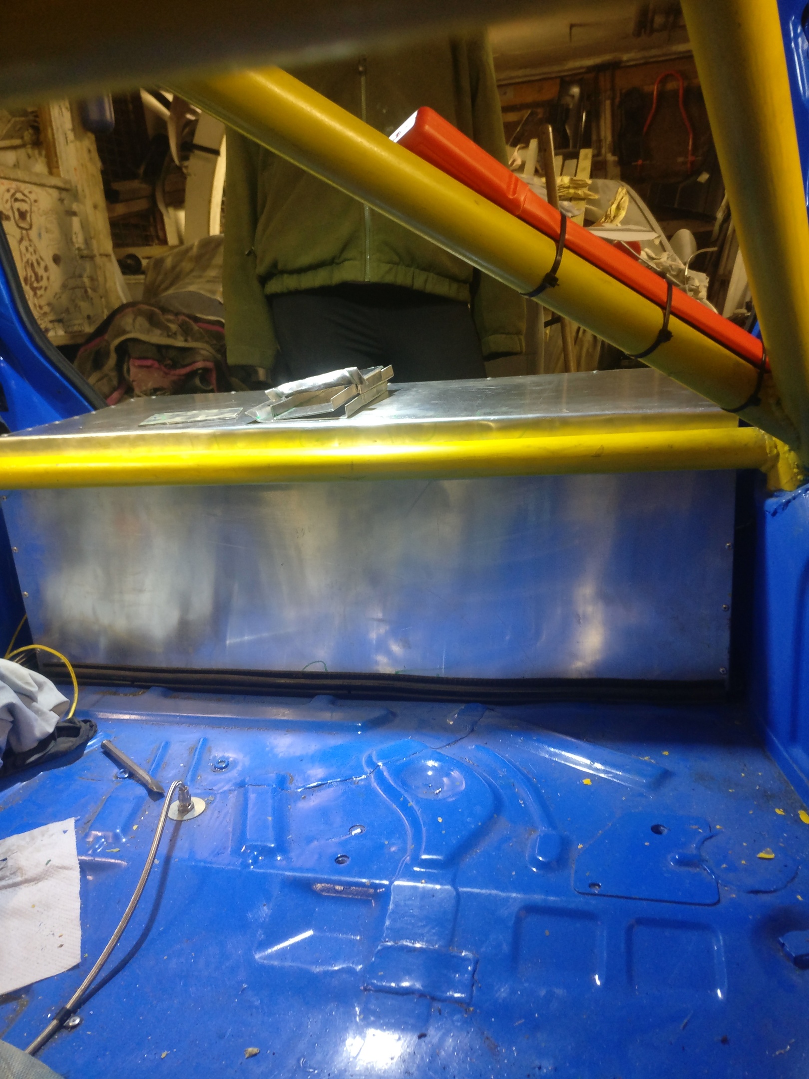

Pictures of the tank cover as it stands... we began making the filler neck section yesterday but haven't quite finished it yet.
Polycarb window to view the fuel level incorporated into the design...
Use of some rubber door seal cut to shape to seal the bottom edges of the tank cover once it's compressed down by the mounting straps.

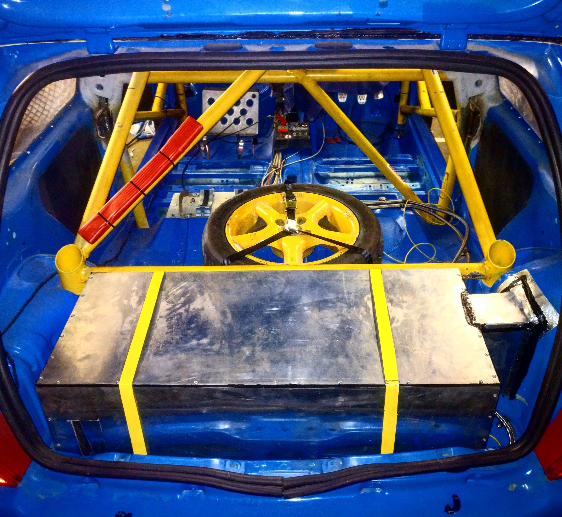

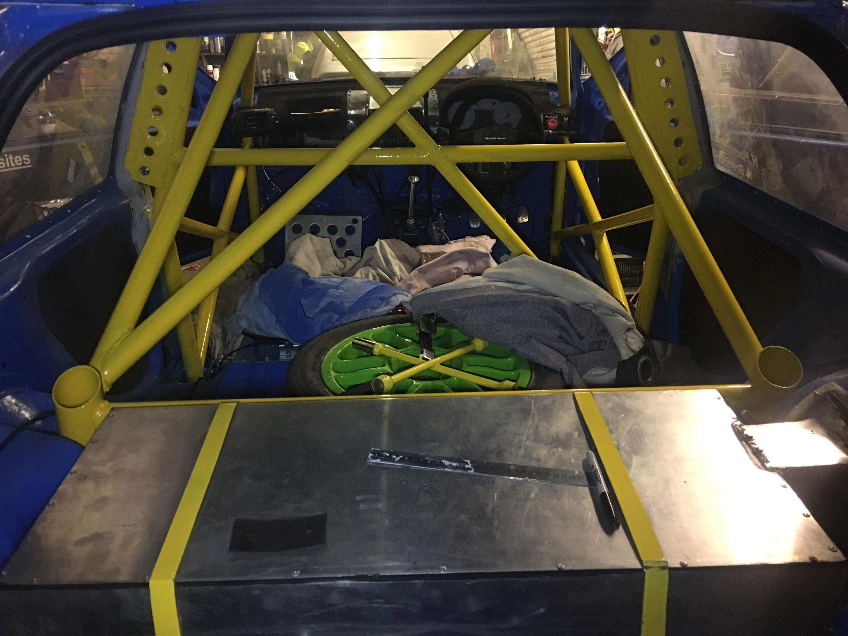

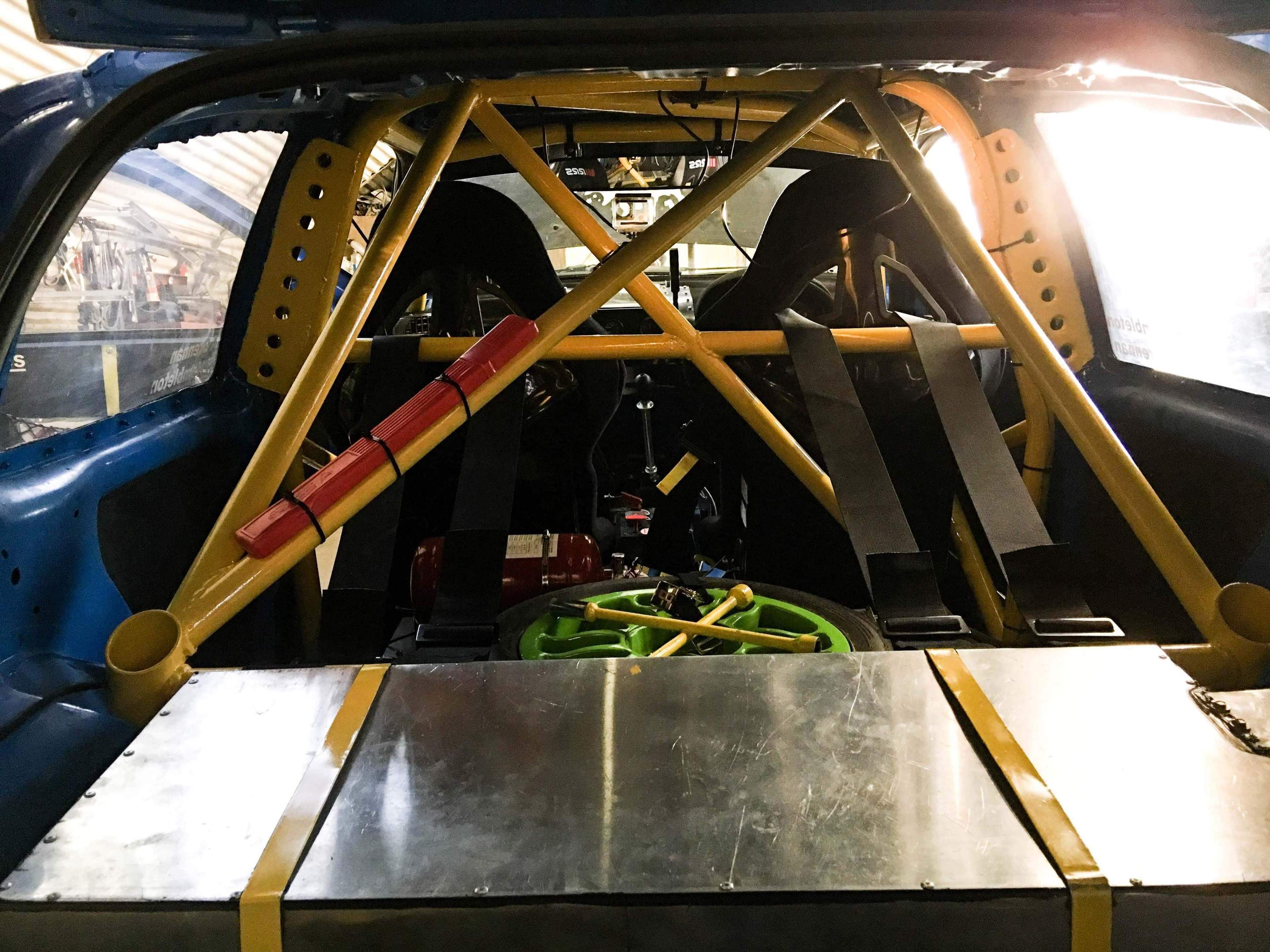

Tank cover fabrication is 95% finished now. Made two straps to fasten it down too so we could then work out the exact location of the box on the side for the filler neck section.
Just all needs attaching together now and then the inner joints sealing with some tiger seal and it's finished!
Hazza462
Tank cover is now finished fitted and all sealed up. Really happy with how it's turned out seems we made it from scratch ourselves!
Spare wheel straps are also bolted in, borrowed one of Pete's wheels just to get them in the right place.

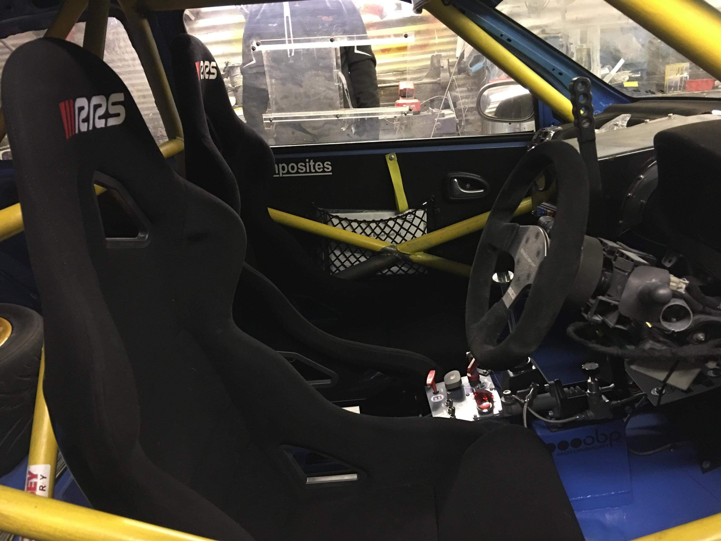

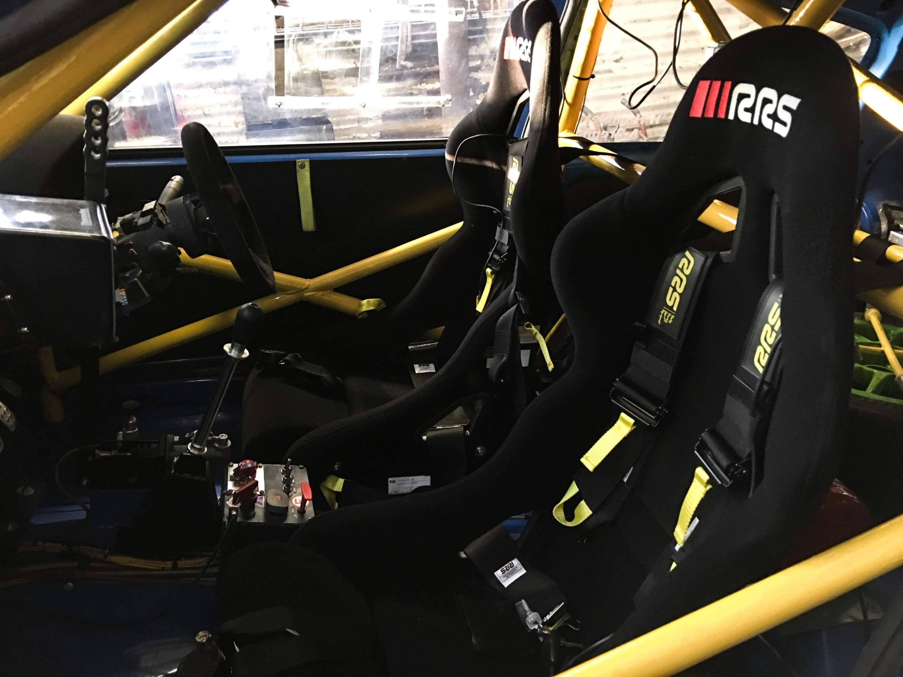

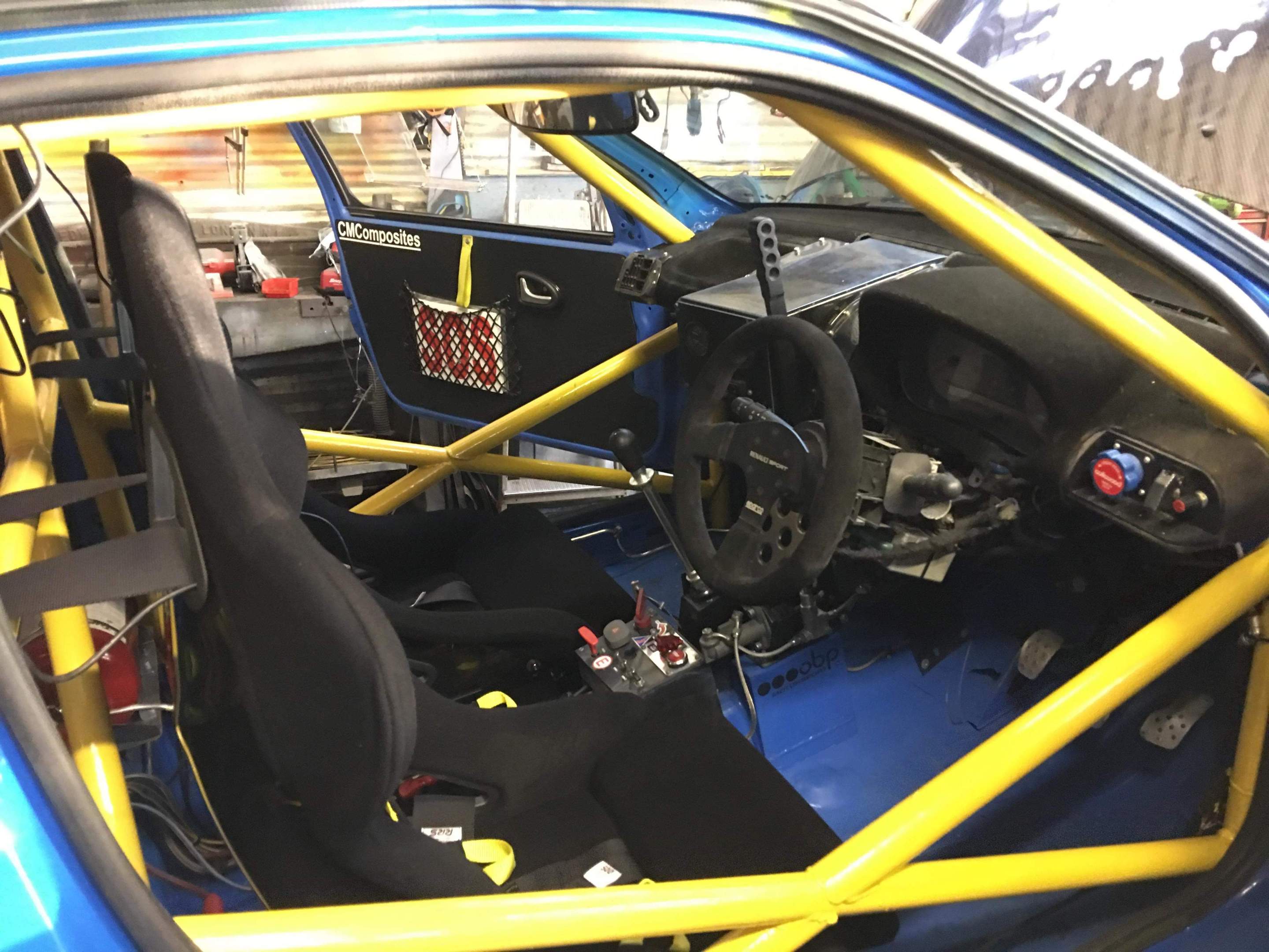

All the floor has been repainted after the new seat rails being welded in. Just in time for our new seats to arrive from RRS France!

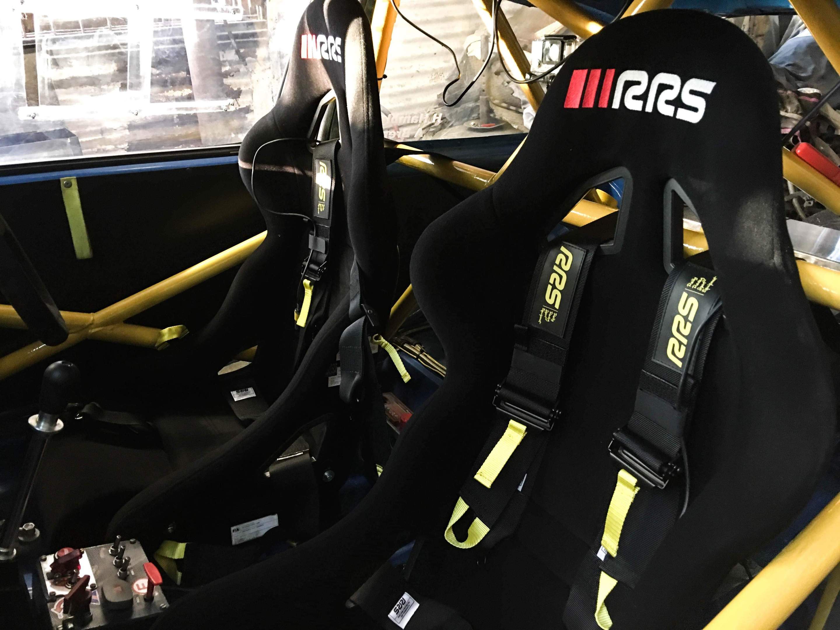

We got them yesterday and had them bolted in immediately! But they're out again now in preparation for the repainting/painting of the cage after the addition of two more door bars!
So so happy with how they look and feel to sit in. Really perfect choice and fit to us for a bloody cheap price!
Can just about see one side in the pic below.

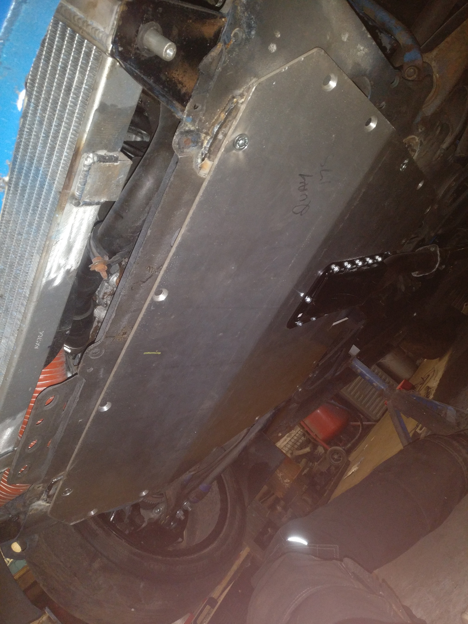

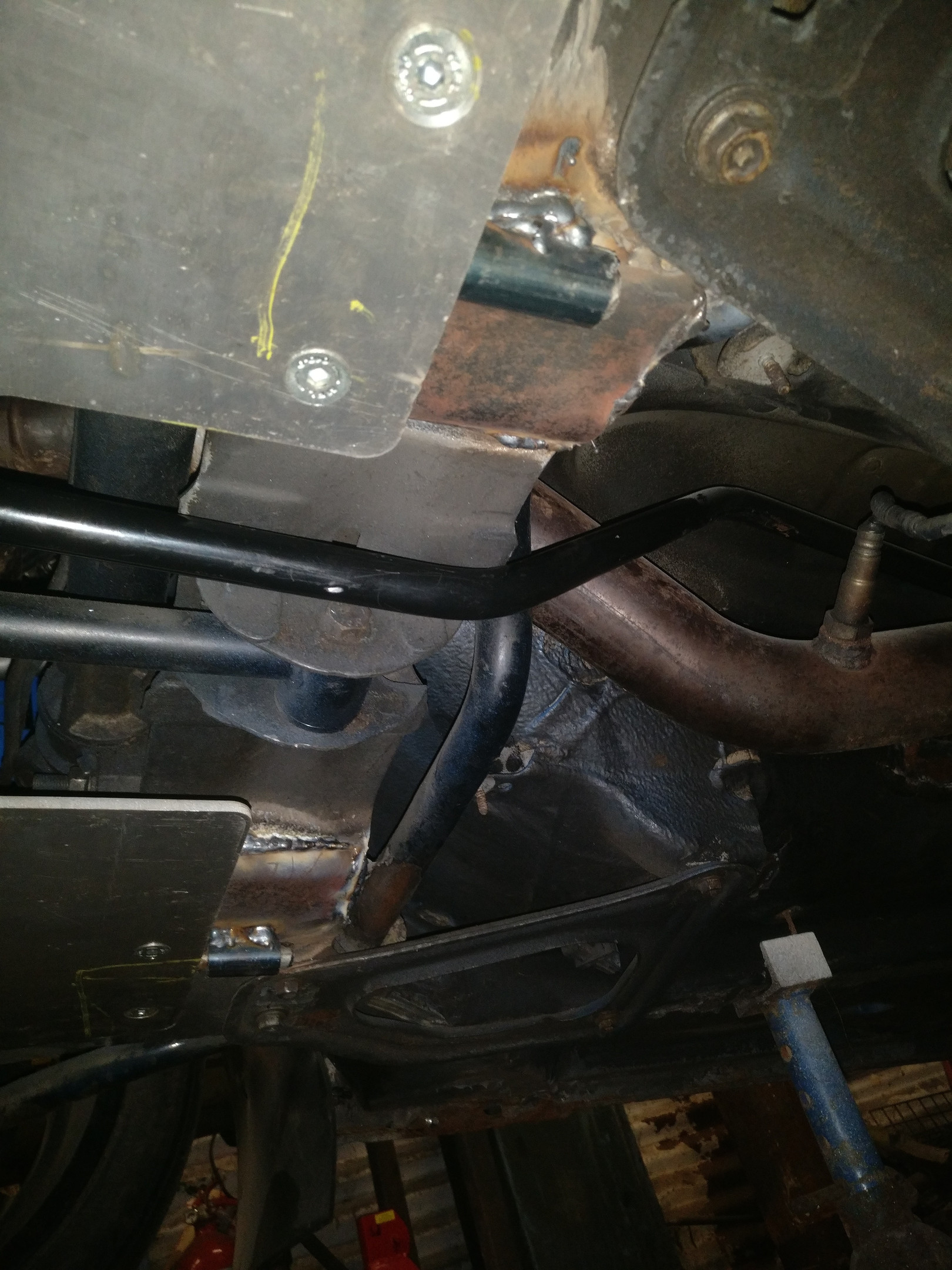

Began fitting the PMS sump guard yesterday too which we're modifying slightly to fit easier by making two brackets to slot into the rear of the subframe and then we're going to weld some captive nuts on the front of the subframe - instead of using a million rivnuts. Much quicker to fit/take off!

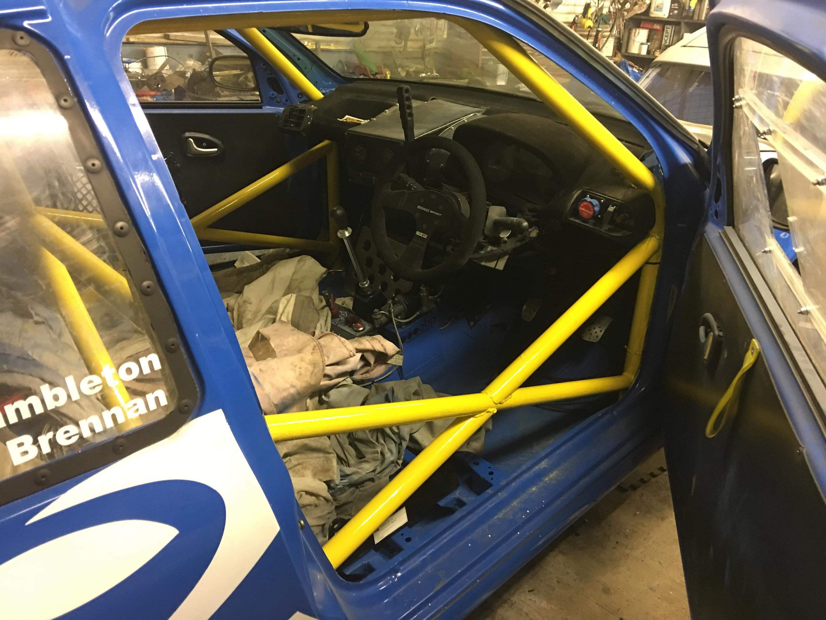

Cage is all painted now and looks amazing thanks to Alex ?
Seats and Harnesses went in shortly after that was dry! The seats are so comfy and the harnesses are brilliant too - we're so happy with them ?
Sump guard mountings are also finished now..
Can sorta see the mounting brackets we've made where the sump guard now slides into two tubes on the subframe.
And to support the front it is bolted with two at the front and two on the side near the front with nuts that are welded into the subframe ? it's now quick to remove and isn't moving anywhere anytime soon.

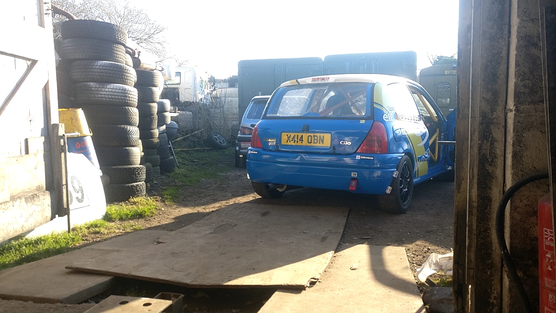

Also had a little issue where our starter motor decided to die for no reason and also our spare too... So i picked a new one up today and will fit that ASAP.
Aiming to get the car MOT'D, taxed and insured next week and hopefully logbooked at the weekend perhaps depending on availability of the Scrutineer... Once the new starter is on and the wheel brace in it's ready to be logbooked finally!
Just want to check the tracking again but planning to take the car to uni to Cornerweight it and then use the String set to do the alignment properly when it's on the road!!
Hazza462
Been a horrendously busy last couple of weeks! Luckily I've been on holiday at work which turned out to be great timing!
The night before MOT we run the car around the yard to get the brakes working a bit better but on returning to the lockup the fronts seized on solid. We had to do a million point turn to get the car back inside and in the process burnt the clutch out ? We only found this out the morning of MOT where the car lost all drive and had to be towed back using my Twingo ?
A trip to Birmingham ECP on last Sunday bought us a new Sachs clutch and it was fitted the same day and all was well again. Also managed to fix the brakes issue by playing with our balance bar, hydraulic adjuster, re-bleeding the front brakes with Ravenol high temp fluid.
We took the car for MOT again Tuesday and it passed with no advisories! On the way back it then decided it wanted to develop a misfire....
I instantly thought it would be fuel system as it always had been with this car so I took the tank cover off and stripped the fuel filter down. There was hardly any crap in it but it was crushed slightly so I bought a new one that day and replaced it. Cleaned the pump out too while I was there but this didn't cure the misfire! Turned out to be a coil pack in the end AGAIN, so replaced it with a new one and all is well now ? Everything was back together by this point with the cover and everything back on and sealed up again.
Just in time for yesterday when we towed the car up to Geoff Doe - MSA Scrutineer to passport the car! No problems apart from the Mild Seven stickers that had to to cus of tobacco sponsorship like @massivewangers said I think? Other than that he said just move our central crotch straps forward a bit, he said it doesn't really matter they're that far back but someone might moan one day so best to just move them!
Just got to sort the tracking which is horrifically out and then have a little seat time in the car on the road playing with brake bias, now that it is Taxed, insured and MOT'd! Big relief that it's been logbooked with no issues and is a mega achievement for me to have built it at the age of 21! (With lots of help!?) Dead proud.

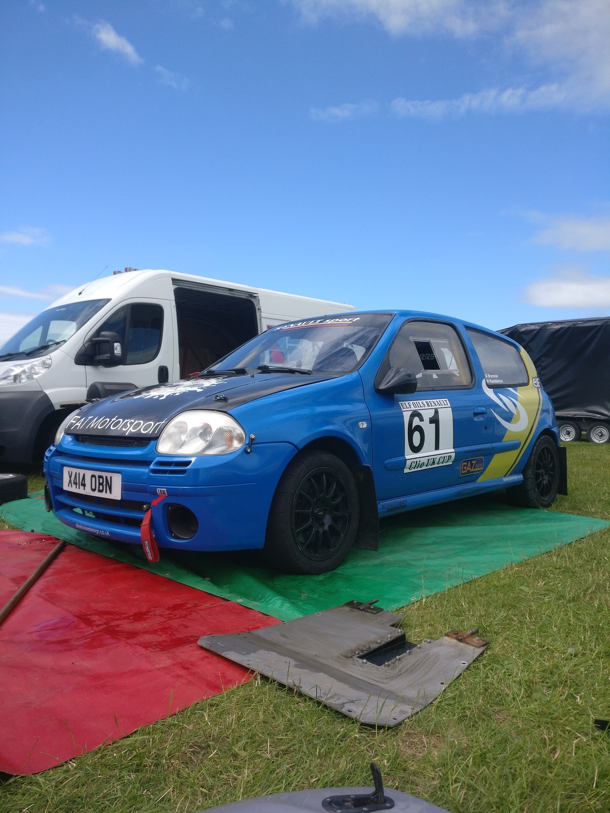

As per not had a spare minute to update this with all the prep for the AGBO Stages that took place yesterday. Pleased to say we finished with little issues throughout the day and was a massive learning curve for both of us on our first ever event. Just took it steady learning the time controls etc etc, both having a rough idea but nice to gain some re-assurance by just taking our time and getting everything right - and getting the all important finish!! Dead proud of Alex for doing so well as Co-Driver she was spot on with the maps all day despite being really nervous in the weeks leading up to it. Also proud that we both managed to finish the event and have found some definite areas of improvement for the car.
Started the day as Car 70 which was great for us, no stress of many people behind us for the time controls etc and allowed us to take our time all day. First stage we soon realised why everyone before the event kept warning us of just how greasy and damp Weston Park is :ROFLMAO: May as well have been driving on ice with the tyres we were using, had a big sideways moment over the flying finish on SS1 where the marshals all cheered as we pulled up into time control ?? I hope the in-car video was working for that stage lol. I learned my lesson for SS2 and decided taking that flat out wasn't the best idea and lifted off instead, keeping it on the tarmac ?
I really struggled with any confidence in the car in the morning, mainly because I hate driving in damp conditions anyway! But with the added hindrance of cold 'track tyres' as opposed to proper rally tyres, little seat time and last but not least the absolutely HORRIFIC brakes ? Pre-event I'd been trying everything to get the brakes to actually stop the car like they should and I've now exhausted every possibility with them - it's time to give up and go back to the servo with a Cup MC. The pedal feel is just awful and doesn't stop the car anywhere near fast enough - it's scary!!? Not denying the stage times could of been better with some ballsy driving, but the brakes would have gave me so much more confidence if they were standard; so that's whats going to happen. Then I've got no excuse?
Even so... the car run mainly faultless all day. Had a minor misfire develop on SS4 and the car kept dropping onto 3 cylinders. With new plugs, HT leads and Coil pack all fitted before the rally it couldn't be those. Turned out it was a blocked injector with some of the tiny filings that were in our fuel tank somehow worked their way through. Swapped that and the car run the rest of the day faultlessly. Some bad luck saw our friend Kevin in his 106 to retire due to alternator failure. Harry in his Escort suffered a misfire which they eventually cured after retiring from the rally, they were able to continue for fun; however in the afternoon they unfortunately had a big off and hit a tree head on - both ok. Rob in his Escort did well to secure 11th after pipping @Nathan Evans by 1 second. Hats off to Nathan that is a ridiculously good result considering the cars that showed up. Myself and Alex had an awesome day and now once this first finish is in the bag we're looking forward to many more (once the brakes are sorted?). Just looked at the results and we ended up finishing 53rd, which considering I didn't even expect the car to finish before the event I'm over the moon with haha.
Below are a few proof pics from the rally while we await the professional ones we've bought as a souvenir for our first one ? Credit to the people on the watermarks obviously:

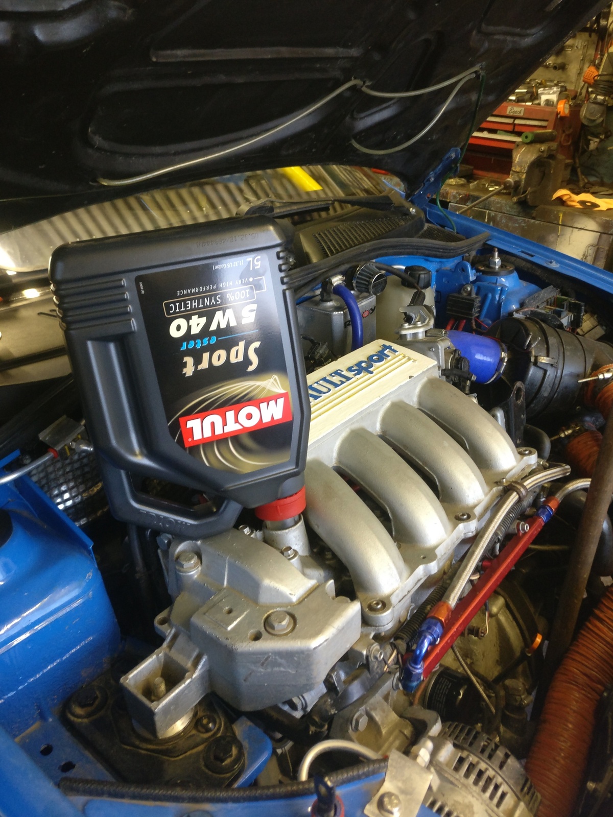

A couple of days after the last post I took off the bias box and fitted a standard servo and master cylinder again. Had to change a fitting on our brake line to suit the MC but it was all done in a couple of hours. Bled them up with some Motul RBF600.
The brakes now feel unreal compared to what we had before? The car actually slows down when you press the brake pedal it's a miracle lol.
Also replaced the oil and filter with some ester synthetic Motul.

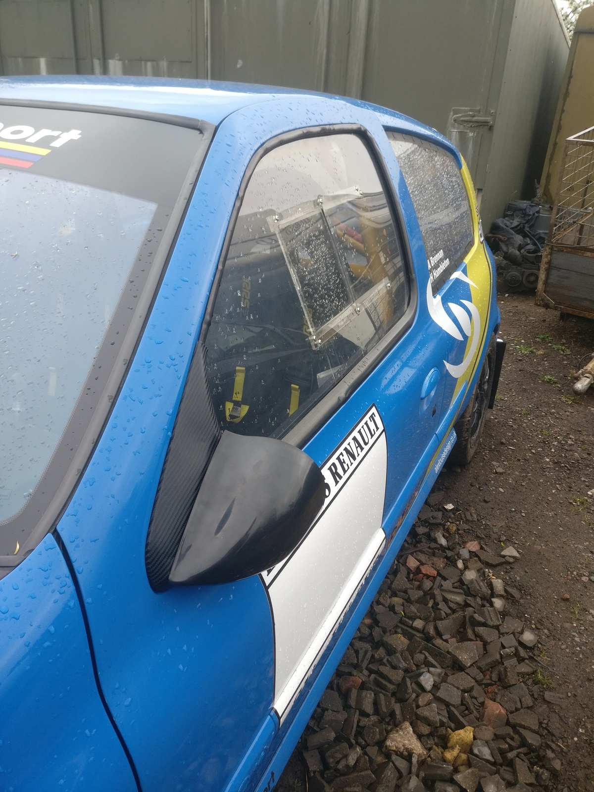

Alex also bought some tryhard mirrors which we fitted last week ?
Took it for a little drive on Thursday and all is good for a change thankfully!! Need to book another event now but not sure what/when.

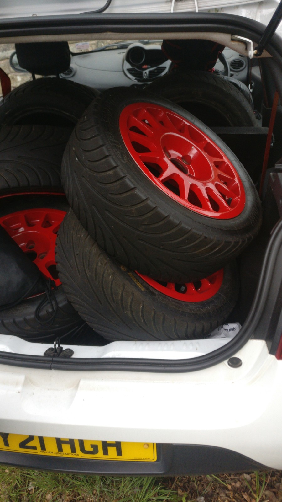

Other news we've bought some more wheels. Ex cup racer 2118 with 6x Dunlop Wets in awesome condition!

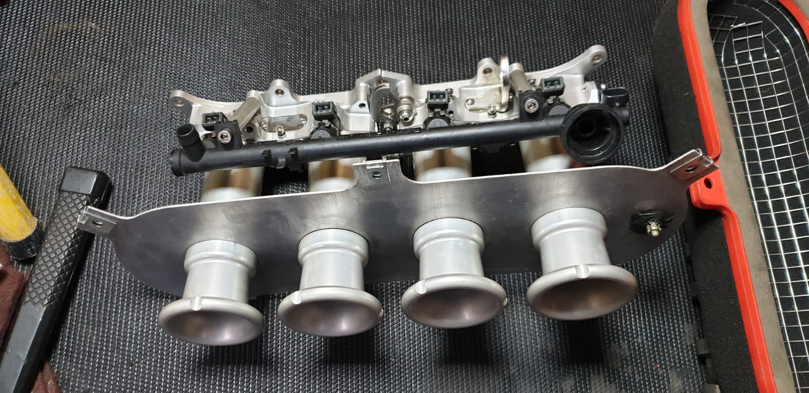

And...?? Will be fitting these after the rally and I'll be making my own loom to suit them and an OMEX 600 also! Can't wait.
Have designed the loom pinouts etc already digitally, but will begin actual construction after the rally after I've saved up some money to buy all the materials, tools etc.

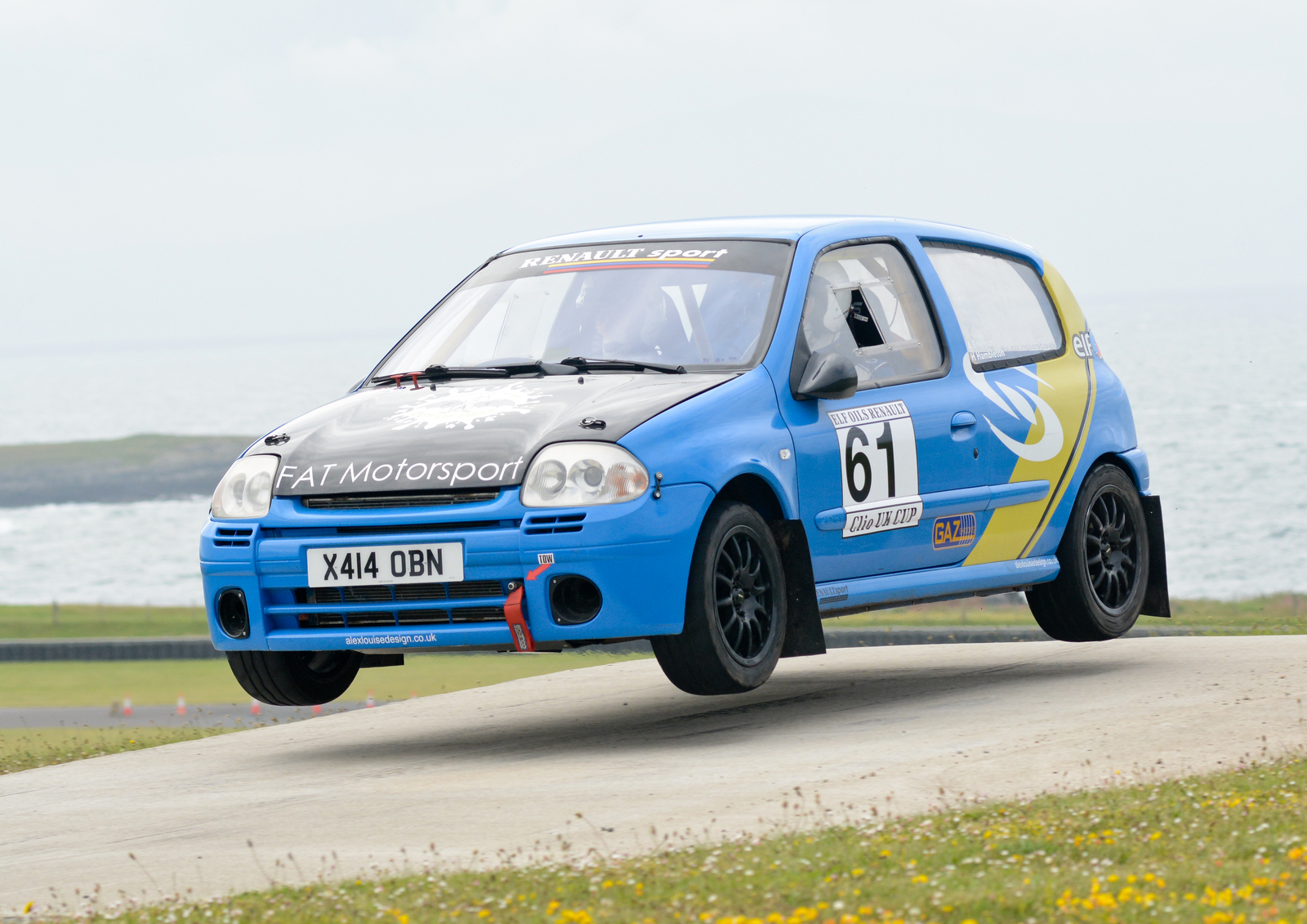

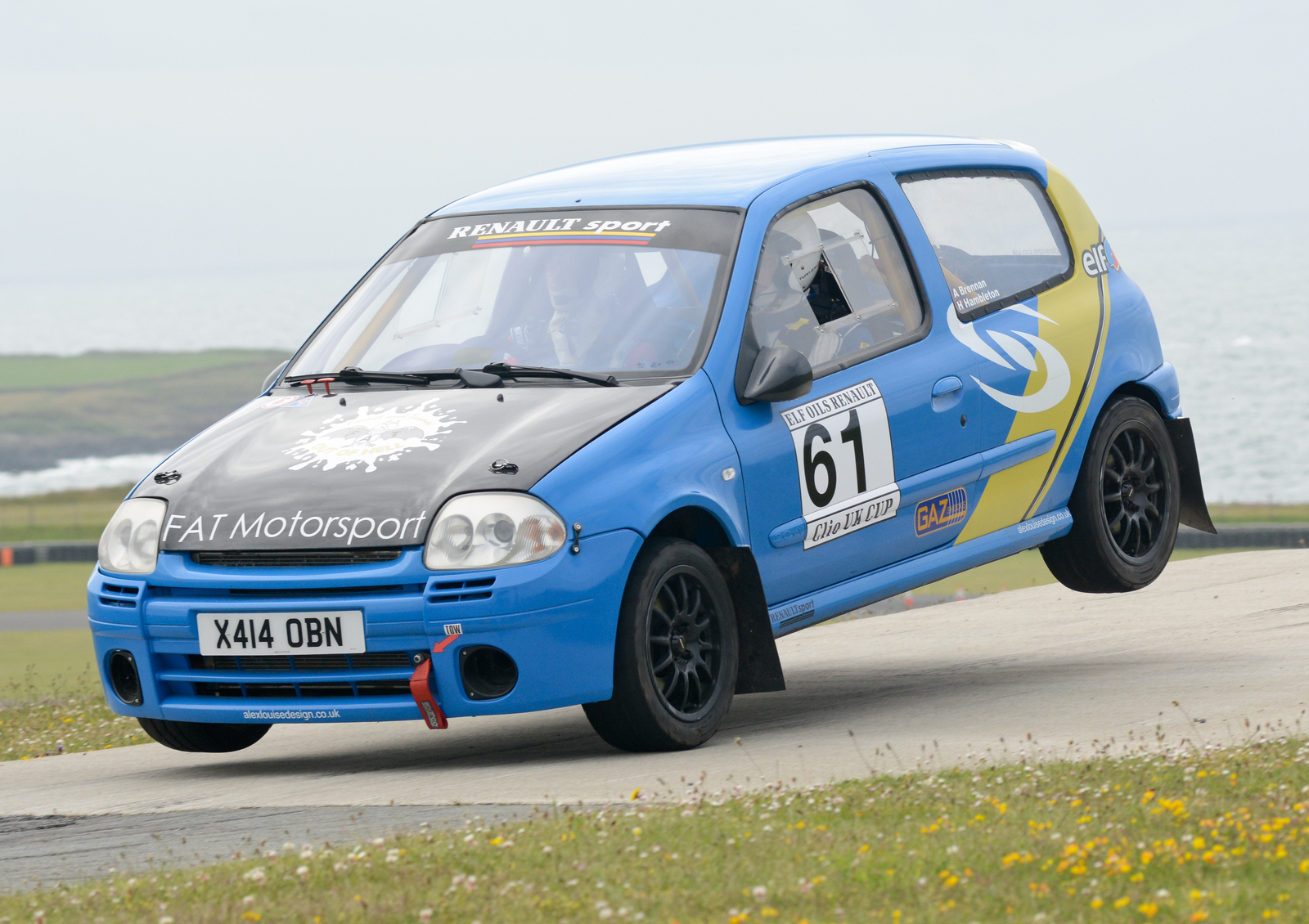

Last weekend myself and my friend Sam took part in the JRT Enville Stages at Anglesey. We had a great laugh and the car showed good pace despite my bad driving and it crying out for an LSD! Thankfully I feel a lot more confident in driving it now however, so will be easy to improve on with a bit of seat time. The new brake setup certainly worked!!!

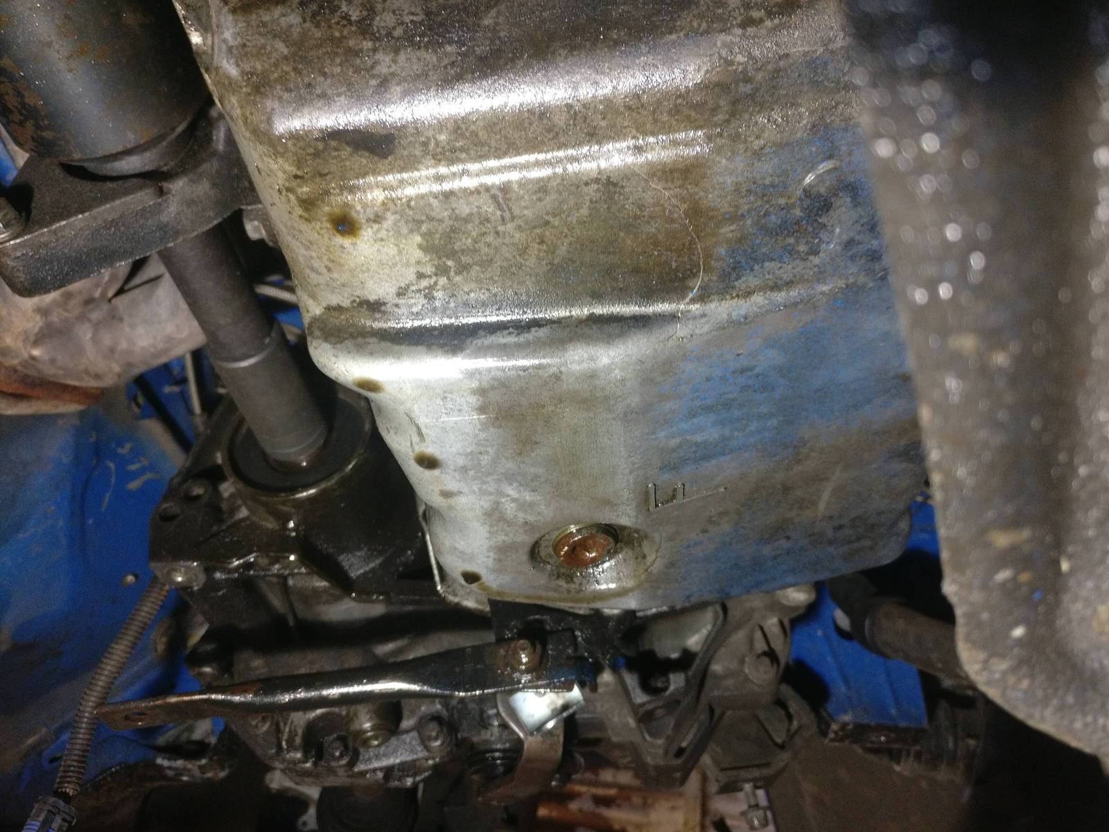

Unfortunately we only managed two stages due to taking the jump flat out resulting in a cracked sump. In hindsight the ride height was too low and the PMS sump guard was practically resting on the sump - a shite design, but lesson learnt.
Can just about make out the two hairline cracks, one by the sump plug and one right in the middle. We'll be spacing the guard down an inch or so and getting some strengtheners welded to it.
After retiring we raised the height on all 4 corners and rolled the rear arches because they were scrubbing - kept us busy for a little while and then we spent the rest of the day spectating and getting sunburnt ?

Sump is now off and ready to be replaced with our spare. Then going to do the cambelt, dephaser and water pump with group N timing. Bolt the ITB'S on, make all new loom and get the car mapped at EFI. Big job, hoping to have it all done by the end of the year to maybe squeeze one more event - funds dependant!
Hazza462
Sump is back on now and engine is all okay, just needs filling up with oil again!

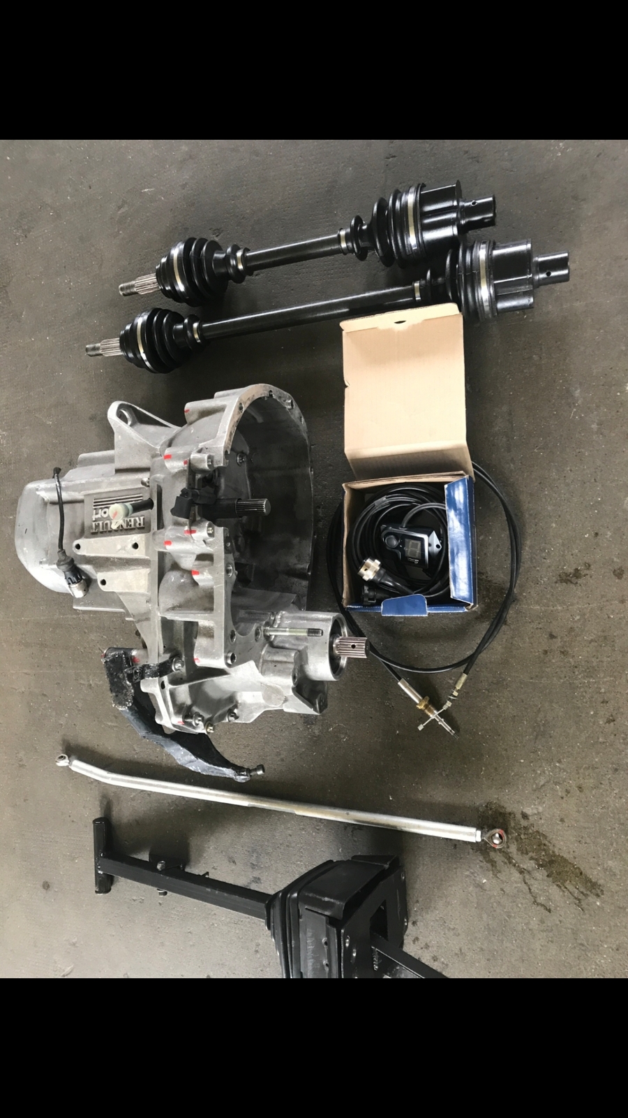

In the meantime I think I've solved the lack of an LSD issue... Just waiting for it to be delivered ?

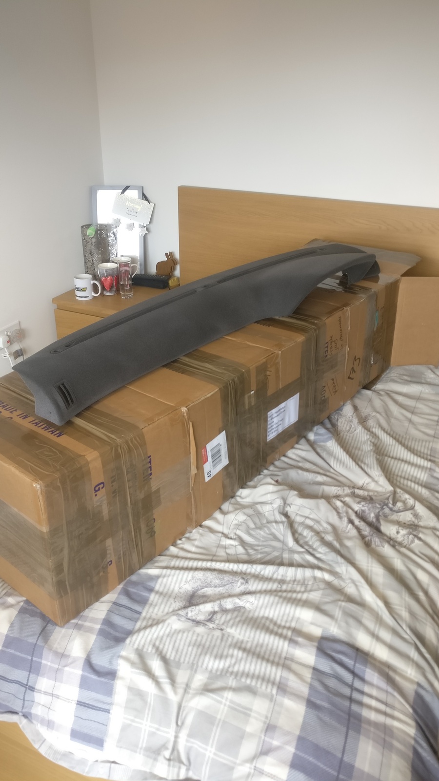

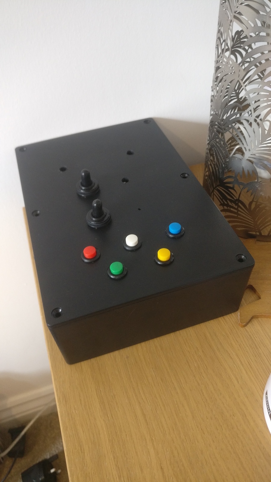

Also progress on the wiring side of things and refreshing the interior to go with it... Flocked MK1 Clio dash also sourced, which will be fit with the rest of the wiring ITB's etc.
Switch panel coming along too, just waiting on delivery of a few more things like a new Autolec. Will be buying a steering wheel control panel off Volantech, who has priced me one up with my requirements - but will buy it when it's ready to fit ?
Happy with the progress so far, but will be slow from now on due to being skint again now ?
Bet your well skint now lol very jealous of your purchase :)
