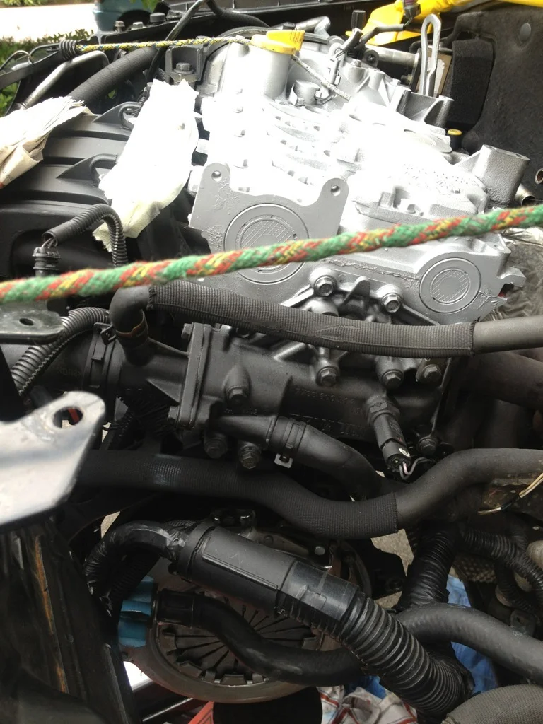

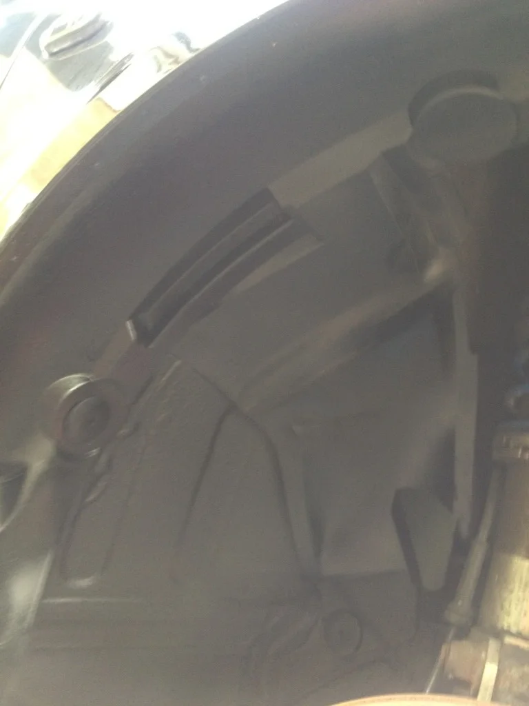

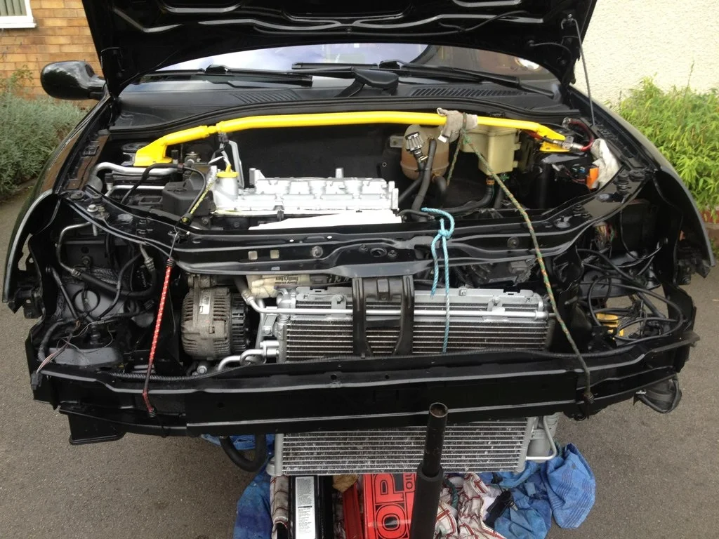

Few of how it stands at the moment.. Clutch fitted... Body waxoyled.. Engine all repainted..Arches all cleaned and sprayed up gloss black.. Subframe is getting a lick of paint too whilst I'm at it.. Anti rust and just so it looks smarter.. Plus I'm just doing things for the sake of it whilst I'm waiting for the box!

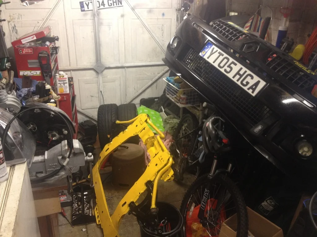

How my garage looks currently lol!! :-/
Bits everywhere!!
