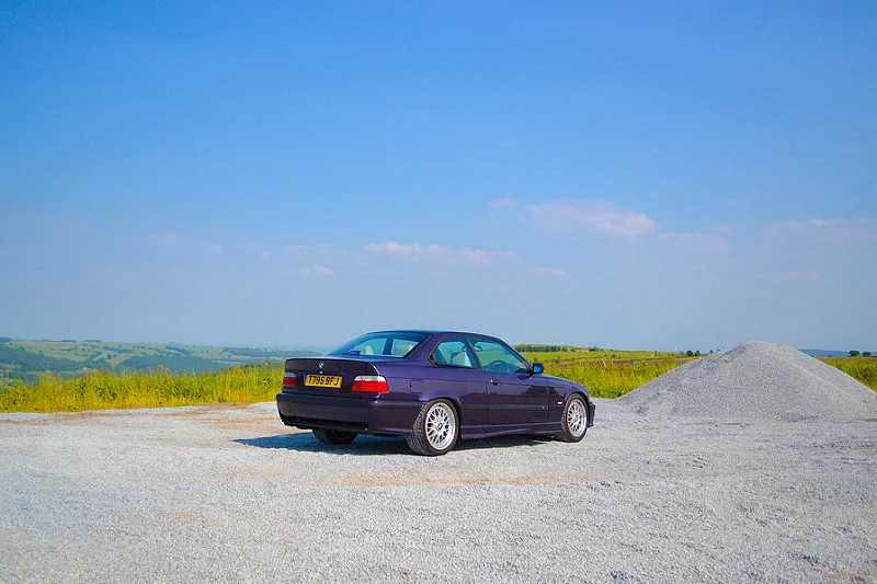

Went exploring at the weekend
029.jpg by DanielJames., on Flickr
033.jpg by DanielJames., on Flickr
030.jpg by DanielJames., on Flickr
038.jpg by DanielJames., on Flickr
054.jpg by DanielJames., on Flickr
057.jpg by DanielJames., on Flickr
072.jpg by DanielJames., on Flickr
080.jpg by DanielJames., on Flickr
081.jpg by DanielJames., on Flickr

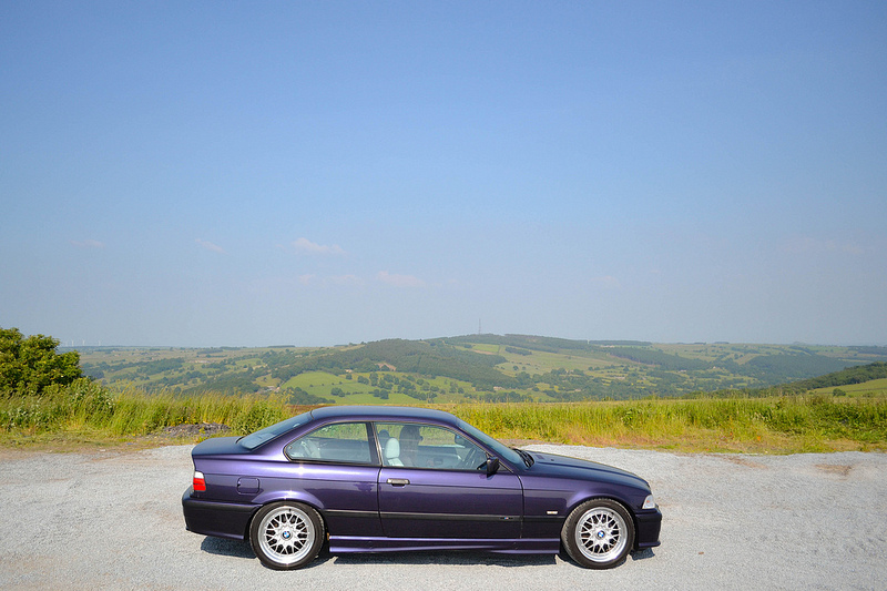

Oh and, I kept trying to get a good pic of the paint when the sun hits it.... and I think this does a good job :)
066.jpg by DanielJames., on Flickr

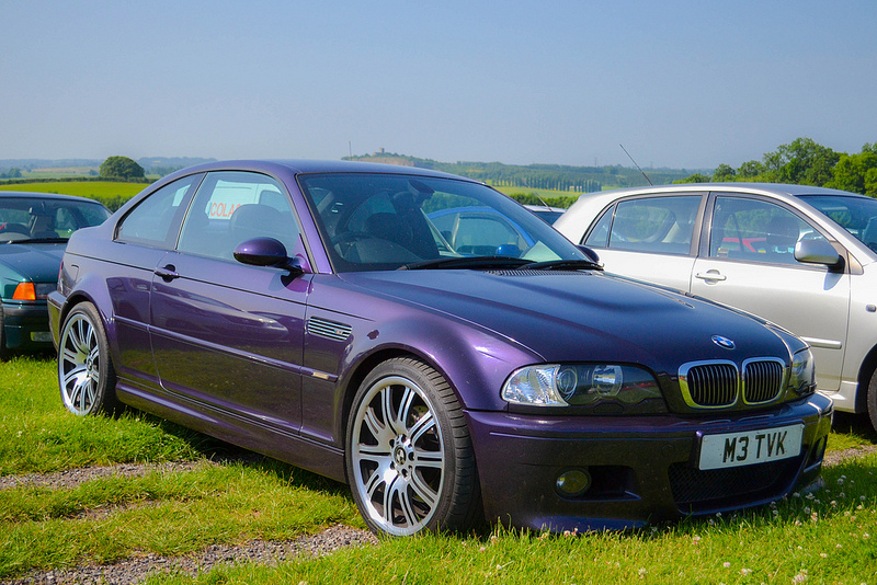

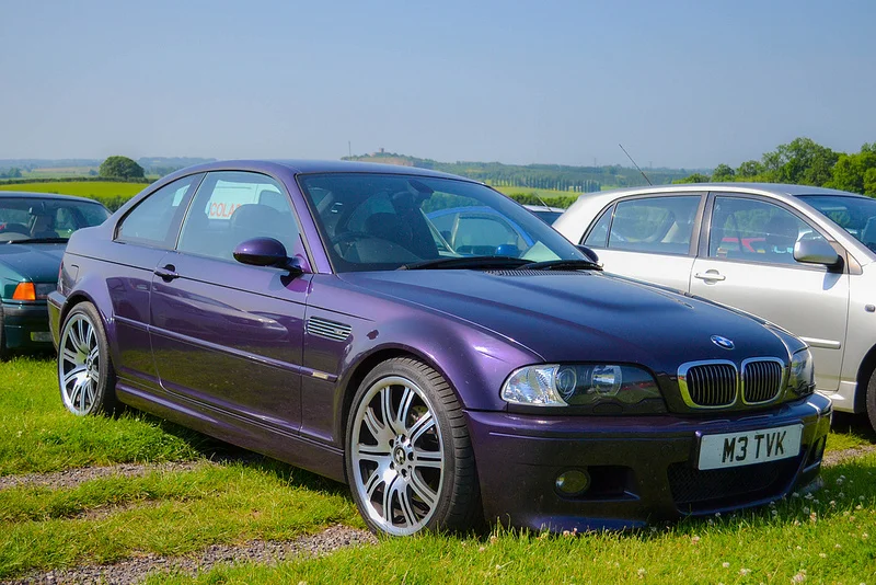

Then at Japfest 2, bumped into a (little bit ropey) TV E46 M3!
083.jpg by DanielJames., on Flickr
_Tom
Colour fwiend.
Anyway, i thought they were roads you wanted to use the teg for? ;) Just sell it and spend monies on that fine '36.
  DC2 TypeR / E36 328i
Exceptional!
How come the e46 was rough??
Budget tyres, few marks on the paint etc. Seemed like it was missing some TLC, wouldn't take a lot to get it up to scratch mind

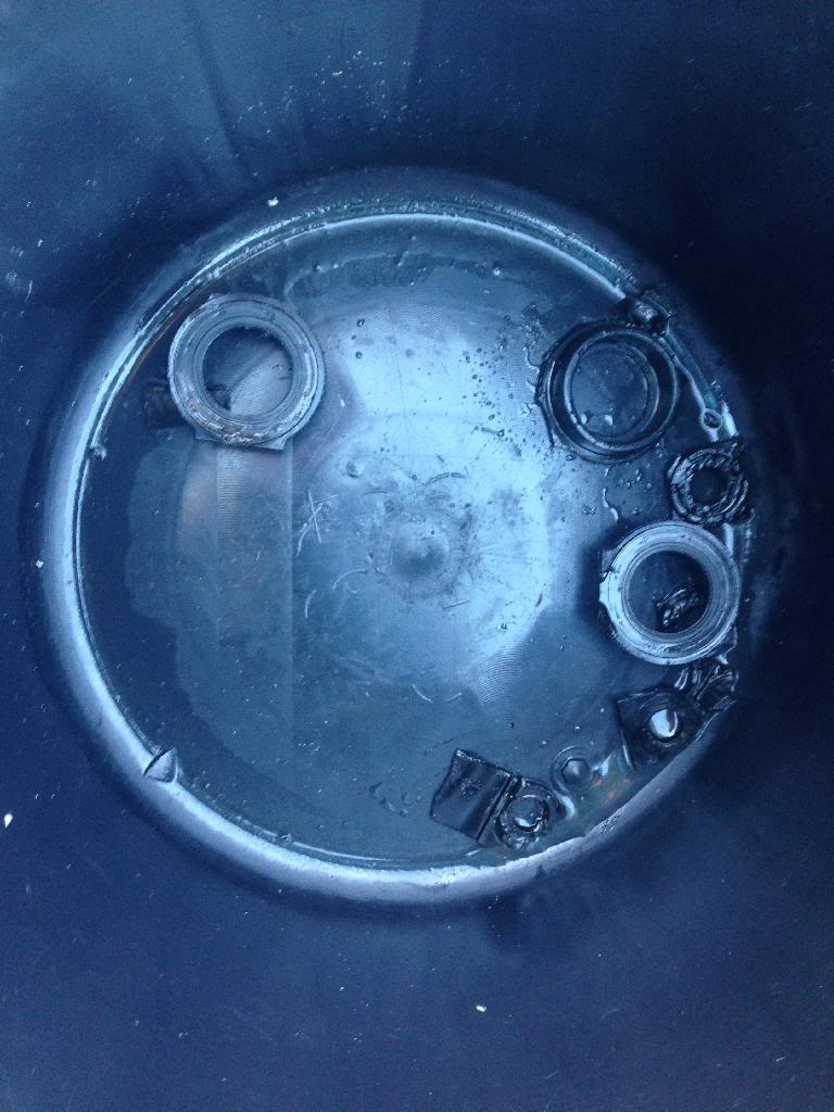

Past few months I've had to do a bit of maintenance, firstly I had or perhaps still have a coolant leak, which I changed the radiator bottle seals firstly as its common to fail and cheap to fix. It's got winter wheels and tyres fitted, which aren't that appealing but do the job (worst winter for 30 years my arse). Also yesterday I did the cam cover gasket. Let's have some pics.
These are copied from a BMW forum so apologies if the formatting goes a bit weird.
11/11/2013
Unfortunately the BMW is off the road currently, I pulled up to the gym last week and heard a hissing sound...
Ordered the rad bottle seals from BMW as it looks to be this, so hopefully a nice easy fix!
Currently it's just sat on the drive

25/11/2013
Drove the car to work for the first time in 3 weeks today!
I've just not had time to sort it out unfortunately. Sunday afternoon however I had a spare few hours so got cracking.
Firstly I had to go to Halfords to buy some coolant - which on the shelf they only sold ready mixed. Didn't want to spend £50 on coolant considering I wasn't 100% confident my problem had been resolved so got the guy behind the counter to have a look in the back and he managed to find some concentrate :D
So on the way home in the Type R which I've been driving daily...
When I got home I cleaned up the rad bottle and re assembled (with a mallet!) the radiator. It's definitely a tight fit!
So back to the car, looking a little bare. Managed to get the radiator out WITHOUT removing the viscous fan though, against popular belief that it would need removing.
Didn't take many pics after that, but I worked into the darkness and got the winter wheels fitted too.
So that brings us back to this morning, and seemingly running sweet! But I will keep my eye on it of course.

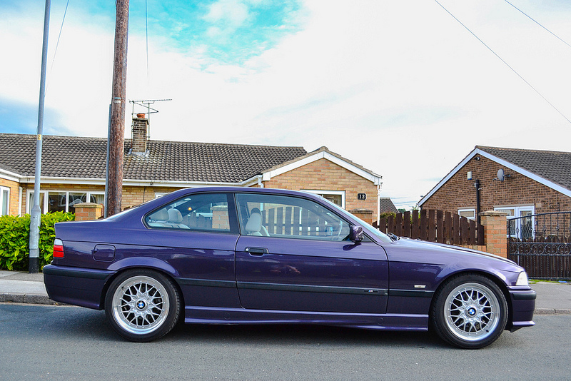

Sneaky pic from the cafe window, I went out to check the coolant levels at lunch and all were well with no drips underneath!
Just needs a good old clean now. May have to wait until after winter lol.

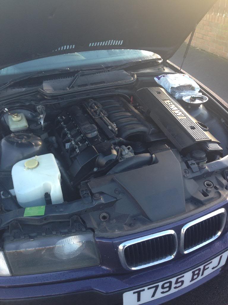

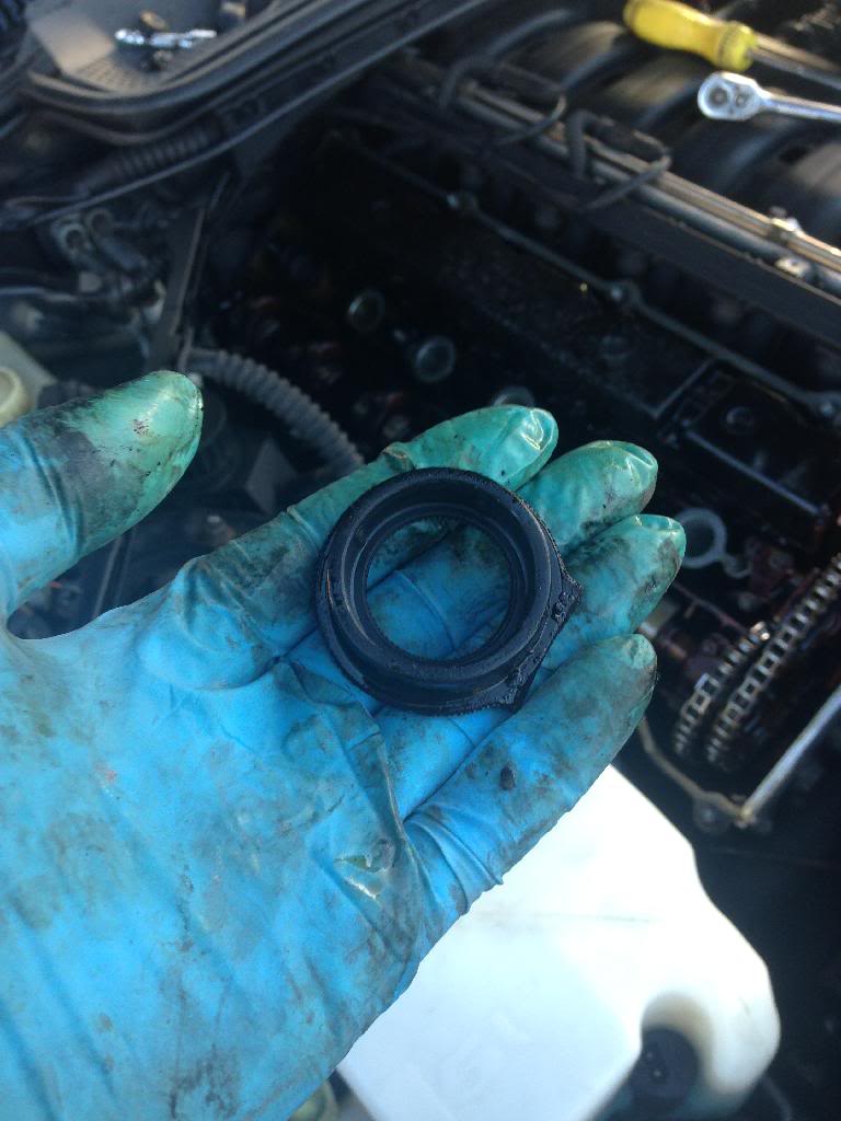

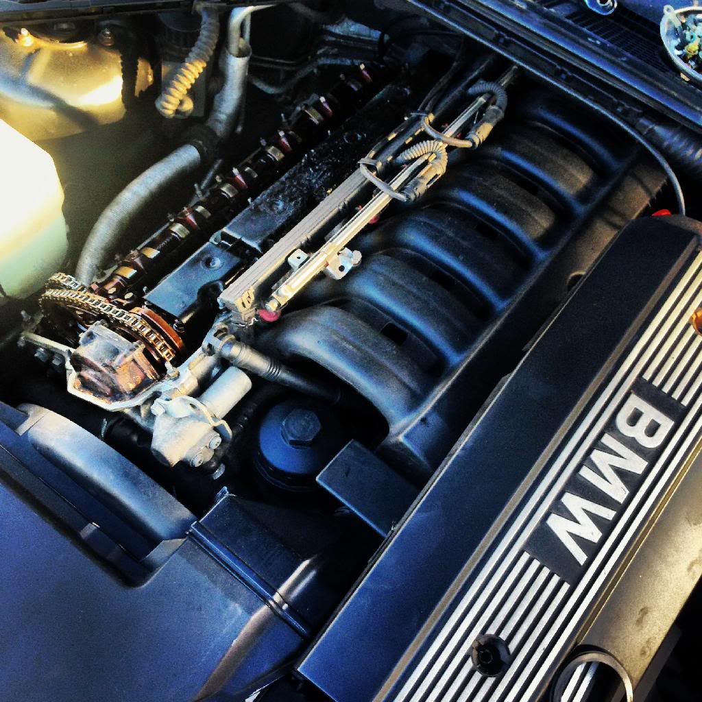

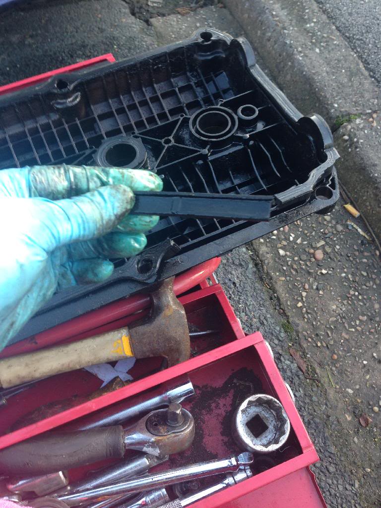

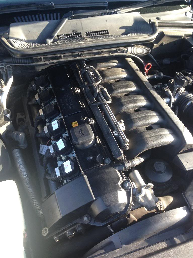

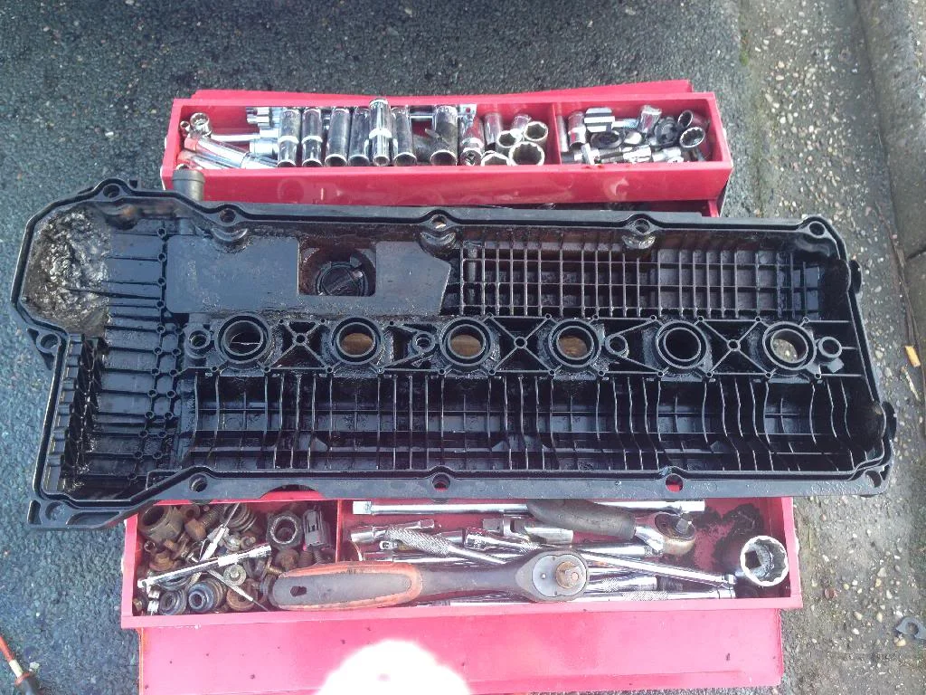

The cam cover seal had gone so decided to DIY it.
Got the parts from Harry Fairbank BMW, £36 delivered for the genuine BMW seal was a no brainer. Also got fresh spark plugs fitted, may as well!
The job wasn't exactly difficult, time consuming though. The old gasket was a pain to remove, rock solid in places, and the center o-rings had bonded quit strongly to the cylinder head and broke off in bits. I had to be very careful not to drop anything into the head.

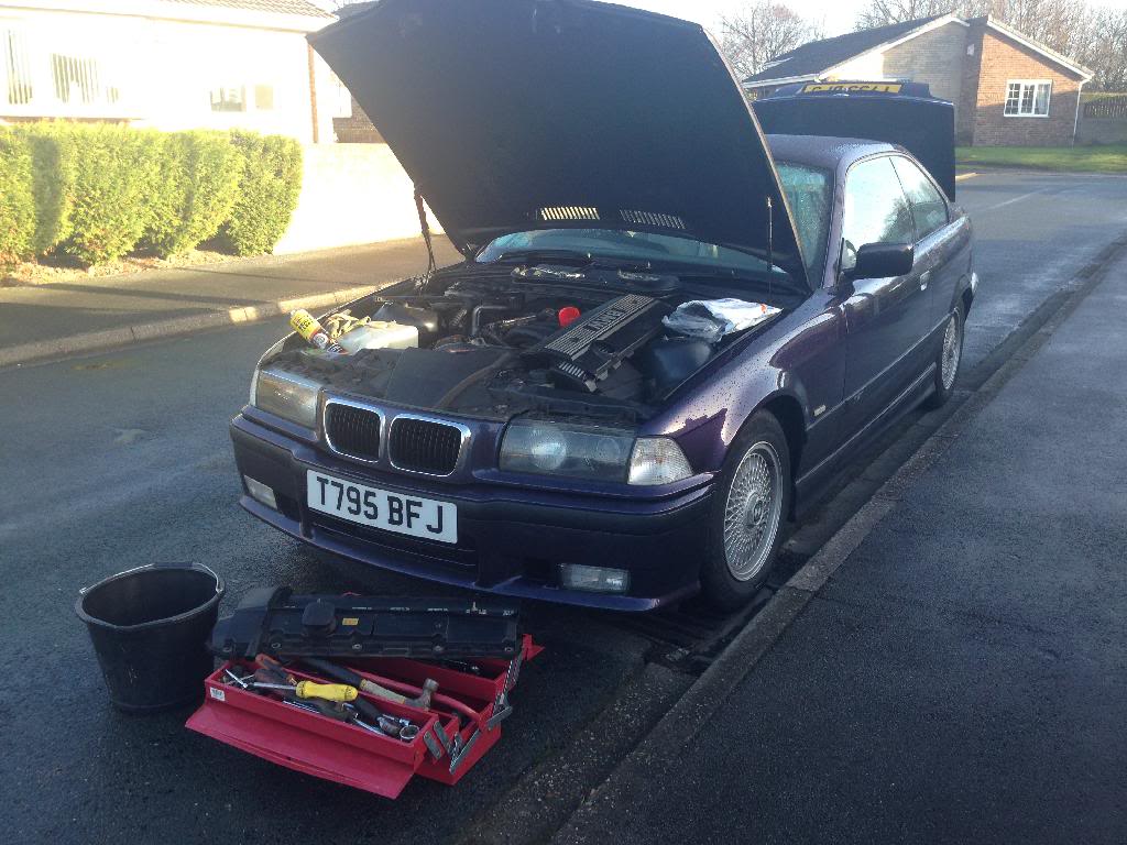

Bright and early(ish) Sunday morning I went out to the car. Decided to do it on the street so if the worse came to worse, I could still get the Integra out!

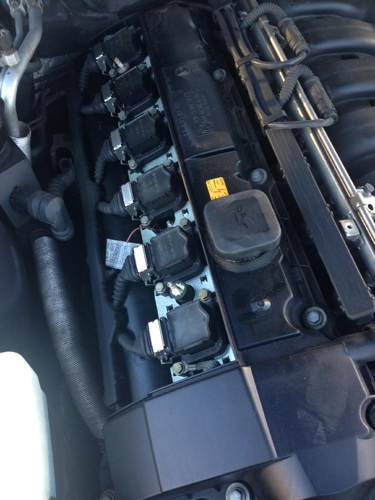

Started stripping the engine covers to reveal the coil packs
Labled the coilpacks so I know which one went where. Not sure how crucial this was, but a few guides mentioned it and peace of mind is always nice. I just went 1-6 from the front to back, not sure what the exact firing order is but lets keep it simple.
The rear bolts are quite a nightmare to get to, you need a variety of 10mm sockets. I had to use a tiny 1/4" drive on this.

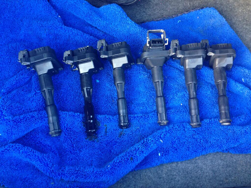

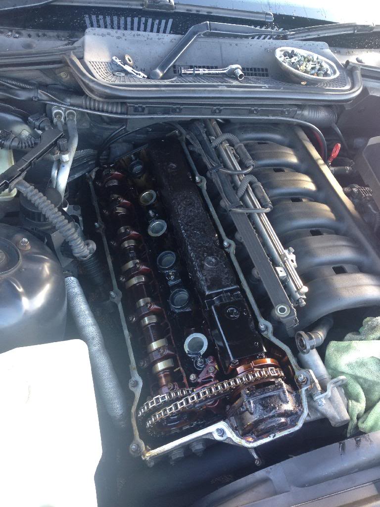

Coilpacks out, and number 5 was a bit, errr

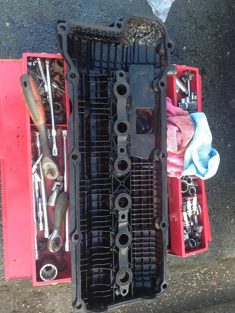

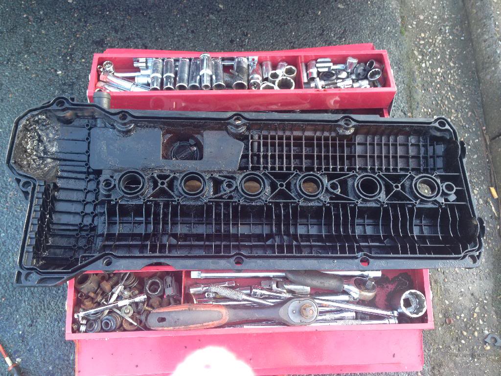

Cover off, not too bad for 150k, a bit of gunk...
Then it was time to remove the old gasket... in pieces

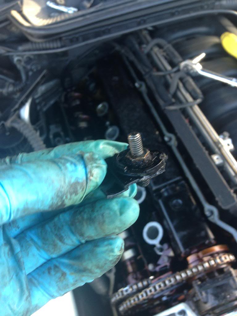

I found it was best to remove the earthing studs in places rather than break the gasket off around it
Stud and gasket, as one...
The center o rings finally off
Coffee break!
I was hoping the outer gasket would come off a bit easier, I thought wrong!
...but after not too long it was off

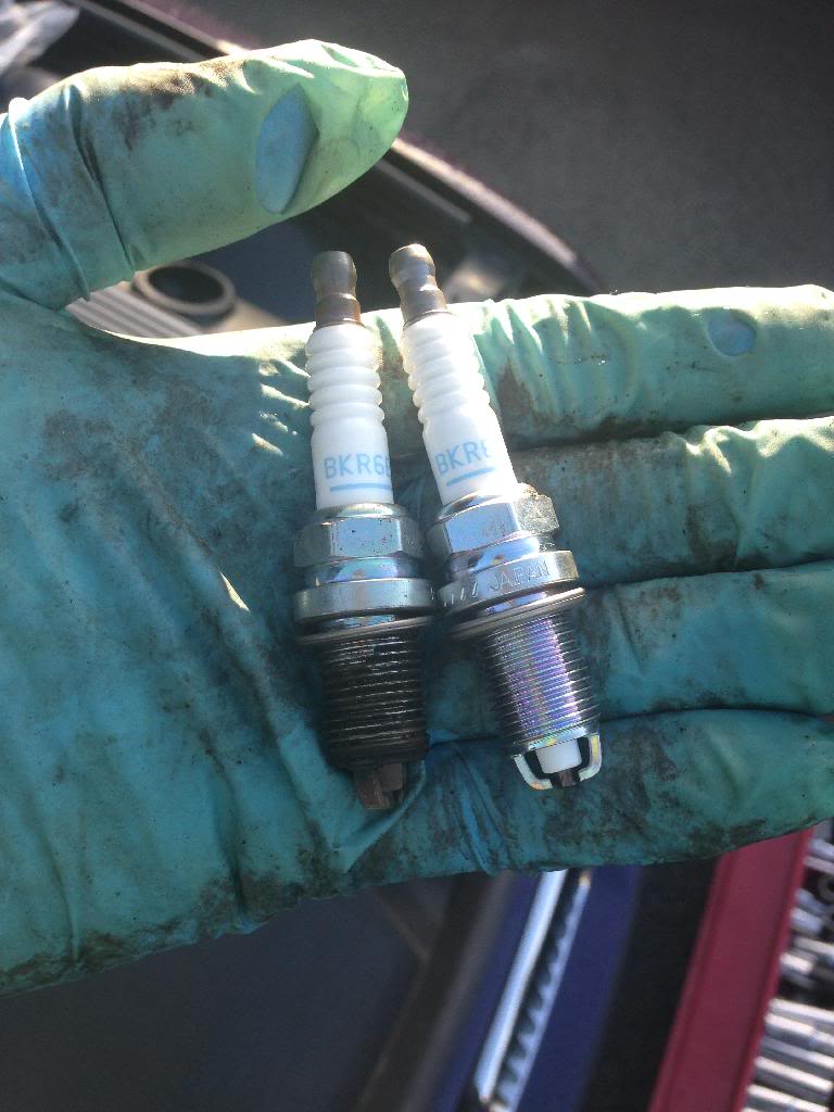

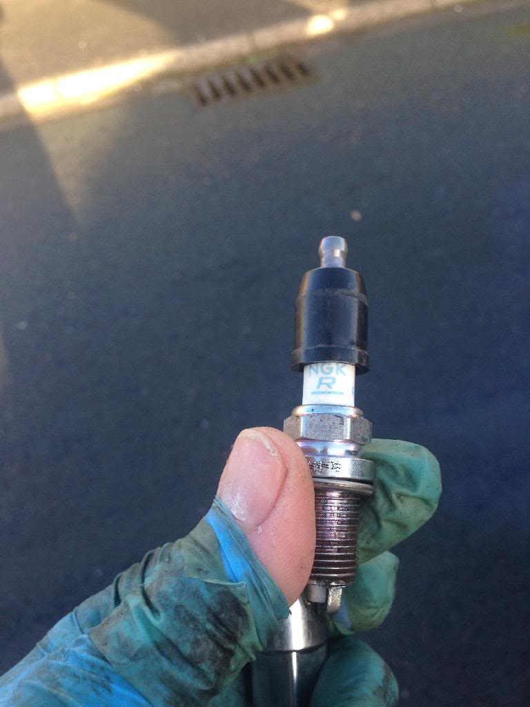

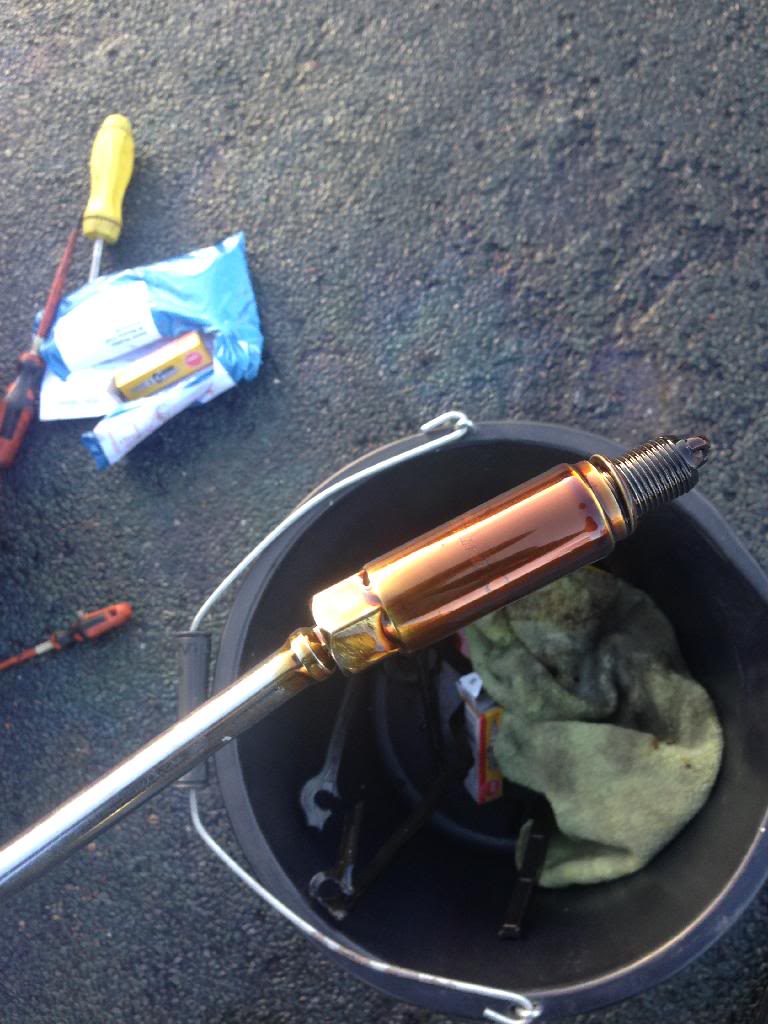

You can't change the plugs without doing a comparison picture..

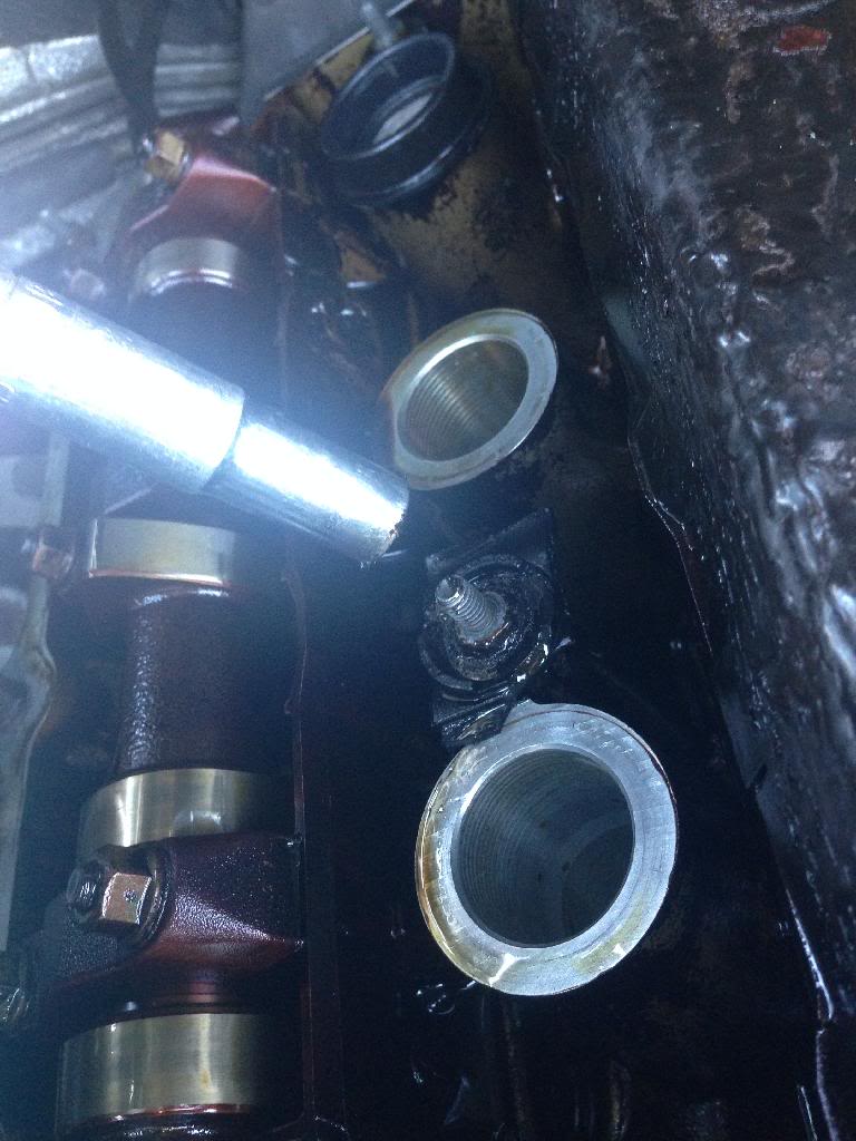

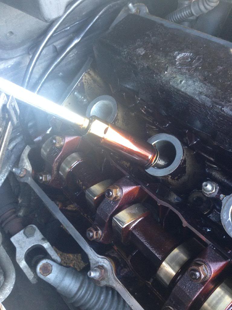

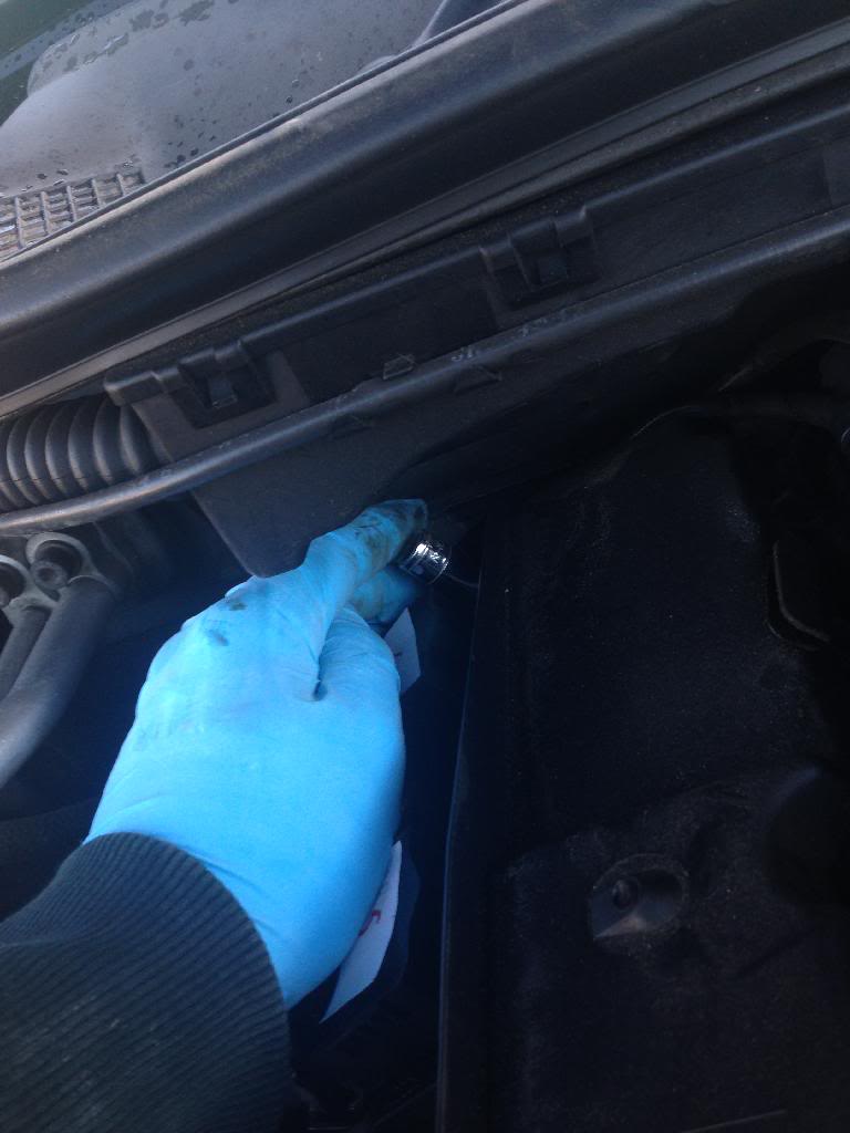

Dreaded number 5 coming out...
The new plug certainly threaded in quite smoothly ;)
On a side note, how annoying is this?!

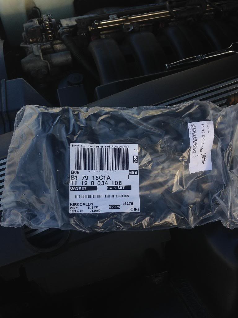

Fresh BMW gasket ready to go!

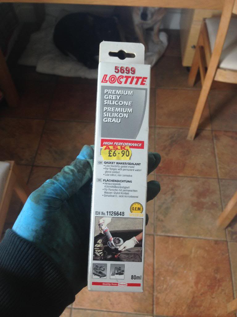

BMW recommend a dab of this stuff in a couple of places which I forgot to take another picture of, wasn't going to bother until I found this in the garage
Everything going back together
Everything went well from what I can tell, very happy with the DIY. The placebo effect of new plugs was great driving to work!

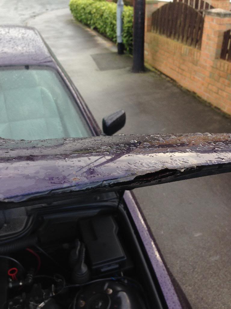

Took a trip to Shrewsbury yesterday to pickup a fresh Techno Violet bonnet.
Mine was badly rusting at the front edge...

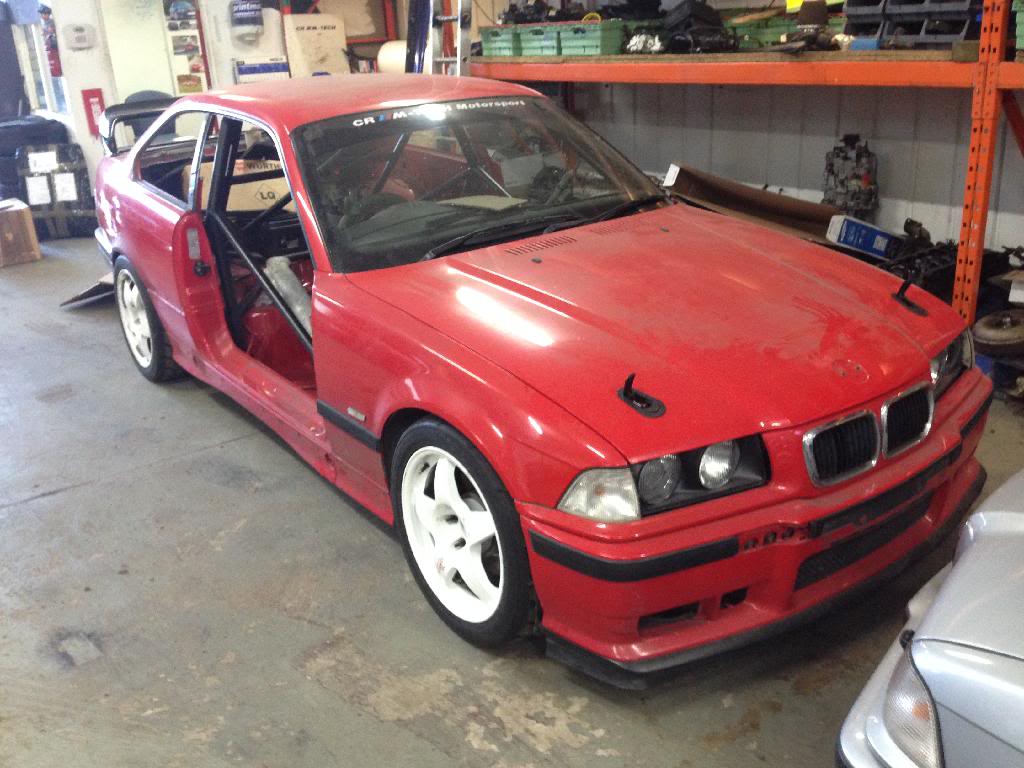

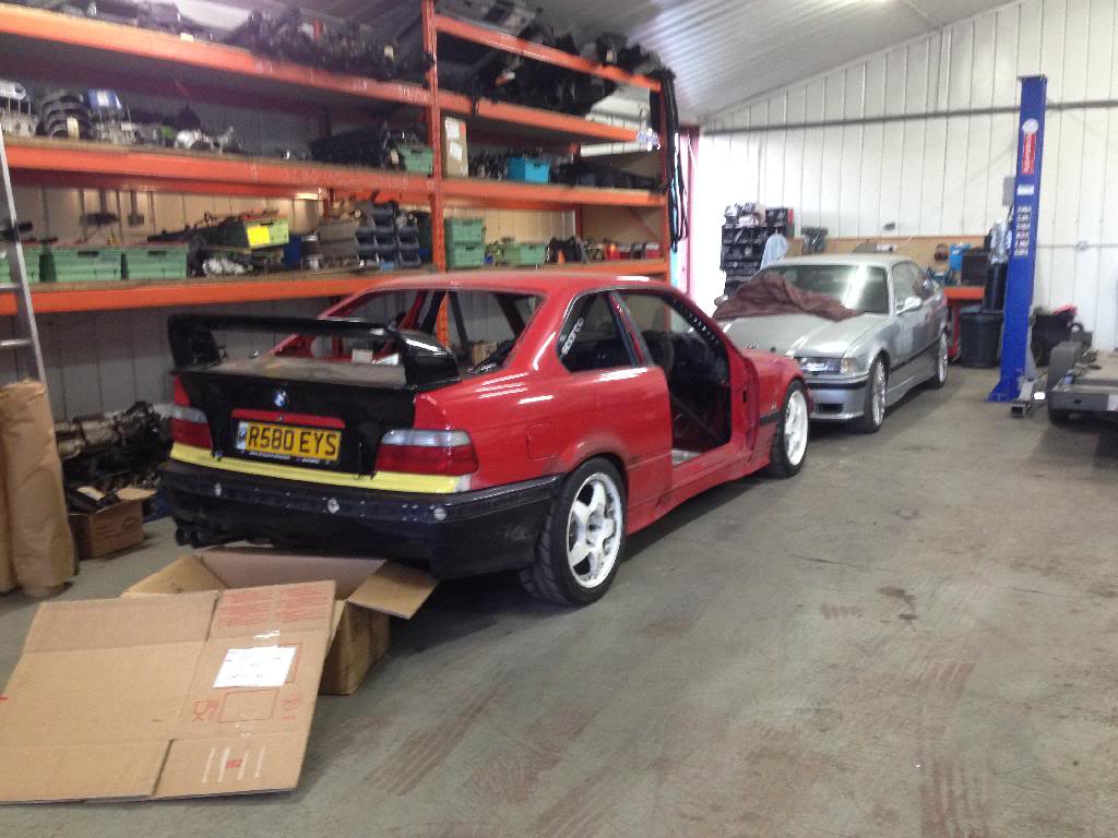

The place I was visiting was CRMTech, who break E36s. Both the guys working there were great and fitted my bonnet free of charge.
As they were doing so, I was having a nosy at this 328 tarmac rally car
It didn't take them long to get it on. Fitment is spot on, and the colour is seamless. Win!!

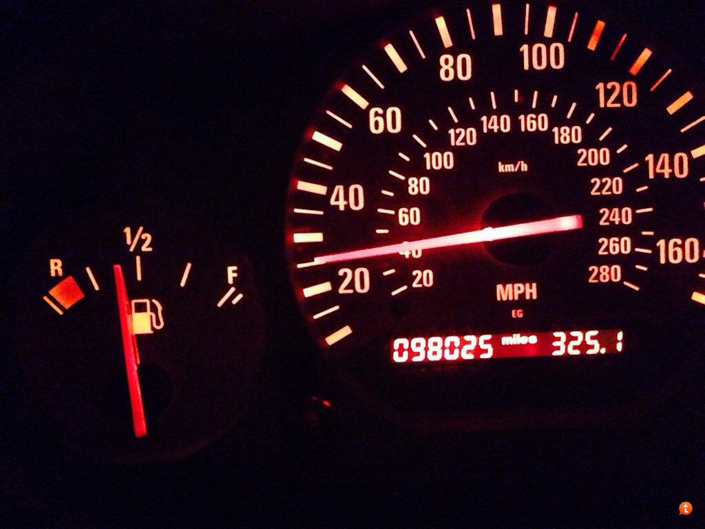

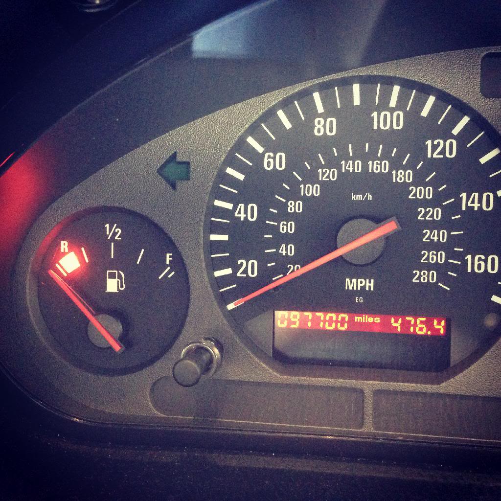

476 WTF! I'm getting 330 at the absolute most. Jealous of the ambers TBH.
Actually I got 365 miles once. Never been able to get anywhere near it since. Regularly 300ish. FML.
I wouldn't worry, I just replied to his other thread with the same :clown:
Usually work from full until the light comes on, so 52L. Does me for about 300-320mi, on a 200k engine. Works out approx 30mpg. I'm on the 3.15 diff though, so RPMs are higher.
Mines always over 400, but I do steady miles. Usually at a constant 60mph for 48 of the 50 miles I do everyday :)
I have a 3.15 3.0 M3 diff too man. I reckon I could crack 500 without it! Try to keep the revs below 3k RPM on the motorway, which is just under 70 if I remember correctly.

Lol - who knows then. I know my consumption is down slightly due to the nikasil bore wear anyway, but you must have a special one - most people I know with them never break 330-340 mixed driving. I do have the inlet and a different map too mind.

I'm hoping that just shows my engine is in good health then. M50 manifold without mapping and M3 LSD and it still does decent MPG. I often wonder about getting it mapped...

Well just FYI, stop-start traffic absolutely kills MPG. Think the lowest I've had was 287 miles. Meh, didn't buy it to worry about fuel I guess...
Yeah I've noticed, I try to judge the speed perfectly at lights/roundabouts so I don't have to come to a complete stop.
