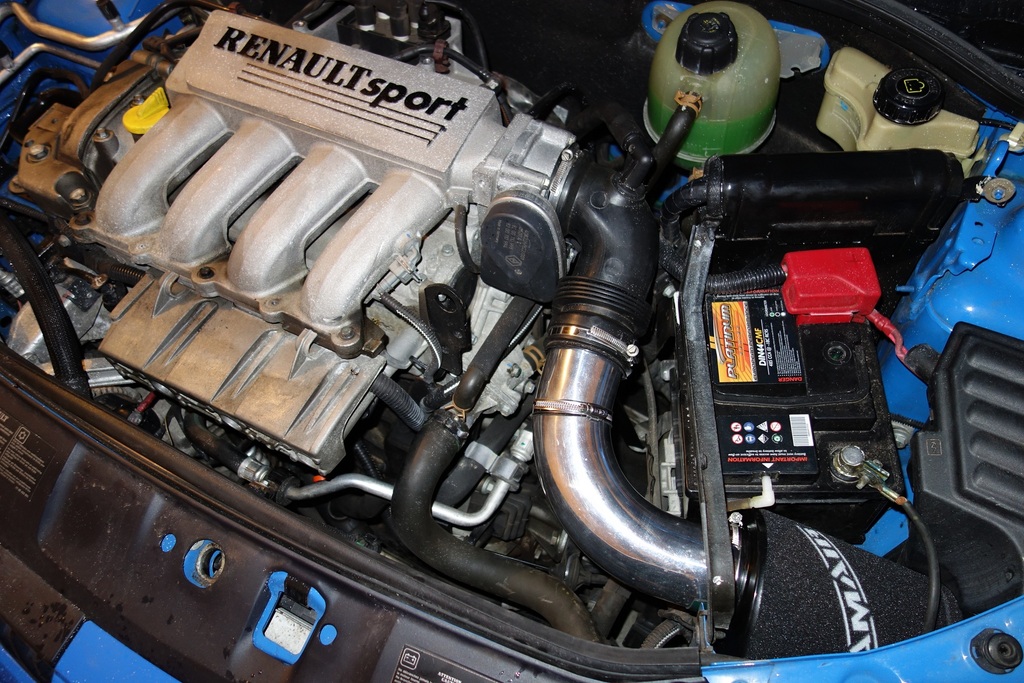

The Fatty's KTEC alternative induction setup that works just as well!
I'm not trying to claim bragging rights that my car is 200bhp just simply showing that this setup didn't harm the performance. I pulls well, making max bhp at top revs. It was just an example of what this set up produces. Take 20bhp off if u wish. Regards the warm up, car was warmish after drive there, was running for 10mins before the rr setup so it was warm enough. We were shocked it didn't rev all the way.

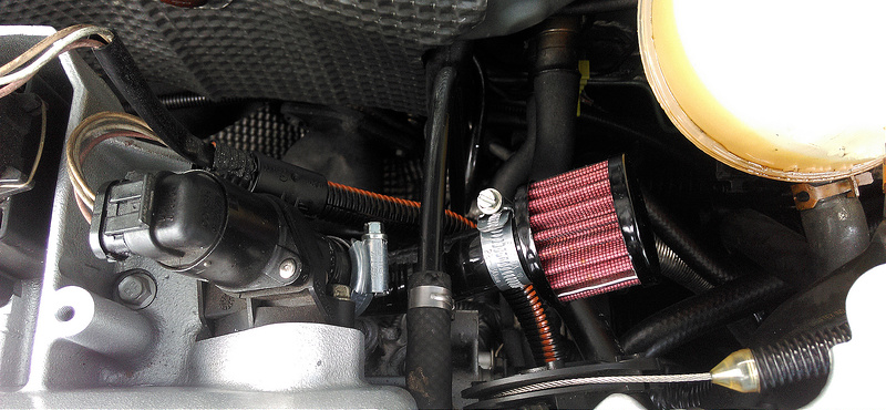

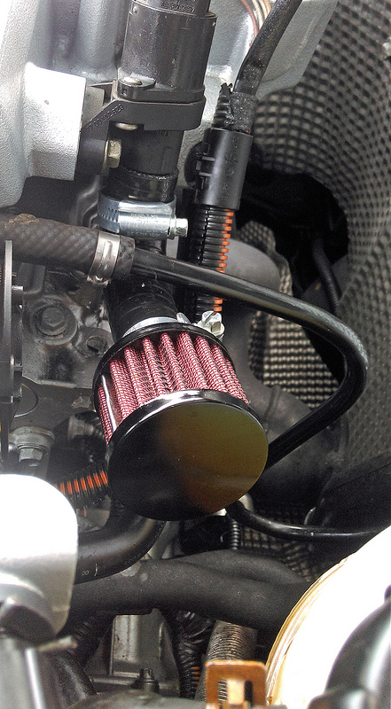

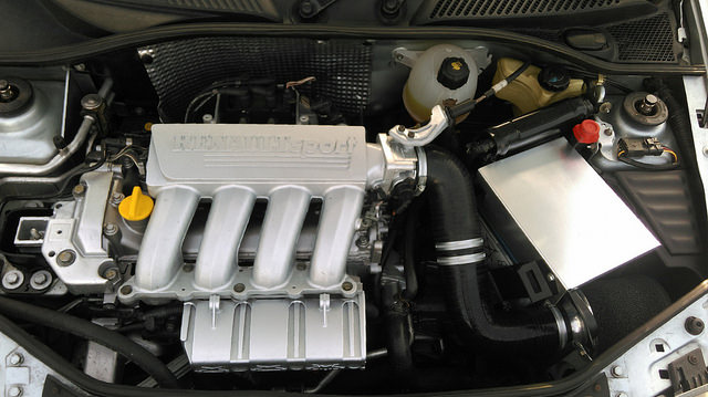

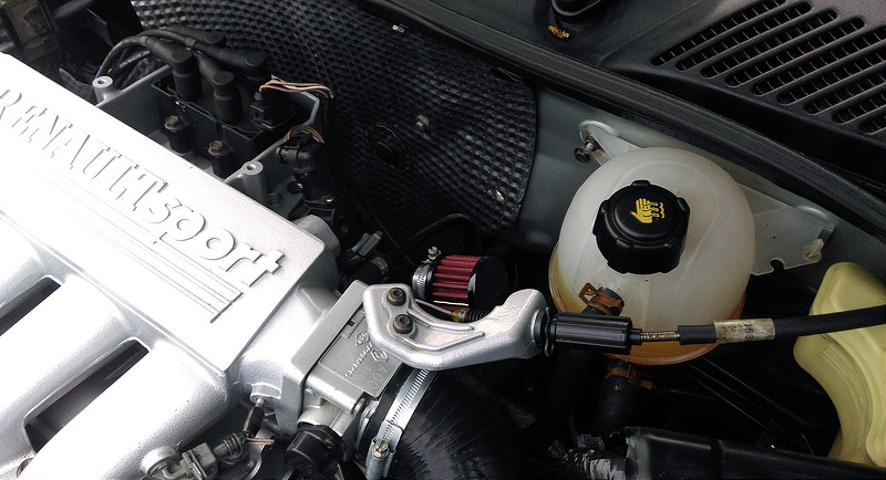

Crank breather? Mine's just on a silicone hose with a filter on the end, you can see it in the back of the photo next to the expansion tank. Some silicone elbows have a hole for the breather anyway, but in this case mine doesn't.
I've got some samco bend the same size as the ICV pipe so I'll run a breather like you've got. Cant quite see in the pic but is it resting on the expansion tank or have you made a bracket?

What crank breather do you mean @Dr Jekyll ?? Is it this bit of pipe?
And presume you just put some other hose and a mini filter on it the same as @McGherkin ?? (I can see that in his picture, yours is slightly obscured)
Also what silicone hose do you use for the filter? is it detailed in your progress thread?

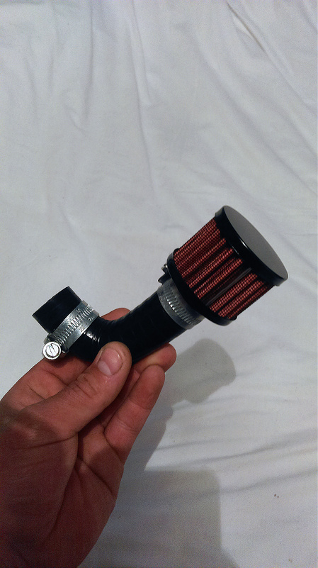

Here is my setup. I thought i had a pic of it fitted but i must have deleted it. I can get a pic for you tomorrow if you require. (Its currently off the car due to the engine going bang :()
Breather filter setup by Dr-Jekyll, on Flickr

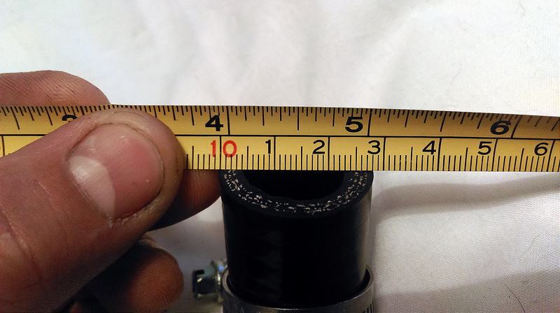

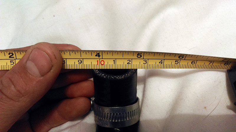

Remove the ICV pipe (circled in your) and replace with this. The pipe is 90 degrees and ID is 18mm, OD is 28mm. This will fit perfectly with the 15mm breather filter. You'll need a couple of jubilee clips and may need to cut the ends down on the bend for a subtle fit.

This is excellent, exactly the info I need, as I had the main filter set up sorted in my head. I didn't know what was meant by the ICV pipe and that just threw me. Will look at getting those parts for next month, time to do some overtime at work as I need to some other things for the car (and house move, but car comes first). Yes I did read about your engine going bang, not ideal really, but all the best getting the replacement in!!
Good stuff :) ICV - Idle control valve. Those bits above are less that £15 delivered. While i was waiting for the parts to turn up, i just left my old pipe connected with nothing on the end. As said, i can get a pic of how it sits if that helps?

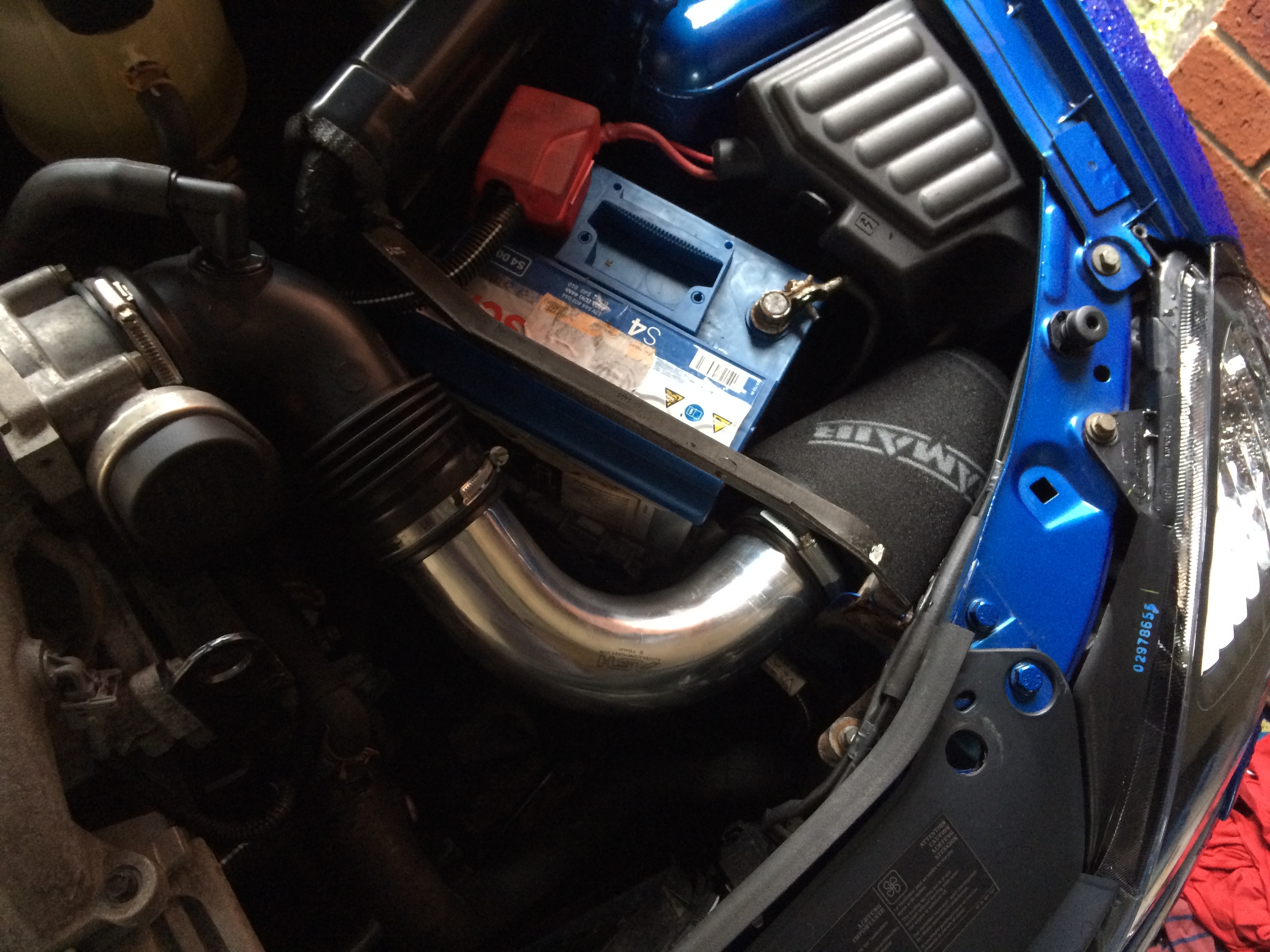

thanks to the fatty for making this thread, I installed this last week and I fricken LOVE it. The sound is intoxicating. I used to have a heavily modified Focus ST (5 pot) and I've missed that sound since I sold it more than a year ago, but I reckon this sounds better! The additional growl you get past 5200rpm is so satisfying.

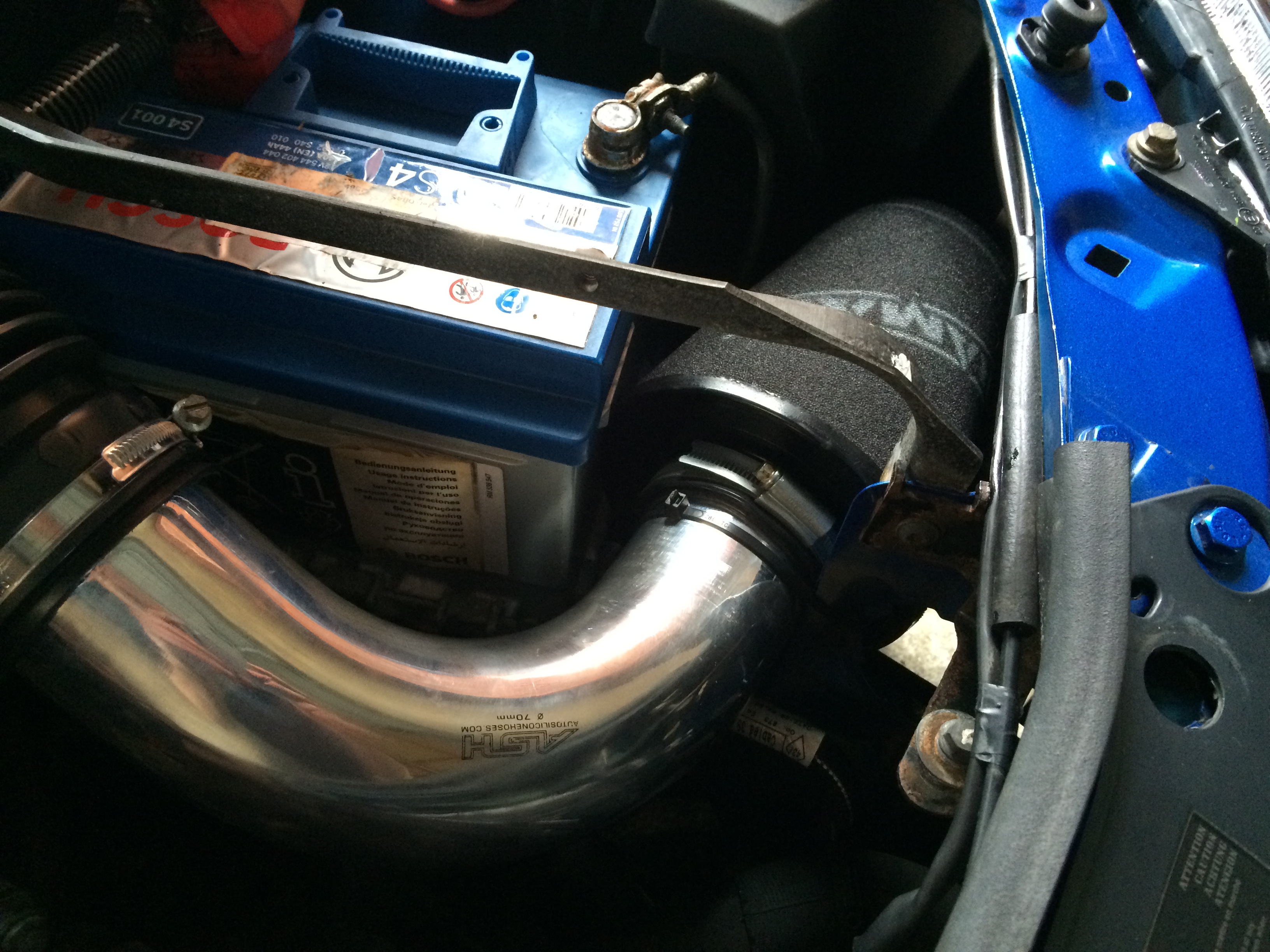

I ended up ordering the Ram Air filter kit for the 172 (rather than the standalone filter), which is designed to stick directly out of the rubber pipe into the throttle body. Less than ideal, but they include a bracket that bolts to the top of the gearbox, and a special jubliee clip like the one on page 1 of this thread. I lined that jubilee with foam and fastened it to the alloy bend and it holds the whole thing very steady without cable ties or any rubbish.

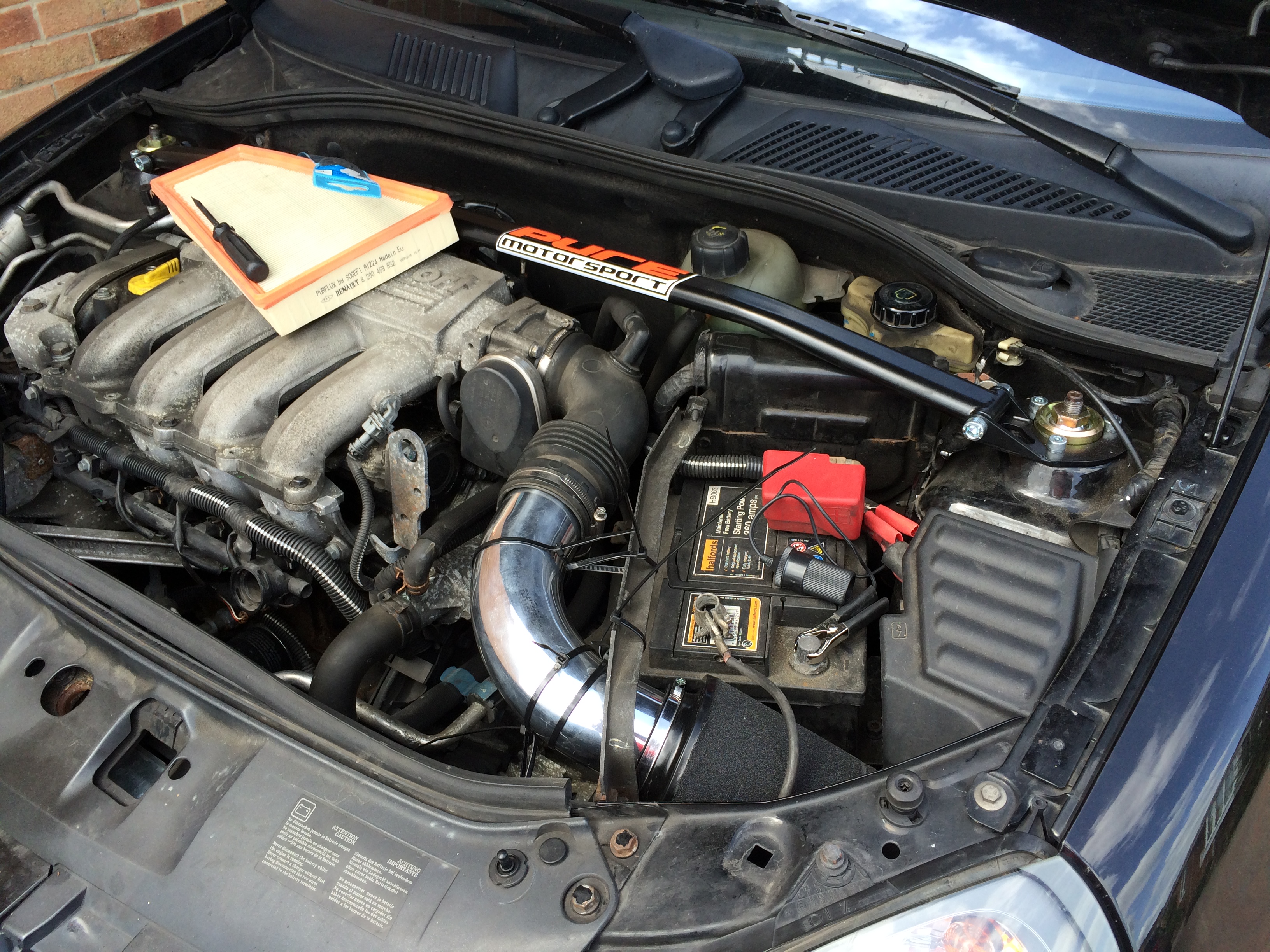

This thing is bloody hilarious! Best thing about it is at smaller throttle openings it makes no difference at all, but put your foot down and it absolutely howls. I've been enjoying letting my inner chav out to play on local roads this afternoon. :smile:

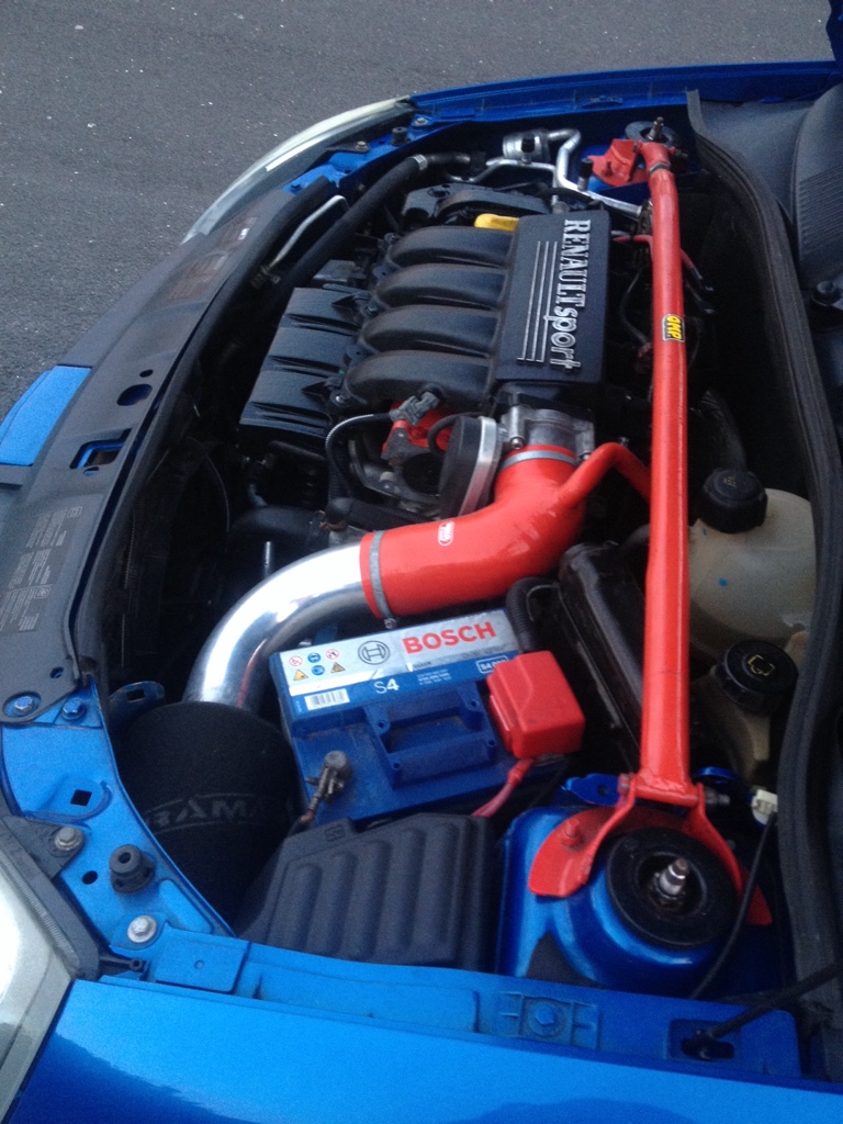

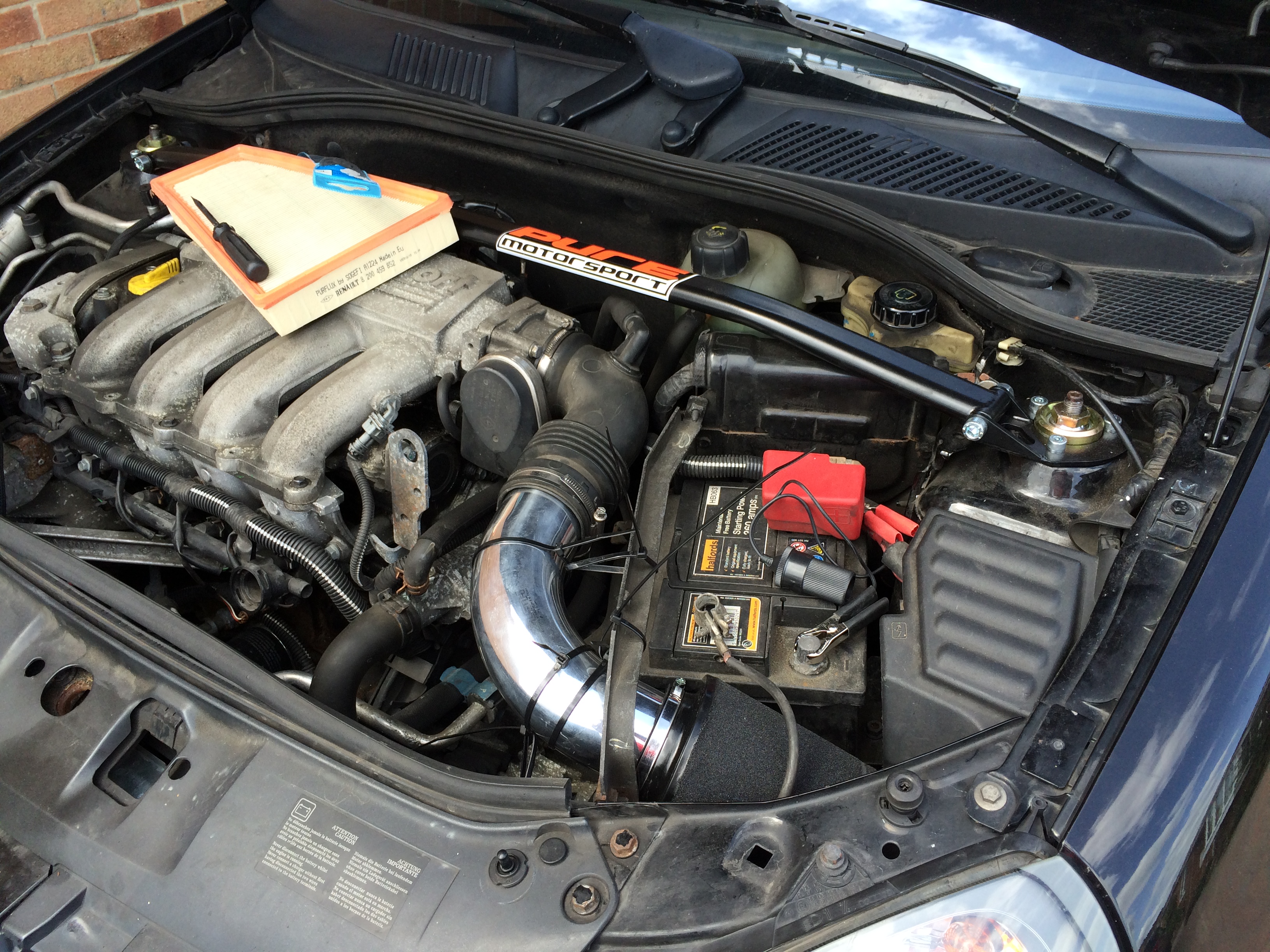

My install. Sorry to all you engine bay detailers/OCD types, I look after my cars, but cleaning the engine bay is not for me. I did at least trim the cable ties down after taking the picture. :wink:
Holy cable ties, batman!
