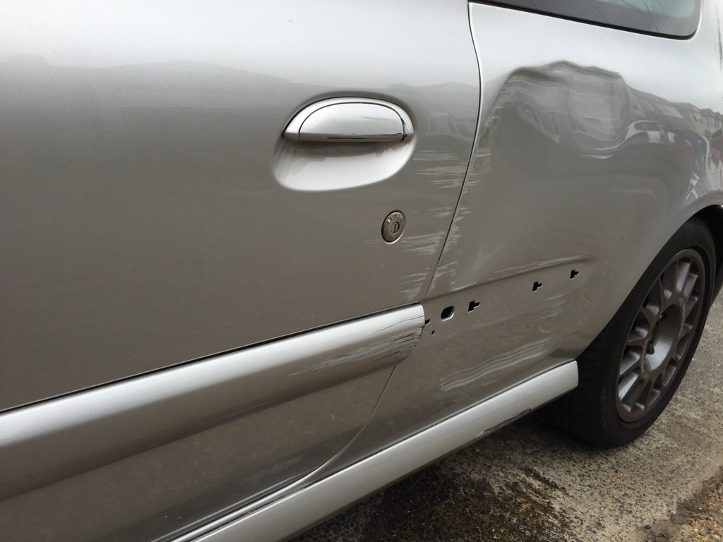

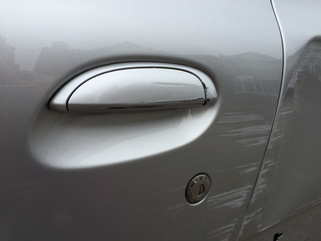

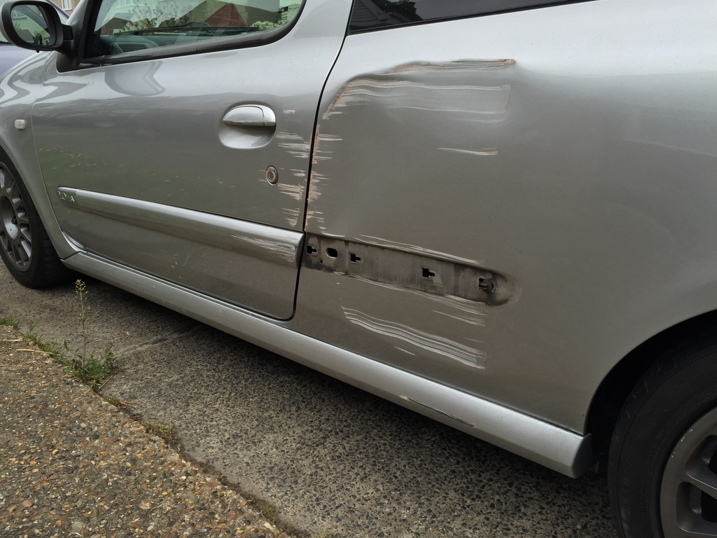

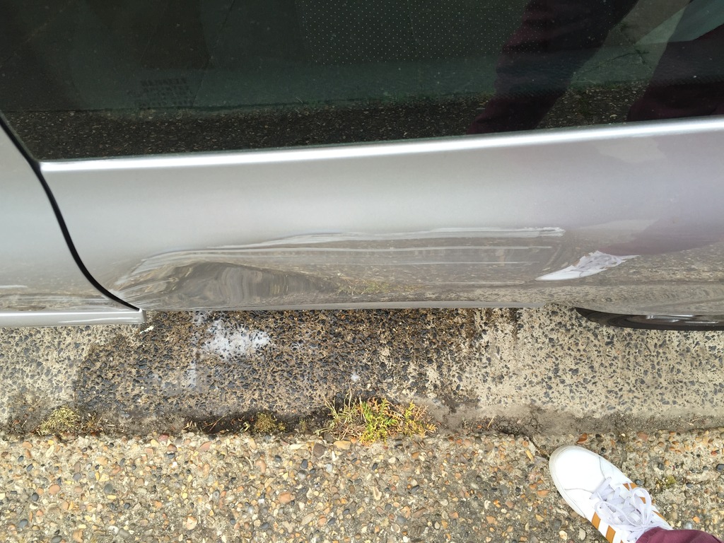

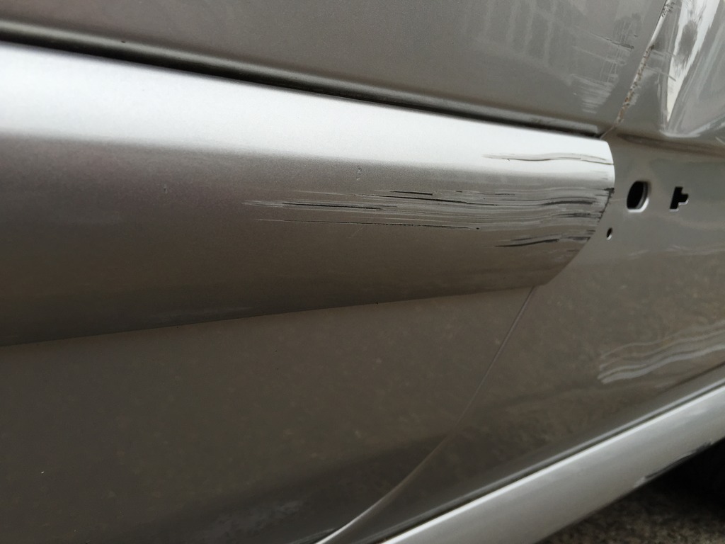

:confused: not content with smashing my carbon fibre splitter off and scratching my wheel to buggery... today she decided to drive into a pillar. Annoyingly as you can see it's not just a single panel that's effected.
I've never actually had to repair a car before so what do I do from here lol. Is it worth getting one of those dent repairs guys out? I'm not sure if that's a viable option as the skirts and door handle etc. will need spraying too. Otherwise does anyone know of a good sprayer in Essex?
Any guesses as to how much this is likely to cost?

Second hand door, skirt, miracle pull the 1/4 so minimal filler is used then paint. Sorted.

So do you guys reckon it's a better idea to get a second hand door and skirt and get the dent sorted by itself rather than get it all sprayed? Thanks for the input so far. As for the toaster, I never did get it where I wanted it, but I put my foot down about the utensils I bought and so far they've stayed put lol.
Silver is the hardest colour to match I would be surprised if its the same shade as the rest of the car once painted.

b****cks really... maybe getting second hand parts isn't the best idea then :confused:
Any recommendations for sprayer around my parts then?

Well if the damage is re sprayed in the same colour it left the factory i can guarantee it would not match 10+year old paint, second hand parts will be better.
Well that is actually b****cks. The shop will just do some spray out cards to get the paint right. Shouldn't be a problem at all now. If you go somewhere with a dupot chromavision or something similar. This is how you do paint nowadays and you won't be able to tell the difference.
