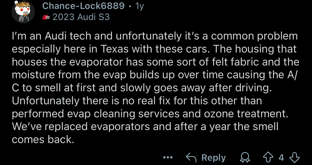

I am chasing a bad smell, a bit like stale urine, in my C7 A6. So far, I’ve checked:
  • Cabin filter, was relatively young, replaced with new anyway
  • AC unit drain, clean and clear, drains to the floor nicely, flushed regardless, water coming out is clear and odour free
  • Cabin intake on the scuttle and the surrounding area, no dead rodents or anything
  • Recirc valve opens and closes as it should, no obvious scent in the surrounding area
  • Run 3x disinfectant bombs over the last few weeks
  • No signs of entry / death of rodents in the car - the car is kept extremely clean
  • No kids mess in the back
  • Smell seems to come from the vents themselves on the dash, and seems to be worse if the car has been sat in the sun. But it’s not every time.
Any help or suggestions very welcome! :sick:

Could it be this?

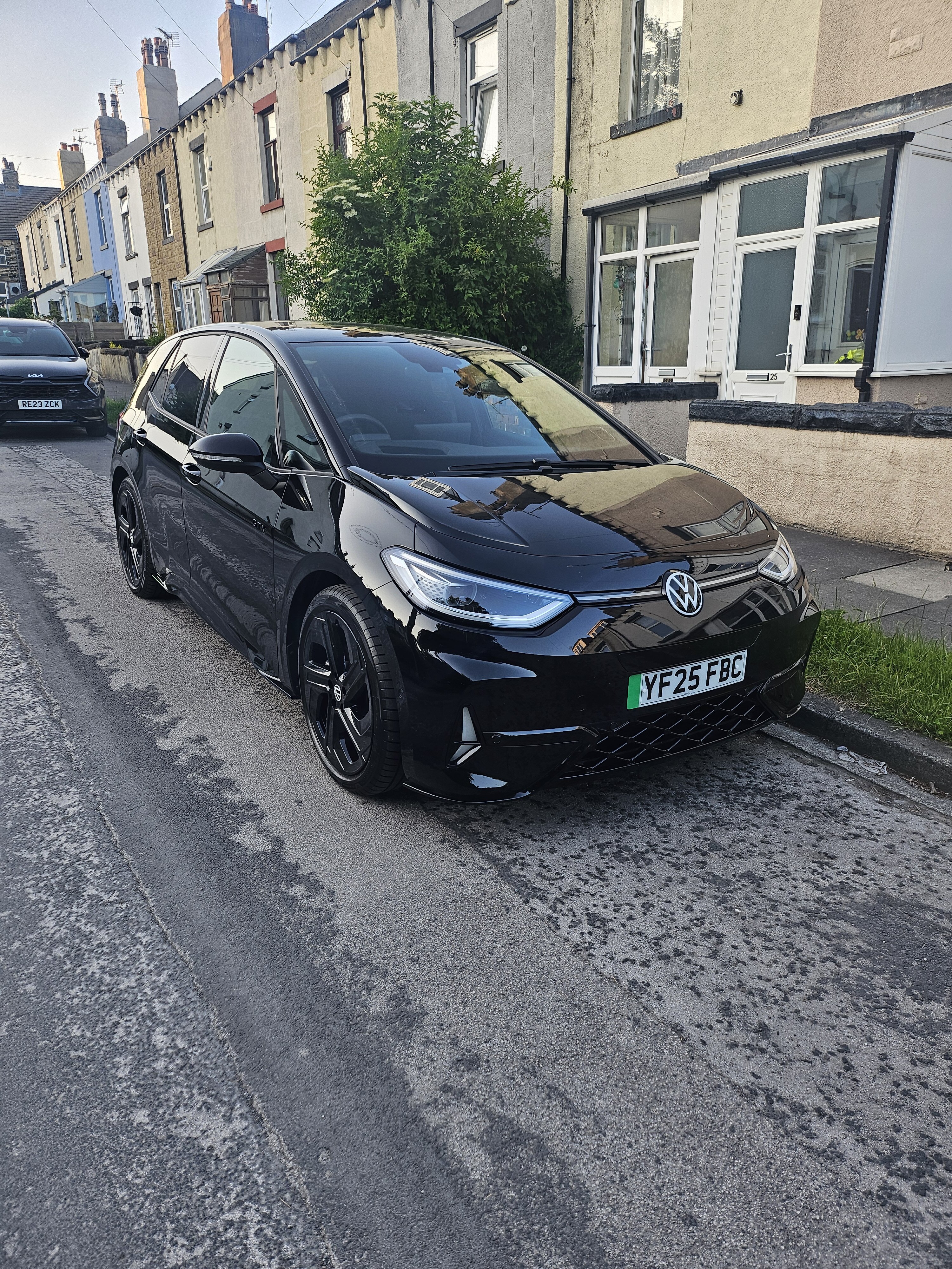

My car is having a service tomorrow and as my brother in law is the sales manager there he's lent me his current demo car.
Its an ID.3 GTX Performance, 300+bhp & instant torque means it really shifts. Especially when compared to my 95bhp Taigo! :ROFLMAO:
