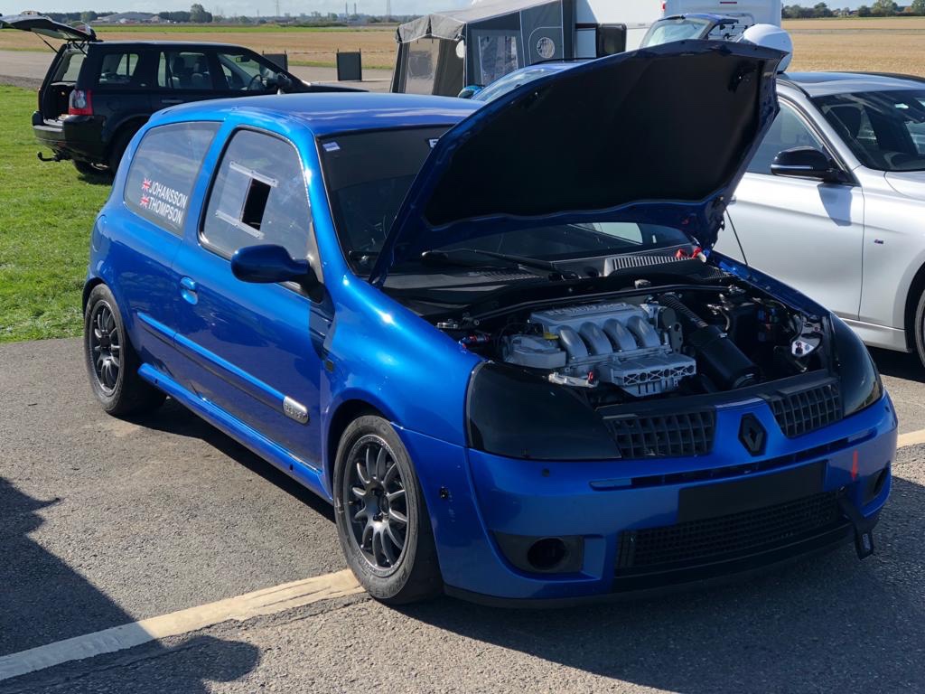

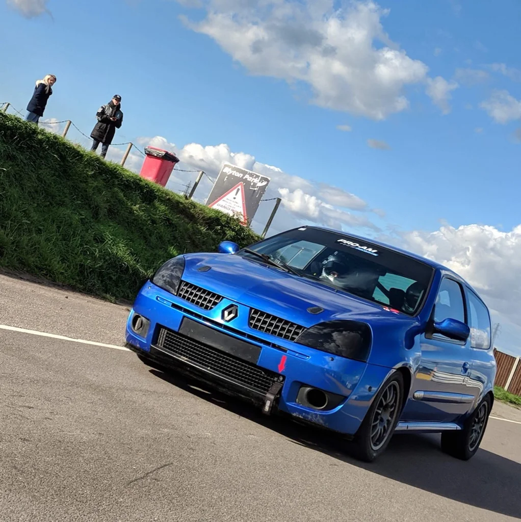

Here’s a few more pics of the day.
Even took the missus out for a few laps!.. she loved it.

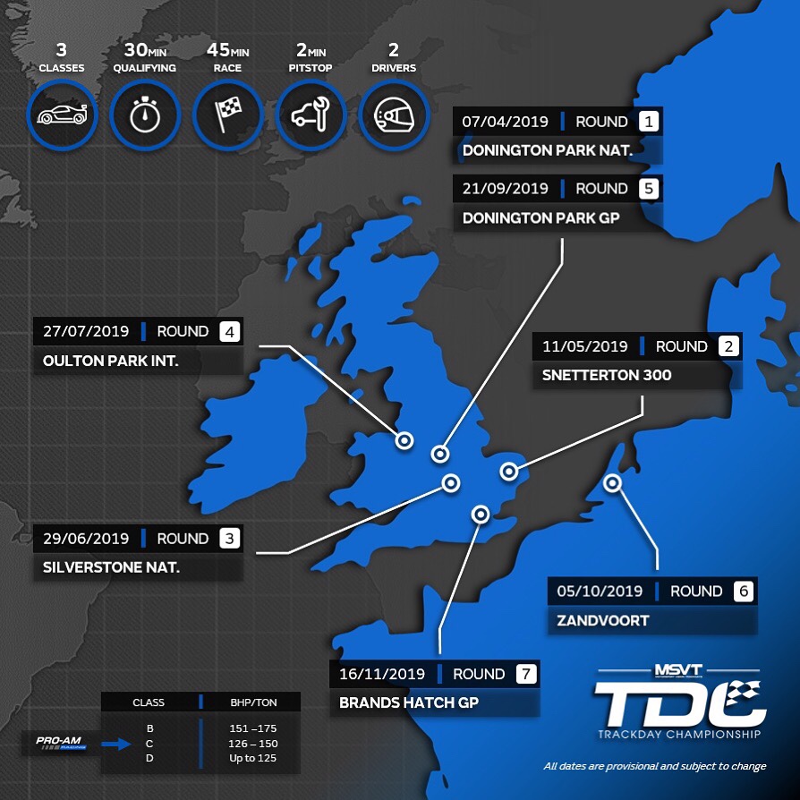

We’ve entered the Trackday Championship (TDC)
It’s 30-minute qualifying 45-minute races
Mandatory 2-minute pitstop for driver change (can have 1 driver cars tho)
They have just announced the provisional calendar
The TBC round looks to be Zandvoort again

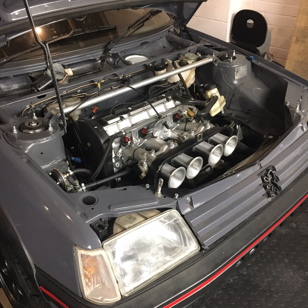

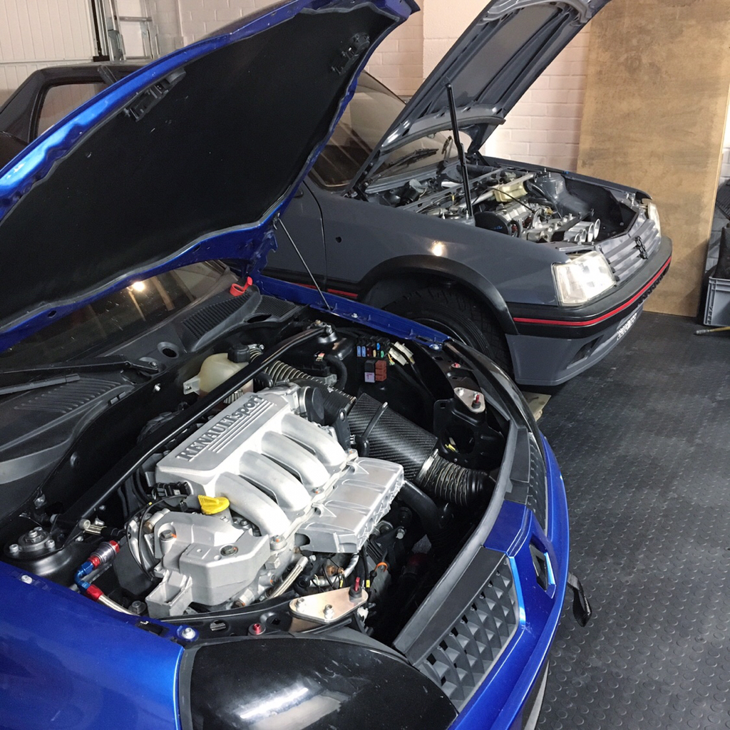

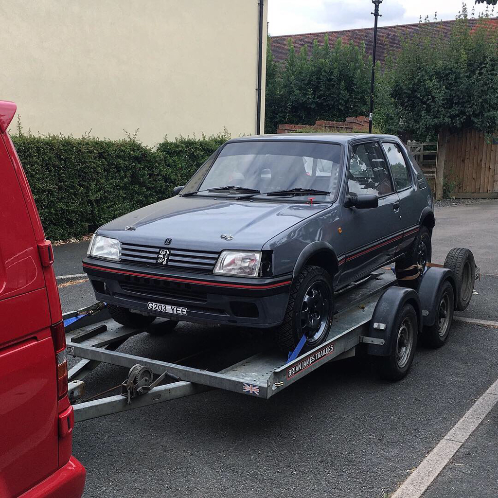

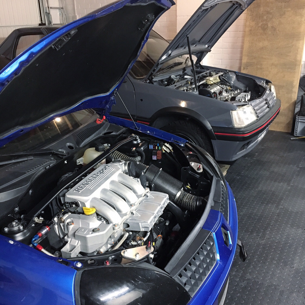

As if I wasn’t busy enough with the Clio, I’ve decided to help a mate out who’s bought a part finished Peugeot 205 Rally car project.. there are a lot of bits to fix and finish
I popped over to pick it up and bring it to the garage
Great motor, pulled from his last rally car (Peugeot 306 maxi) which was built by one of our other friends @coderallying

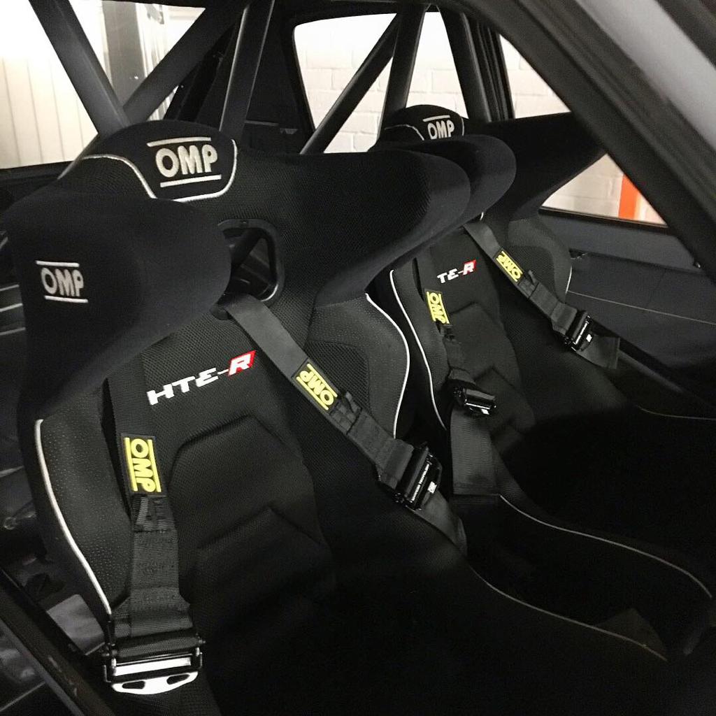

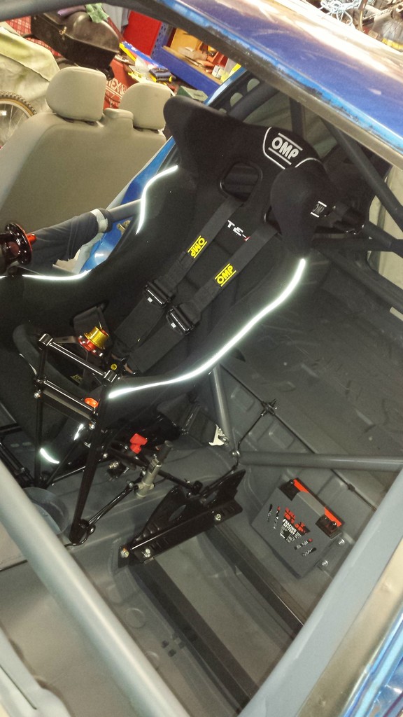

First job was get the seats and side mounts modified and fitted, matched with some OMP 6 point harnesses

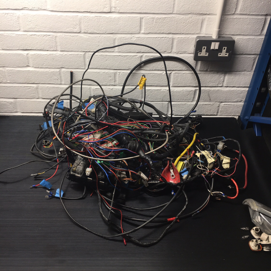

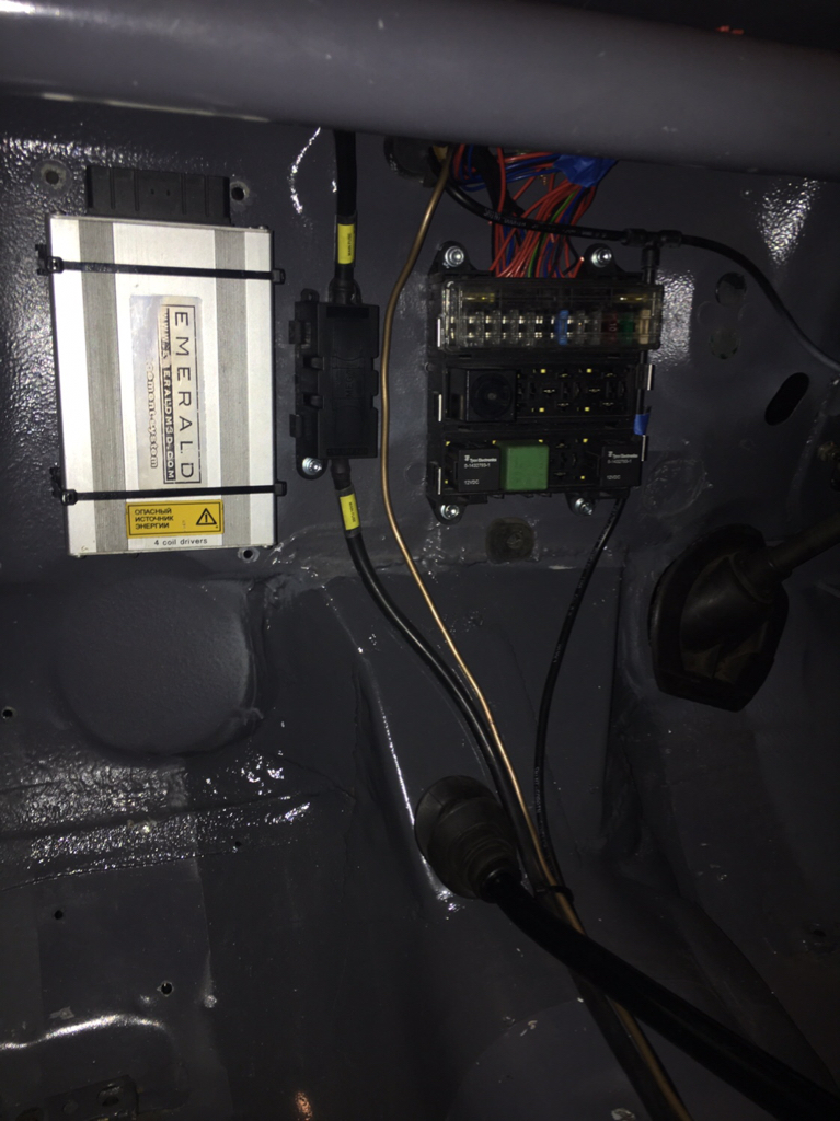

Then I started on the electrics.. the current loom was half finished, and a bit of a mess really, it was a lot of different looms spliced together
I took from it what I could and started to fit the battery and make up all the power cables
Then I fitted the stand alone ECU, main fuse and relay box to the bulkhead (re positioned the brake line and extinguisher line to sit everything neatly)
Then stood back to admire the view
Garage is very French right now!

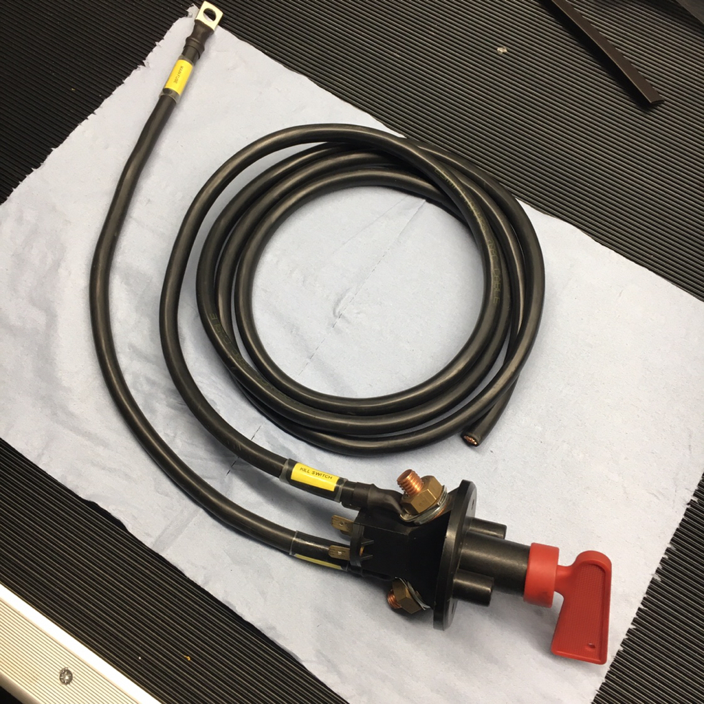

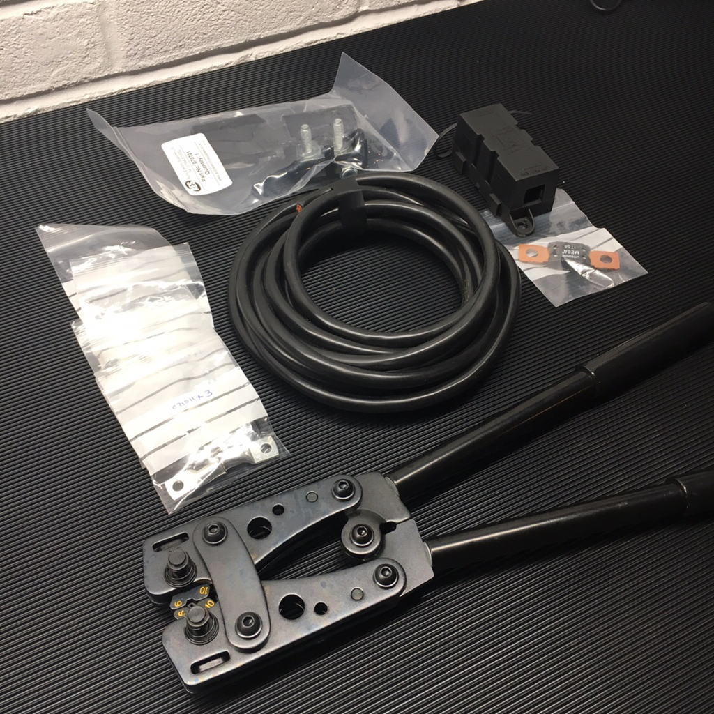

Be interested to see how you wite your kill switches in mate? Do you just run a positive from main battery to a 60amp mega fuse, then onto kill switch.
Tomotek
Hi mate.. yeah we have run a cable from the battery to the main fuse (175amp) then from the main fuse to the kill switch, then on to the starter motor and alternator.. the cable size is 25mm2 rated at 170amps.. this rating is constant and can manage a higher spike.. that’s when the main fuse comes in at slightly above the 170amps .. the feed to the fuse/relay box is then taken through a smaller fuse and smaller diameter wire as the ampage to all the ancillaries is much less.

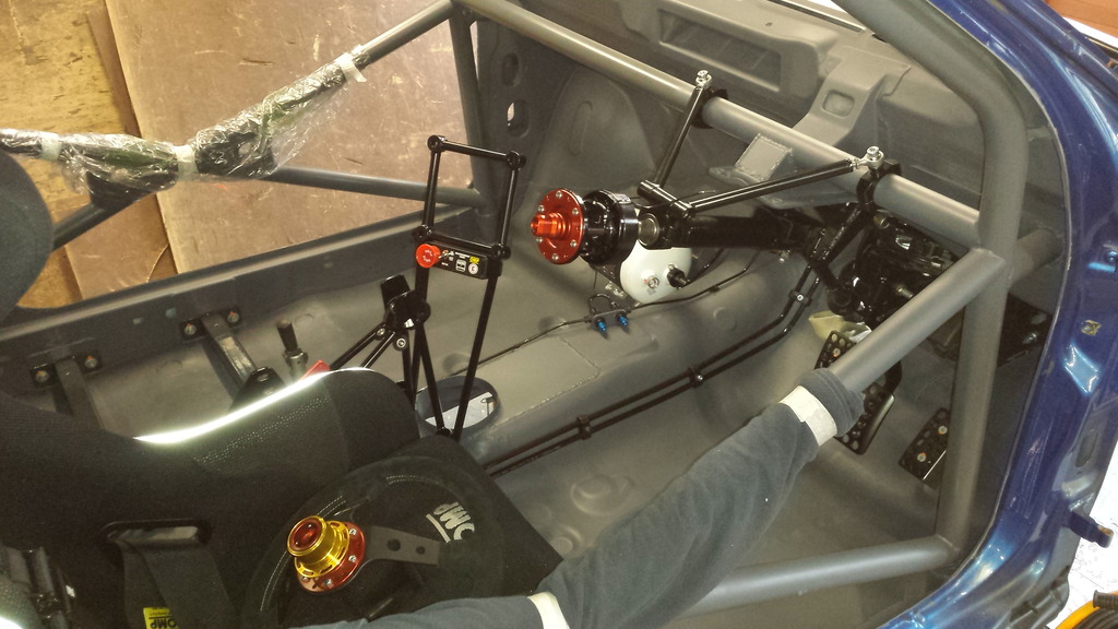

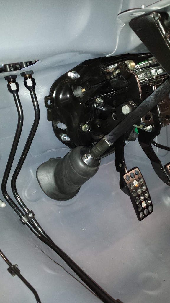

Steering column/boss/quick release were next on the agenda.

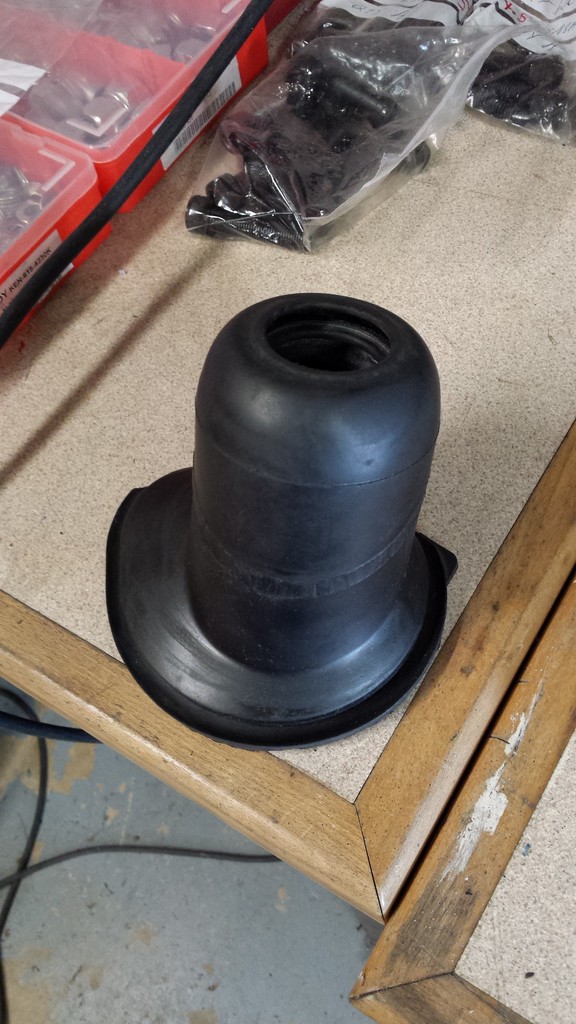

I started out by cutting down the column/bulkhead, bearing/seal (it has a large flange for mounting to the sound deadening) You can just see the faint outline of where I cut it half way down the shaft.
I then installed the column and mount with the rubber seal into the bulkhead. Seen from both sides below.
View attachment 1297025View attachment 1297026

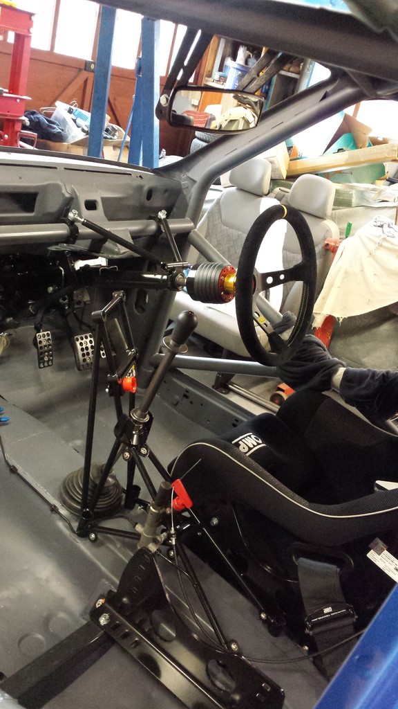

Next the seat and harnesses were fitted so that I could set the height for the column/steering wheel.
Both myself and @Jenbo sat in the car and as we are the same height, the final height worked for both of us.
Column clamp was set and tightened up onto the cage.
The longace wide angle mirror was also fitted to the cage, along with the custom shifter arm and rubber boot.
The steering wheel boss boot and steering wheel was also fitted.
Looking more like the office we wanted now ;)

Loving the switch panel/gear shifter idea, how did you go about extending the linkage rod to move the shifter back and how did you go about increasing the height of the shifter without adding more throw? Or is that just the standard height of the PMS shifter?
Don't suppose you could knock up a second version of the setup for some cash? ?

Hi Steve, as you read, its a fully bespoke system with a reduced throw (enabled by moving the pivot point, and extensive mods to the tunnel area) but the end position is so worth it.. sitting so far back with a higher shifter is so nice!
I am working on a more customer friendly version which I intend to make at some point next year if there is enough interest. Next year is looking incredibly busy though, so not sure on time frame at the minute. I'll keep you in the loop!
