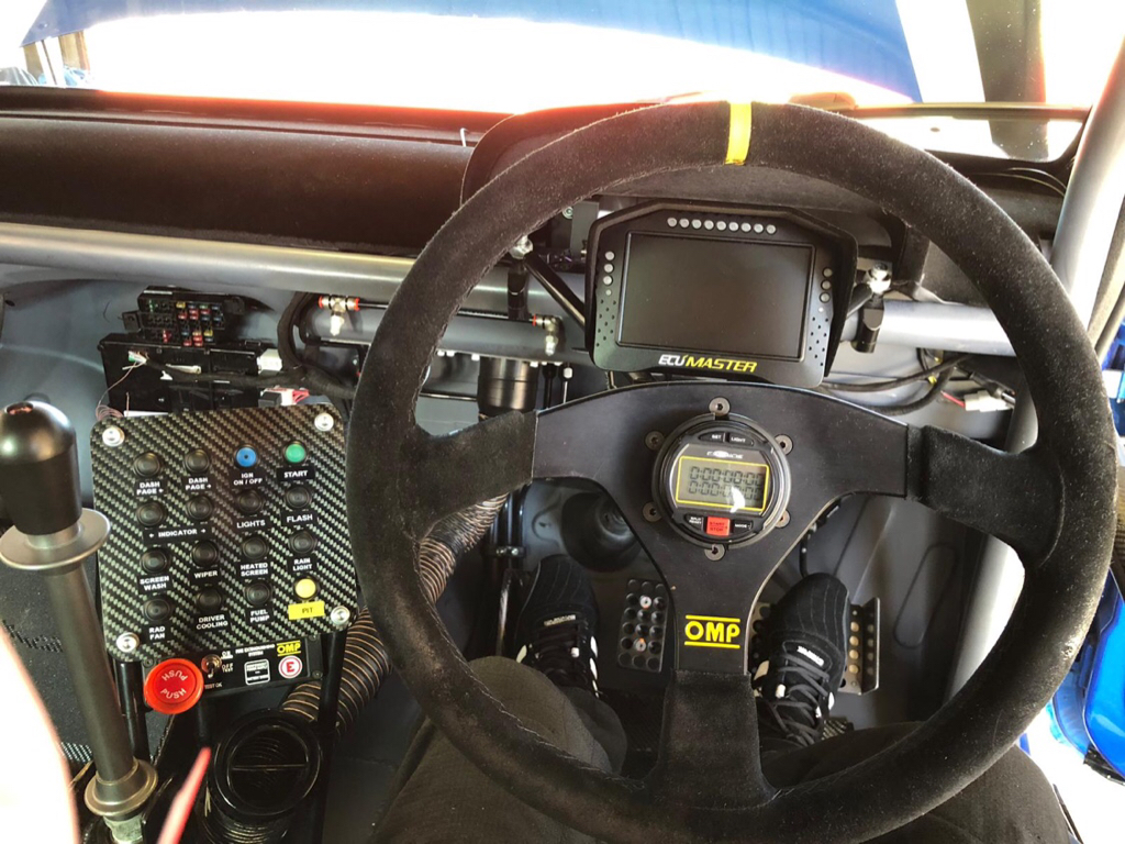

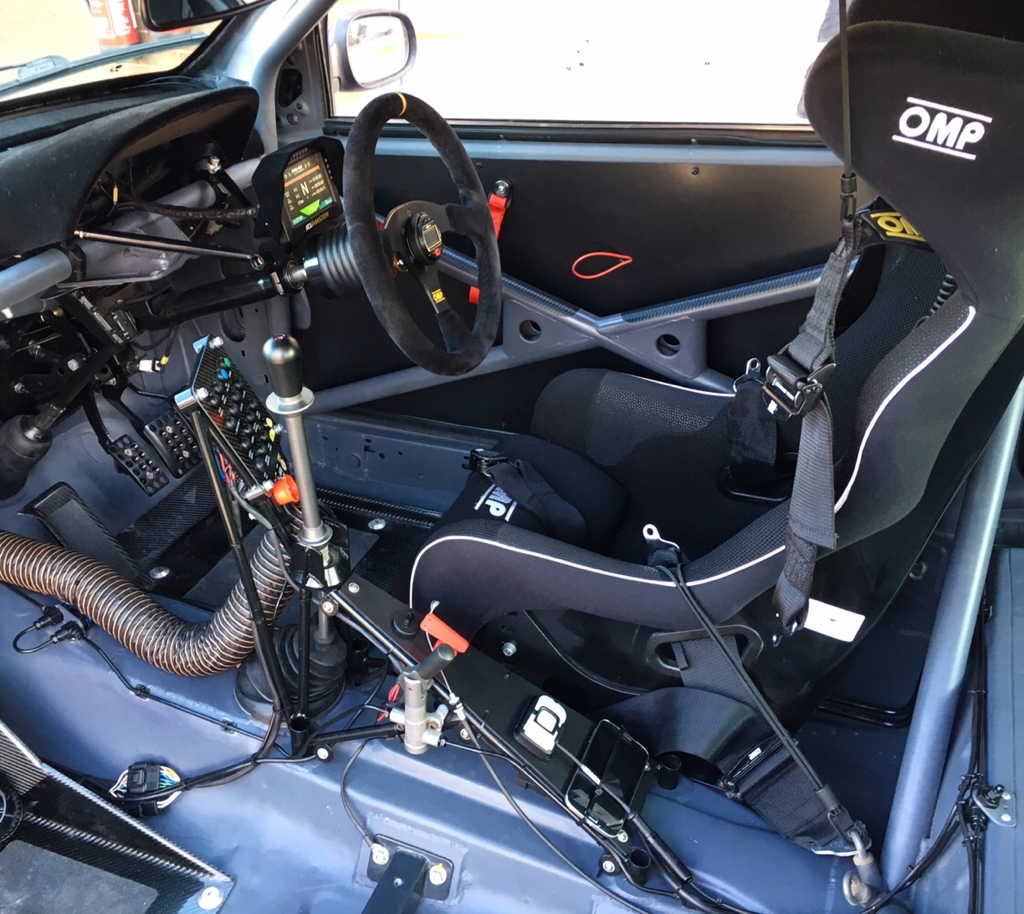

What's the reason for twisting the wires in the loom?
Hi.. two reasons really.. certain wires are for CAN Bus signals going between dash to car and dash to GPS, these wires have to be twisted to cancel out electromagnetic interference (EMI) from external sources, power cables or other twisted pairs... and secondly the main wires where there are a large quantity are twisted all together to prevent any strain in the loom.. it enables the loom to be bent 90deg without snapping any wires inside the heatshrink.. if they were all straight the inside wires would have to bend at a much tighter radius than the ones on the opposite side, which would have to stretch.

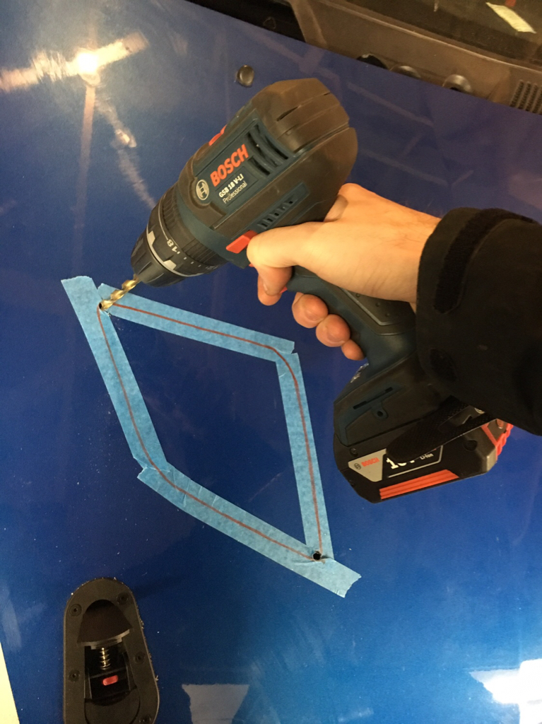

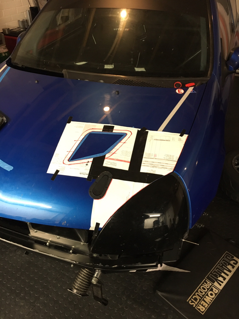

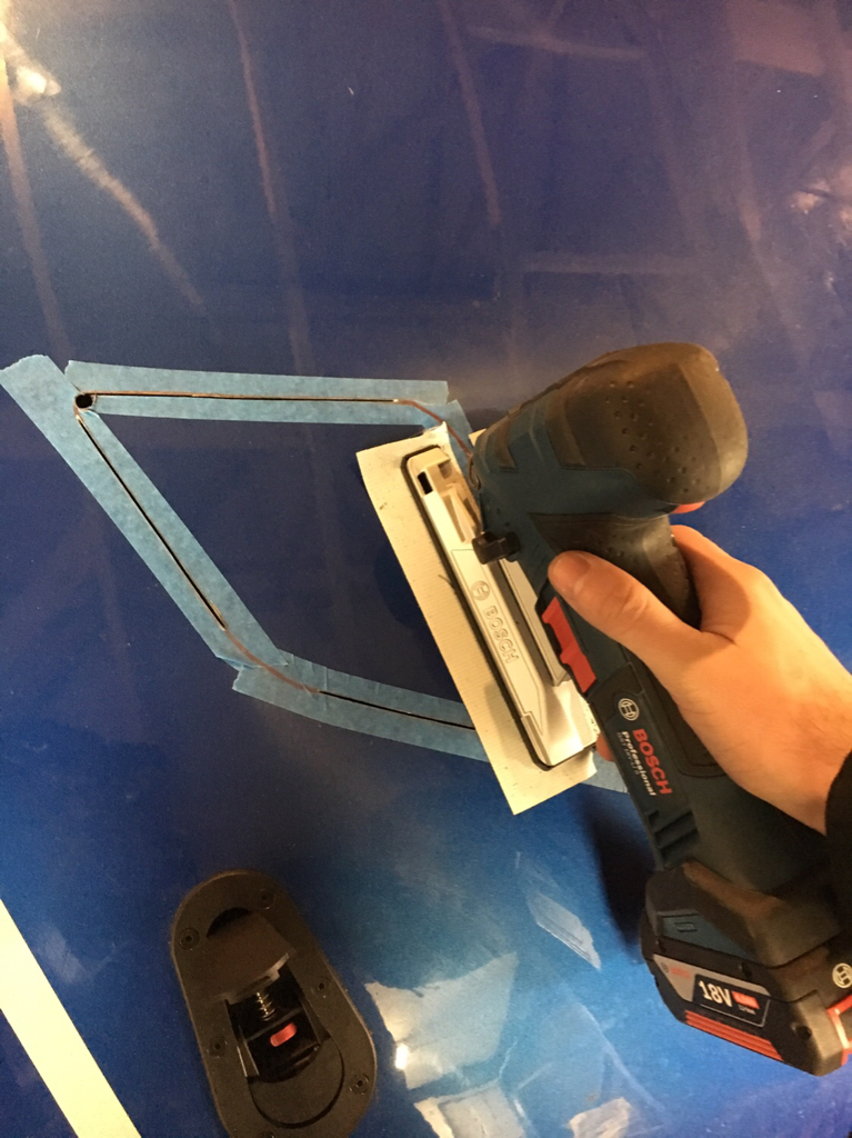

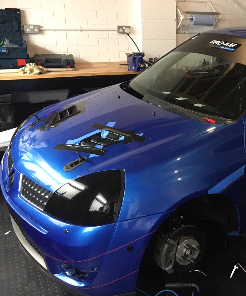

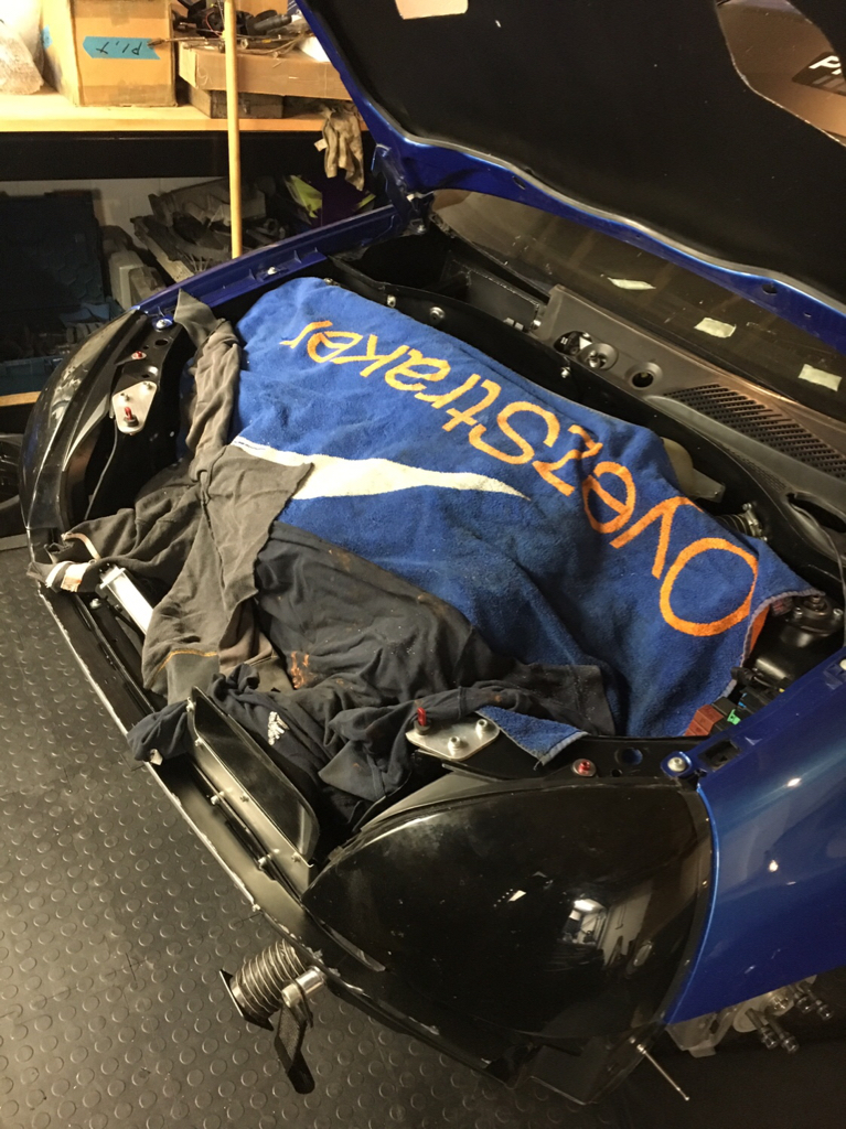

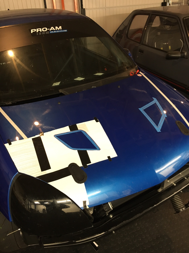

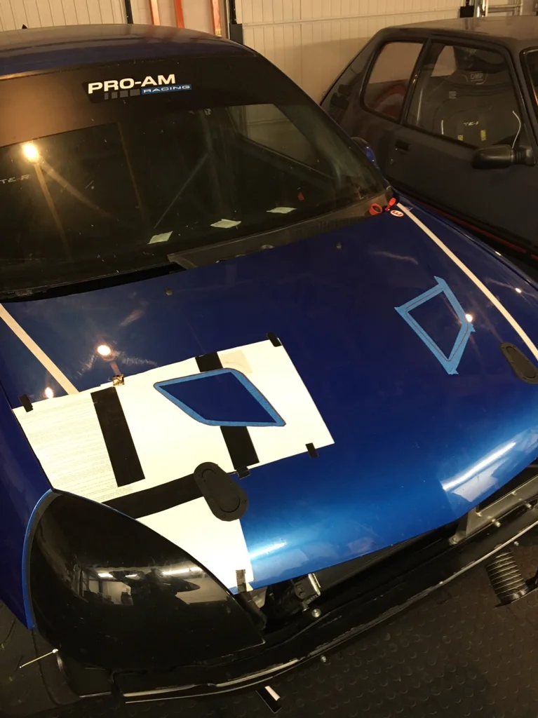

I bought a set of the fiesta vacuum formed ABS vents.. thought they suited the bonnet shape the best.. and allowed the most airflow in the area I wanted.
First job was to mark out, using a template I made, where I wanted them to sit.
I then flipped this over to mark up the other side.. the same process I used for the aerocatches

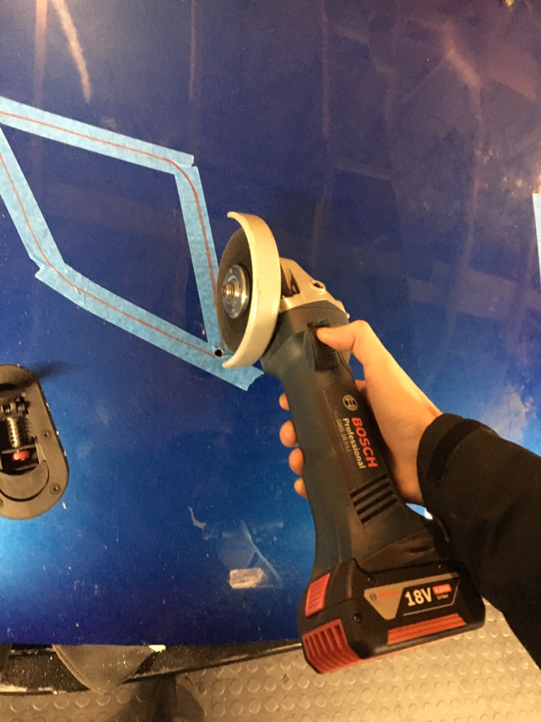

I placed towels over the engine to catch all the swarf and grinding dust which would follow
First job was to drill a hole for the small radius.
Then I used the grinder with a slitting disc to cut the straight lines
Then finally I used the jigsaw to cut the larger radius curves
Last job was to peel off the masking tape and sand the edges smooth and prep the area for bonding,
I then ran the car up to get the engine bay and bonnet nice and warm, to help the silicone set.. I used Sikaflex 221 sealant to bond the vents to the bonnet, same stuff I used for the rear poly windows.. these were held down with strips of tape during the boning process

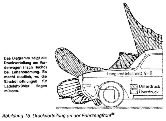

Hi,
dont get me wrong! I was only a silent ready, which was and is impressed by your project car. And I Wish you all the best for your sponsor search. This was only a joke, not the best maybe.
But now seriously,

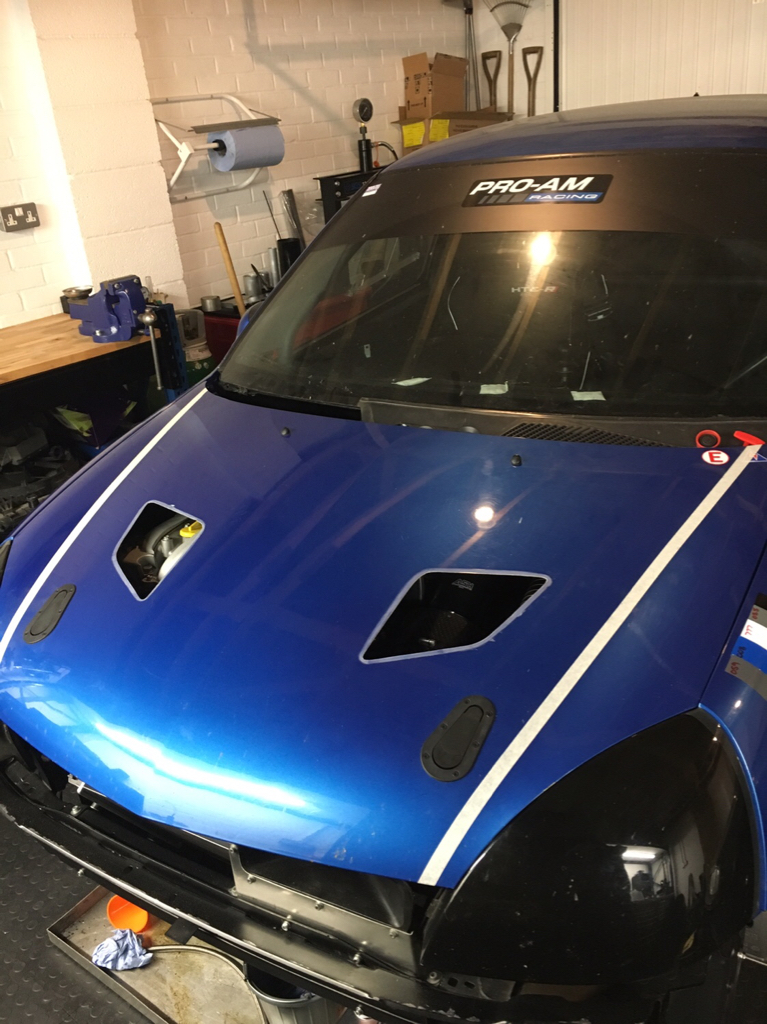

if you look at the pic below
1408244
The striped areas is underpressure, and the white areas are overpressure, (its according the engineer Hucho, sorry for the german description) it seems that in the middle of the bonet, where youre outlets are located should be a less of under pressure in comparrison to more in the front or more to the rear. I know the pic is not a clio but in general this sheme is used for basic understanding.
So if your intension was the have a heat diserpation while driving it seems that it might be not the best possition. More to the rear would be the best.
I might be even better if you could open the the sheet metal below the wipers. Or find a solution like the clio williams or 16V.
If it was your intension ta have a good heat disserpation while standing, its seems perfect.

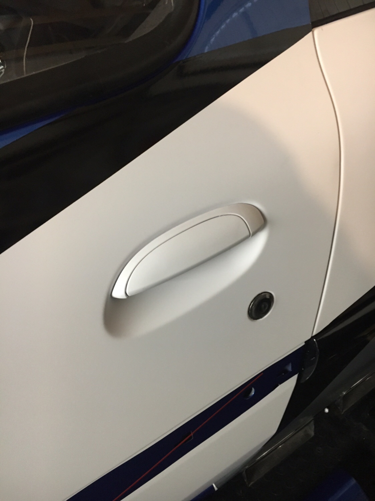

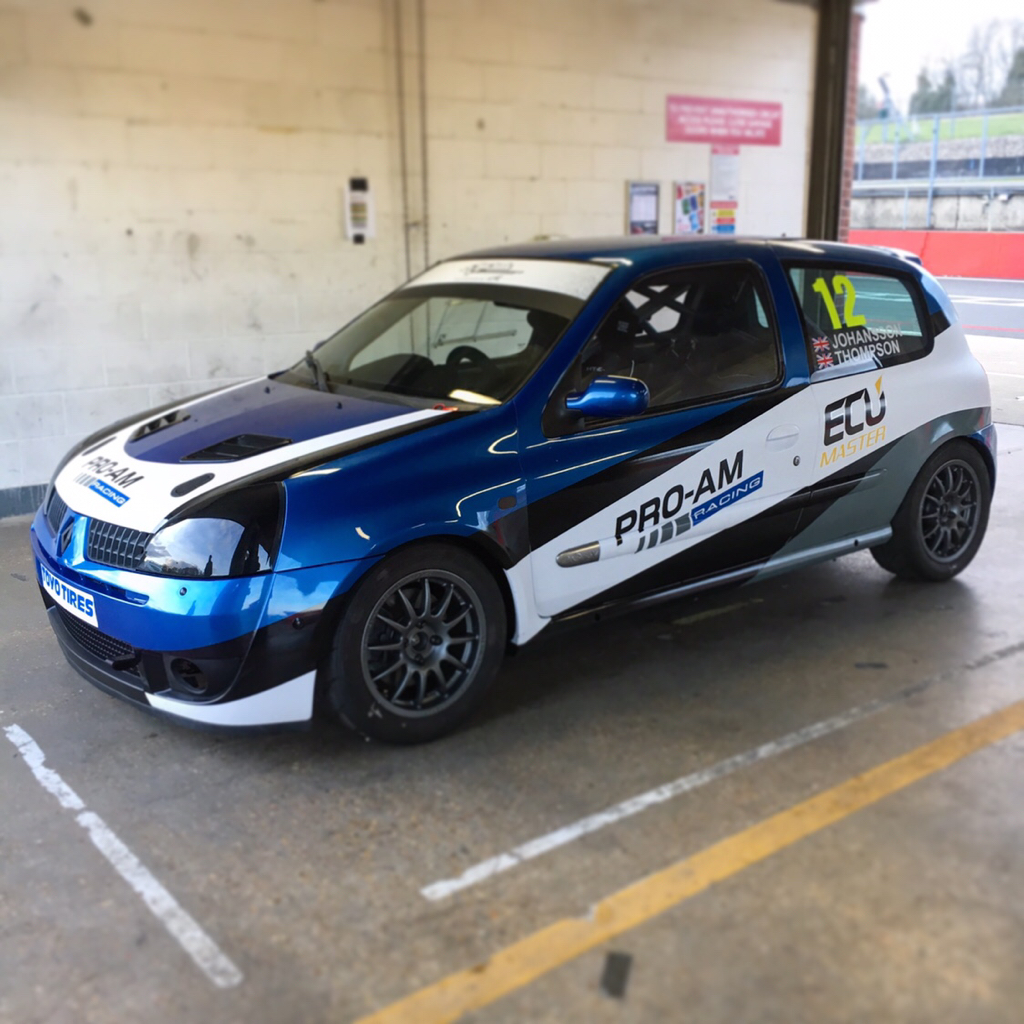

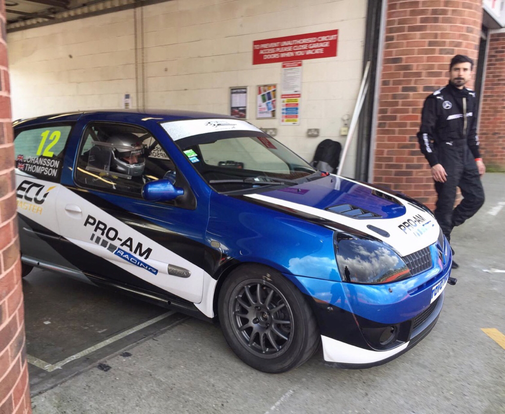

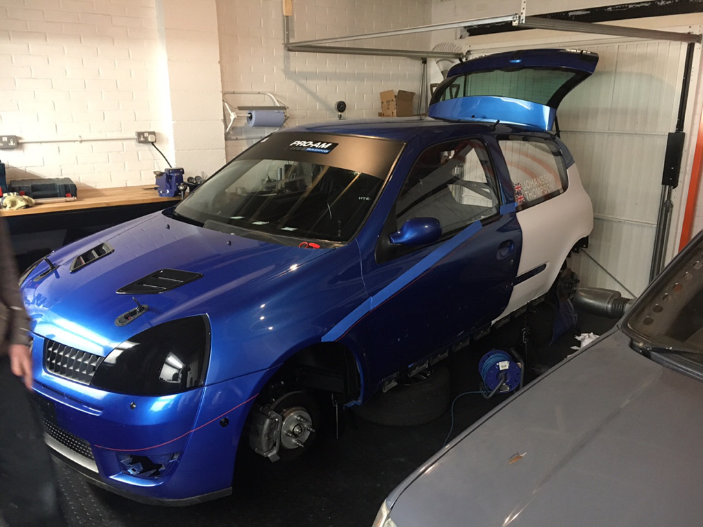

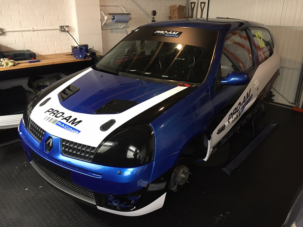

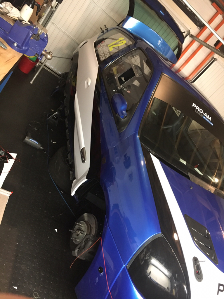

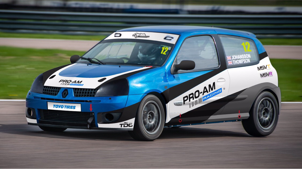

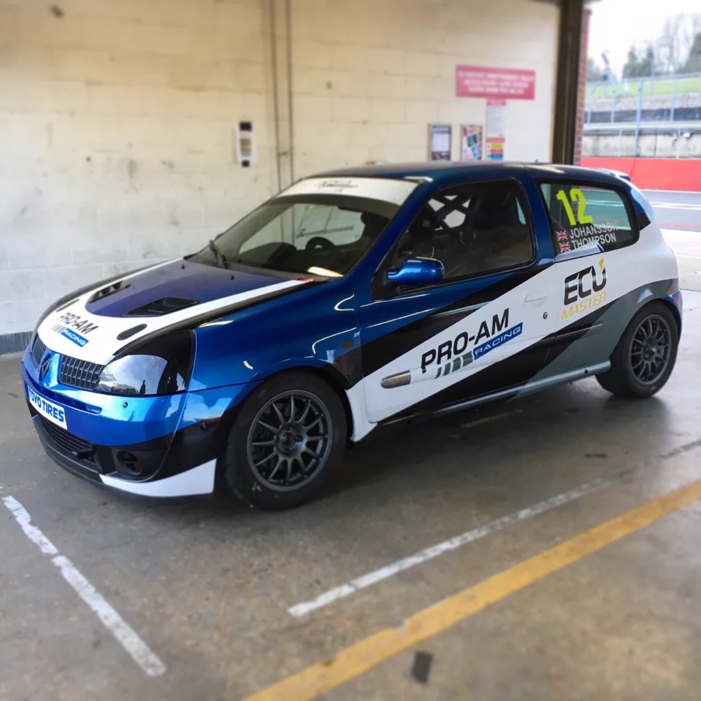

As some of you may have seen on various other social media platforms we have finished the livery design, which we ran at the first MSVT official test day at Brands last week!.. I spent weeks playing round with livery designs before finally settling on the following base design...
I planned on leaving the blue parts as the std metallic paint of the panels, then adding Matt white, gloss grey and gloss black vinyl to form the livery..
Vinyling was the best and cheapest option for us, easy to repair if/when we get damage from racing.

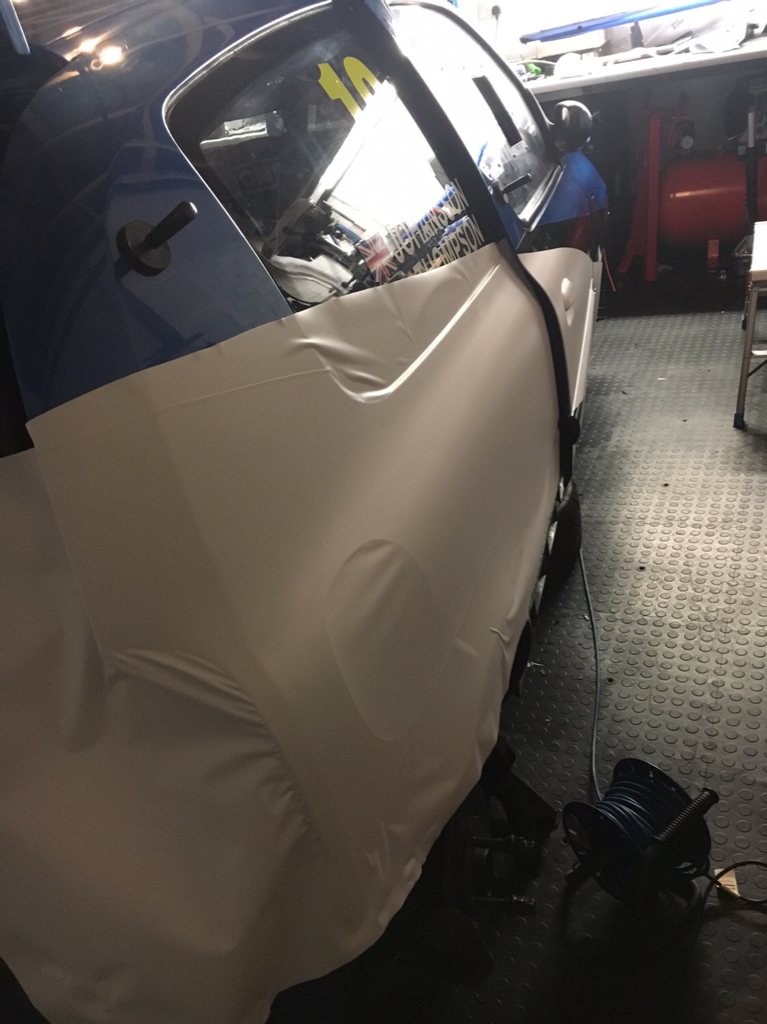

I went on the hunt for decent vinyl to use. I settled on KPMF airelease from MDP Supplies.. As I decided I would do all the application myself I went for good quality vinyl with the air release technology making it easier to apply.

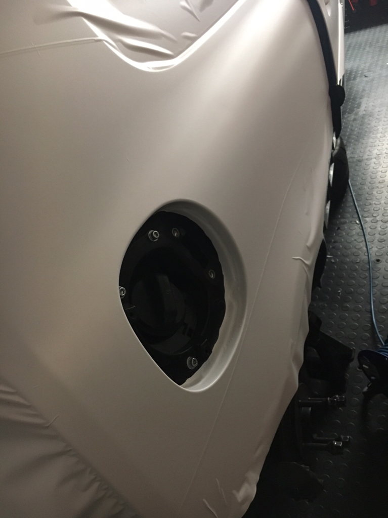

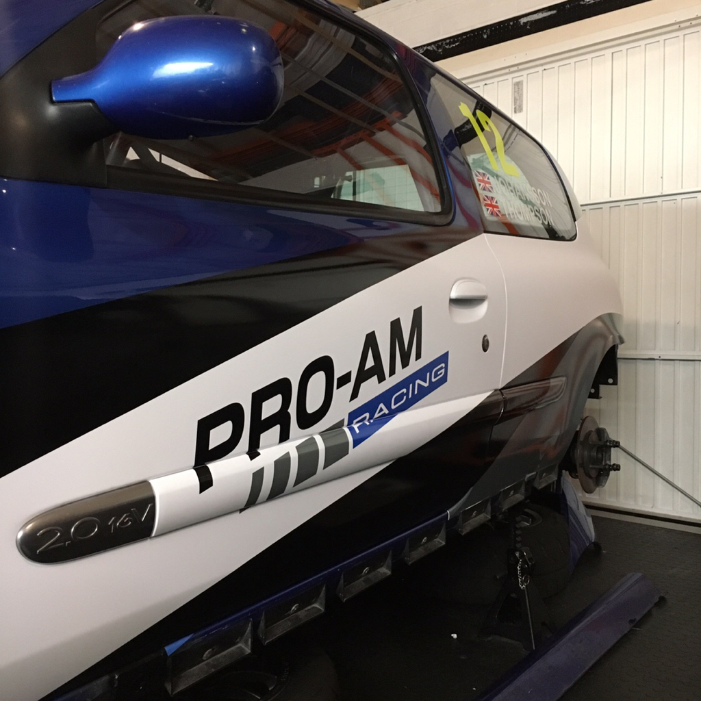

2 very long days and nights before the test I managed to get everything sorted.. here are some pics of the process
Door handles are “fun” haha (I removed them to wrap them separately)
Logos on!... all trims, and sills were removed so I could wrap around them for a better finish
Bonnet details on!.. lined up with the vents
Then the whole process again on the other side!!!! (Starting to get a little tedious haha)
All done and off to Brands we went, here’s the finished product.. still need to fit the championship sponsors and more of our personal sponsors.. but I think it’s looking good so far!....

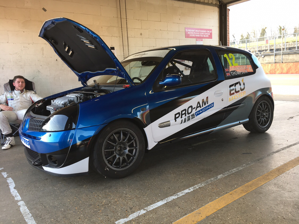

The main purpose is to improve the airflow through the radiator. As there is a high pressure in front of the bumper, radiator area I need to reduce the pressure behind the rad to enable higher airflow through it. As there are no real exits to the engine bay area the pressure under the bonnet will be quite high, therefore restricting the amount of airflow through the radiator.
By placing the bonnet vents where I have, the fast airflow over the bonnet near the front/middle where the lower pressure, or less high pressure (which ever way you want to look at it) it will suck the air out through the vents and create a lower pressure under the bonnet allowing more airflow through the rad.
I don't think moving rearwards would be of any benefit, that moves the vents into the higher pressure area which is opposite to what i want to do.
Also due to the angle of the windscreen you actually get a stagnation of air, even a reversal of airflow by the wiper area, so removing those panels wont do anything for removing hot air from the engine bay. Plus that area (scuttle) is separate from the main engine bay.
That aside, any further back and the vents sit on top of the engine/inlet which would restrict airflow to them. Also you have to consider water ingress which would then fall directly onto the injector loom, crank sensor and ecu etc.
The Clio Williams 16V inlet is to cool the inlet manifold. It causes a pressure change from the air at the front of the car to the air at the rear of the engine and forces air movement past the manifold under the bonnet. Its position is primary due to package. But again, I am trying to have air exit not enter the engine bay.

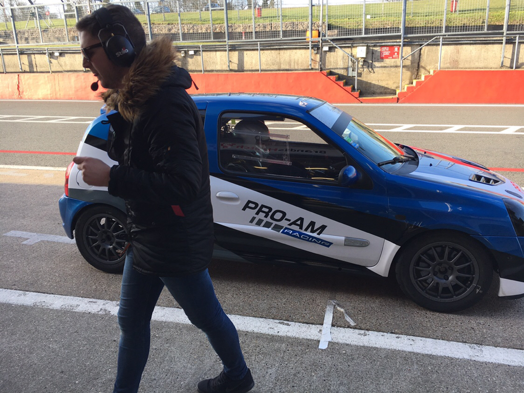

Few pics from our days at Brands..

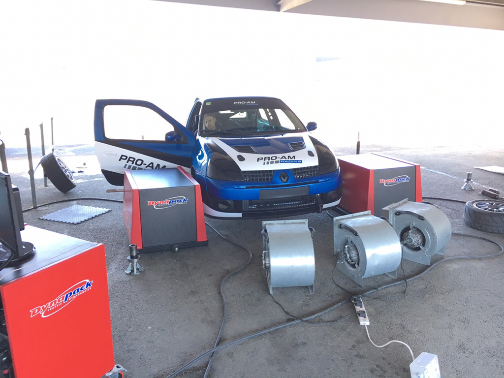

It was the first official test of the MSVT trackday championship.. so first things first we had our dyno test in the morning to get our power figure for the season.
Then we ran through our test schedule.. we were testing our new pit to car radio system, the new dash layouts, pit lane timer, damper sweeps, tyre pressure sweeps, fuel usage etc.
Here’s a vid with @chrispy.clio putting in a great lap
Fastest of the day was a 55.08 .. but without our champ ballast fitted.
What power did you make? I can’t see two pictures so apologies if you put a graph up
We had a few issues with oscillations on the dyno, but hit 158hp at the wheels after some tweaking.. getting retested on Monday at Donington to confirm the value. (Not too bad for a stock engine with no mods, and 110k on the clock lol)
