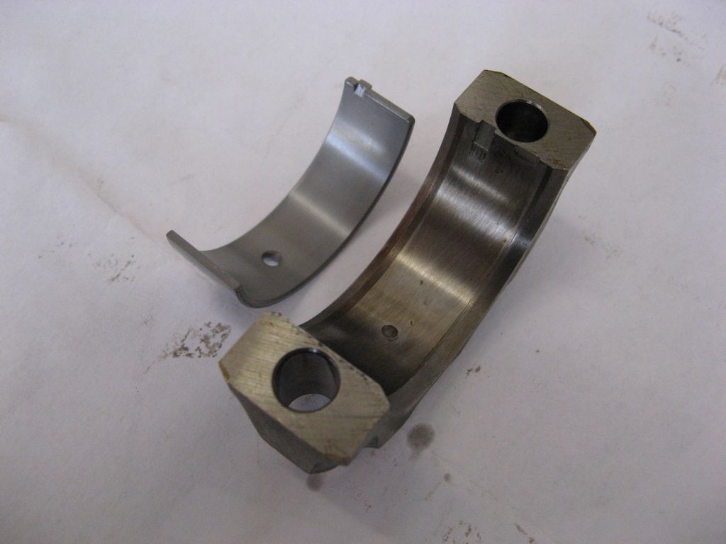

This isnt a clio specific image, but this is what I mean:
The bearing has at one got a tag that locates into a cutout, this helps to prevent it from turning.

Bearing crush should indeed hold them in place, but on the centre main bearing in particular on the clio, the slightest loss of oil pressure can see the crank "grab" it and force it to spin, when this happens it then means the hole in the bearing no longer lines up with the oil feed hole in the block, and then its game over.
Where as if the bearing is tagged, when the crank picks up on the bearing in times of low oil pressure it just does a tiny bit of wear to the front surface of the bearing, which is a much more preferable situation, yes its increased wear but it doesnt cause the same sort of dramatic failure that a spun bearing can.
Ultimately if you get low oil pressure a lot and the crank keeps picking up the bearing it will fail of course, but better if it takes a few dozen times than just once, lol.

As fred says, its 2 half bearings, one with a hole and one without.
  182/RS2/ Turbo/Mk1
if its going to go wrong tagged bearings aren't going to save it!
It can help prevent the shells turning as easily, so if you have a marginal loss of oil pressure it can help, if the crank really grabs the bearings though then it will just rip the tags off and spin anyway.
