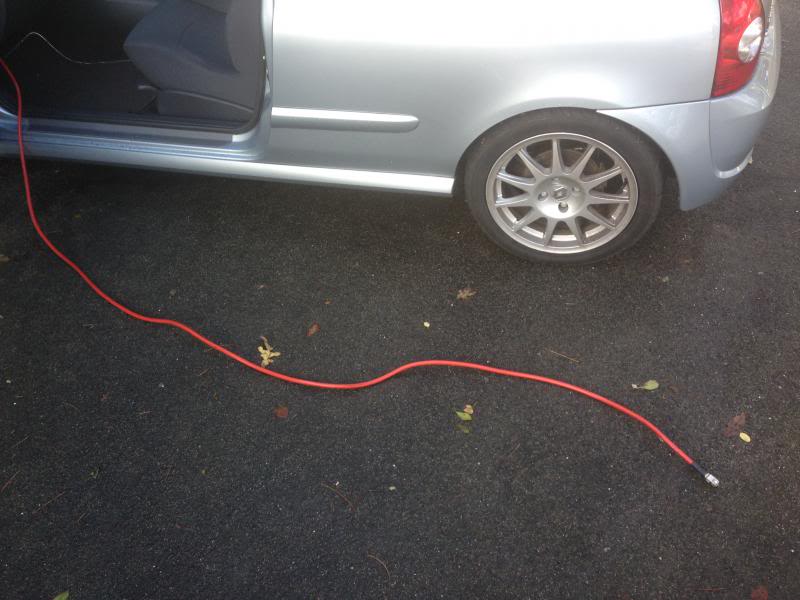

Anyway while i accumulate parts i thought id start on the first step as it was actually sunny yesterday, the battery relocation. i mocked up the cable run with some old wire and then messaged a bloke on ebay who made me a custom 3.6m long 35mm2 cable for power pre-terminated, saves me messing about.

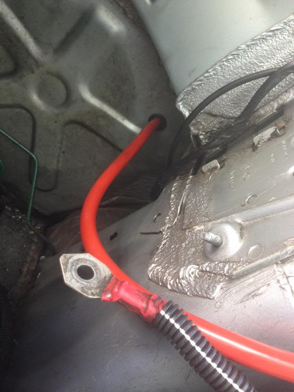

Drilled a hole in the bulkhead and inserted a rubber grommet.

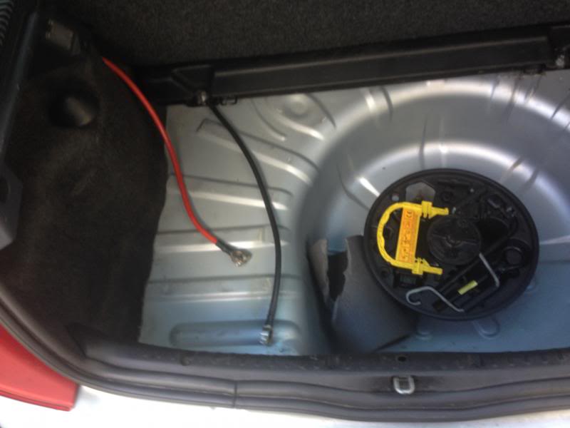

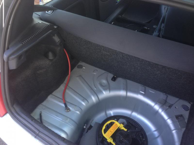

Ran the cable along the inside behind the plastic kick plate trim, and behind the rear door card and got it to poke out at the boot in the ridght place without stressing it or having it chafe on anything.

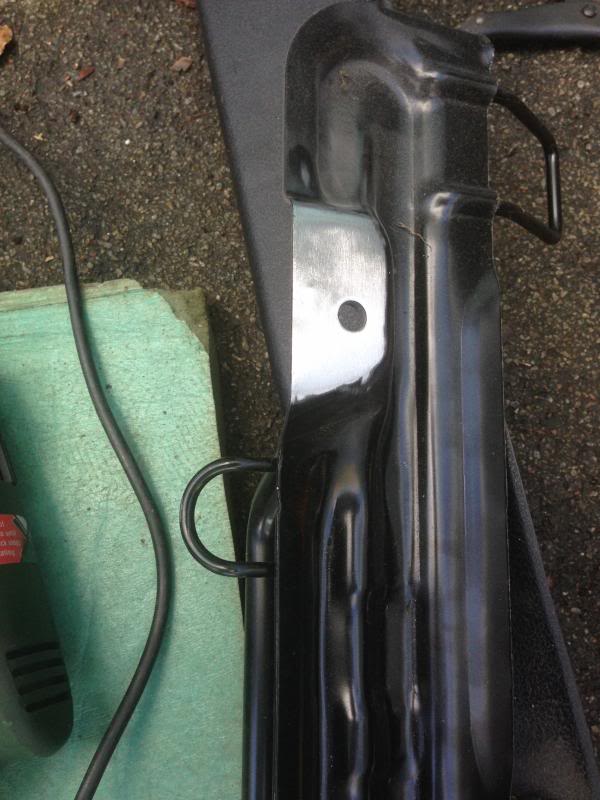

Didnt really want to drill the boot floor for an earth, so sanded the ISOfix bar back to bare metal and part of the boot floor.
Done, hooked up the battery and it actually cranked better than the normal place! Just awaiting on a battery box, junction box for engine bay and then ill complete the install.
