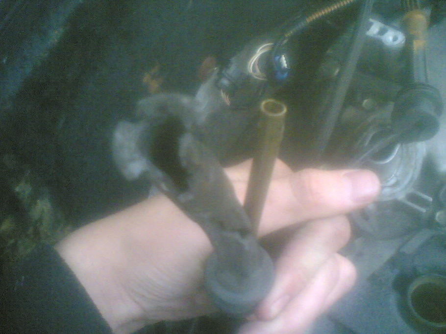

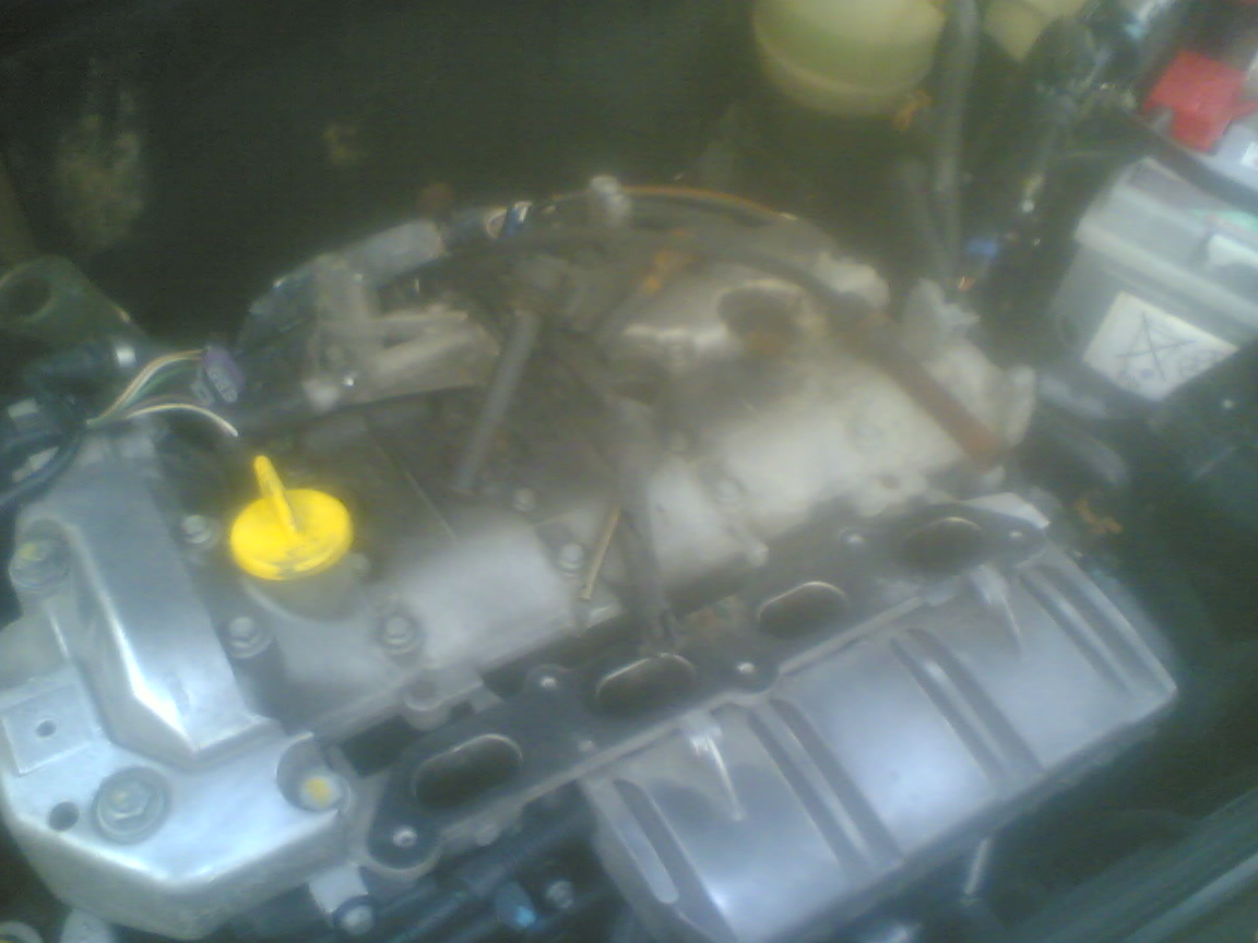

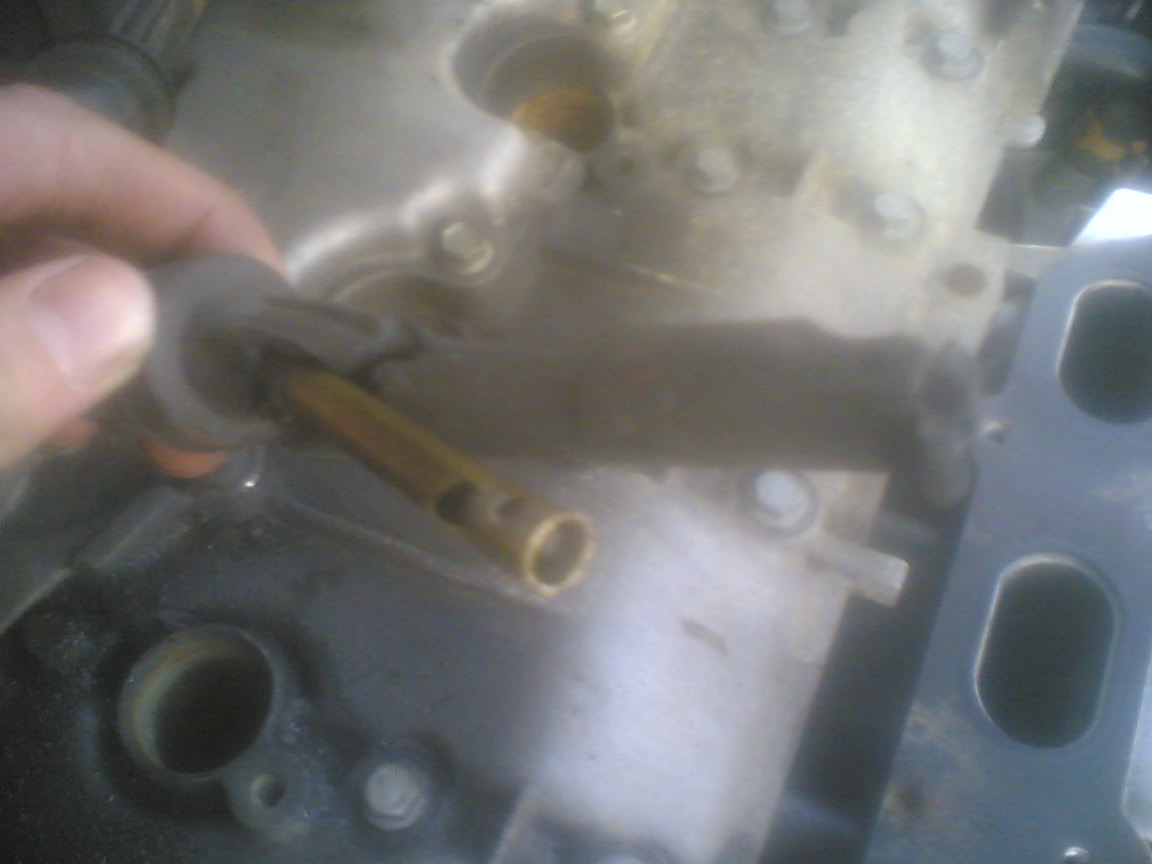

well it turns out after stripping the inlet that the engine has blown a plug out, shredded the block and eaten the ht lead, FUCKED! gona try and get it helecoiled, hears some pics..................

Sounds bad mate :dapprove: ... hope you get it sorted :D

good effort mate!!!!! helicoil it is!!
speak to CupCake, he had the same thing happen

40 quid with head on we think. fred what im worried about is the fact why it blew out..... i have have it pluged ack in is it gona go bang again.

it was probably ever so slightly not as tight as the others IIRC the tourque setting is around 25nm for plugs
it happens mate, you were just unlucky, get helicoiled, bang a new set of plugs in, replace HT, job done

I've just seen this thread. Basically the noise you could hear thata you originally described is the sound of the air being sucked in and forced out on the stroke of the piston as the engine internals are open to the outside.

I'm not sure what the problem is though is it just that the plug needs helicoiling out if so any garage can do it realy and replace the plugs etc
