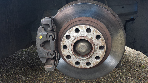

The reason I've got these is because I have a full set of 15's to run while the BBS are refurbed. Rears fit fine, fronts do not clear the calipers - they should do without an issue on standard brakes. So I thought it had e46 carriers/calipers with 300mm discs which is a popular mod. This isn't the case, discs are standard 286mm and the carriers on the car and the spares are exactly the same. I can't check the calipers' part numbers as the ones on the car are so thickly layered with paint that I can't see them but they look identical to the spares. I then looked a bit harder and saw that there is some contact material on the disc that isn't being touched by the pad:
Untitled by matt_13289, on Flickr
When I took the caliper off, there was a lip at the top of the pad where that wasn't making contact too. This leads me to believe that the calipers are sitting too far out, but I have no idea why...unless there is something blindly obvious that I'm missing? Any ideas?

Maybe you have M3 hubs that someone has bolted the 328i calipers to. The caliper mounts are slightly further out on those to account for some of the disc size increase, along with the caliper being different to gain he remaining room. Is the very outer bit of the pad (furthest away from the centre) not even touching the disc? Whats the gap like between the disc vents and the caliper?
  E36 328i
It pretty much has to be the hubs, unless like I say its staring me in the face and I'm not seeing it. Yeah, furthest from the centre of the disc isn't even touching, creating a lip where the rest of the pad is wearing. The lip is only 5mm ish but its just enough to foul 15's.
Sounds like you somehow have the wrong hubs to me. Looked at the pic again and the gap between where the disc enters the carrier looks to big
  E36 328i
Starting to doubt myself that the calipers and carriers are exactly the same. gonna mock bolt them up next time I'm off just to double check before going any further

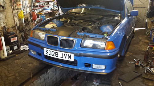

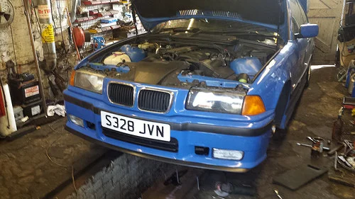

Managed to get the car over a pit recently to replace the engine and gearbox mounts.
While under there we found that some of the bell housing bolts weren't tight, so they were sorted. One of the manifold to exhaust gaskets is missing too which could explain the idle problems. Also found one of the manifold studs had worked its way loose but it was late by then so I'll sort them another day.

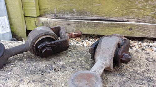

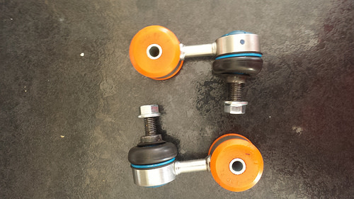

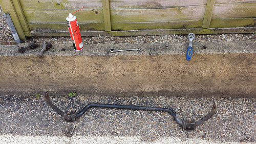

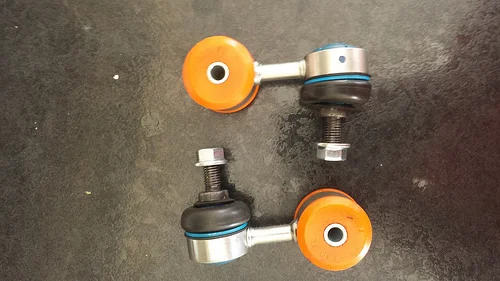

Most of the car has been polybushed by the last owner but the front anti roll bar bushes/drop links were shot. Ordered up the parts and went at it today:
Put in the polyflex roll bar bushes and drop links, tightened everything up until the last bolt sheared straight off which induced all the swearing. It was one of the U shaped brackets seen above and as far as I can tell, a BMW only part. Took the whole thing off again and I'm now waiting for new ones to arrive Saturday. Had to drive the car earlier and it's some what boaty without the ARB. It'll sit on the drive until Monday now as that's my next day off. Joy!
Should have dropped me a message, I've got two of those U brackets that have been powder coated lying about spare, could have had them for free! Nevermind lol. They are asking for trouble though - be much easier with a nut and bolt through it..

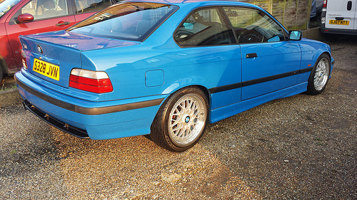

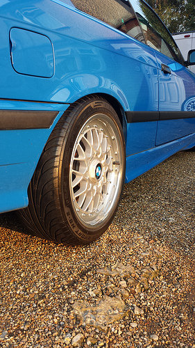

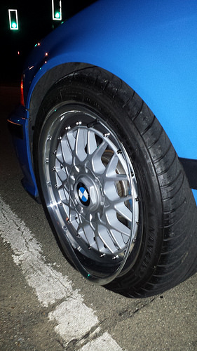

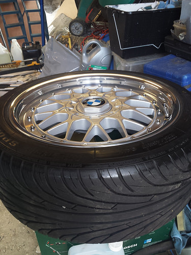

Things are still happening, slowly. Finally got the wheels back, washed the car before putting them on and they looked great. Massively pleased as the car looked pony for months with 15s on the rear and some shagged 17s on the front.

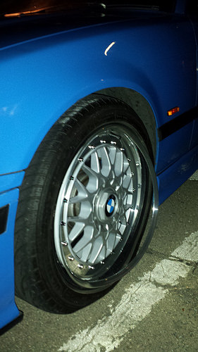

Then, no more than 5-10 miles later i heard a huge bang and pulled over to find...
No potholes in the road, nothing in the tyre. Looked at the lip and the metal was really thin. Absolutely gutted!
Took them back to the refurb guys today and they were just as blown away as me. I won't name them as I know their work is good and they sorted everything out as soon as they saw it. I am now on the look out for some sunflowers for it as this has somewhat put me off the BBS.

Whaaat the fuuuu. That's could have been bad, very.
Car's still looking awesome btw.
_Tom
Do you think it was just these particular wheels? They do look awesome and I've never seen/heard of that happening before?
Oh and a a/c service was one the best £35 I've spent this year..
  E36 328i
They are off the car completely now Mark. On the lookout for something else. They kept them as I just don't trust them anymore.
Tom, they were diamond cut so I guess too much was taken off.
