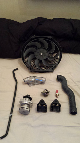

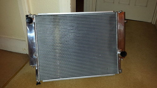

Lower temperature thermostat and fan switch, metal thermostat housing, new water pump and a bigger radiator due to the old one splitting. I need to mount an separate expansion tank somewhere as the new rad does not have one built in like the OEM item:

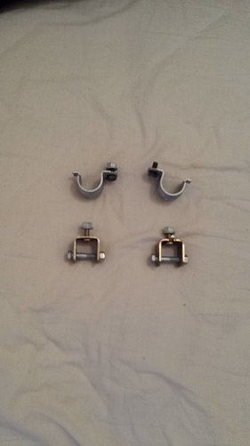

Rear anti roll bar items - old stuff is well rusted in so will need cutting out:

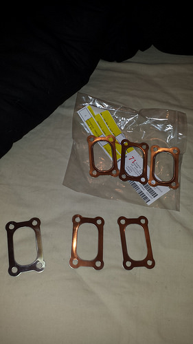

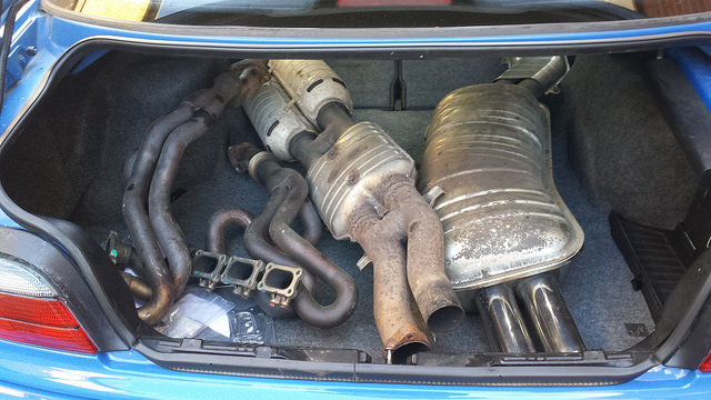

Picked up some M3 exhaust manifolds a while back, bought the gaskets for when it gets fitted:

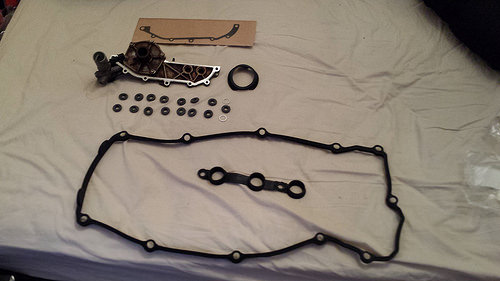

Vanos parts that I've had for ages - now I have the garage free I can tackle this without having to have it back together again within one day. I need some M52 timing tools if anyone has them and fancies selling:

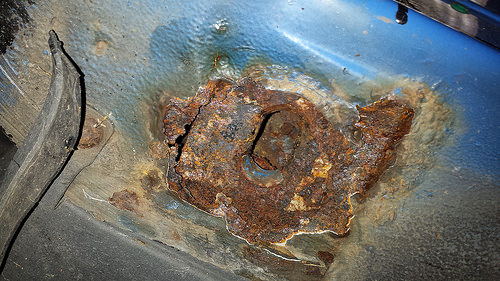

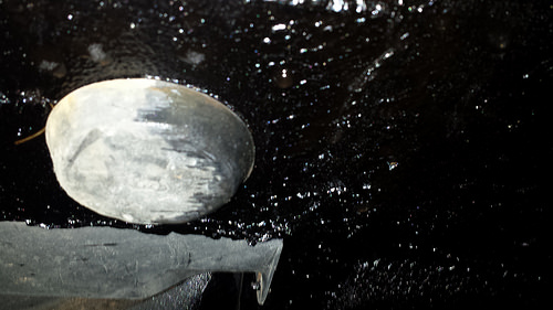

Lastly, I put the car in for under sealing last week. I got a call from the shop about one of the jacking points. It had started to rust out pretty badly:
20141113_091006 by matt_13289, on Flickr

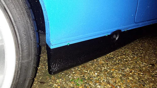

It was cut out and a new piece of metal welded in (the guy took lots of photos, he hasn't sent me them yet though). The whole underside and arches have been sealed now, skirts will be going back on covering the black part!
IMG-20141117-WA0003 by matt_13289, on Flickr
Here is the jacking point rust free:
IMG-20141117-WA0006 by matt_13289, on Flickr

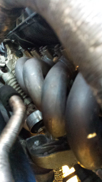

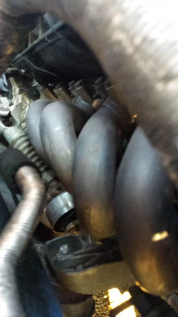

Good work - much better noise with the M3 Manifolds. How much were the gaskets?
£7 each was expecting worse!
When you welded on the plate for the expansion tank, did you take the strut out? I don't want to set fire to the top mount.

Yeah, although mine were solid top mounts, but I had it off the car at the time anyway. If yours are the stock rubber type 100% remove it..

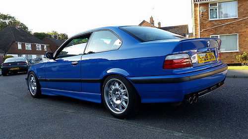

The car has stayed pretty much the same since, although the M3 manifolds are now on. It sounds better and seems happier at the top of the rev range so well worth it. The best photo I could get as it is tight for space!
20150429_185432 by matt_13289, on Flickr
IMG-20150423-WA0019 by matt_13289, on Flickr
Engine wise there isn't much else I can do now. It has an M50 manifold with remap and now the M3 manis. I want to get it rolling roaded as it should be around 215-220 from what I've read with those mods. The M3 LSD has a higher ratio than standard and with all of the mods combined makes it pretty fun to say the least. The last thing I can do would be a cold air intake but I'm very unlikely to make any power with it and I don't want chavvy induction noise either.

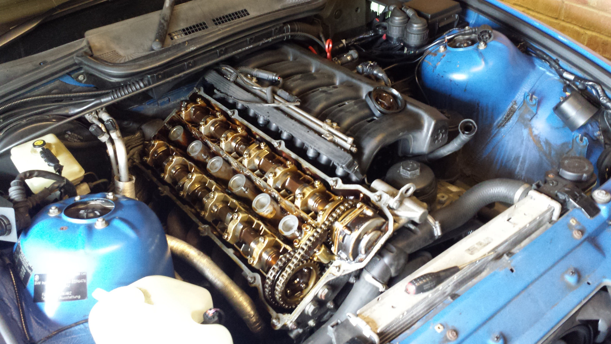

Also changed the Vanos seal which I've been meaning to do for a long time:
IMG-20150727-WA0003 by matt_13289, on Flickr

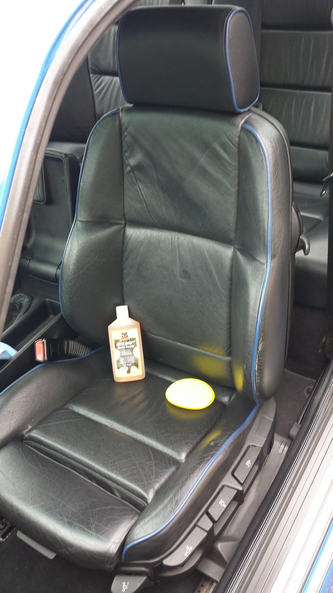

Gave the leather a much needed clean and feed with Gliptone:
20151006_134626 by matt_13289, on Flickr
IMG-20151005-WA0007 by matt_13289, on Flickr

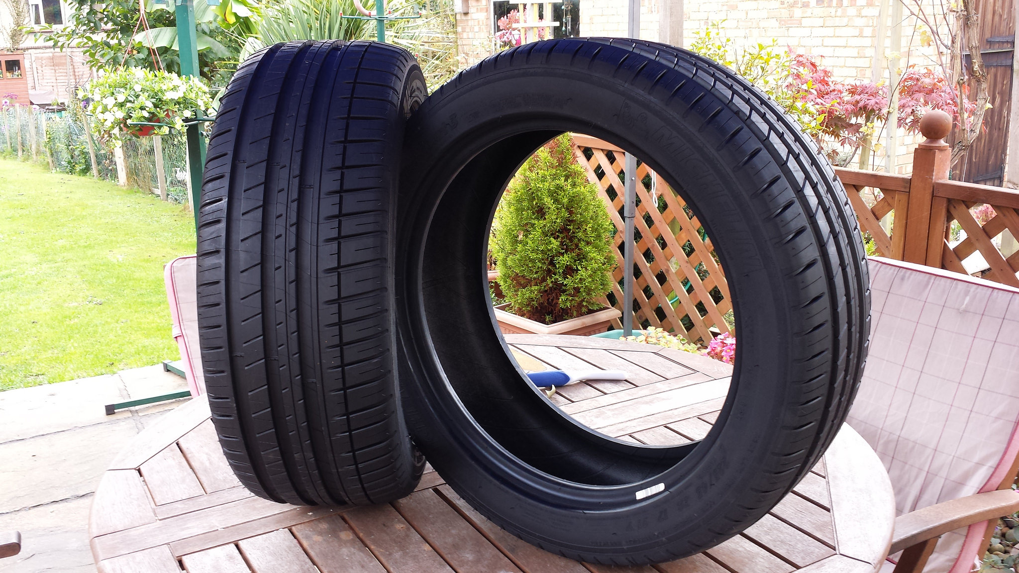

Replaced the Nankangs with Michellin Pilot Sports all round. Not surprisingly the difference is huge!

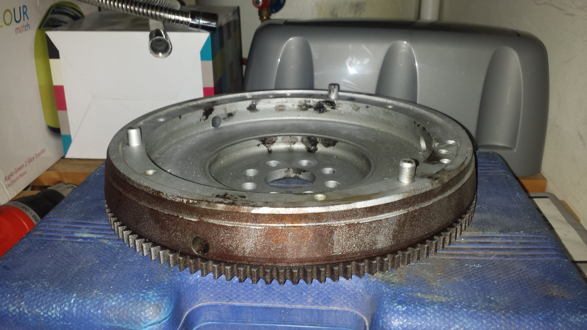

I've also picked up an early M50 single flywheel as it was local and cheap. I had a problem sourcing the right bolts but managed to get some from Germany in the end. The advantage with the M50 flywheel is that there is no need to get it machined or use another starter like you do with the M20.
20151010_101714 by matt_13289, on Flickr
The clutch isn't going and probably won't for some time as it was replaced with a new DMF in January 2013 so the flywheel is bottom of the to do list.
