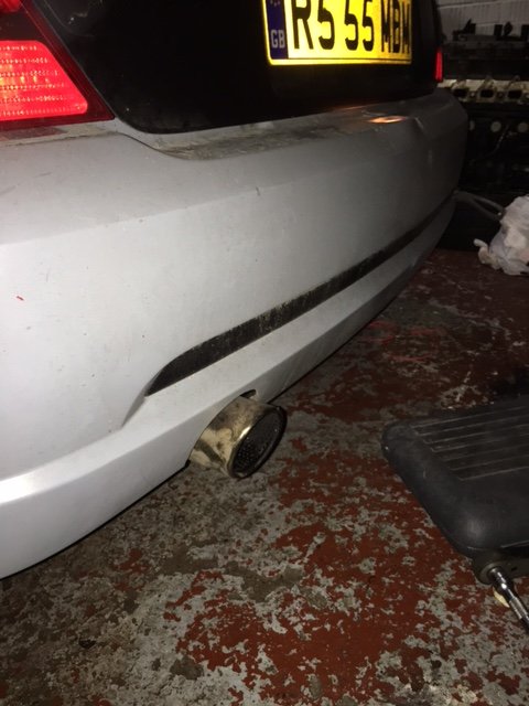

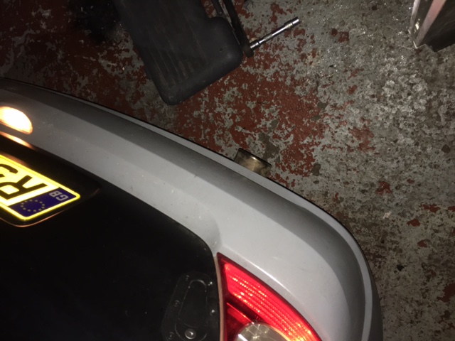

Took the exhaust off tonight from the link pipe back so I could shorten it. Cut 50mm ish off the end of the Ktec mid section, re-slit it and refitted it all. Looks better now as it was sticking out miles too far before.

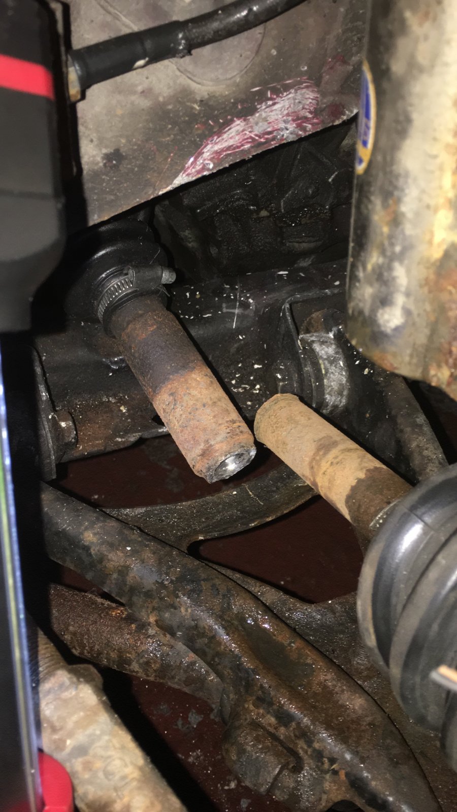

It's been bugging me since the shafts were made that the driver's side is too long and is a real pig to get into place with everything bolted up. Decided it needed shortening before it breaks or breaks something like the gearbox :weary: Split the shaft at the inner joint and 5 mins and an angle grinder later...
This is just temporary whilst I have a proper shaft made up by Berrisford. Needs 25mm in total taking off but I only took 15mm off so I had enough splines left to engage the cv joint. Went back in and bolted up nicely :up:

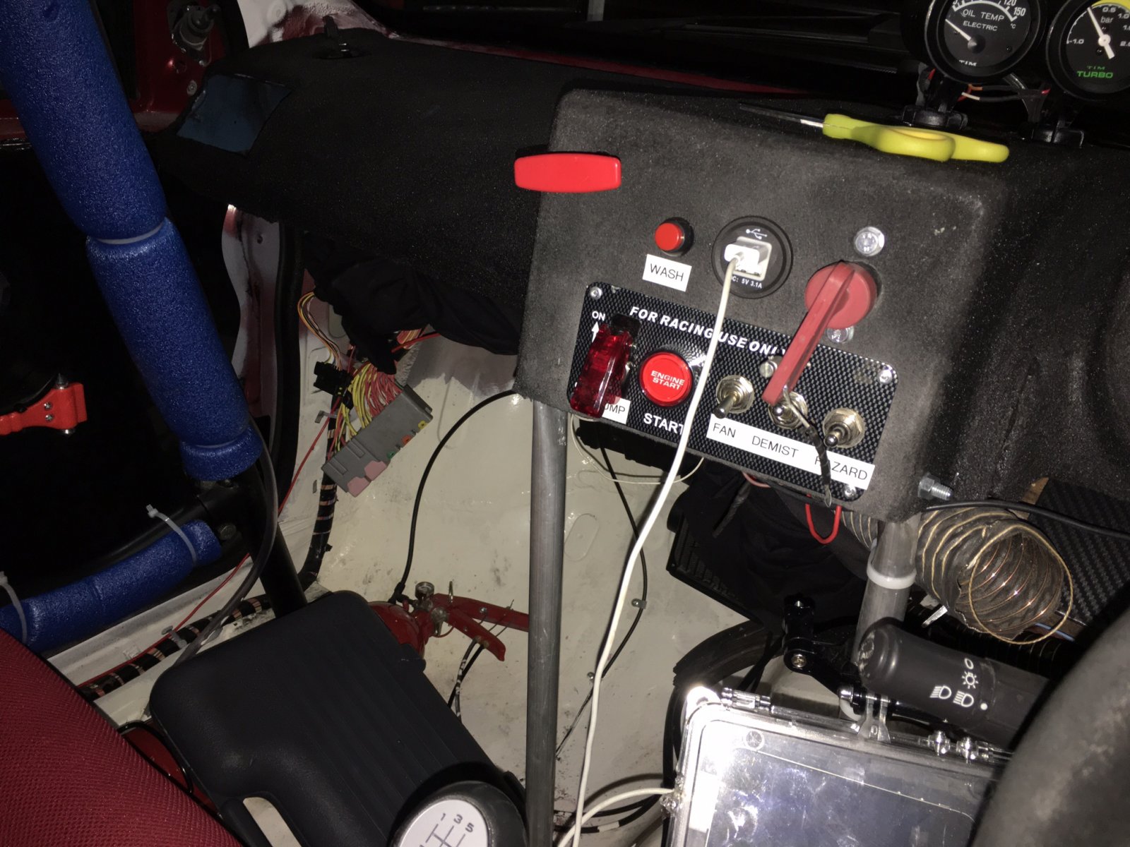

Got round to labelling up my switch panel, exciting I know, again for when other people drive the car. Also fitted oil temp sensors by replacing the sump plug with one threaded for a sensor, and added a boost gauge. Going to get a thermostatic oil cooler and then add a pressure gauge off the sandwich plate.

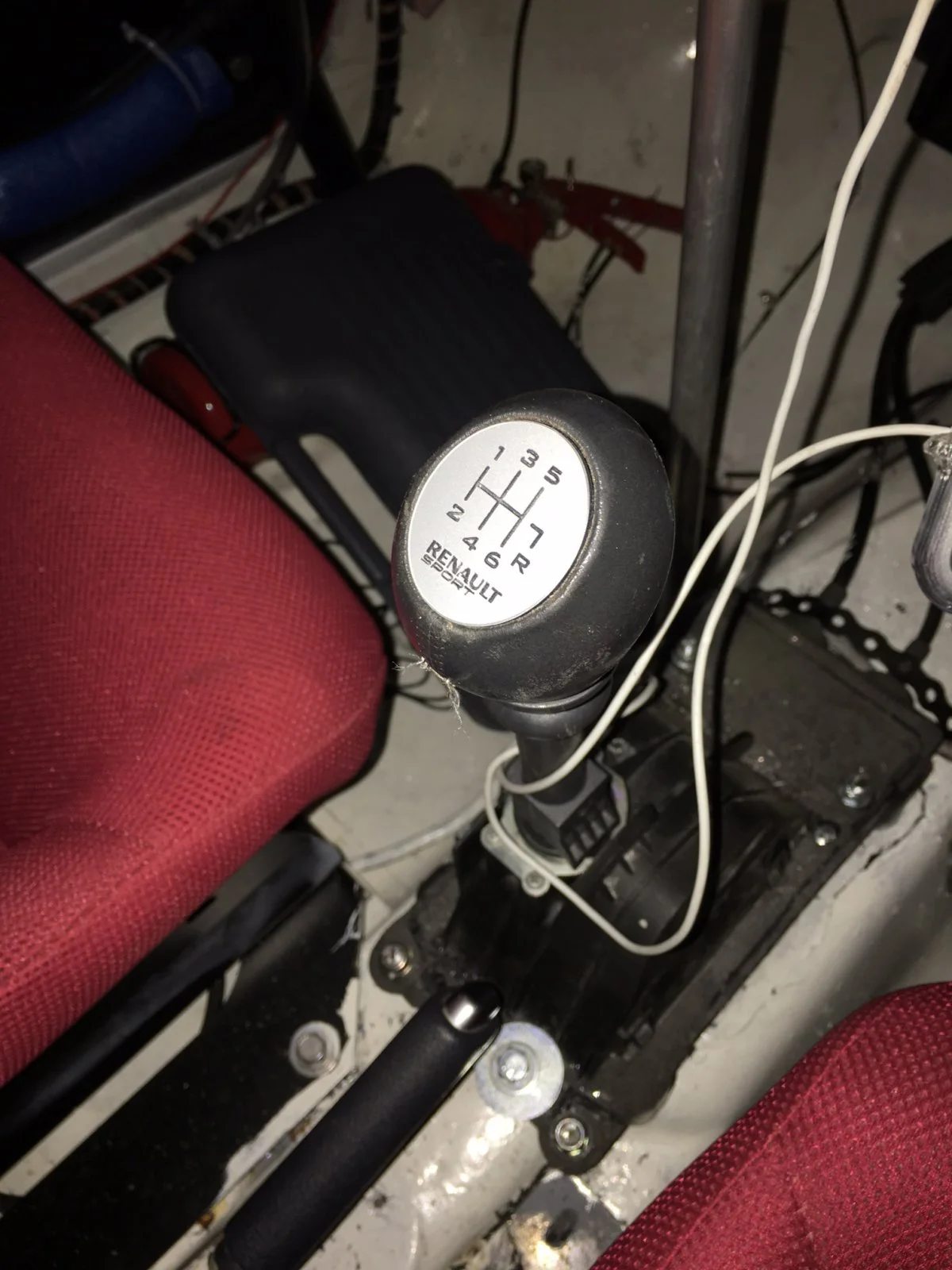

Spent a bit more time trying to sort out the dodgy centering of the gear stick from 5th and 6th. Remove and dismantled the selector, there's a nylon bush which I greased up a few month back, this time I've bored it back out to the standard 10mm it should be. Back together and seems better. Also cut away part of the upper Clio part of the gearbox mount to make future access easier

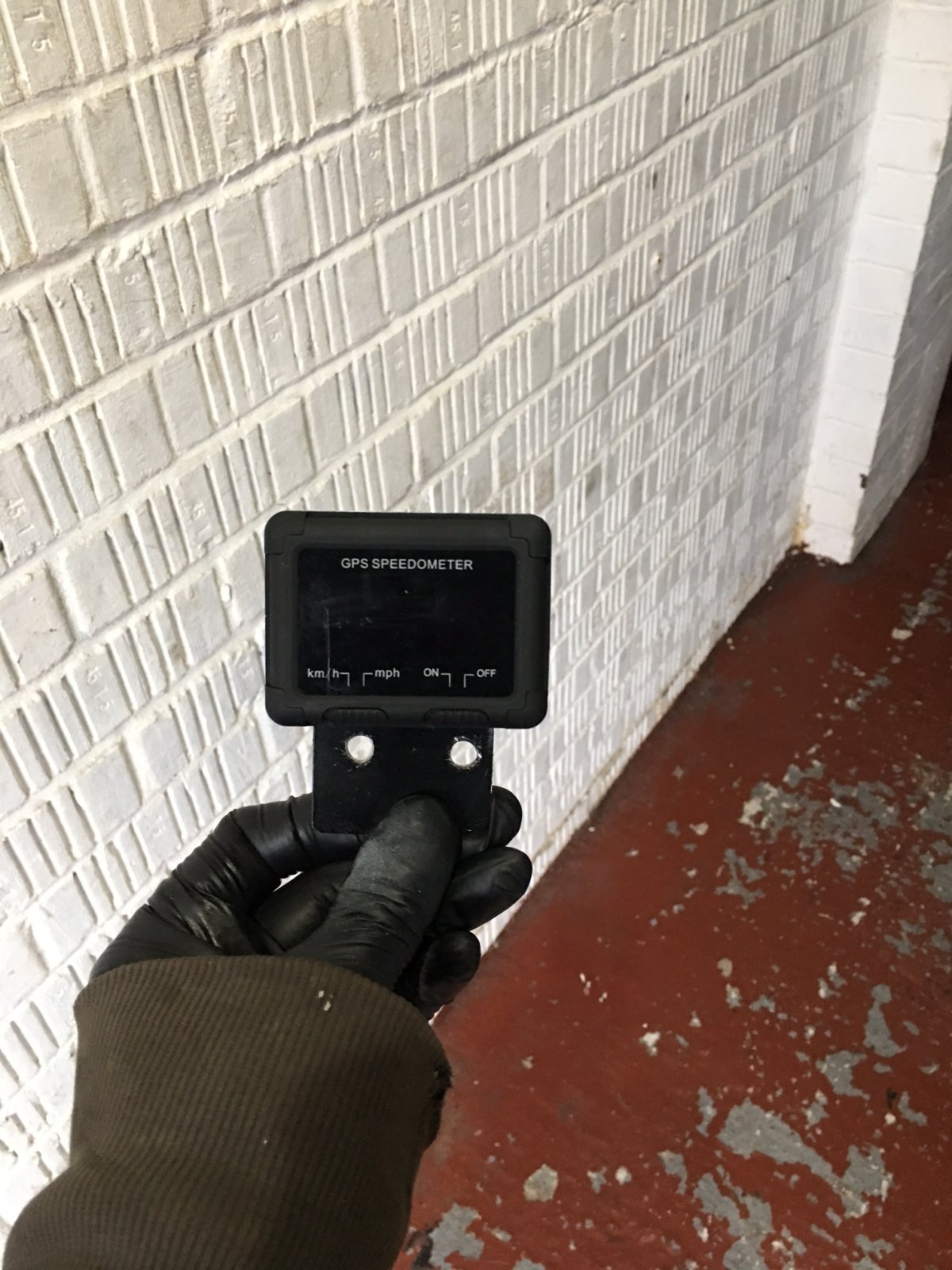

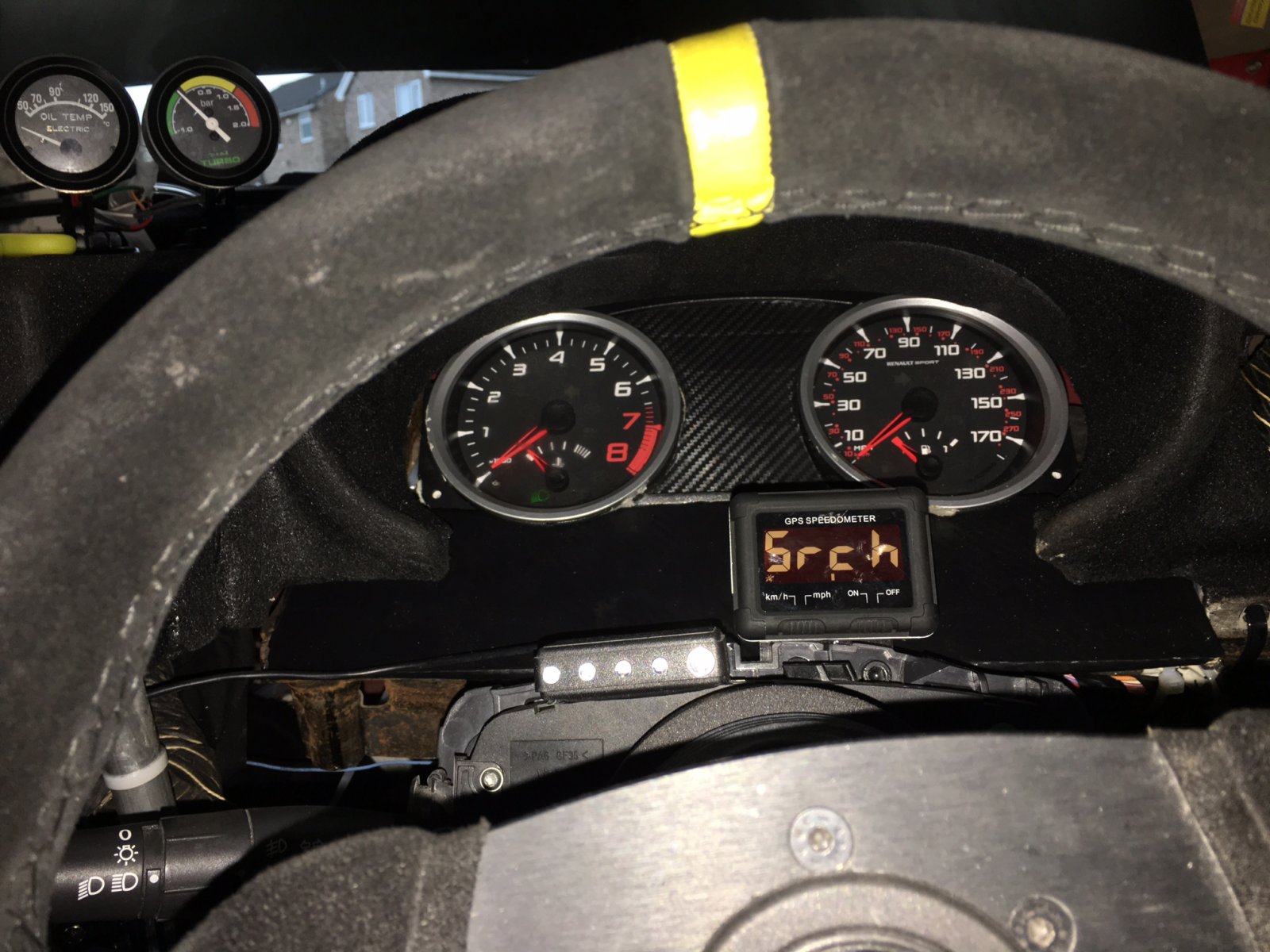

Next job was to make a mount for my GPS speedo
This then mounts behind the wheel in front of the main cluster. Also made a couple of blanking pieces from hardboard and carbon fibre effect wrap to hide the centre of the cluster and the dash support bar below

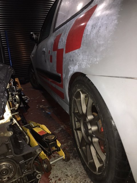

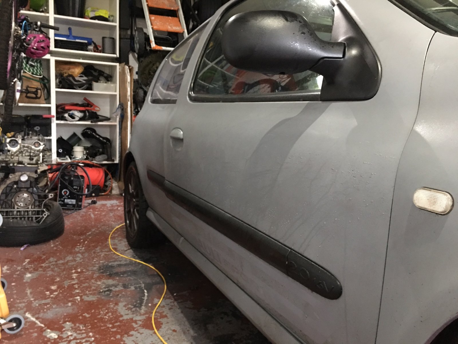

After a few weeks of indecision decided to remove the red side graphics, had to repaint a bit on the drivers side but piece of cake in primer grey

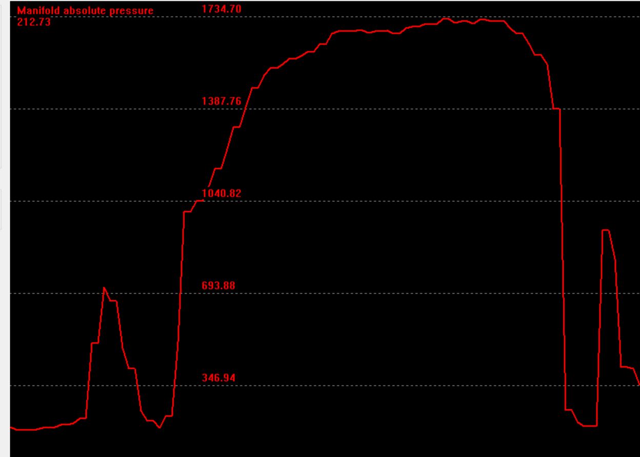

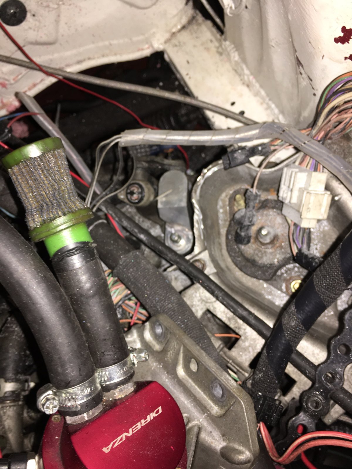

Took it out for a quick test run tonight with my laptop and rs tuner to do some logging. When it was at RS Tuning before the car wouldn't hold boost, however.....
So that's holding 0.7bar which according to the mighty internet is standard boost. Repeated it in various gears several times, and held in every gear. Feels ballistic so fingers crossed it behaves itself on the 23rd :cool:

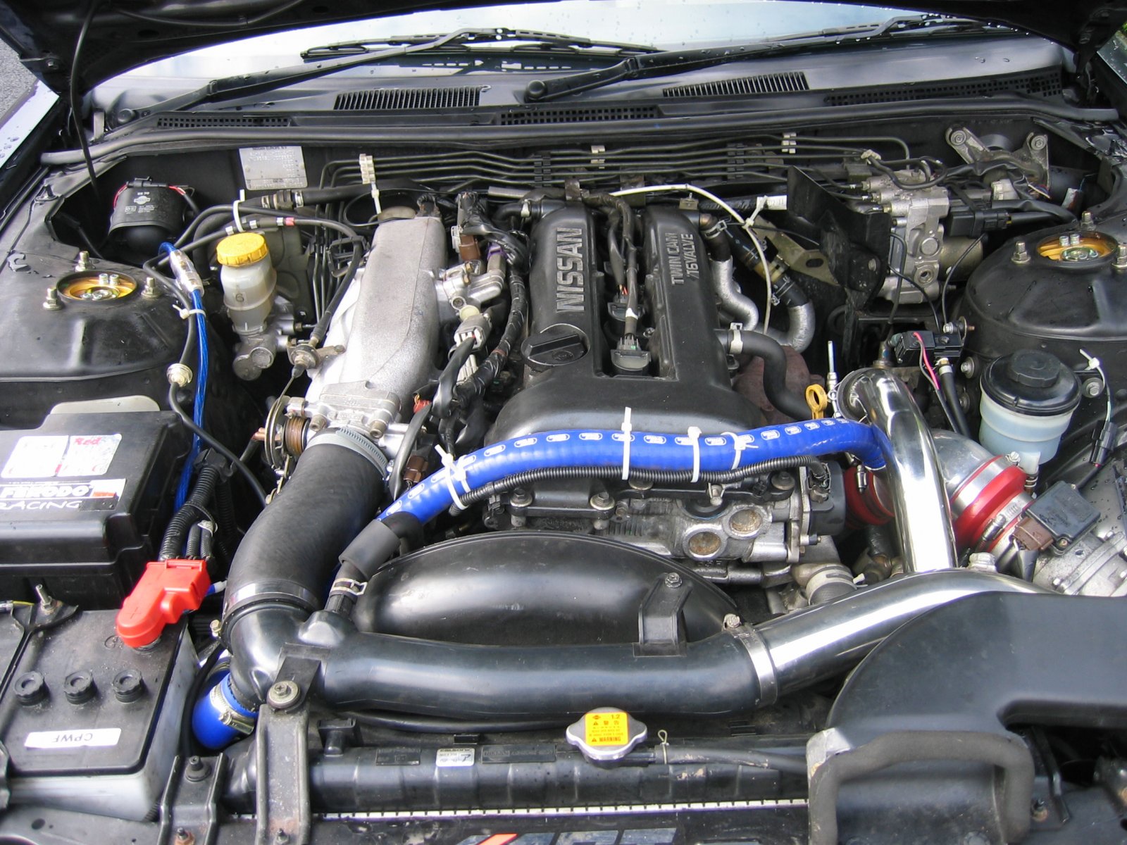

The above boost graph got me thinking about my old 200SX, 1.7 bar on a GT2871R turbo, standard interior apart from some recaros and fooking quick. Renault really should have made the pipework and plenum bigger, and the internals stronger. 380BHP on the standard engine. Bloody awesome. Should have kept it, first car I ever messed with 😢

Cheers, have binned the abs wiring now so will stick with the gps speedo. Original speedo will be out by 10% anyway due to much smaller wheels than the Megane has, worked it out properly and the plus side shorter gearing should be even better acceleration.

I think the Megane bush thing is standard on most causing gearstick issues so atleast that should feel better now

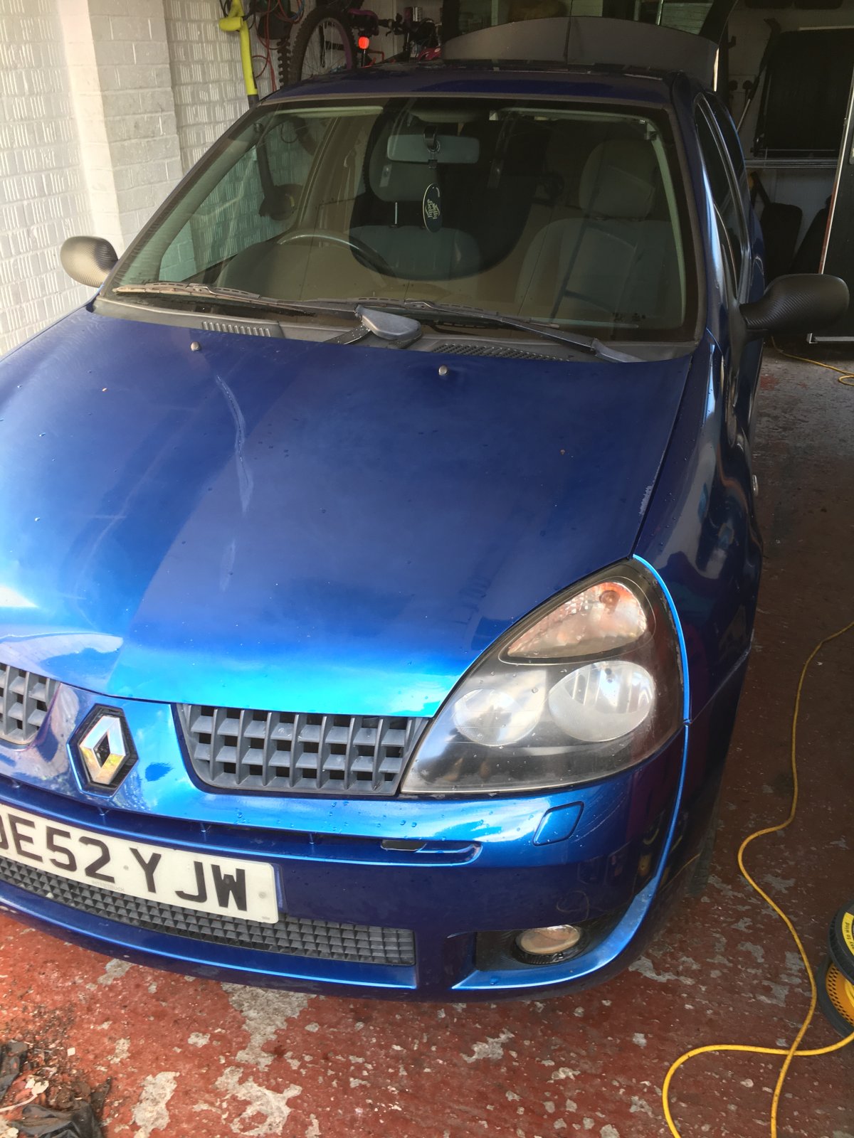

Well this turned up today, 110k mile 172 cup with terrible paint, it's been keyed and repaired by a blind man on most panels. Ordered a new car and going to be running this as a daily until it turns up and then intending to go production class racing with it. For the moment I'm stripping it out and it'll be with the turbo at oulton on the 21st. Make for an interesting comparison
Getting rid of the grey shell?
What's the new car?
No, grey turbo is going nowhere. Ordered a discovery sport to replace my 1 series and the 1 series is going this week so bought the cup as a temp car. When the disco turns up I'm intending on going production class racing in the cup. Well that's the current plan anyway

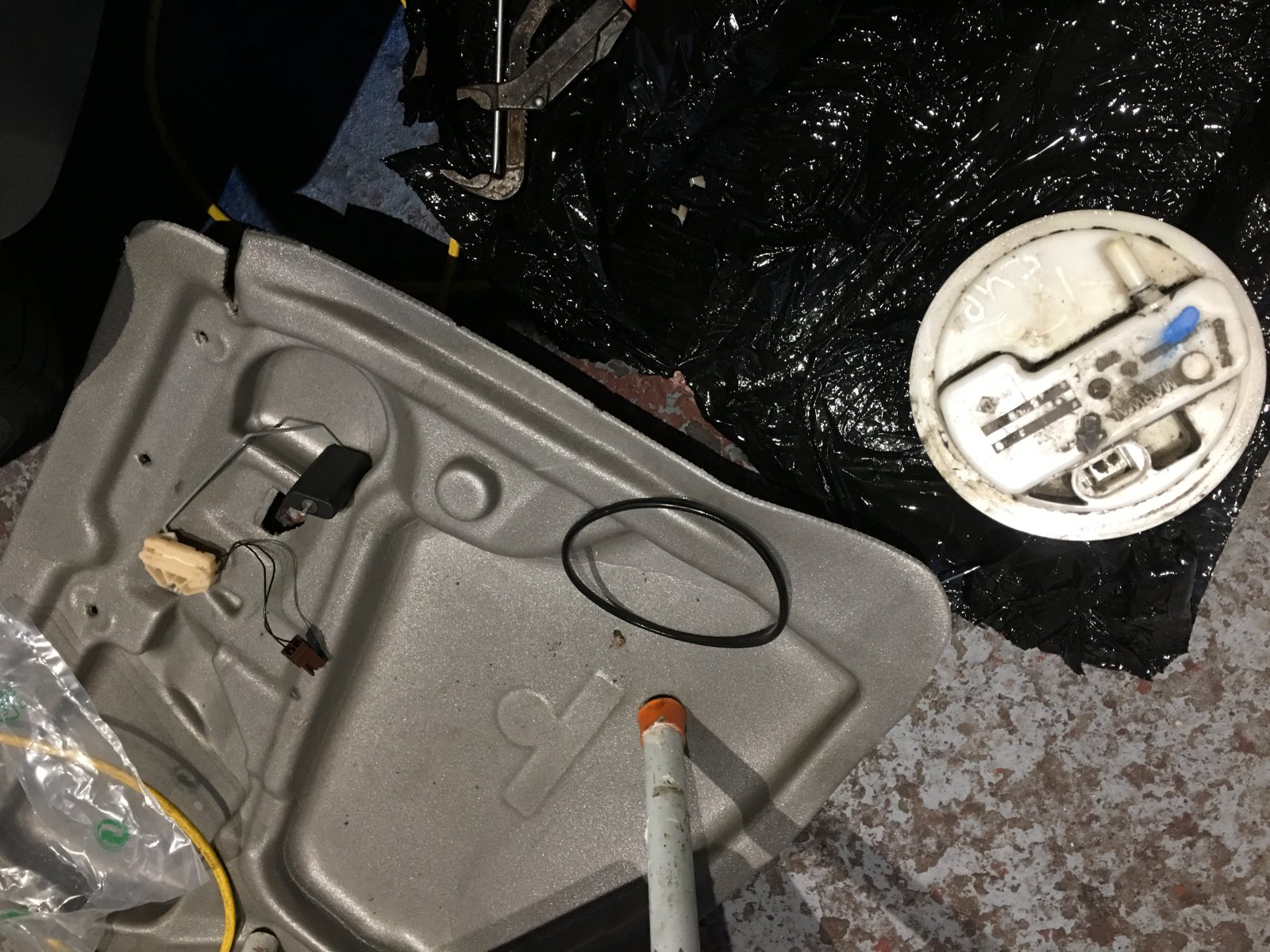

Clio turbo started smelling of fuel badly a couple of days ago and found a puddle of fuel on top of the fuel tank. Turns out the sealing ring has expanded and is about an inch too long so the sender wouldn't seal against the tank. Got that changed over and also swapped the fuel level sender as that had packed up. No more petrol smell. Win

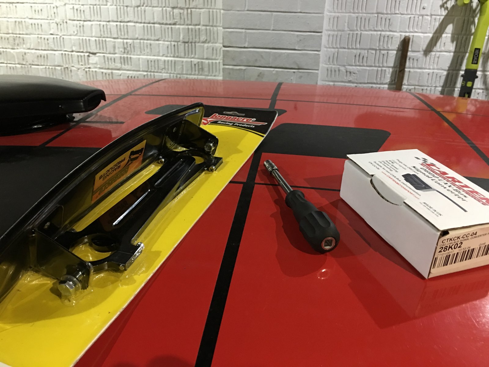

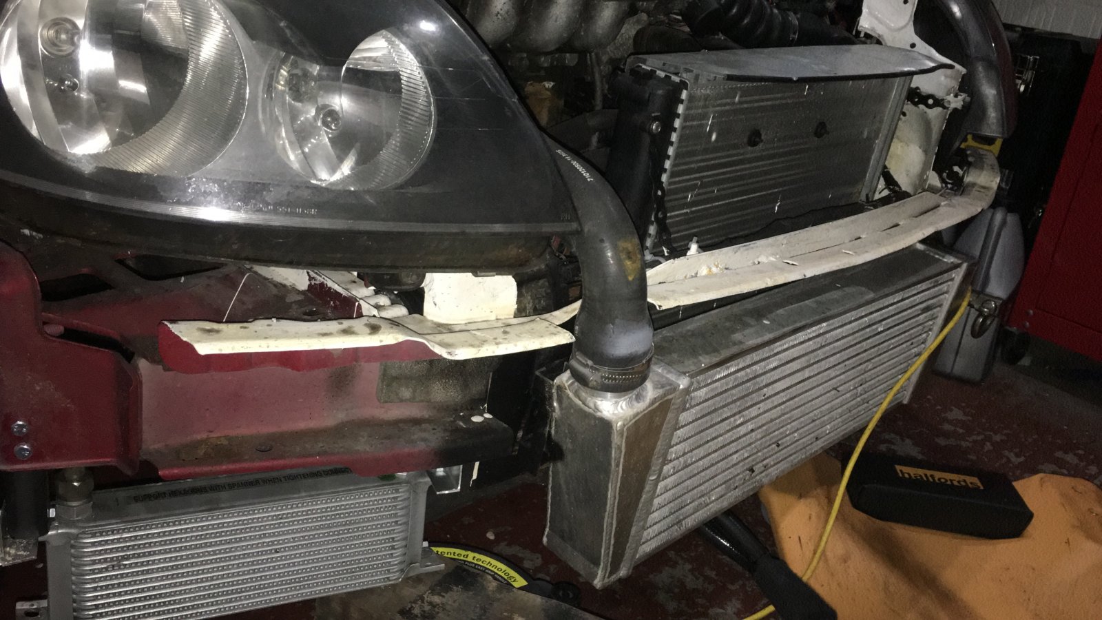

Few other bits turned up today. Longacre rear view mirror, and canbus signal converter. Had issues getting the shift indicator to work with the Megane ignition. Tried a signal pickup and that's a bit hit and miss so gone for a canbus signal covertor, plugs into obd port and offers various signal outputs so going to wire that up to the shift indicator

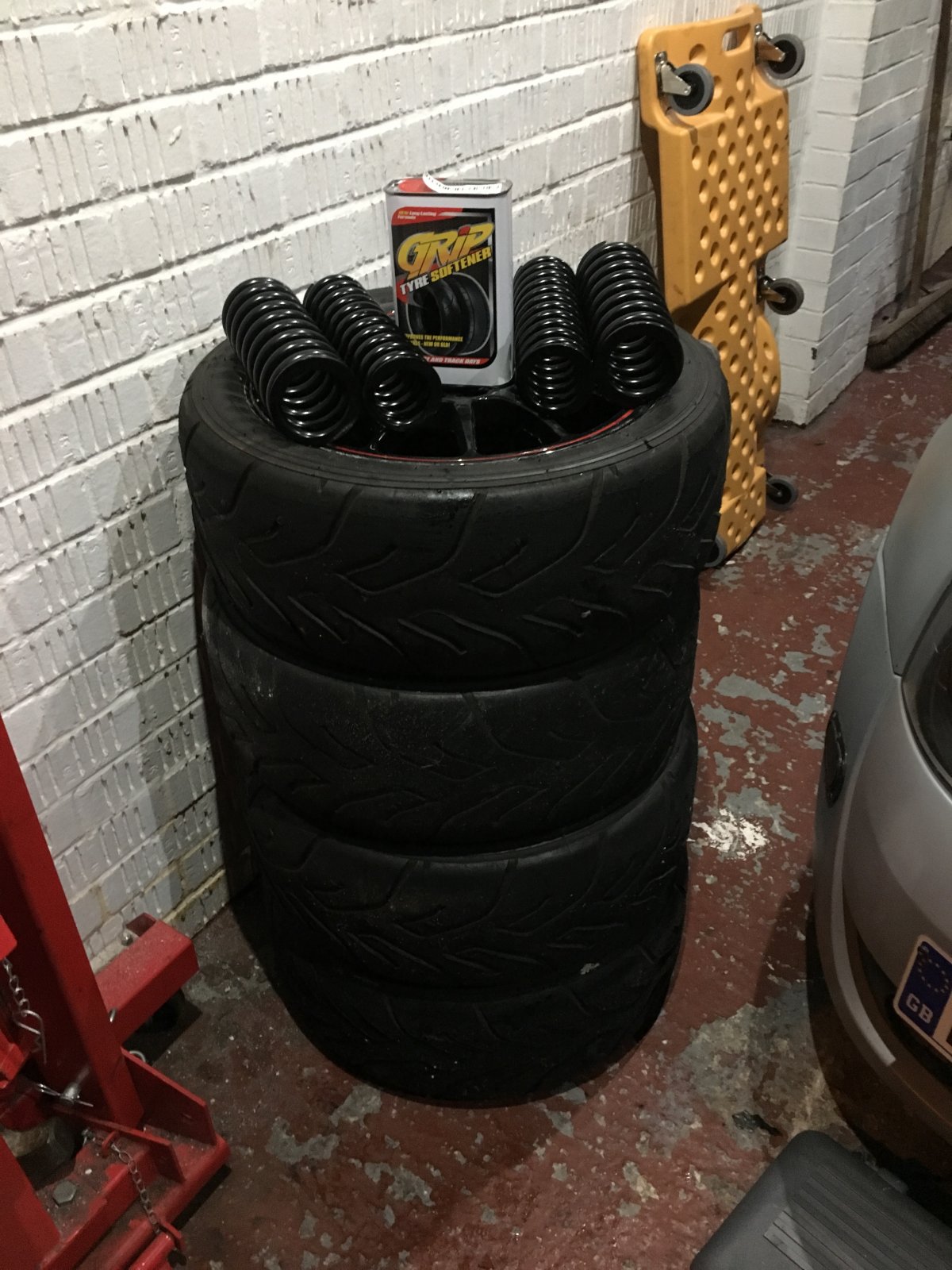

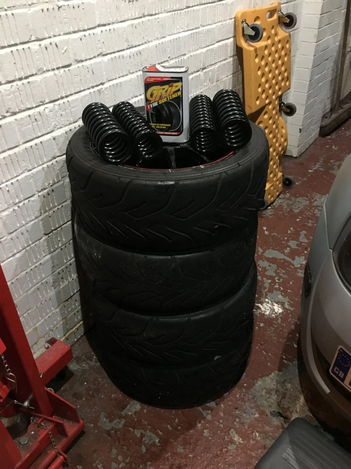

Also got some Grip tyre softener to use on my well worn semi slicks. Last delivery today was a new set of springs from Faulkner springs. Gone for 450lb fronts and 400 rear. Hopefully make the car more usable on the road as the current ones are something ridiculous like 600 and it's unusable down country roads at present

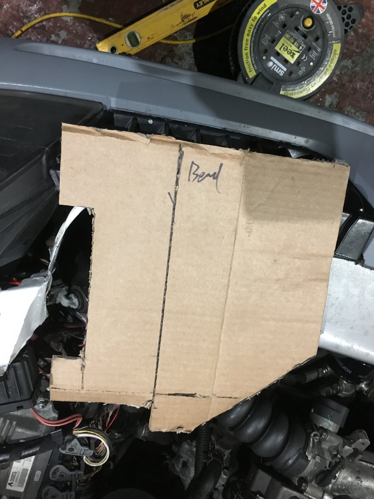

Did some CAD design ala project binky. Need a cover for the fuse box so made a cardboard template. Get it made up in aluminium tomorrow

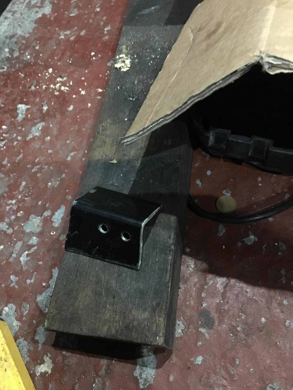

Last thing was starting a pedal stop for the clutch pedal. Chopped a piece out of a spare subframe. Needs tidying up and bolting to side of pedal box

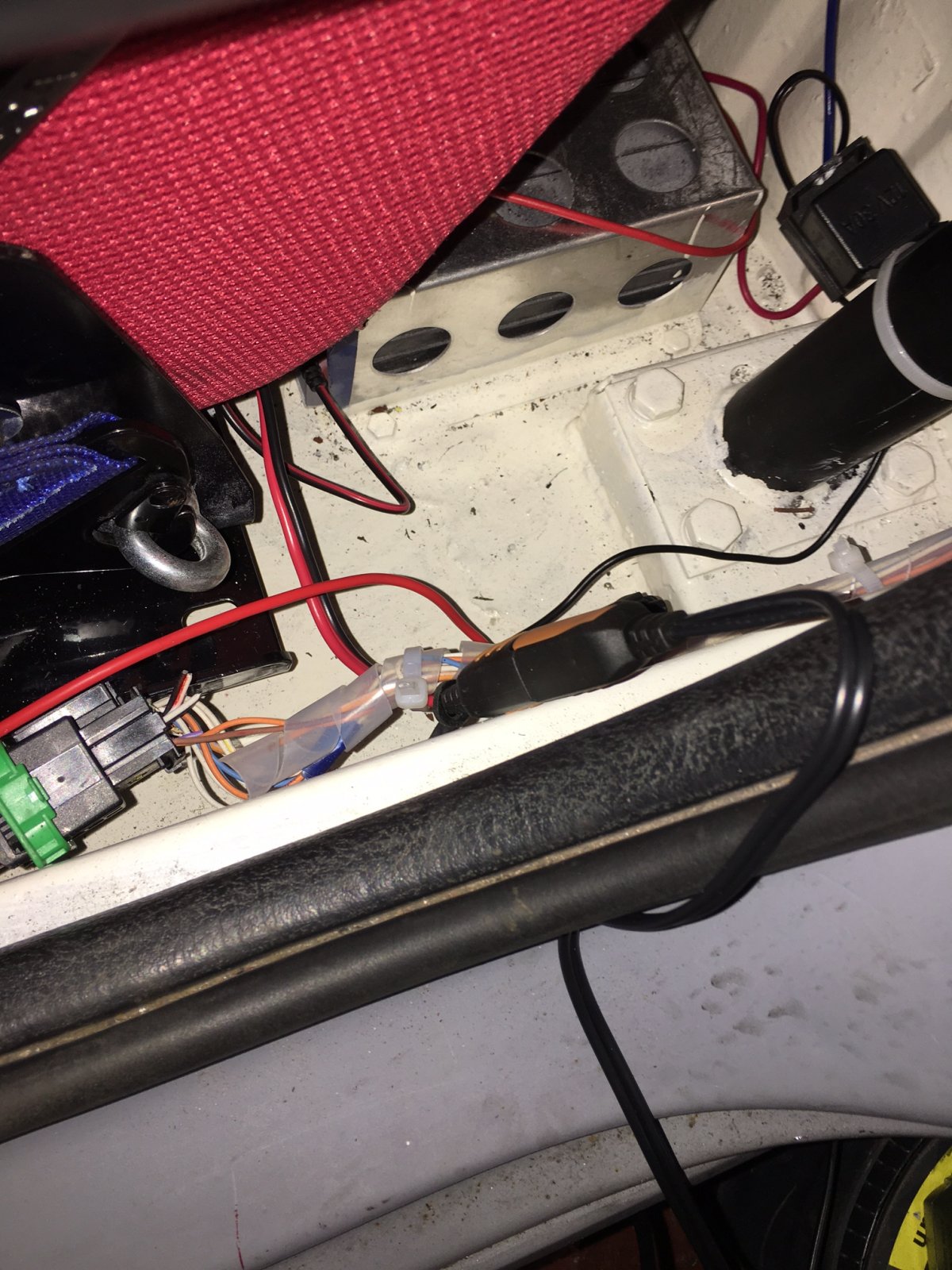

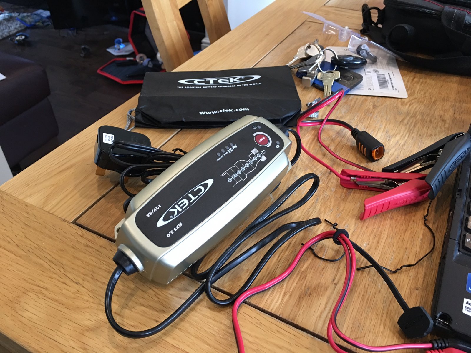

Got a CTEK trickle charger and conditioner to keep the battery topped up.
Added connector behind the passenger seat so the charger just plugs in to the electrical system.

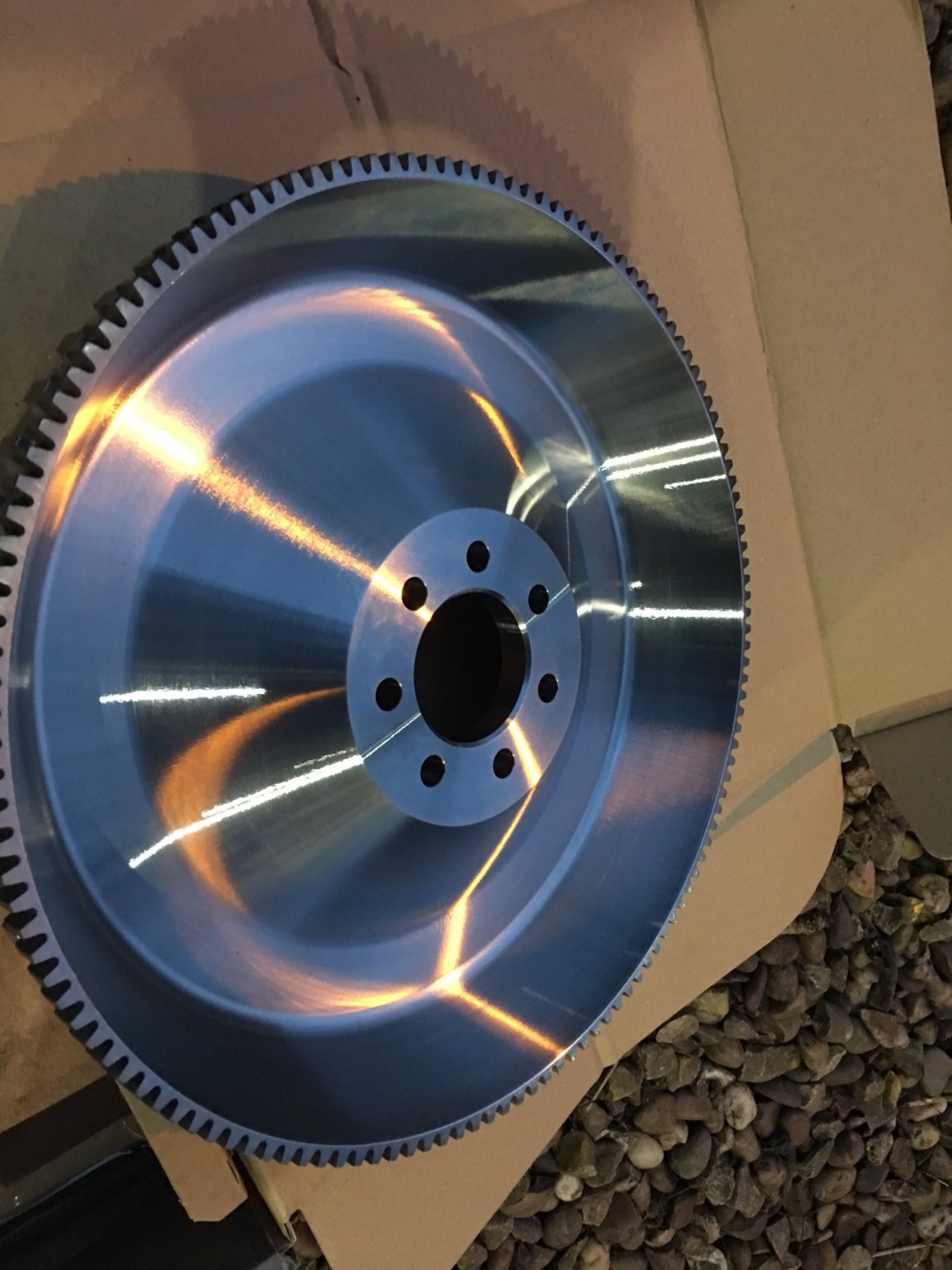

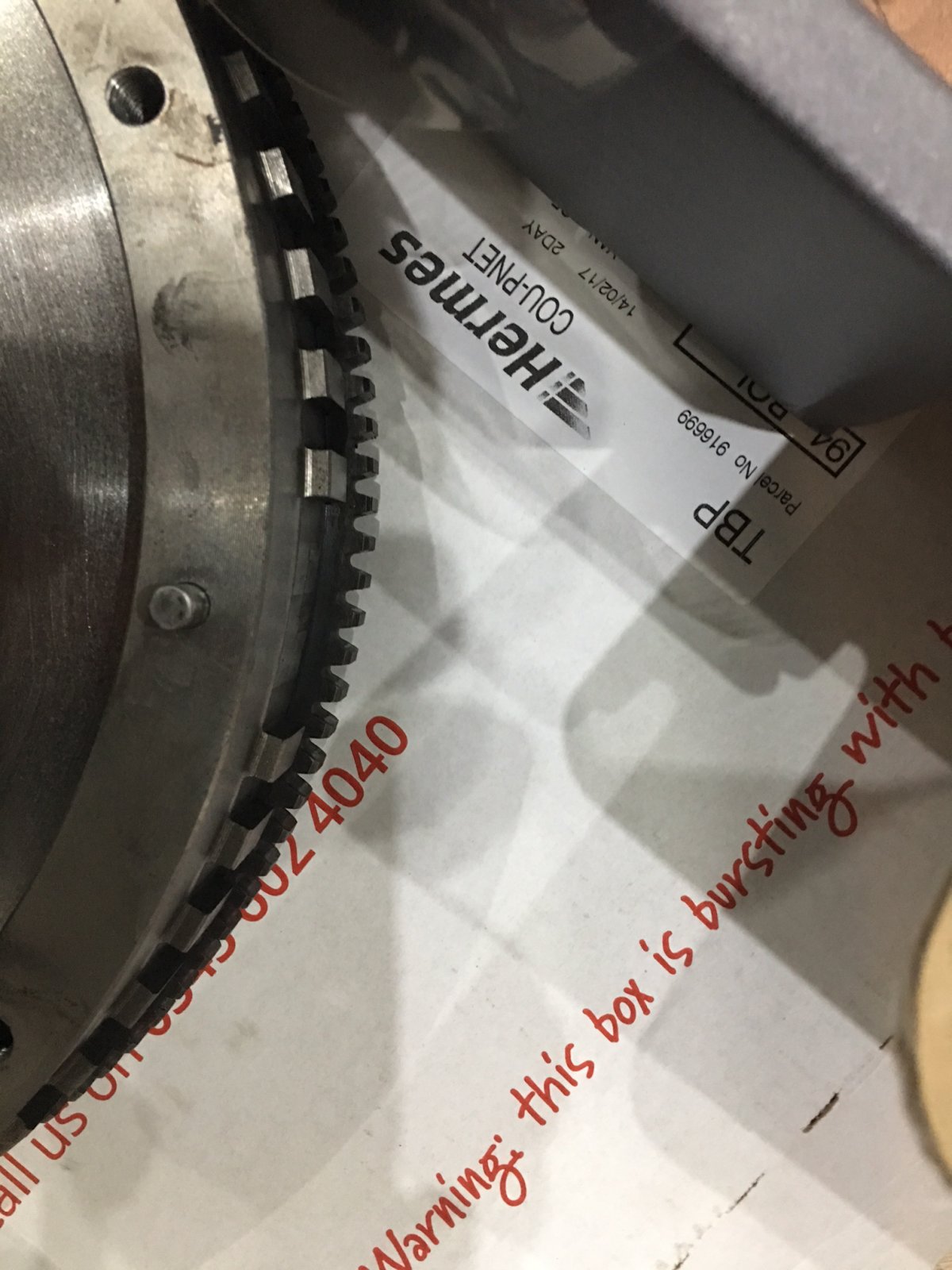

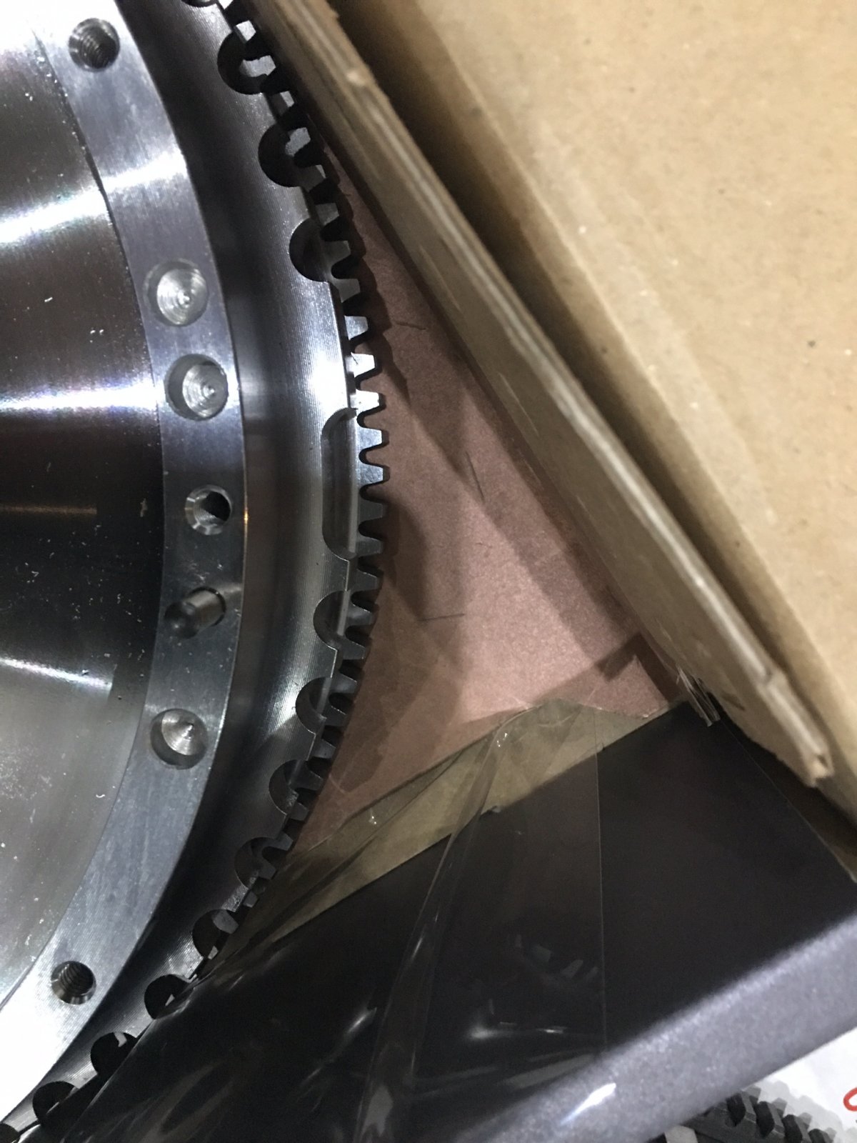

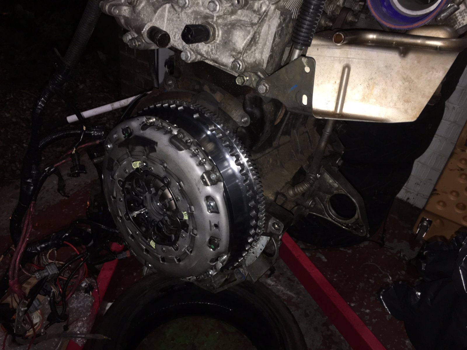

Well last week we had mapping attempt number 2 at RS tuning. Whilst the car was idling well it was keeping high revs coming off the throttle and Paul didn't like it. During conversation mentioned the single mass flywheel and after a brief discussion around it being a techniclutch flywheel off Ebay we abandoned mapping again. He's a bought one of their kits in the past after seeing several cars with blown engines and the flywheel being in common to them. Turns our the trigger wheel is 30 degrees out meaning 30 degrees of advance. All the problems we've had the flywheel has been common to all 3 engines. After despairing at the thought of taking the engine aout again Paul arranged for a TTV flywheel to be drop shipped to my address and I took an R26R clutch kit with me.2 days later it's all fitted and idling better than it ever has. No light popping from the exhaust anymore and rock solid idle.
Shite flywheel trigger:
Proper trigger:
ALso new flywheel is less than half the weight of the other - hollow at the back
Assembled with R26R clutch - needed 9 bolts rather than 6 on original, had to cut some down to get enough. Has 20% more clamping force

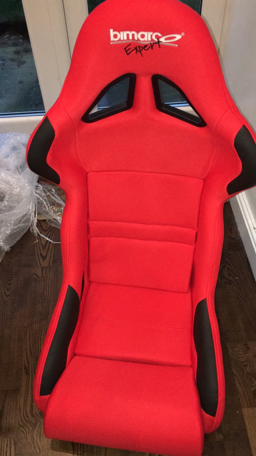

Also got this over the last few days - much snugger and more comfortable than the Cobras

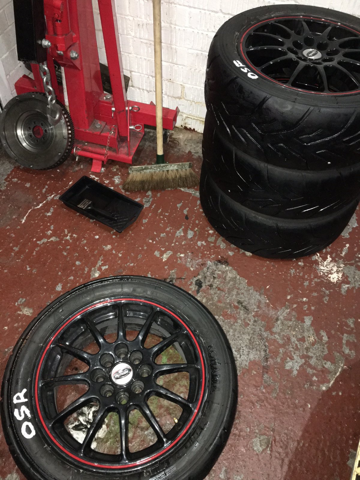

Ever the optimist I've also applied a shed load of tyre softener to my semi slicks ready for Tuesday

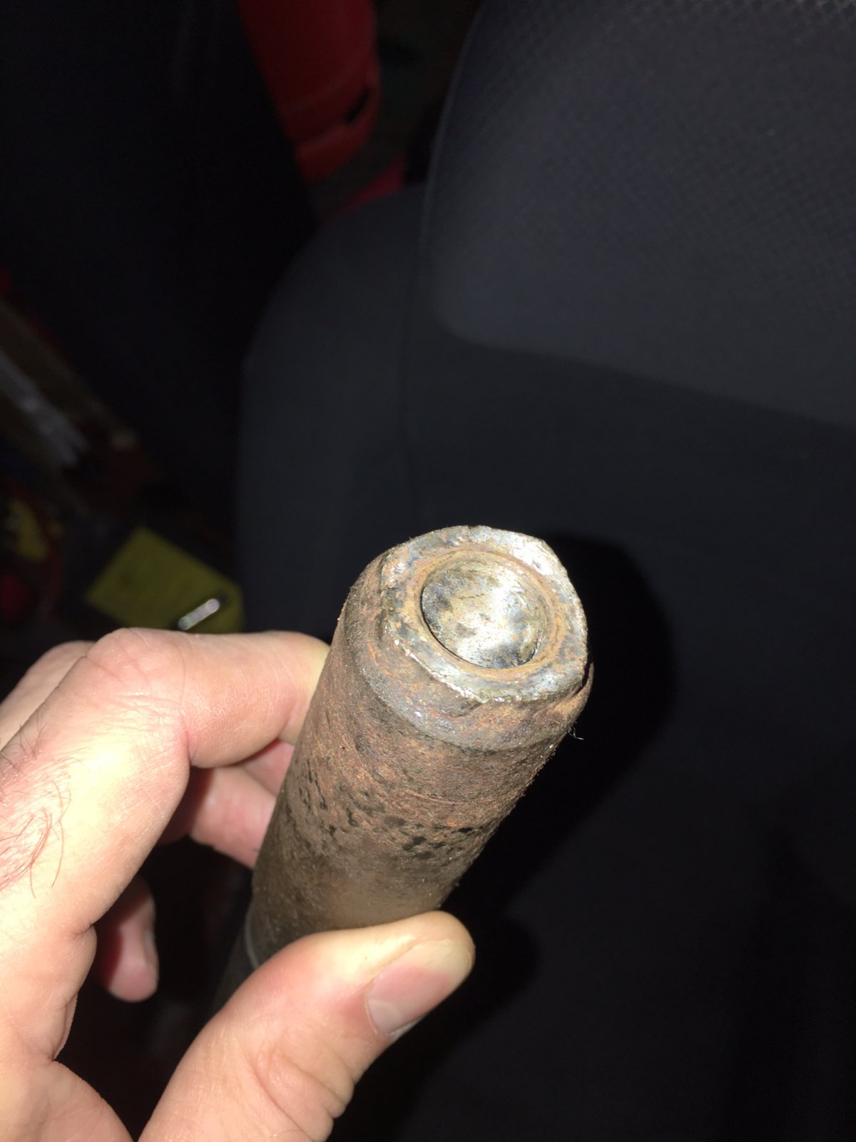

Thanks, was hoping to have got some videos tomorrow but as I've snapped the os shaft that's not going to happen
Could you maybe slide a sleeve over that shaft and weld it that way? I believe my mates 106 turbo with a BE box has sleeved shafts as he had a similar recuring issue.
Clio shafts and Megane shafts are different diameters so can't sleeve easily. Just going to get some proper ones made. Intend on pulling them out this weekend then dropping them off to be copied. Hopefully, how many times have I said that over the last 6 months.... it'll be up and running in a few weeks.

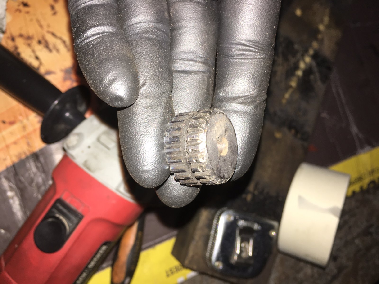

So today got around to taking the welded shafts out so can take them to get proper copies made. Looks like the broken one not only broke the weld but also the insert that had been put in

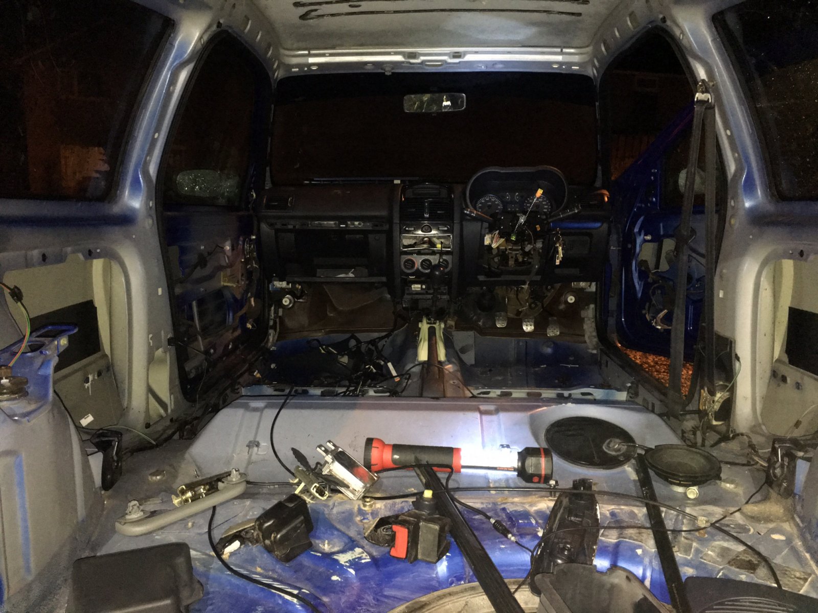

Also got on with stripping the cup out
