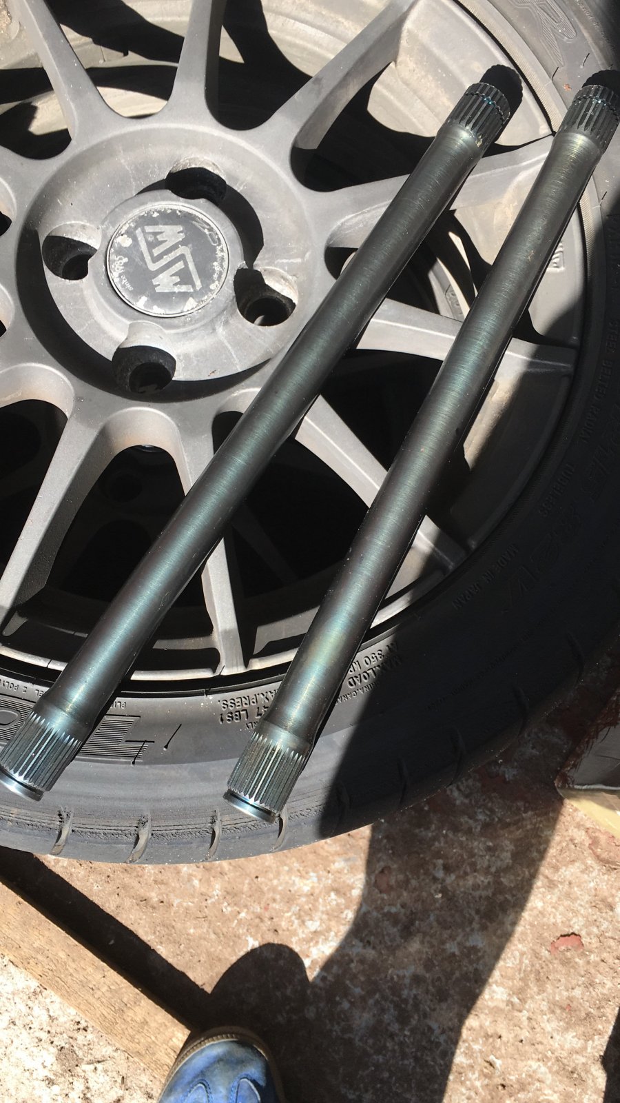

Custom shafts made by berrisfords, proper grade of steel and heat treated for good measure. A lot happier with these than the welded shafts.

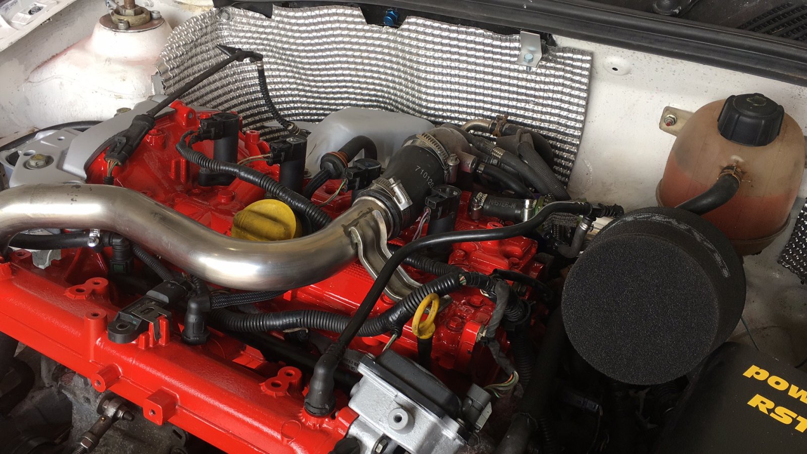

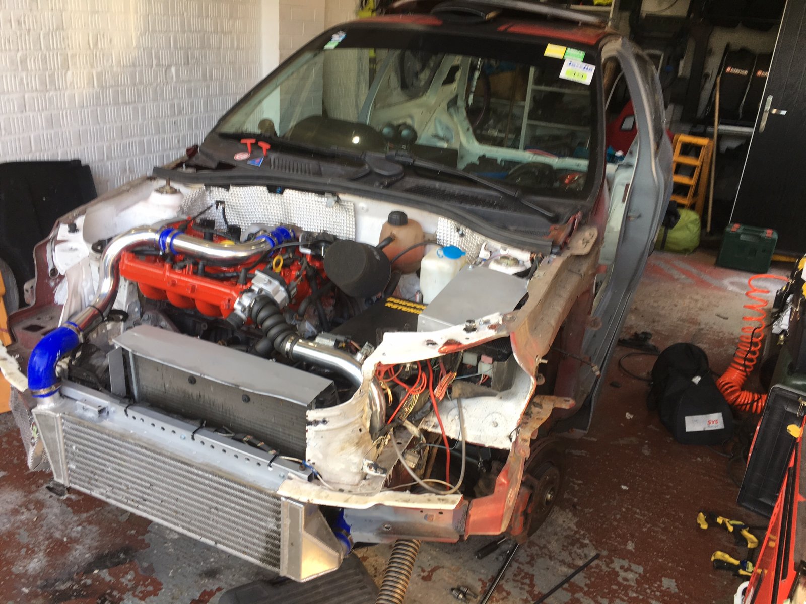

As we now seem to be mechanically good decided to make a start on making it more presentable. Painted the engine and I think it's come out okay.

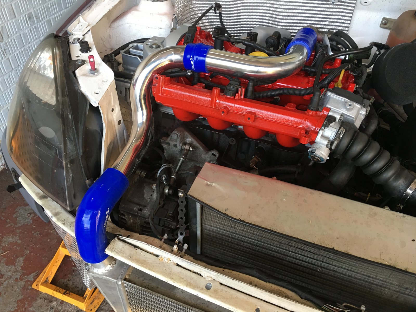

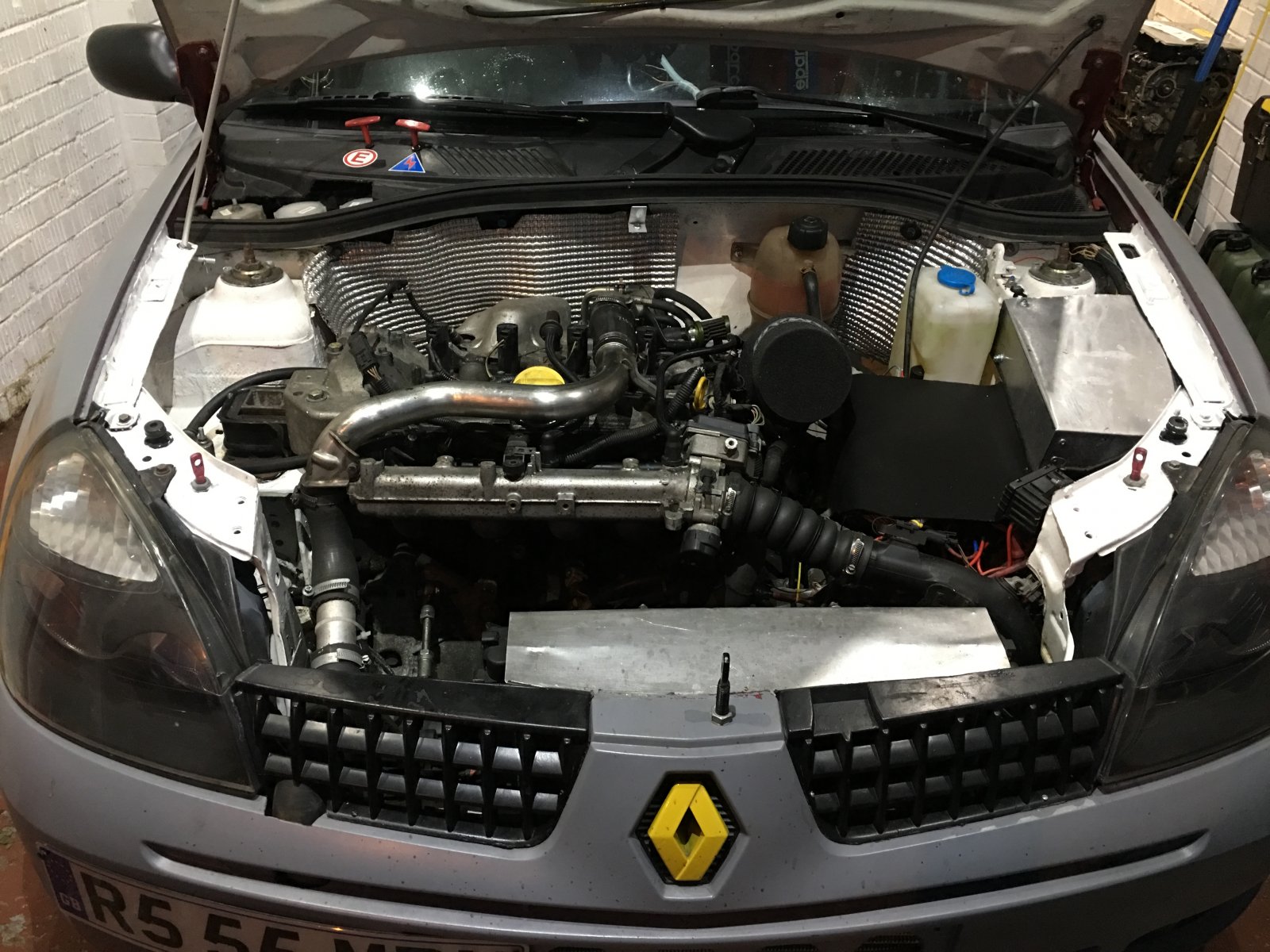

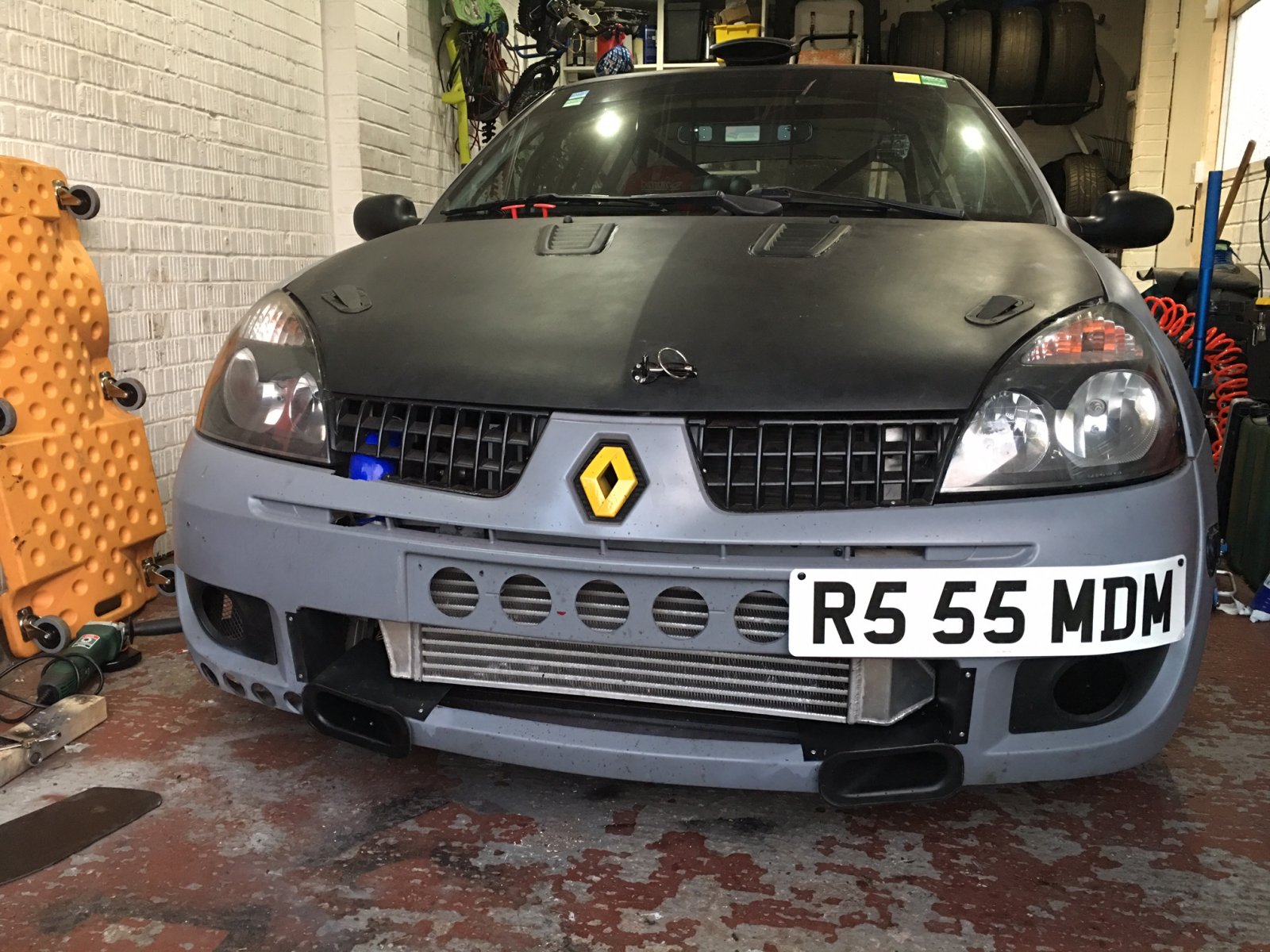

Have ordered a new intercooler hardpipe kit with 2.5" diameter, will need to reposition the intercooler slightly when it arrives but will sort then. Also started getting paranoid about engine temps for Oulton, no reason as yet to worry as I think the overheating last year was down to the stupid 30 deg advance ebay flywheel. Regardless, I've ordered a low temp thermostat (75 deg) and saved a bit more weight from the bumper...
Going to pick up a bit of sheet metal this week to shroud the oil cooler in and force the air through it.

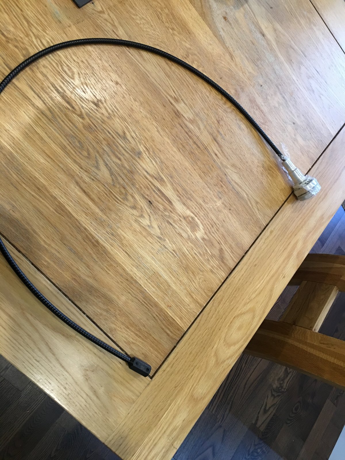

Some other bits turned up today

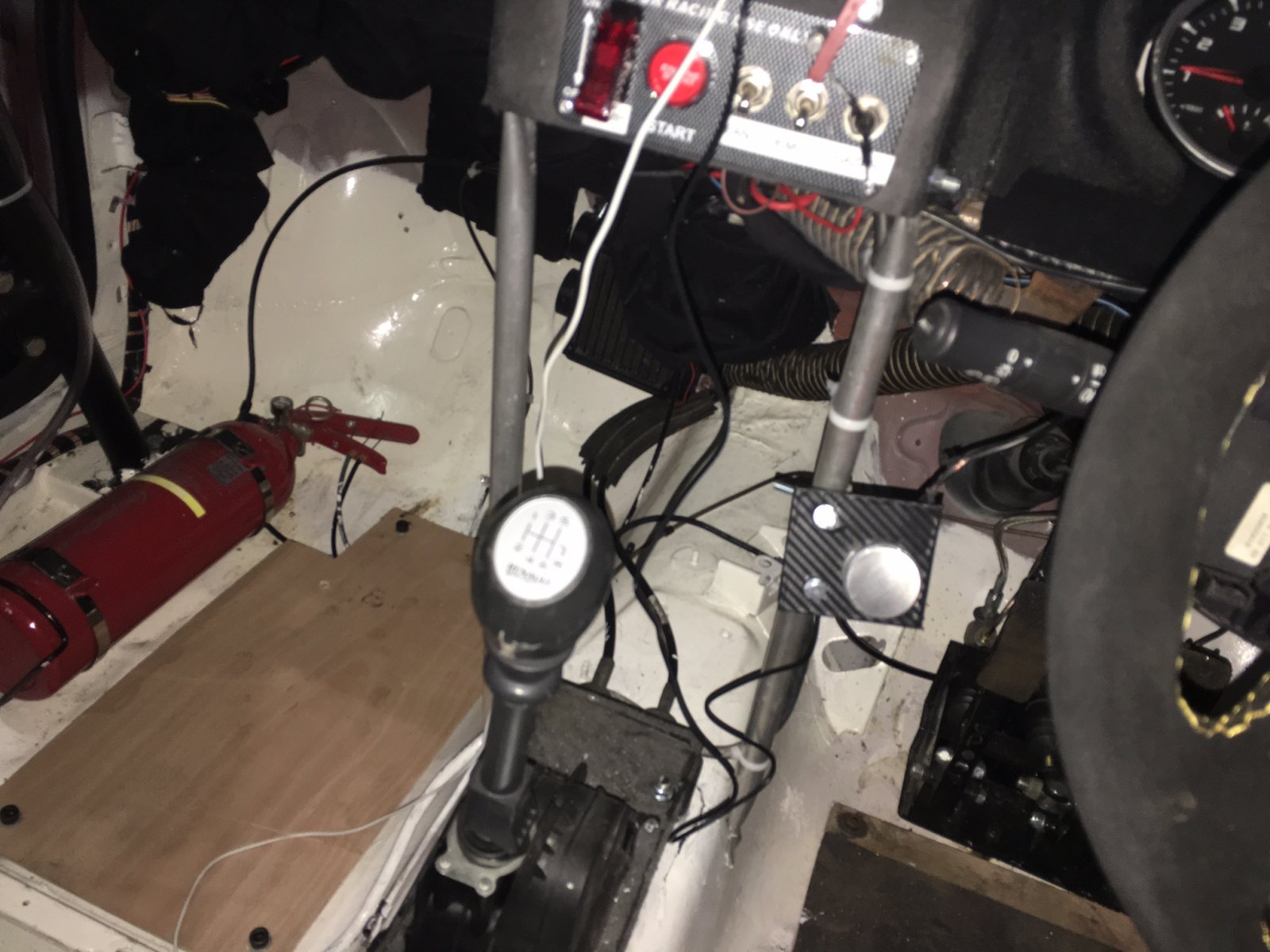

Brake bias adjuster for the pedal box. Thinking of mounting near the gear lever, need have a proper look at the weekend where it can go.
Also got new intercooler hard pipe kit, so started fitting. Think the intercooler needs to move up and back towards the engine 25mm ish, will have to work out how to mount it as it mounts from the rear and there's no room if I move it further back to mount it that way as the alternator is completely in the way.

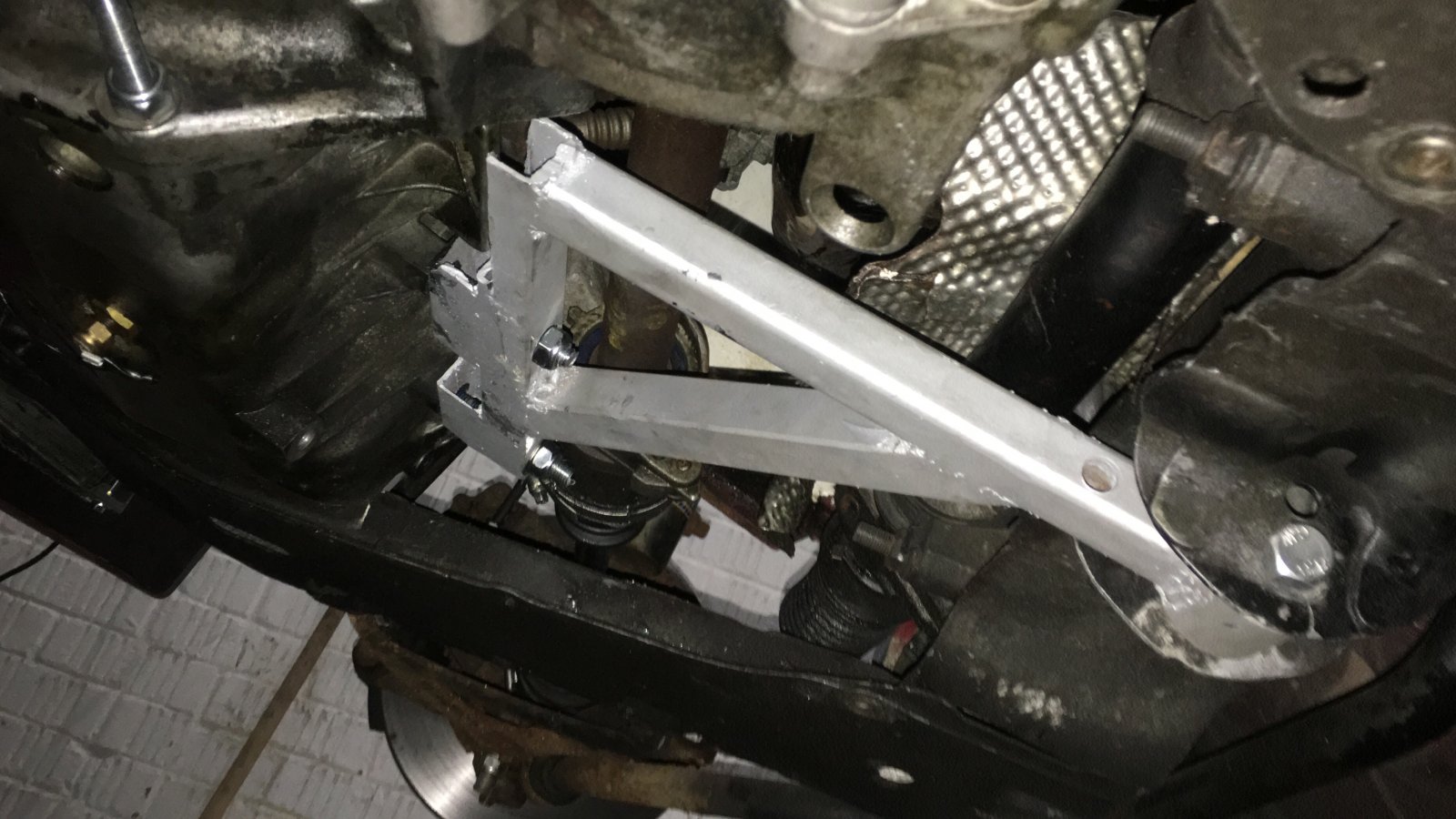

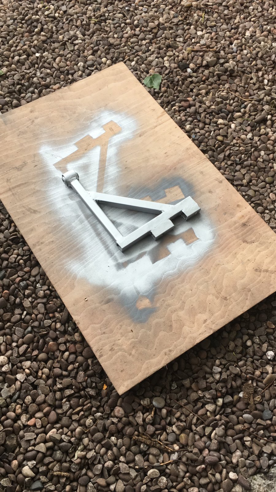

Finally got around to making a proper lower engine mount. Square box section and a random bush welded together
Bit of fettling and it's in. Mounts to clio body mounting point and picks up the mounting points on the Megane sump

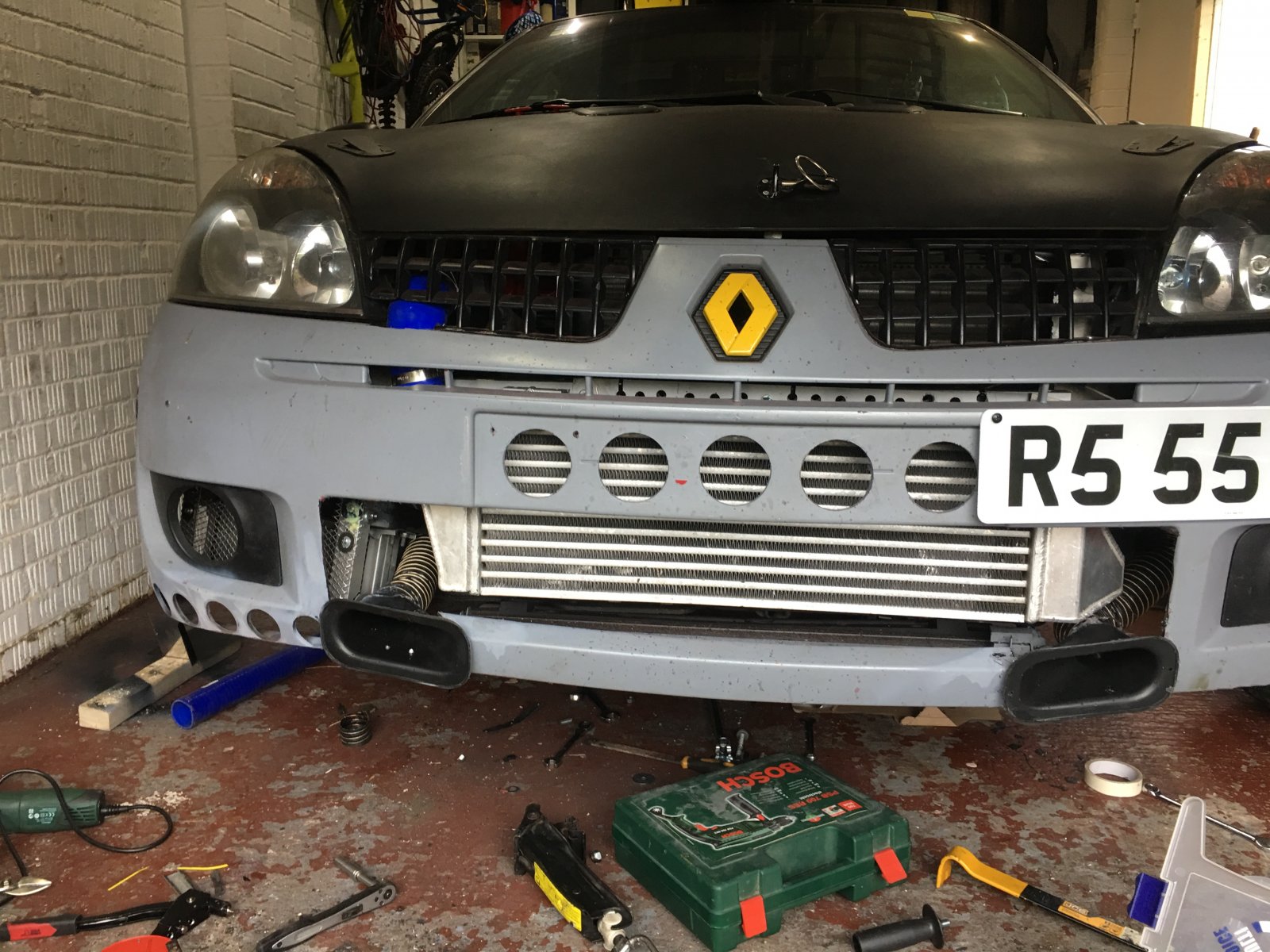

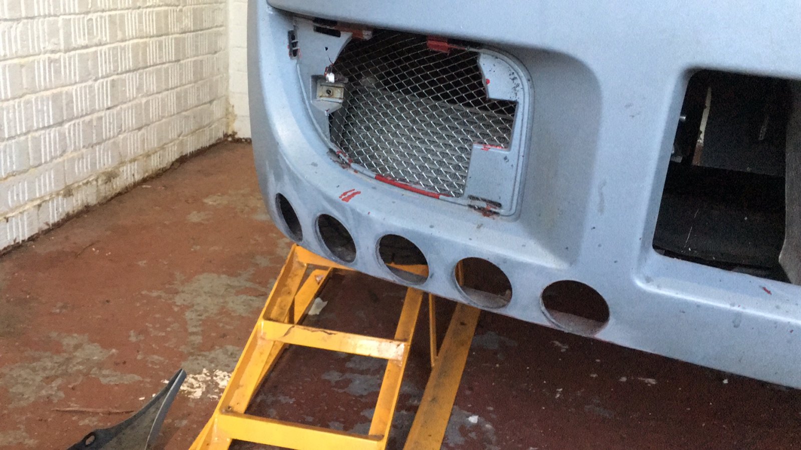

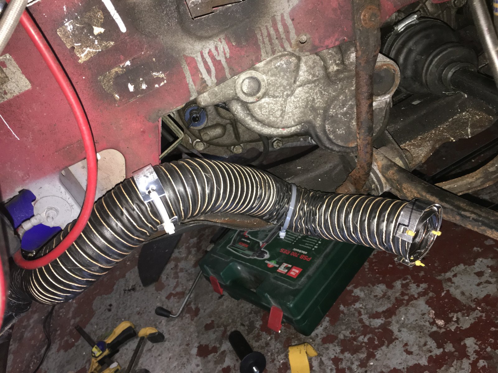

Chopped the bumper to fit a couple of brake ducts. Couldn't do the usual thing of mounting behind the fog light holes as the drivers side one is where my oil cooler is. Going to fit a couple of deflector plates on top of them to tidy it up; to be honest I don't like how it looks but if it works I'm not overly bothered. Having said that I've got a spare bumper on it's way as I've thought of a different way of doing it but it'll do for now
51mm flexible hose for brake ducts, made some 'brackets' with strips of aluminium pop riveted to the car, then ducts attached with good old fashioned cable ties

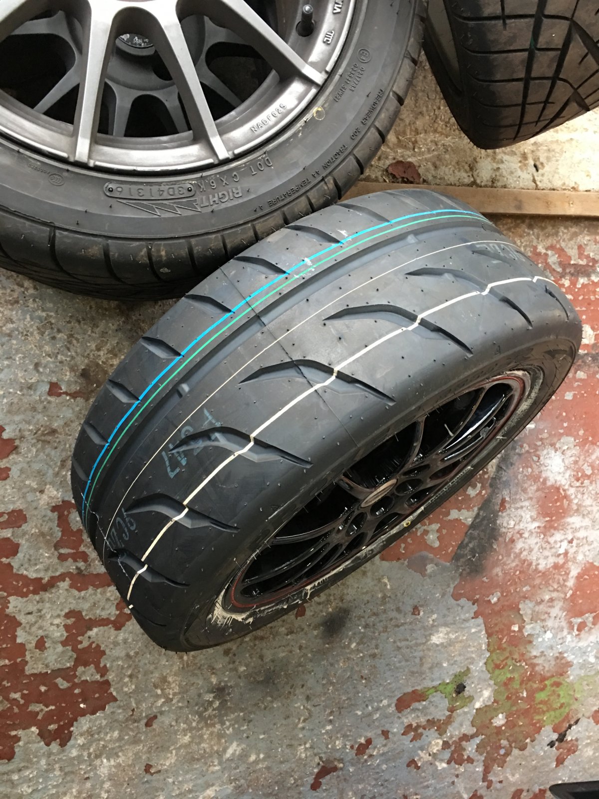

Picked the R888Rs up and got them fitted to the car. GG compound, and really soft so have high hopes for them at oulton provided the weathers dry

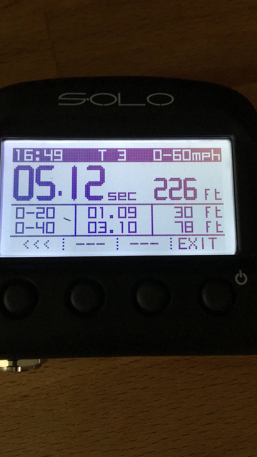

Got a GPS data logger/lap timer coming tomorrow so interested to see what we can get 0-60

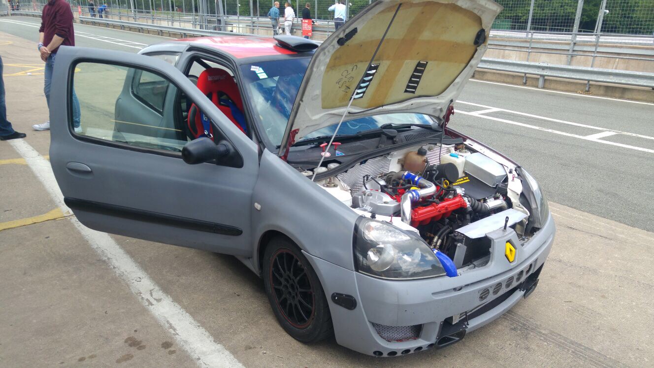

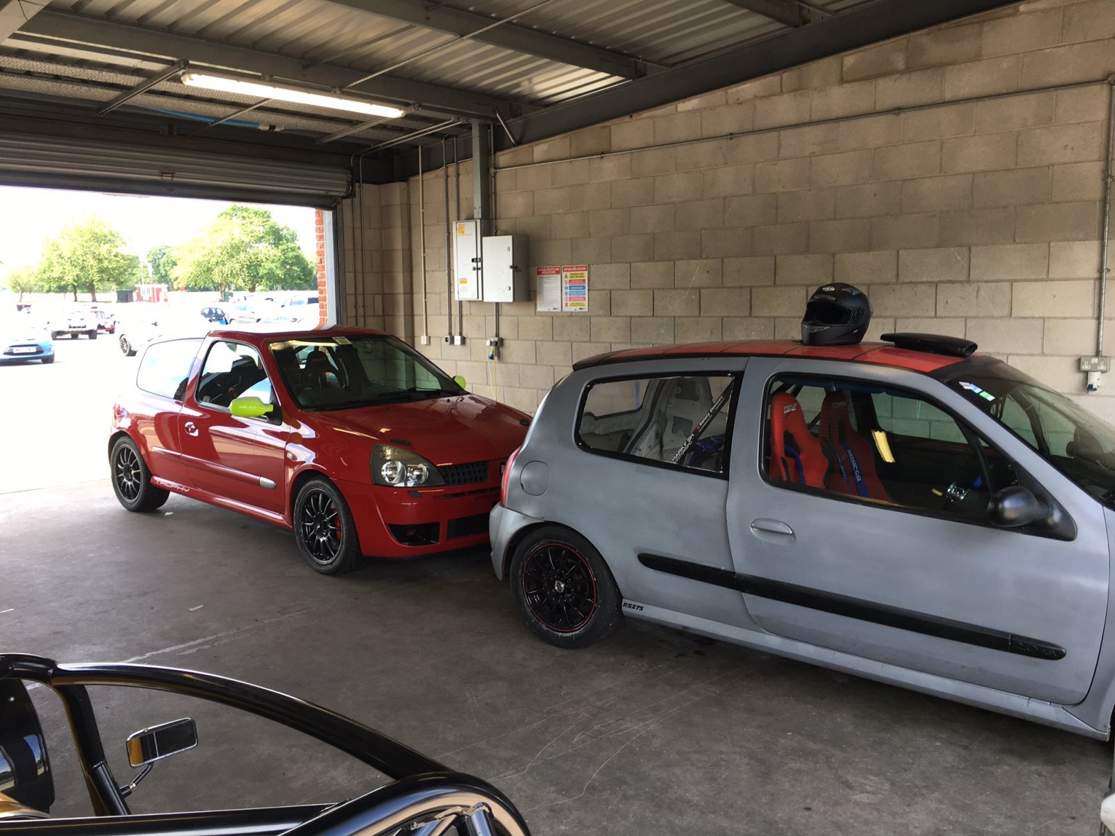

Reasonably successful day at Oulton on Wednesday :cool: Car is a handful, massively fast in a straight line, young @dann2707 came down for a nosey and a quick passenger ride where we pulling away from stuff like new Impreza Turbos.
Had issues right at the start of the day where I lost gears 2 4 6 and reverse, fixed temporarily with judicious use of cable ties where the shifter cable had broken away from the mount. Only other issue was boiling the brake fluid despite being extra high temp racing fluid.

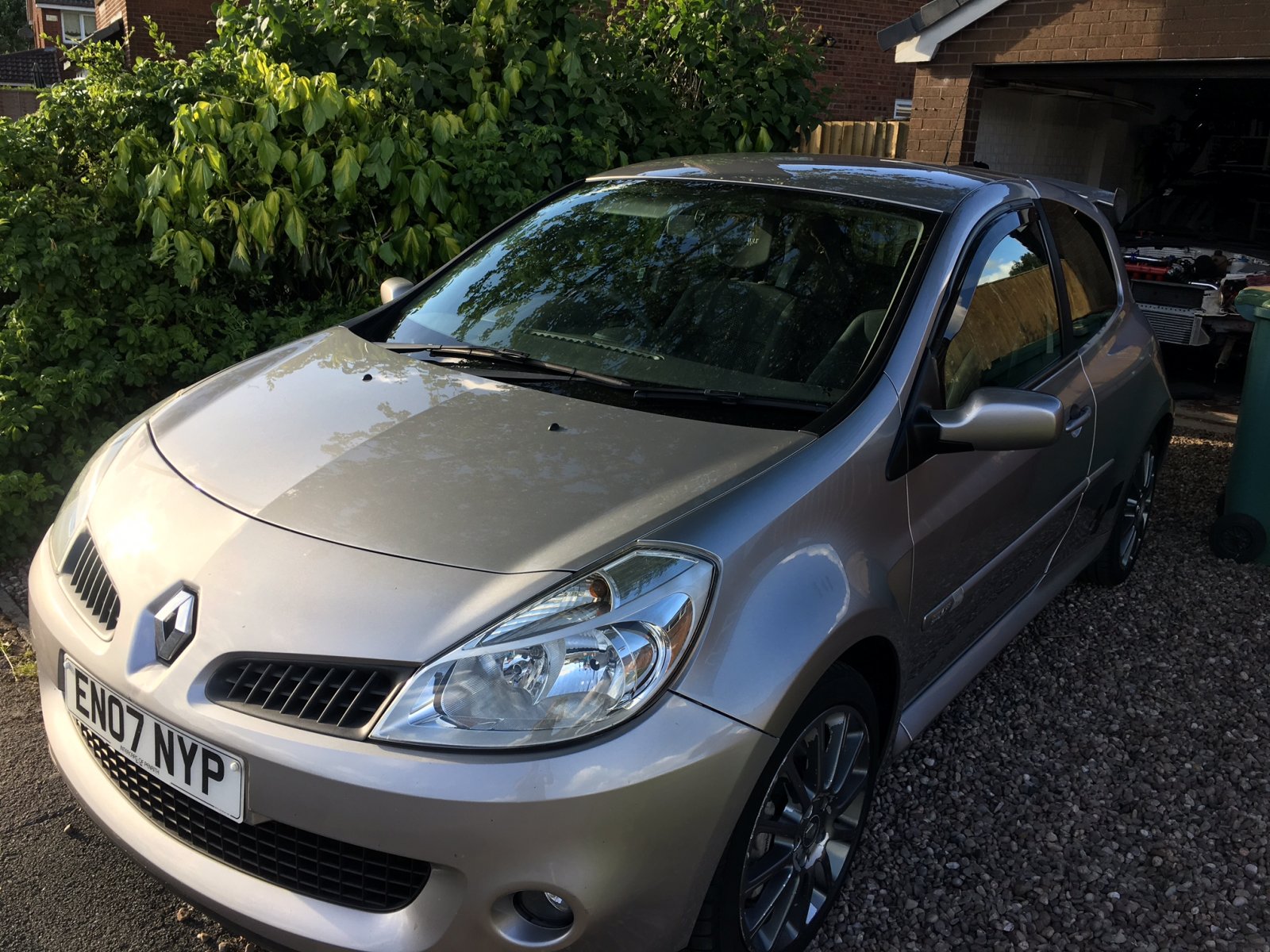

2 owner, full history and I'm going to pull it apart :cool:

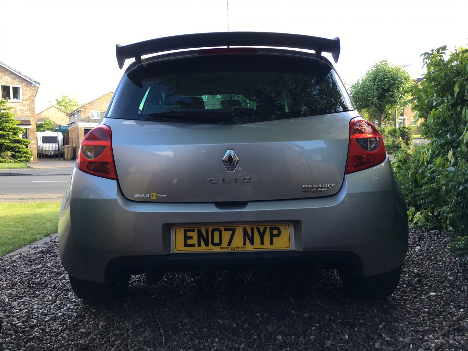

So here we go again.... collected the 197 earlier and I'm impressed. Gear change is a revelation compared to the vague shifts of the megane and 172, a couple of small bits need sorting on the body work and the wheels could do with a refurb but overall I'm pleased with it. Chassis and brakes feel great just feels a little slow compared to the other one.....

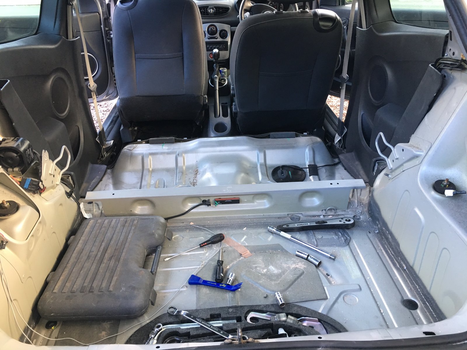

Made a start stripping out the rear. Not going any further with stripping it out until I start the conversion but I'm intending on keeping some interior in including the stereo at present even though it is crap.

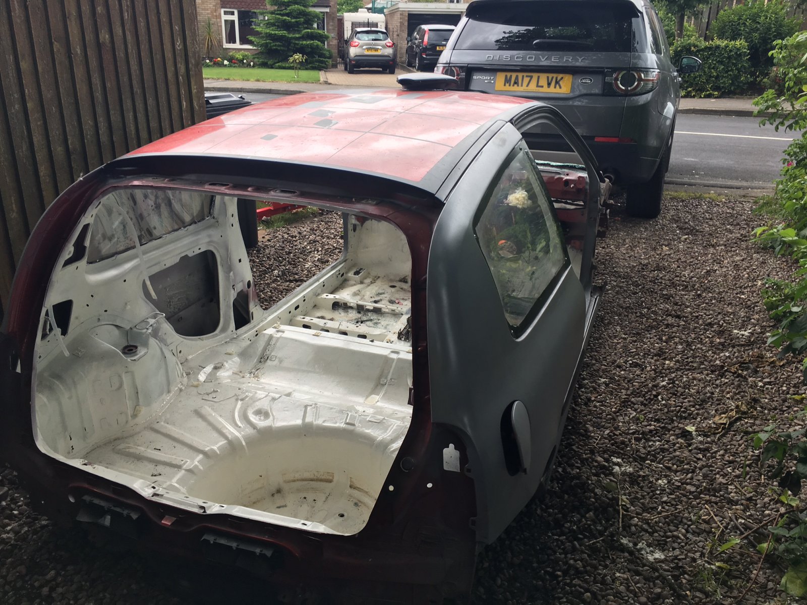

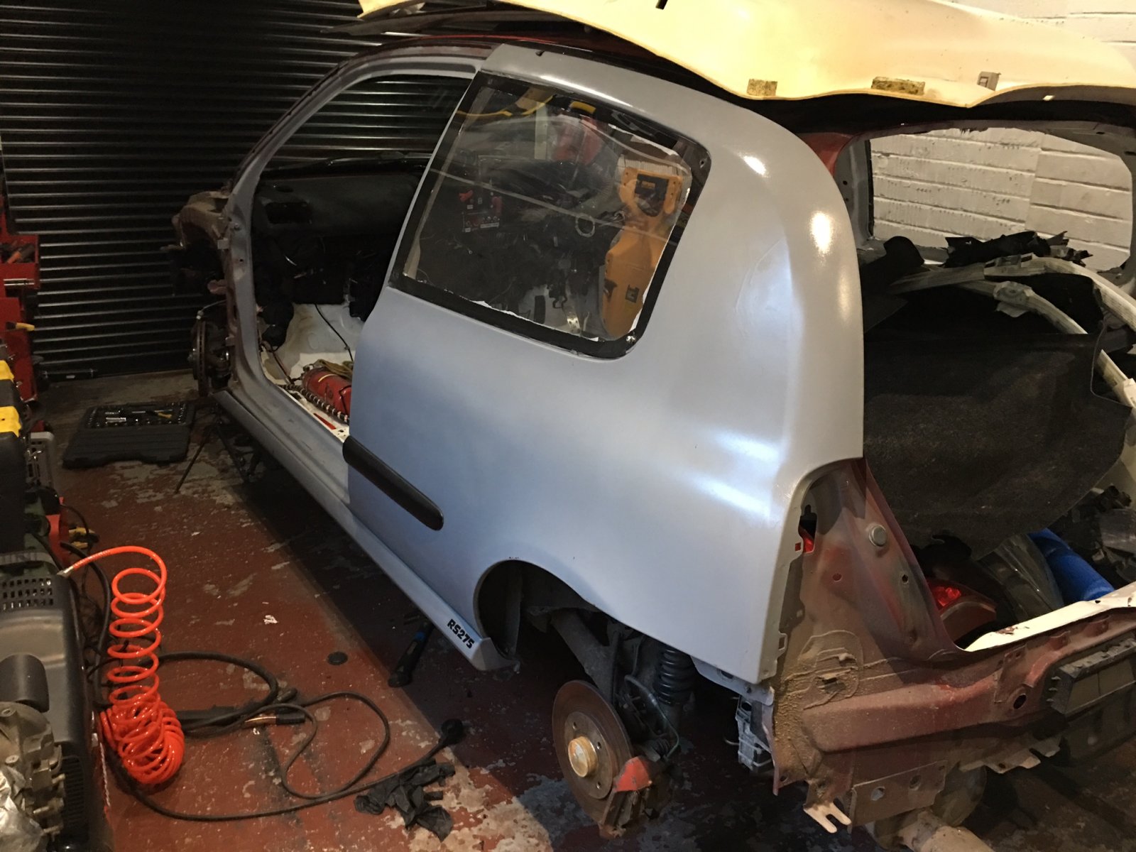

Finished stripping the 172 and the majority of it is now sold and gone. As I want to get cracking on the 197 I dragged the shell out of the garage yesterday, hopefully get it scrapped in the next week but need to wait for my V5 to turn up as I've taken my private reg off it. Kinda of hoping someone steals it in the next week, saves me the effort of getting rid...
So that's 2 years worth of work pulled apart in a couple of evening and left to rust outside :cry:

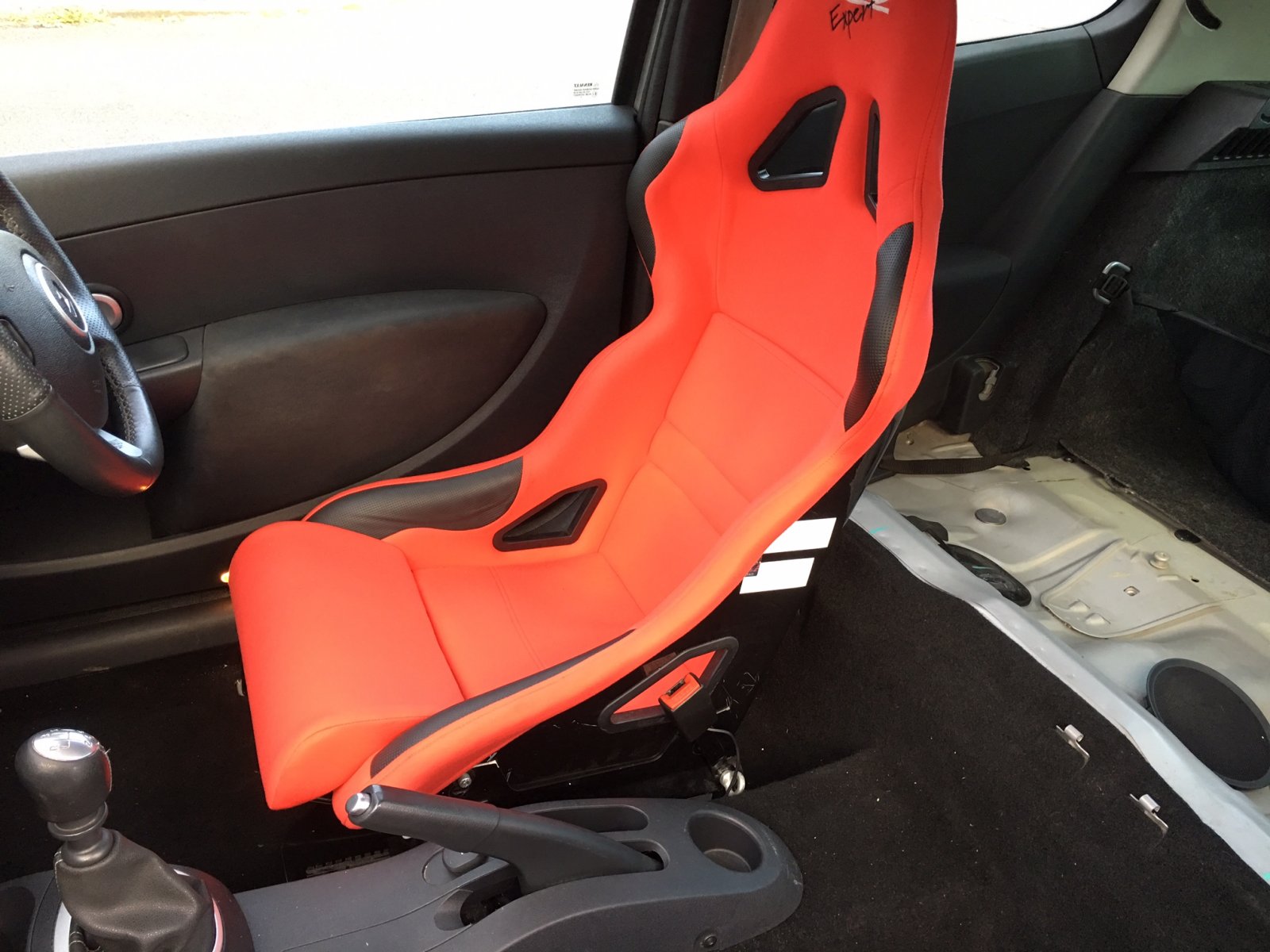

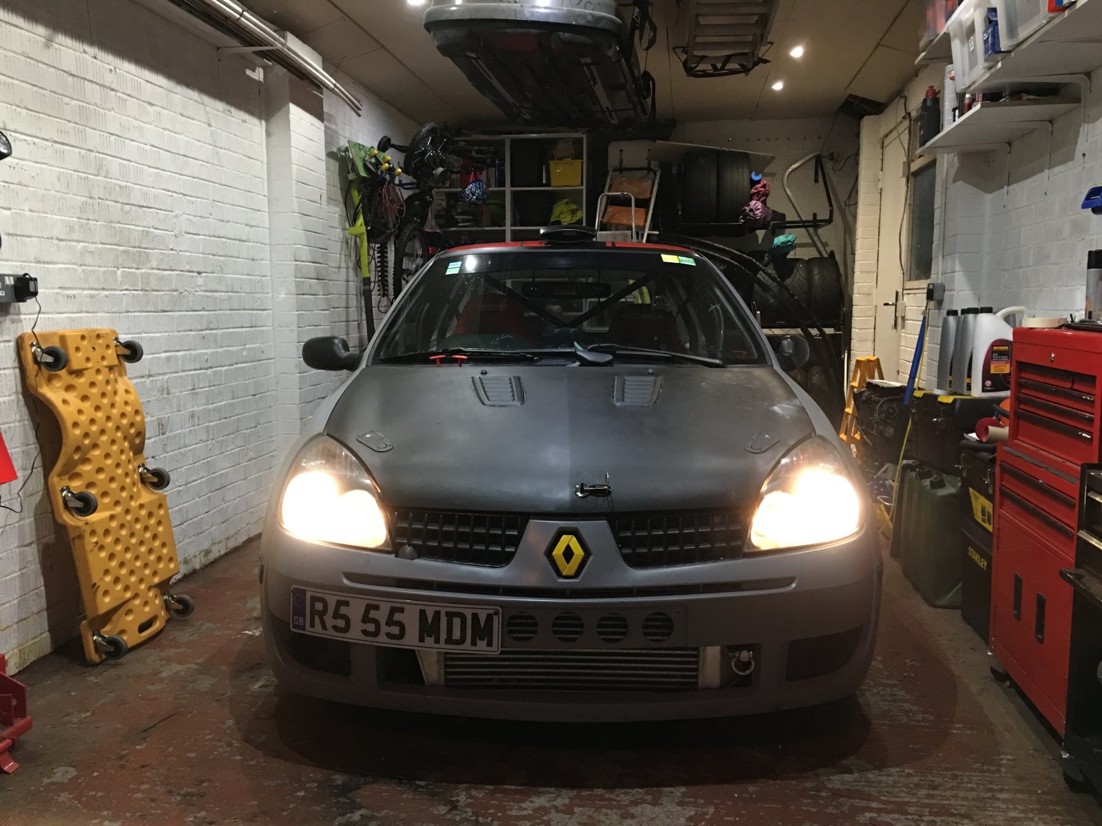

Made a bot of progress with the 197. Had stripped the interior and removed some weight, then refitted all the trim plus chucked in the Bimarco seat. Purchased the airbag controller module off Fastchip so disabled all the airbags I'd removed and no more error lights. Have left driver and passenger ones in as keeping the 197 wheel.
Need to get some carpet for the rear so I can cover over where the rear bench was.

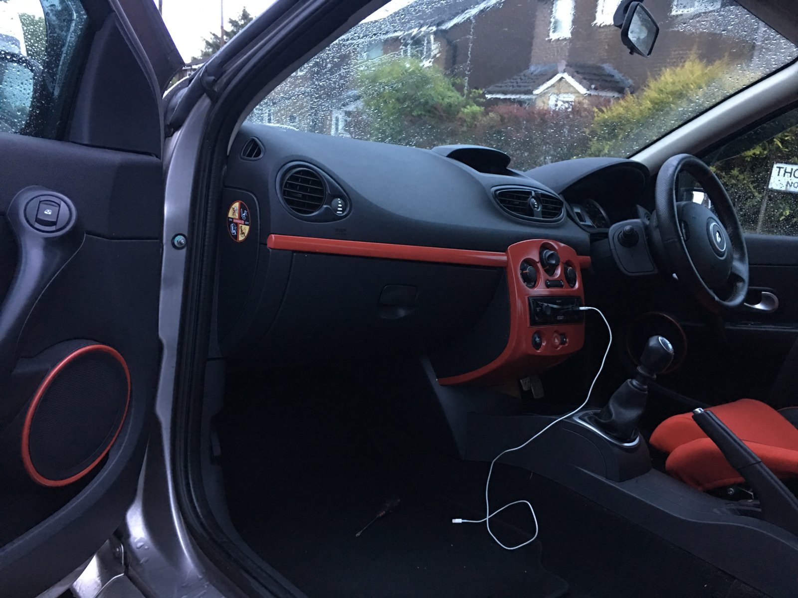

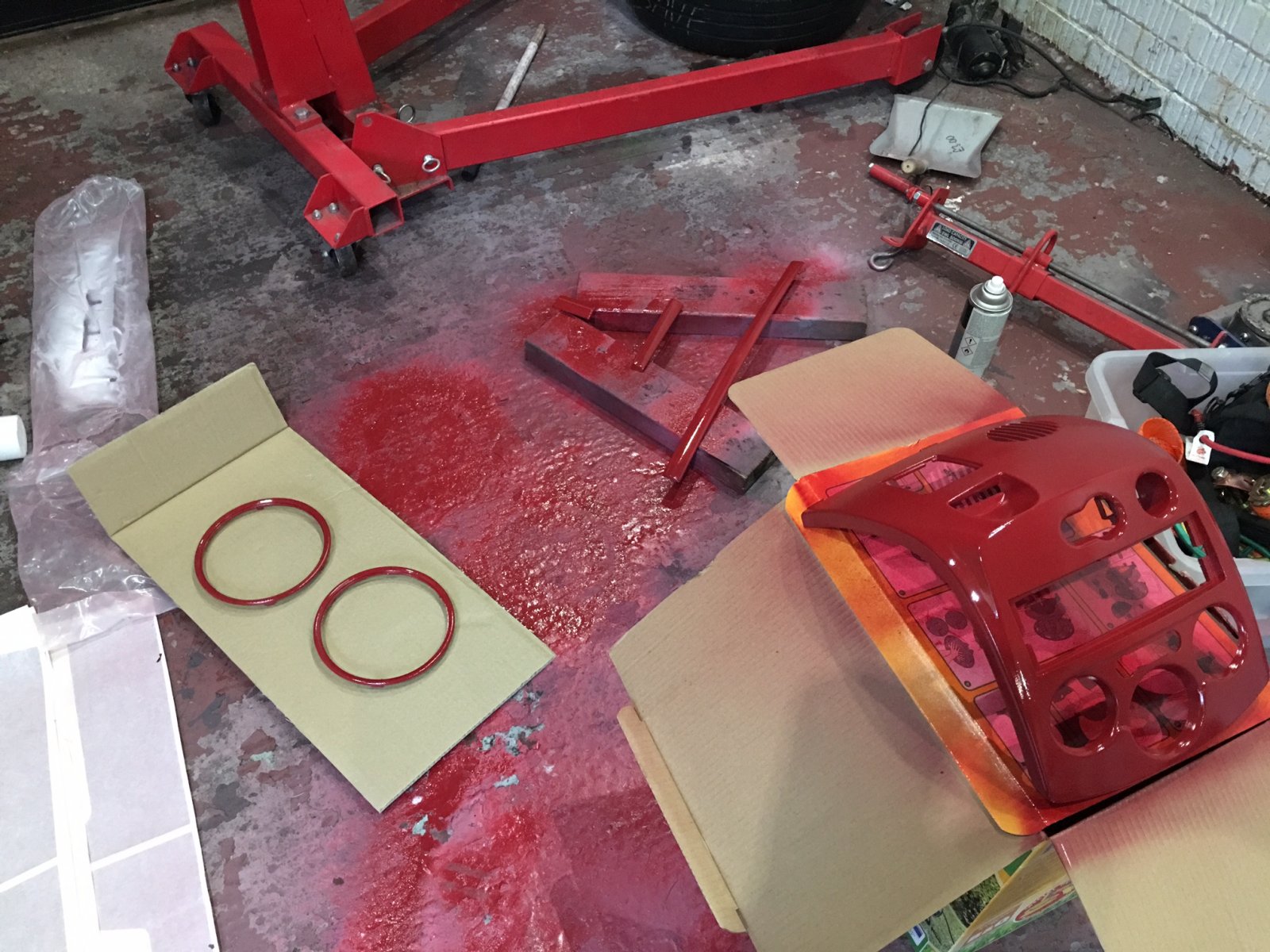

Liking the look of the red seat with the interior and the silver paintwork so decided as the silver interior dash trim was a bit worse for wear to remove it and paint it
Should be dry by tomorrow then will stick it in. I've also changed the stereo for a Sony one as the original Renault was really bad.... and if I'm keeping the stereo in it needs to be a decent one :up:

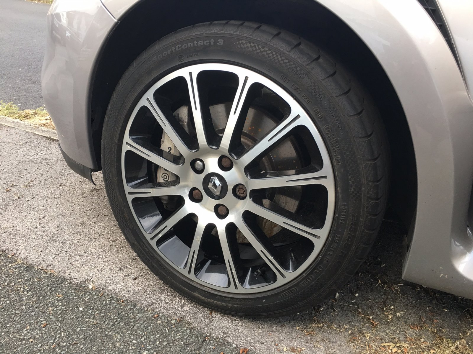

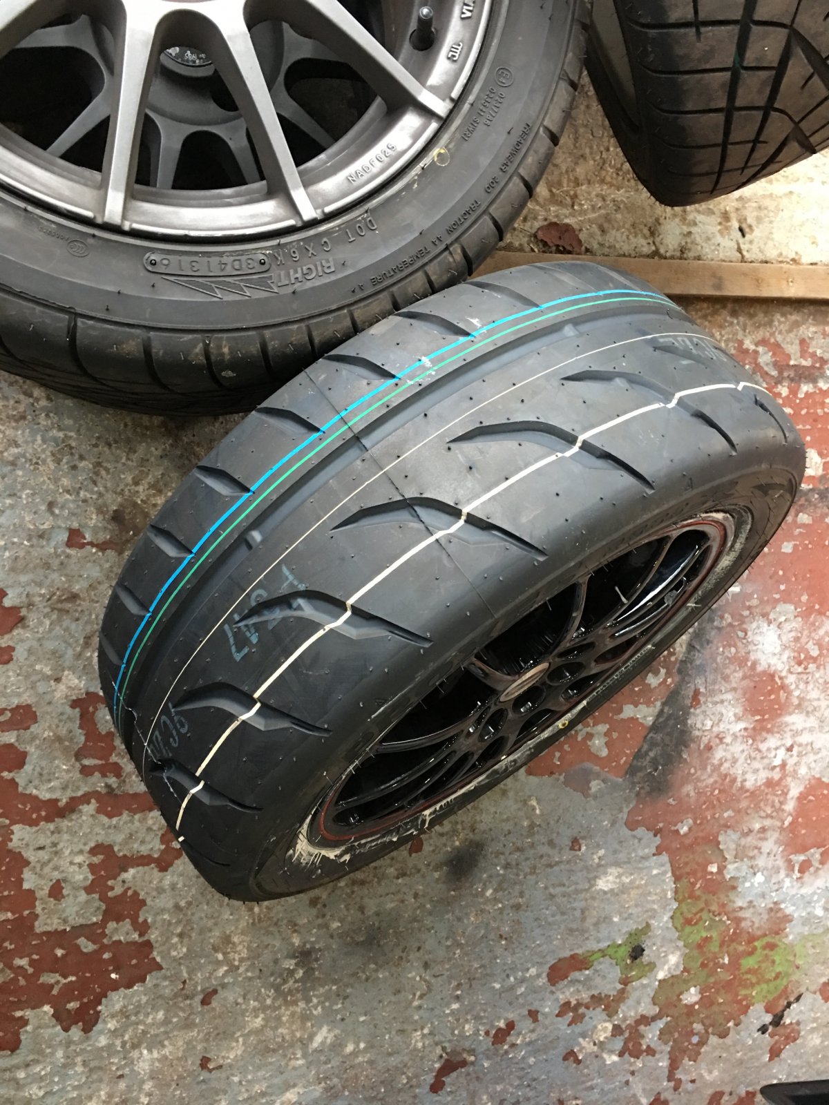

So, as the existing wheels need a refurb and the tyres are utter garbage got a set of raider alloys which are pretty much mint off ebay fitted with half decent tyres. Going to run these till they're dead then get some R888R and get the other wheels refurbed and some R1Rs on them.

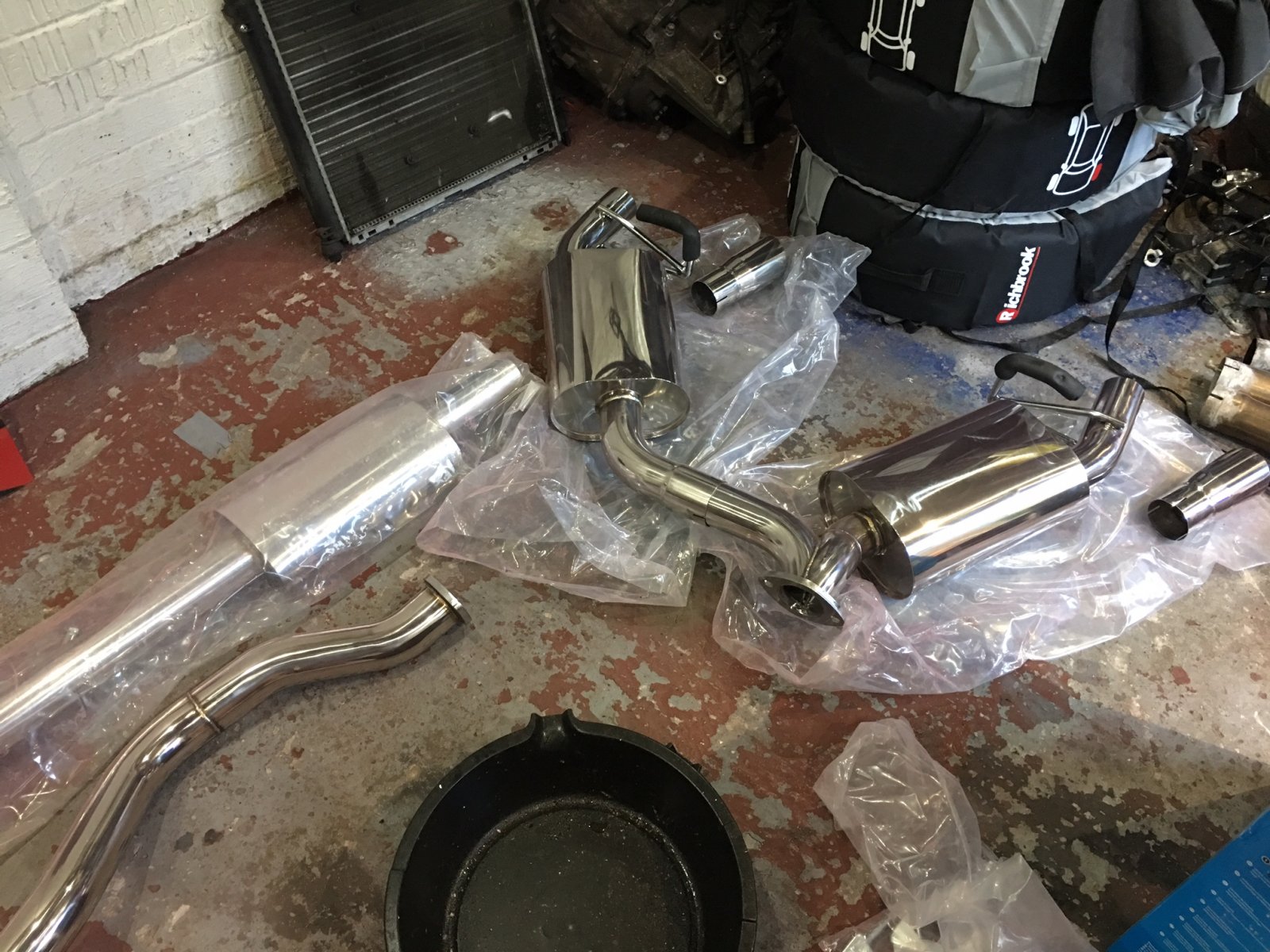

The car's not loud enough either at the mo so stainless steel exhaust procured, get it fitted next weekend

V5 turned up today so with any luck I can get rid of the shell by the weekend and get cracking on the 197
Also trying to find a turbo from a RS250 but struggling to locate one...
Need to remove the driveshafts and then its ready to come out and go to its new home. Had to use a 6ft extension on the breaker bar to get one hub nut undone, other than that pretty straight forward. Seems a whole load more substantial than the 172 ie heavier. More power will be required :up:

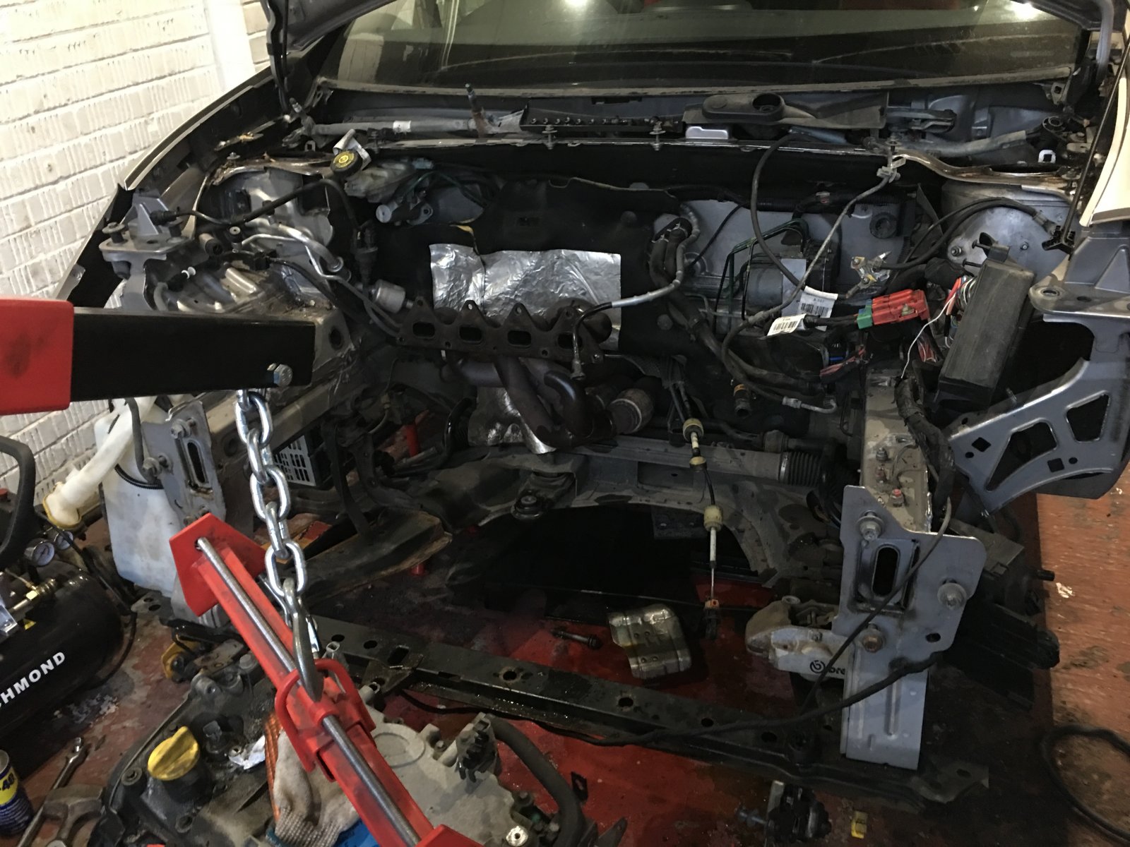

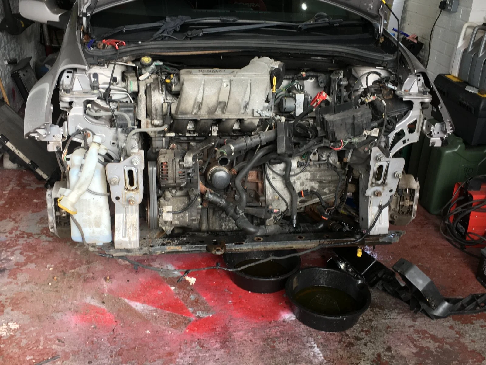

So last night I got on with removing the driveshafts, well failed to get on with is more like it. All the various bolts holding the ball joints together on the anti-rotation links, drop links and connecting the bottom of the swivel hub to the control arm are rusted solid and just spinning when using my impact gun so I'm going to have to resort to cutting them off and replacing :rage:

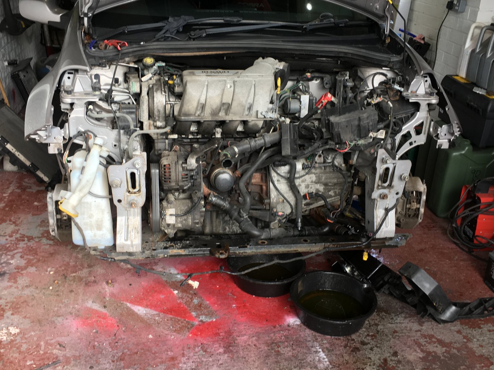

Well the engines finally out for collection tomorrow.

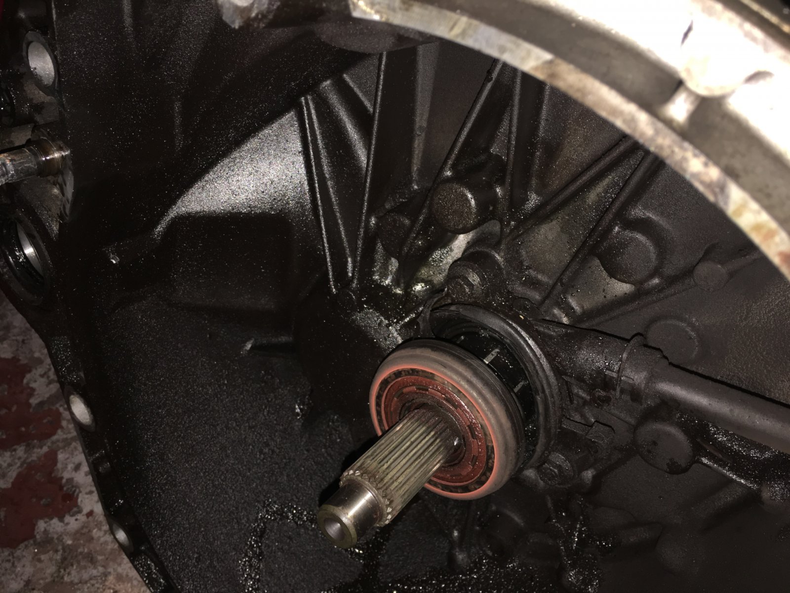

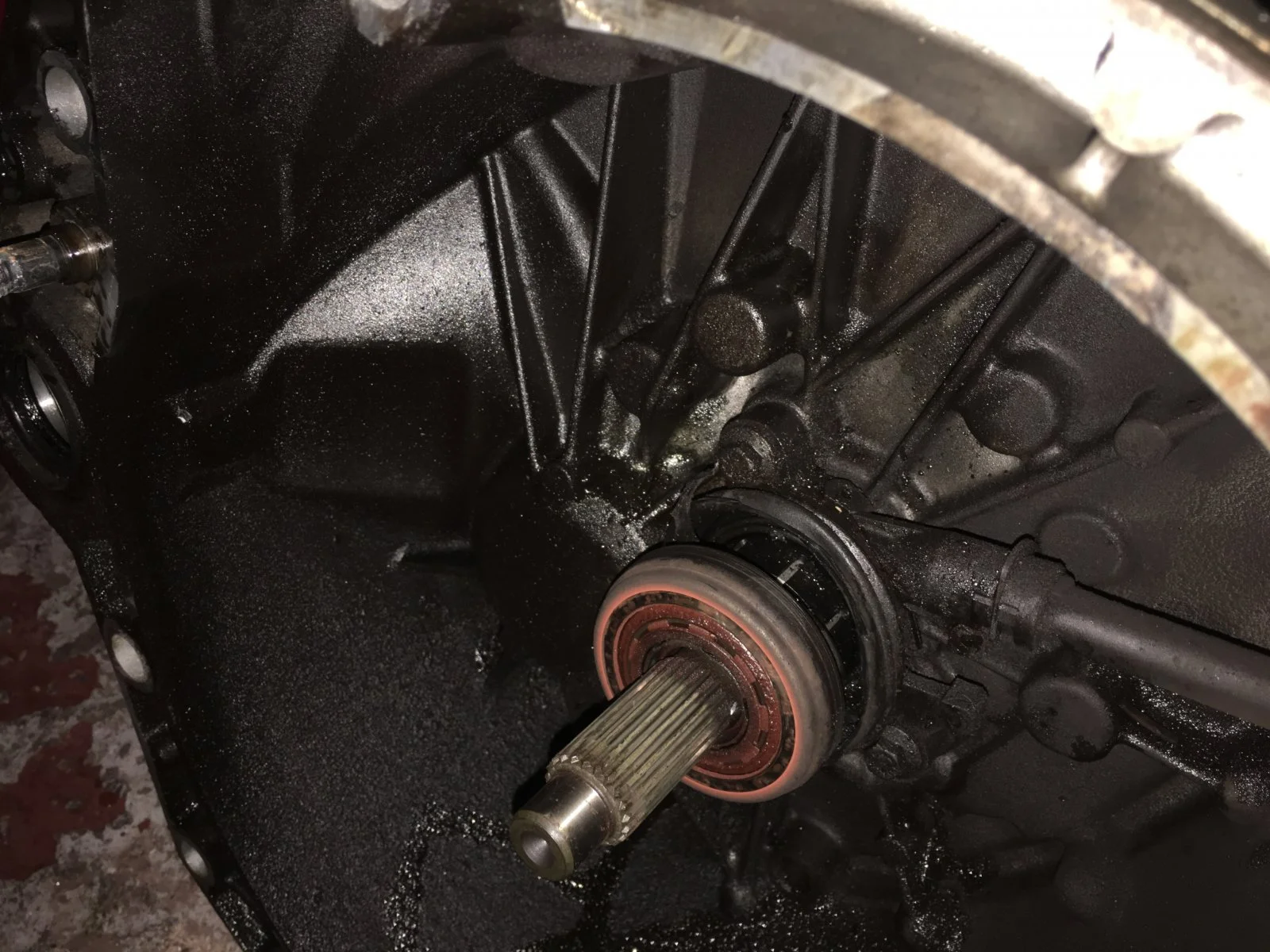

Got the gearbox off and found this
Be needing a new slave cylinder then. Also had to split the passenger side driveshaft as the end appears to be stuck in the gearbox and couldn't get enough leverage on it in situ to get it out. Car's fought back every step of the way so far 🔨:spanner:
