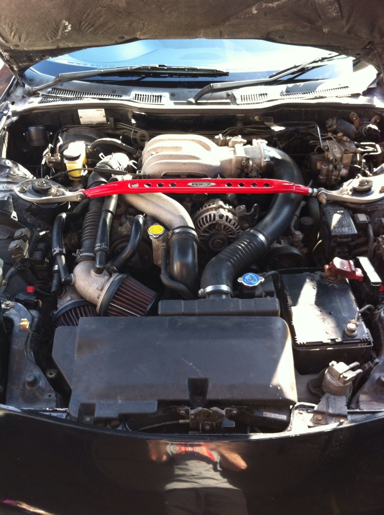

I also sorted out a stock strut brace, so fitted that this morning.

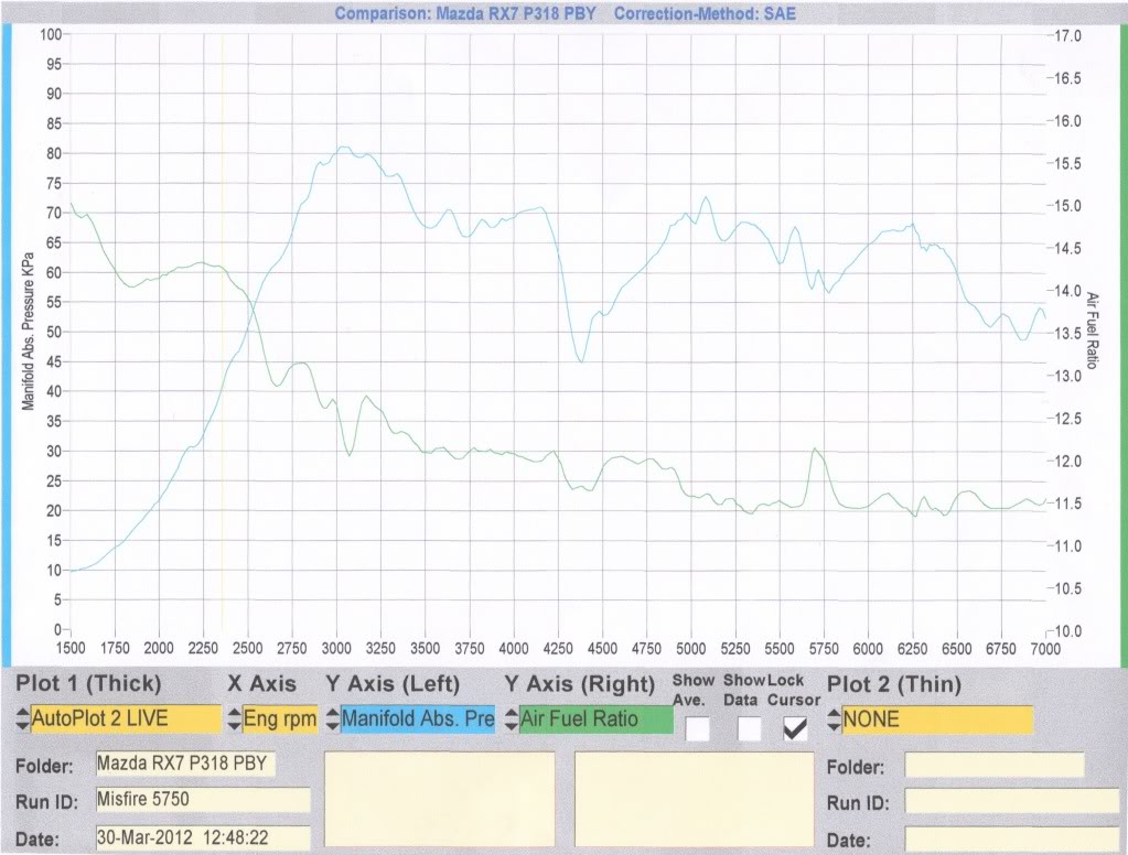

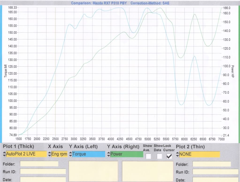

Then I drove over to AET Motorsport in Normanton where a good mate works, and we got it on their hub dyno to see what the crack is. The crack is this...
Misfiring from around 5750rpm, that'll probably be why the Apexi Power FC went off it's tits around 6k. It's blowing out the spark on boost, so plugs, leads or coils. Fun times.

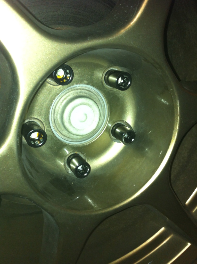

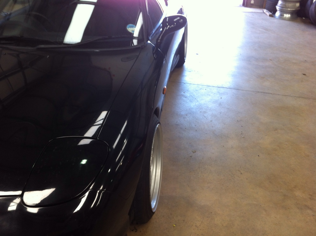

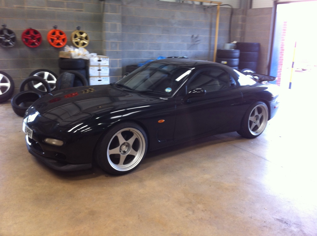

To cheer myself up I went over to Leeds and fitted my Regas. 18x9.5 ET18 all round. I'd lower it more as it needs it, but it turns out the front suspension is actually some "Potenza" shocks and springs, it's just the rears that are Tein coilovers. So that was that idea shagged, and also goes some way to explaining the bad ride.
Rears still need spacing out, 15mm should suffice.
Feels a bit better on the brakes and to drive now with properly balanced wheels and tyres that are somewhat more compliant than the Jap market stuff that were on it. Brakes are still shagged and it still wants a good alignment/ball joints or tie rod ends changing. And it needs the misfire sorting. Oh and the horn, rear fog, speakers, aerial, polishing, coilovers, misfire etc. Bloody cars.
