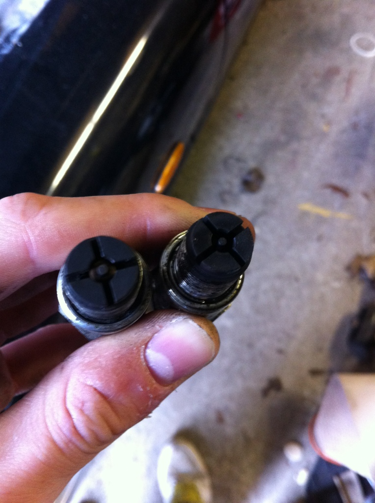

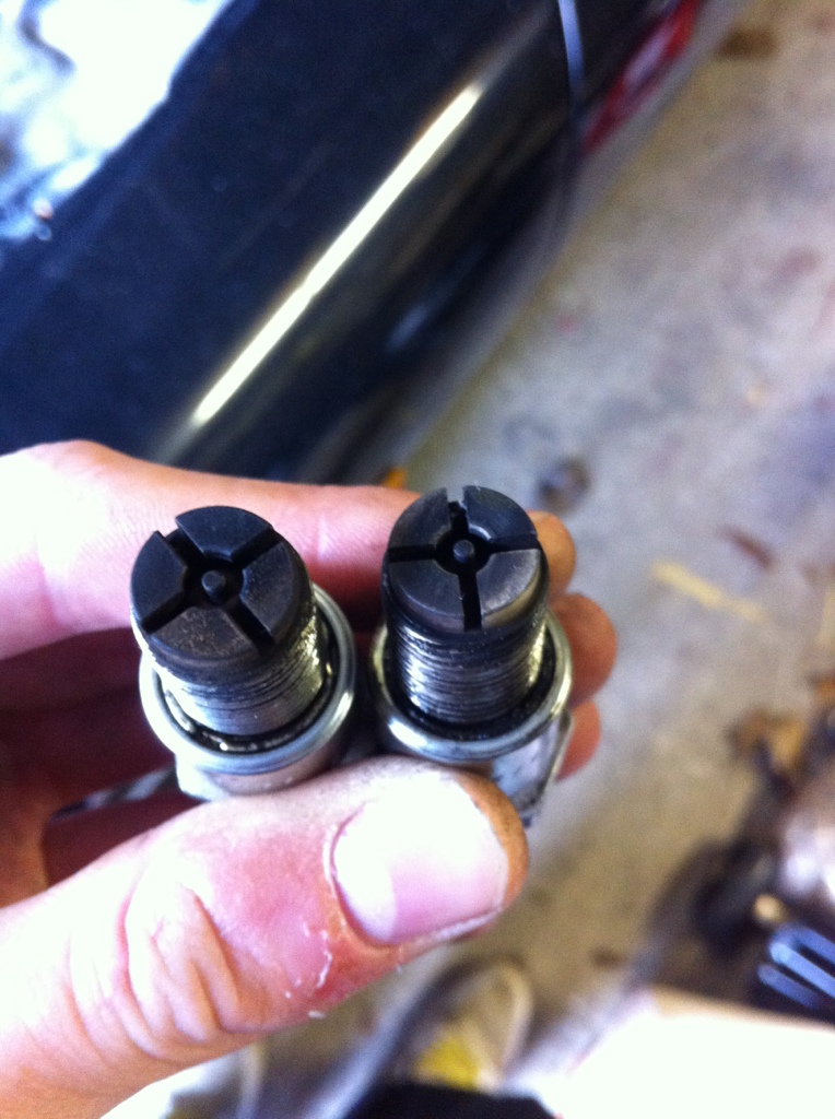

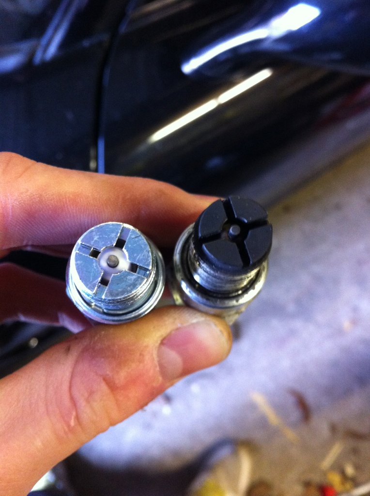

Now I'm back on nights, I have afternoons to kill. Decided I'd replace the plugs seeing as the new ones were now in my possession.
Whipped the Nology HT leads off, some of them were rusty, and one had a split boot! They won't be helping matters then. Then toyed with which way to get the plugs out, had been told to get underneath but managed it from above, saved the ball ache of getting the jack under the car anyway.
New vs Old, the gaps are the same (I measured this, I didn't just rough it by eye)...
Rotor 1, showing a bit of a brownish tint...
Rotor 2, just carbon...
Those haven't been changed for a while. Also discovered my battery has gone well and truly flat as my charger won't even register it's existance. That didn't even manage 2 weeks :rolleyes:. The alarm must be drawing some current.

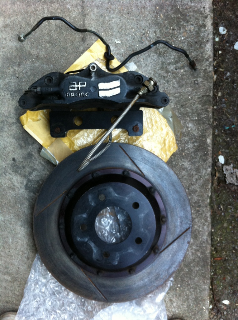

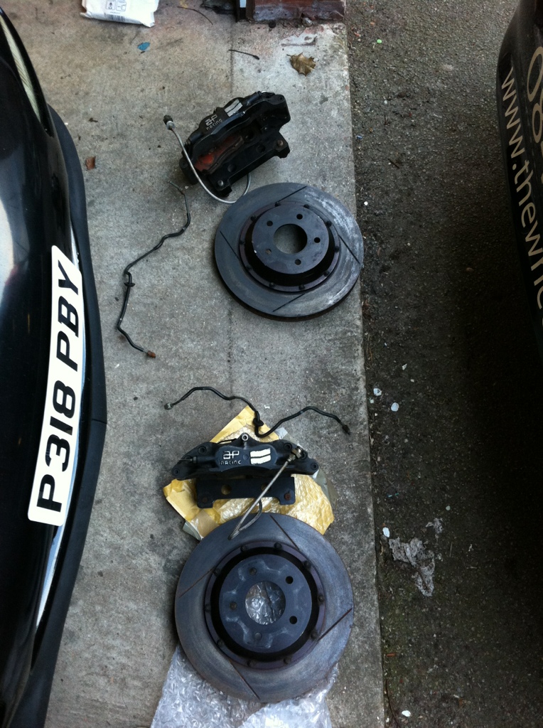

Oh, I bought some big front brakes too, they'll get fitted when I have accumulated some other pieces such as a Master Cylinder, braided lines, and the gear to remove the ABS...
Weird flat-headed spark plugs. lol. Just bung some normal ones in. Should be fine. ;)
AP's look awesome. What are they from?
They're the factory recommended plugs mate. The problem is normal plugs can protrude too far into the chamber and the rotor will hit them.
The APs were from a lad on FDUK, who bought them from somebody else in the USA. All I know is they were a setup made by a company called M2 over there. There's a few people on RX7Club using them, which I guess is where they were all sold. I believe they're an AP Racing 5200 caliper, then these blokes made the carriers and the bells/rotors. I'll have to get rotors made up once they die probably, from the threads I've looked at everybody is getting replacement rotors made rather then them being an off the shelf item.
U can't adjust the gaps on them plugs anyway lol, u gone 9's all round? Plugs look ok to me anyway lol.
Oh and 10's and 11's look like normal plugs...
I would of gone 9's all round mate, would of made more sense and might of been the 7's blowing out up the range that is giving u Ignition issues...
Have u done the direct 12v feed to the coils? And the fuel pump?? Also I wanna see the other rims on it... Not the regas lol
Well I've not read anything to that effect, so I just stuck with what the factory recommends. After all, it should be a stock engine so it shouldn't be blowing the spark out with those. We'll see what happens.

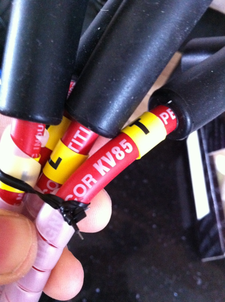

So my leads turned up today...
But, they're not 10mm R100 leads. They're 8.5mm KV85 leads :rolleyes:
So no progress can be made there. Not very impressed anyway as they were meant to be sent out on Friday, when they were in fact sent out yesterday. Now I have to wait for tomorrow, when the guy who boxed my order is in. Quality.
