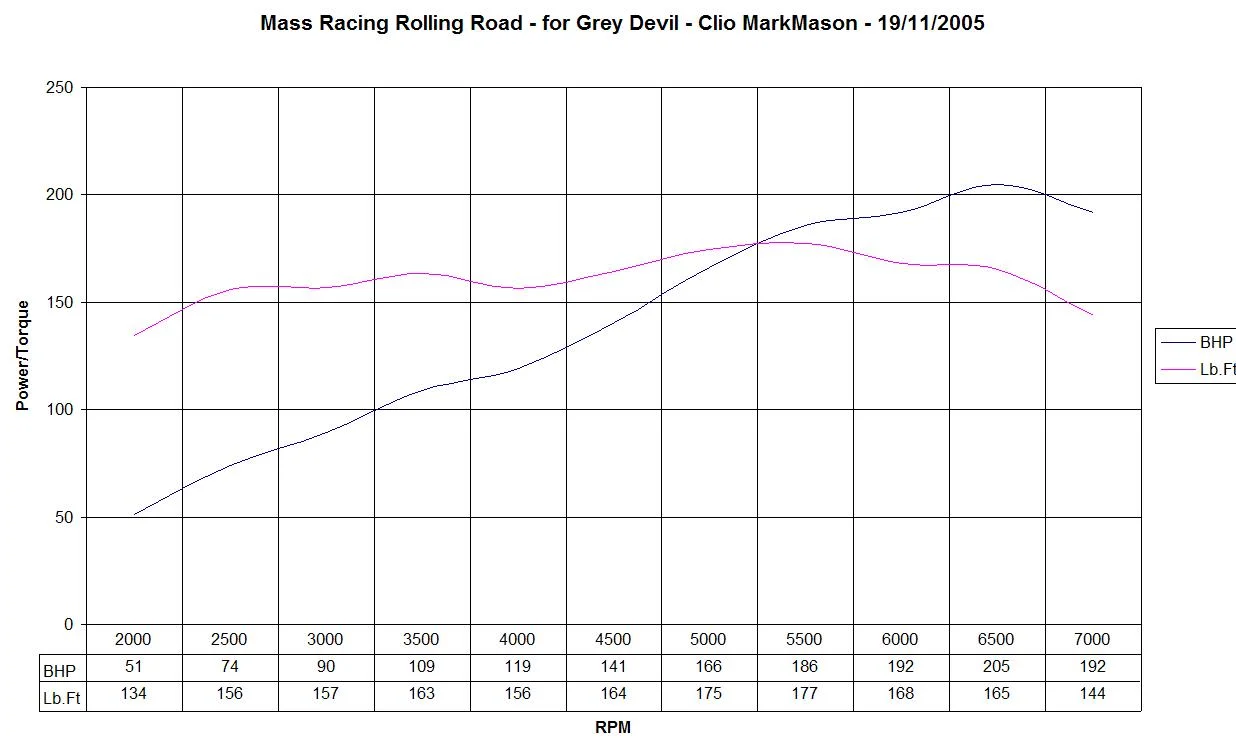

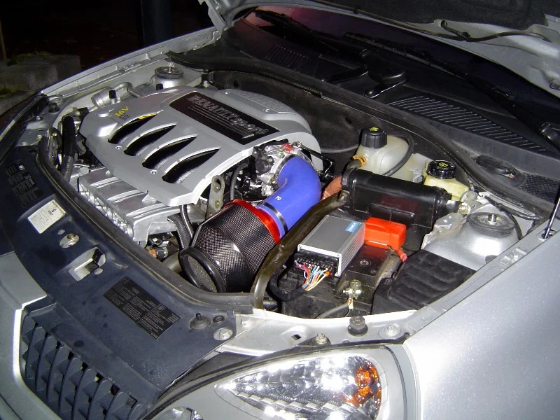

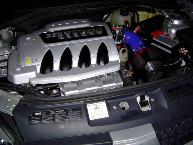

The car has been at GDI for 2 weeks, a bit longer then originally planned. Picked the car up today and am very pleased. Under the bonnet is spotless (see pics) and every thing is very neat and tidy. Not that bothered personally how it looks but it gives the impression that Andy takes alot of pride in his work and has put alot of effort in.
The car is quick standard but know it is different again. There is no 5000 kick the car just accellerates hard from 3000rpm to the limiter. It is stronger at the top end but now due to the torque the car feels much better mid range. It sounds sweet on full throttle know aswell maybe due to the viper?
The cable throttle makes a surprising difference, throttle respone is instantaneous.
Small issues are the engine judder off the throttle below 3000rpm. Nothing major though and nothing a bit more time mapping wouldnt sort out..
Overall very impressed with the car and GDI, will no doubt be visiting them again when I have saved up some more cash. Also mention AWT, Bens new cams have done the buisness

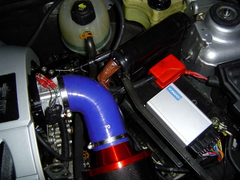

nice, the only thing that lets that install down is the placement of the ECU, but i'm a bit picky about that!!! lol
top result as ever
Like that idea !!! ... Andy, get the loom extension cable out ;)
Fred2001Dynamic said:
mine's going in the glovebox! i'm not having a £1K bit of kit dangling in my engine bay!
