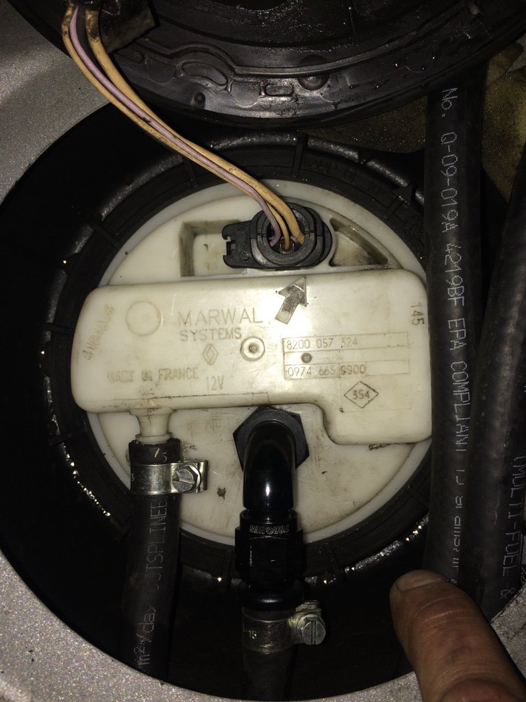

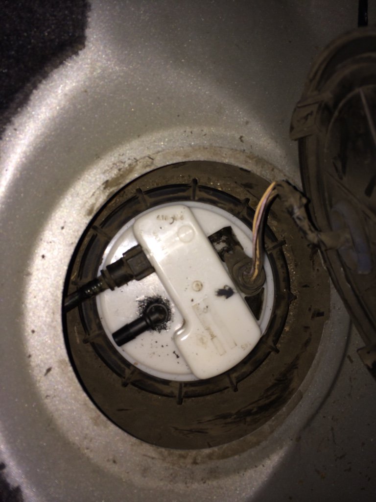

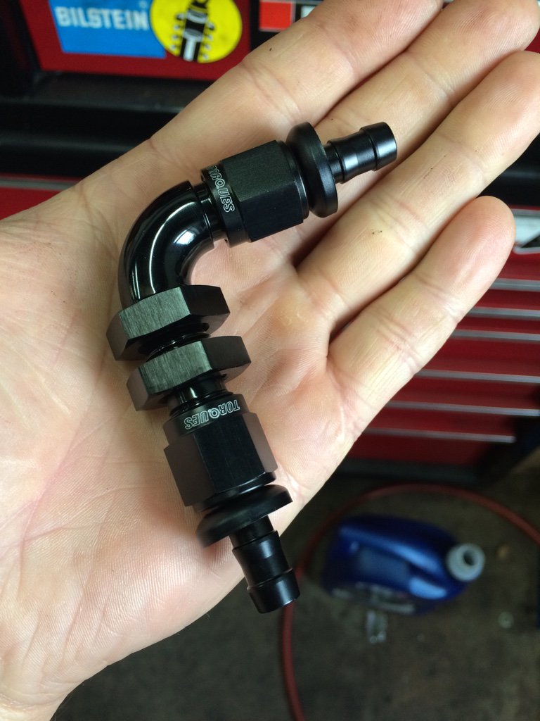

Very small update on fuel system, had a bit of a weeping return pipe where I had to bond a pipe connector on, fuel eats anything!!
Noticed a small smell of petrol so sorted straight away with a nice AN6 bulkhead 90 degree elbow and some 8mm barb connections.... Great success!!

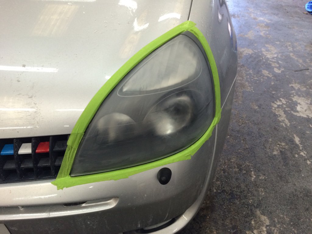

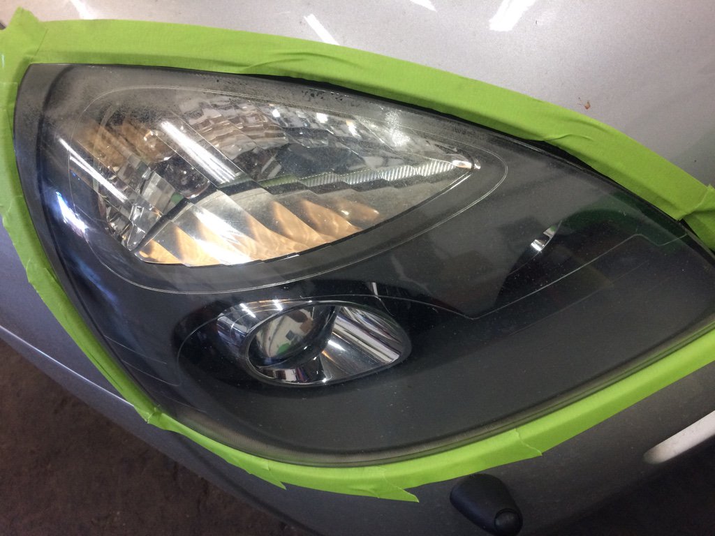

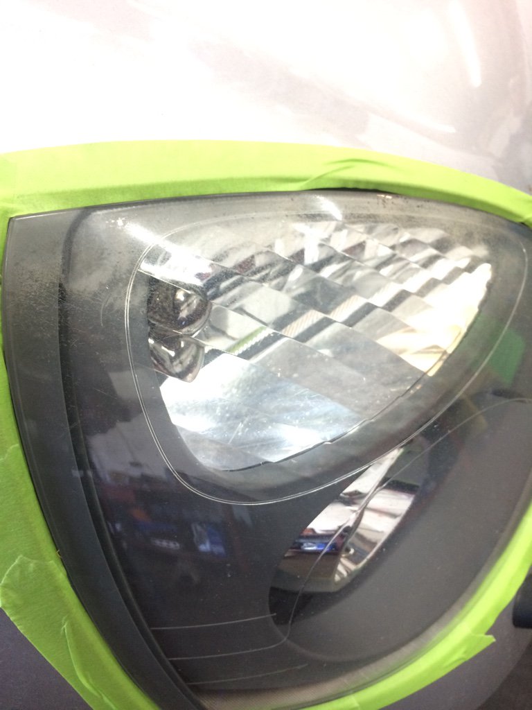

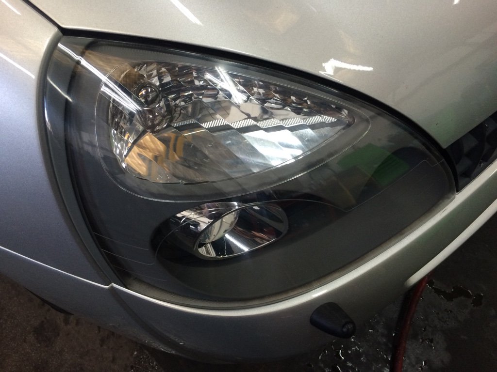

Front lights are looking a bit shite so gave one a trial go at lunch time with a kit from @Chi
Before....
After.....
Pretty chuffed, only took 30mins.... The other side will probably come up better now I have the technique down!! I'll prob go over this side again if it needs it :) top tip use loads of water, they dry quick in this weather!!

As said, the one you've done looks loads better, need to do this on my Bean as one is about 100 times worse than the other.
What kit did you use?

I tried that kit. I couldnt get a good result. I bet its my drill being too slow, It was about to die.
Will borrow a faster drill and try again.

No, I could just use 500, 800 then 3000 from our Bodyshop but just used the discs with plenty of water, worked really well, I have a fairly high speed air drill which helped A lot too, I think the main advantage of this kit is its nice and compact so you concentrate on small portions at a time rather than loosing where you are with a DA sander or similar bulky tools.... Plus it's all ready to use!

WIll have to redo this then. I should be able to borrow a mains drill so wont have to worry about battery.

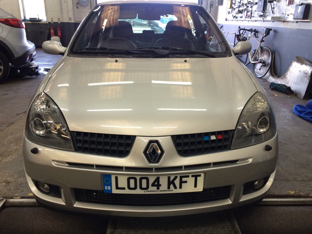

Did the other side today, looks good...
Will say though, my lights weren't as bad as some I have seen and buy the second light the single 3000 disc was getting a bit tired, had to work a lot harder to get it back to perfect, they aren't 100% but 100% better than they were and really improve the front end... Good results! :)

They look great and I know what you mean about not being perfect. I spent ages doing my lights wet sanding like crazy - working my way through the different grades and even machine polished them after that too. But they werent completely immaculate, few small stone dents and some patchy areas around one edge. planning on doing them again this summer.

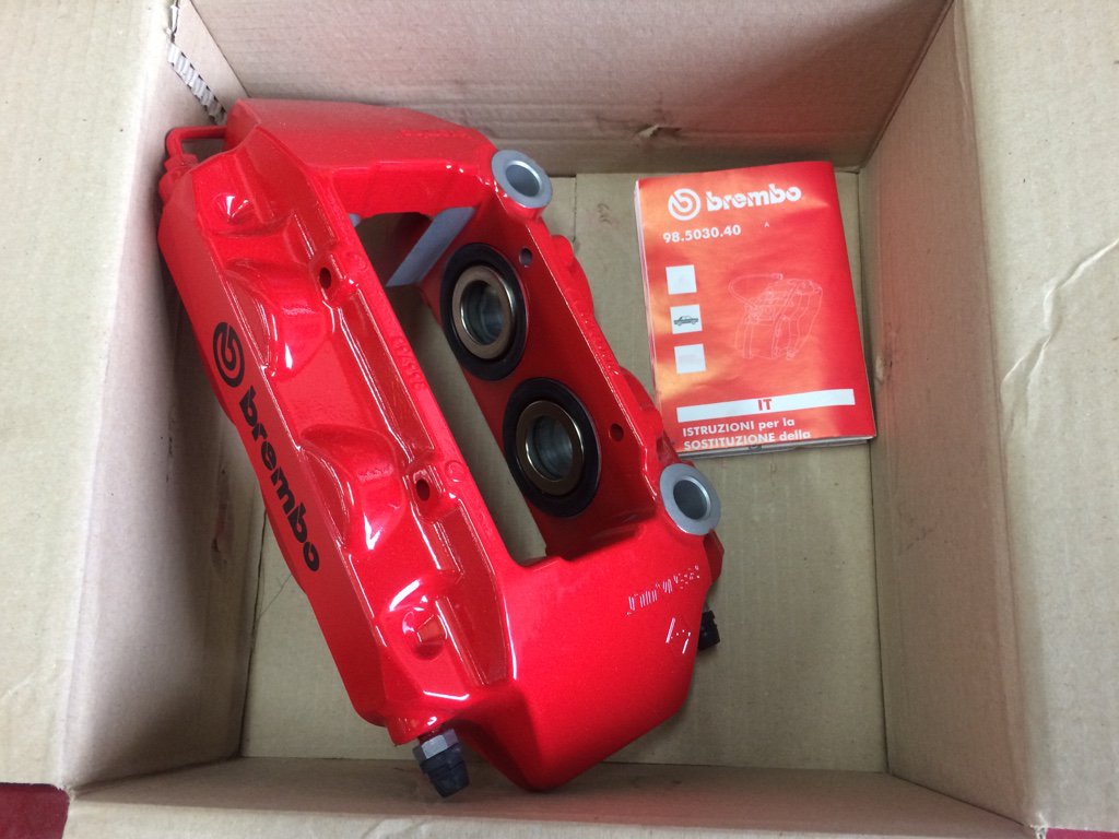

Got myself a new set of Brembos! [emoji3][emoji3][emoji3] got some 300mm discs on the way that I will get the R26r pattern machined into, going to order brake lines from French people and need to either get some brackets machined up or just bite the bullet and order some PMS ones, will post more when I get more
