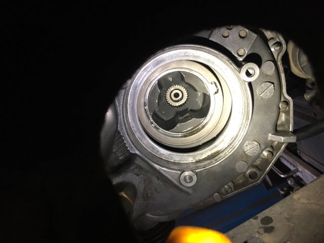

was this the onde that required maching to the casing or has that problem been fixed?
very interested in this diff.
Hi mate, didn't see this... It was a case of very lightly shaving the smallest amount of the rough casting of the inside of the case with a die grinder, probably an area the size of a 1p

So found out with help from @NorthloopCup that a shorter ph1 172 shaft is required to work with my diff, 182 n/s shaft is too long and Judders when cornering hard and going quick into roundabouts.... Just thought I'd post incase anyone is considering one.. Apparently gripper diffs had the same problem [emoji106][emoji106][emoji106]
Fitted the shaft today and it's spot on!!
Yeah gripper is the same, only notice it on right handers.

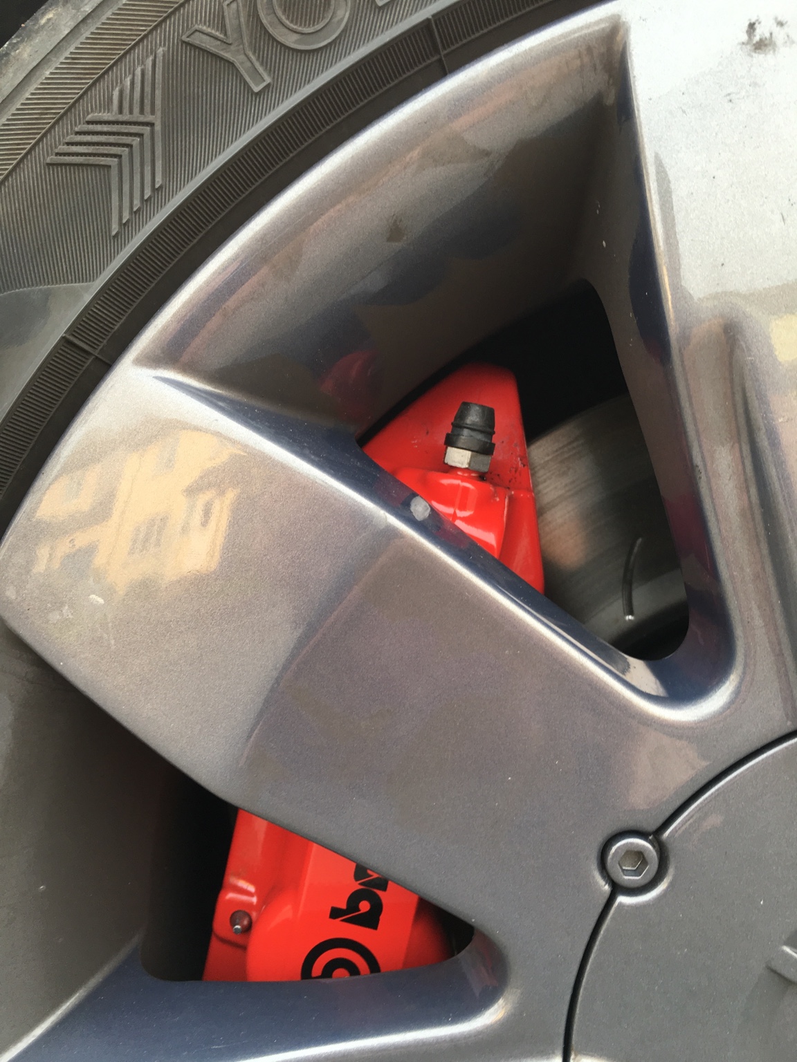

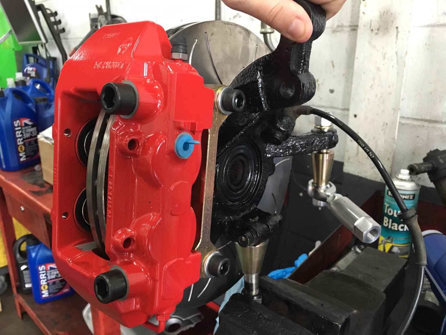

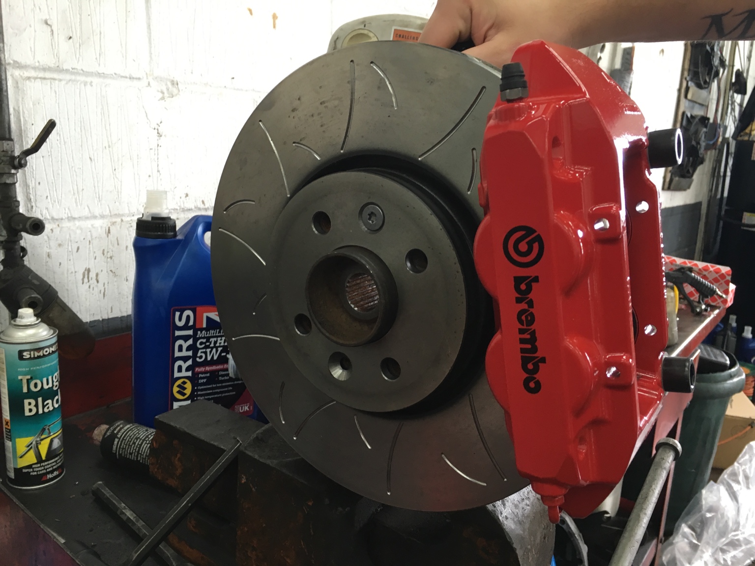

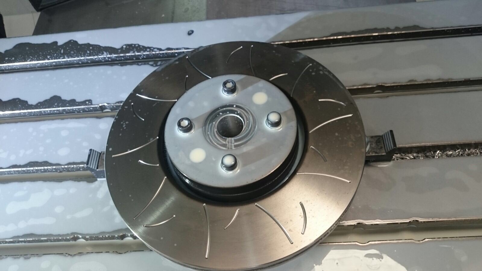

Brakes and roll center kit on... Need to fit tyres and get the pissed geometry set up!!
Little bit annoyed that the pads don't contact the full disc surface, about half inch of unused disc on the inner part, anyone know of a bigger pad or is this not an option??
incy-spider
Thinking of putting this up for sale, just about to turn 60k miles..... really want a Clio 200 and have seen the one I want. Just don't know if I can do it, also putting a price on this is a challenge!! Thoughts??
cs_dave
West Midlands
Useless on 300mm discs as like you say there no more disc contact.

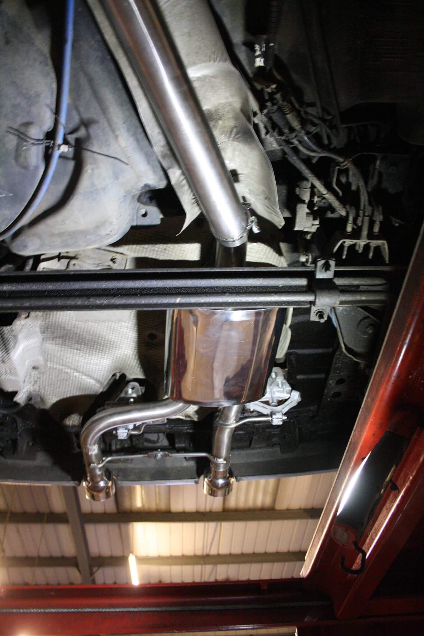

Booked into Phoenix performance exhausts in Cullompton for a custom exhaust soon, popping up to see Chris@efi for a possible tweak on the map to suit if needed on the 29th of April too. Need new track rubber, new 300mm discs, front track pads, rear discs and track pads.
