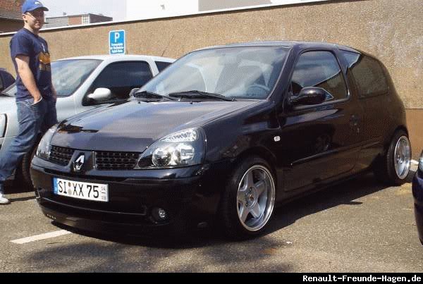

different wheel ^^ but similar and looks the dogs tbh revolutions i think
  AMV8, Mk1 Golf
KT1s dont really fit the 172s, even if you have standard offset, youll need spacers becayse of the design of the back of the wheel it catches on the hub
the look mint tho imo
  A Euro'd one...

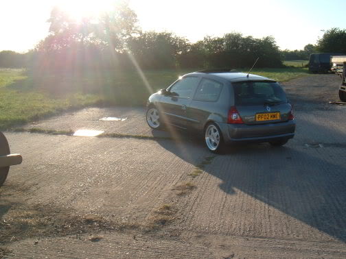

The car is still in the garage but pics will be up soon. Im running 195 45 16s on the front and 205 45 16s on the rear but im going to change them for lower profiles in the next week or so. The car is lowered 60mm but its nowhere near low enough but that will be taken care of soon. As far as Im aware its the first Clio Mk2 in the UK to be running 9s. ;)
  172 ff silver
cool as fcuk mate
whats the offset there buddy ?
im thinking of schmidt modern lines in 16" now
  A Euro'd one...
Offest is ET15 so Ive had to do some major archwork to get them on. I like the Schmidt modern lines, they look so good on a Clio.
