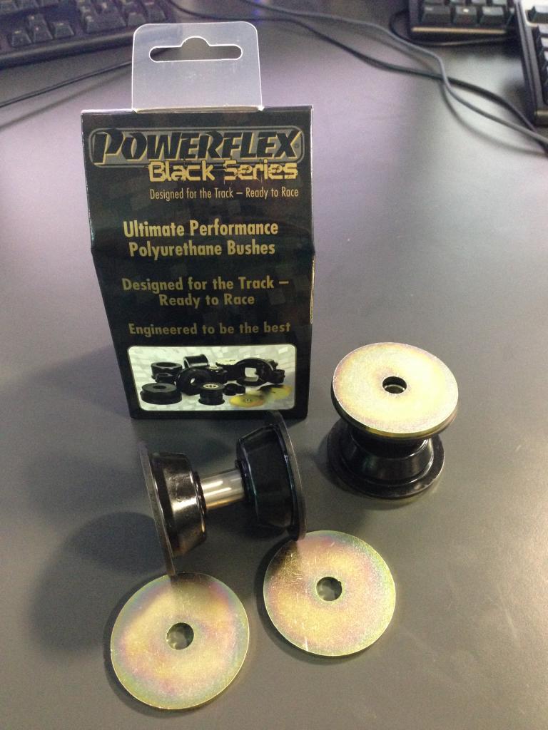

I bought these to replace the worn standard Renault ones
Got them fitted as soon as possible

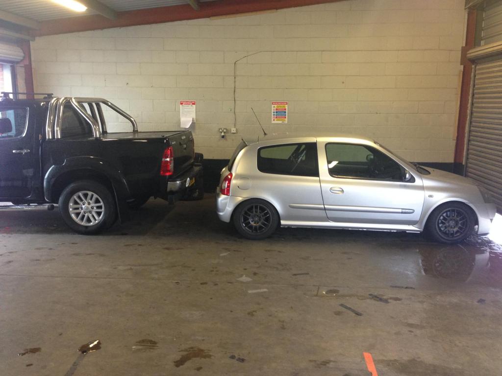

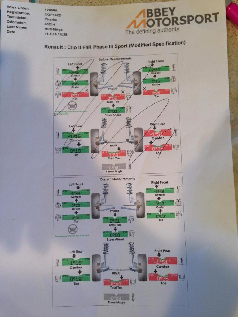

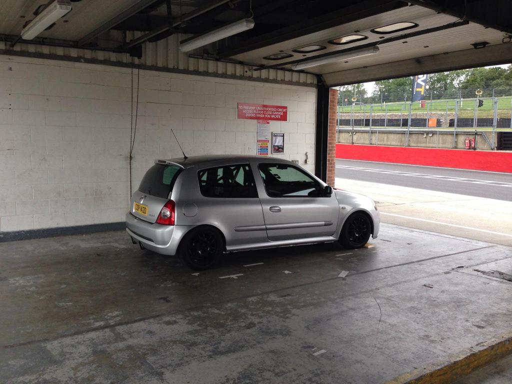

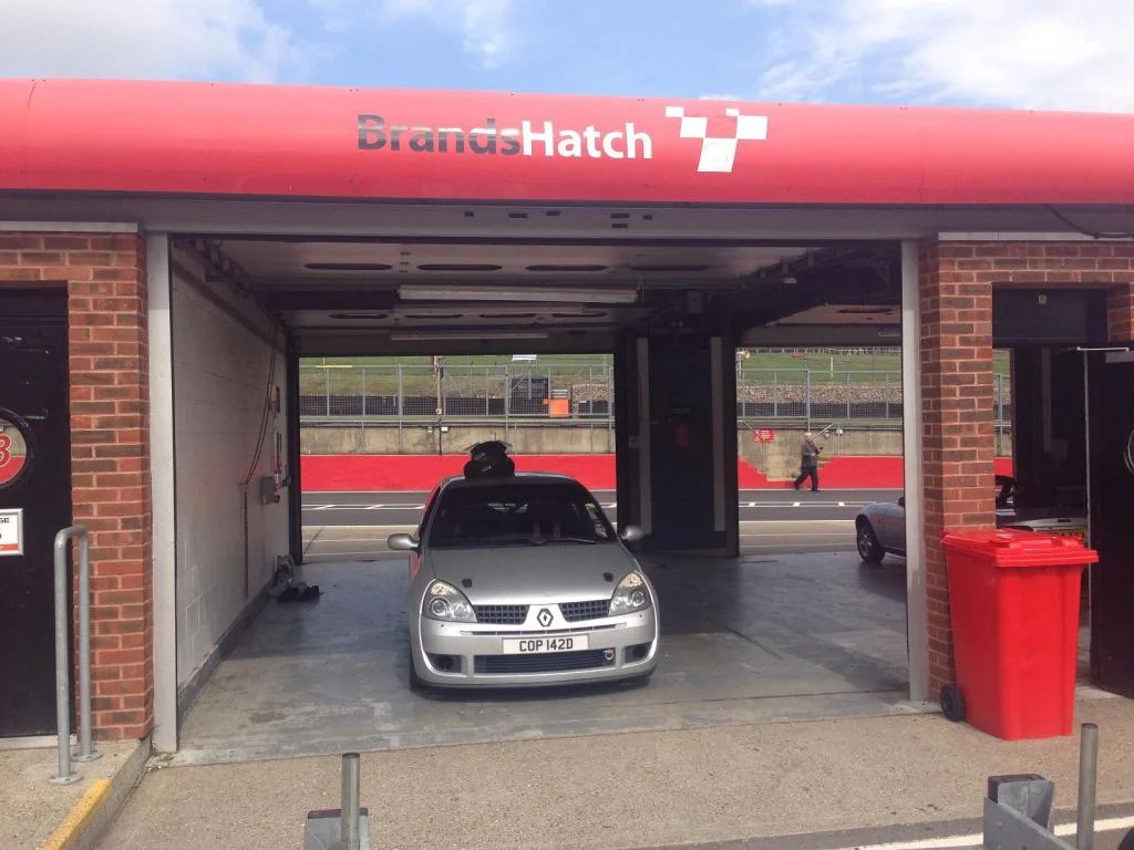

That was everything done. So I put the wheels back on, booked a track day at Brands and took it to Abbey Motorsport the day before for a GEO setup
I'm planning on buying a few shims for the rear, to even out the readings a bit, but nothing has been done since.

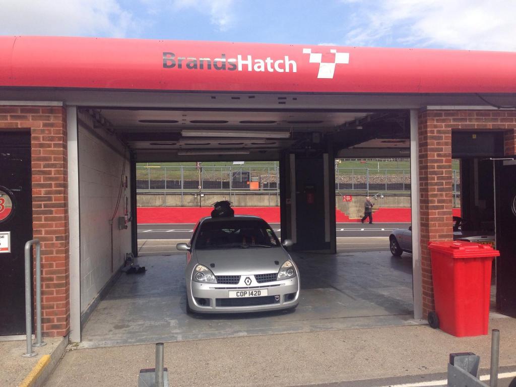

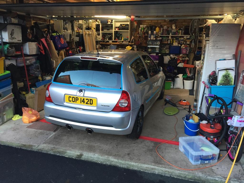

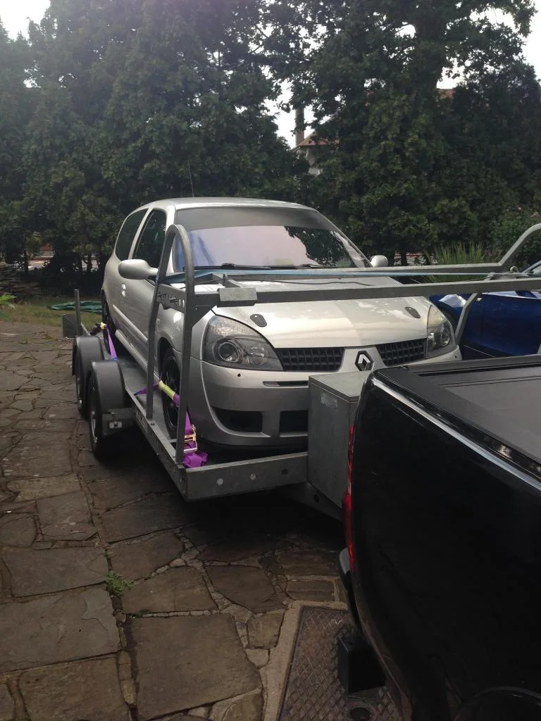

I loaded it up onto the trailer that evening ready for Brands the following day
Standard pit garage picture, looking purposeful

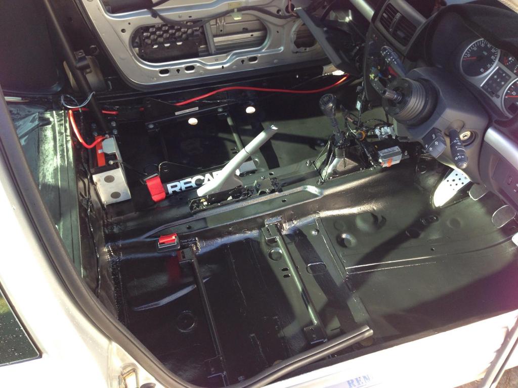

My Recaro seats didn't sit as low as the previous Renault Sport ones did, and I wasn't 100% happy with the position. So I had some plans to improve it and set about making this happen by buying these.
I sent the car off for these to be welded in place and it came back looking like this

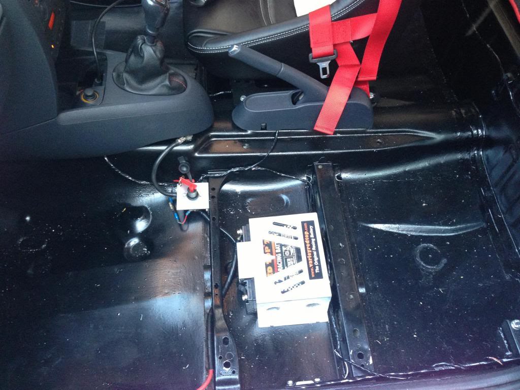

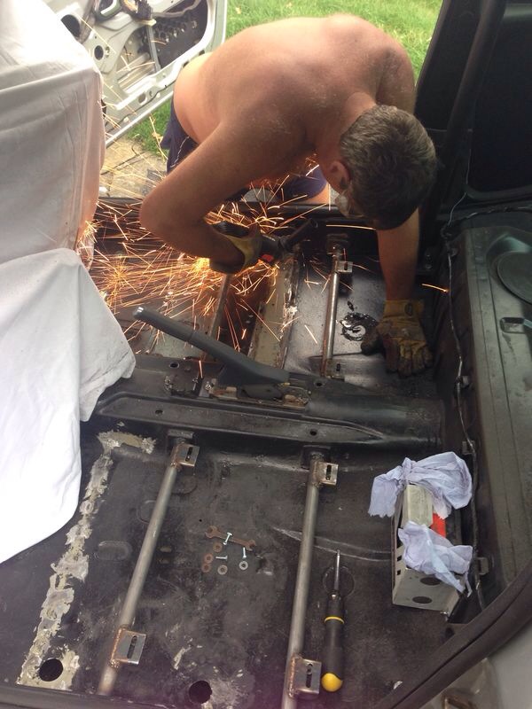

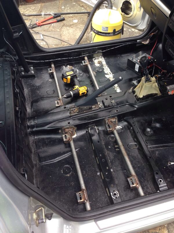

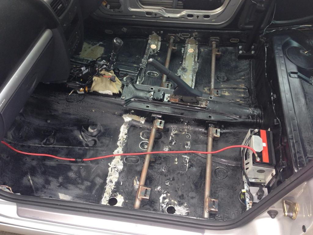

So I made a start at removing the old seat rails, with a lot of help from the old man. He likes the angle grinder!

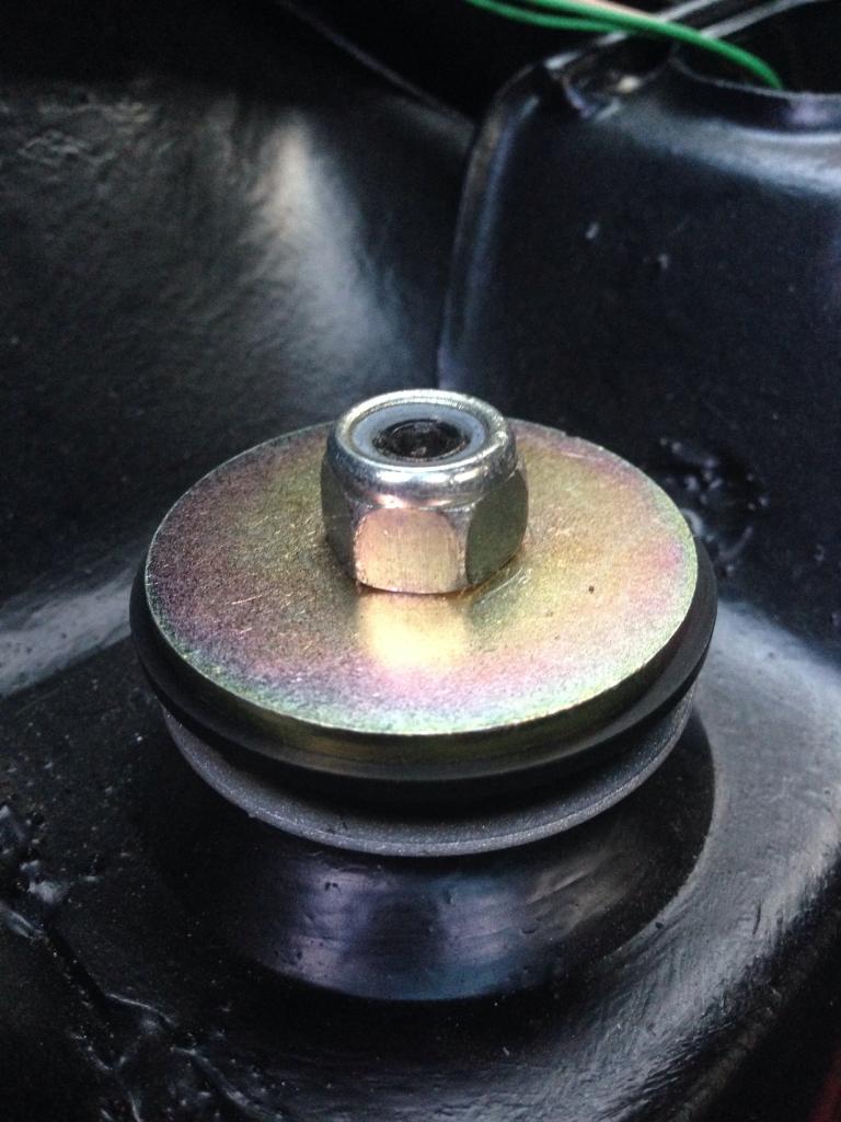

I also moved the battery into it's new position as there wouldn't be room for it under the seat anymore
The standard seat rails were finally out, so I temporarily moved my cut off switch next to the battery and wired it up
Gave it all a lick of satin black paint to tidy things up a bit

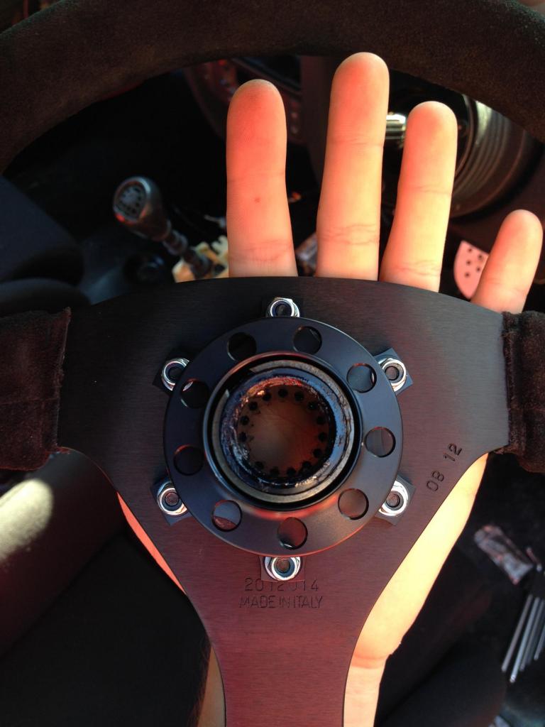

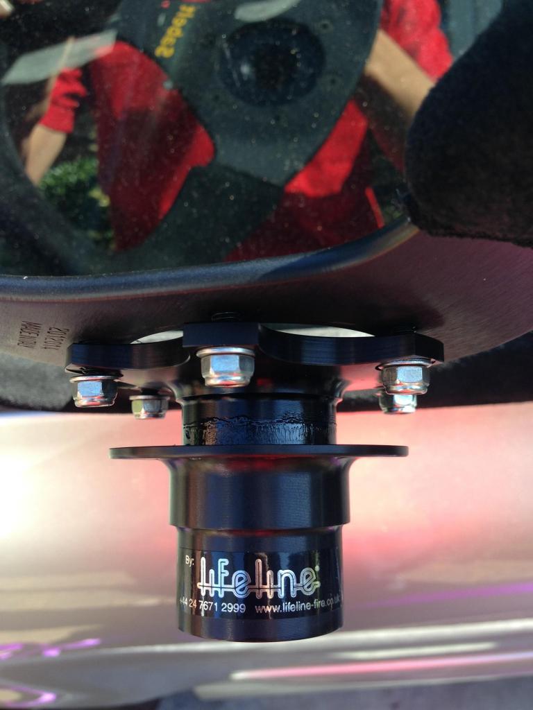

Fitted my new Lifeline snap off boss to bring the wheel back with the seats. It wasn't cheap but it's a lovely bit of kit and will help with security when the car is parked up

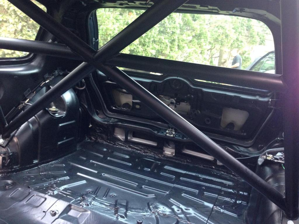

Not much happened for a few weeks as the weather was shocking, but when it dried up I nipped back out to give the inside of the car another lick of paint.
All the sound deadening patches are gone now from within the car, apart from the one shown on the floor, which I'm leaving be because I don't want to rub down or paint anymore.

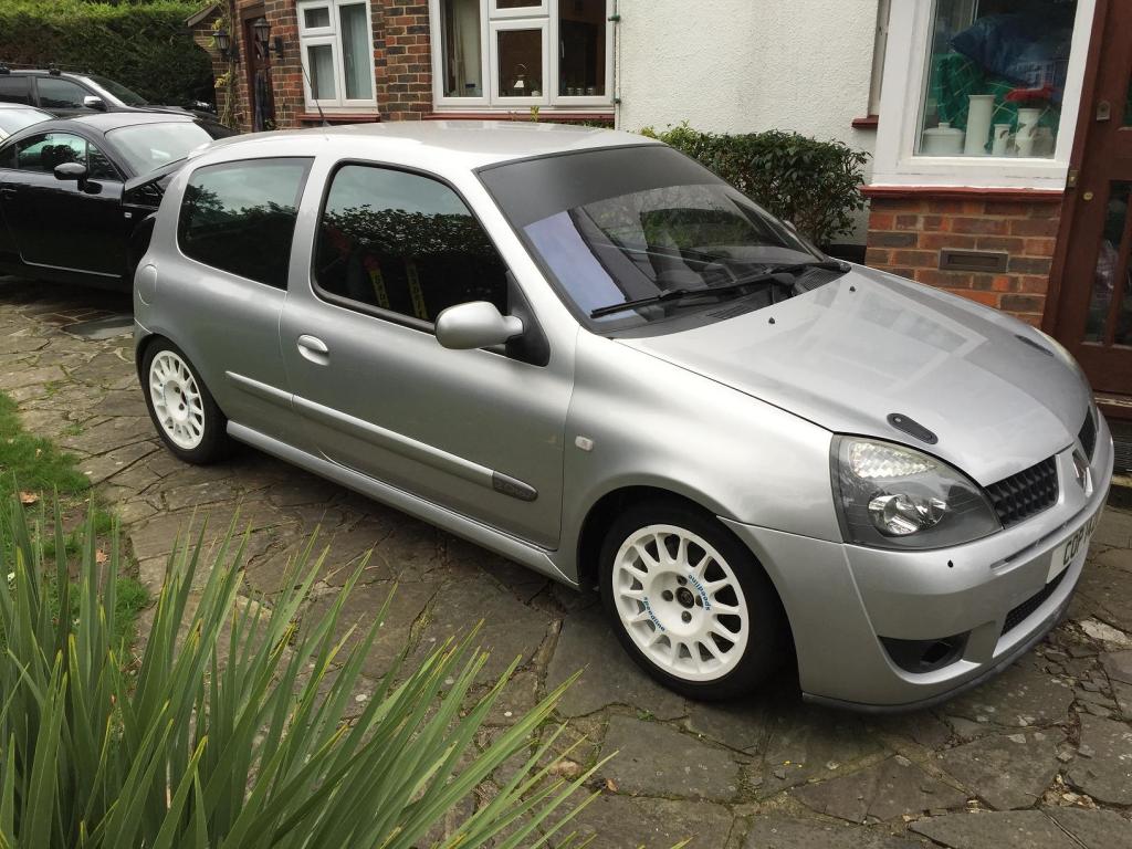

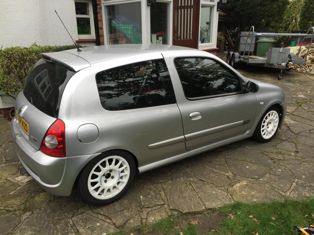

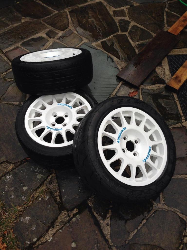

Shortly after I picked these wheels up and trial fitted them. It was now my fourth set of wheels 😂
I was surprised how good white wheels look on a silver car. It almost looks like a cup racer

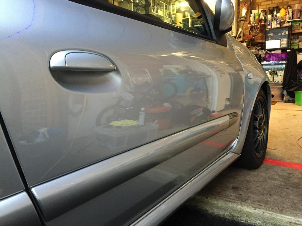

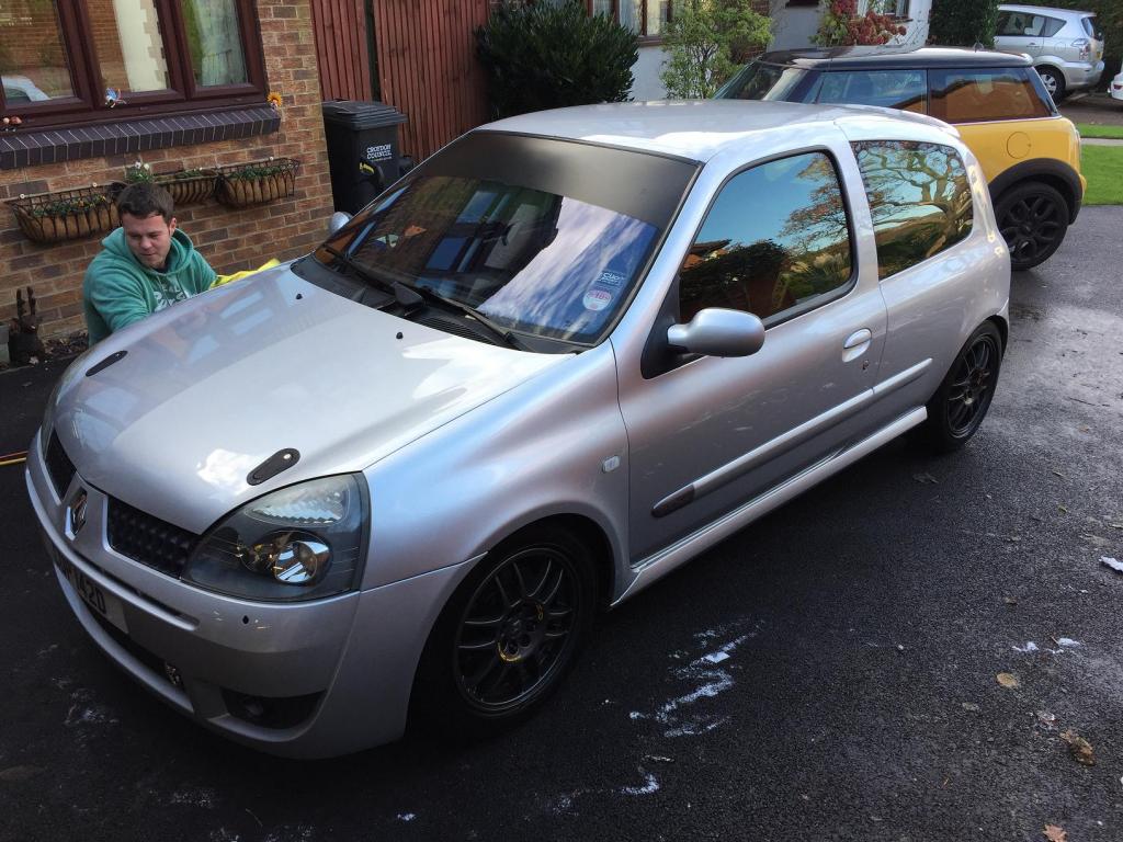

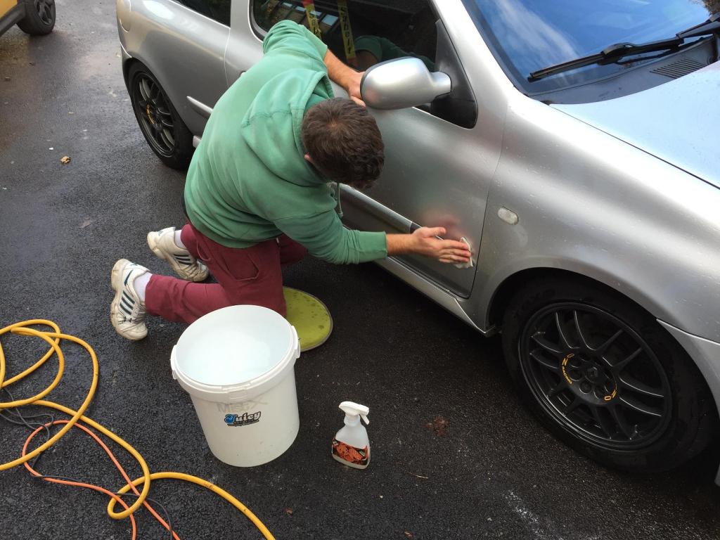

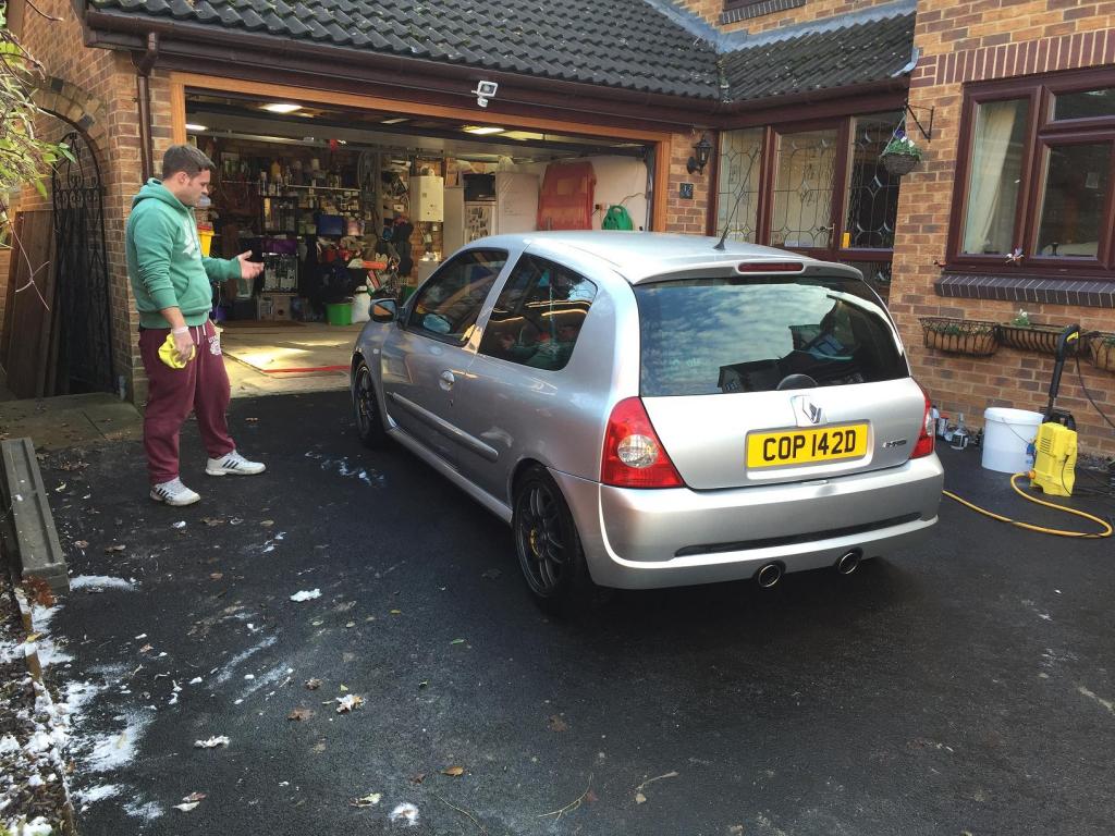

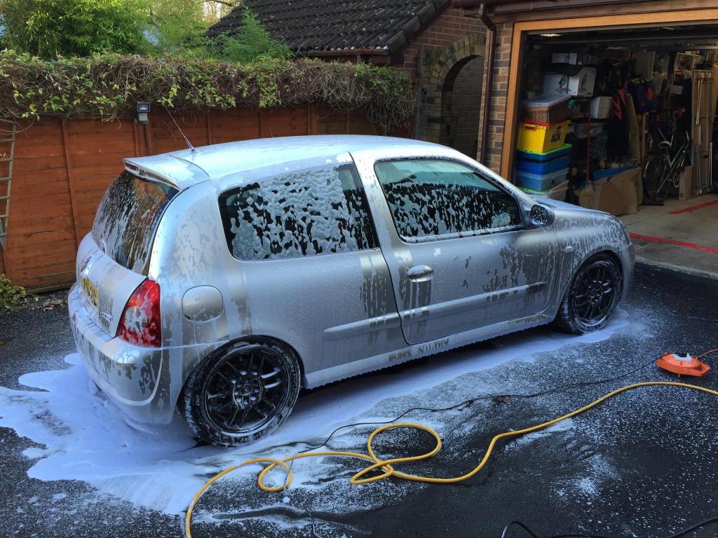

Anyway, when the weather allowed, good old Kyle came down to give the car a detail. The car looked clean enough as silver cars always do, but he couldn't believe the state of some of the panels.
Big thanks to Kyle for coming down to Surrey to do this for me. It looked immaculate after he had spent the entire day on it!!

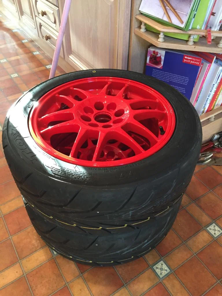

Got my third set of OZ F1s back from the powder coaters and stuck some new R888s on them. These were to be my new lairy track wheels
New vs old

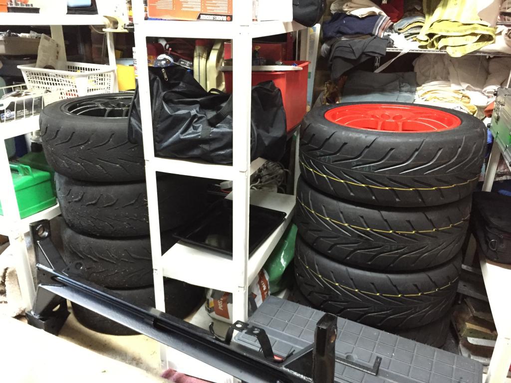

Then I did something silly and bought two more sets of wheels. By this point I realised I had a serious problem and for a short period I owned 25 wheels for this car :fearscream::fearscream:
So I decided to sell two sets on. My original track wheels, the black F1s and my wet wheels, the anthracite F1s. Leaving me with the red F1s, the white 2118s and the two new sets of Team Dynamic Pro Race 1.2s, one set in black one set in white.

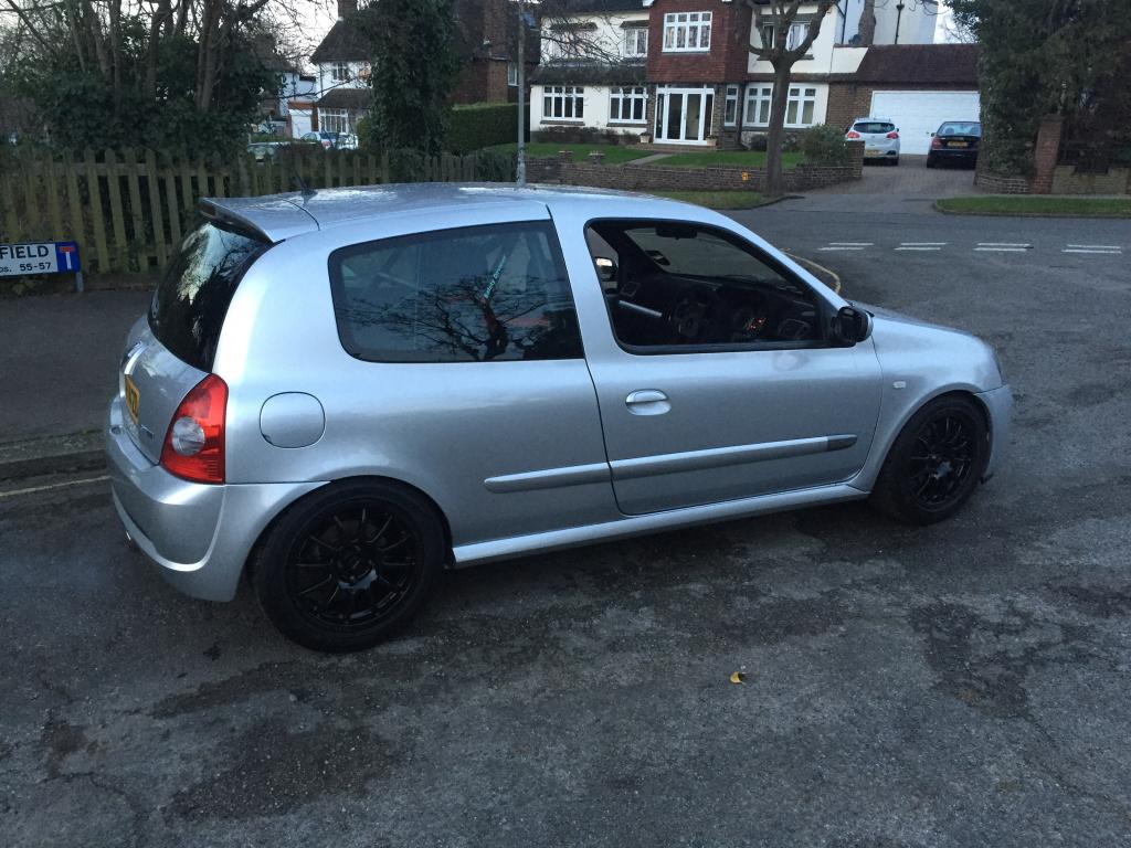

I got my wet tyres, the Toyo R1Rs swapped over onto the black 1.2s and got them fitted.

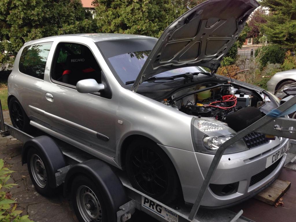

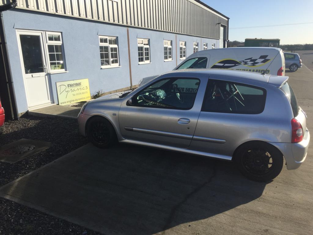

Crap iPhone pictures, but that's how the car stands now and nothing has changed since. I'll be taking it to Engine Dynamics tomorrow morning though so watch this space :cool:
I also refitted the horns wrong and destroyed one on this test run. But @Kelv has kindly agreed to let me borrow his so I can work out how to reassemble it correctly. I'm hoping that it will still work with just one horn, but yet to try it out.

I'm not sure how to answer you about the height of the ASTs as there isn't a set height, they were adjusted by Abbey Motorsport until they were happy with how it was sitting as a whole. At some point I do intend on measuring each arch to the ground though so I have a reference point to compare to.

Reference your AST's. Next time it needs a geo is it worth getting it corner weighted properly? Might be able to ditch the abs then without locking up the NSF (unless it's wet at bedford again and you'll lock up both fronts haha)
When do the big brakes go on then? :wink:
Corner weighting will be done once I've finished taking things out :cool:

The 2118s are going now though unfortunately. I've swapped them for another set of TD1.2 with my good mate.
I've got a white set of 1.2s though so at least the white look will be kind of staying!
