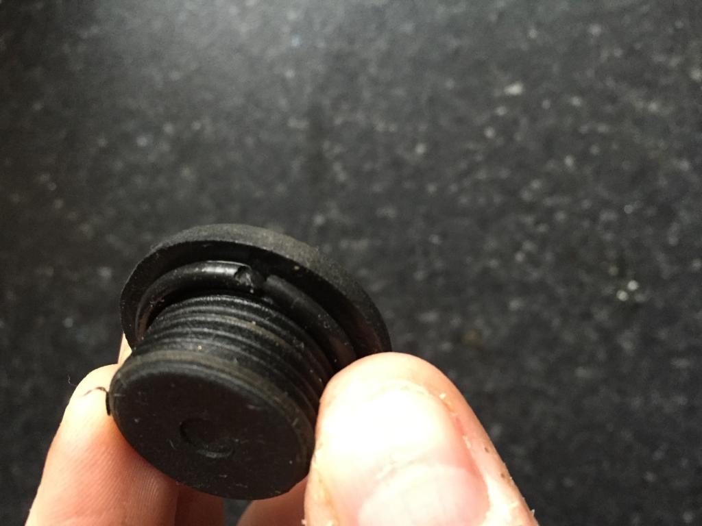

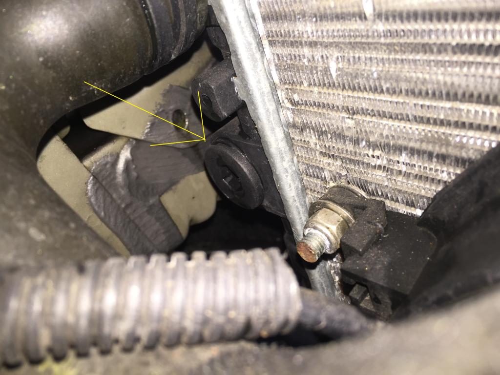

There was also a little mishap when the car was on the dyno. There is a bung in the radiator, and the o-ring seal decided to split. Dumping about 2 litres of coolant all over the dyno. Thankfully this was noticed before any overheating occurred. But it stopped play for a couple of hours whilst Andy had to repair the rad and clean up the dyno. Although it was a pain for Andy, thankfully this happened whilst there, and not when I was on a trackday! The system was also drained, flushed and refilled with new coolant.

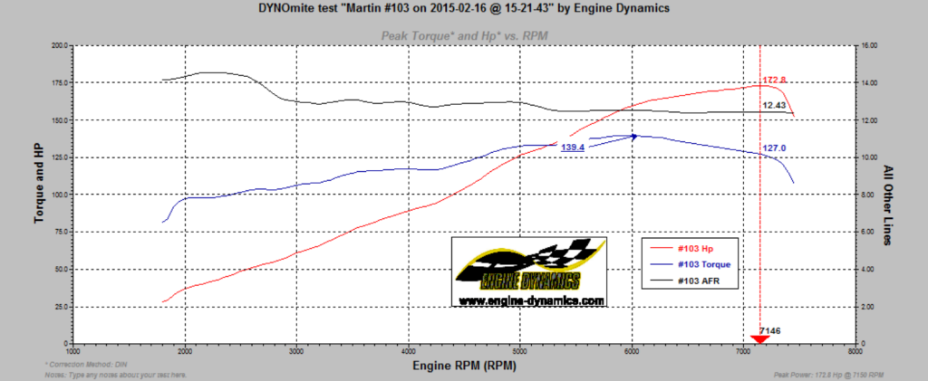

After a lot of work and lots of optimising the mapping was finally done. Andy managed to improve the map in most areas, including 5 BHP at the wheels at the top end. But still keeping it safe and reliable. The rev limit is only 7500 and there is a cold limiter at 4500 also.
So I set off last Saturday morning to collect the car. Had a good old chat with Andy on arrival, paid my bill and trailered the car home. It's now sitting ready for the first outing of the year at Bedford on Saturday.
Final peak numbers were 172.8 BHP at the wheels and 139.4 ft lbs. Engine Dynamics use ATW figures rather than ATF, simply because they mean more.
I'm not exactly sure what this converts to at the fly but I don't really care too much, I was never chasing numbers. Andy and Alex White have both mentioned it's a tickle over the 200 BHP mark.

Split o-ring on the radiator bung:
Power graph:

FYI Martin mine was mapped on semi slicks with the pressure a bit low so on RS Tuning rollers is made 152 at the wheels and the printout said 184 at the flywheel. So then when I had mine mapped on the ITBs (with the same wheels and tyres) it made 172 at the wheels and that worked out as 208bhp using the same ratio. Whereas running road tyres at a higher pressure would give a higher ATW figure.
You can work out what the torque is too. Have you got a graph for it, and what tyres and pressures were you running?
Interesting thanks Tom.
I was running 15" Toyo R1Rs. Tyre pressures are 28.5 currently. What does that mean? ☺️
The only graph I've got is the one I've posted up there. Andy did say he could re print anything out if I wanted though.
Thats a shame about the rad plug, is it a Polo Rad, iv seen a few of those fail, so make sure you use a decent one.
It is mate. It's only temporary until I sort out a bigger one. But yet to look into that, and this one hasn't caused me any issues up until now.

Very similar tyres and pressures then. So if you use the same ratio mine came out with yours works out as 209bhp and 169lbft. Which is what I'd expect tbh considering you're on 421s
I would have dynoed the car with the tyre pressures you run on track hot. I.e operating temperature, as mentioned above.
Hmmmm I reckon due to the polo rads small size and the inadequate airflow meant that the rad was hotter than normal and the weakest point gave in i.e the rad bung.
If it's something over 200 then I'm more than happy haha.
I was always guessing between 200 and 205 anyway.
Looking forward to seeing how well it drives on Saturday.
I run about 28-29 psi hot on track. But that's with r888s. These tyres are my roads/wets.

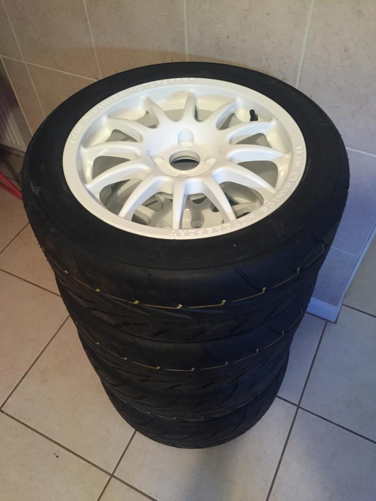

New wheels and tyres were only sorted out the day before.
