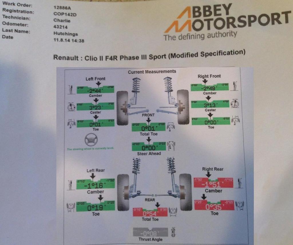

Right, whilst I don't have the car to play around with I thought I should start to order a few small things.
I need to sort out some shims to bring my rear toe and camber more in line. This is what I'm working with at the moment... I'll also be going to 10 minutes toe out on the front axle when I have the tracking done next.
What I'm thinking is a 3mm shim for the left rear camber. To make it -1.46 degrees. Which would bring it more inline with the right rear at -1.51 degrees.
Then ideally a 1.5mm shim for the right rear to bring the toe back out a bit. That would make it 20 minutes toe in this side and 19 minutes toe in on the left side. (which would be perfect) However I'm not sure I'll be able to find a 1.5mm shim 😞 so I may have to settle for a 1mm one (If they even do these). Which would make it 25 minutes toe in this side.
My OCD doesn't like the fact that it's never going to be perfect but it's obviously very very small differences.
Am I right in what I'm thinking @NorthloopCup or am I missing the mark somewhere here? A 3mm shim and a 1mm shim almost seems so minimal that it's not worth doing, or do I have my measurements wrong?
Get the Pure Motorsport shims, they're marked in minutes not mm, so it's easy to work out.
They do 10, 20, 30 minute shims for toe. So just stick a 20 on the right side so you end up with 19 left and 15 right.
I've just bought a 20 minute shim as mine is pretty much like yours on the rear.
Confirms what I was thinking cheers.
I'd want a 15 minute shim ideally to keep the rear end 'safer'. Although I'm not sure the difference would even be noticeable?
I'd want a 30 minute shim for the camber on the left side then too right? To make it -1 degree and 46 minutes.
Saying that I have been trying to source the 5min metal Renault shims to bring my rear in line to the other, currently each side is slightly different, and yes it would notice (on track).
That's 0.5mm? Interesting, never would have thought that would be noticeable, cheers. Let me know if you come across a 15 minute shim :up:

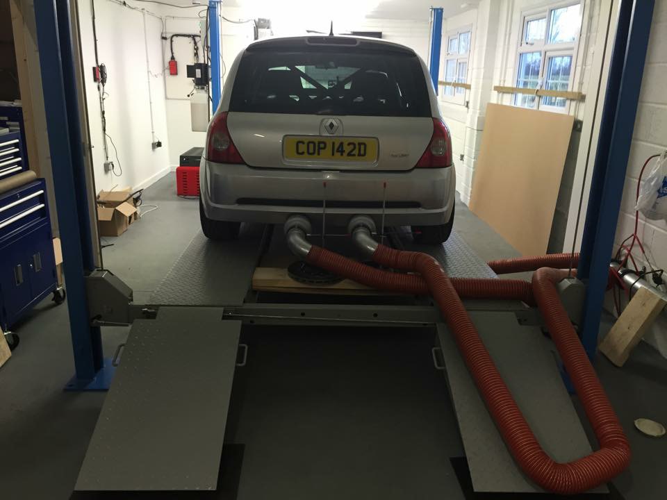

Mapping Update
I spoke to Andy at @Engine Dynamics last night. He said the mapping is almost complete and that the car has gained in most place, including around 5 BHP at top end. There's a little bit of tidying up to do still, but he said we are still good for collection at the weekend :grinning:
I'm really looking forward to getting the car back with a map that's finally complete, and not having to let off at over 100 MPH.
I don't know any power figures just yet, but this isn't that important to me. I was never chasing figures and we all know that N/A tuning doesn't give you much back anyway! I just wanted it to drive well and most importantly, be reliable/safe.

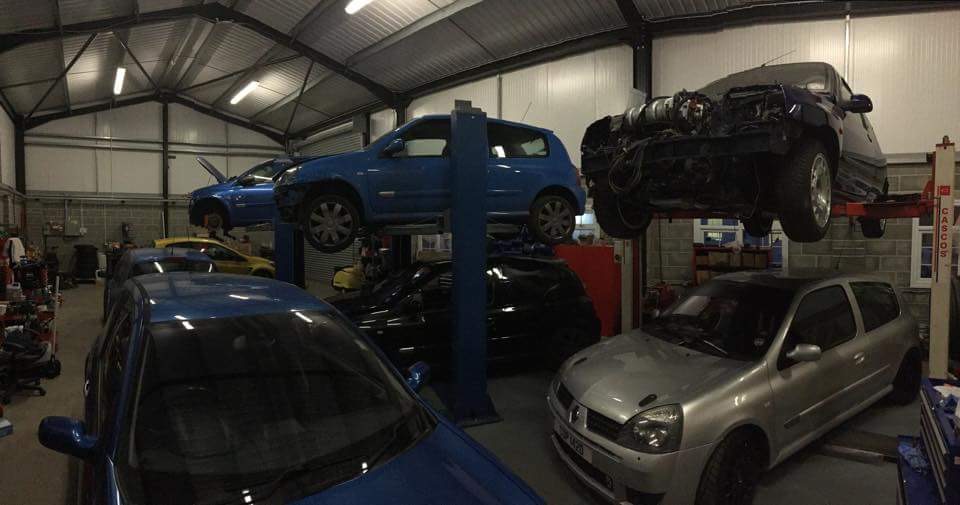

Sitting patiently in the workshop:
On the rollers:
