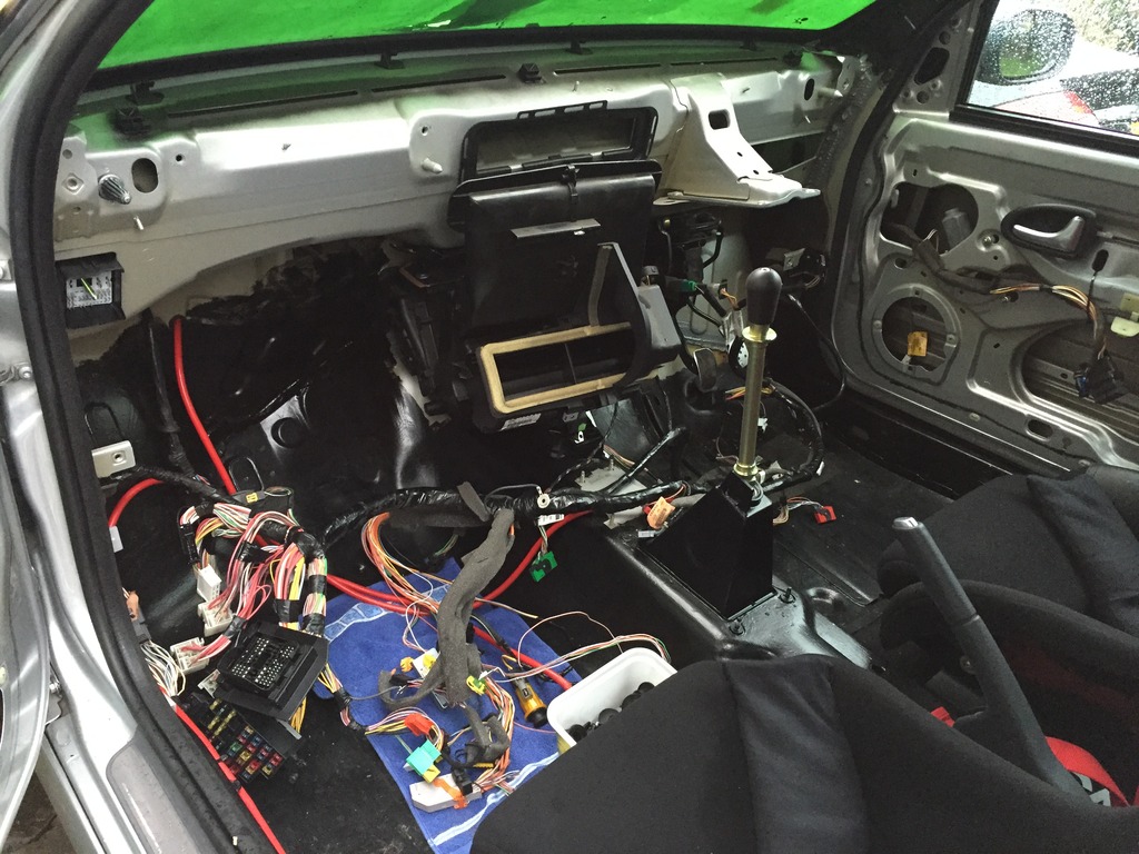

Only picture I took because I didn't want to get my greasy hands on my phone. It's looking very empty under there now!

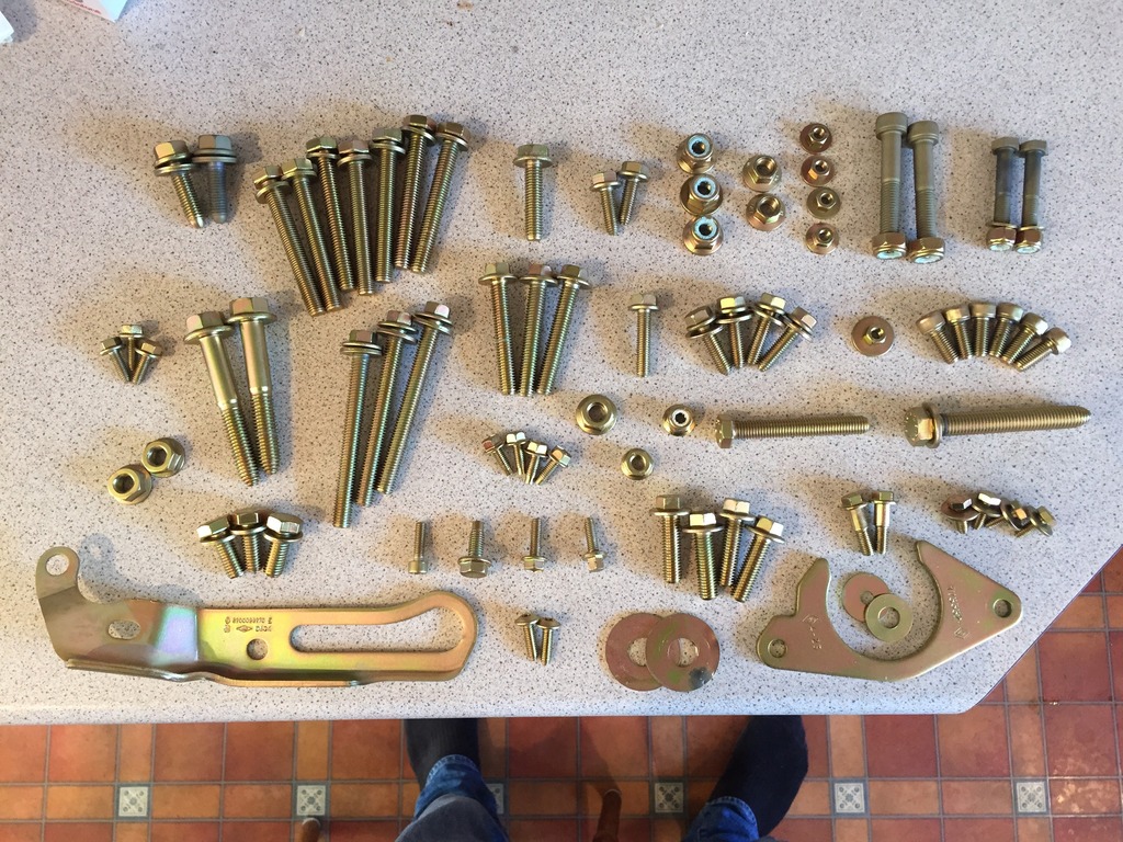

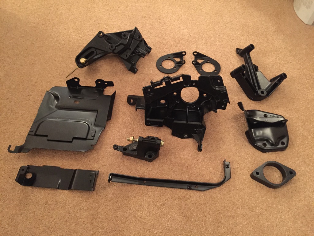

Powder coated parts.
Zinc coated nuts and bolts. (A couple came out funky, so @Ant_Smiggy has sent me down a few to replace these)

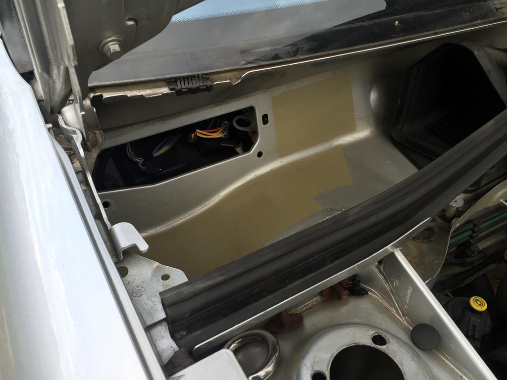

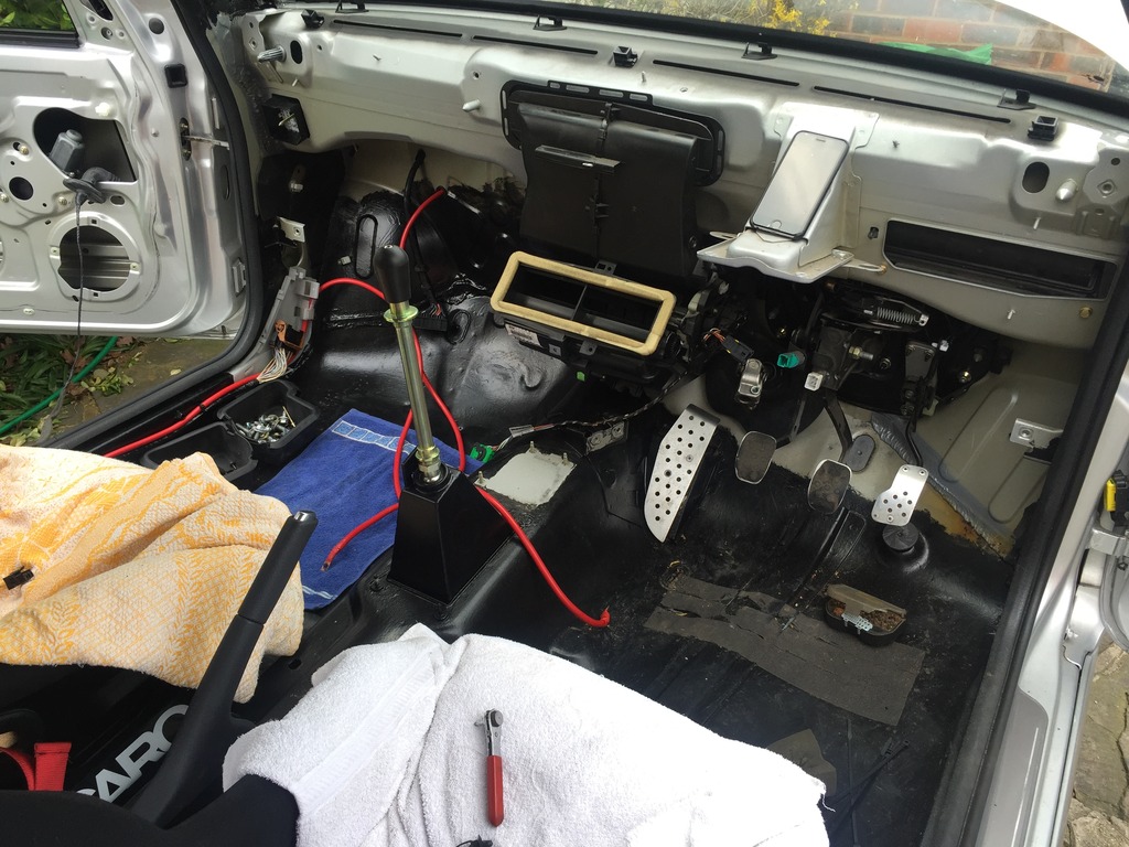

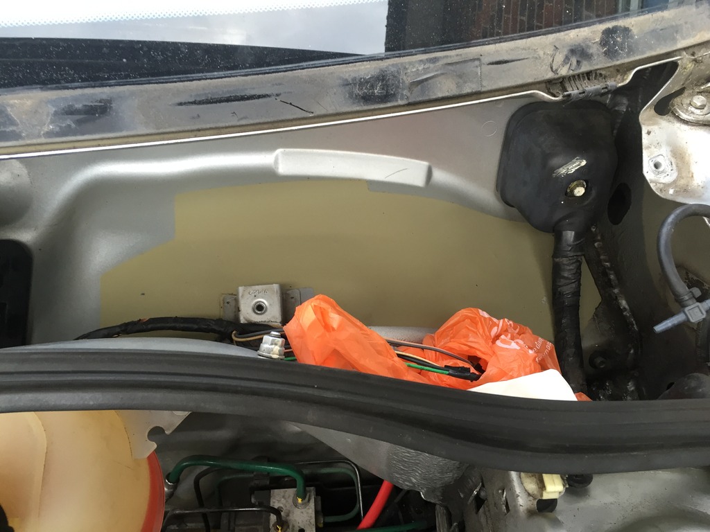

I quickly removed the sound deadening in here whilst everything was out of the way.

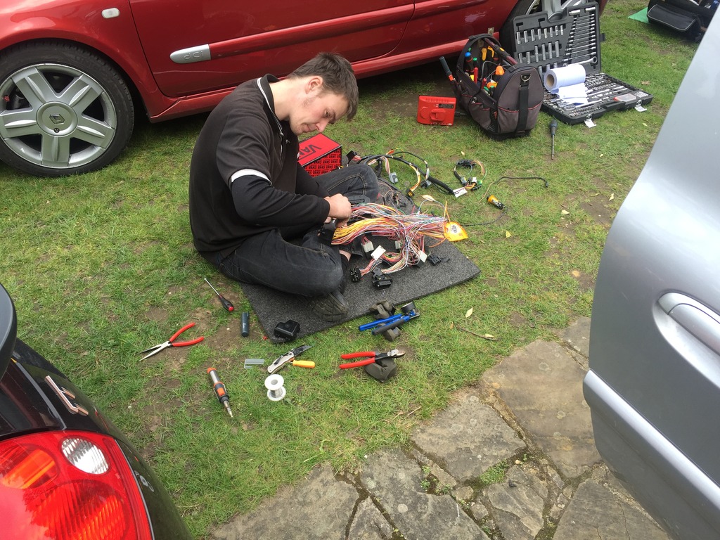

Graham also popped down one afternoon to help me remove the full dash, ready for Alex to work on the loom. We also removed the PAS pump, 182 alternator, PMS AC delete kit and then mock fitted the new 172 cup alternator brackets. After he left I also removed the standard gear stick and fitted the PMS one into place.

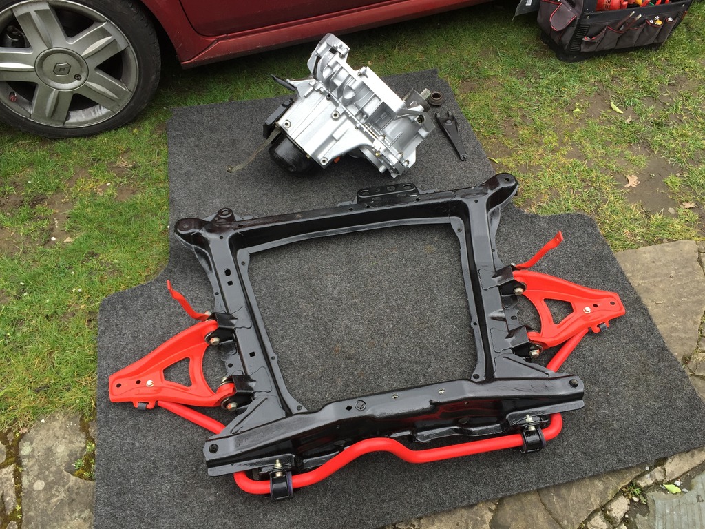

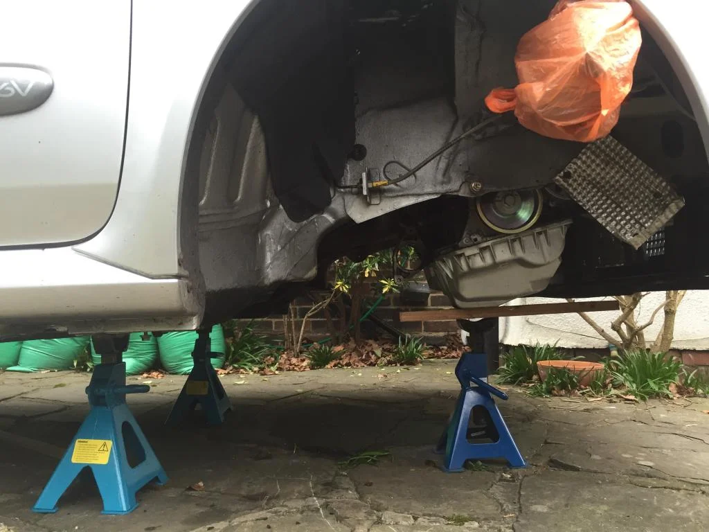

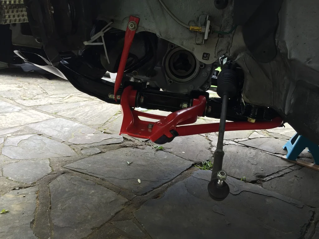

The gearbox from @Porkie and subframe were cleaned up and painted ready for refitting.

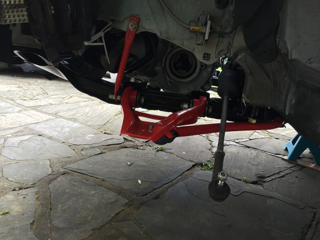

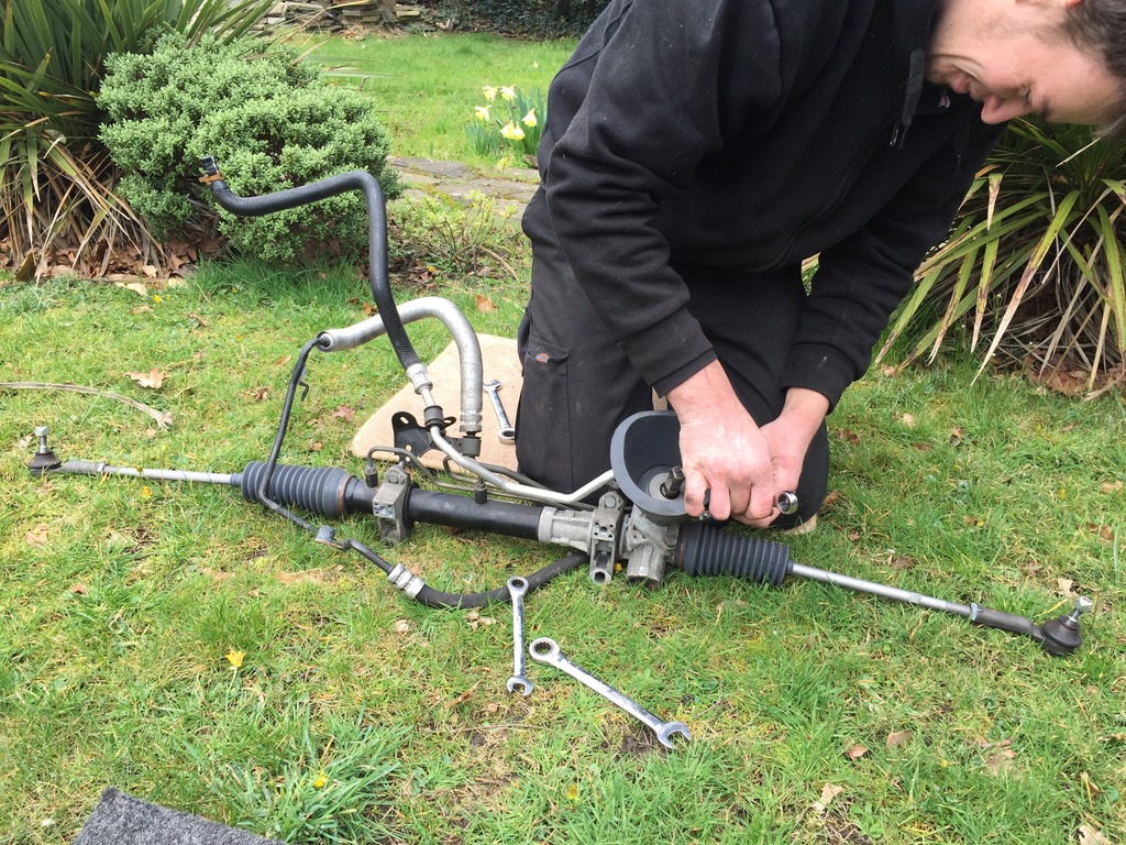

Alex sorted out the steering rack. He removed the PAS pipes and fitted some new rack bushes.
Everything went back on very smoothly, apart from one gearbox mount bolt. I've also refitted the hub, coilover and brakes since taking this photo.

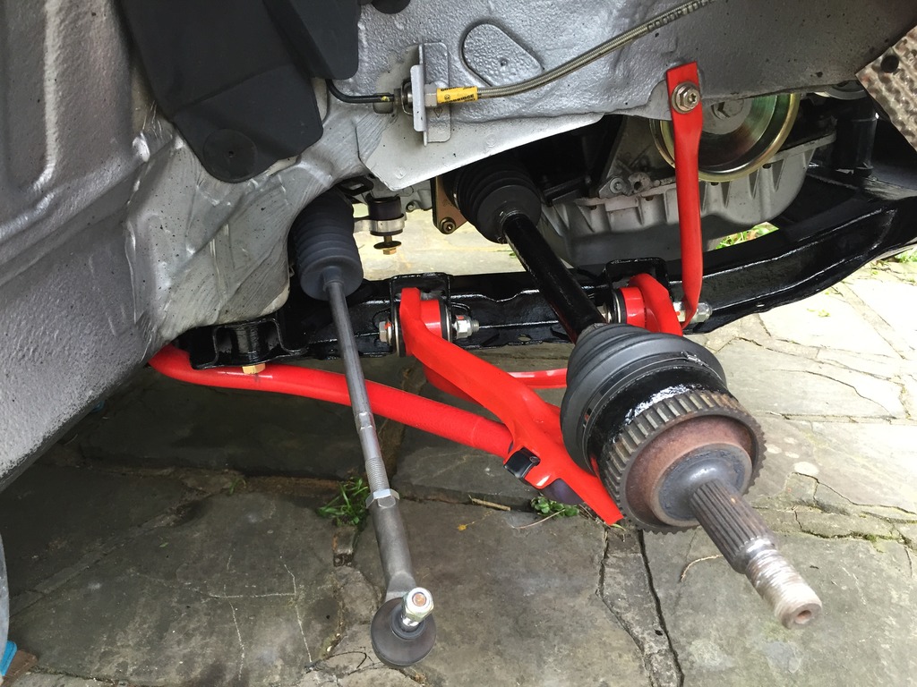

This side hasn't changed much, because of the drive shaft fitting issue. Once I get the hub nut buzzed off though it should all be back on in no time.
Alex then removed interior loom and fitted the bottom half of the EPAS column.

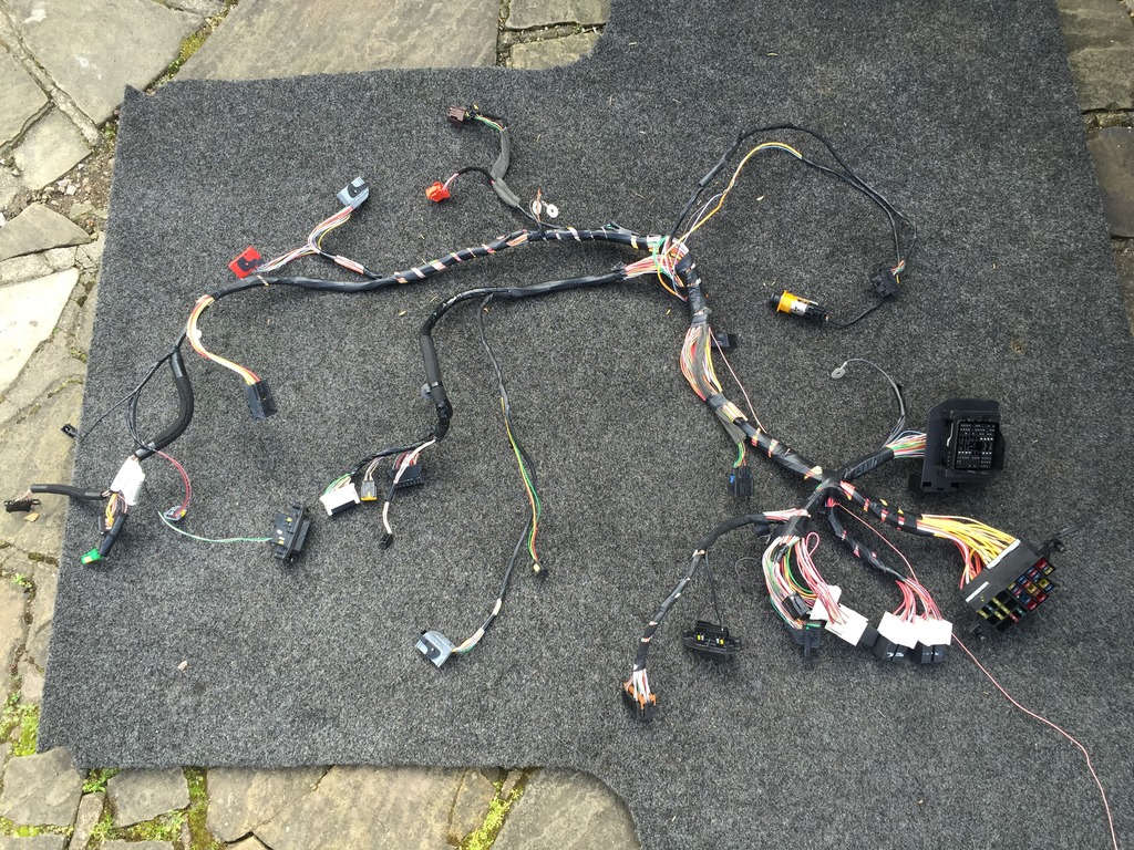

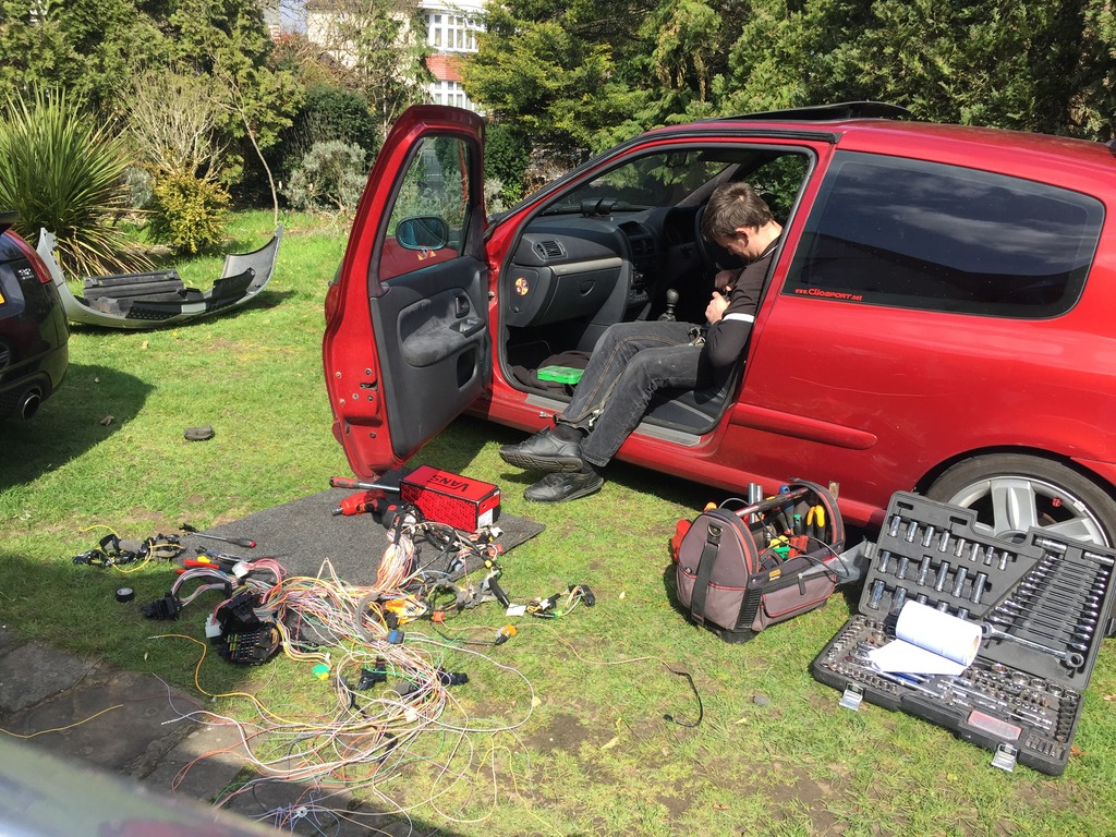

He then made a start with trimming the loom down. Removing what he could easily and keeping it tidy.
The finished loom. Much tidier.

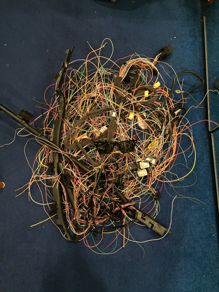

The pile of crap he removed. Yet to weigh it all but it's a huge pile.

@AlexW cracks me up. Look at him happily sat on the lawn chopping loom apart like a kid at Christmas. Legend!
I managed to get him to eat once here. At the pub. He couldn't really not eat it as I just bought it and plonked it in front of him.
He was in his element. He got angry when I kept trying to talk to him.
I managed to feed him a bacon sandwich this time round. And a bag of mini cheddars, he likes those.

Did you find those sunglasses in the loom!
Looks like you got a lot done yesterday. Summer is going to be so good. Belt should be 4/5pk847 if the lightweight pullys are the same diameter as the originals.

I missed the sunglasses on that loom pic lol.
