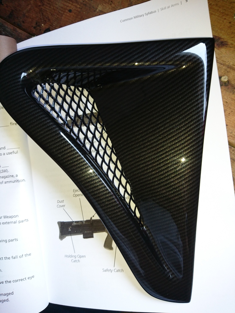

with the mesh bonded on

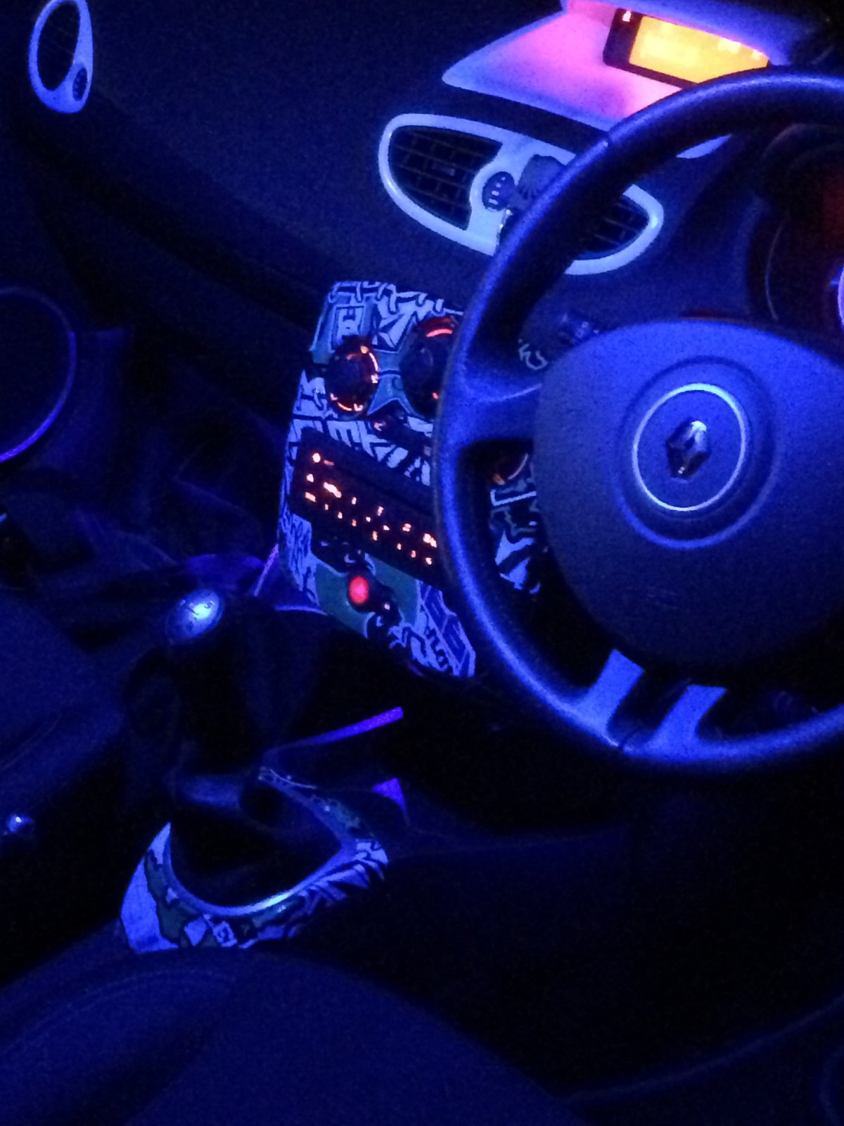

Not going to lie, this looks absolutely amazing! I especially love the carbon fibre bits on the inside. Sorry if you've already answered this, did you take out the bits and send them off to get them carbon dipped? I have a Clio RS MK4 and I like the idea of replacing some of the matt elements with carbon elements. Were they expensive? Keep up the great work btw! It looks amazing!
  Clio Mk3 tce
Thank you so much. Yes, taken out the bits I wanted dipped and got them done. Also a few things were brought from eBay and then dipped. Not familiar with mk4 interior. What does it look like? I would say it's a little expensive. But the quality is great. I think it's worth it. Price is hard to say as it was done in a batch with my bfs parts

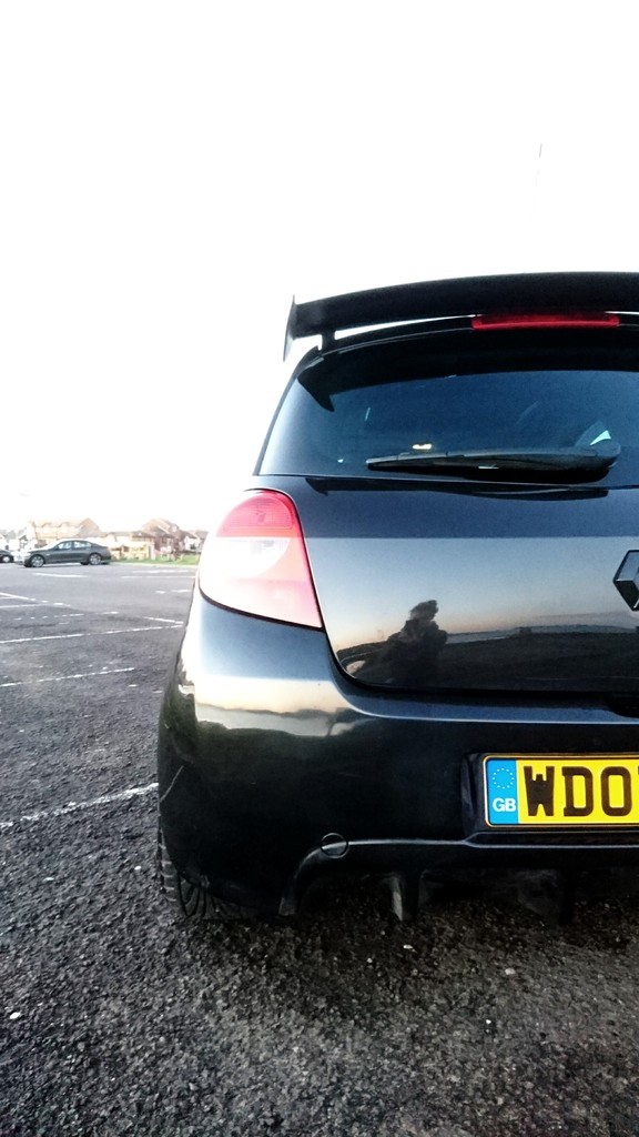

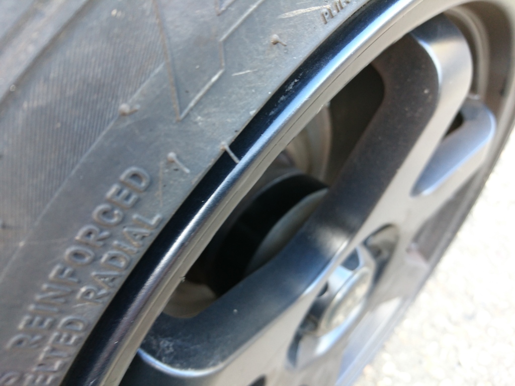

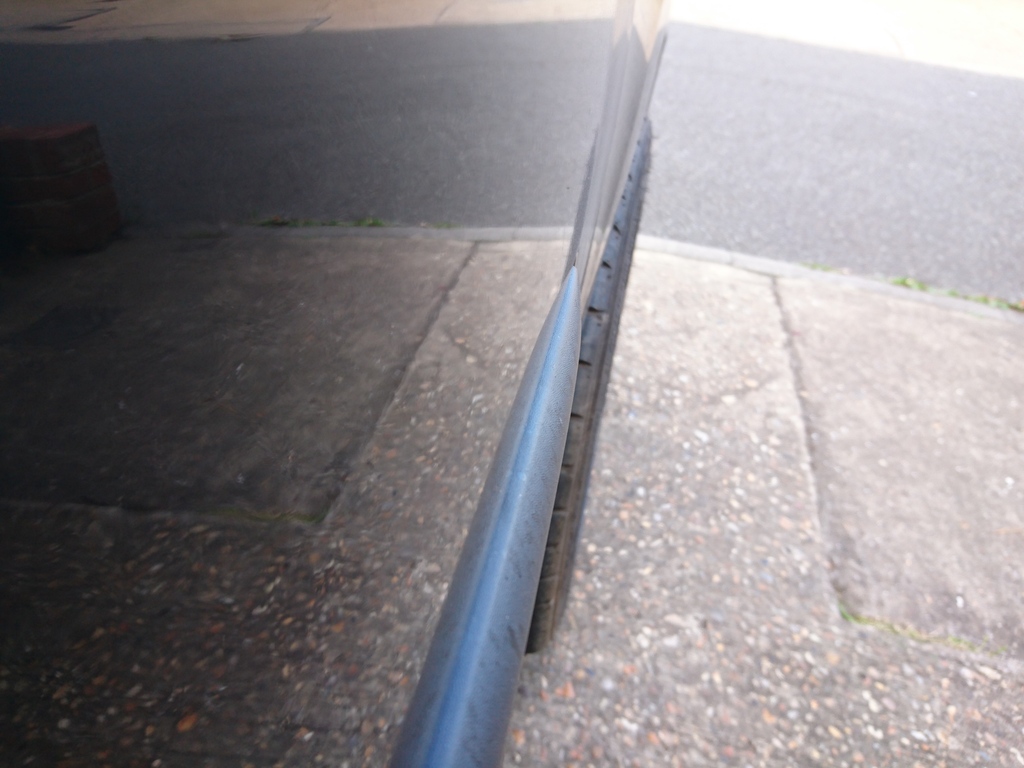

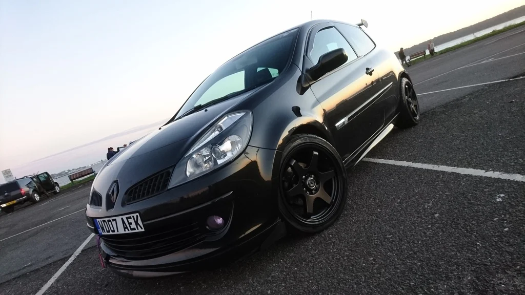

Widened the rear. Went from 20mm to 30mm spacers.
^painted edges
Thank you :smile: I was really pleased with the hydrodippped things. They came out really well.

hi how much did you pay to get all your interior hydro dipped I'm always messing about with my car will up load sum pics soon love the alloys btw have exact same ones with tyres lol
Everything on the car including foglight surrounds, Front bumper mouldings Engine cover, battery cover and all the Interior bits would have been about £200. But was done as a batch with other cars parts

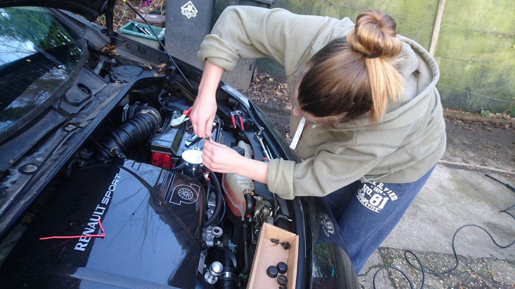

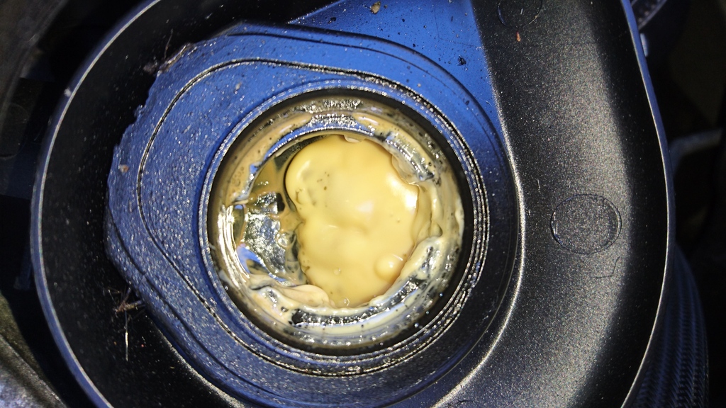

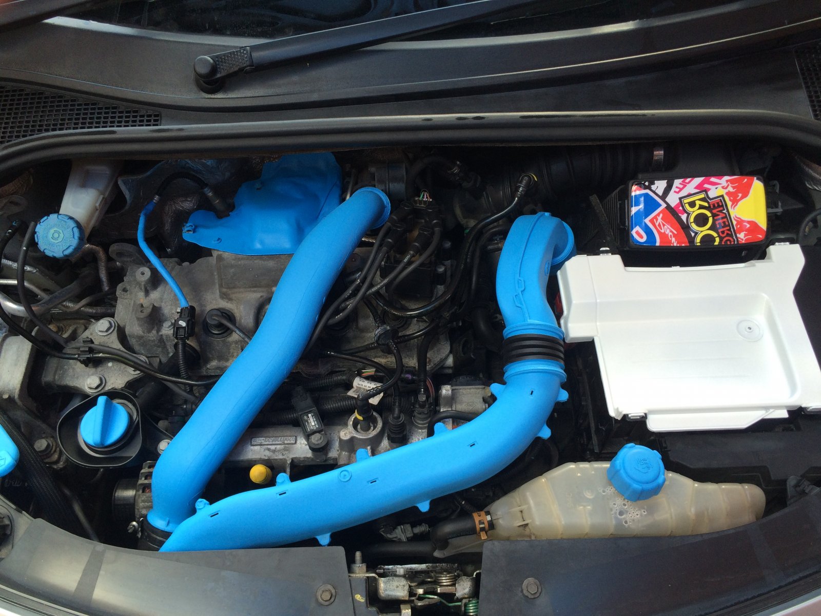

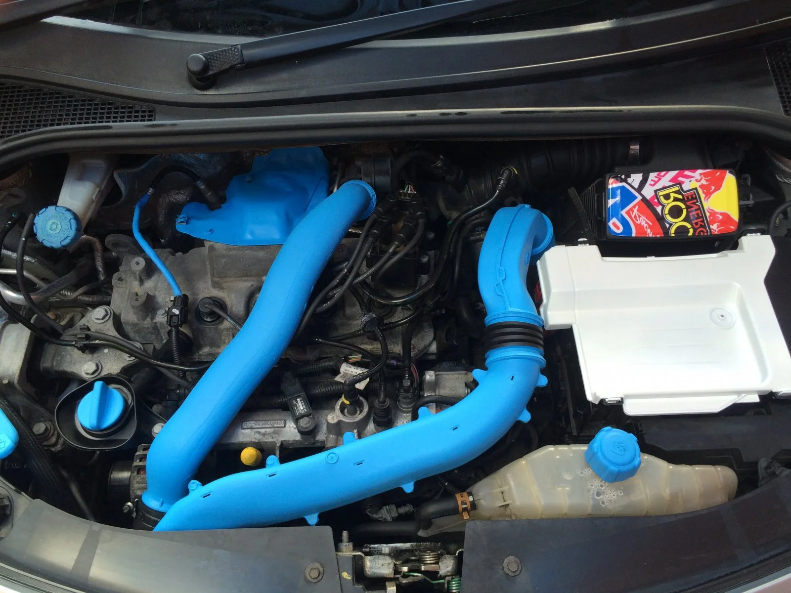

Time to empty the oil catch can again , because it was full up, I had sludge under the oil filler cap again.
The can really reduced this build up in the past.
Next was to fit the boost gauge :) looks great and suits my other Dials.

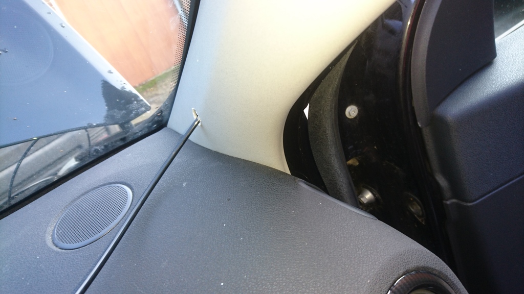

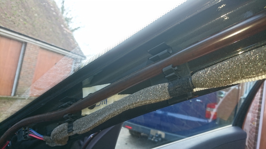

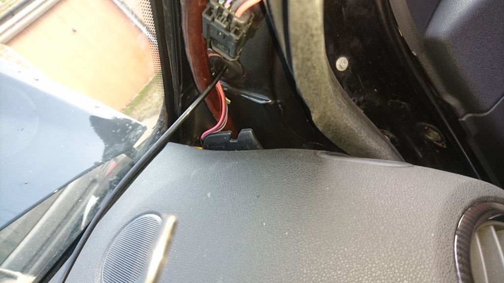

Does anyone know what this hose is? I have a feeling it's a water drain from the sunroof and it's blocked, looks too big for rear window washer.
Plumbing into the inlet manifold to dumpvalve hose.

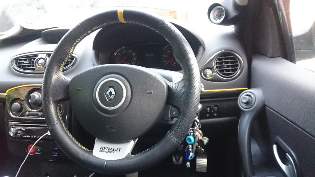

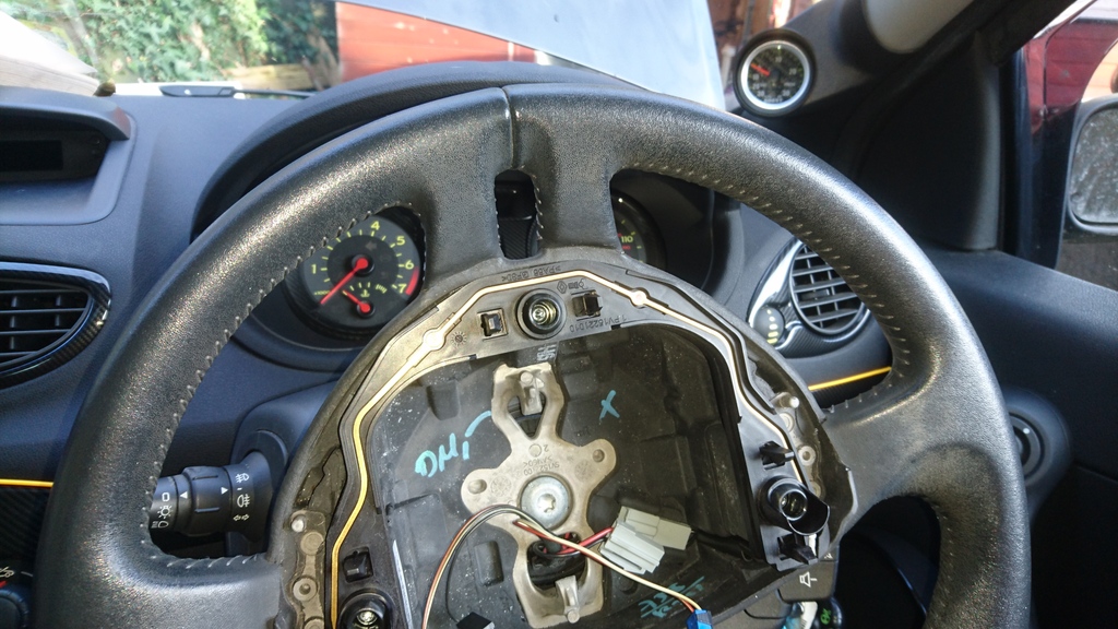

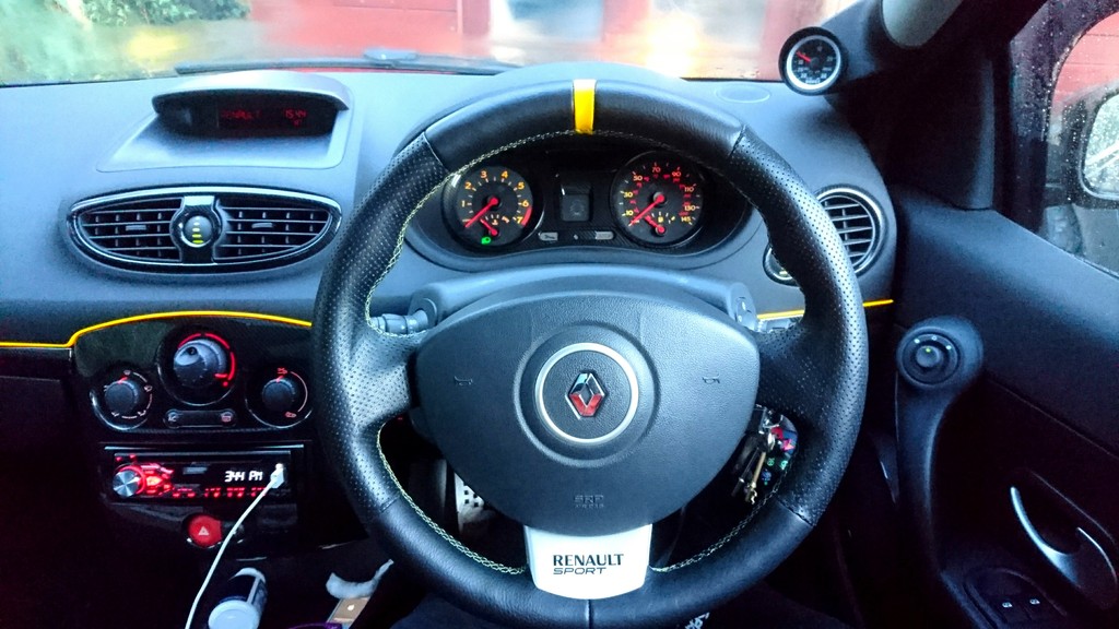

Then removed the old boring steering wheel and installed the new custom one I got for Christmas :)
Bit of a pain to release the airbag!
Final outcome

I believe that tube is the drain for the sunroof. Have a look at page 52A-20 on this pdf: http://philch.free.fr/clio/clio3/MR393CLIO5.pdf. For some reason it's on the passenger side, however that may just be because it was originally written for LHD cars. I should probably check the drains on mine too, can't imagine them ever being cleared/flushed.
  Clio Mk3 tce
Ive had a look. Thanks for the link may be helpful in the future. Do you know if the tube is on both sides on the car? I see it says about being front and rear. Do you know where the pipe exits?
  Clio 197
No problem :) I reckon the tube will only be on one side but i'm not 100% sure. iirc the front drainage point comes out near the front arch liner, and the rear one at the rear arch liner
  Clio Mk3 tce
No problem :smile: I reckon the tube will only be on one side but i'm not 100% sure. iirc the front drainage point comes out near the front arch liner, and the rear one at the rear arch liner
I'll have a look on my car. That makes sense seeing as it says about removing arch lining. Thanks for your help :)
