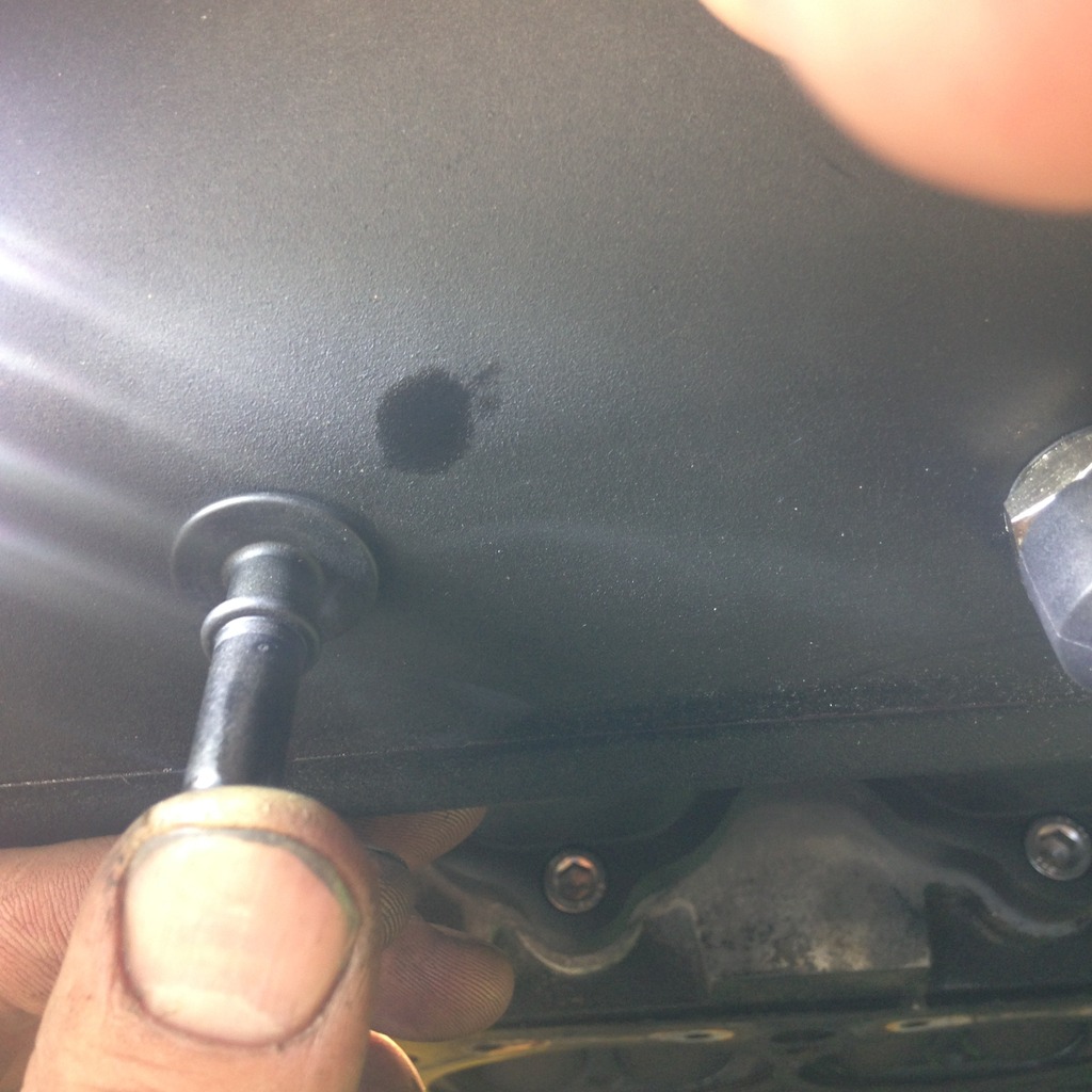

he should be refunding some money due to the s**t quality and problems dan has just found.
Appalling picture, but you can see the light trails and just a small smoke trail to the right.

Can you confirm that the brake booster fitting is the one dan has his thumb on in the pic and the other one is the canister connection. Thanks
