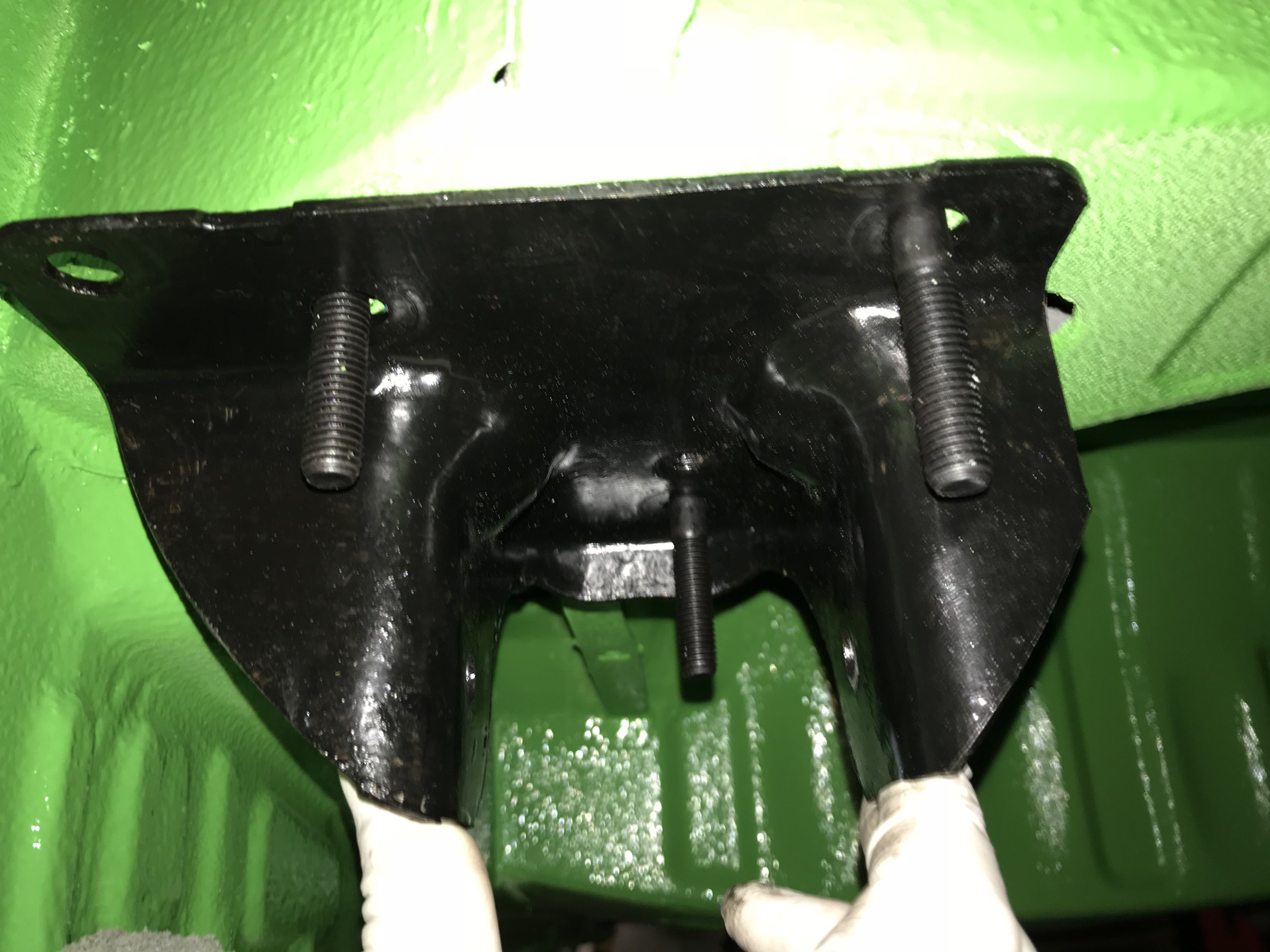

Hey @Tomotek
I wanted to check if you had any issue with you chassis to rear beam mount bolts?
Just looking at them it looks like there isn’t enough thread to them.
Hey, no I didn’t have any issues. They had 2 threads sticking out the end of the nut when I tightened them up. (I do have mine going through the cage spacers though, which would have caused me to need a longer shank than a std car now thinking about it). Totally forgotten about that when I sent that spreadsheet.
Is that the issue your seeing?

I haven’t put them on the car yet just looked at them against the old bolts and it looks very close to not enouugh thread - your cage pick-ups would of been an advantage in this situation. I will probably be offering it up today so will see
Nafoff
As thought, this was an issue. I need to space the 2 inner (on both sides) rear beam mount bolts upwards at least 15mm to be showing only thread. (see pic below)
This will probably be done with stainless spacers like @scotiamr2t suggested above, the 19mm versions should be spot on, annoying but things need to be right.
Nafoff
Having done a bit of thinking I won't be going with spacers, I don't want to cause any potential for movement. I am just going to source new bolts for the inner 2 bolts on both sides, these will have to be 100mm.

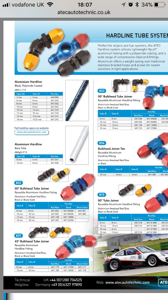

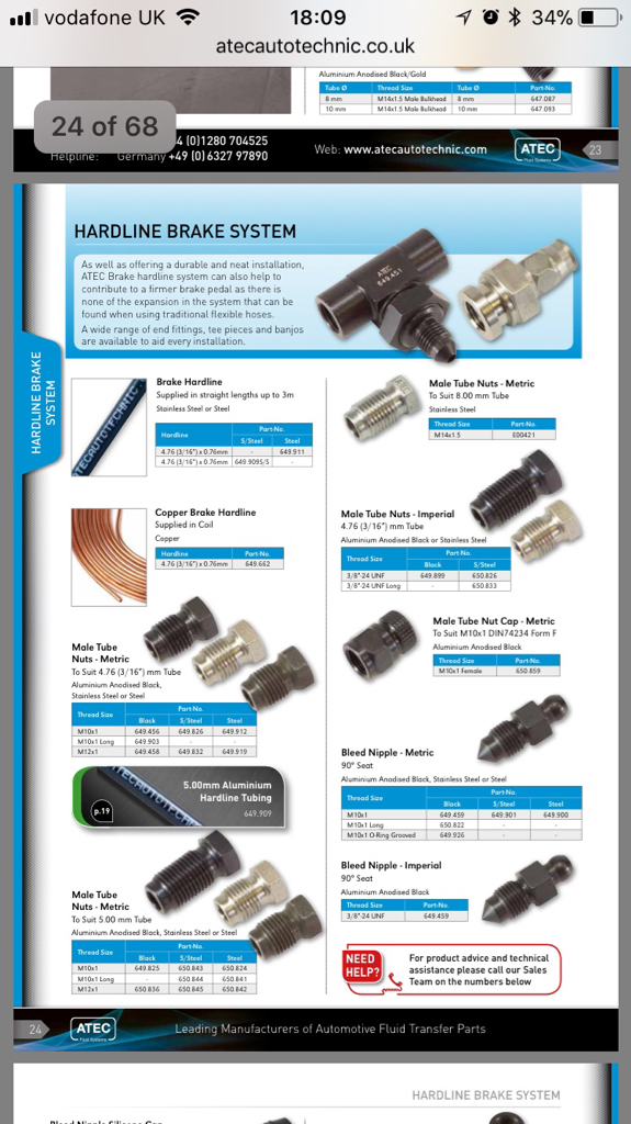

Hey @Tomotek , I cant find the aluminium brake lines on the atec site. Do I have to speak to them direct? Also If you dont mind me asking, how much was the line, was it per metre?
Ive just plumbed my system only yesterday and am not 100% happy with it, it was full braided but its my design and the fittings just didnt work out as planned
Tomotek
Hi.. yeah they don’t have everything on their website.. the catalogue is your best bet.
The below pics shows the Brake hardline and standard hardline depending on the fittings you use.. I used the 5-3mm line (649.909) .. at the time it was £3.30 a meter
Hope that helps

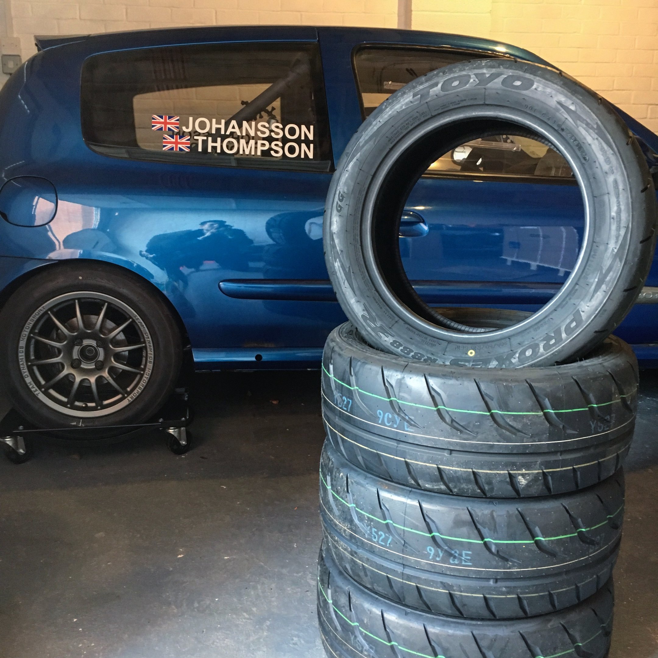

I sorted out mounting the ECU on the bulkhead, mocked up and made my own door cards and door releases, sealed the bulkhead, changed the toe, made some tweeks to the brake setup, got the new tyres fitted etc. (pics to follow of the mods)
Went for new Toyo R888Rs as they are the Track day championship control tyre.

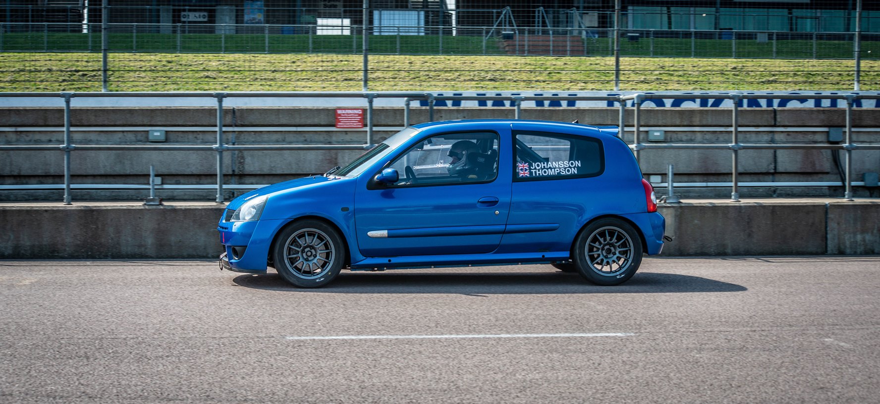

Darren S Photography were on sight to take some great pics of everyone out on track... a selection below.
All in all we had a great day!. Got the balance we wanted, learnt the track, put more miles on the clio!. TICK!

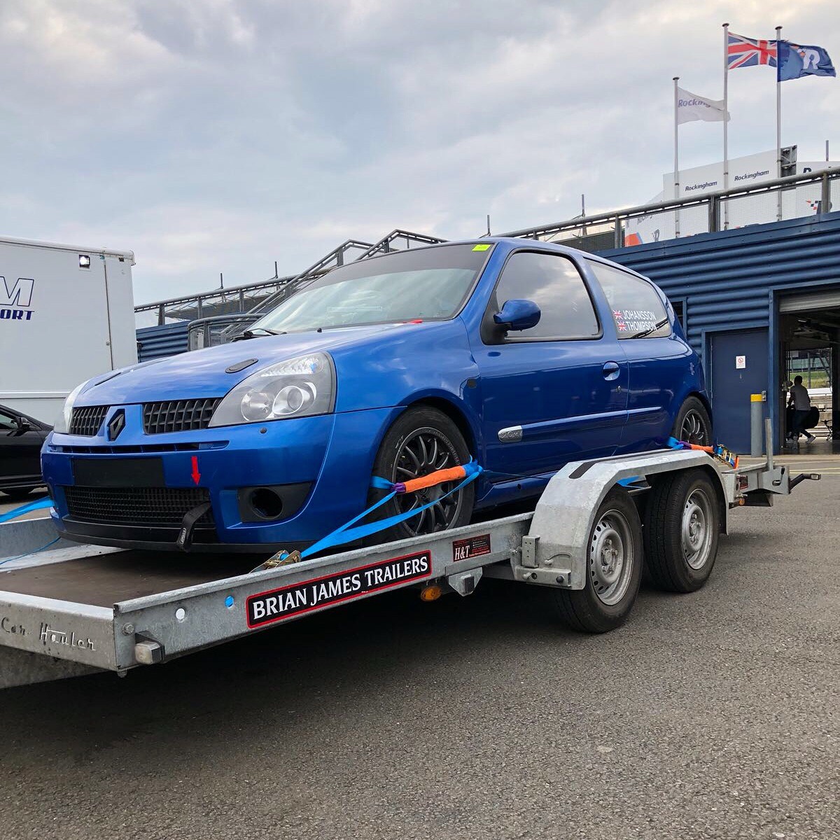

Then to let the engine cool down and load it up on the trailer to bring home!.
A massive thanks to H&T Trailer Hire near Coventry that saved the day, having a trailer to hand to hire the day before the track day as our usual supplier had messed up our booking!. Hugh at H&T was a pleasure to deal with.. I highly recommend their company, we'll definitely be going back!

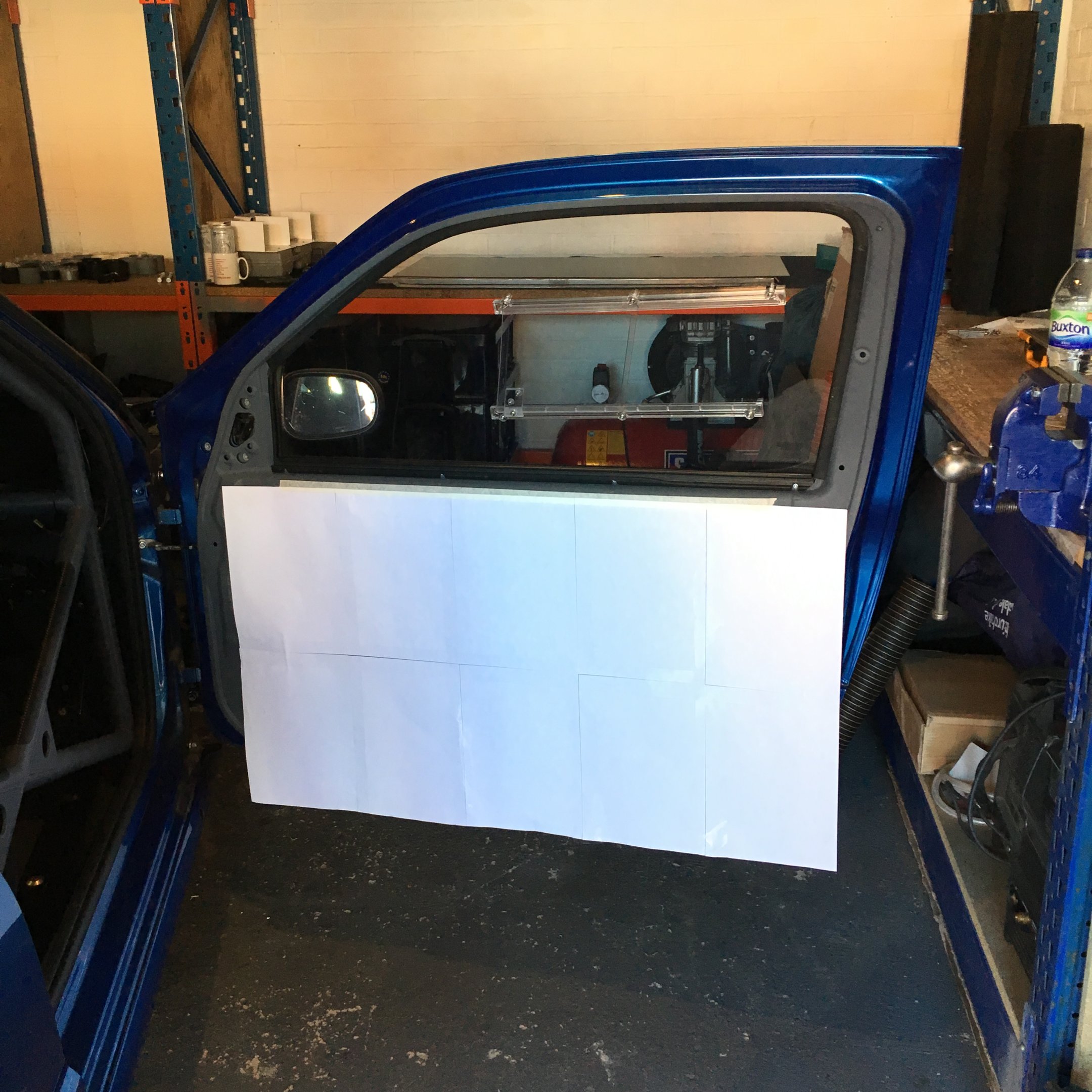

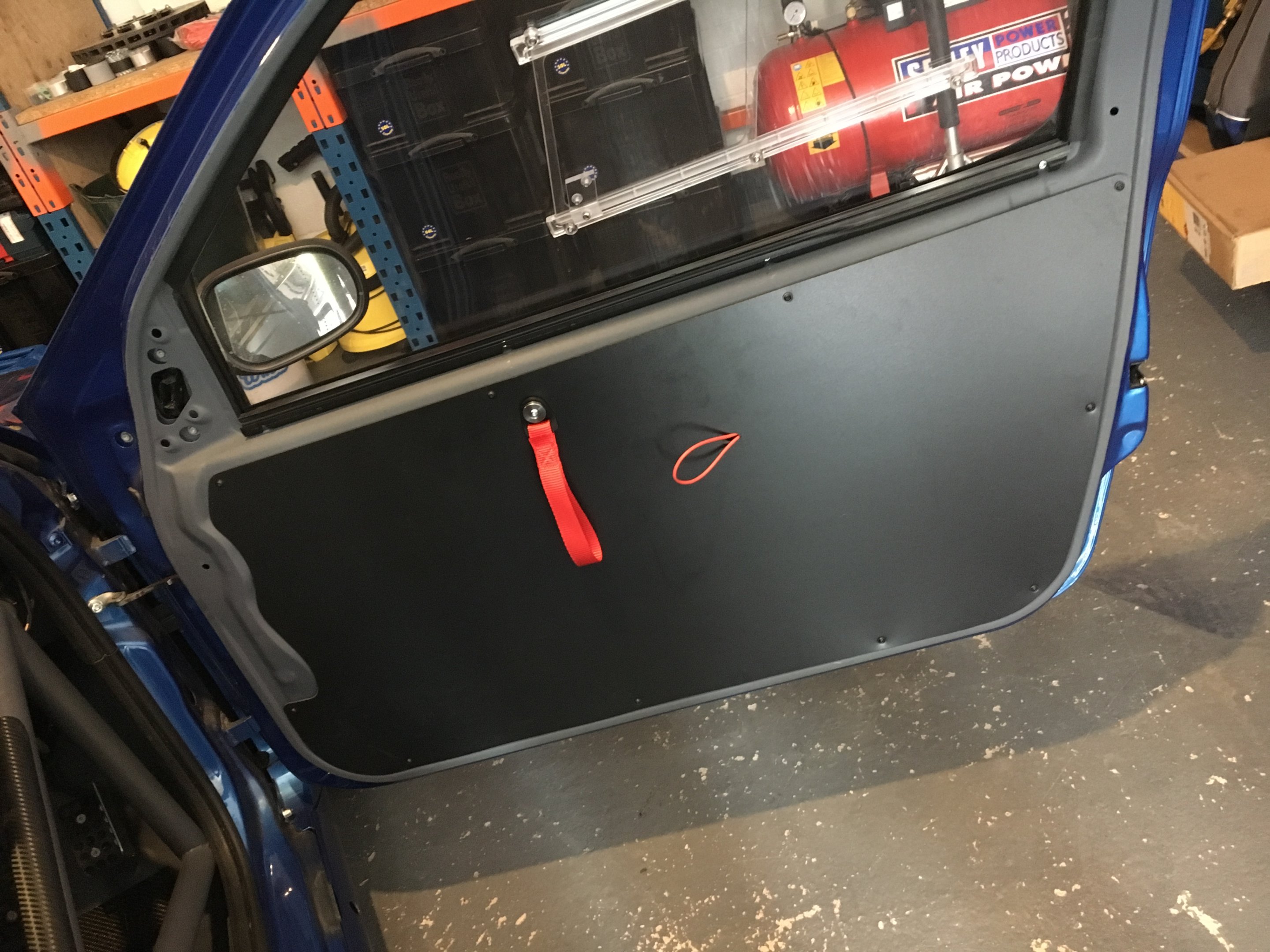

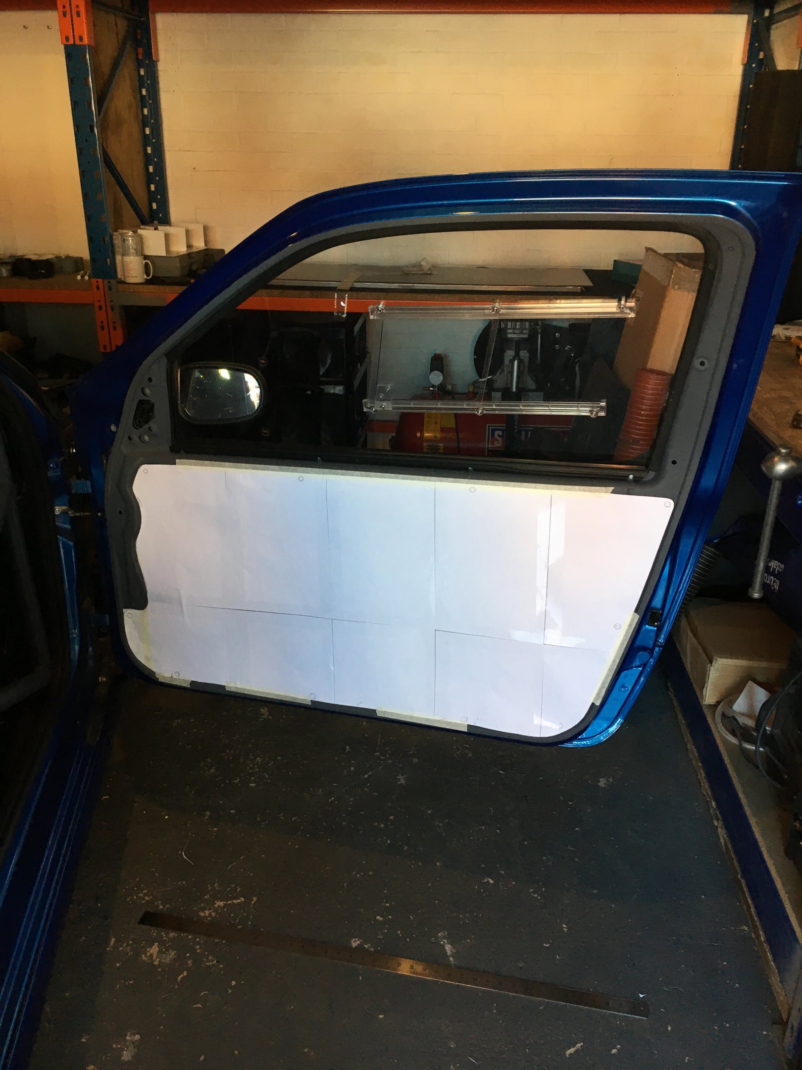

I decided to tidy up the doors as not having door cards on was bugging me.. plus we need them to race so that there are no sharp edges close to the driver etc.
I started out by getting some paper hung on the door to cut out the profile i wanted. I then used this template to cut out the cards. I used some 3mm foamex. Cut with a fine metal cutting blade on a jigsaw.
I then mounted them with torx head self tapping screws into the door structure
I reattached the door pulls and modified the original release cable, looping it around and fitting a red plastic sleeve, which can be used to open the door.

So imitation is the highest form of flattery so they say?
Your cut lines were perfect so I copied them. Thanks
What's the next project on your list?
Looks good mate!.. that’s what the build thread is all about, giving people ideas!
