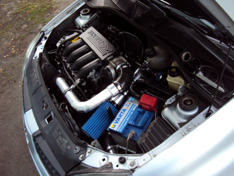

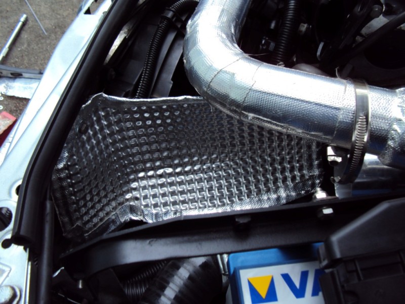

DOnt know whether to try and make some air filter heatshield out of nimbus, or if ill be wasting my time?
Countdown to mapping begins :)
Ricardos
  LY 200 EDC
Super tidy engine bay, I've read this from the start and looking forward to the mapping results. It's something I've been seriously looking into doing.... But scared to actually take the plunge!
  Clio T 314hp c43 AMG
Looking good, regarding the "controversial pipe" chrome heat soaks quite bad in comparision to wrap/black, you can barely touch mine after a spirited drive.
Hope it makes good power, the gen90 will help.
  182/RS2/ Turbo/Mk1
The laws of physics disagrees with you there TBH mate, shiney light coloured surfaces reflect heat, where as dark matt finishes absorb and radiate far better.

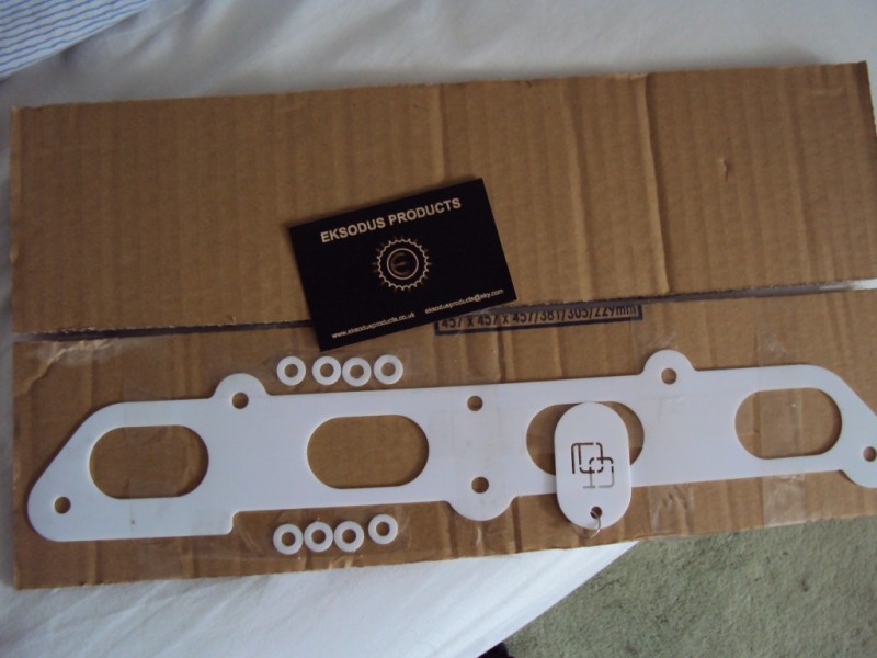

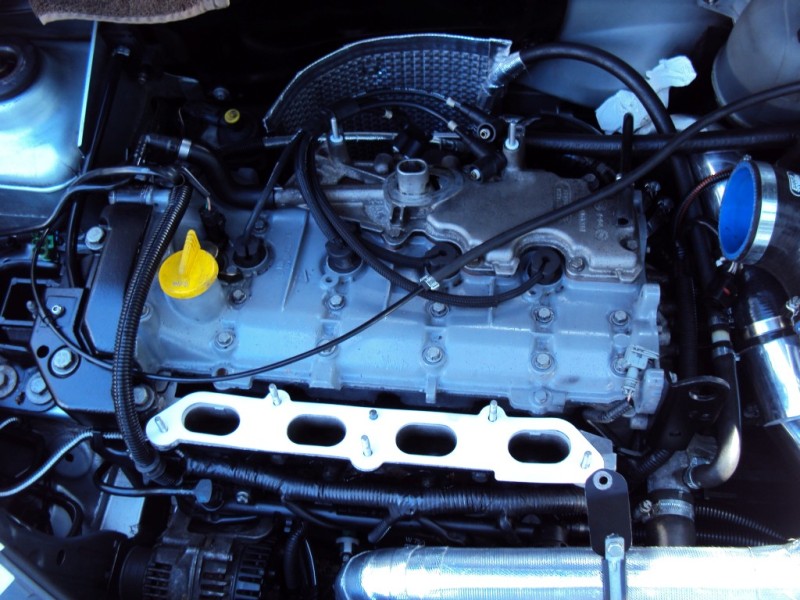

Top PTFE gasket fitted today again with the idea being "every degree less, helps!", decided against the lower as i DIY matched my inlets when i had my engine in pieces and ended up porting too much and then had to port the head out to match and the lower gasket so don't want to ever touch those again where possible.

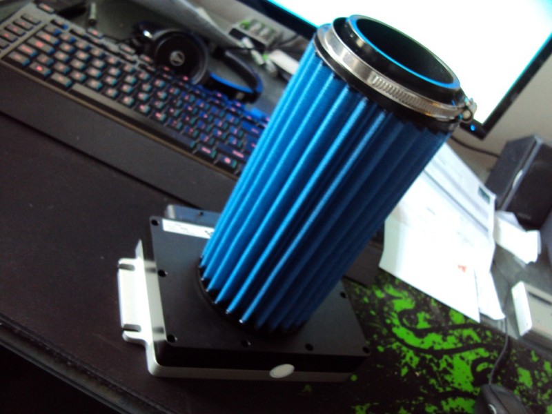

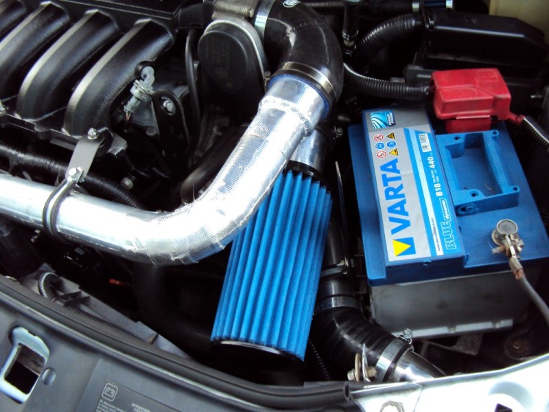

Pissed right off fitted new filter drove it a couple of days and it has slipped off the end of the pipe (through engine movement i guess), and torn the flimsy rubber neck right off. So i've had to pikey it with a piece of silicon hose and black silicon sealed it onto the filter, not happy at all (but i guess its my own fault).

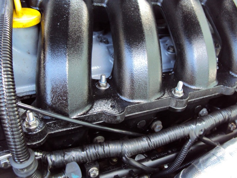

You'll also notice below i "stud'n'nut" converted the top plenum fixture points, i did this 1) i was bored 2) i get a little nervous about tightening as i know it wouldnt take much to strip them. 3) wanted to tighten them pretty tight for extra clamping on PTFE gasket. All works well :)

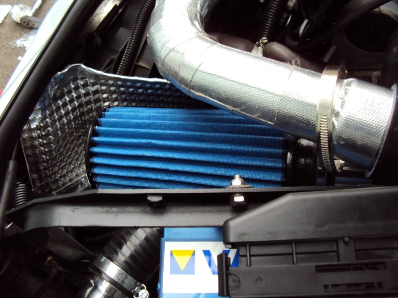

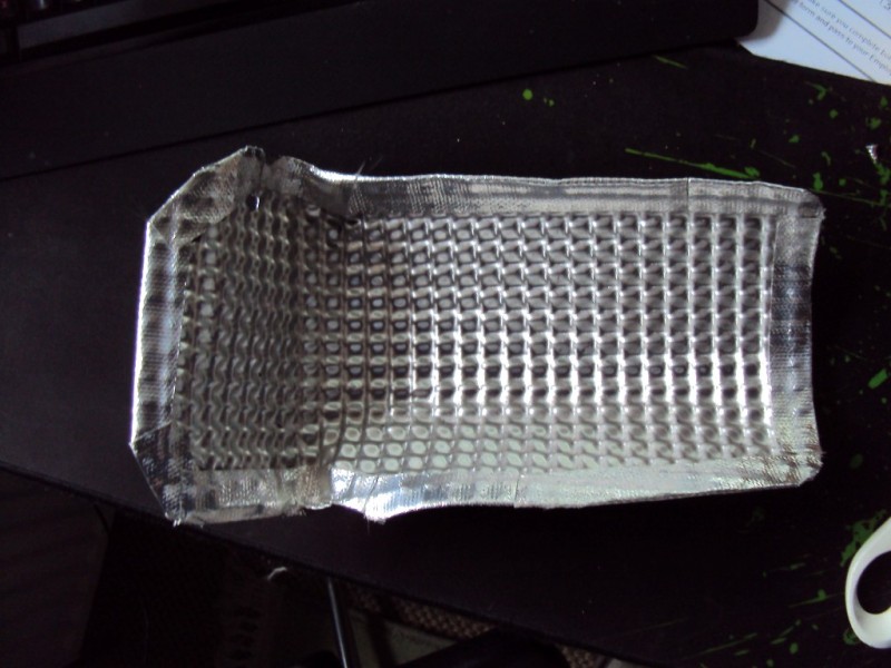

Made a headshield this afternoon out of boredom.

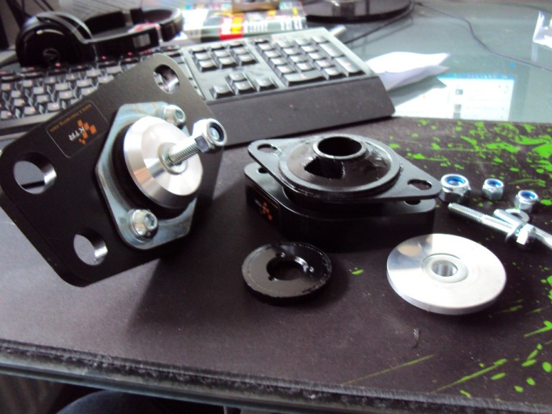

Ktec mounts fitted this evening, old ones were no doubt the originals and showing their age a bit. Car already has a polybushed dog bone.
But i decided the OE mounts will soon wear out with the extra torque, aswell as putting strain on the downpipe from any extra movement. Uprated mounts was a no brainer.

Great progress Laine. Nice heatshield - nimbus is so nice to work with isn't it.
Shame about the filter:( I tried to get hold of one of those for our car but Jetex didn't have stock so went for the piperx instead.
  HBT 172 Cup
Yeah nimbus is great stuff, love the fact you can cut it with kitchen sccisors :D Just watch out for the edges, they can be SHARP!
Yeah the silicon didnt last long the filters pulled off, im going to try some strong adhesive tommorow as a last resort, f**king hate ruining brand new things. I must have had the last one from the Jetex stock? lol
May replace with the pipercross, but always been told a turbo should be run with a cotton gauze, but guess it doesnt *really* matter.
