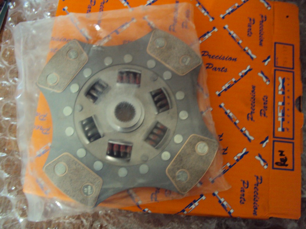

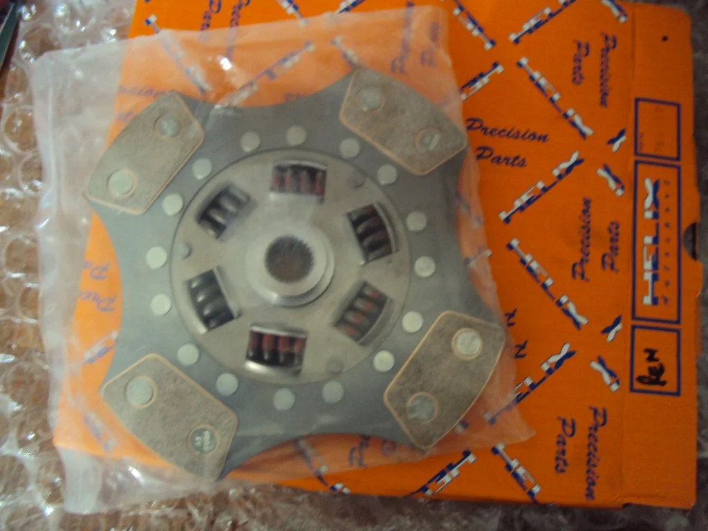

The next logical step was to sort the clutch out. The car slipped the clutch as soon as it rolled off the dyno and had its first WOT session on the road. Timining was retarded slightly to reduce torque, and thats how it ran since.
So i bought one of these...
And put it somewhere in there...

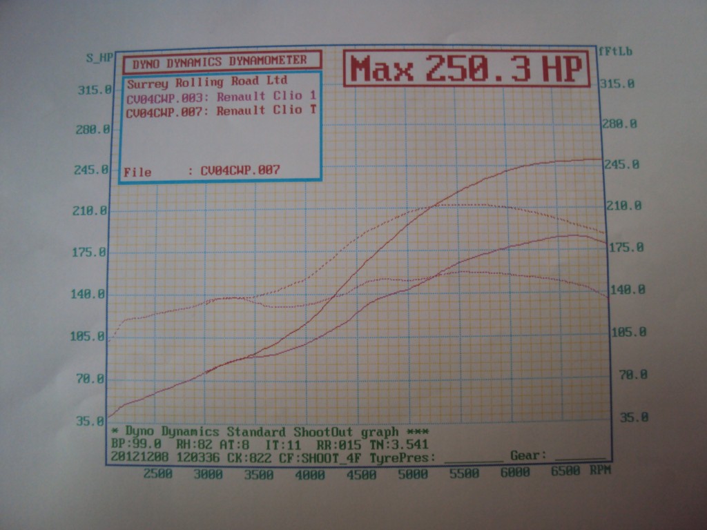

Trip to Surrey RR last weekend. Good results :) Its down on torque compared to Ktec. I think SRR applied a block 20% losses across the rev range, where as Ktecs losses are dynamic calculated from run downs, both therefore acheived same peak bhp at the same peak loss, but anything before that would read low? Might be wrong, but not wholey bothered either :D
Bottom set of lines were when i took it there standard, a nice direct comparison, aswell as having +80ft lb's over stock in some places!

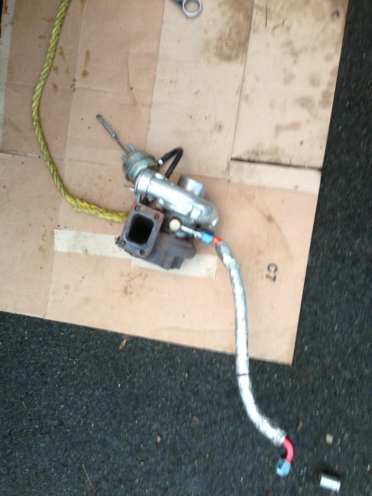

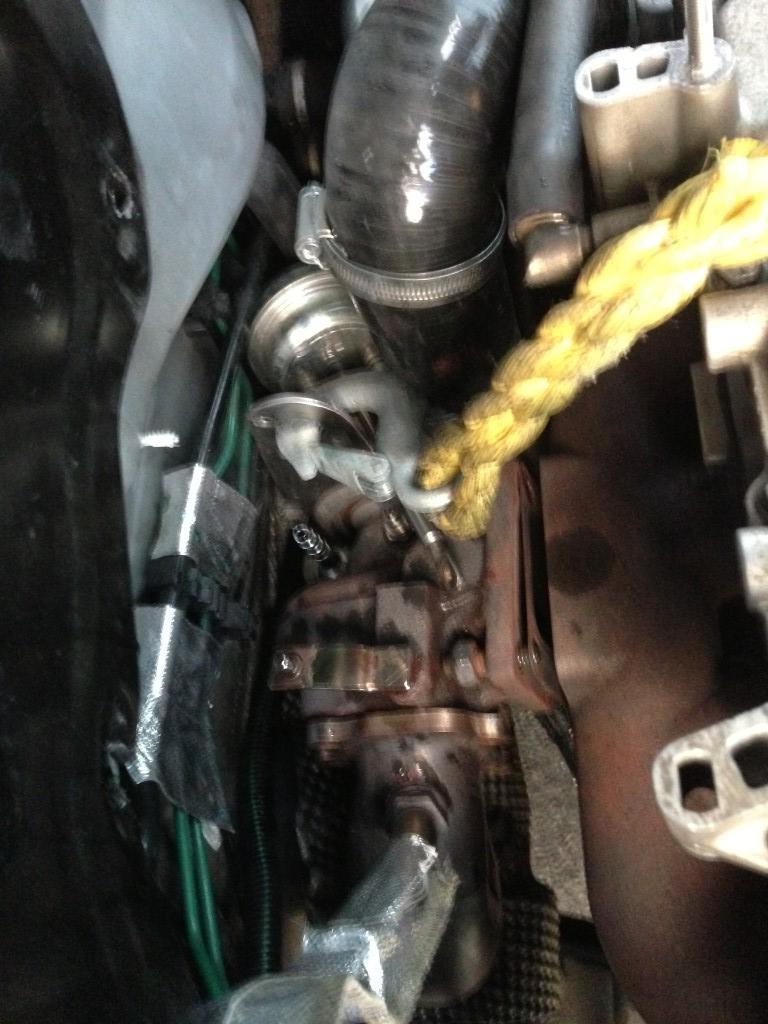

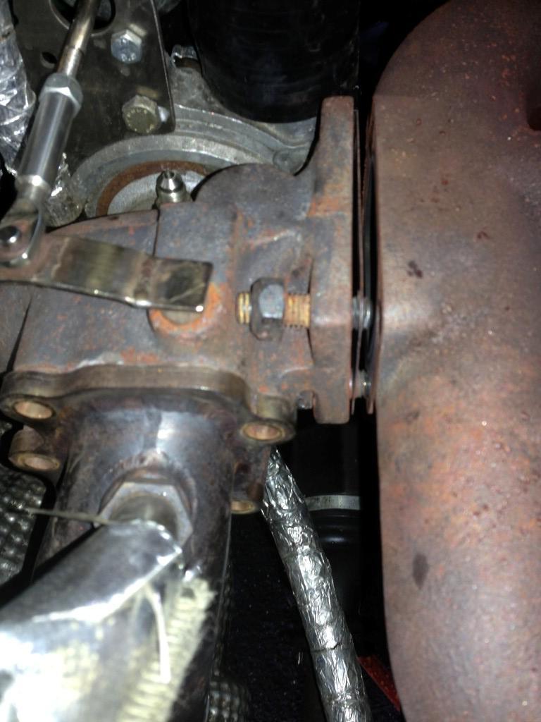

Well nothing much to report, took the plunge to replace the turbo studs and nuts, a good 6-7 hour job at a leisurely pace, not fun at all but all done, i am VERY surprised at the difference a small leak can make betwen manifold an turbo, since ive changed it all it 100% is boosing better, and feeling more torquey, doesnt drop off boost as much through gear changes, i was quite shocked so it made the hours worthwhile.
I'll be makeing a brace to hold the down rigid to the block to stop and flex between the downpipe and turbo should eliminate this problem every happening again :)

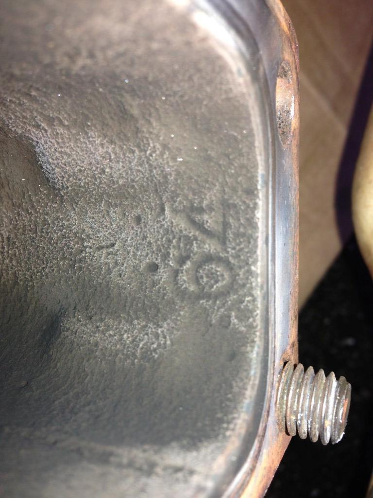

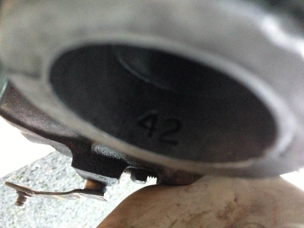

ALso noticed the A/R stamps inside the housing now. .64 exhaust housing, and .42 compressor housing. A few pictures but nothing of real interest (im keeping up this habbit of takeing poor pictures!)
Turbo out after many hours of swearing!!
Leaking oil return, cross threaded, but think ive actually sorted it now :)

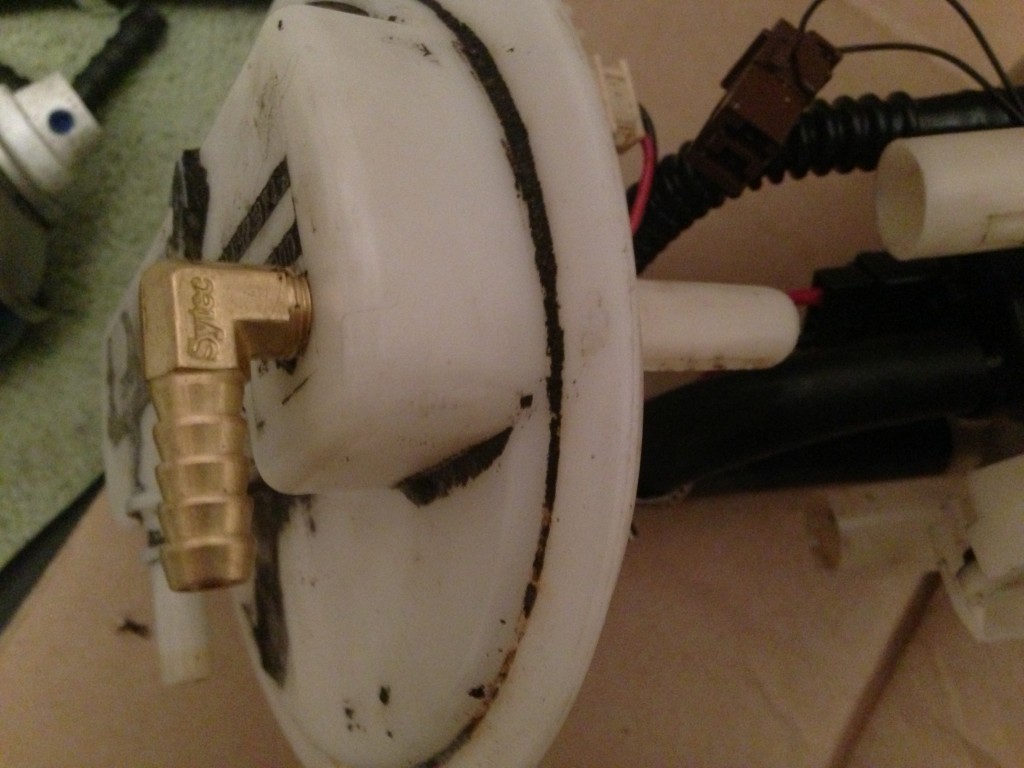

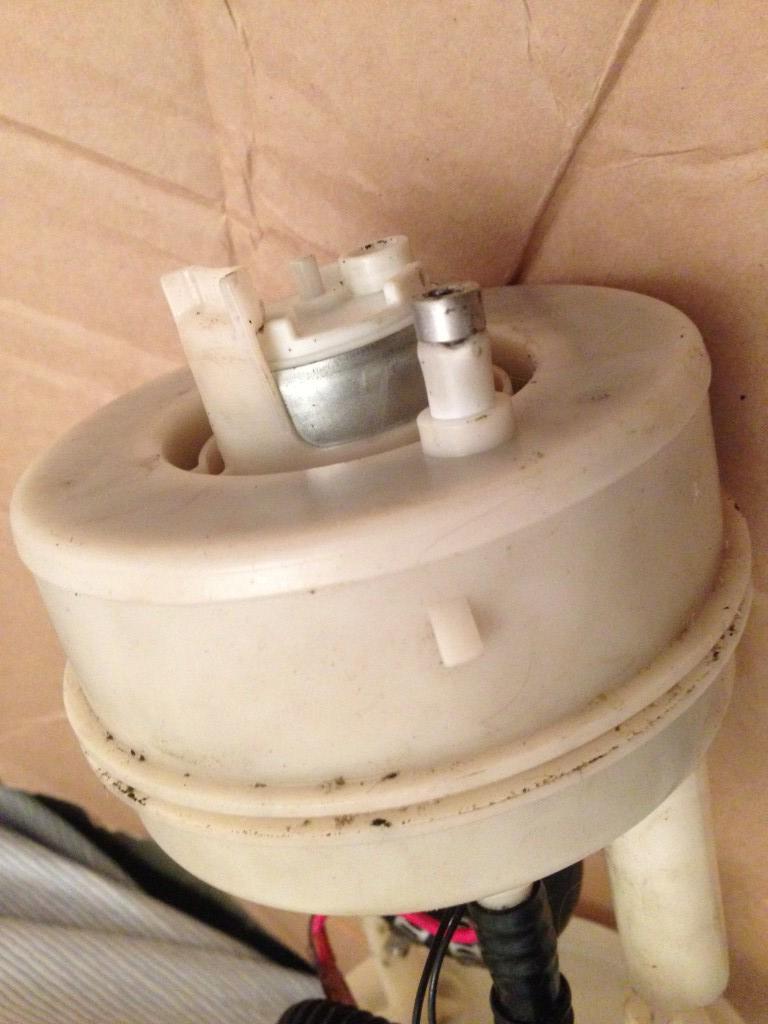

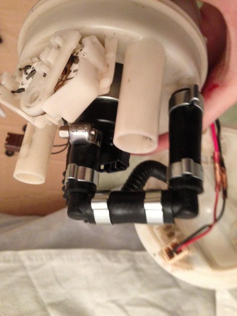

Also finished off fitting my Walbro 255lph pump to a spare fuel pump housing, may be helpful for others as i cant see a guide anywhere on cliosport that helps people fit these. I was contemplating doign a guide, but i didnt take enough step by step photos.
This hole is where excess pressure is vented directly into a regulator. Seeing as i am going to be using a regulator in the rail these needs to be blocked off so the fuel pump "bowl" stays pressurised. An M5 bolt creates an extremely tight fit and should work well.
Next up is actually fitting a return line into the tank, i guess you can get a ph1 which has this inbuilt but.... i didnt. Drill an 8mm hole through the top (use the tube sticking down on the bottom as a guide for a straight hole), then used an 1/8" NPTF tap and just screwed it in by hand (easy as its plastic).
Then screwed in a 1/8" NPTF 90 degree 8mm tail fitting, because the thread is tapered the more you screw it in the tighter it gets and created a good seal, hence no need for sealing washers or the like.

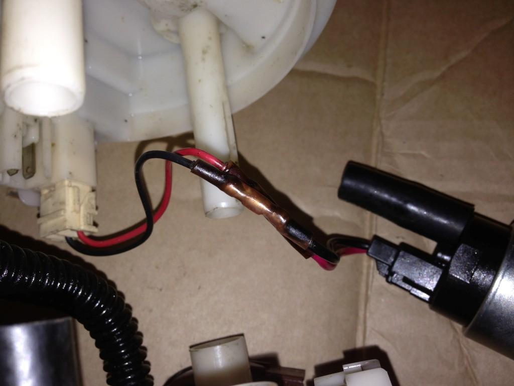

Next turn your attention to the wiring, quite simple chop off old plug and mate it up to the plug included in the walbro kit, exscuse the black marks on the crimps its just carbon from where i used a lighter to heatseal the crimps.

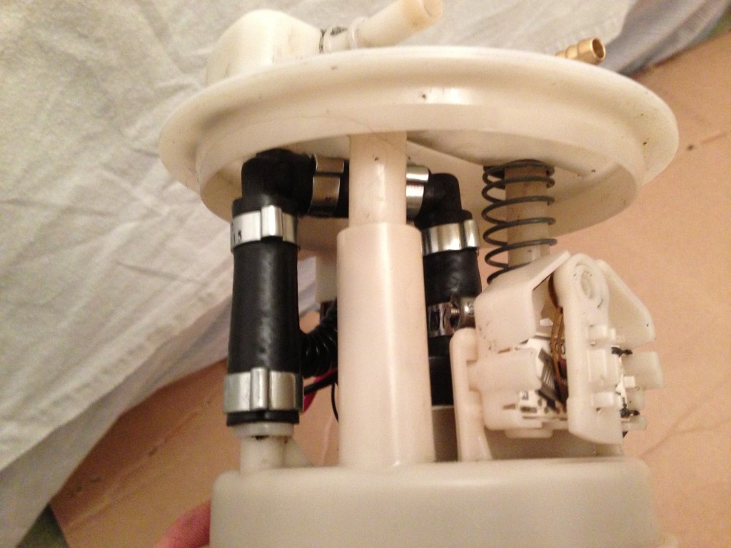

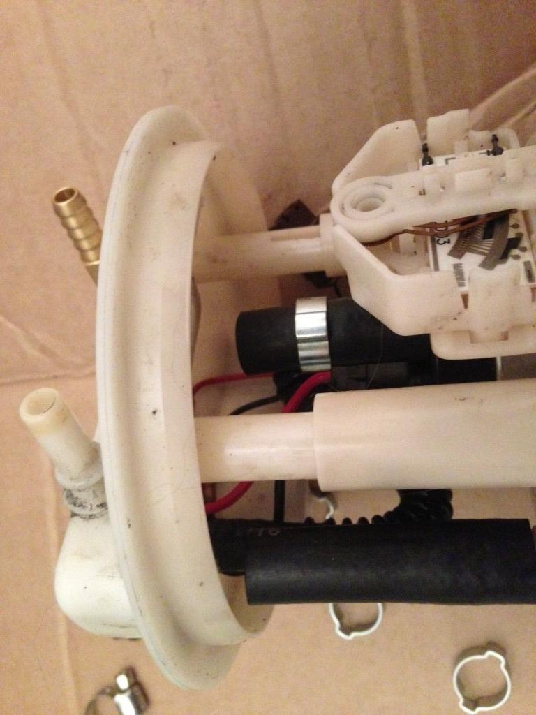

The walbro pump is fractionally larger in diameter and will not fit straight into the housing, you need to file dow the tabs that stick out until they are pretty much flush.
SLot the pump in. At this point also note the filter they give you in the kit does not fit without fouling the pump casing. Bin it and fit the OE filter that... does fit! (straight fit back onto the walbro pump)

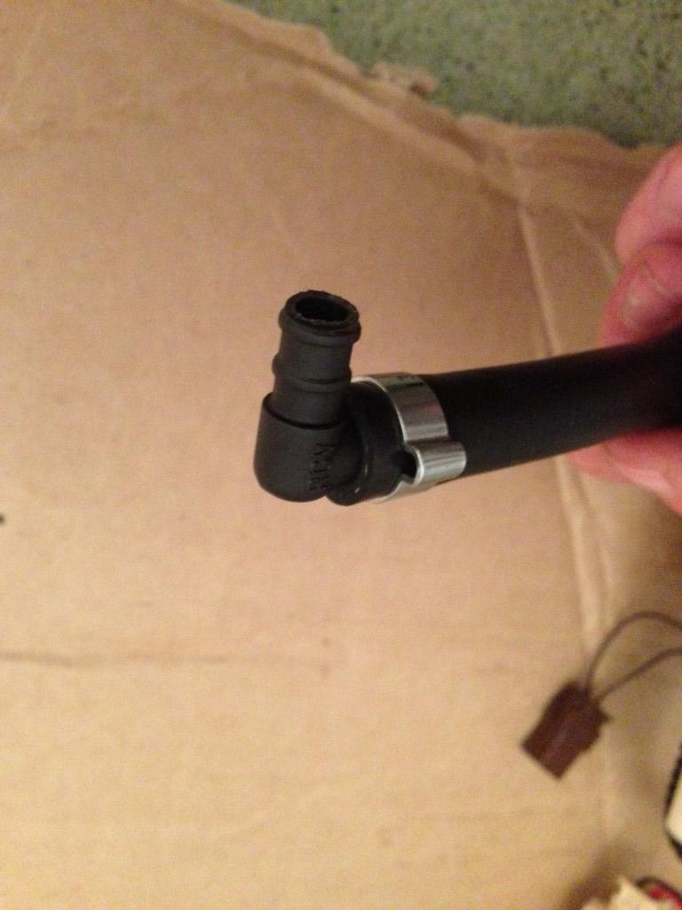

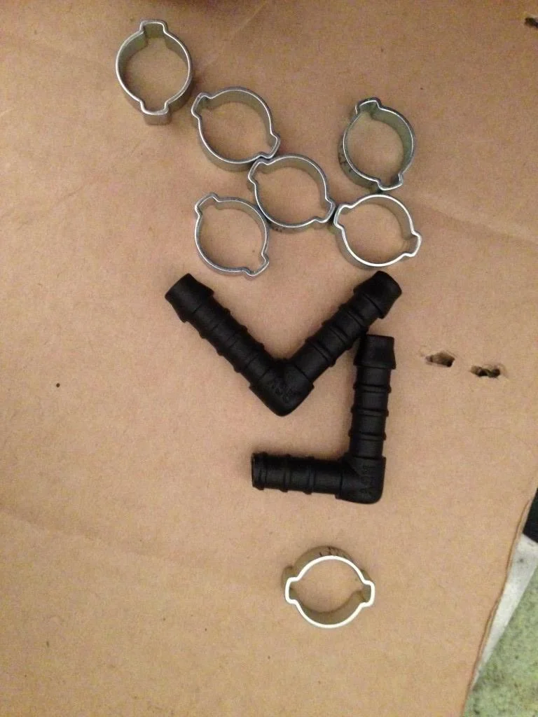

Turn your attention to the top of the pump, youll need to replace the pipe that links the pump to the fuel housing "bowl", this was cut off when you removed the old pump (sorry didnt take pictures of that).
THe piece of pipe they included in the kit... you guessed it, its garbage. You have to flex the pipe over on a small radius, and it will kink and not work, you also dont have a massive amount of head room to fit it. I decided in the end to use some 90 degree connectors instead.
I used 13-15mm O clips on the pipe as i prefer them as a more permanent solution over jubilee clips.
And thats it job done :)

Flol @ that pipework, could you not just find a proper hard plastic hose in the right size?
Im sure it will work just fine though.

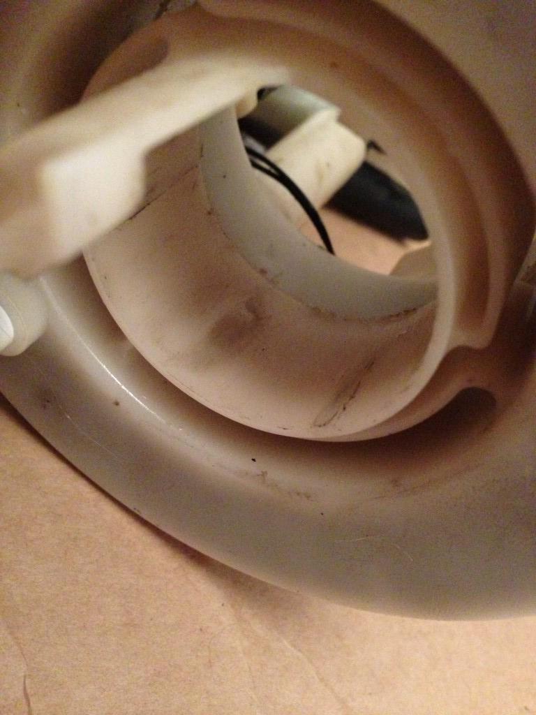

Laine, have you tried pushing the lid down to its compressed position? Its spring loaded so pops up until its installed and held down by the big mounting ring that goes above it.
That looks like it might not have enough room to move.
  HBT 172 Cup
I did think that, but i cant actually figure out why a spring is needed, and why it would only be installed one side? Screwing the mouting ring doesnt cause it to compress in any way?
  182/RS2/ Turbo/Mk1
It pushes down as you install it, the spring is there just to make sure that the top stays in contact with the ring as you screw it down.
  HBT 172 Cup
Gotcha! so is there a platform inside the the tank the housing located onto to sit it square? and then the ring comrpesses down? or does the houising just bottom out on the tank floor?
This is all new to me to be fair, first time ive ever even removed or fettled with a fue pump / sender unit.
  182/RS2/ Turbo/Mk1
TBH I cant remember what the profile of the bottom of the tank is like, I just remember that it most definitely compresses as you install it.

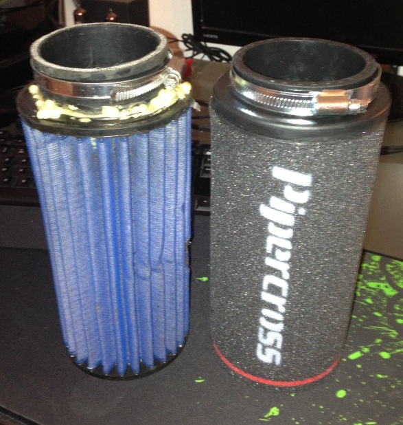

Replaced the air filter today, after i originally ripped the neck off the Jetex filter and glued a neck on, that has now failed and a jubilee clip rubbed through makeing a small hole.... its now seen better days lol. Wasnt impressed with the build quality in general.
Contacted pipercross who knocked me a filter up with identical dimensions, made much much better so stuck it on :)

Dealt with PiperX in the past always a pleasure to spealk to !
Looks like they have done a good job for you dude!

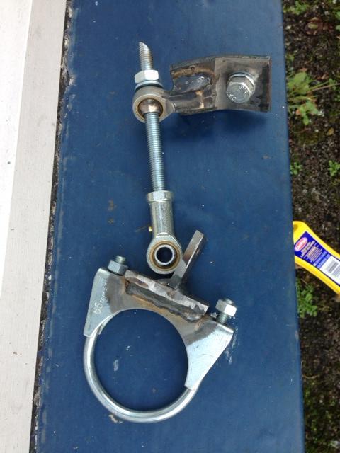

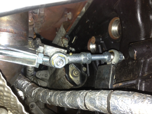

I made a bracket to brace the downpipe to the block, the block mountin point is not ideal (single mount point), I've had it on a couple of weeks without issue now and it seems to help. ill improve it when the engine is back out, but its not important at the mo.

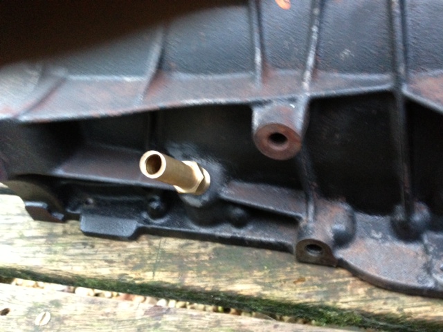

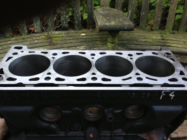

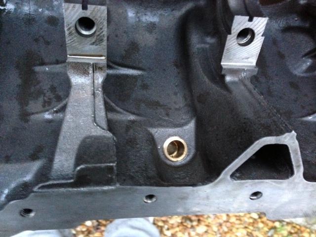

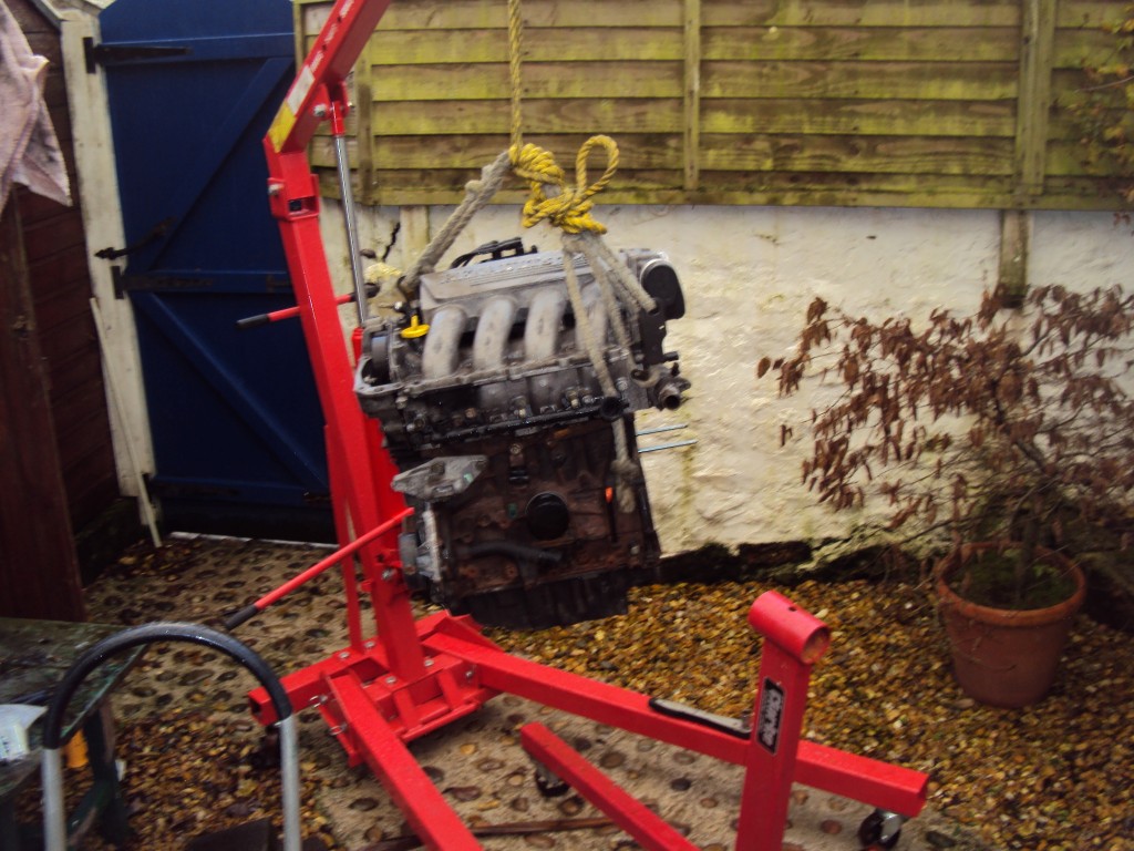

Got engine black from the machine shop all freshly honed, got them to tap and drill me a proper oil return aswell to rid me of the leaking mess i have at the mo.
Main and big end bearings and thrust washers have turned up aswell as a new set of ARP 2000 bolts. Im hopeing to get the pistons and crank bolted in at the weekend if the weather is kind enough :)
From there it should only be another month or so before its ready to drop in (want to strip the head, lap the valves and check thats all ok).
