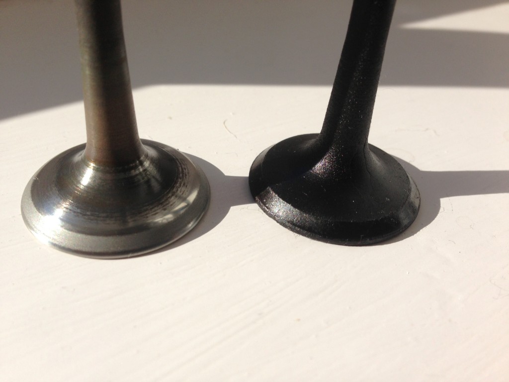

A day of refurbing valves ensues! I always find the exh valves of every F4R engine i've seen are always reasonably pitted on the exhaust valve, takes a considerable amount of time in a drill and lapping to get them back to perfecto :)

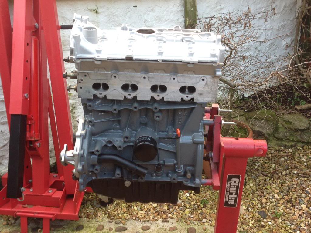

The engine should be 90% built by tommorow :)
  HBT 172 Cup
Almost there!!

172 bottom end, Meggy 225 pistons and rods, ARPs, new oil pump, shells, gaskets e.tc and PH1 cylinder head. Full closed loop ECU boost control.
Produced 275bhp / 260lbft at actuator pressure 0.75bar. Full power set to 1.25bar approx 330bhp.
