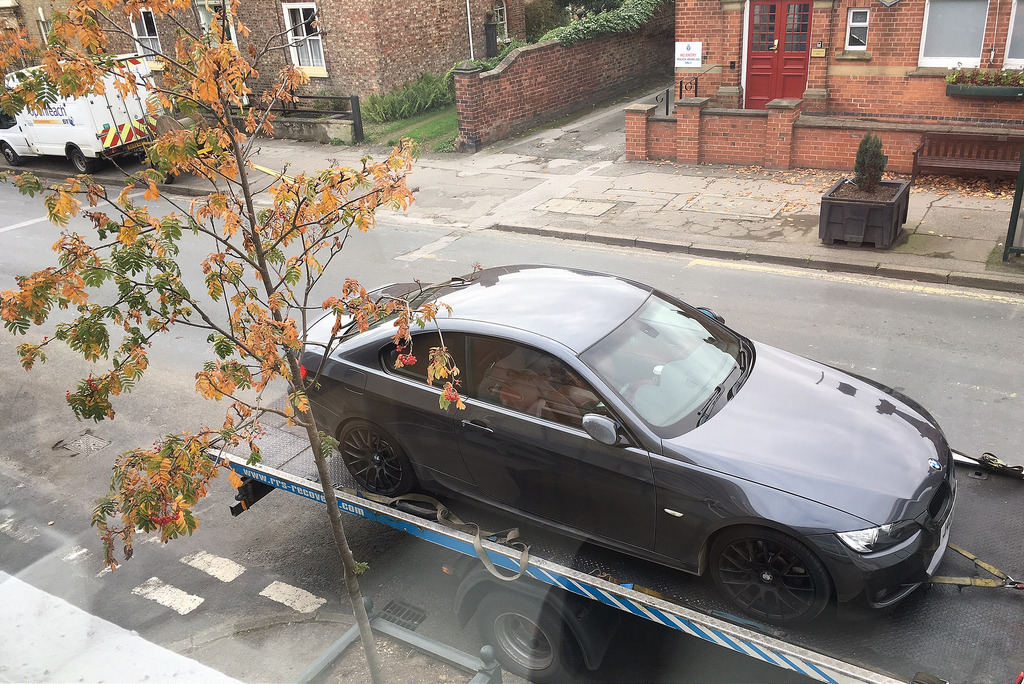

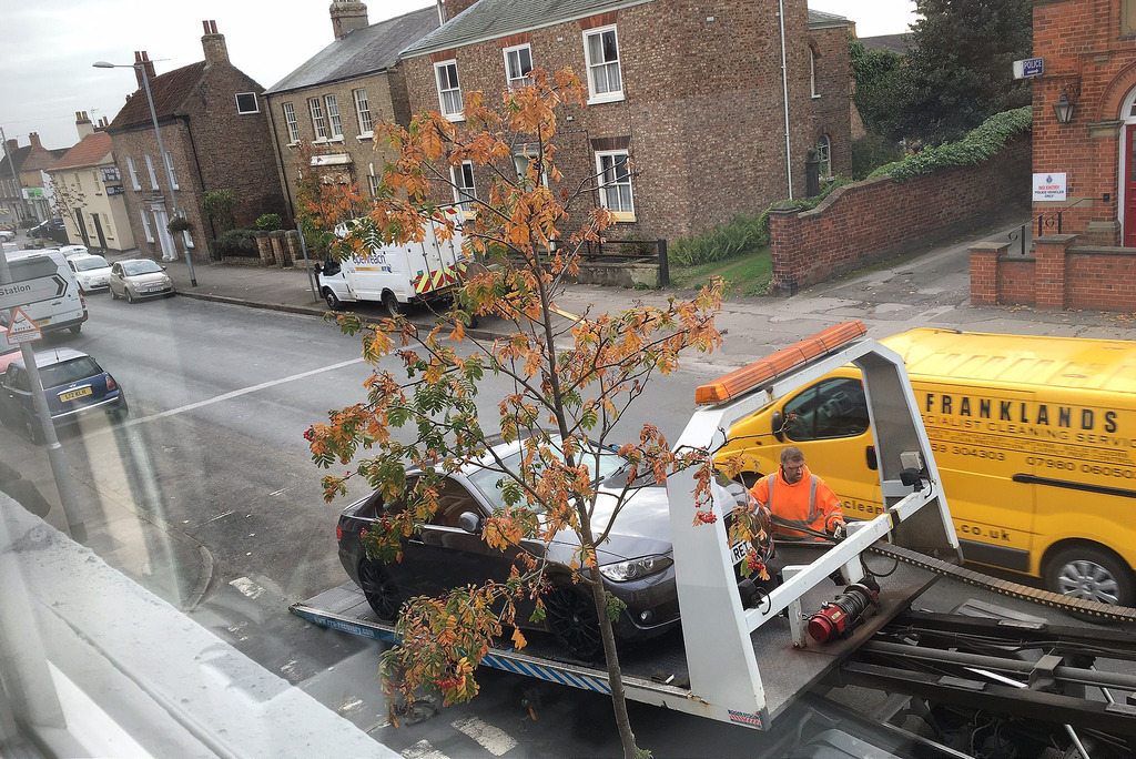

Wife just got dropped off at my work, to collect my car. It won't unlock/start. FML.
BMW are sending a recovery truck now.
Great start to the weekend.

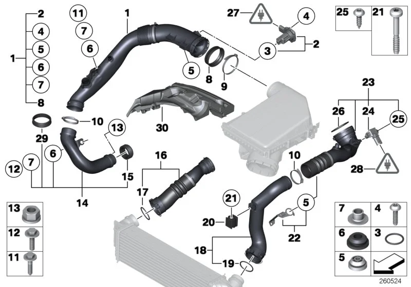

Just got a call to say the turbos are missing an intake pipe heat shield?! The part is on back order from Germany :(
What is this shield? Why isn't it there? Was it missed when they replaced my turbos 10k miles ago?

Stops the exhaust manifold melting the intake pipe form the airbox. It should be there. Perfectly usable without it though. Part 30 on this image.

Thanks for that, that's really useful!
They've confirmed to me that the intake pipe has infact melted, so they need to fit a new pipe too.

Melted and split or just melted? Could have been sucking in unfiltered air.
They've just said 'melted' to me.
You know what it's like, they're never going to be 100% honest with me, so I've no idea what's going on. They've admitted it though (they could have blamed me I guess), so that's a good start.
It seemed to be running fine though, can only hope it comes back even better (unless they forget to fit the turbos).
