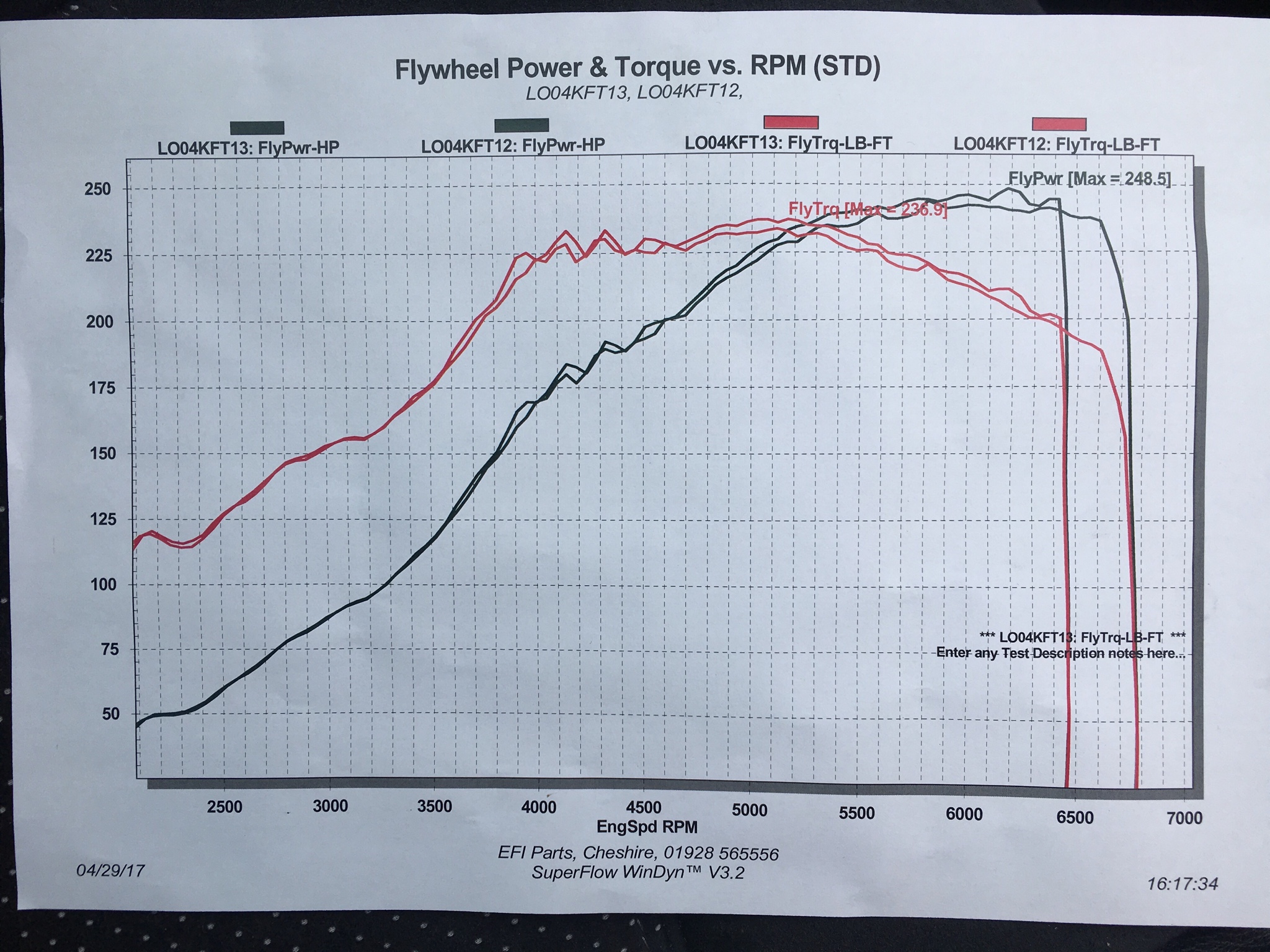

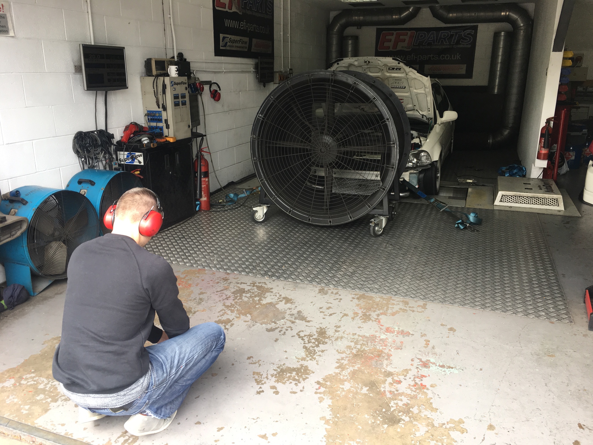

So, 'popped' up to see chris@efi with @DV8 mainly for mapping on his EK9 turbo, had mine on the dyno to see if all is well with it after my new exhaust and it was perfect.. still great power and nothing needed!
248.5bhp/236.9ftlb

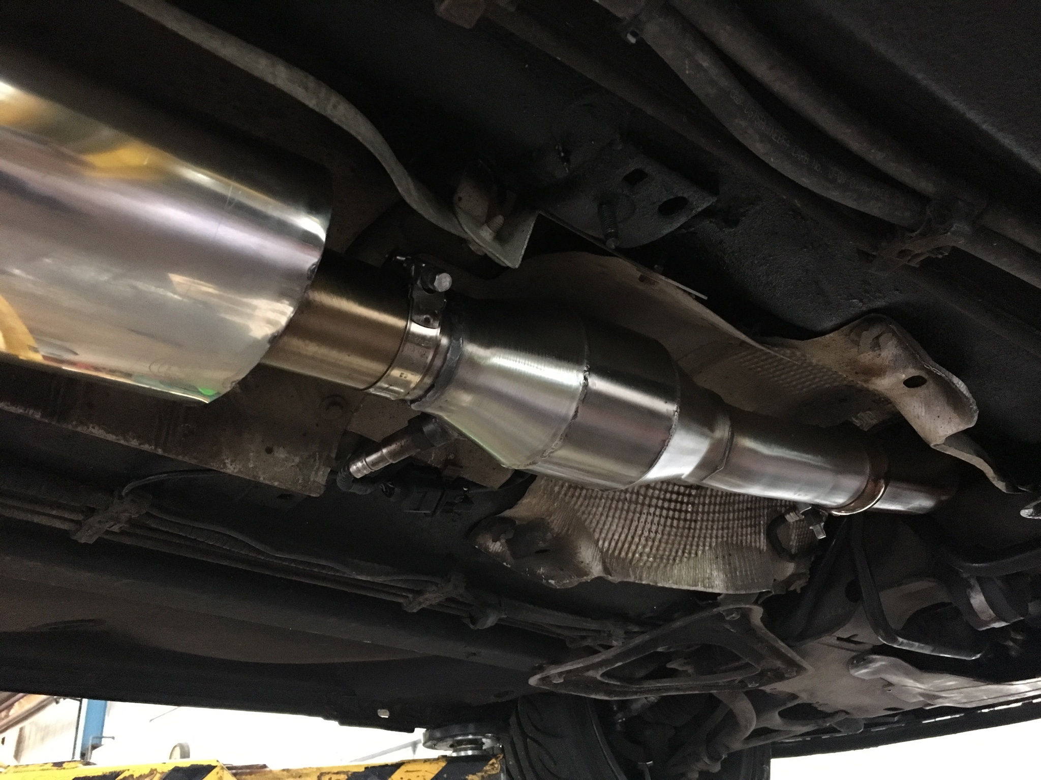

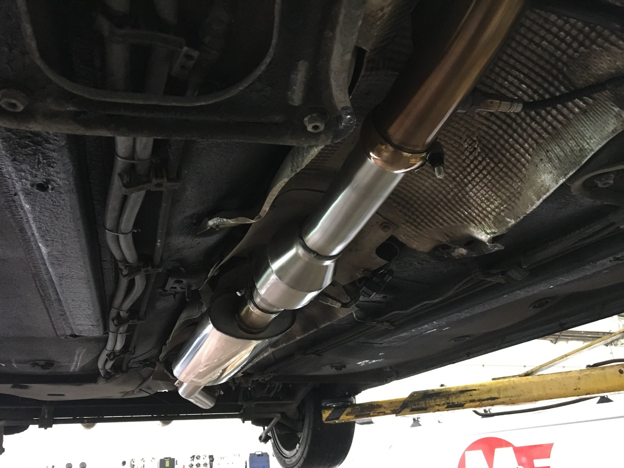

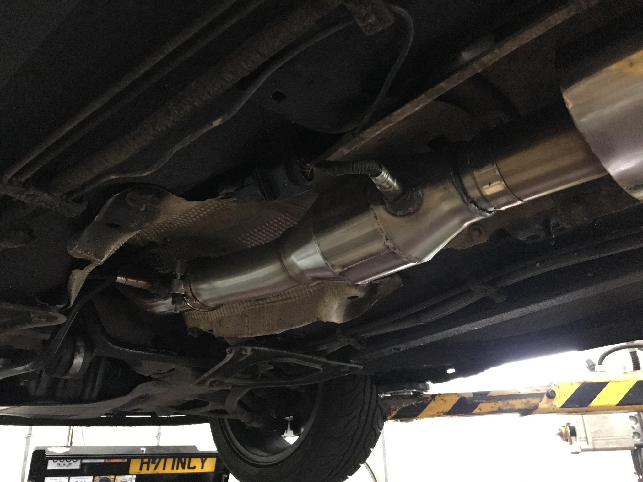

The guys at Phoenix custom exhausts are awesome, I messaged them about the car being a bit too boomy inside when at low revs pottering about so asked them if they could make me up a silenced decat - this came in the post, all custom made. They didn't charge and it fits a treat... and most important it's just taken the edge off the deep note from the exhaust!
Highly recommended guys! [emoji106][emoji106]
I may have missed this in previous posts but have you had any problems with taking away the pre cat gasket and fixings? I assumed the springs and that had to be there to give a bit due to engine movement etc. Seems much better to do what you've had done than constantly have to mess around with gasket and fixings as I'm having to do now.
I may look into a silenced decat like yours for mine, wonder how much they usually are....
That's awesome, how much was the system in the first place? I want a 3" system.
Hi mate, the system itself is very light and the rear mounts allow for plenty of movement, I have a brace on the downpipe to the back of the block so it takes away any kind of strain on the turbo and downpipe... plus the usual polybushed dog one so there isn't anything to worry about [emoji106][emoji106]

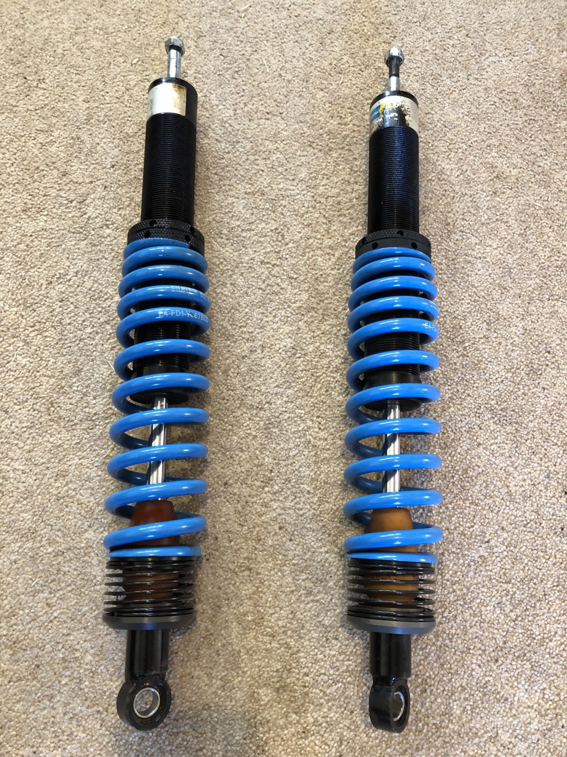

First up was to address the spring rate slightly upfront to stop the springs going spring bound on the carousel, so after a few chats with Nick at Pure motorsport I decided on some 450ftlb eibach springs to suit my billies. After fitting I found a really annoying creaking/squeaking sound.... after a lot of messing about I found the front dampers had an issue!! So off to David Masters at Bilstein UK...
Spoke to David about the new spring rates I had and we discussed having my dampers dyno’d for better mid range damping to further improve the issues with going spring bound, so while they were being rebuilt he did that.

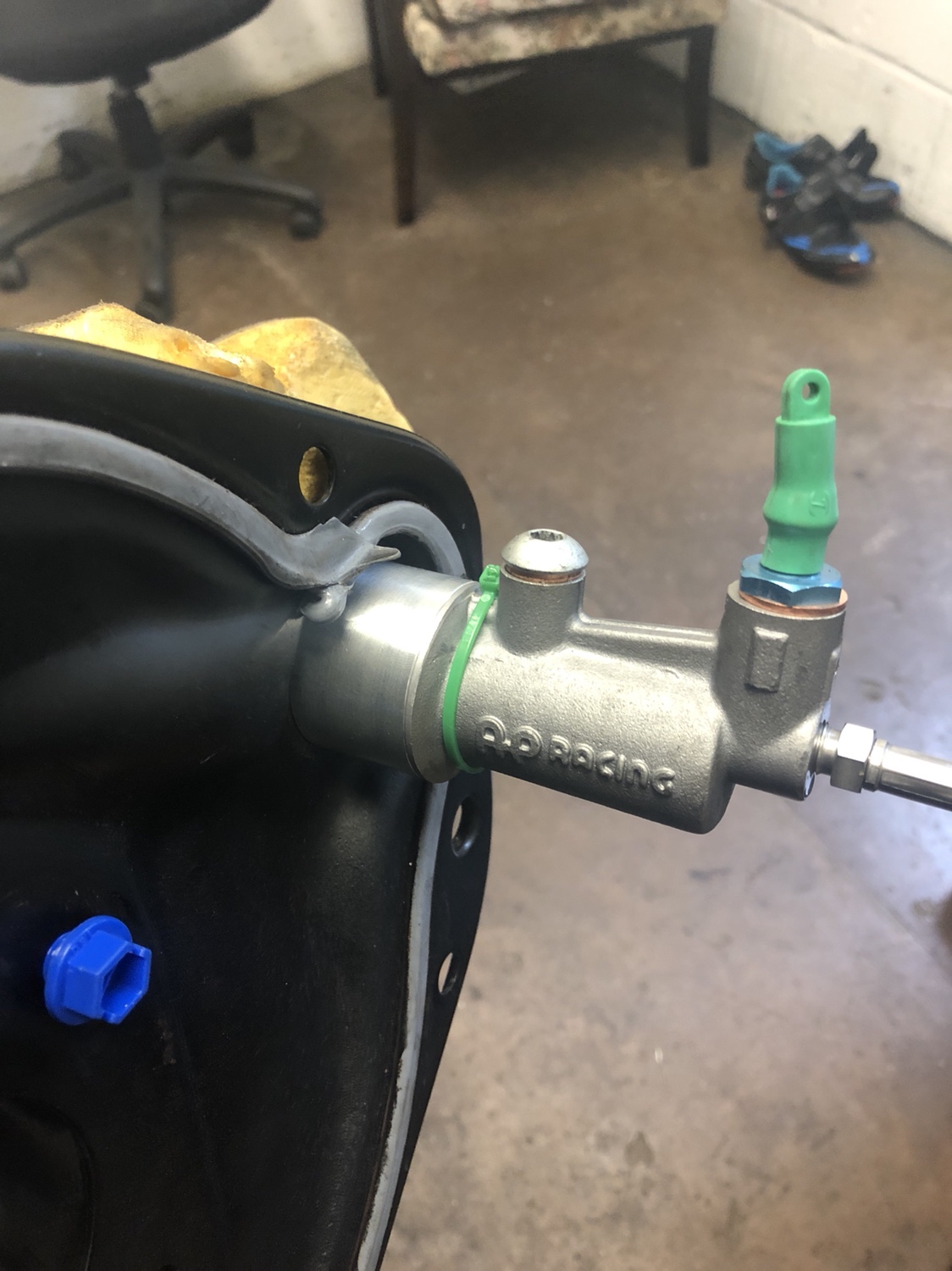

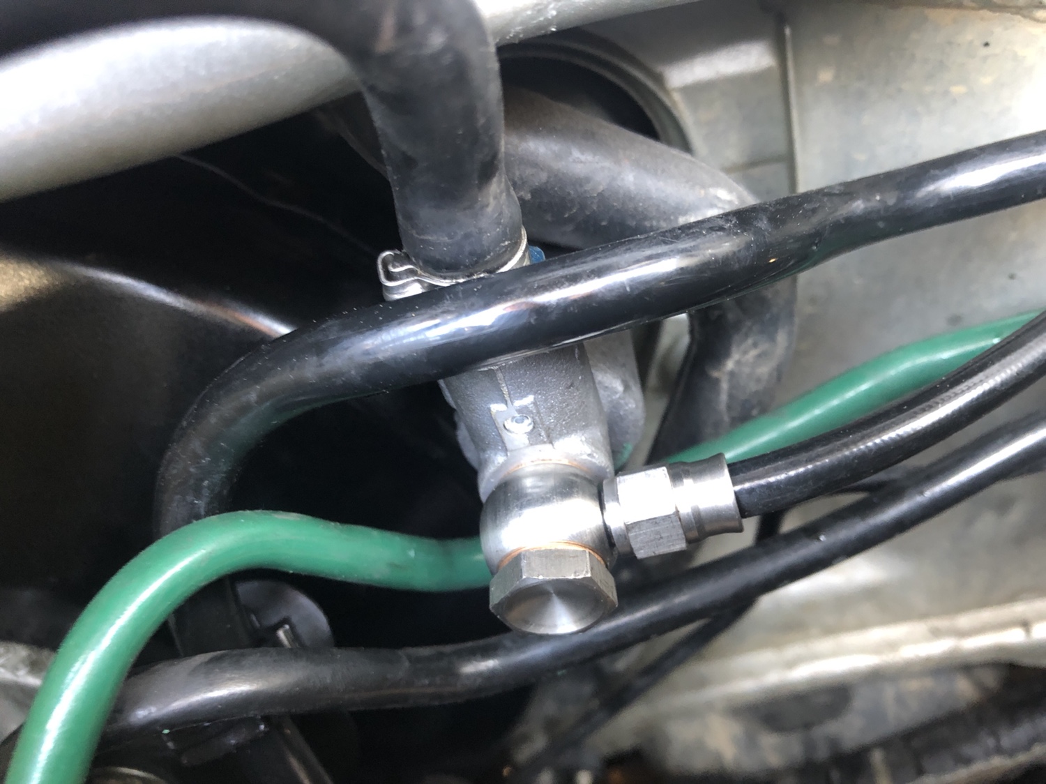

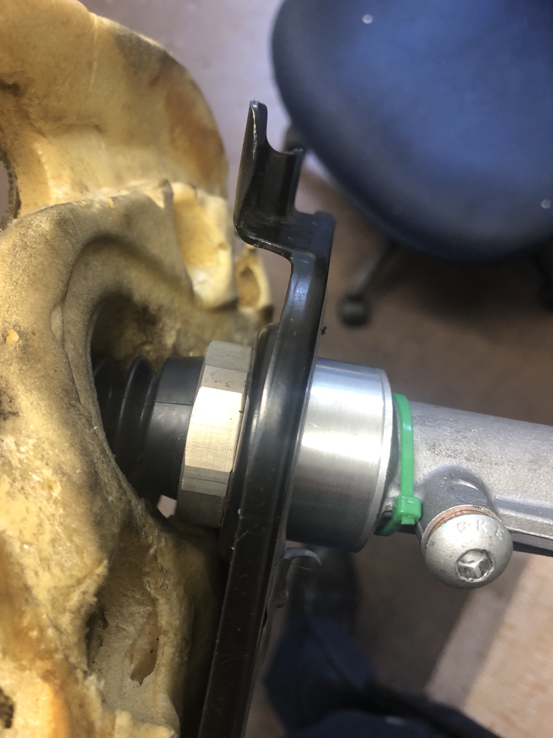

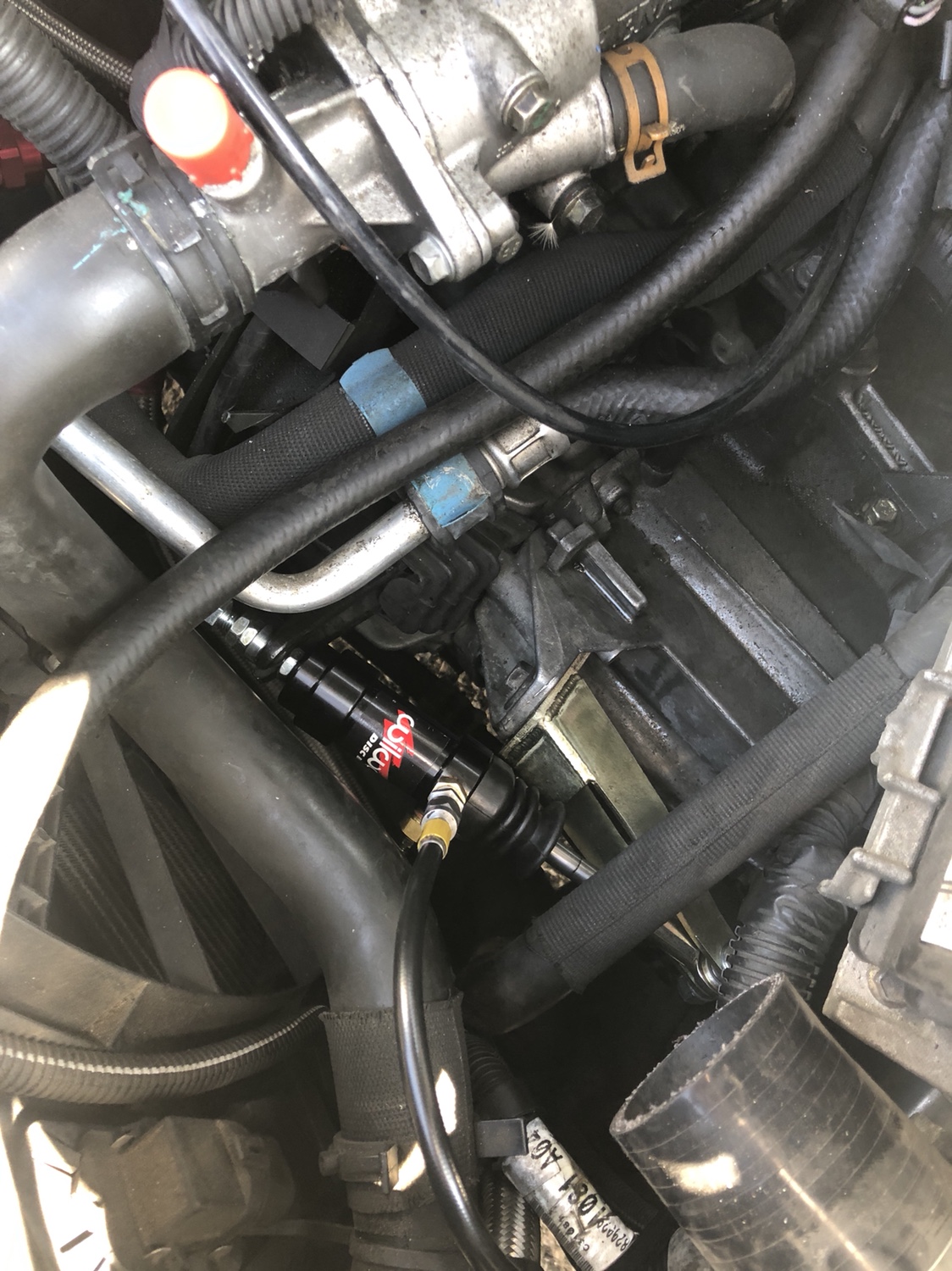

Got some prep to do on the Clio, nut and bolt checks as per but I’ve just ordered an AP racing master cylinder to go with the PMS hydraulic clutch conversion.. trying a setup with the DCI 100 Clio pedal box so hopefully I can get that all working nicely!
Will update...
I’ve got a Sachs performance clutch mate and I’m not a fan of the high bite point on 182 clios and it’s heavy as hell.. also just like tinkering!
Cracking idea tbh mate! Mine is so light with the hydraulic kangoo set up. Makes driving very easy but at the same time it's incredibly grabby. I did away with that dampener though which doesn't help.
Yeah, I’ll see how the setup feels without a damper. What clutch do you have?

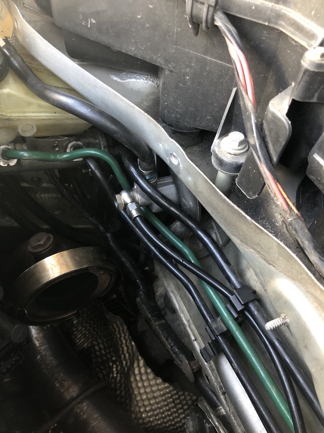

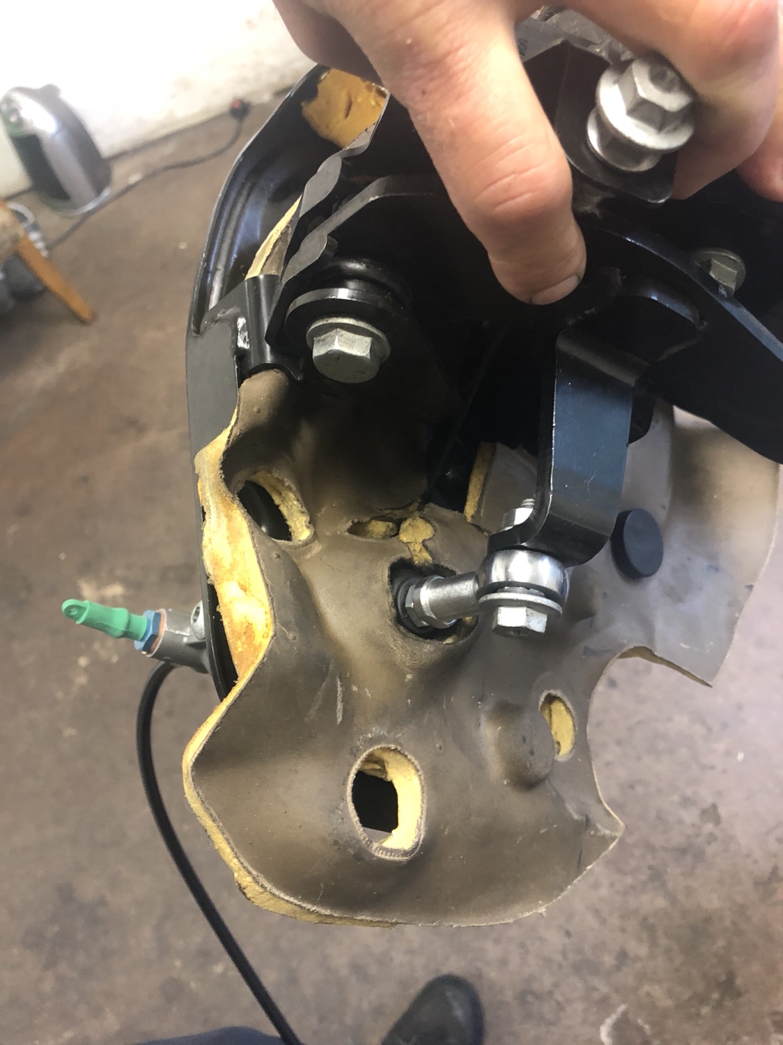

Little update on the hydraulic clutch... I’ve got it all mounted to the standard pedal box and have a braided line ready to go... ordered the bracket and slave cylinder so will give it a trial run soon.
Finished my hydraulic clutch just before our ring/spa trip... what a massive difference it made!
Gear changes up through the box on hard acceleration has been a slight issue when on track for a while, a bit like the cable wouldn’t dis-engage the clutch quick enough and dragged slightly... especially 3rd to 4th. This issue has now been totally sorted and can throw it into gear and down shift soooo much better!
Possibly a new clutch cable may have solved this but I wanted a lighter shorter clutch throw. That’s exactly what I now have!
