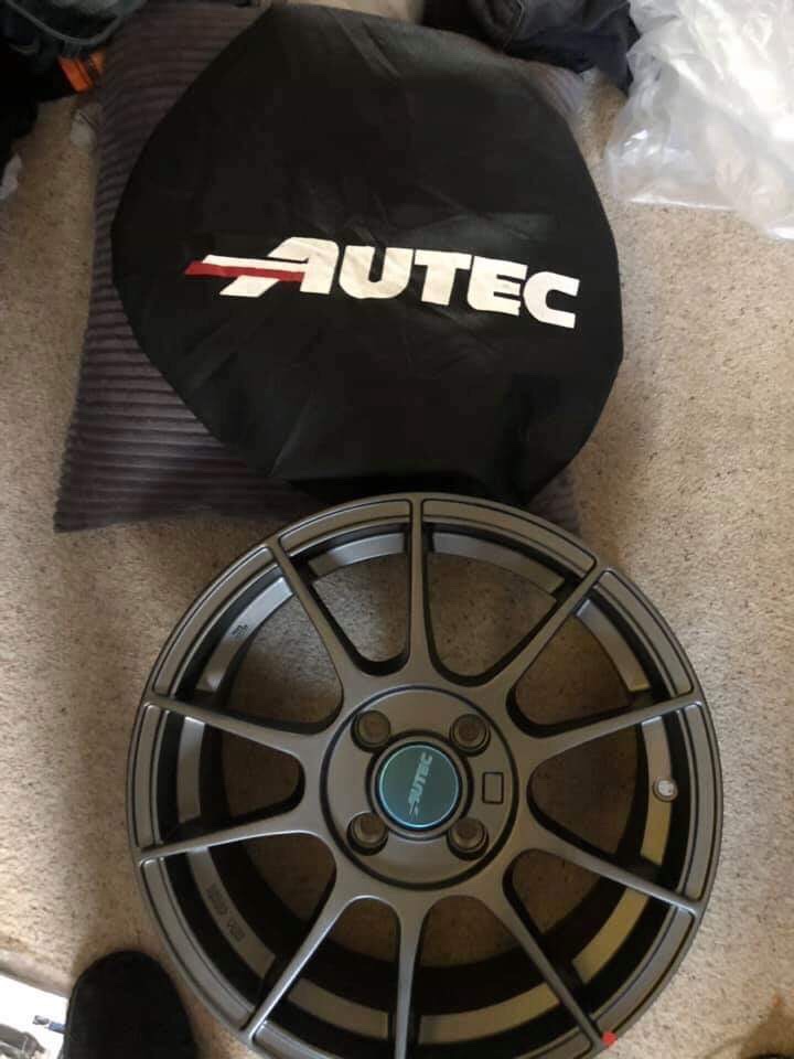

Couldn’t fit 15” over the 300mm front disc/Brembos setup unfortunately.. I have seen some very nice light wheels about lately.
These are nice but not actually that light.. the classic speedline turinis or OZ ultraleggs always catch my eye too!

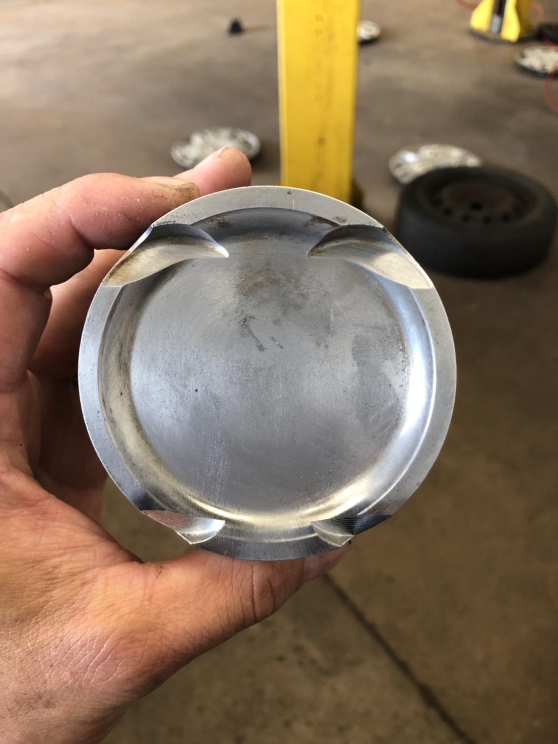

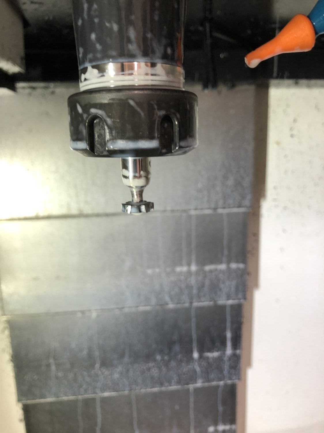

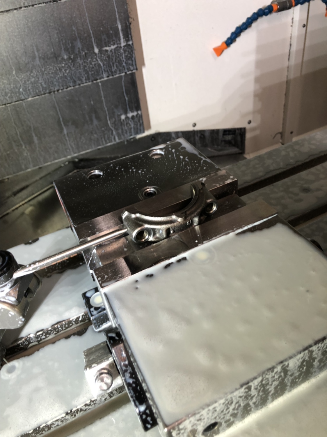

Hi guys, been quiet on my build thread for a while... car is still going strong.
I’m about to embark on the next stage of my engine for this years Nür/spa trip.

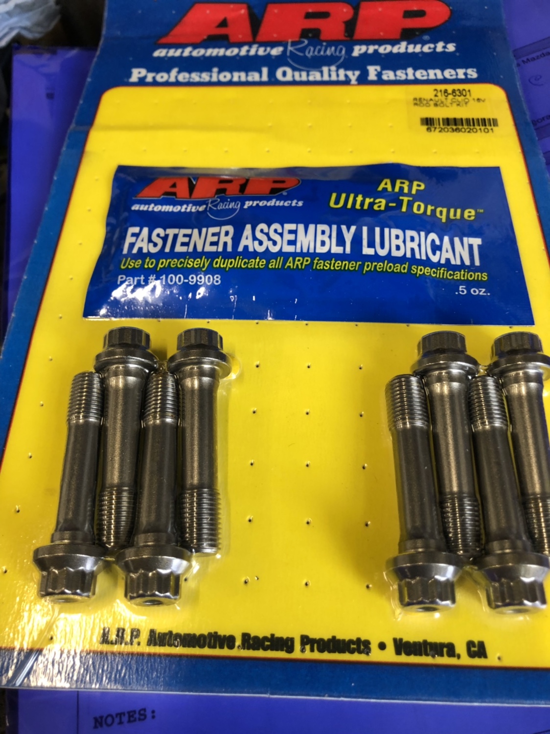

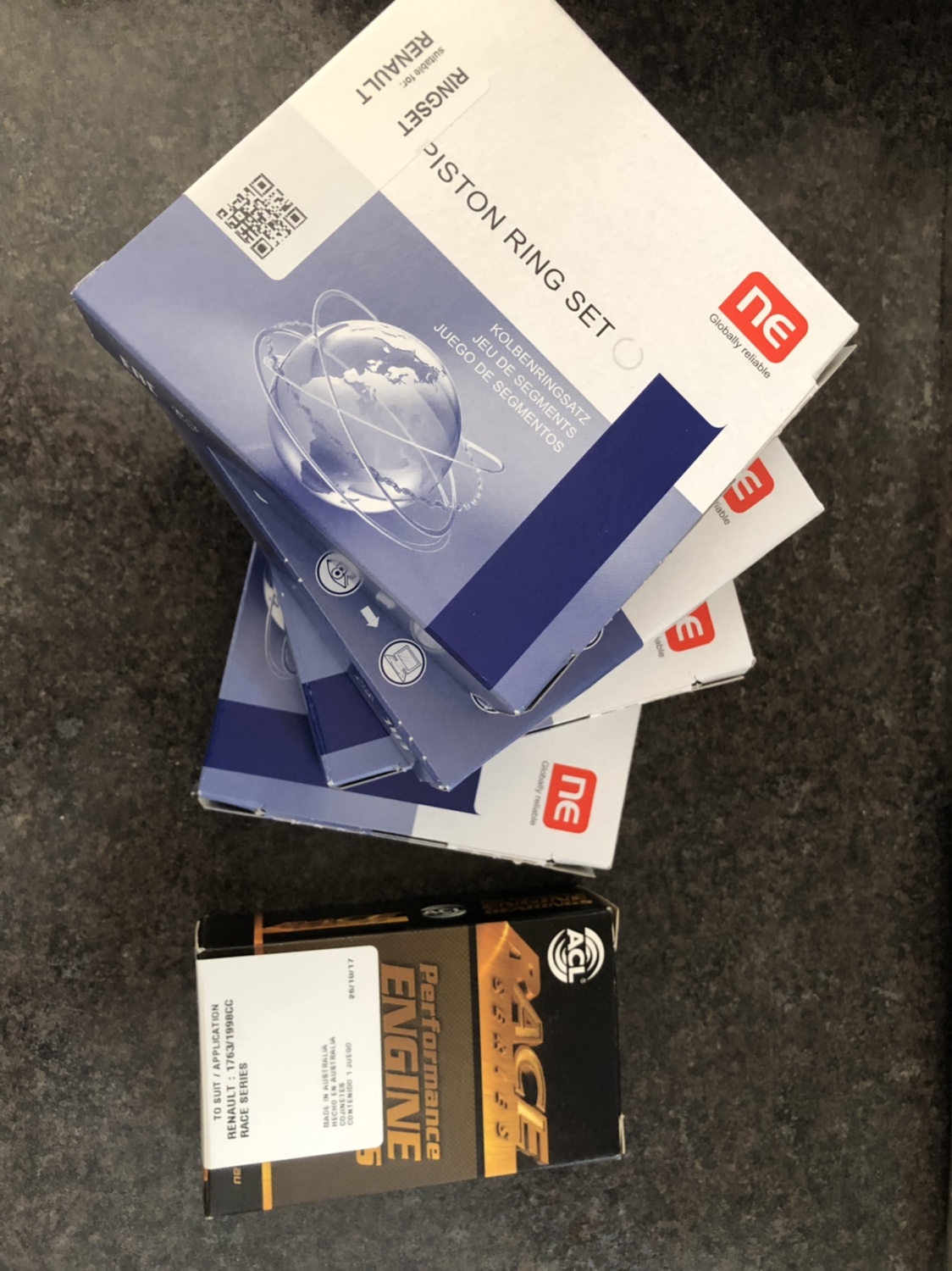

List of goodies are,
Supertech inconel valves.
Megane 3RS pistons which have been pocketed on the exhaust side.

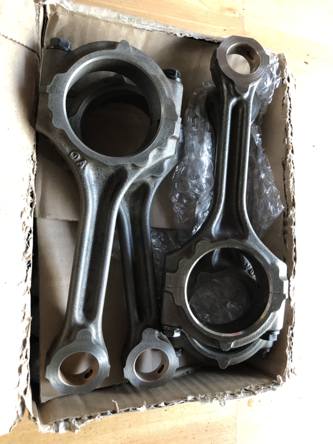

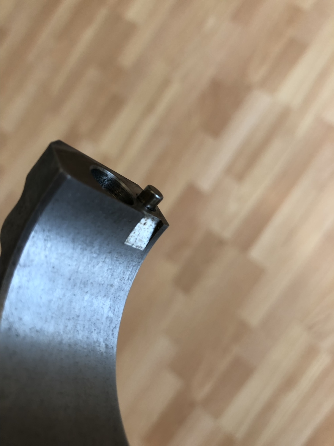

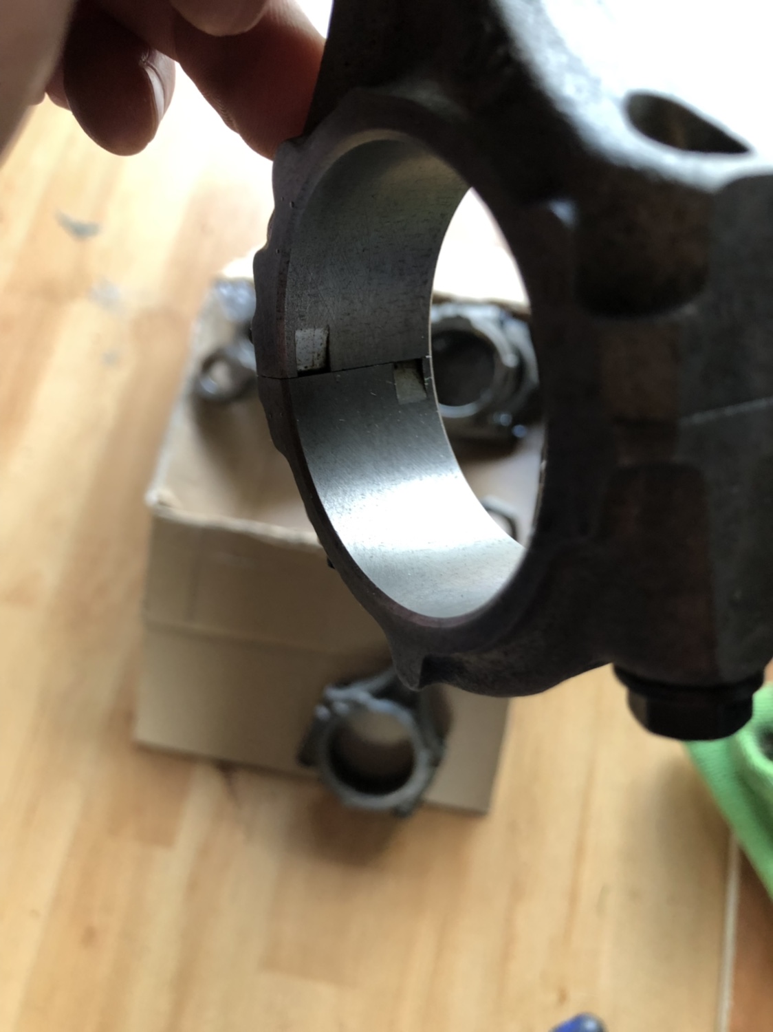

Megane 3RS rods with grooves machined to take tabbed type ACL bearings.
New Rings.
New head set.
Timing belt kit, aux belt kit and dephaser.
It’s not about shooting for massive power, it’s more about prolonged engine life.. after 5+ years of a relatively high powered, low boost setup I keep feeling like something could give. Be it a valve dropping, which is becoming more common now or a rod letting go etc.
It could go on forever in its current form but I like playing anyway.. I don’t think anyone has done what I’m doing as they all go forged.
I’m not going down the forged route, as a daily and a track car a forged engine wouldn’t last long with cold starts, short journeys etc.
It’s basically going to be a hybrid meg 3 RS Clio 182!! It could obviously have the scope to go to near the power of a mapped meg 3 RS but that would ruin the drivability of my car so I’ll see what works well on mapping day... would like in the region of 280bhp 260ftlb which is a fair leap from its current 245/235 tune..
I’d like to keep my gearbox and current Sachs racing clutch happy also [emoji3061]
I also won’t be upgrading the T25/28 hybrid yet so that could be a limitation for now. Will see how that goes.
It should be around 9:1 + compression with the standard Clio 182 gasket which is slightly higher than a standard meg 3 rs which is 8.4:1 I believe.
Going to be an interesting month, will update with pics and results. [emoji106]

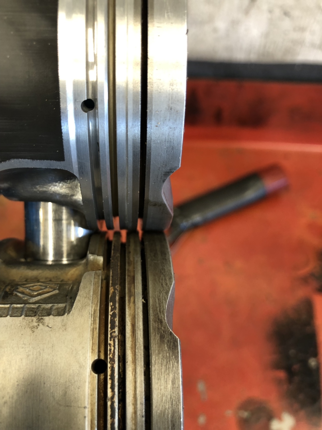

Nice to do something different to what everyone else does. Watch for ringland issues with the pistons as winding in too much boost to them is fatal.

Cheers mate, I won’t be going crazy boost. The meg 2 RS pistons were more problematic than the Meg 3 RS pistons I’m using. I’m just about to start it all after compiling my parts, sourcing rings etc! A company called MAR MOTORSPORT were able to get my rings [emoji106]

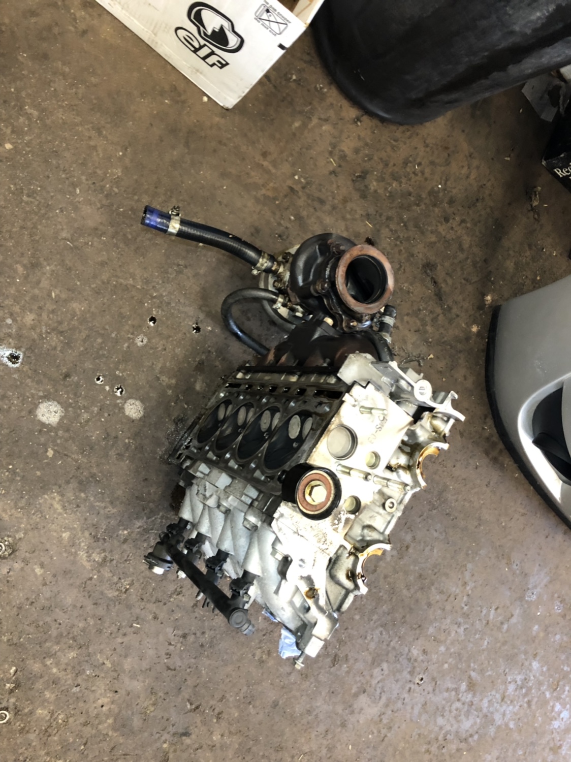

And yes it has been absolutely reliable, it’s had some serious abuse too. Feeling a little bit sad about pulling it apart again [emoji20]

Seems a shame to open this up, but it’s worth it for peace of mind.

Yeah I was nearly in tears mate, when the head was off you can see how well it had been running, looked perfect.. the bearings etc were all like new [emoji30] as expected of a 70k mile engine!
But like like you say, peace of mind and I don’t have to worry about a valve dropping either!

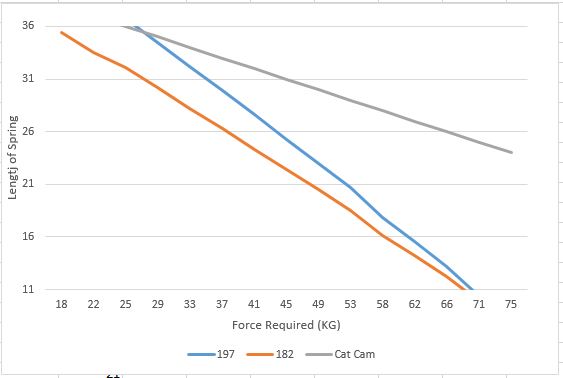

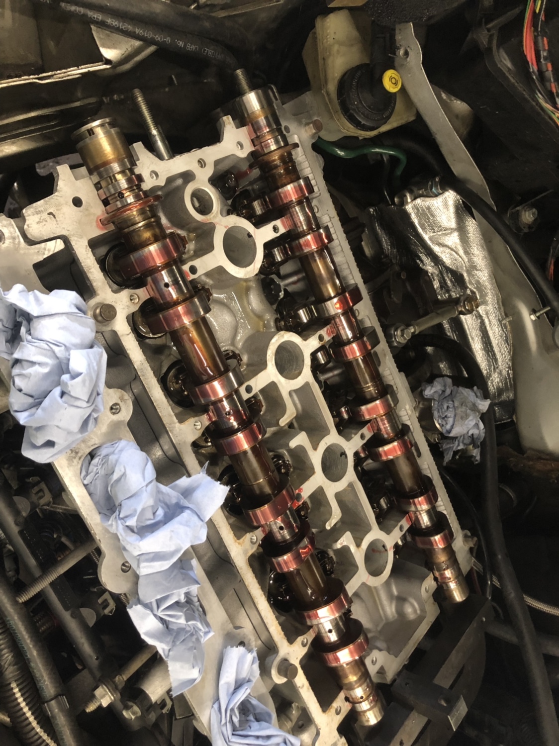

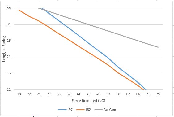

Ah yeah now we're talking. Did you do the hone yourself dude or get it done on at the shop? You putting in 197 or cat cam springs in? Not that they're needed but they can reduce float, particularly the cat cam ones but the more cost effective 197 ones too.
1420583
Nice to see this just being done so quickly but clearly a lot of planning has gone into the work which I like!
incy-spider
It took a lot of planning to get things all together, lots a waiting too.

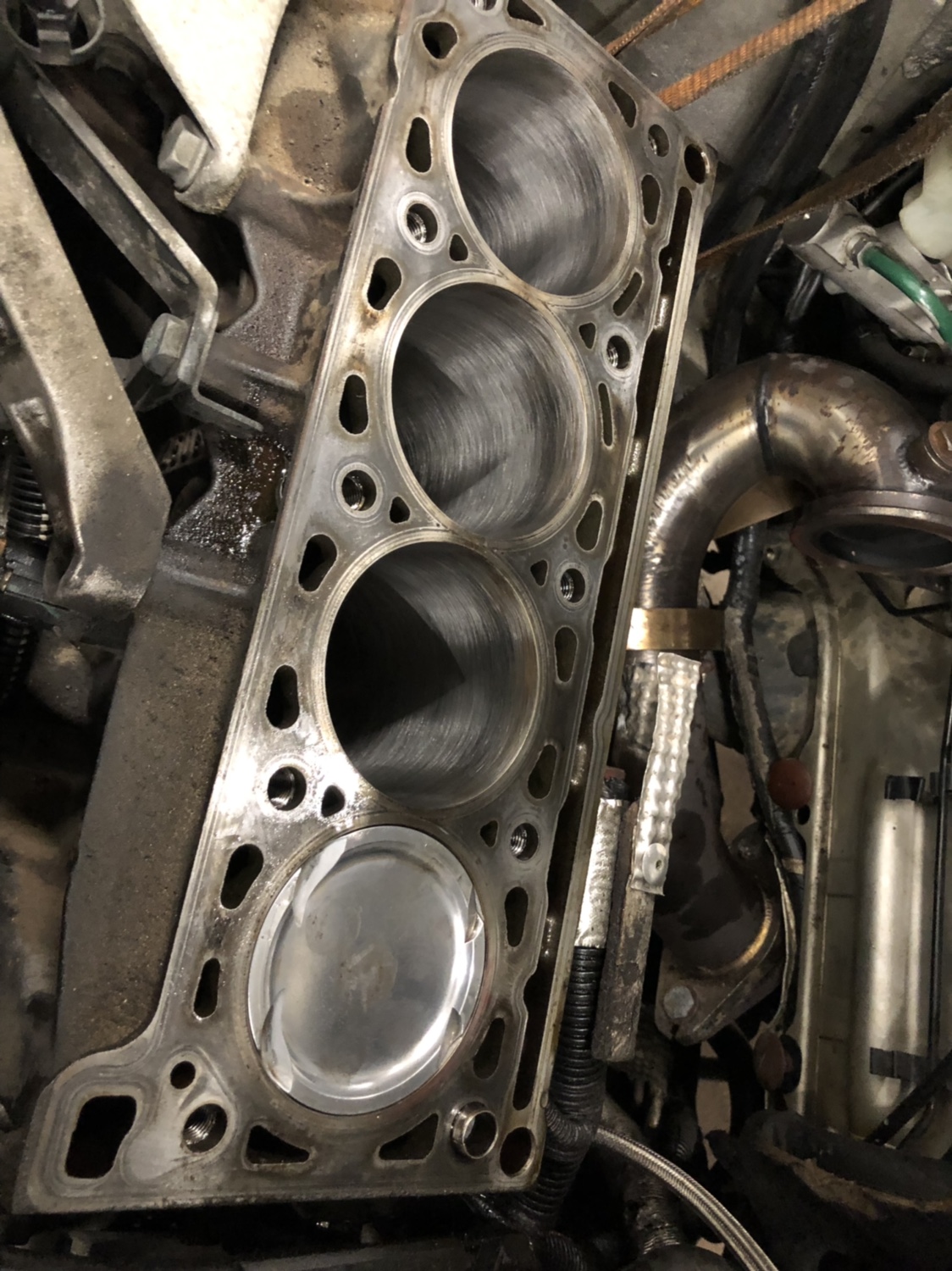

I did the hone in place, the pictures actually make it look quite rough but they are perfect and it was only very light!
Spring wise.. I’m using the standard springs but with the pure motorsport shims under the valve stem seals as I’ve noticed on the supertechs the collets groove sits about 1.2mm higher than standard which would reduce the spring rates..

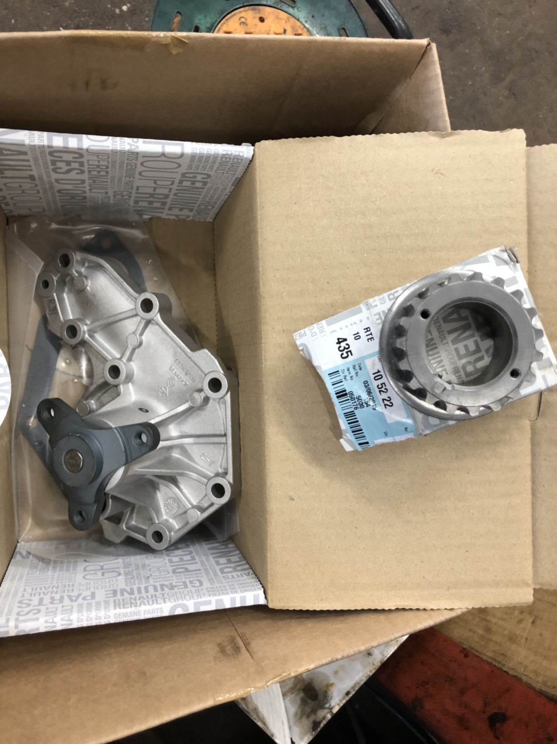

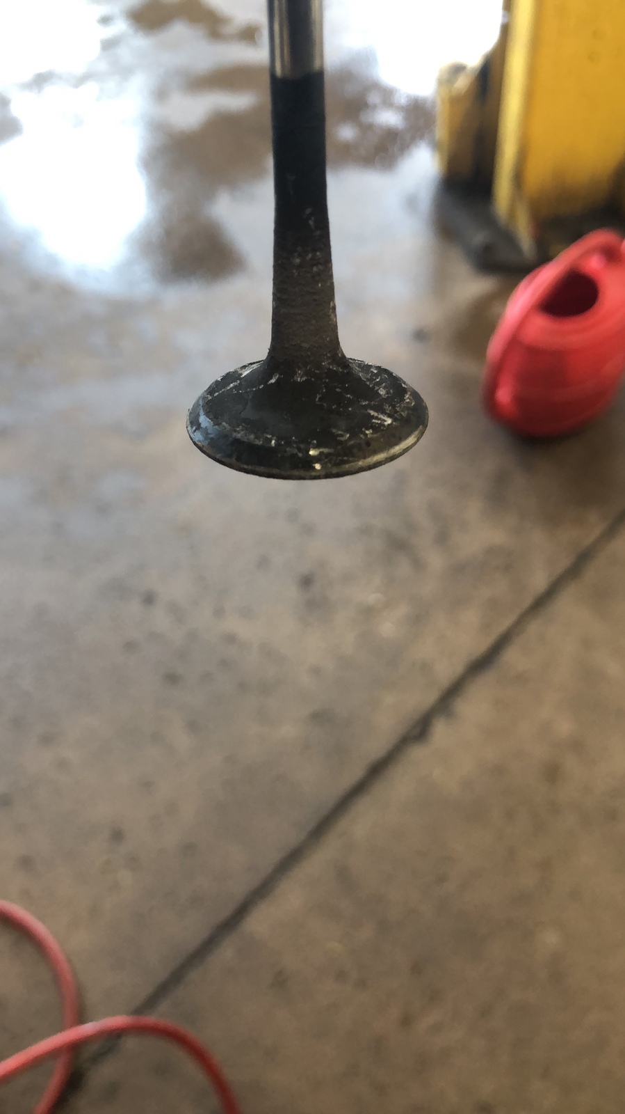

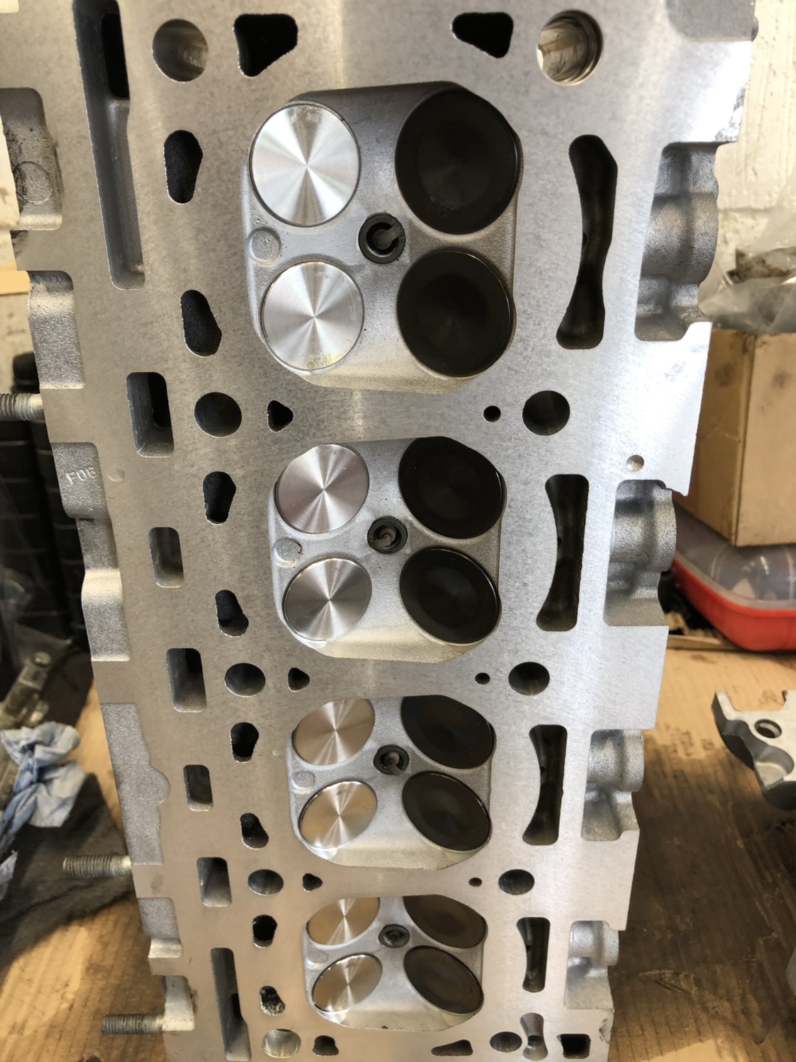

New water pump, keyed megane lower cam gear.. head fitted with new supertech inconel valves, seats cut, head checked and cleaned.. new copper gasket on turbo to manifold.
original exhaust valves weren’t too good!

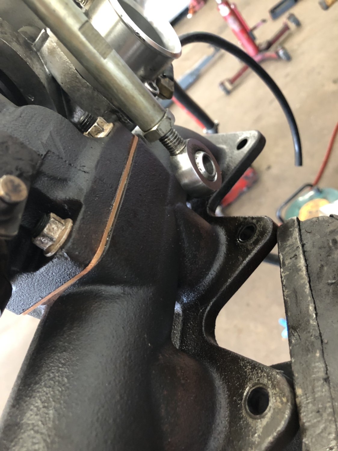

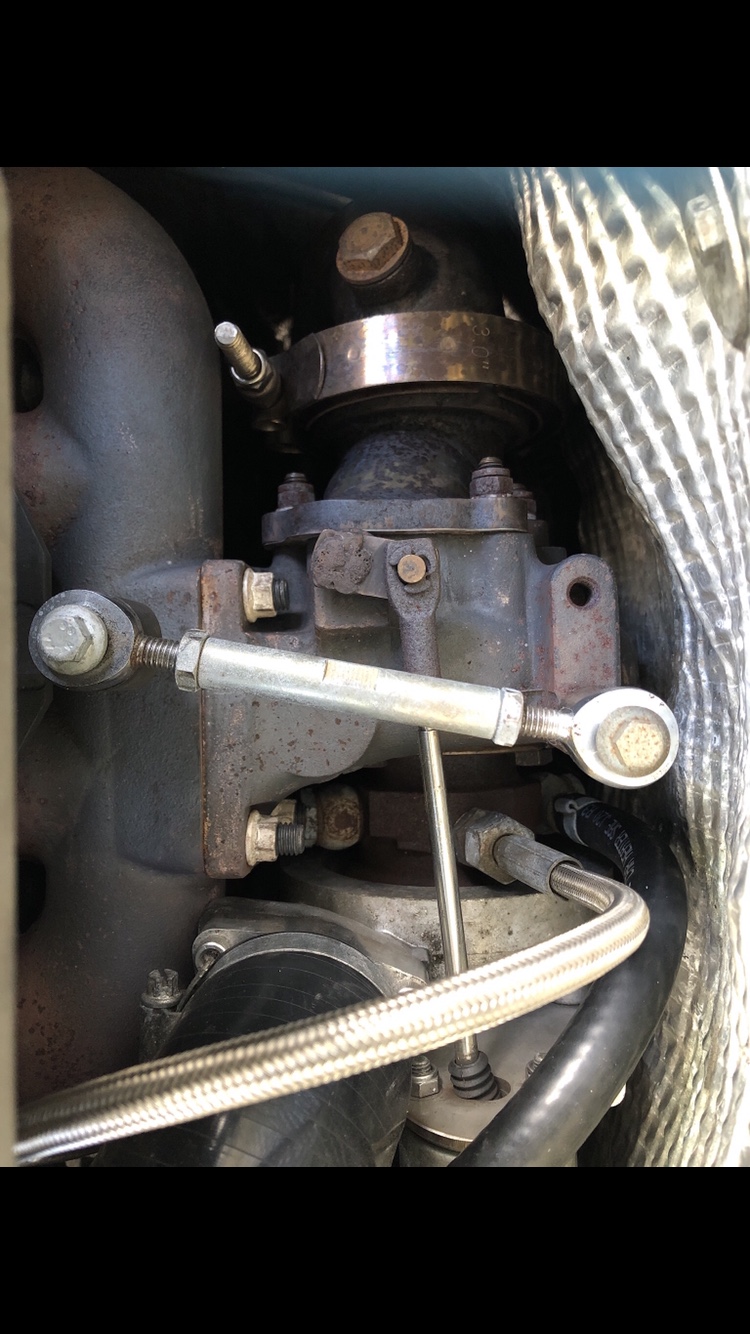

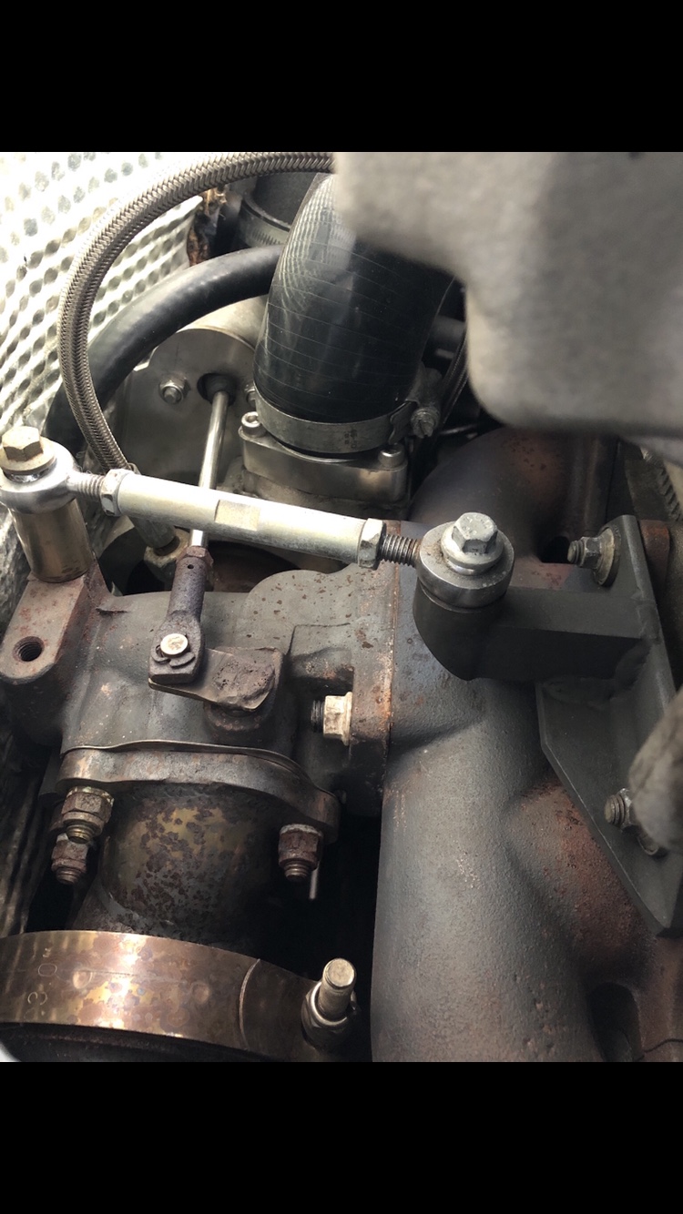

Mind linking me to the copper gasket? Did yours blow from there before? I'm doing a very similar build at the moment and want to avoid all the teething problems as much as possible. Already got inconel studs, heico washers and knuts but your gasket has got me thinking now! Log manifold also looks painted black but I guess that's just the heat.
Bet you're looking forward to getting it back up and running. Is is booked in for mapping yet or do you want to see how it runs first? What are you doing about running it in? So many questions!
incy-spider
Here you go mate, with the upper brace I have made up its sorted the issue of the two top studs coming loose but the surfaces - even though they were machined flat have a tendency to warp slightly, which is why a nice thick copper gasket is a good idea to take up any imperfections that occur from heat cycles...
Defo recommend a top brace mate, all that turbo wants to do is pull away otherwise!
And no the manifold isn’t painted, it’s just from the heat as you say and plenty of WD40 treatment [emoji23][emoji23]

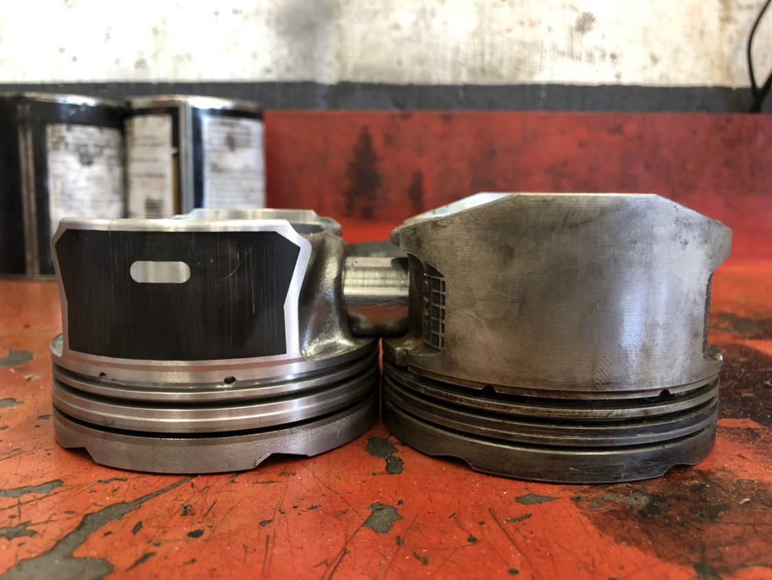

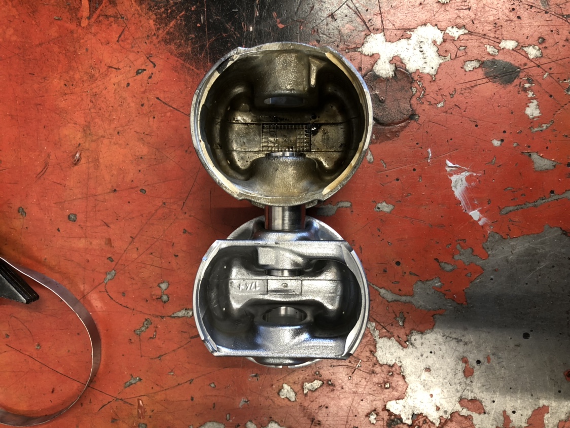

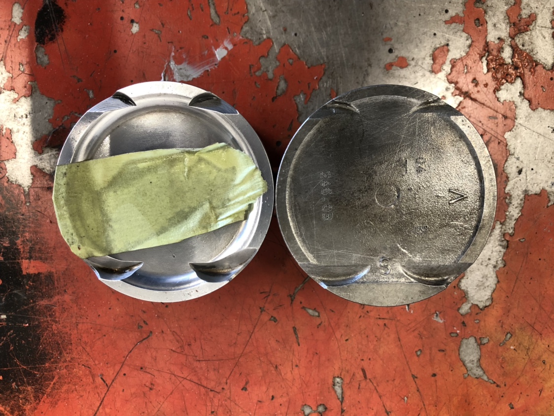

A few pics of how a Megane 3RS piston compares to a standard Clio 182 piston, the Megane piston was my test piston for exhaust pockets. You can see how much more of a quality piston they are now compared to 182 or Megane 2RS. The Megane 3RS piston weigh approx 30g more too..
Have been driving it around mildly since finishing the build last week and it feels great.. really want to give it some right foot but will hold off until mapping done.
Feels very smooth and responsive though, I’m pretty sure the old exhaust valves weren’t sealing great previously.. with the new mapping I’d imagine it won’t need to be tuned so safe and rich so exhaust valves won’t carbon up... also being inconel they won’t get so hot!

Amazing what a difference there is between the pistons. Would love to know why they’ve gone for a different skirt design and what the coatings on it are because it looks lighter at first glance. Looks like it would be ever so slightly higher compression on the top hat. Figures will be interesting!
incy-spider
Thanks for the gasket link :)
No worries, it’s lower compression. The volume of the dish on the top of the Megane piston is about 11.60cc and the standard is basically zero.. pictures are deceiving! [emoji106][emoji106]

Hi I was wondering if you only felt the need to upgrade the T2 gasket because of it blowing at the manifold or did you loose the standard T25/T28 gasket in favour of the more malleable copper plate aswell?
incy-spider
I’ve run with gaskets in the past which generally fail and crack causing it to blow slightly, most OE stuff don’t use gaskets between the manifold and turbo so I went down that route and had both faces machined flat and it worked great, but over time it must warp slightly so I thought a malleable gasket which is thick enough to cope with the heat would be a good idea, also takes up any small deviations in the mating surfaces...

Think it's a combination of hard seats, bouncing off the limiter and detergents etc in modern fuel. Not actually sure how good the original valves are regards material used and hardness of the face on them.
Cool I'll just go overkill and get a set of copper gaskets, some locking washers and copper locknuts. If that doesn't prevent gasses leaking for a while i don't think anything will
Get yourself a brace mate!! Literally the best thing, your nuts won’t come loose ever again! [emoji108][emoji108]
