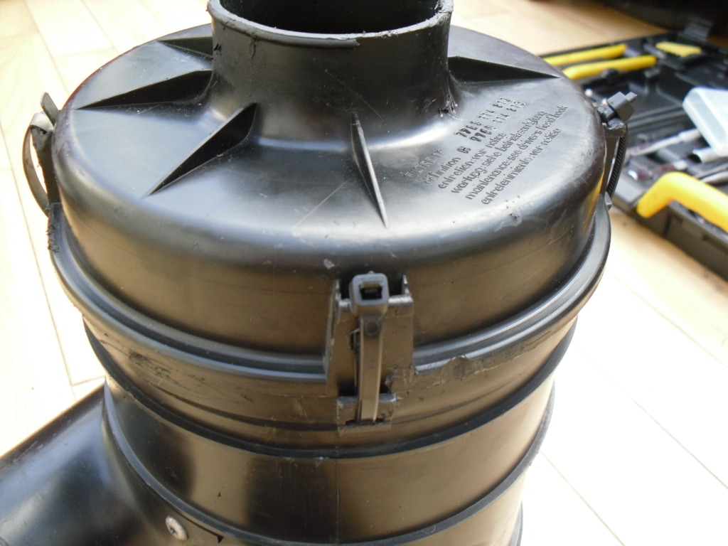

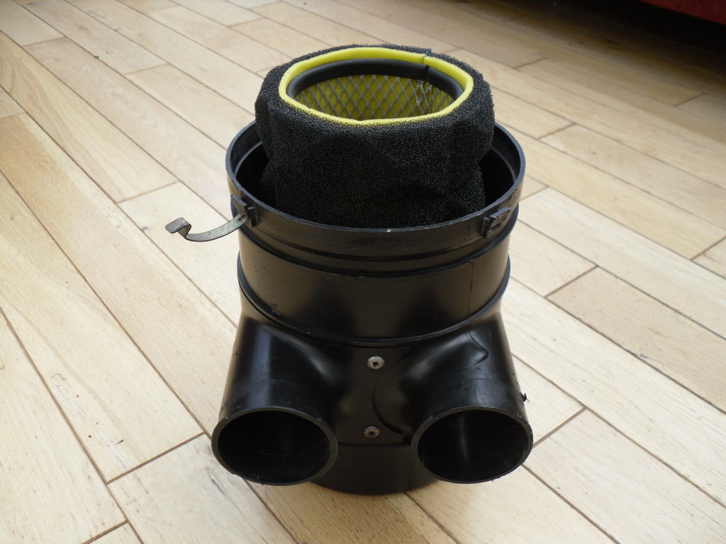

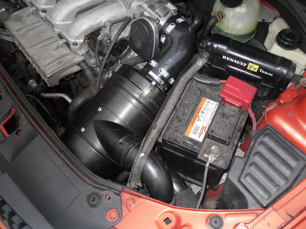

I decided today would be the day I attempted to fit my ph1 172 airbox and lets just say it hasnt ended well :(

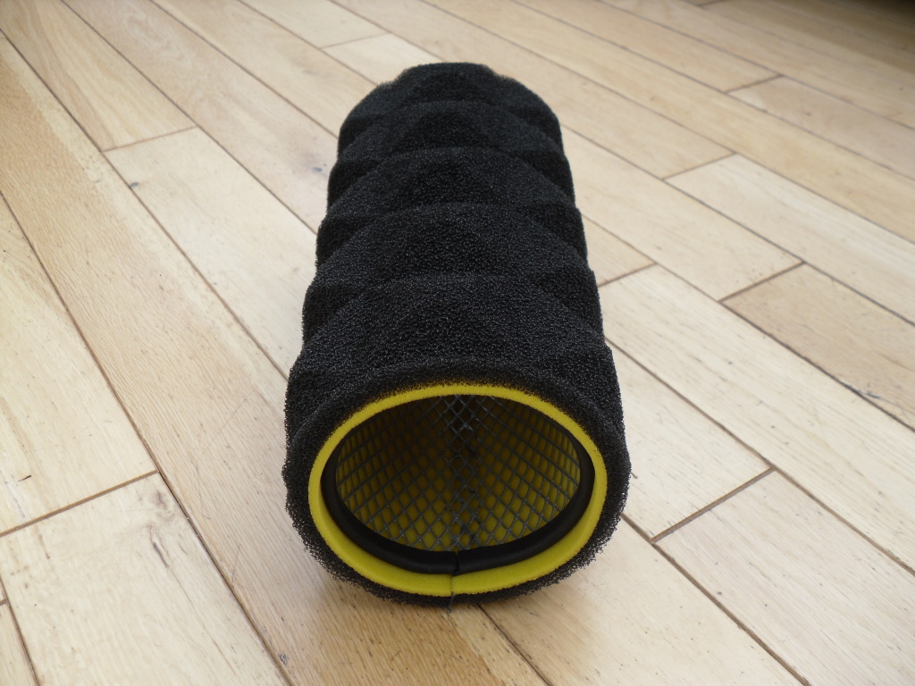

New filter arrived from KTEC and I had cleaned up the 172 box as it was a bit shabby.
First issue was i didnt have all the clips to hold the lid to the box, out came the drill and managed to fix it together with some cable tie's. Did the job and looks okay imo.

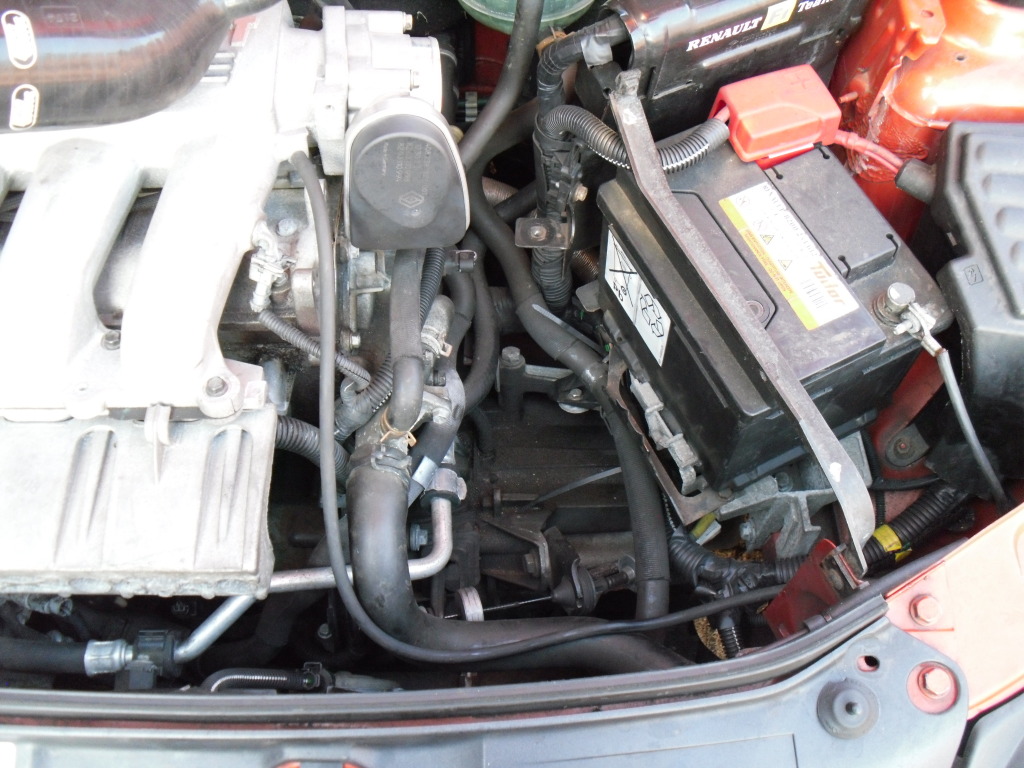

Removed the 182 box and air feeds and tried to fit the 172 box in place. No matter what angle it was at it just doesnt seem to fit. I think its just that the Samco bend it runs off is too long so will have to look to cut some off of it in order to squeeze it in. Also noticed that i dont think i will have enough space to fit the cold air feeds behind the light so may have to look to remove the accustic valve as well. Currently the car looks like this until tomorrow now as im fed up trying for today.
Any tips / ideas on how to get it to fit better would be greatly appreciated.

Does look tight. My airbox is held together with cable ties also, its fine.
Even on the standard ph1 bend its tight to get it in. Recon you'll have to cut abit of the samco down.
Cheers mate :approve: Cable ties have kept the lid on nice and tight.
Yeah it is quite a squeeze, seems it will be wedged along side the battery. Think will need to cut around 1inch from the Samco bend, need to make sure i can get the air feeds in okay too though before I start cutting things :S

There is room with the accoustic valve in bud, as long as the original feed is removed.
The feeds just seemed reluctant to bend into place, just couldnt seem to get it to go down far enough. There is space beside the accustic valve like you say, think will just need a bit of force to get it down there. May try jacking it up and going from underneath and see if its easier to pull them down. If i can get an air feed in properly will try cutting the bend tomorrow. Can see what you meant now when you said it was tight against the battery lol couldnt believe how tight everything was in there.
The feeds are ridiculously tight on mine as i re-fitted them. The box will probably sit again the battery bit and wear down the plastic on the airbox, at least mine has.

Get rid of that hulking great battery, fit a smaller one and remove the ECU bracket.
That should clear enough room.
Gonna have a look at fitting the air feeds this morning. Once there in will then look at cutting the samco bend. Is very tight but ideally want both the air feeds in if i can. Yeah looks like that had happended to the box previously tbh mate as it was rather scuffed up, as long as it doesnt cause any issues then should be okay hopefully.

Ahh rite, which part is the ecu bracket ?? I take it that its not needed. Had thought about a smaller battery when looking at relocating it but seemed a little out of my capabilities to relocate the battery. Would a light weight battery still fit in the same place okay ?

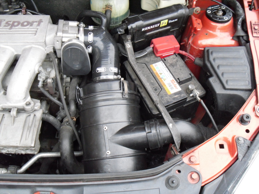

This is a pic of the phase 1 box fitted to my 182,
In this pic the box is sat to the left more than i have it now, ive pulled it over more closer to the battery.
I found putting the hose on to the throttle body first, then lowing the box in bottom first close to the radiator, then roll it back towards to throttle body, and connect them up, its a tight fit I found but it will go.

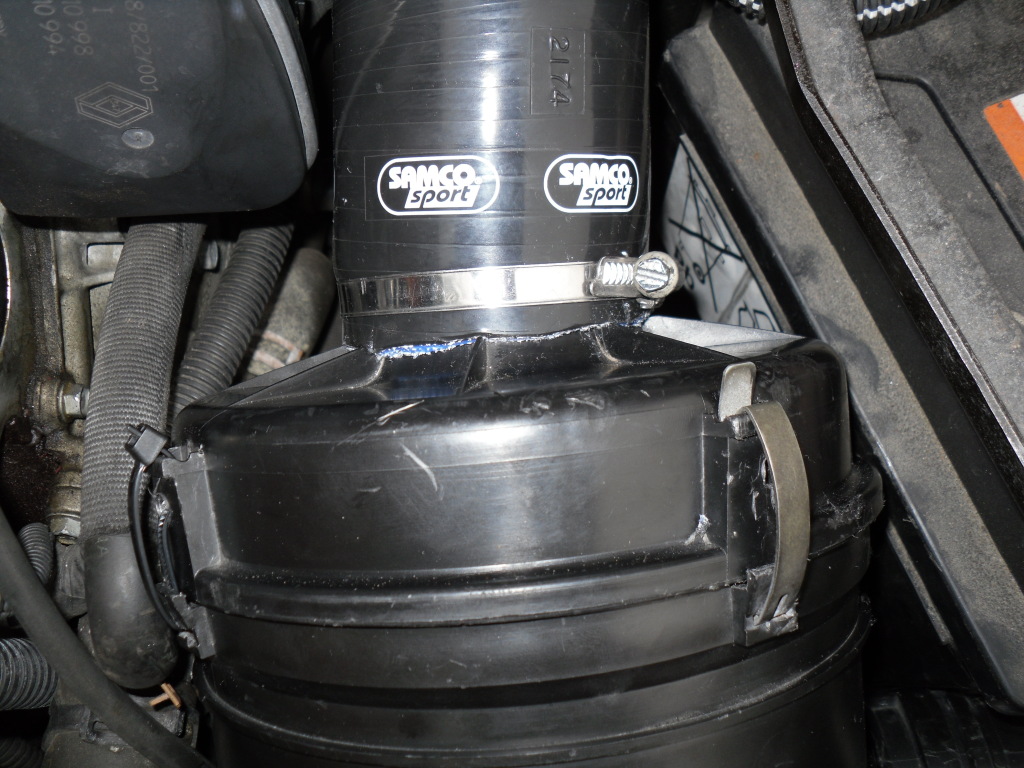

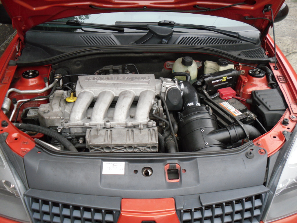

*** UPDATE ***
My perseverance has finally paid off and with only a few grazed knuckles the 172 airbox is fitted and seems to be held solid in place :approve:
Havent done the best of jobs cutting the Samco bend but its in and can be tidied up at a later date if need be. Managed to get both air feeds fitted, one heading behind the headlight and the other down towards the accustic valve. The box is held pretty tight between the battery and the old airbox mount but may need to be secured better in the future.
Havent noticed any change in sound although you cant hear anything over the exhaust anyway. It does feel ever so slighty more responsive although i could be imagining it. Just need to tidy up the bay now as it does look a bit worse for wear but thats a job for spring.
Cheers for that mate,
Mine looks like it sits the same as yours did in the picture, It did turn out to be a lot more work to fit than i was expecting but im happy now its all sorted. How you finding yours ? Love the Inferno Inlets btw mate, will need to look to get mine as presentable.
Jay
I doubled up two tie wraps and put them around the bottom of the box and pulled it over slighty away from the water hoses.

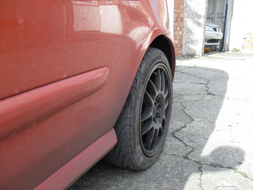

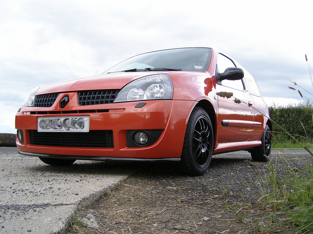

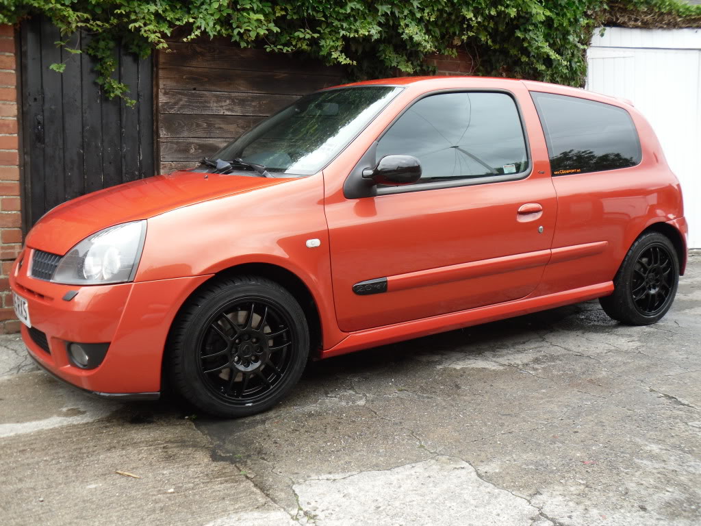

My clio currently has 15" OZ F1's and Ive fitted Sportlines to try and reduce the arch gap. Hadn't really noticed before but the front is much lower than the rear and since its been pointed out i cant stop noticing that the rear wheels look a bit lost in the wheel arch. Had been planning on upgrading to coilovers but before going ahead was wondering if someone could advise if that would correct the issue with the rear and levelling the car out ?? Or any other ideas to make it look more "normal" without going back to standard ? Wasnt sure if coilovers or maybe spacers would be the solution.
Current looks like this side on.
Thanks for any ideas/advice

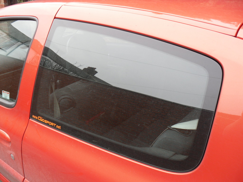

mate you really need to ditch them tints, no offence pal but they look s**t,
like i said, no offence taken i hope,
but some 1 has to tell you,
None taken mate, im aware there rubbish :approve: They will be coming out shortly, seem to have another list of things to do lol.
Jay
Neither coilovers or spacers are your solution. Coilovers could reduce your arch gap but that is an expensive way to work around a simpler problem.
What tyre size have you got?
I have gone down to 15"s but don't have the same arch gap. The reason? I bought tyres that would give me the same rolling diameter as standard. For a smaller alloy, you need a thicker aspect ratio (sidewall height) to maintain the same diameter and all things that go with it, e,g. arch gap, speed/gearing relationship.
You need new tyres fella, yours look like they have too small a sidewall.

Ahh rite cheers, never really thought about the tyres. I just replaced the old ones with the same sized new ones when I bought them. Mine are 195/45/15, what size have you gone for ??
Im in need of two new rear tyres shortly so will give it a shot.

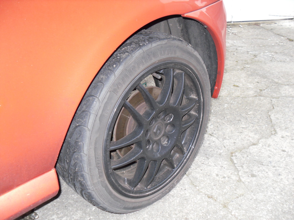

Hi, just after some advice really . . .
Regarding previous posts i havent been happy with how the car looks on 15's with only Sportlines. I am going to change tyres from 195/45/15 to 195/50/15 to see if it reduces the gap slightly and i have been looking at spacers so that the wheel doesnt look so far inside the wheel arch. I measured the gap from the top of the tyre out to the arch and the front is approx 3cm and the rear approx 4.5cm. Was hoping someone could advise of the best size spacers to go for really. I had been looking at the ones below from Kam racing,
http://www.kamracing.co.uk/renault/renault-clio-mk2/suspension/spacers/renault-clio-mk2-facelift-pcd-5x108-30mm-eibach-pro-spacer-type-2.html
In all honesty im not clued up in this kinda thing at all and im not sure they would be the correct ones and hope someone can point me in the right direction. Arch gap currently looks like this,
Really appreciate any assistance, thanks

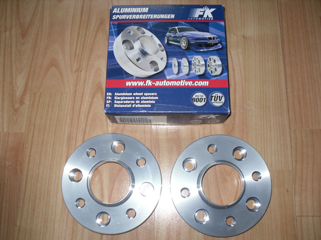

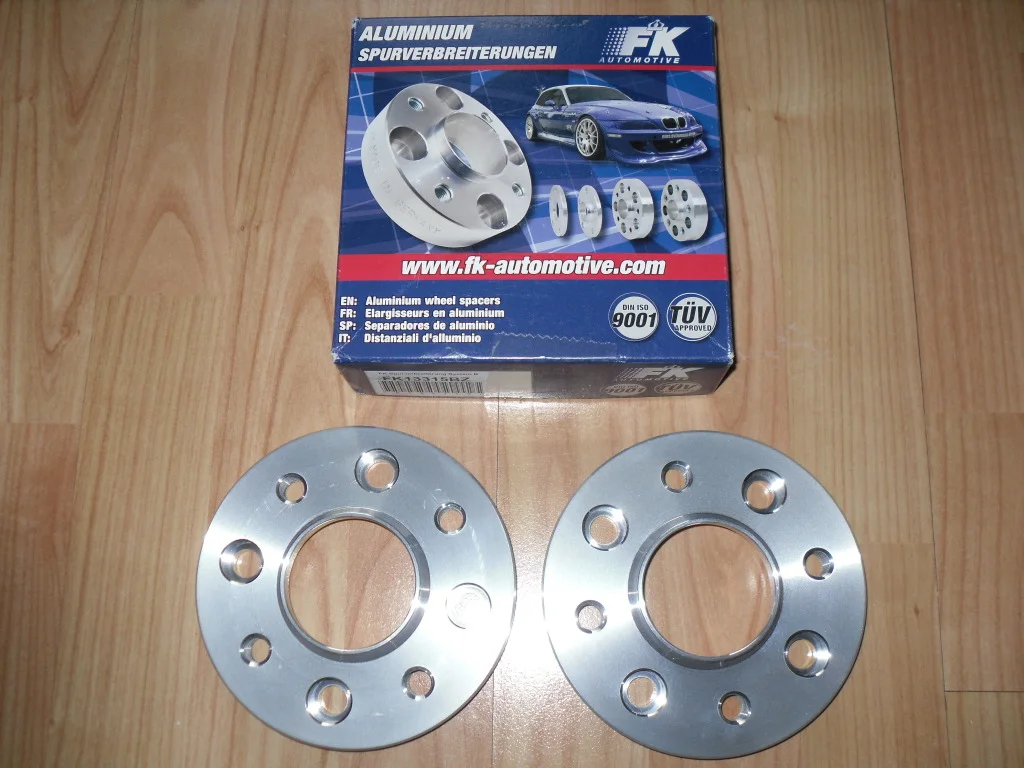

Decided to go for some FK spacers from Venom motorsport, seem well recommended so gonna get some 15mm ones. Think i had my gap measurements wrong above as measured to the outside of the arch :S Hopefully should make the alloys / arches look better and be easy to fit :approve: Also going to try and remove the window tints shortly if all goes to plan.

** Small Update **

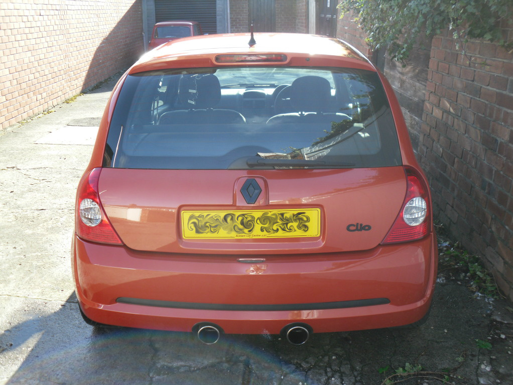

Got out this morning and removed the window tints from the rear. The two side windows came off easily, the rear one left a lot of glue on the window but following the guide on here a little SRP did the job. Quite surprised as to how much lighter it seems inside the car and tbh it does look better and should have proberbly been done sooner. Was going to give it a wash after but its started to snow so may get that done tomorrow.
New wheel spacers arrived from Venom motorsport yesturday too. Went for some 15mm FK spacers for the rear, havent bought any for the front as of yet as the rear seemed to be more noticable but depending on how they look once fitted will proberbly get some for the front too.

*** Update ***

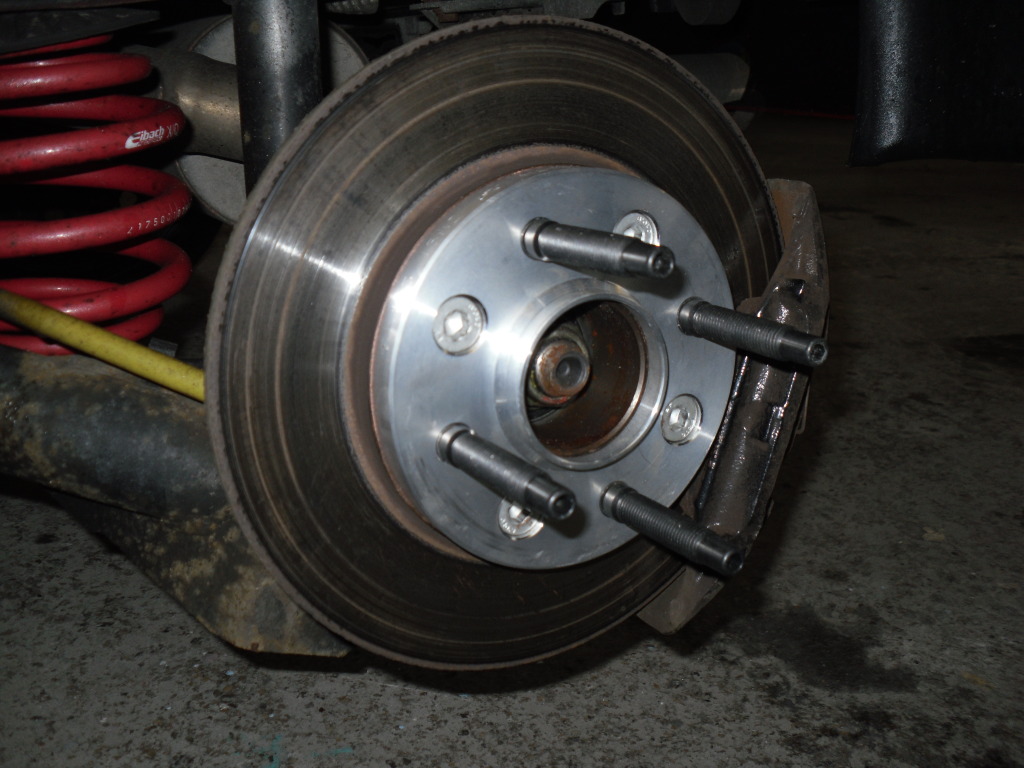

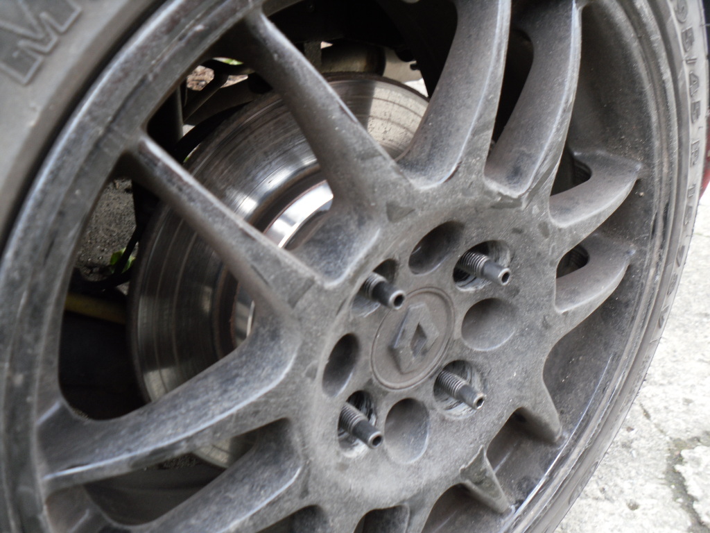

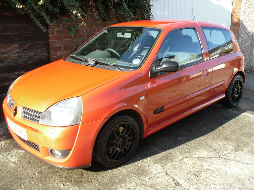

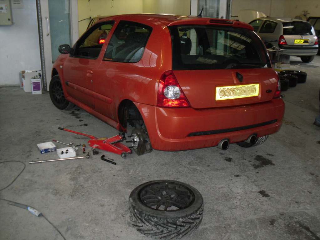

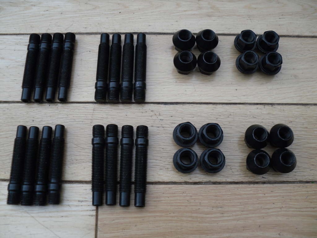

After a failed attempt to fit the rear spacers last week due to my existing wheel bolts being too long I decided to give it another go this weekend. After some much needed advice from a few members I decided to go for the Pure motorsport stud conversion rather than buying smaller bolts. Excellant service from Pure motorsport and really pleased with the studs, imo look a lot better than my original bolts.
Managed to get the spacers and studs fitted to the rear today rather easily. Really happy with them and it has made the rear arches look a lot better.

They stick out a bit :S love f1s though, looks good mate
Thanks mate, Do you mean the studs ? Yeah they do a bit but only by 1cm and they still sit flush with the face of the spokes on the F1's. Pleased they look better than my shabby original bolts ;) just need to get the fronts sorted now.
