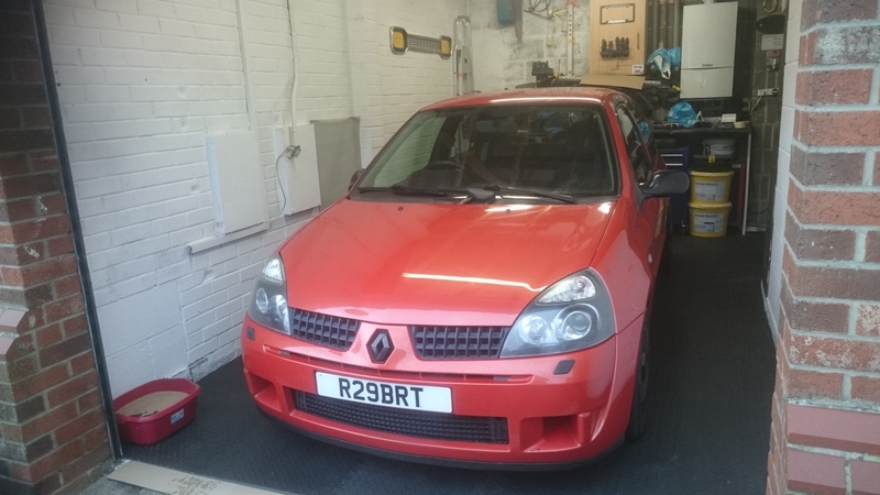

Last night we tried doing the first fire up but were greeted with immobiliser light on solid and not trying to turn over. Checked over and found fuse in engine bay tripped (15A). Only had a 20A so replaced it & was greeted to smoke from the AEM module.
Checked over and 1 wire wasnt labelled correctly so revised the wiring and replaced fuse hoping it was just the circuit polarity check and it was thank god.
That took us to 10PM last night.
This morning we pulled it out under its own steam for the first time then tried fitting bumper - no good. Passenger side cup racer duct was hitting the intercooler pipe.
This has been trimmed back with the dremel so I can now still use as a brake duct as well.
After all checked and coolant system bled equipped the car with the fire extinguisher from the Impreza, unfortunately this is where it gets funny haha.
Went over speed bump - pin in extinguisher fell out then when came off bump fell over landing on handle. This sprayed straight at me and the car so had to then clean all that up. Not a pleasant experience lmao.
Took to Shell and filled with fresh fuel then off for a play.......

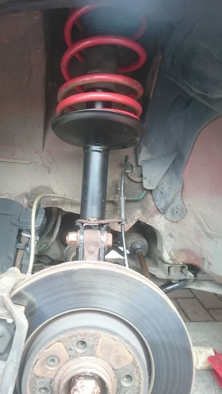

  182 Cup & DCi 172

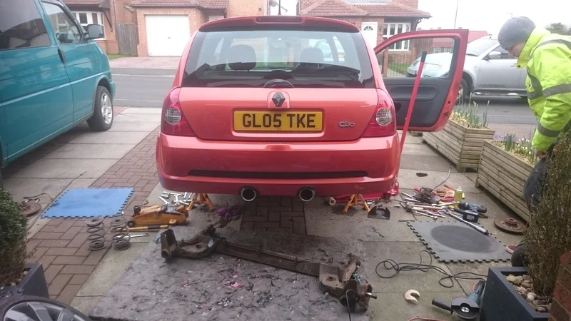

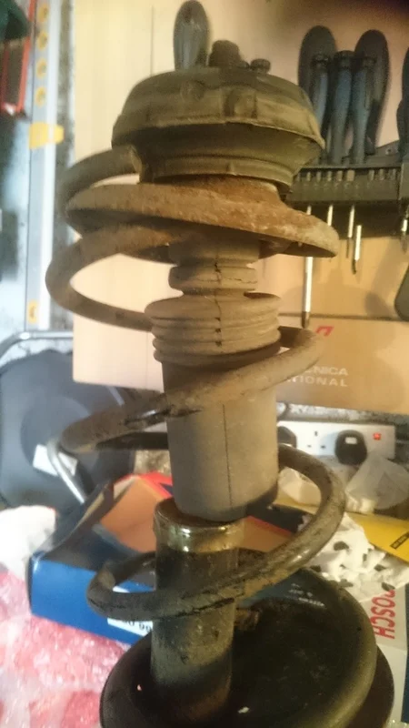

Nice few hours working on the Clio.
It is nice and relaxing working in the garage now it's all done out.

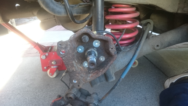

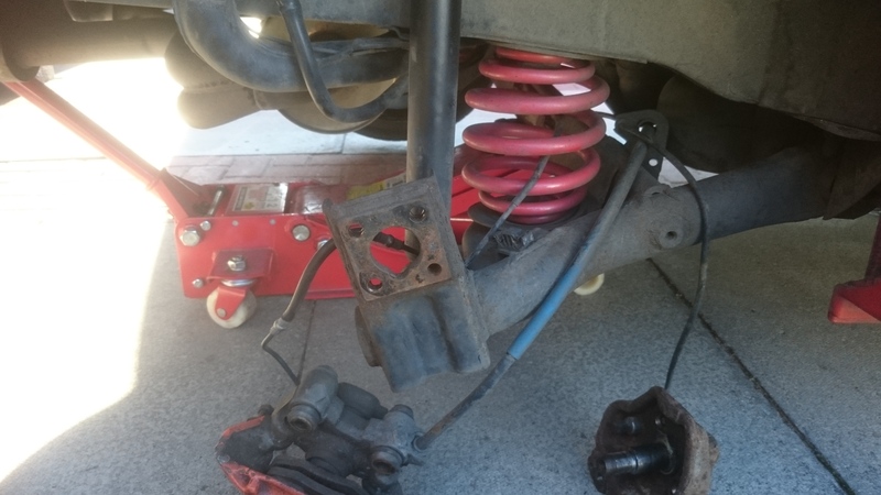

- Bilstein B14 coilovers on with powerflex rear top bushes and camber bolts.
- Pure Motorsport non cambered 10mm rear hub spacers
- Renault rear discs and pads with new bearings and abs rings
- Coil pack fitted
- Breather can painted wrinkle black
Left to settle now and see how the height is tomorrow then can adjust it.
Also if the intermittent off boost miss isn't cured then new Lambda will be getting fitted.

Can I ask why you went for non cambered rear spacers?

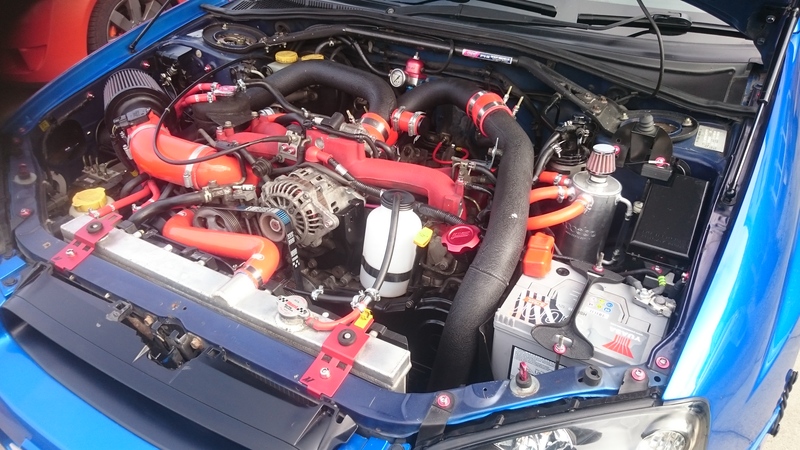

What's going on with that u clamp behind the manifold flange?
I fitted 10mm clambered rear spacers to my old PH1, it looked proper broken at the rear.
I think they run something like 1 to 1.5 deg neg as standard so adding another 1 deg neg is far to much.
I got rid and also fitted 10 mm flat spacers.
I was thinking of adding some camber to my rear as the inside of the rear tyres is hardly wearing, although more research is required.

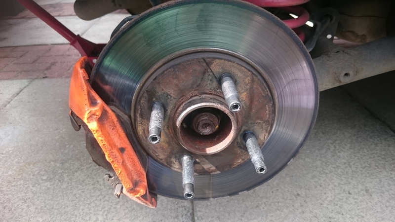

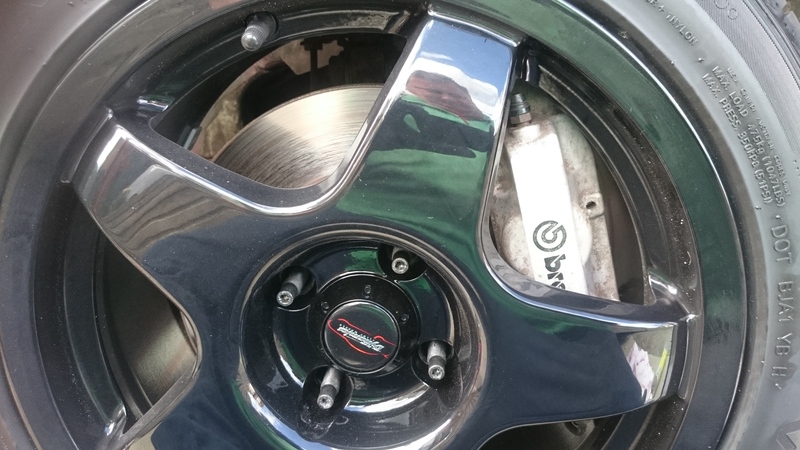

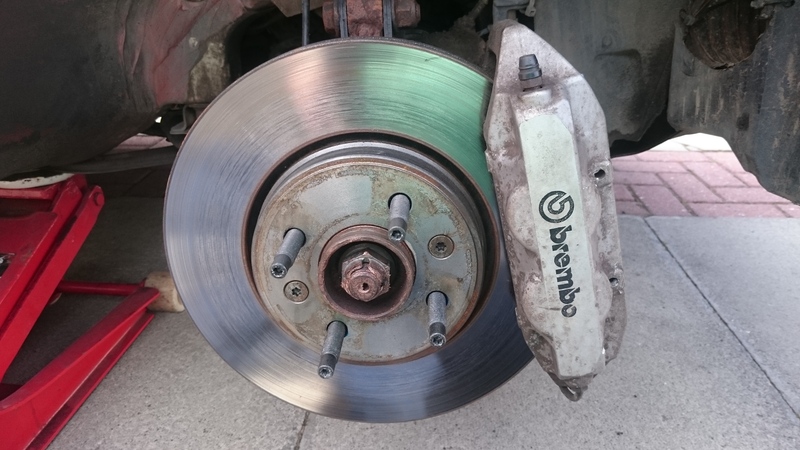

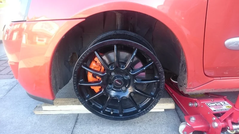

Got my stud conversion fitted up so wheel changes are alot easier haha

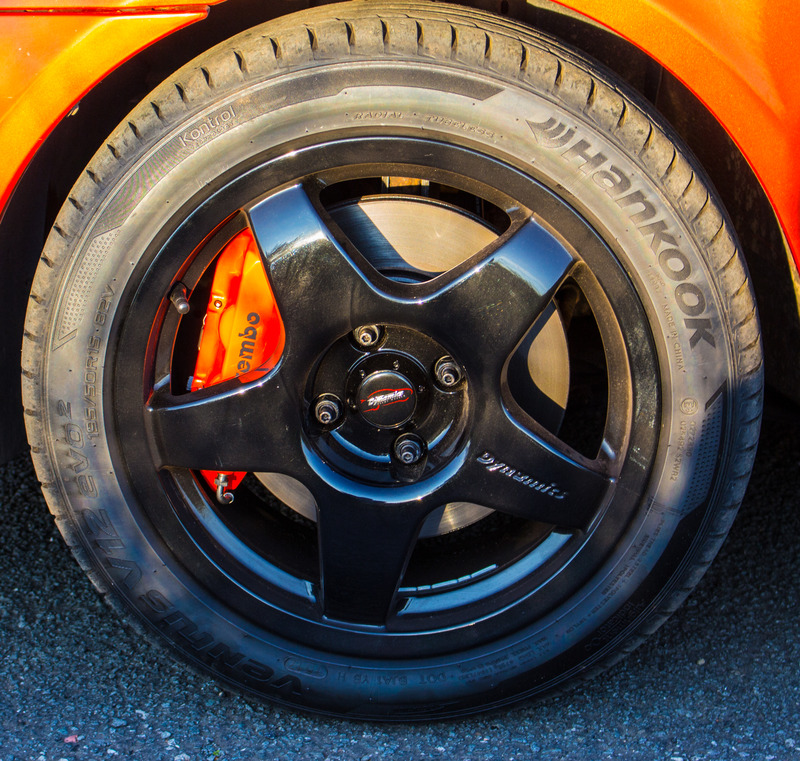

:up:..those wheels look nice& good match with brembo, r the discs 300mm? whats the model of the wheels?

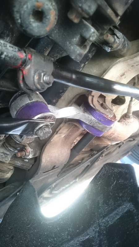

I have more Powerflex bushes on the way - Front ARB inner and outer bushes. Still need to sort my shelf full of other bushes haha.

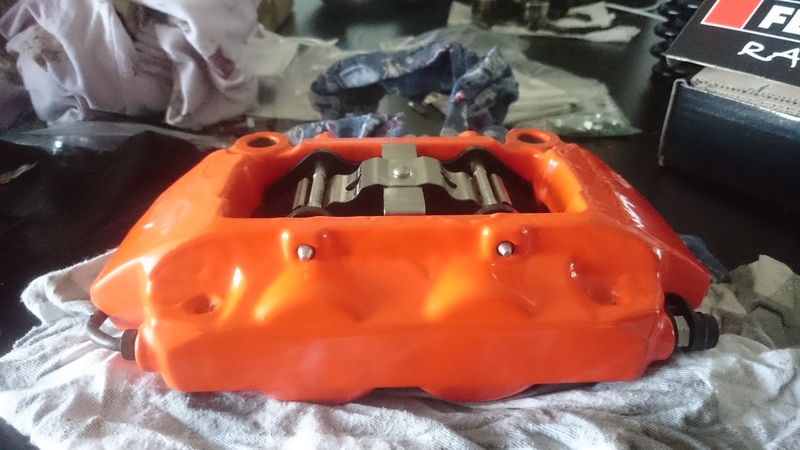

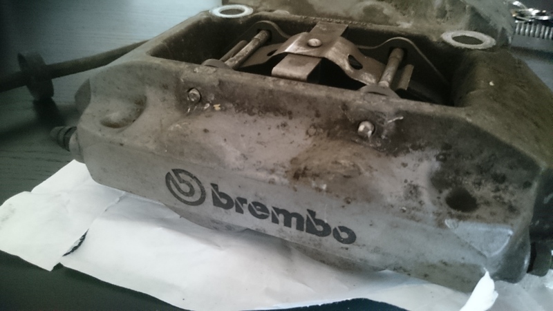

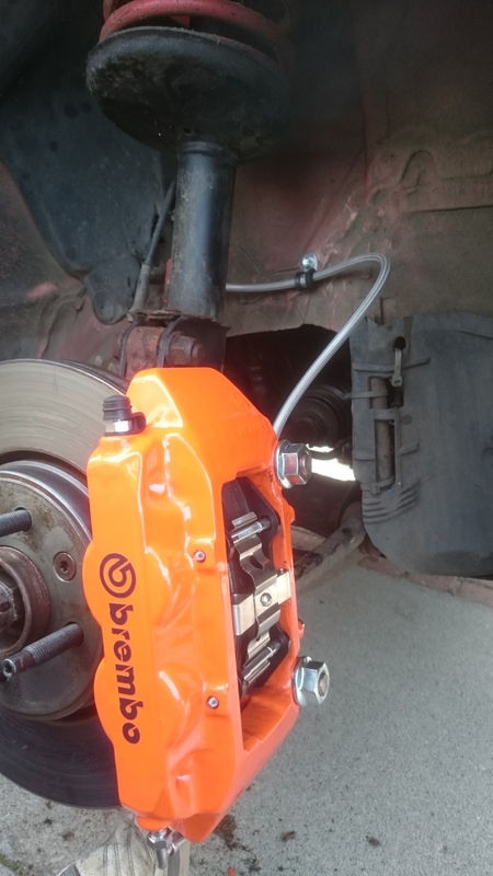

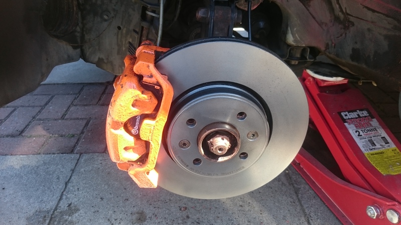

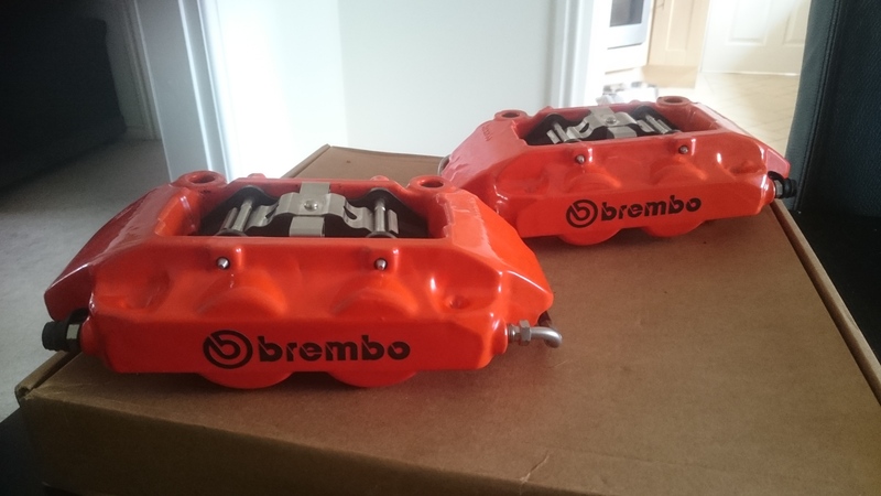

The brakes I am making good progress on.....
- DIY shot blasted
- Fully cleaned out
- Painted in proper orange caliper paint
- Stainless bleed nipples
- Braketech seals and dust covers

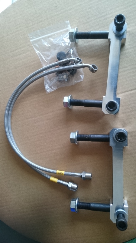

Just waiting for stickers and the proper Pro-Line link pipes and they are going on.

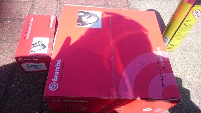

Pads are my new DS2500 I just had delivered.
Quite happy with how these are coming along!

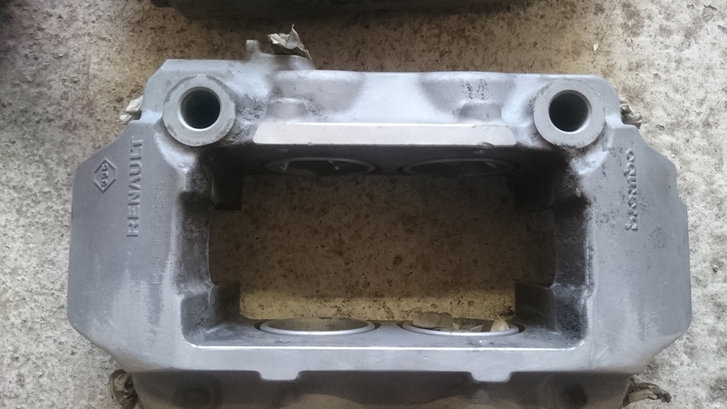

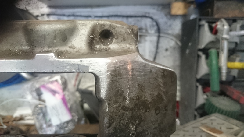

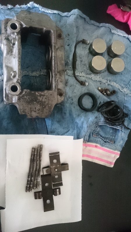

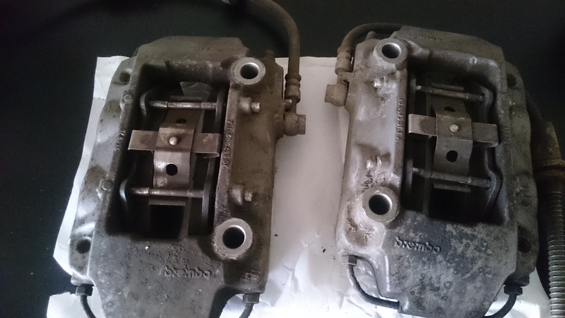

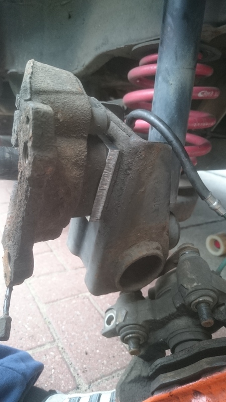

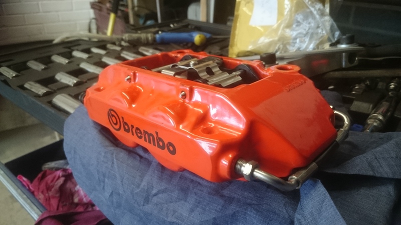

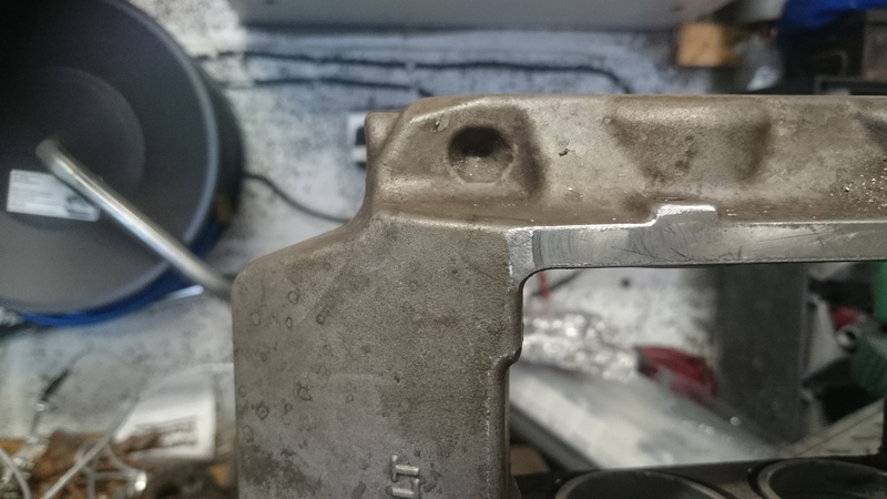

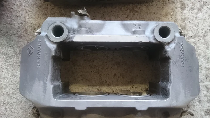

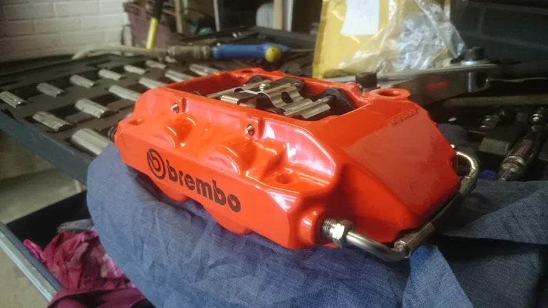

Also the brembo calipers are here and have started on them. They are all stripped and have been mocked up on the car and fit snugly under the new 15's.
Will be getting the required 5mm machined off then my mate is shot blasting and powder coating them before I will rebuild them with all new seals and stainless bleed nipples.
