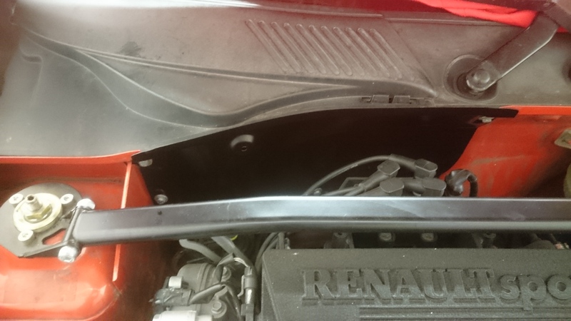

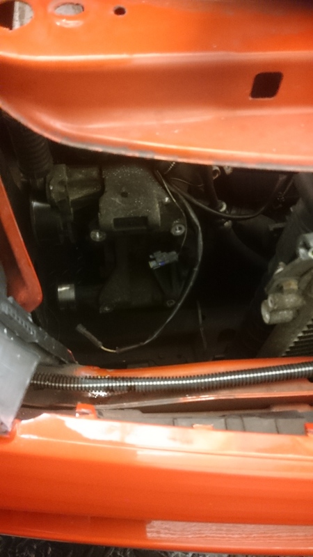

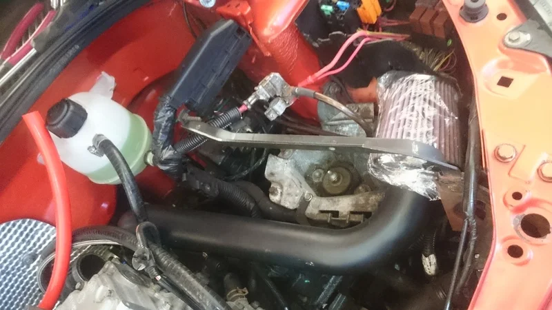

Aircon removed and none aircon bulkhead panel fitted.

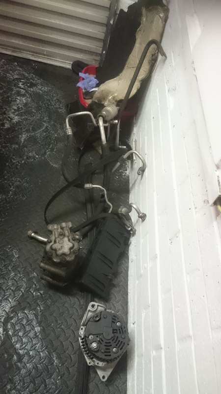

Also removed aux belt, alternator, compressor and steering pump.
Letting pipes empty into bottles tonight then will be continuing tomorrow night!
Didn't get much time tonight after my trailer driving lessons but made some good progress still....

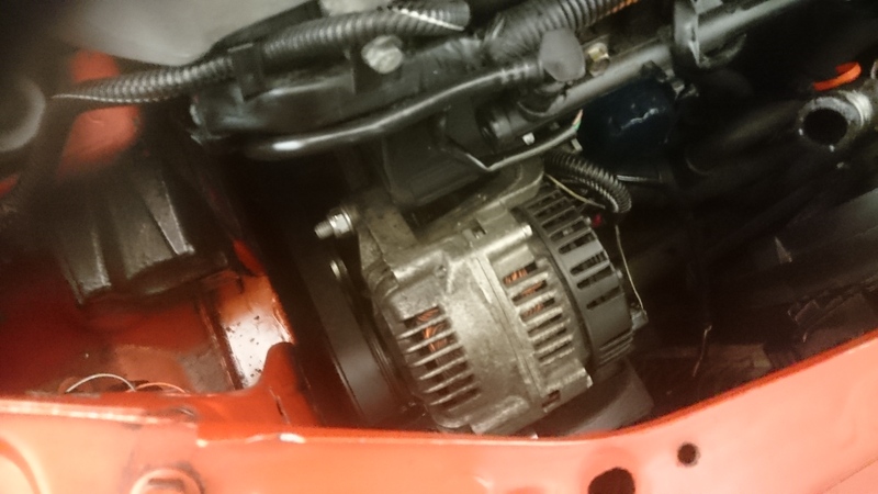

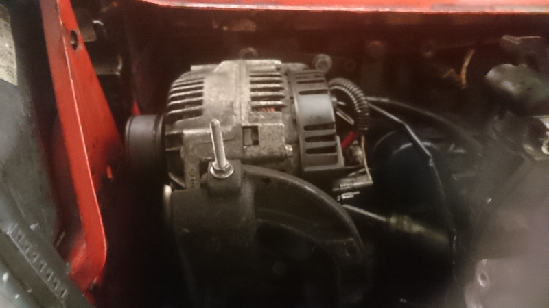

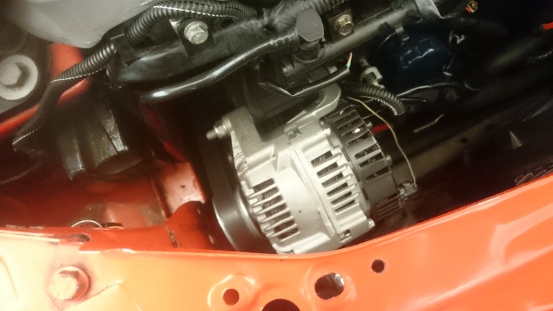

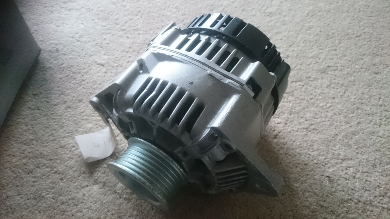

Cup alternator all fitted with shorter belt all fitted up.
Really happy with how it all looks and deleted the aircon and power steering pump.

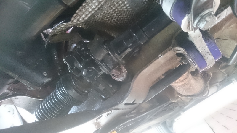

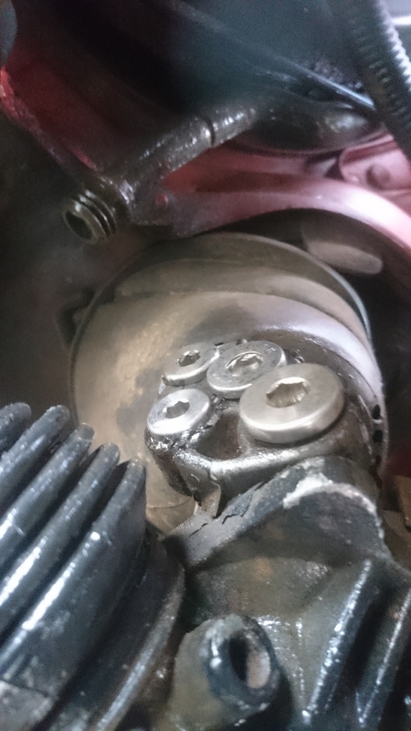

This leaves the steering pipes to finish removing and rack to be plugged and looped then move onto the interior for the column change.
Well that was horrible!
Power steering pipes are a nightmare to remove haha.

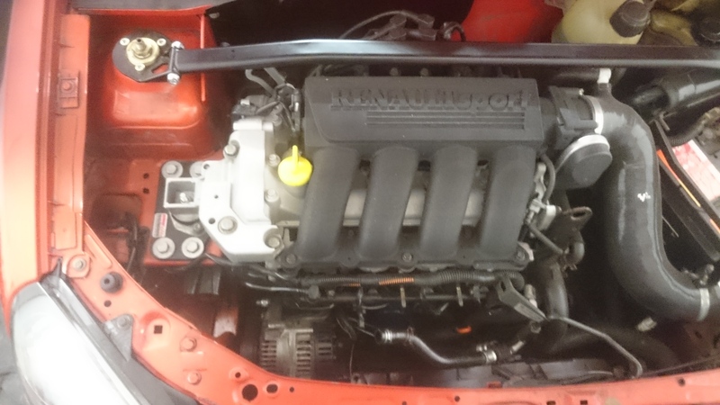

Degreased the engine bay after all the power fluid escaping haha

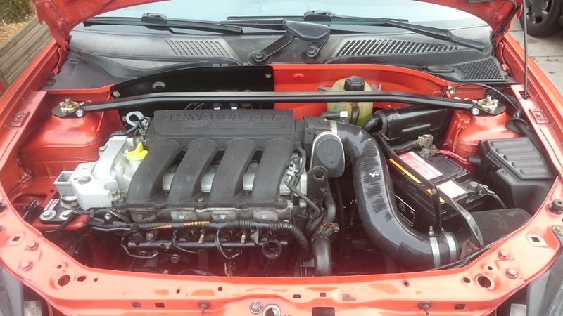

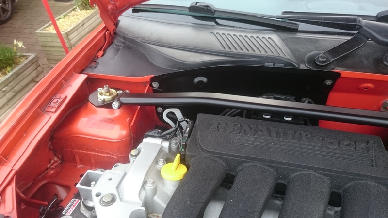

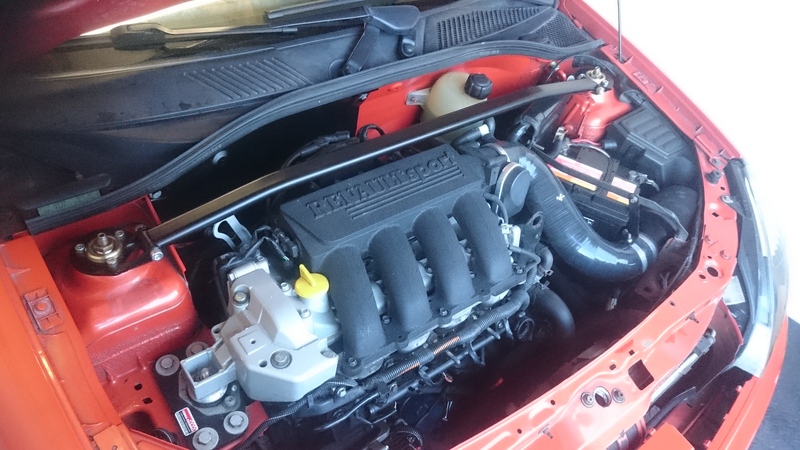

Engine bay now looking canny....
Just the column left to do on my days off next week!

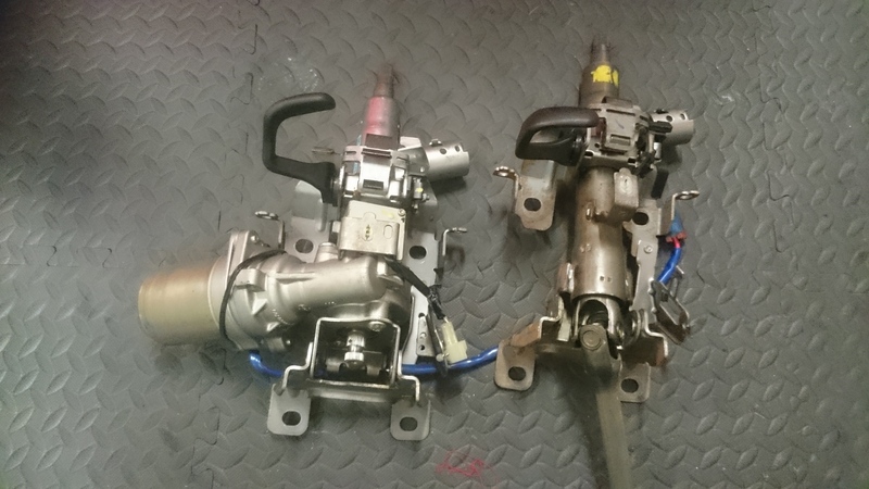

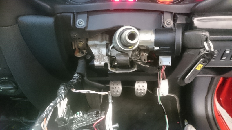

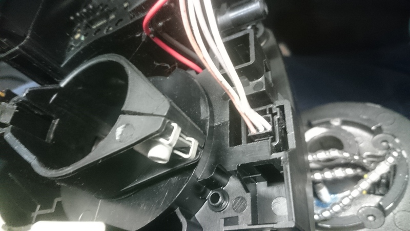

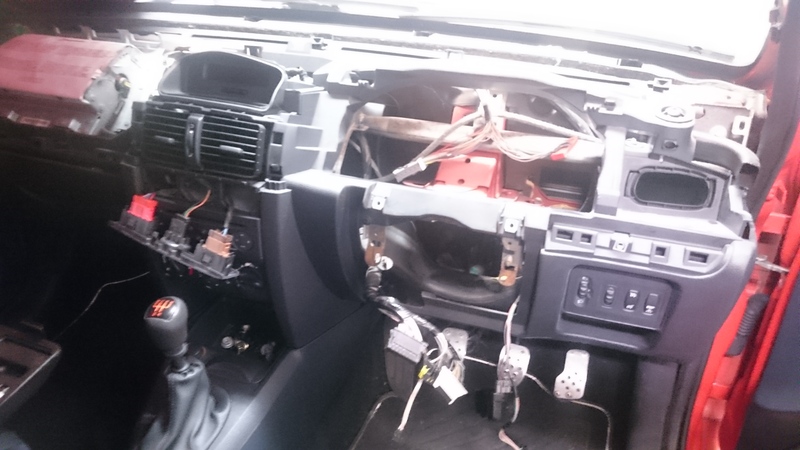

Will be next week then I test it hopefully. Got the upper column to change and wire it all in

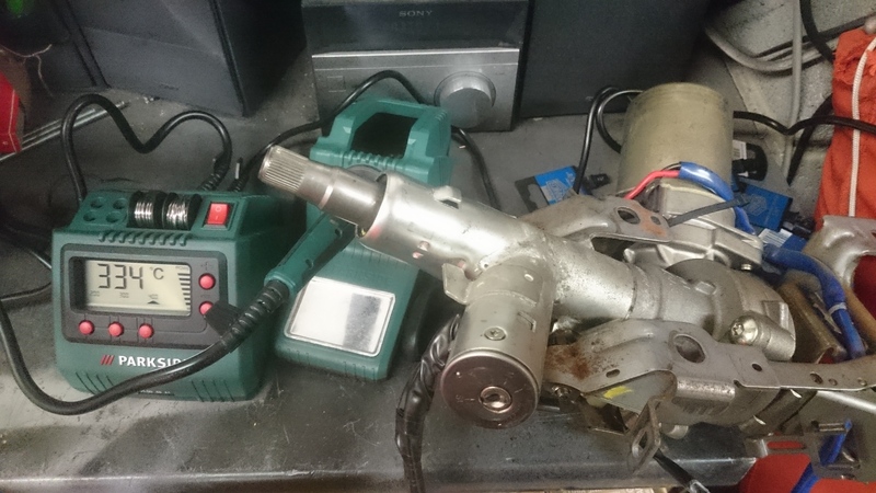

More days off so managed to crack on....

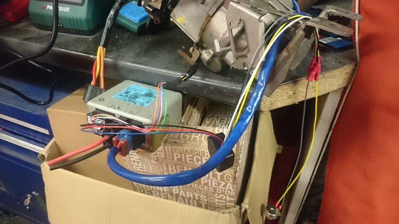

All working first attempt with no issues upto now.
Love the variation and means you can still have excellent steering feel.

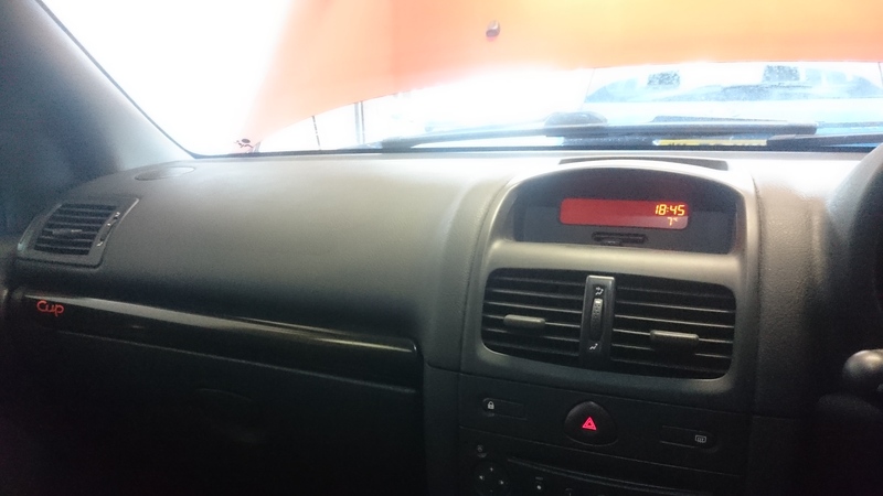

Have also replaced the HVAC controls to one without ac button and also fitted a non sticky dash top as breaking my daily Dci clio as got a new daily.

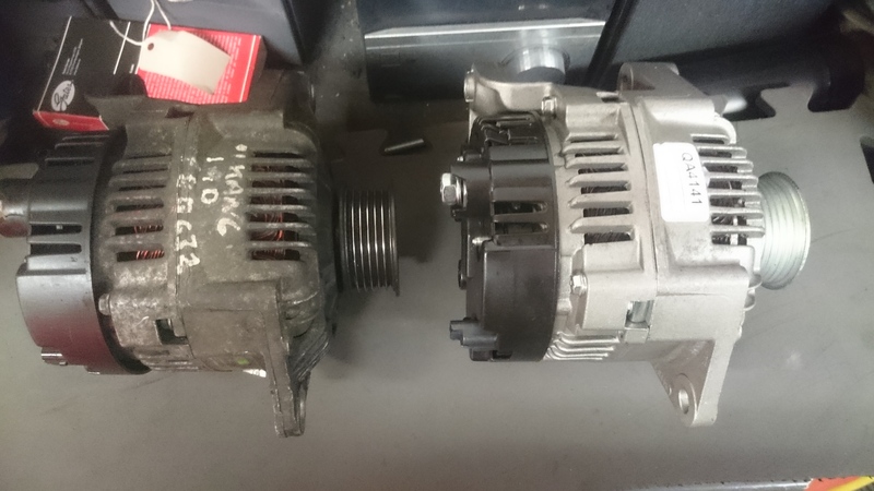

The Cup alternator I was sold was duff so got a reconditioned replacement on as well.

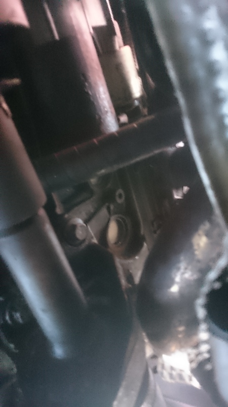

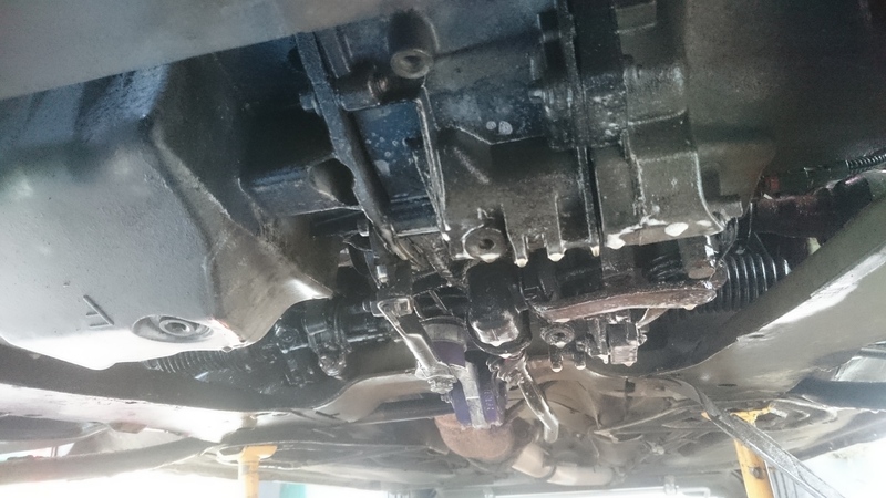

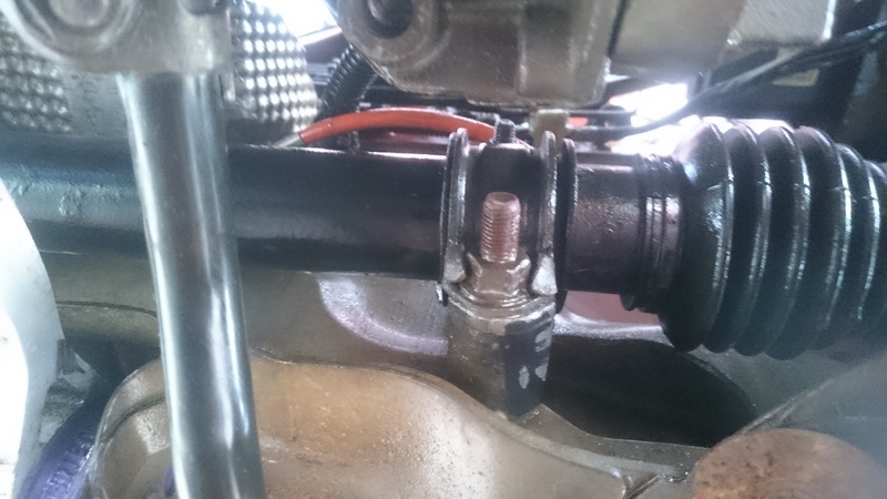

How did you go about removing the power steering pipes off the rack? About to tackle mine in the next week. Making fast progress with this!

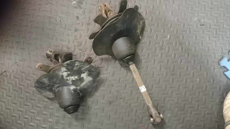

I couldn't be bothered to save them so used a junior hacksaw at each point and chopped them out. Much easier haha
They can be taken out complete just a pain that's all
Did you manage to get the fittings out with the rack and subframe still in place? Even after cutting the pipes.
Yeah was actually easier as manged to get a spanner on properly rather than just the flats.
If you try an open ended spanner you will probably round the fittings as they are well in there haha.
Flare spanner if not cutting pipes
Getting the hacksaw out then haha cheers mate!

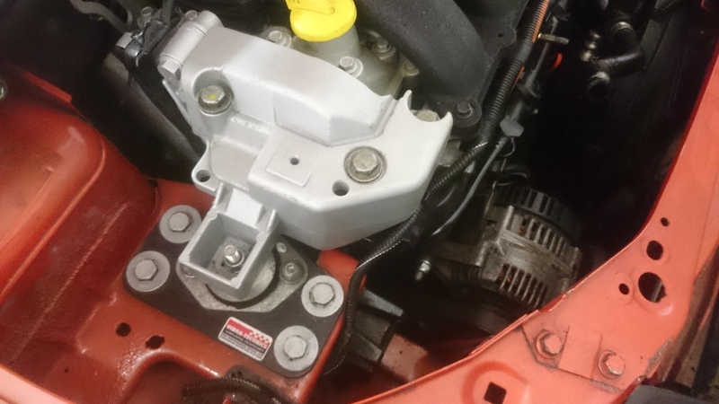

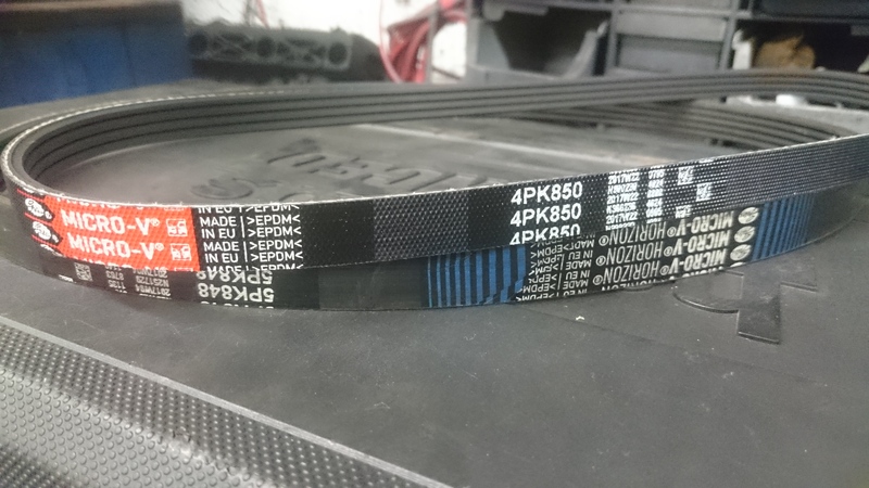

If anyone is doing the same EPAS conversion as me check the clearance off the top of the crack pulley to the block.
Now on a PK4 850 and alot more room.
Mine was quite close and did rub slightly, I had a noise which I assumed was that but wasnt.....
My 16mm socket had fallen in next to the water pump pulley and was catching now and again, oops! Lucky boy

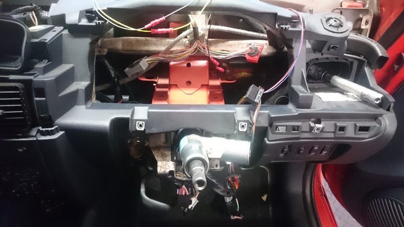

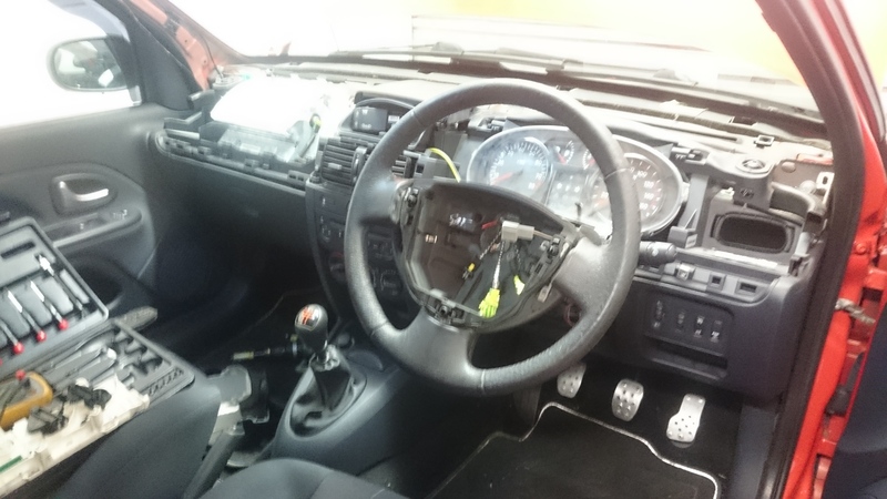

Also worked my way through the Christmas tree of a dashboard haha....

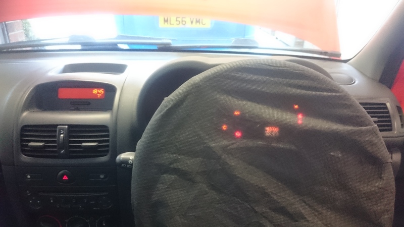

Traction and abs light were on as the squib plug had come partially put. Airbag and Serv light on as a resistor had failed for steering wheel so soldered some new ones in before going through the squib.
Low and behold dashboard all clear. Car drives superbly as well and think I have found the sweet spot for weighting of the steering.

Finally how have you run your belt now?
Good updated.
I've just collected all the parts to do the very same as you. How do you find the EPAS?
I like the EPAS, turn it up for normal town driving and down to get a decent steering feel for fun driving.
The belt comes off creak and over water pump before going round altern.

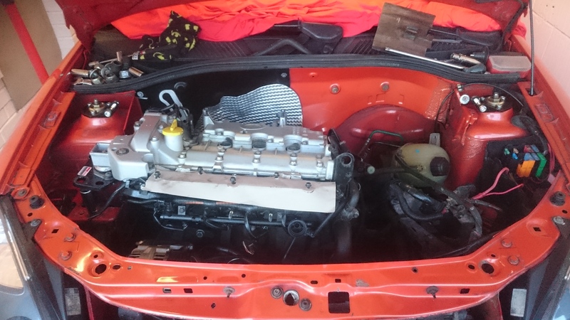

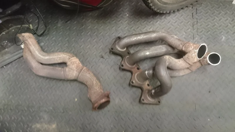

Started earlier than expected with the turbo conversion.

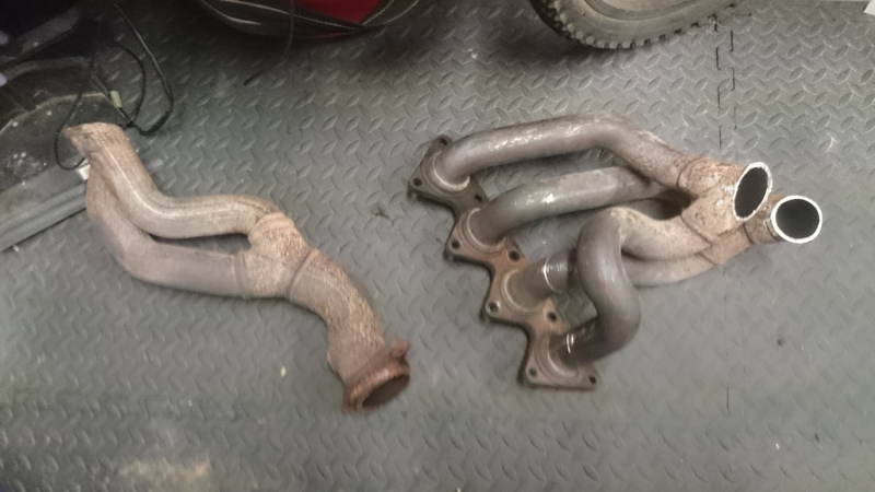

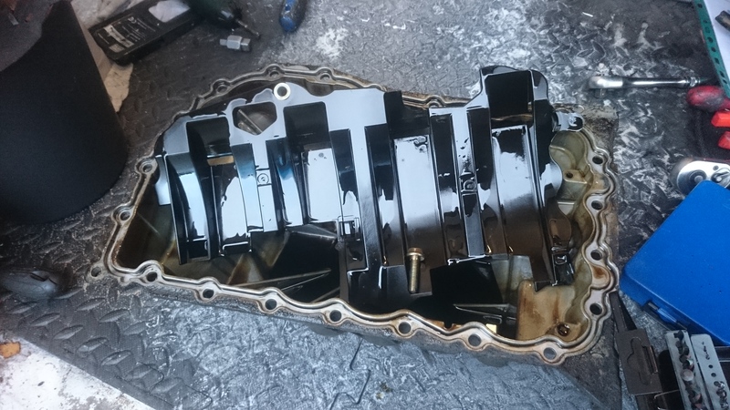

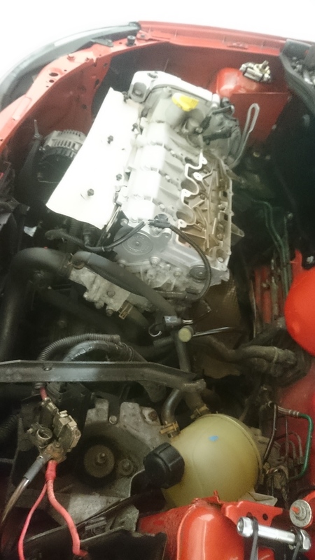

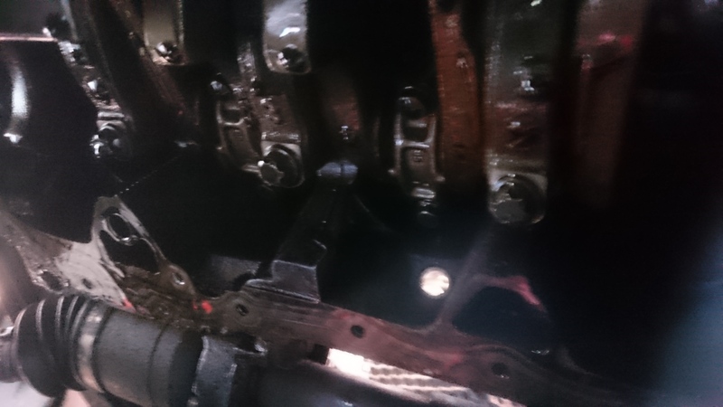

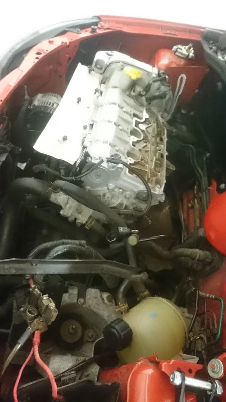

Cut the 182 manifold off to save time and got the sump off as well.

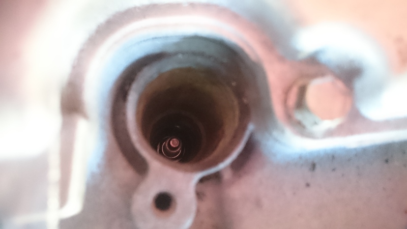

I have drilled and tapped the block for the oil return and have started on the heatshield.
The engine is lifted around 80mm in the engine bay so the sump can be done much easier.
Ecu is off tomorrow for base map so all heading in the right direction.

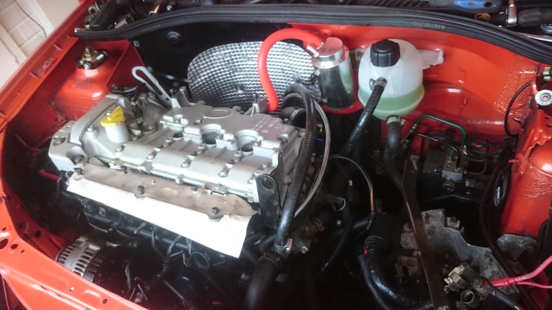

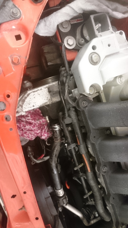

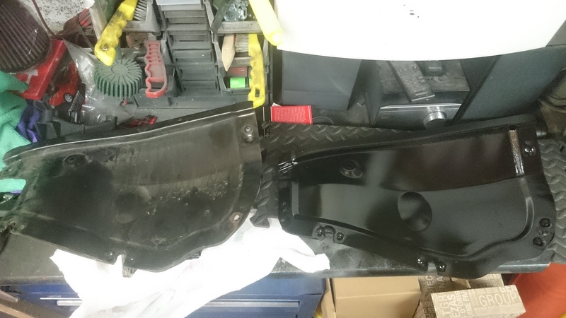

Well a nice chilled few jobs progressed as not waiting for arse pieces fancy sump bolts......

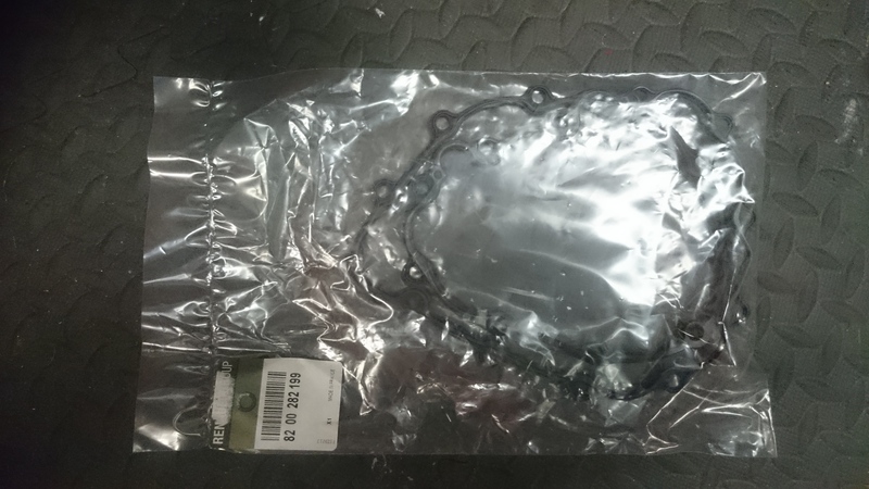

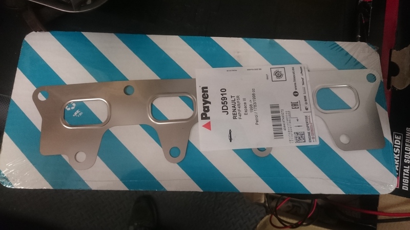

- Turbo is loosely mounted with new gasket

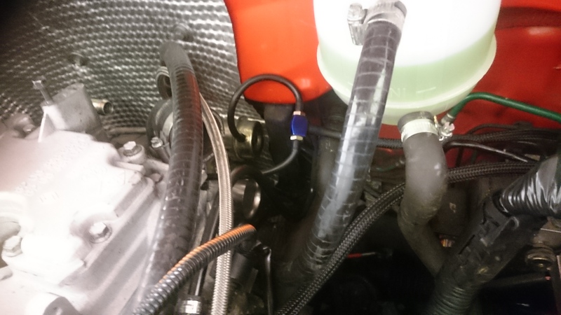

- All coolant lines in and coolant replaced as well as bottle replaced
- Oil lines all ran in
- Breather setup started but want to move it
- Sump replaced with new gasket
- Bulkhead heatshield fitted
- Downpipe loosely in place

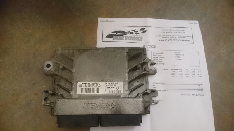

Had a nice message off Engine Dynamics to say they have already posted my ECU with base map. Excellent customer service as they only had it delivered yesterday.
Next days off I will get the boost piping and intercooler in and then it's wiring before securing everything 100% and putting exhaust on.
You might find the 850 belt slips, you can't tension them properly with epas set up. I never go longer than 838.
Pull the drivers shaft out, only takes five minutes and gives you so much more room.

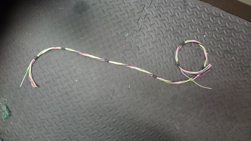

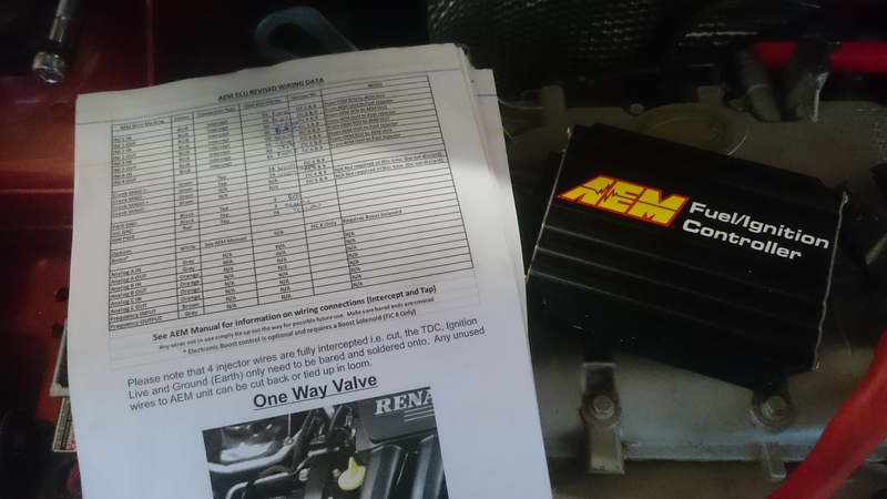

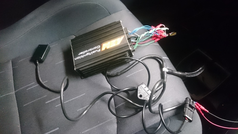

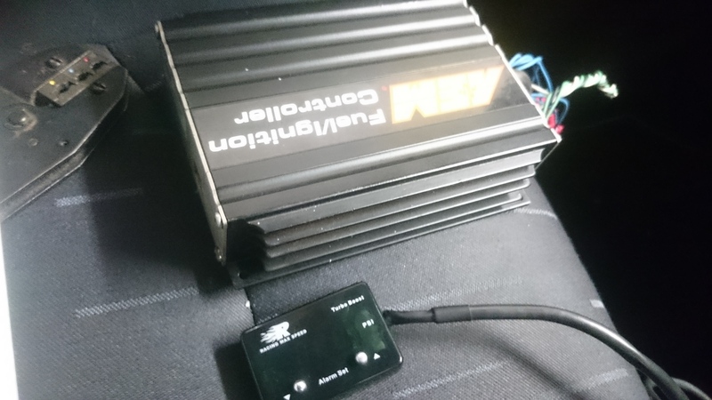

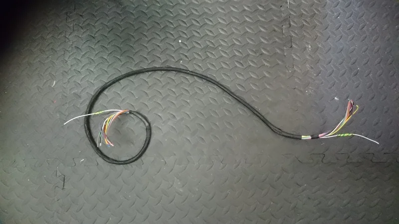

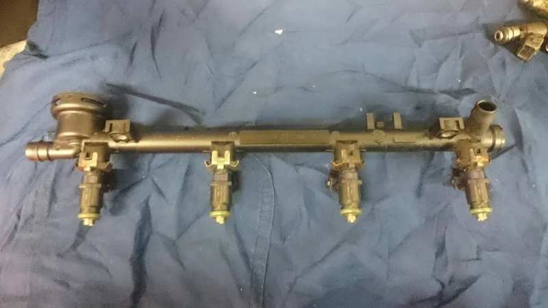

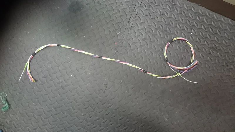

- Ecu is back from engine dynamics

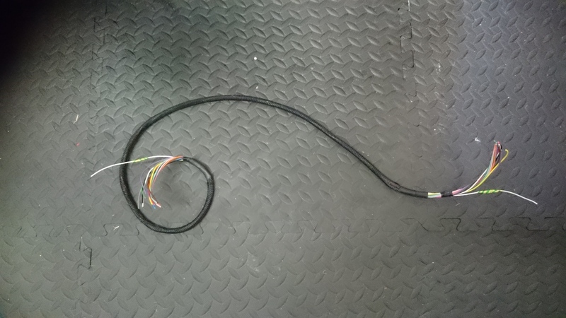

- made up 13 core wiring loom for piggyback ecu
- Megane plugs in set at 0.9mm
- Megane injectors in
- started mocking up more of the pipework
Also picked up some new magnecors for th rebuild time.
I’m using the AEM to, have engine dynamics mapped the standard ECU and the AEM? I was under the impression it was just the AEM that modified the signal to the standard ECU? I’ve not spoken to them yet so interested to know.
They need to put a turbo base map on the original ecu and AEM then piggybacks for injector control

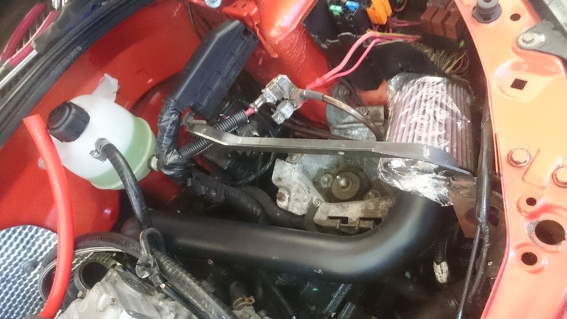

Well another short spell between Christmas running around and managed to sort a few more bits.

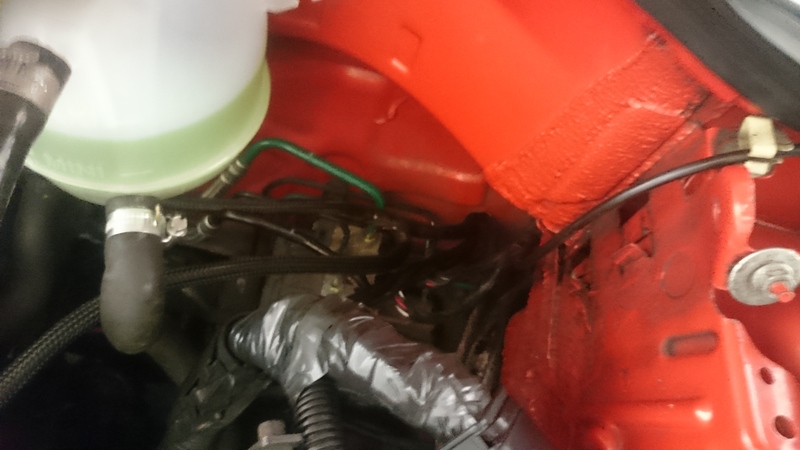

- Vac lines ran in
- Wiring complete to AEM unit
- Boost gauge piped and wired in

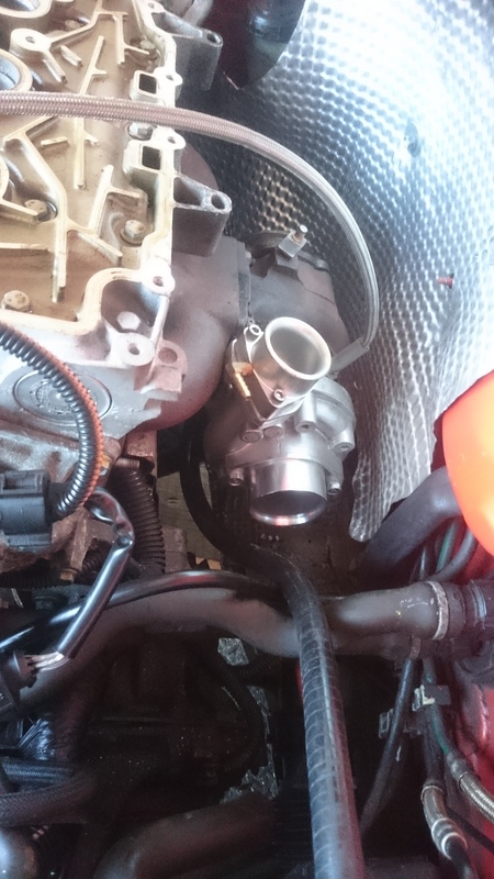

Need an extra pair of hands for lining up downpipe and some smaller arms to get to underside bolts on manifold. So my brother has drawn short straw haha.

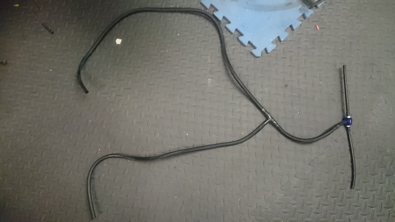

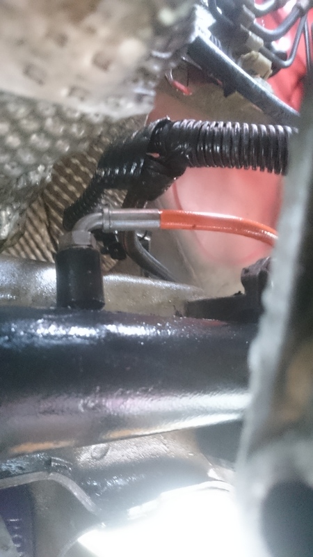

All the lines have been covered in braid to add to the factory look.
I had the opportunity for an hour in the garage and even better my brother came round in his trophy to help @matty1995

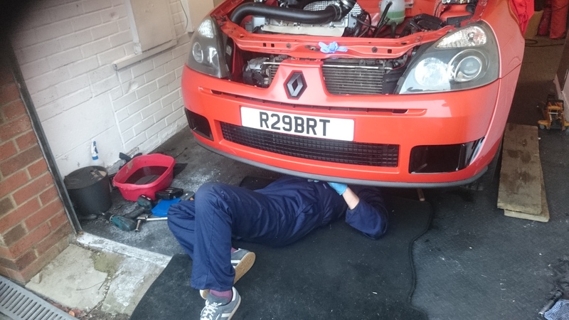

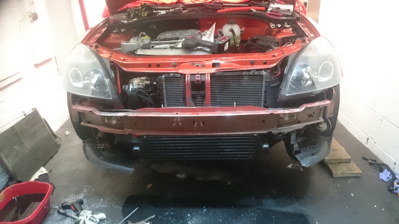

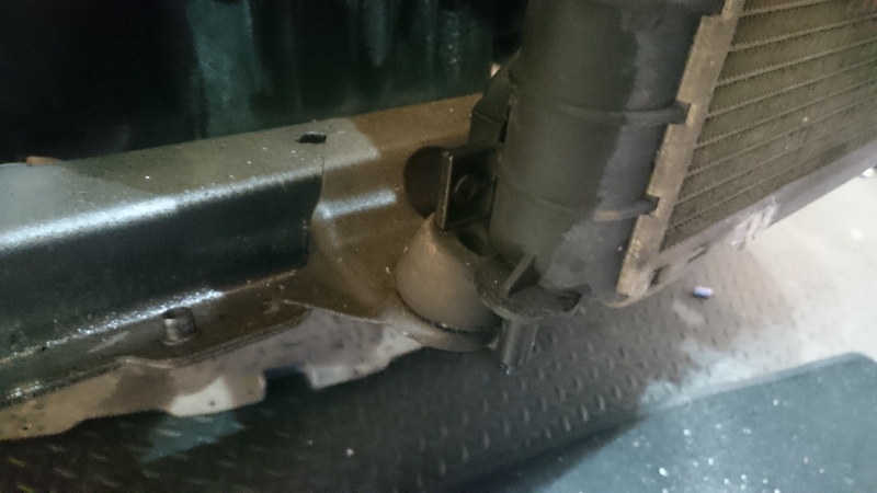

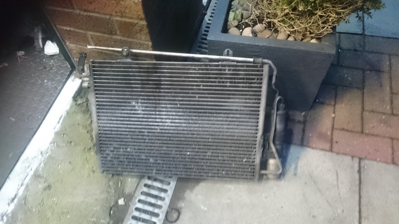

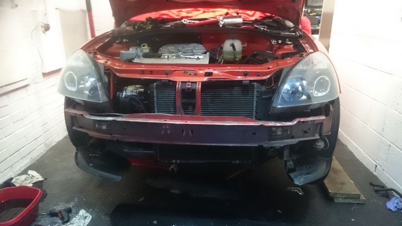

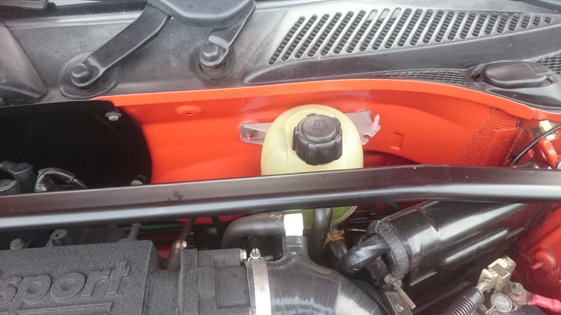

So we now have turbo bolted on fully, downpipe fitted and when he left I spent half an hour removing aircon rad and mounting the intercooler......
Also had to mount radiator correctly as wasn't sat in its rubber.
Nice and stealthy....
