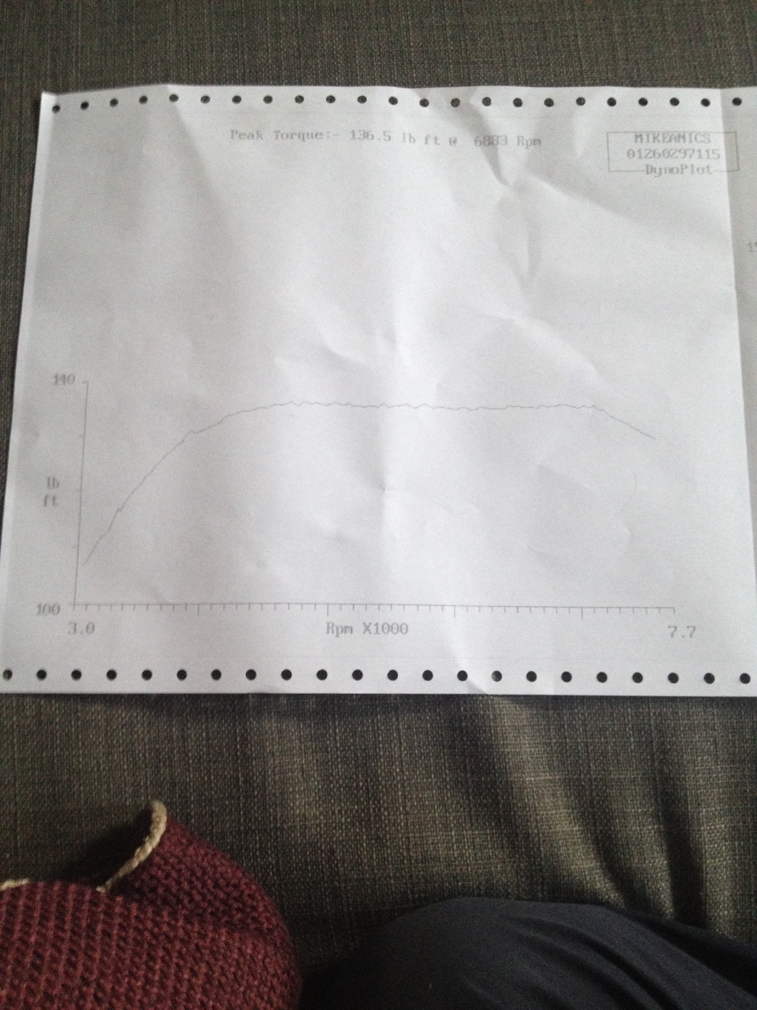

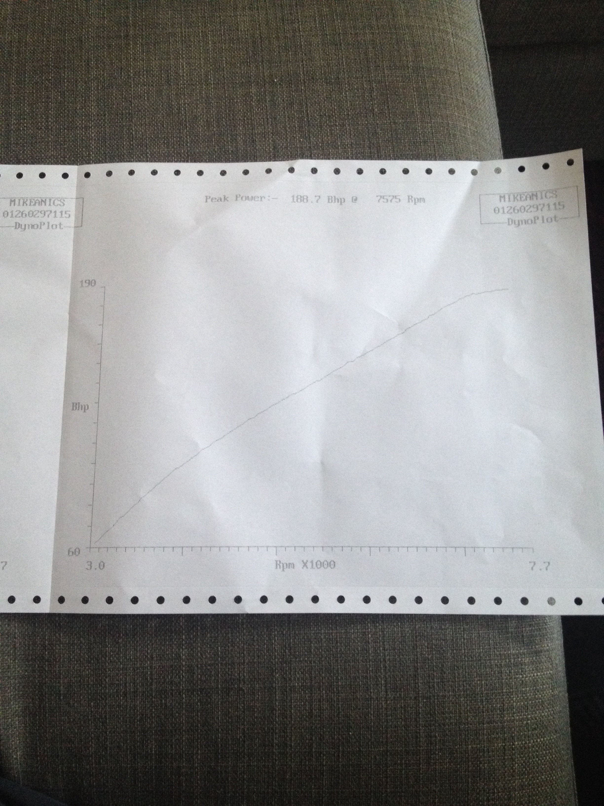

Right don't know what to say really! Good and bad news!
Made 188.7 bhp and only 136.5 in ft
BUT the torque curve is very flat, as I said before feels very reponesive it makes 130 ib ft between 3800rpm all the way to 7300rpm
Still I think the car had very good numbers before With just beathing mods (and it was a very damp day)
Oh well surpose I have to wait and see what the 438 cams do!

@Hatto So £850 down and you've got more torque across the rev range but less torque at peak and less power at peak?
A little bit more power, but like I said not mapped to suit I'm sure if it was would be a bit better, but still id say it was a waste of money!
realnumber 1
Problem is that bit more power is right at the top of the rev range so in reality your peak power was probably better/more usable before.
Hope a decent map changes that and the torque for you...
  306 gti6, Clio 182
If I'd never got it on the dyno and never known the power I'd say it feels quicker! After fitting the kit it felt very responsive low down!
What can I say think I was expecting mid 190 really!
Iam not surper disappointed, because I've got 438 to go in and will be mapped to suit, I'll just have to wait if results are crap then I'll be very upset
So basically its made no difference! you need it mapped, when i had cams fitted the the RR before mapping and after mapping was 15bhp difference, i think you'll see a nice difference with a proper map!

1.7 bhp not a great result but if its not mapped its to be expected. If you put itbs on and didnt map it you would probably get the same power. There is no doubt the engine is getting a lot more air in a lot quicker than before just simply down to the more direct route if the fueling hasnt been compensated for the added air the mixture wont be right therefore not producing anymore power. I dont think its a waste of money the sound alone is probably worth some of the cost. In hindsight its probably too expensive for what it is and should have been £500 but i guess the 2 guys on here and me have took one for the team as is always the case with a new product. I am still hoping for some decent results as mine is getting mapped, to be fair the tourqe is what i wanted not a headline bhp figure so iam quite pleased that it has given a smoother tourqe curve. Hopefully wont be too long before i can get mine mapped .
